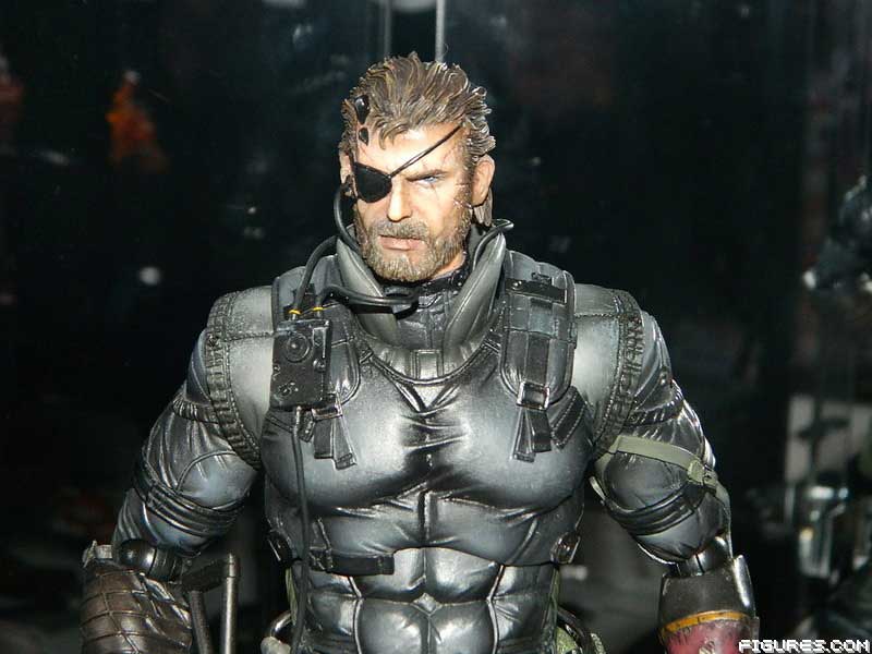

The other topic I wanted to cover in the design phase of this project is the actual "texture" or layering they seem to use in this particular sneaking suit, as the previous ones have been thinner and more like Navy SEAL, diving or tactical wetsuits while the DD's suit has very clearly, muscle shaped armor plates particularly in the vest area:
As you can see, there's a lot of creasing, I'm not sure if I would use a thin layer of black leather or if I'd be better off avoiding the unnatural wetsuit look of the armor and going straight for a plated look on the entire suit, here's another pic:
As you can tell, I'm still very undecided on how I'm going to achieve the effect I'm looking for in this suit, by all means please share with me any insight you more veteran prop makers may have as to how you'd go about it. Thank you for reading, I look forward to updating my thread further as the weeks go by.

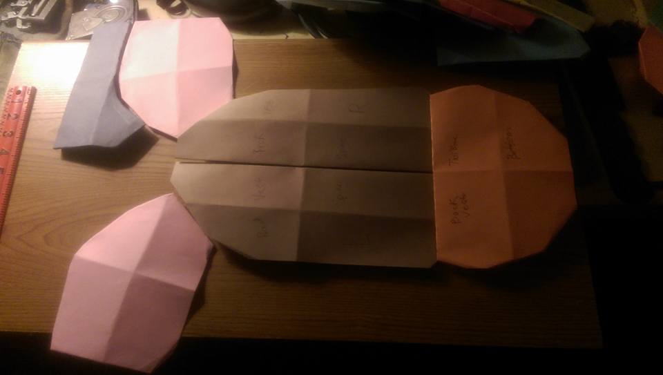

The Kydex finally came in, wasn't in a rush though as I'm still making the design of the suit fit to the proportions of my body by using craft paper and a tailor's measuring tape:

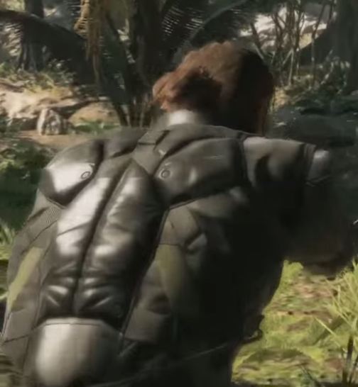

Another problem I've encountered is that I can't seem to find a good high-res shot of the back part of his sneaking suit, other than maybe watching the gameplay demo vids and pausing them when he's got his back to the player's camera. I'll continue to update by the end of the weekend, thanks for reading and I'd still be much obliged for any tips the community has.

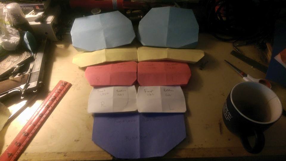

It's been one hell of a summer, thanks to two very terrible online courses I was taking with my local college (that I had to get out of, whom I'm still fighting about getting a full refund) and playing the Witcher 3...well let's just say I simply haven't worked on this project like I should have. There's still a lot to be done in terms of design, luckily I had some help yesterday to measure my back area with a measuring tape because I had "eye-balled" the general size of the armor for my back by looking back and forth from the few pictures I was able to screencap of his suit:
Here's how my design came out:
