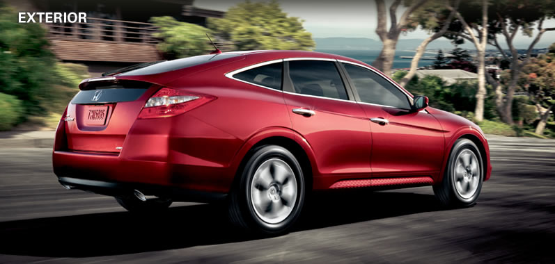

I'm looking to achieve a metallic paint job like on most cars but at home. Not a chrome or mirror polished look, just something that looks like the finish of an automobile. I've heard that you can get automotive paints from automotive stores, but am uncertain as how well the paint job would be. Does anyone know how to produce the desired effect? Please provide examples of work if possible.
Thank you.
Here is an example of what I mean:
alot of folk use normal car parts store rattle cans , just need to be carefull as some melt the plastic
idealy you want acrylic based paint not laquer/cellulose , and use a plastic primer first on plastic models
when you get really picky some of the flake can look too large for a model
if you need more "how to" info just ask , i paint cars for my job
In my part time guise as a custom painter, I use Createx Auto Air paints. For a pearlescent finish like you want, you'll need a black basecoat, pearlescent colour and then a good lacquer over the top. Auto Air have a number of quite fine grained pearl colours as they are designed to be used with an airbrush.
