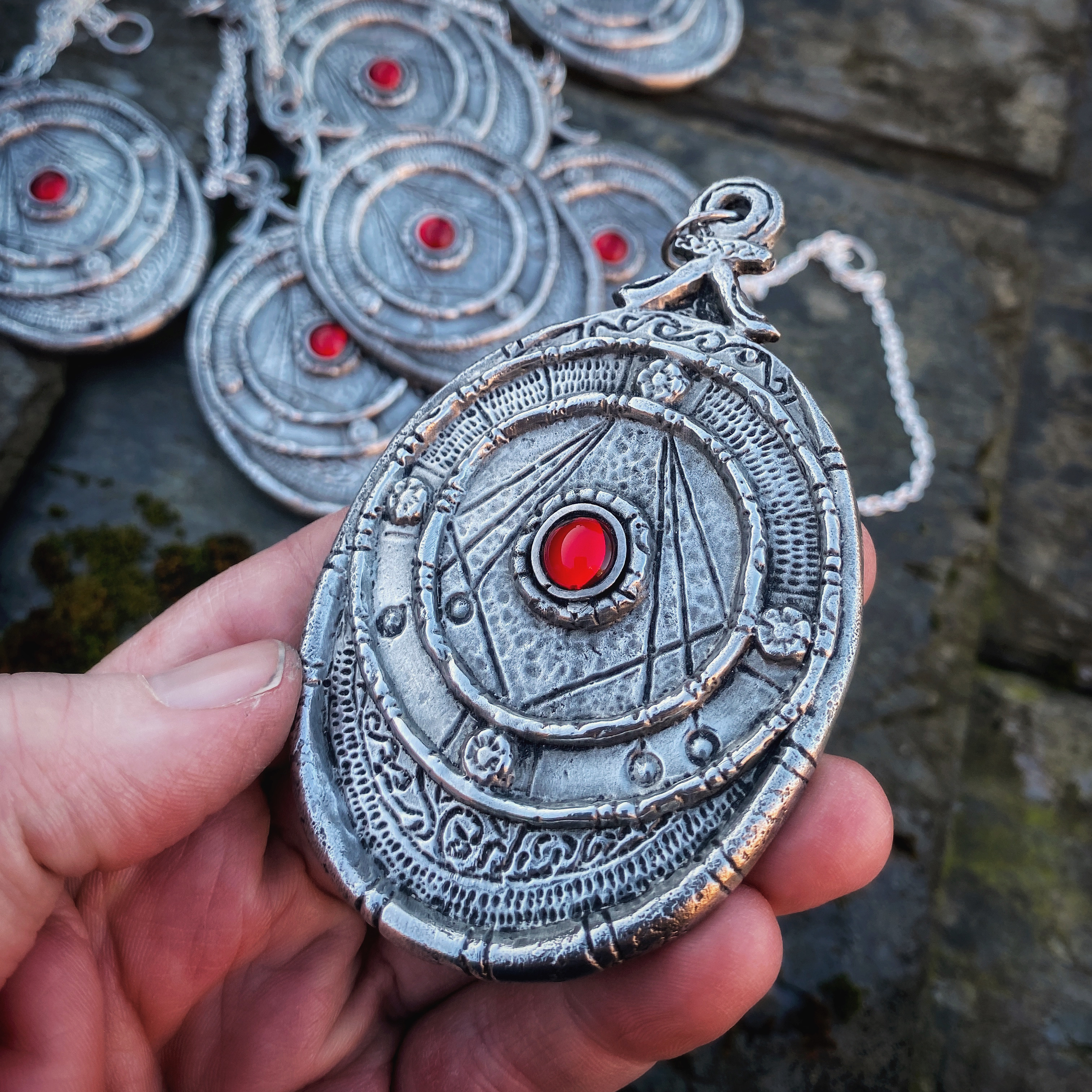

OK guys, a little update on this project.
I've managed to get a much cleaner cast from the mould. I've got to say I'm MUCH happier with the definition on this one, I think it's pretty much there....
I still have to find the "stone", the quest continues....

Hey guys, Here are a few shots of the medallion all pieced together, stone, chain and all.
This is the most recent cast from the mould. I have been experimenting with heating the mould to help the pewter flow into the details. I'm then forcing the pewter into the mould with as much pressure as I can.
If anything, this latest cast is a little less defined than the one before it, (but I think it actually looks much closer to the original, due to the much less enthusuastic weathering!) I think the main reason for the lower definition is that I didn't melt quite enough metal to overfill the mould, so there wasn't quite enough pressure, it's quite a fine science apparantly!
Well, back to the fire I go, I'm determined to get a cast I'm happy with!

Thanks James, your making me blush! Honestly, there's nothing too impressive here.
Casting low melt alloys, like pewter, doensn't really require any special equipment, at least, not doing it at this level.
All you really need is a silicon mould, (I use a high temp rated mix), an iron crucible (approx £30 from Alec Tiranti), and some heat. If i'm doing a fairly big ammount of items, I build a real fire. If your only doing one or two items, then you can use a gas camping stove, or just a blowtorch. I've found that a great way to use up the ends of a summer BBQ fire is with a bit of pewter casting, just make sure your sober enough!
The resources aren't to diffucult to come by, you can buy Pewter ingots online, the things you really need are patience and perseverance, it's easy to cast pewter, but it's very tricky to get a perfect cast.
