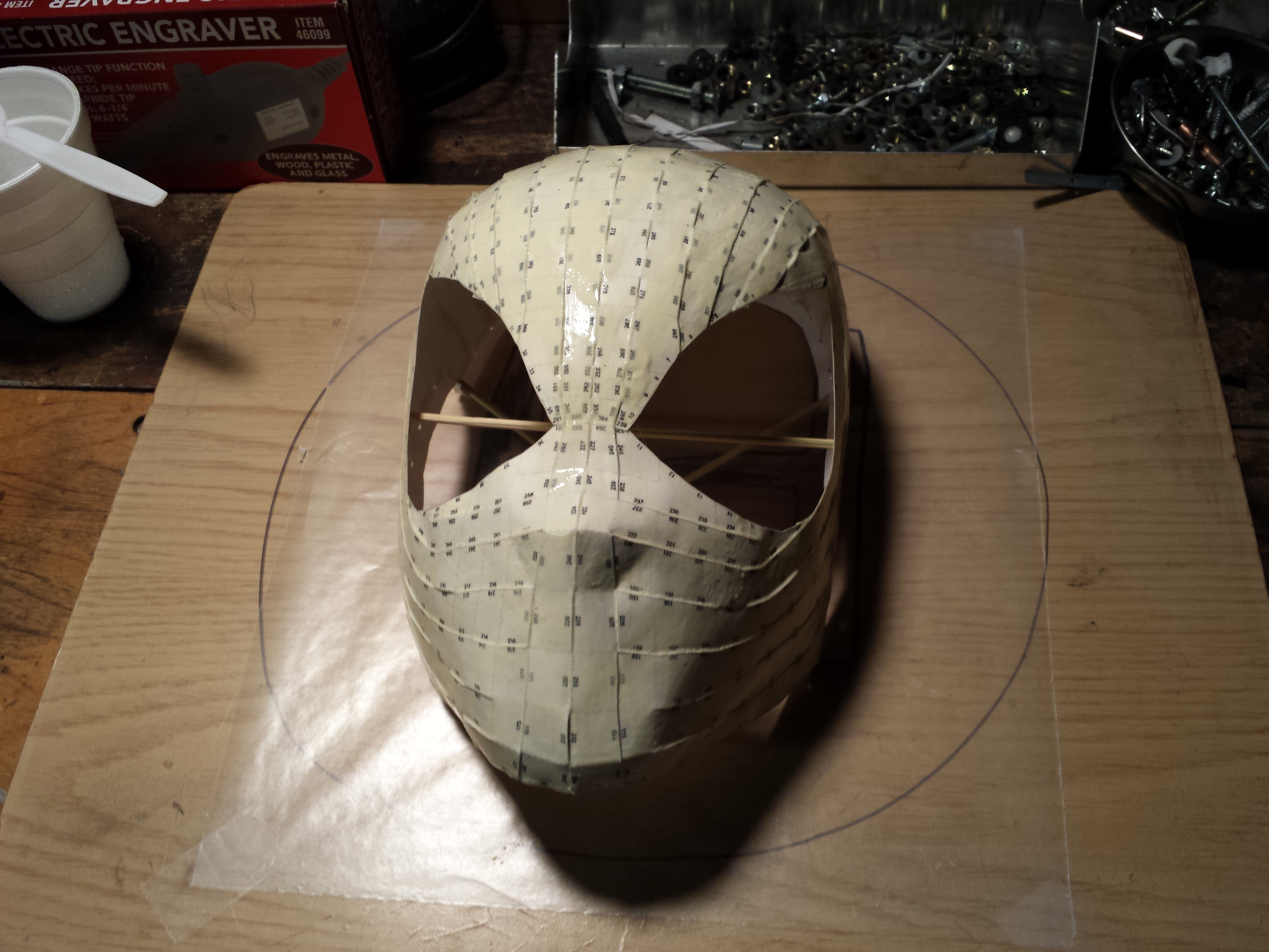

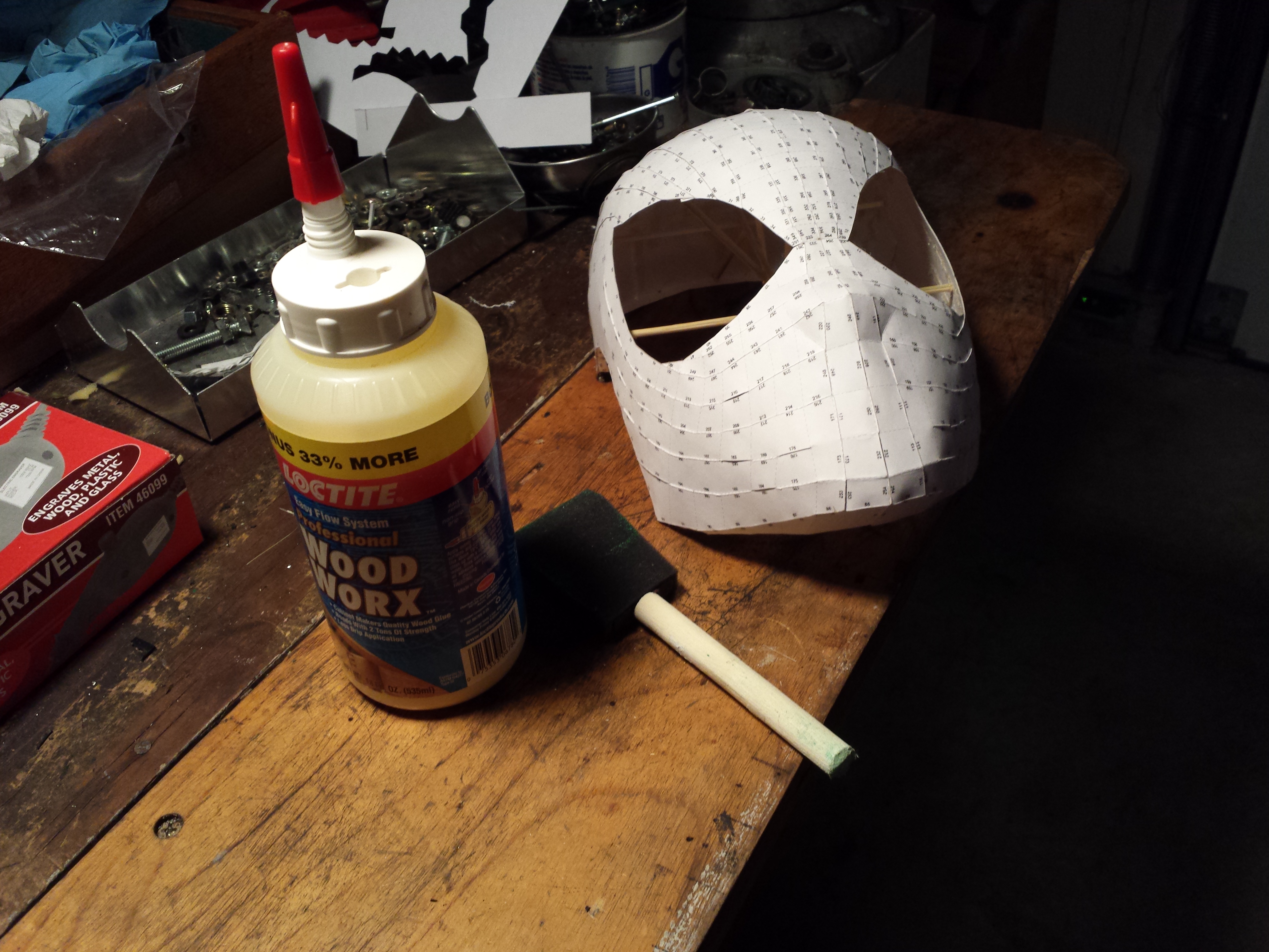

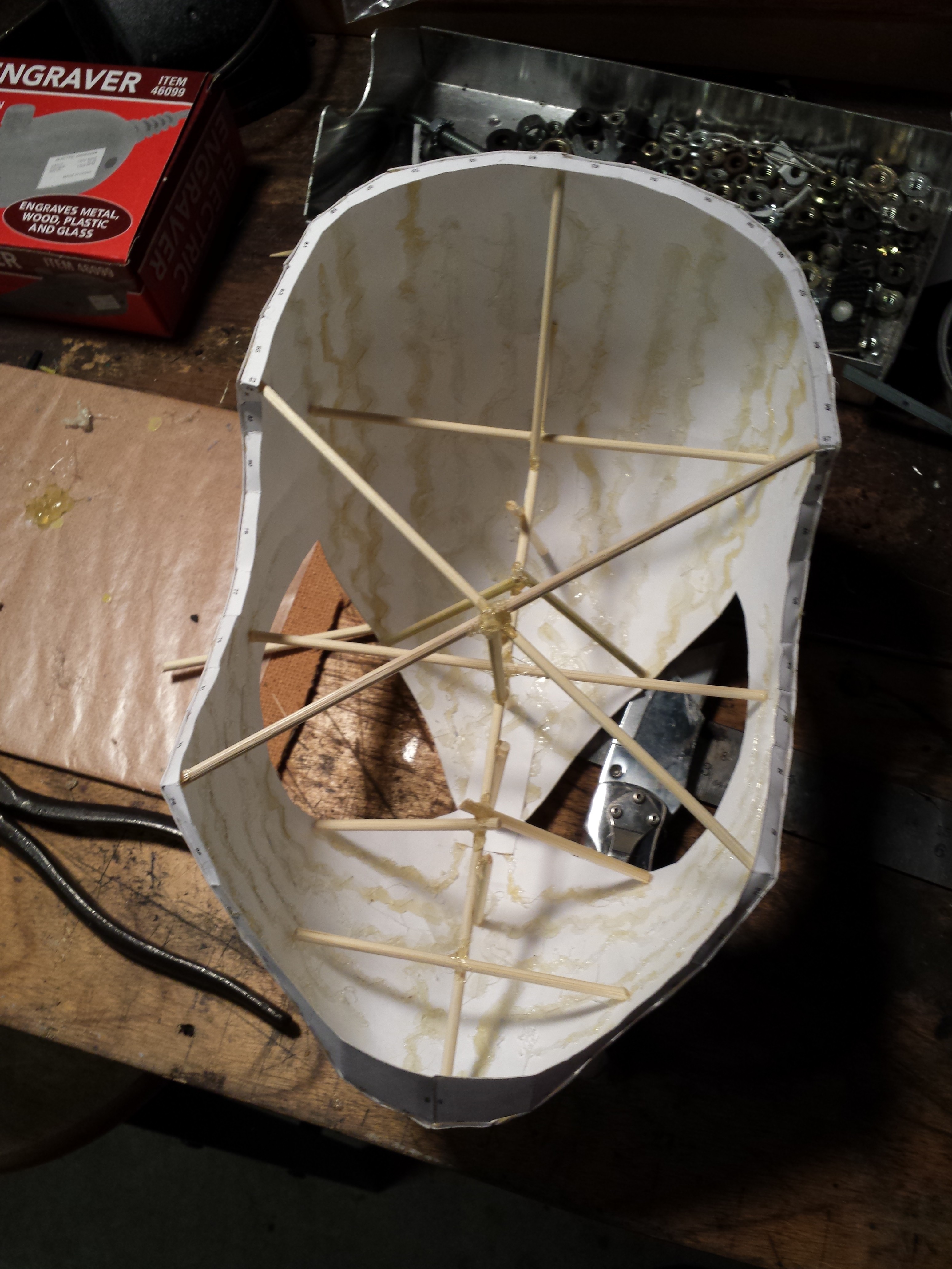

Did some testing using the wood glue method from the 405th forum. I used whatever I had laying around my garage: Loctite Wood Worx.
At first, I thought it didn't work because the cardstock would just become flimsy and not strong. I gave up and was looking for another method for hardening/strengthening, but when I checked on my test sheet and parts, it became pretty tough. It just needed extra time to dry.
Test part. I threw away my test cardstock since I broke it doing stress tests.
Here's my faceshell reinforced with an unnecessary amount of bamboo skewers. I didn't want to risk any warping since the glue is mixed with water. Water + Paper = BAD!!!

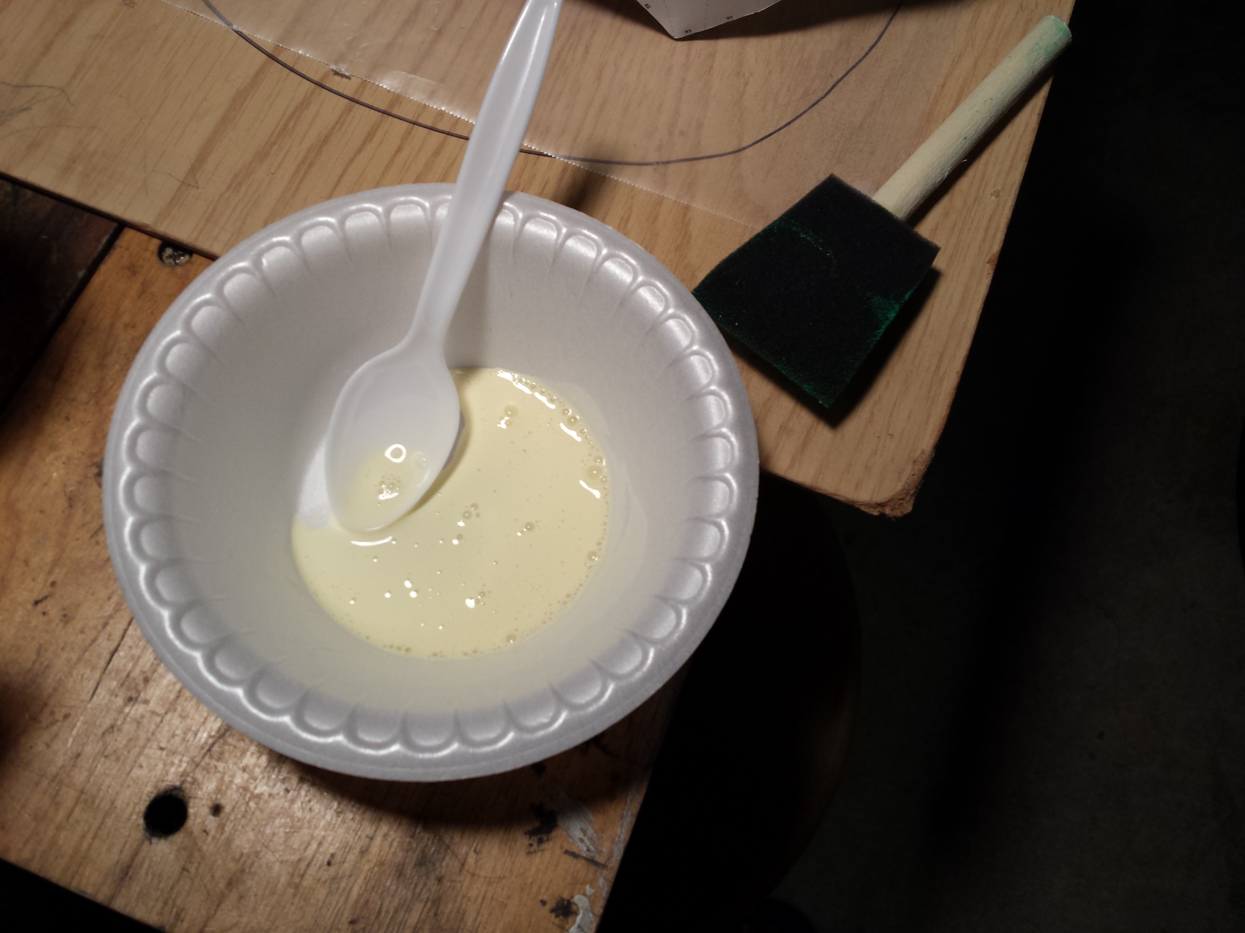

Supplies and prepping the glue.
After about 10-15 minutes, I finished the first coat for the.
I waited about 1.5 hours for the glue to settle. I then applied a slightly thicker second coat. I'm going to wait until sometime tomorrow to add the final layer and then let it dry for about a day. Then I'm going to remove the bamboo braces and do about 2 coats inside the faceshell.

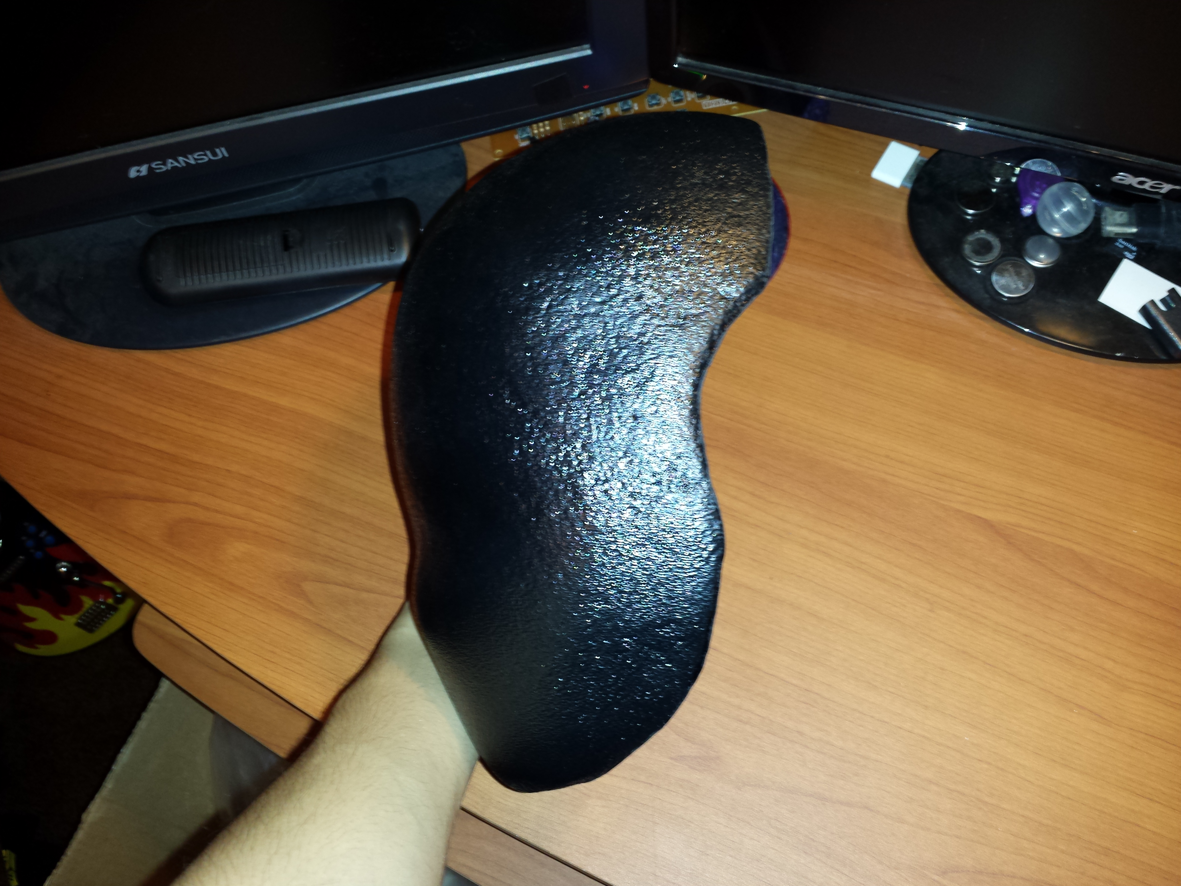

I finished up the coats of wood glue. It warped around the eyes a bit, but that's my fault for not gluing on the eye frame supports.
I also filled and smoothed it out with wood filler and primer/filler spray paint.
I didn't really bother with getting it perfectly smooth since it's pretty much unnecessary.

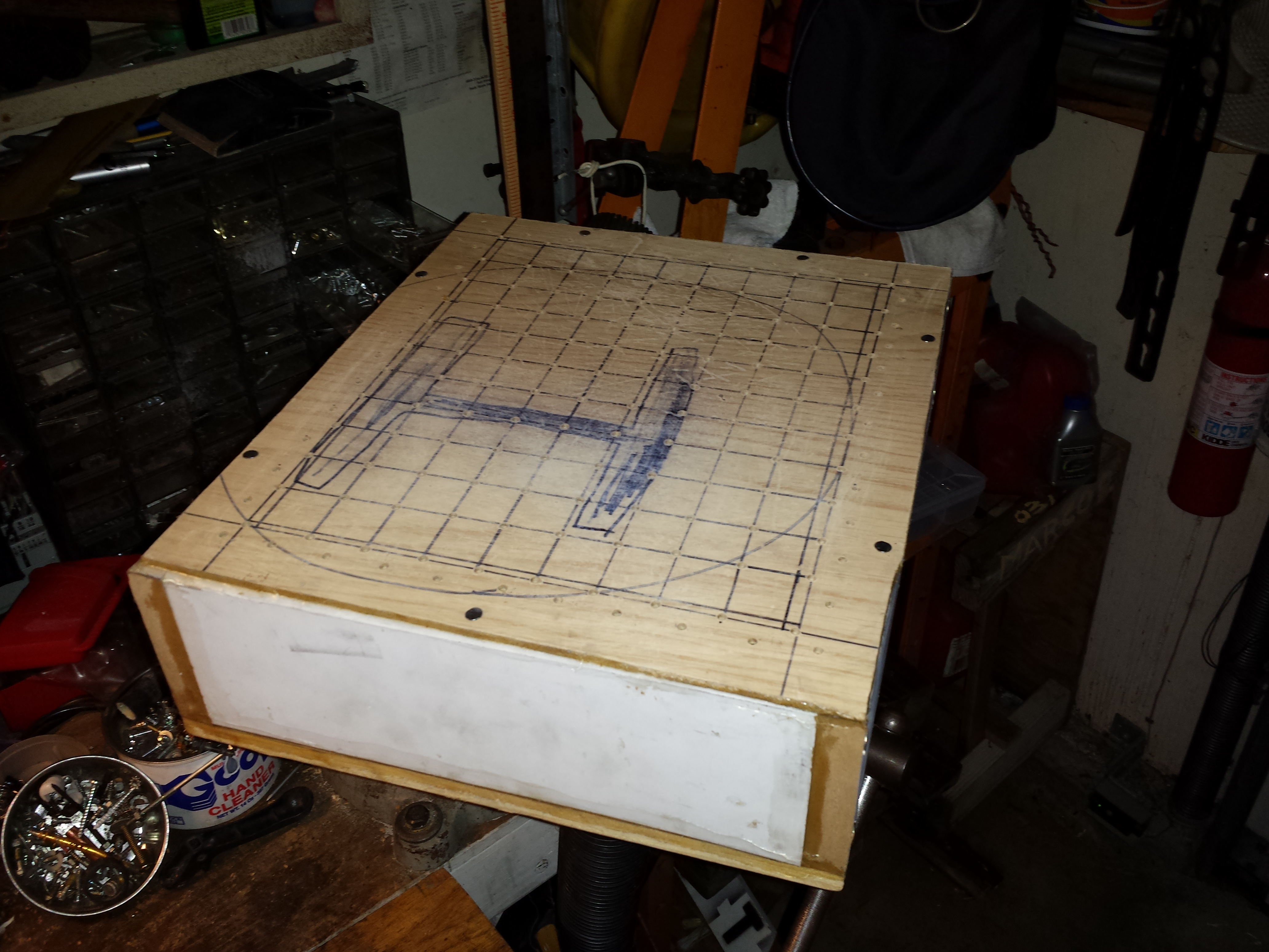

I finished the vacuum former earlier this week. I have to say, I'm pretty impressed with the outcome!
Here's a small test I did with a ball bearing toy. It takes the shape really well!
Now that I know it works, I need to buy some casting/molding material and some larger plastic sheets! :)

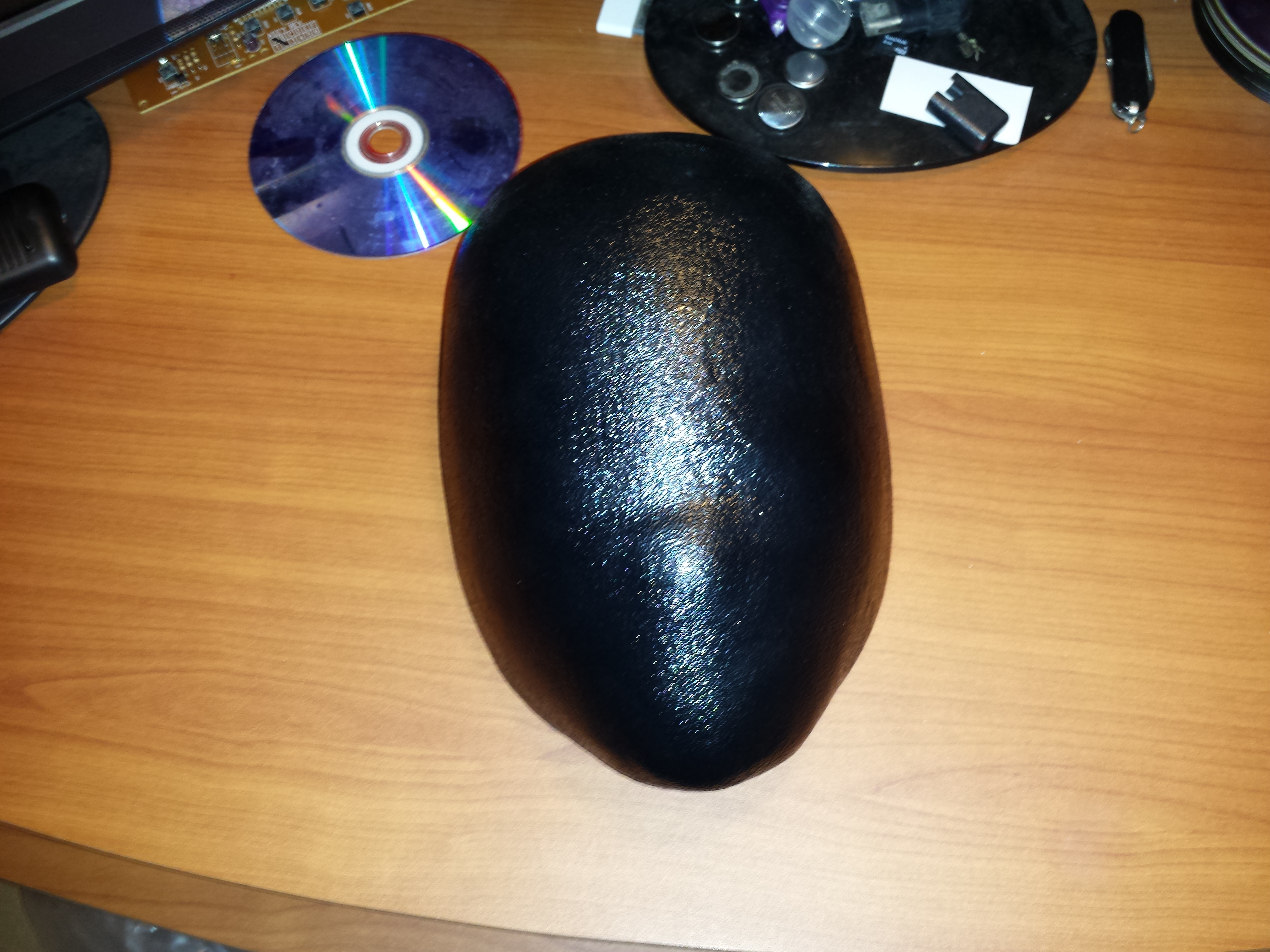

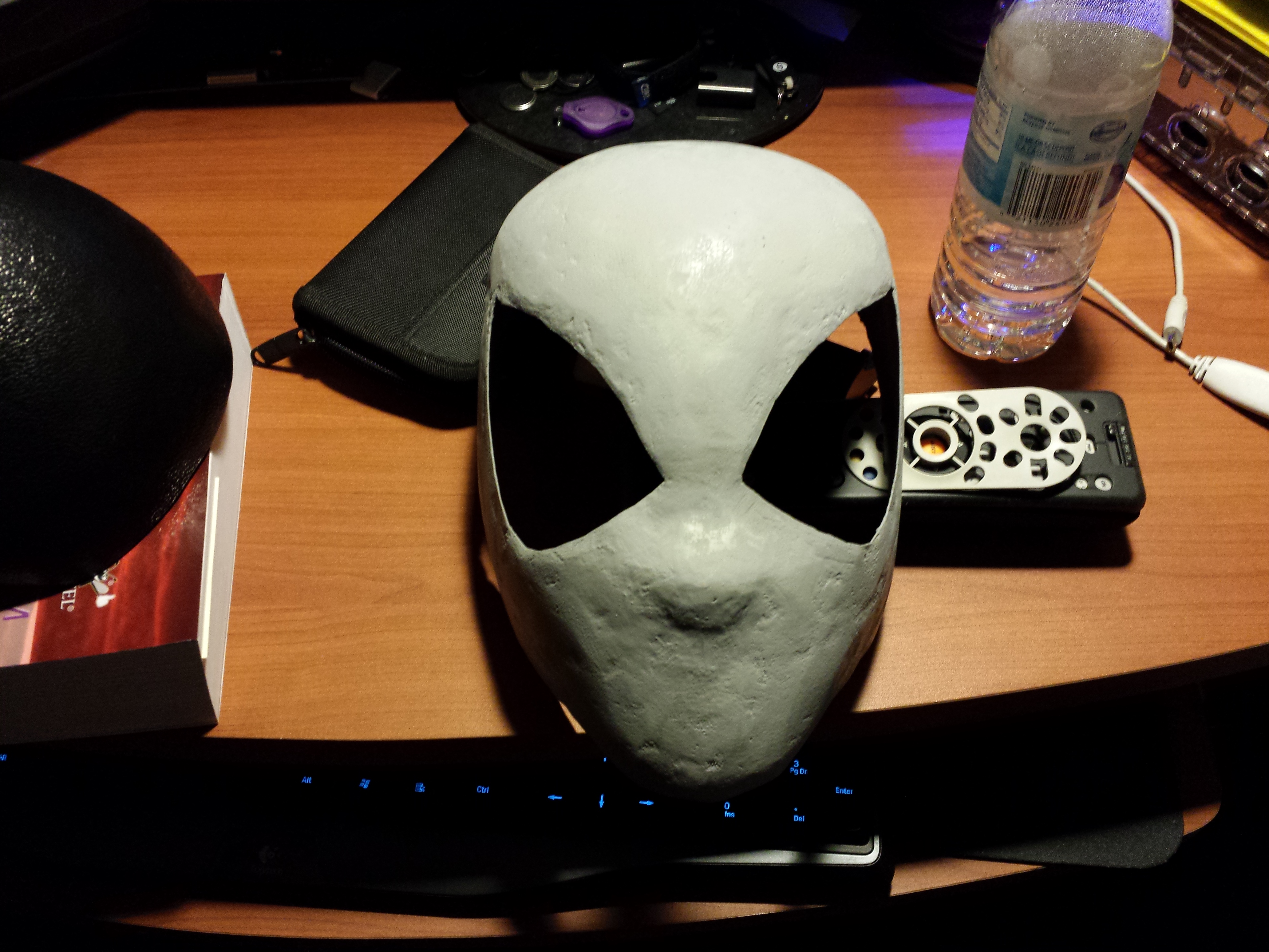

I covered the eyes on the shell and used drywall spackle to make it a little more round.
After I got the supplies, I created the mold and used hydrocal(plaster) to cast.
IMG_20141016_230449.jpg IMG_20141024_202156.jpg IMG_20141016_213100.jpg IMG_20141016_221419.jpg
This thing weighs a ton!! I used a chisel and sand paper to lessen the size of the nose. I also made the head more round.

I've always wanted one. But never had the money to buy one. So I looked through my garage and had the right kind of wood to make it for free!
I say go for it! There can be a lot of use from one.
meowz0r
I don't know the exact kind, but I used 3/4" thick wood that was really dense for the bottom and the four sides. For the top, I used some ~1/8" thick plywood and drilled 1/8" holes every inch. I also used a lot of caulking sealant.

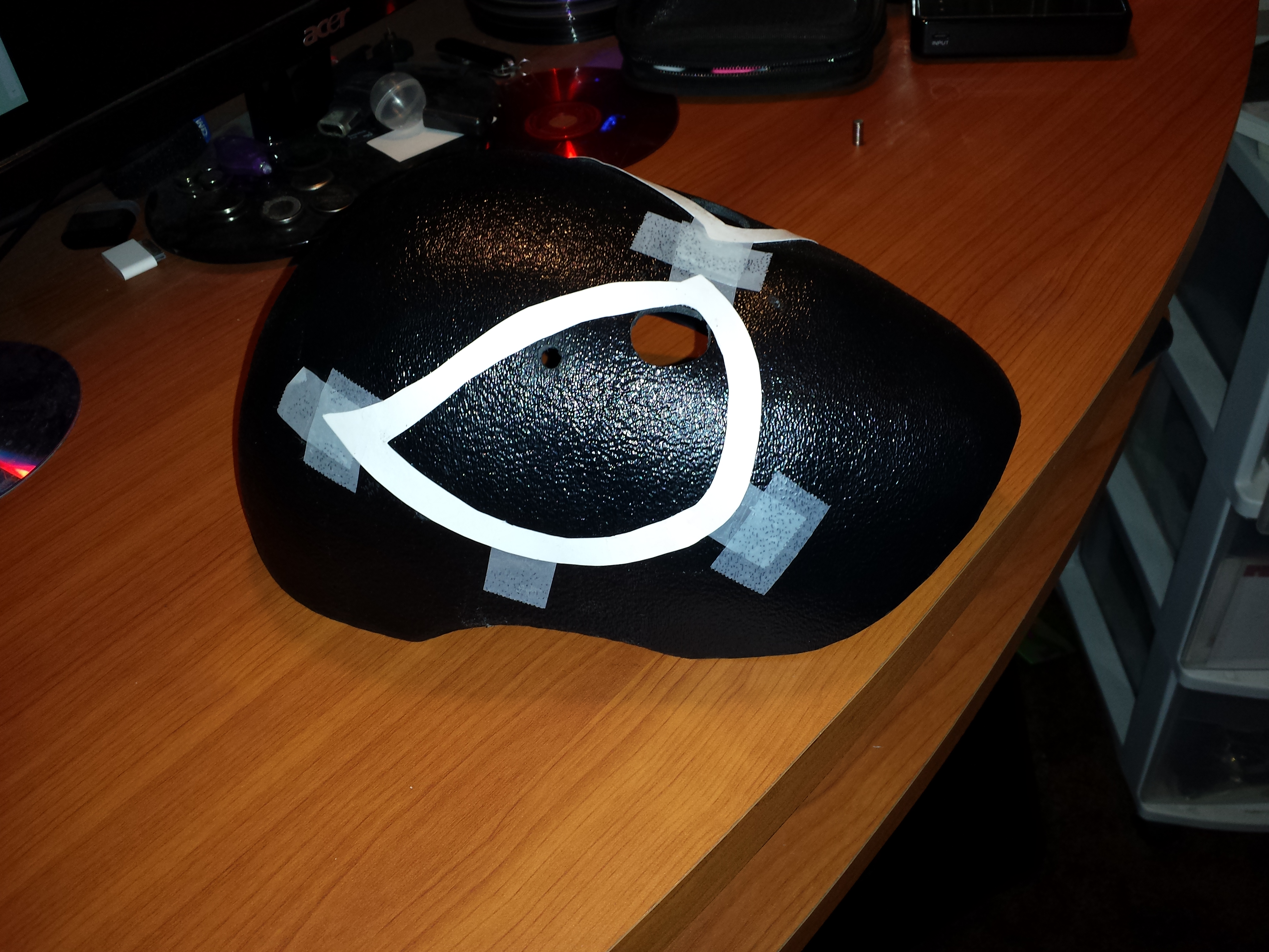

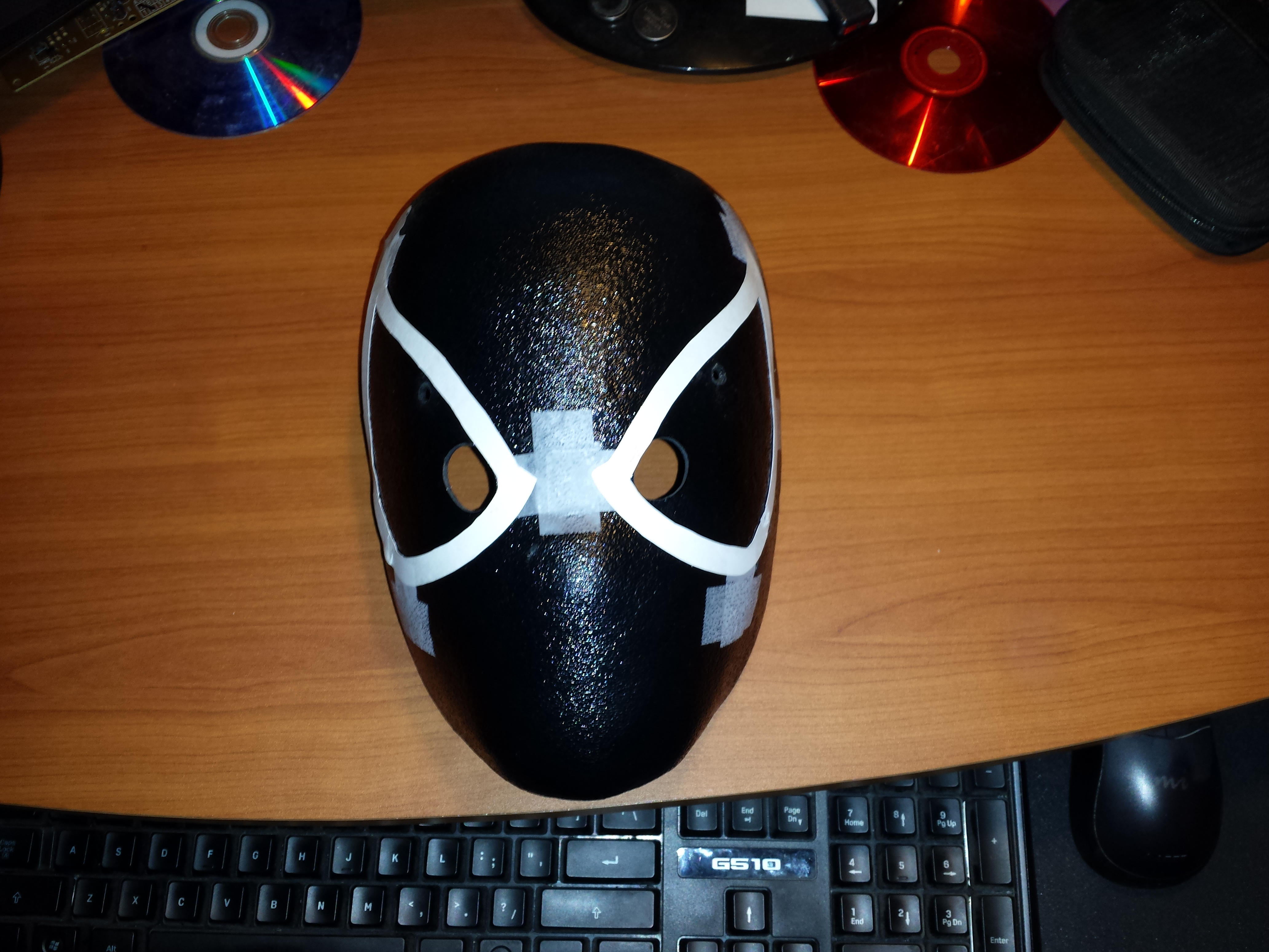

Forming the shell. This was the most exciting part! I heated 1/8" thick ABS plastic I got from a local supplier. I now know that 1/8" is too thick and will probably go with 3/32" or 1/16" next time. The shell is slightly smaller than TJack's.

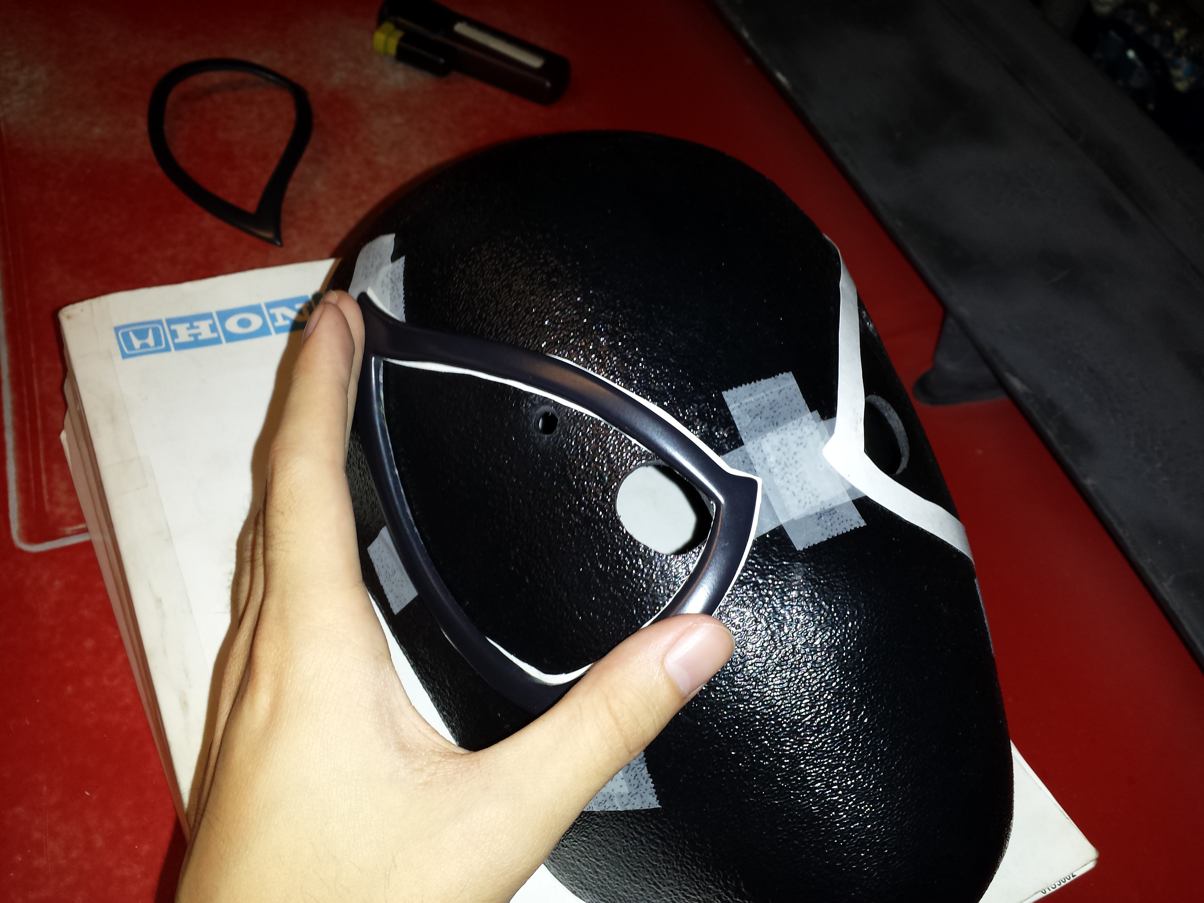

Next, what I thought was the hardest part, forming the lense.
I used boiling water, it wasn't hot enough. I used a lighter torch, I burned some parts of the lense. I finally gave in and used my heat gun. I set it to low (650F), and held it about 2 inches away and evenly heated the frames until they became moldable. I have magnets to attach the frames to the shell, but they are too small and not that powerful. I ordered new ones. They should be here by next week.
What do you people think about the angle of the frames? Does it look good?
