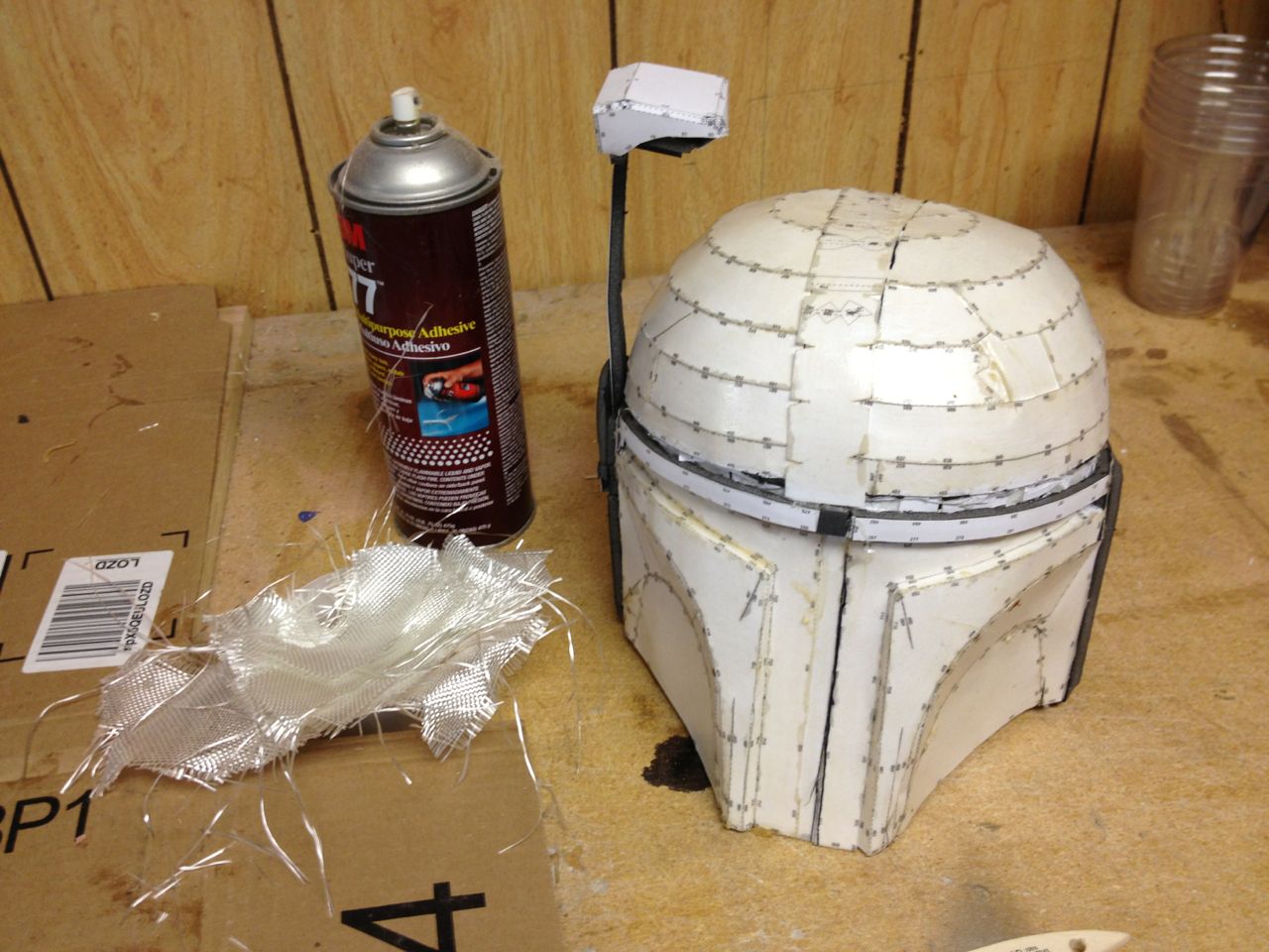

The helmet was done with the Pep technique using 100 weight cardstock for the basic model. After scaling the model to my sons head size and making 3 helmets shells until I was happy with the model I then used resin to strengthen the shell and followed that up with 2 layers of fiber glass on the inside. After the fiber glass was the bondo to smooth out the shape. ( I learned allot of lessons doing this. In the future I will sand down the facets to a smooth shape. i had enough fiberglass on the inside and it would of saved a lot of bondo.) After many layer and countless hours of sanding It was ready for glazing putty and wet sanding. Primed and then painted with enamel rattle can paint. I wanted to go for a non traditional clean look for this Jango armor. I wanted it to look really used so I weathered it quite heavy. I scuffed it up a bit and dry brushed rub and buff on to look like the paint was coming off. I used black and brown acrylics for the grim. The inside has foam for comfort. No visor present in these photos.

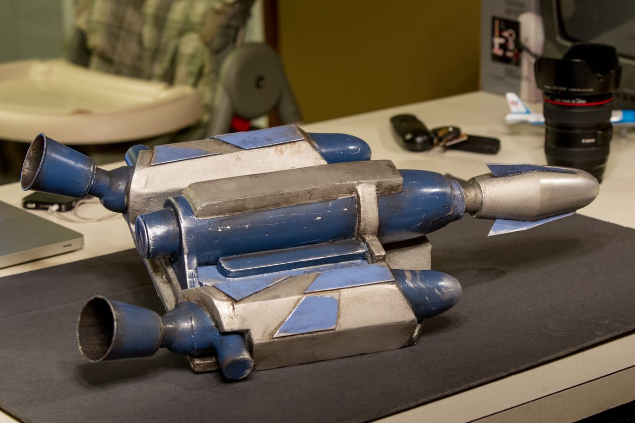

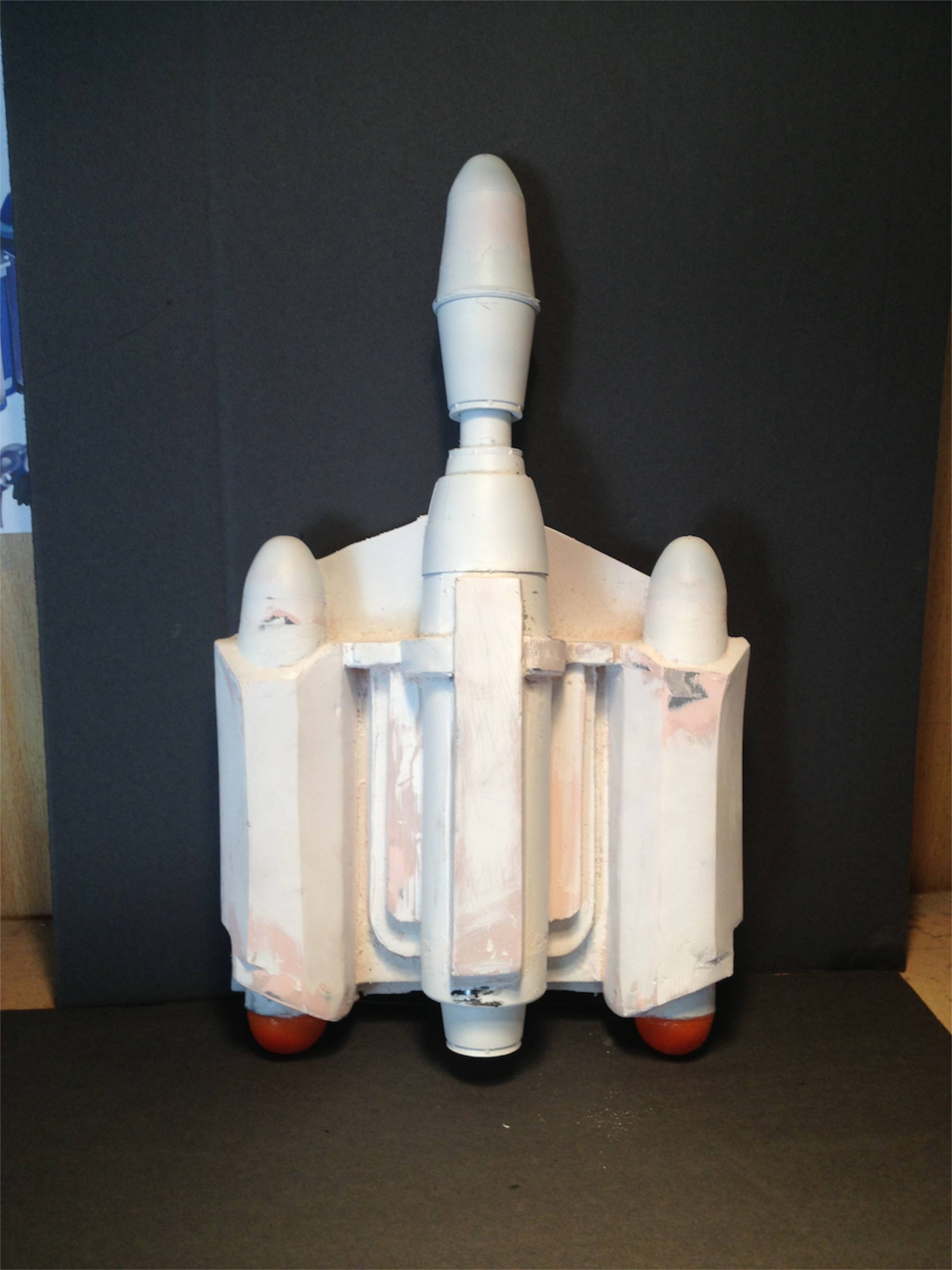

The jetpack was a big challenge for me. There are allot of curves and tapers that I was unsure how to do. I used EVA foam for the flat surfaces with a square piece of MDF for strength on the back. The cylinders were objects that I had on hand. The main "gas tank" was from a tall beer that i had "on hand". For the tapered sections I scrounged up a McDonalds cup and a couple of rattle can lids. They all fit together so they made it into the model. The thruster tubes were paper towel rolls that I strengthened with resin. I wanted to use PVC but I had to save weight. I ran a long piece of PVC for the missile on top was made with 2 dixie cups glued together with an easter egg on top to make a point. The thrusters were from dixie cups and PVC. I used hot glue to hold everything together. To seal up all the foam I covered it in mog podge and then used bondo to fill the gaps and make flat smooth surfaces. Details were done with styrene. Painted it with rattle cans and weathered with acrylics and rub and buff. I wish I would have taken a picture of it before the primer because it looked hilarious. I screwed some snaps on the back to attach it to a harness under his flack vest. The jetpack weighs in at just over 1 1/2 pounds. Now I know that this version of Jango's jetpack does not have this type of missile on it but the boy insisted on having one and I liked the color of this version.

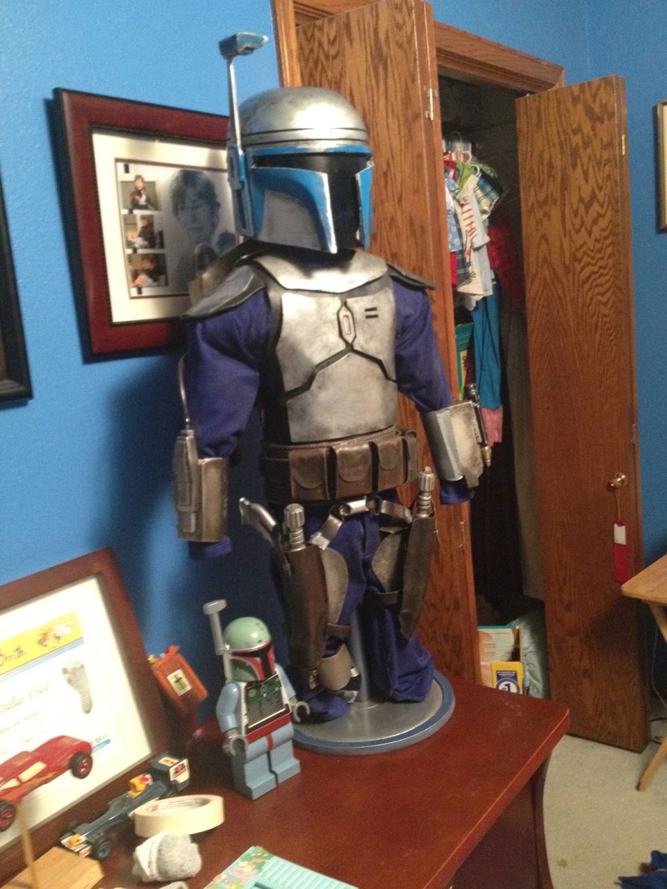

6th: What to do with it when you are done. I would like to display this costume and let him mess around in it from time to time. I decided to build a stand for it and display it in his room but it takes up allot of space. I am going to hold on to it for a few years and hope it will fit my youngest son in 5 years or so. ( I hope he is into Star Wars)
Thanks to everyone who made comments on the costume. This is a great community to be part of, so much talent out there to aspire to. He turned allot of heads while we were out and he was asked to take allot of pictures. He was loving it. Nice to see all the other kids in Star Wars costumes. I had to answer allot of questions about how it was done. I had a great time building it and now have the building bug. I would grade it at a C+. I would do things different next time but for my first project I am very happy with it. I am now designing my own costume for next year and cant wait to start the construction. I would like to start on the kids costumes but I don't know how much they will grow through out the year. I will make sure to make a post with my next project.
Here is a pic of the costume on the stand I built for display.

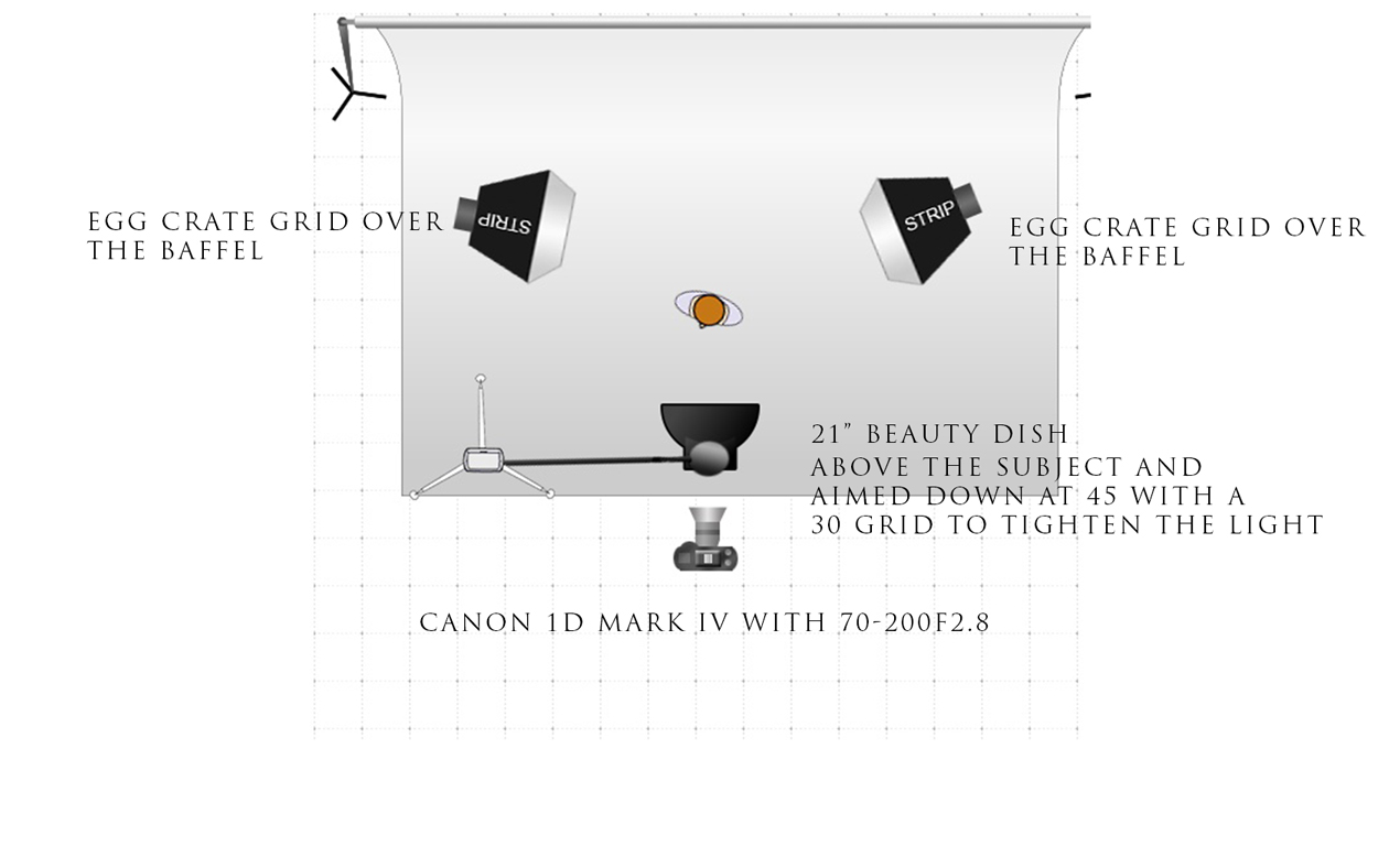

I love these pictures. You mentioned that you used a lot of light and Adobe Light Room.
Can you elaborate on the type of lights you used and did you use one spot or multiple sources?
medic427
bzaitz,
I am glad that you like the pics. Below is a lighting set up for the images. The light set up was designed for drama. To achieve this I placed one 500 watt second on either side of the subject. On this light I placed a strip bank with an egg crate grid on the front to tighten up the light. With out the grid I get a lot of light hitting my lens because they are behind the subject just out of the frame and facing toward the camera. If you dont use the crates you tend to get allot of flair in the lens (not always a bad thing but it didn't go with this image set). These 2 lights put light on the edges of his body spilling on to his face. It makes it look like there is a strong light source behind him like the moon or sun. It gives the pic allot of punch and separates him from the black backdrop. To put some light on his front I used a 500 Watt second light with a 21" beauty dish with and a 30 degree grid on it. This put some bright contrasty light on his face and made his eyes sparkle. The grid was used to make the beam of light very tight falling off fast as it made it to his feet. I had the power on the lights cranked up fairly high so I could shoot at something like f18 or so. I wanted everything in focus and I was shooting from 10-15 feet away with a telephoto. I could have used something wider but I like the compression you get with a telephoto. I used a black backdrop behind him to hide all the junk in my living room.
For the retouching I used a fairly light touch. I first selected the ones I liked in Adobe Lightroom. I did the bulk of the retouch here. First was to correct any exposure problems. I got it mainly right in the camera. I did have to reduce the highlights a little. His shiny armor was kind of a pain to photograph. ( this is where softboxes come in handy it reduces the bright highlights you get when you photograph shiny objects)
After that I played with the color temp of the photo. I shoot in RAW so I can adjust the color temp of the photo in post. I went for a cool look for the photo. This man is a trained killer after all and a cold tone to the photo worked for me. I also added a touch of green but its very hard to really see unless you know what you are looking for.
With the color the way I like it I cleaned up some of the junk I saw on my backdrop (cat hair and some other grime, I really need to wash it). His armor was supposed to look dirty so thankfully I didn't have to touch the costume.
Shadow control was next. I lightened up the shadows a little to soften up the contrast a little. It's something I find I have to always do with this kind of lighting setup.
I pushed the Clarity up by a couple of steps to make the grim on him show up a little more. It also gives a little more contrast to sharp edges making things like wrinkles and fine details "pop"
After all of this I took the image into photoshop to put some smoke on some of the blaster images. I found some smoke assets I have that are on a black backdrop. I dropped them in the image. I scaled them and blended them in to the shot. I did a little sharpening and exported them as JPEGs.
I scaled them down for the web in lightroom
This kind of lighting is kind of expensive. I do this semi pro so I have some powerful lights and modifiers to shape the light just the way I want to. You can achieve a look like this with smaller lights or even really powerful shop lights if you have them. Just make sure that you account for the color of the lights. Daylight color are the best for making sure your costume colors stay true. Also you are going to have to get them really close, even a 1000 watt shop light really isn't that bright through a camera and a stopped down lens.
I hope this post isn't too long and confusing. If you have anymore questions please let me know. Photography is my passion I learned by asking allot of questions so I am happy to help. Make sure you just take alot of photos and play with the light.
