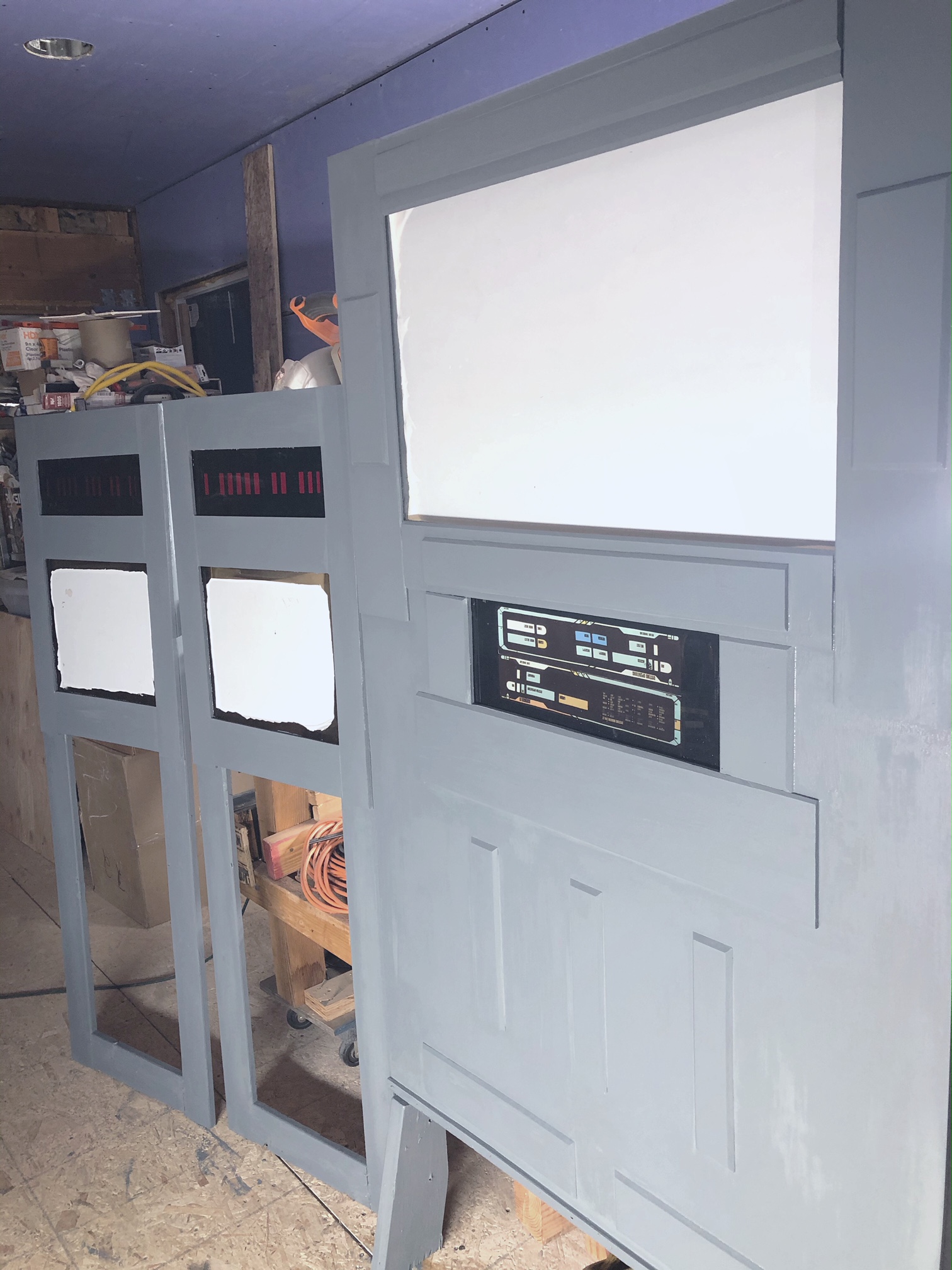

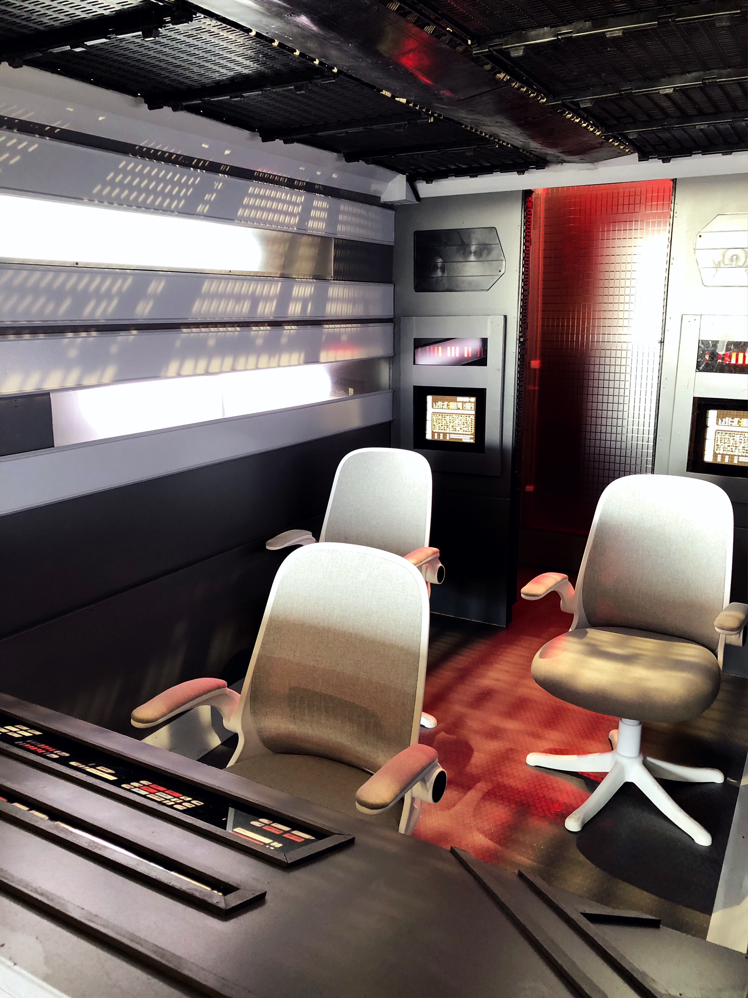

There is also a cheap, thin, easy to cut, smooth surfaced material called "Hardboard Tempered Panel" sometimes referred to as lucite in the film industry. Many times it's used for background makeshift wall panels where flats are either not needed as a whole or a base for plant on panels such as those above where a routed out surface is placed over the top adhered with glue then scuffed and painted. The main difference is they offer little if any load bearing surface. Old skool break away walls and tables used non tempered hardboard if that's any idea of its characteristics. But it's great for what it is. I've made countless Sci fi control panels and walls with it quick and cheap.
