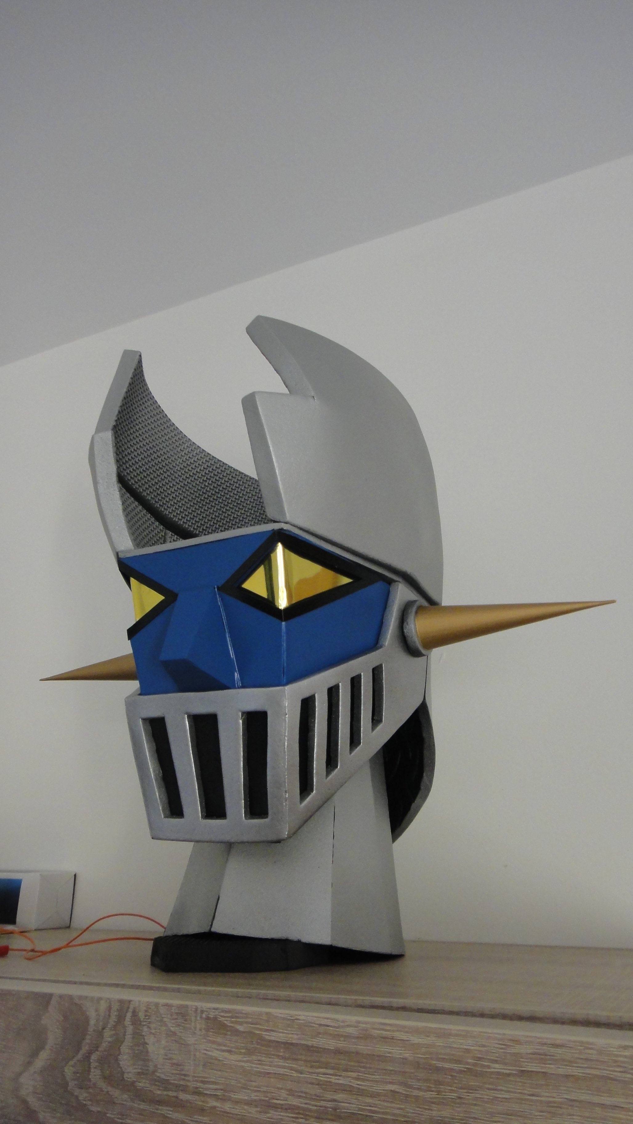

Well, here is the head. I opened a hatch on the top platform in order to be able to separate the neck from the head, for storage and it will be necessary later to suit on. LA MEJOR.jpg DSC01480.JPG DSC01491.JPG

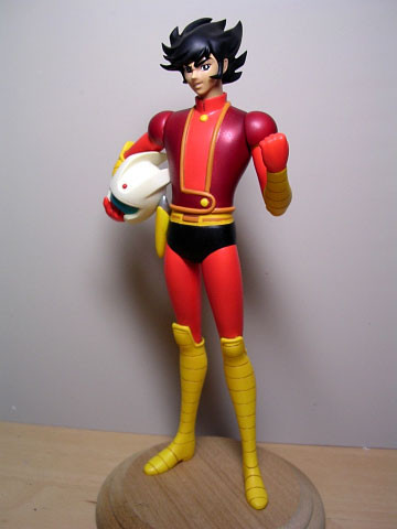

KOJI KABUTO
I decided to use one Playmobil cause the scale would be right, so I stole an all white statue Playmobil from my son and a motorbike helmet from another.
(before you call Social Services, please note I gave him this one in exchange) :lol
the helmet build:
and here is Koji, my Ratatouille :love
No legs needed cause he goes inside the Hover Pileder ;)

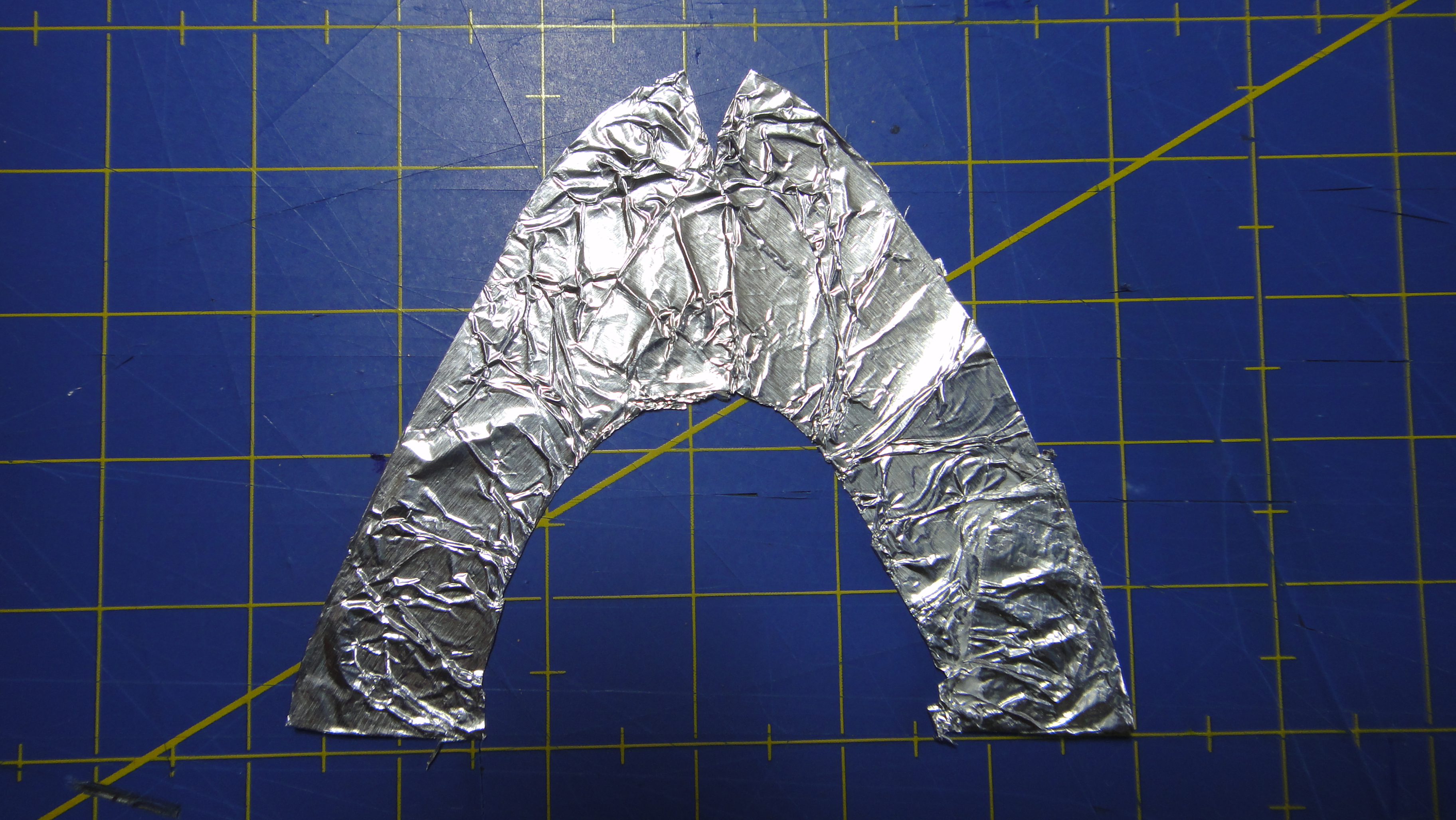

For the feet, I took a template from the feet of the figure and increased the scale:
Now some pics of the feet making and how I attached them to the stilts:
Feet do not touch the ground to avoid trips and they are not attached rigidly, they can swing a little for the same reason.
