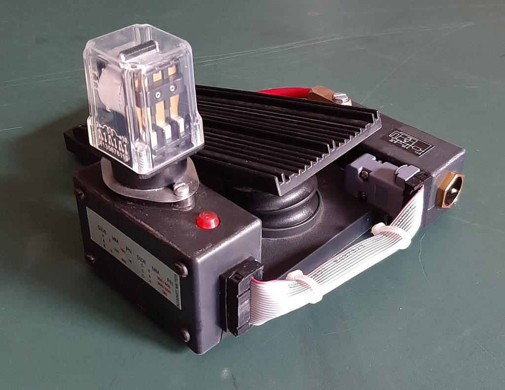

I attached the VGA plug I got from Aliexpress to a ribbon cable, added two zip ties and already, the project looked promising!
Next was to remove the large relay piece. Looking through my greeblie box, I found a close-enough piece to work as the lower socket:
Found some long vintage screws in my box-of-things, made up some spacers and started assembling:
I put the new relay in place, added some vintage screws to the side of the box and replaced the sticker with a metallic one:

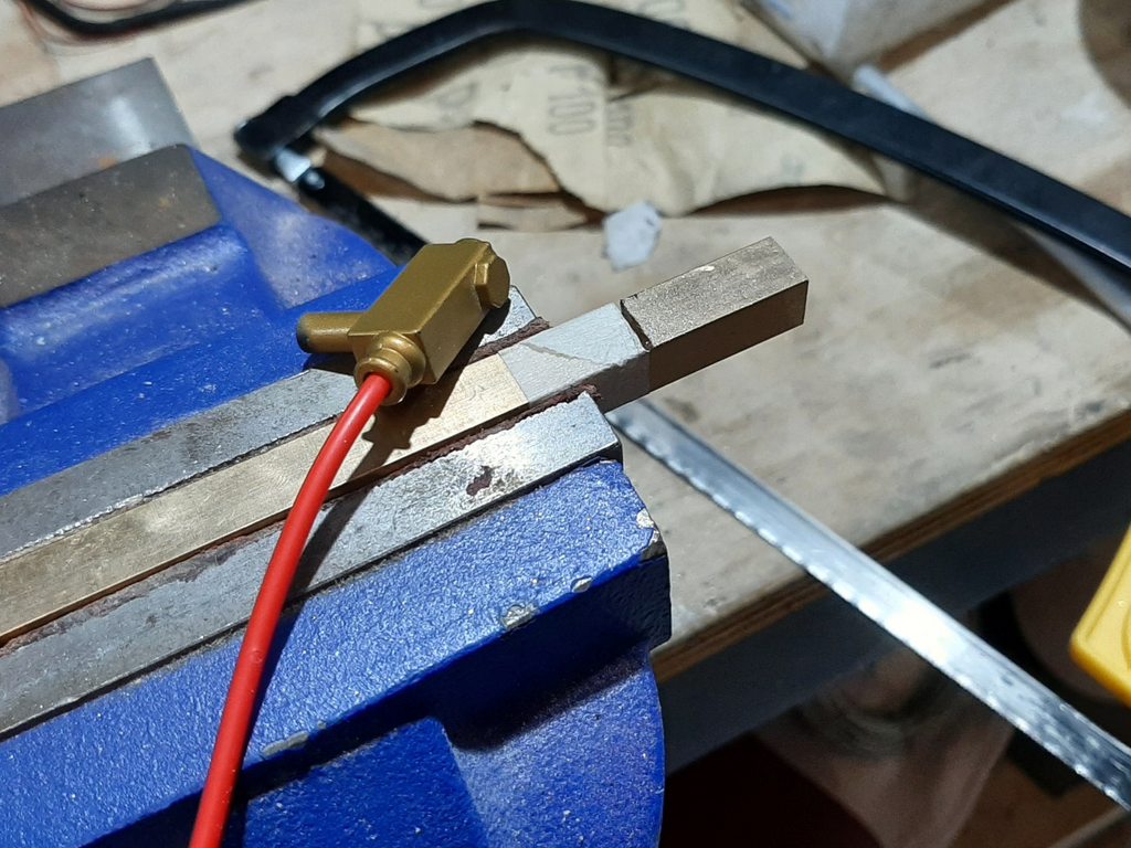

Next was to replace the gold-colored plastic pieces with actual brass. The various banjo pieces tend to be hard to find or expensive to source, I got a cheap piece of brass rod and started cutting with a hacksaw:
A little bit of file work on the corners, a vintage screw and old rubber tubing... getting closer to a realistic piece:
The other piece was a bit trickier since it has a hexagonal cross section, but some patient work with a file and some more vintage tubing created this:

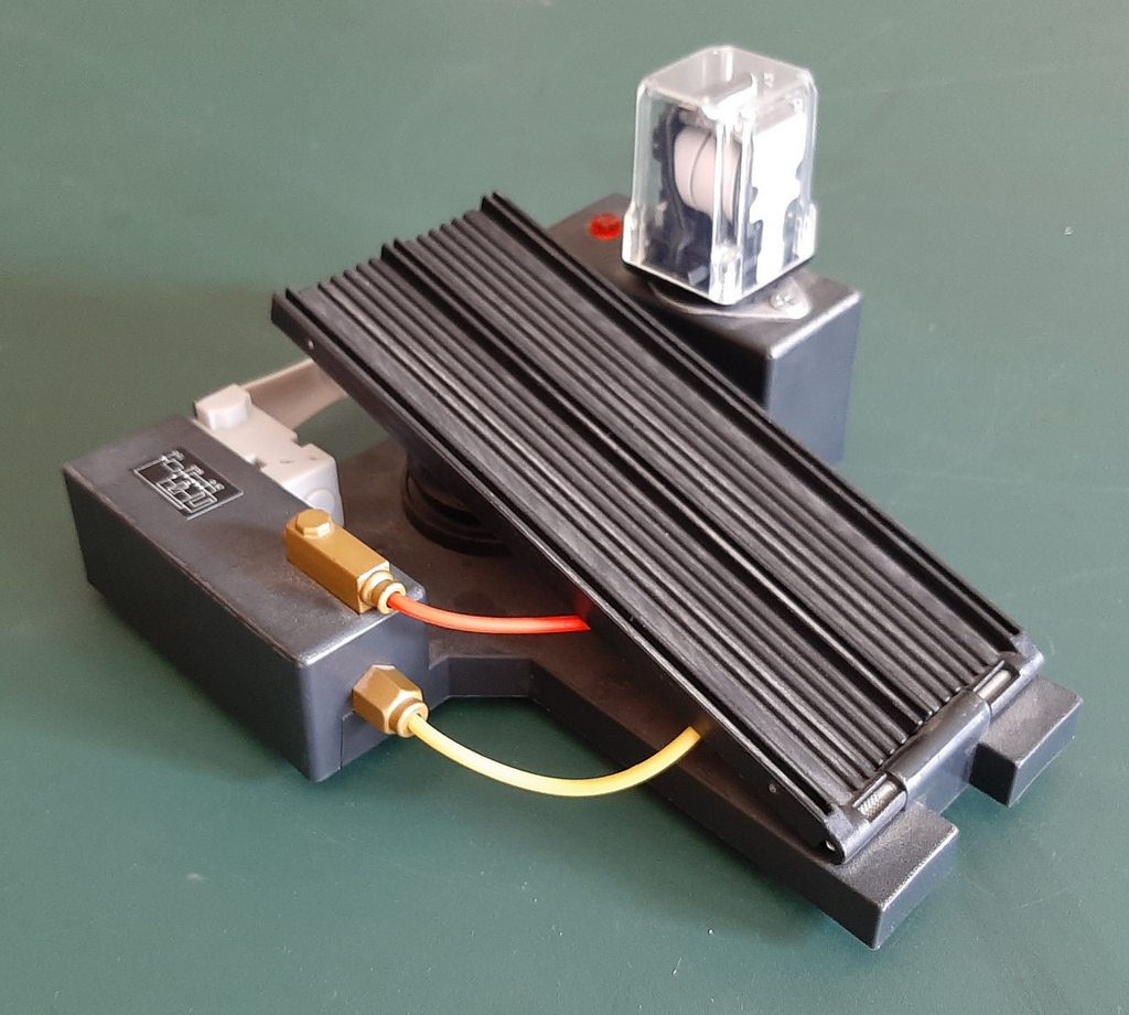

The finished product!
It's not a perfect replica by any means, but it still works and definitely looks more like a real-world item and not a toy.
