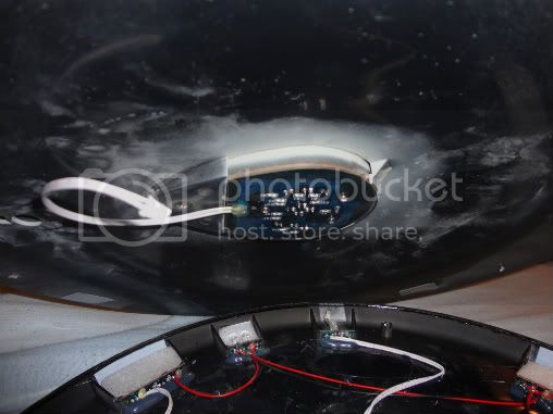

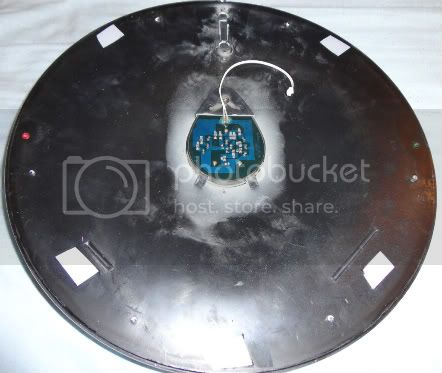

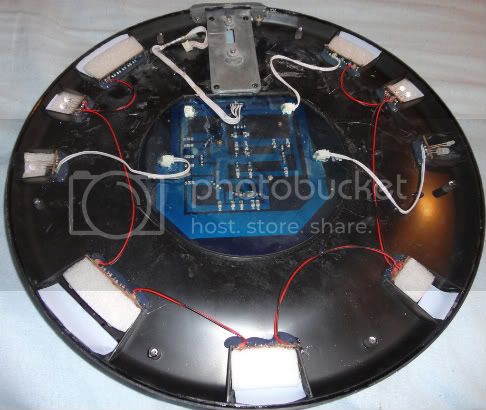

Here are some pictures of the Master Replicas Enterprise taken apart.
Funky
Spacerone, is there any additional info on how it was taken apart? Those pics are fantastic!!!
spacerone
You will have to start by separating the seam on the saucer section. This was easy for me because when I opened the box for the first time it already had a split in the front of the saucer. So I took a razor knife and went around the entire saucer. But then you will need to break apart the six plastic stud mounts that are glued together that keep the bottom and top saucer sections from separating (see photo). Once you open it up you will have access to screws and electronics that will further take apart the ship.
