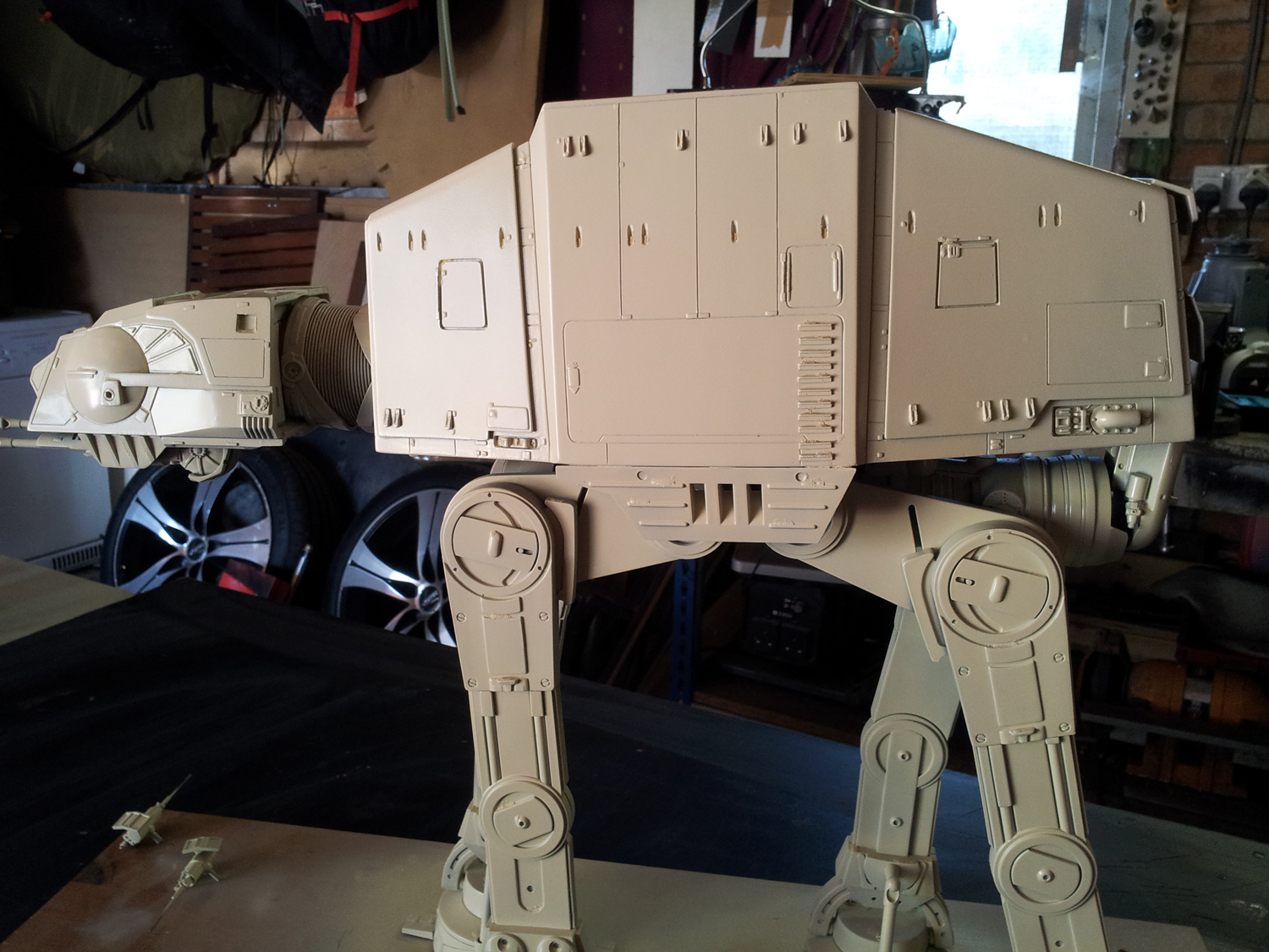

You can see that the surface has almost no weathering detail and the ones that are on there are pretty darn awful. So first thing to do is remove it from its base and clean all surfaces with degreasing agent. After many hours cross referencing the images of the real filming miniature I chose a warm white as a base coat.
On this version the model has may snow effect "blobs" which are super difficult to remove, so these were left on as the client is wanting plenty of snow on this one. I will be covering the original MR Blobs on the finished piece, so no worries there. Unfortunately my phone camera has a warm hot spot in centre frame which gives a pinky cast to the centre of the image, so please ignore the slight colour indiscretions of the images.

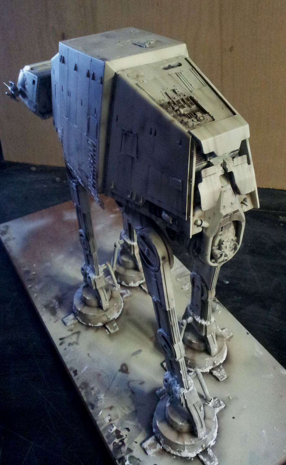

So this is the end of day 1 painting and mounting to painting base.

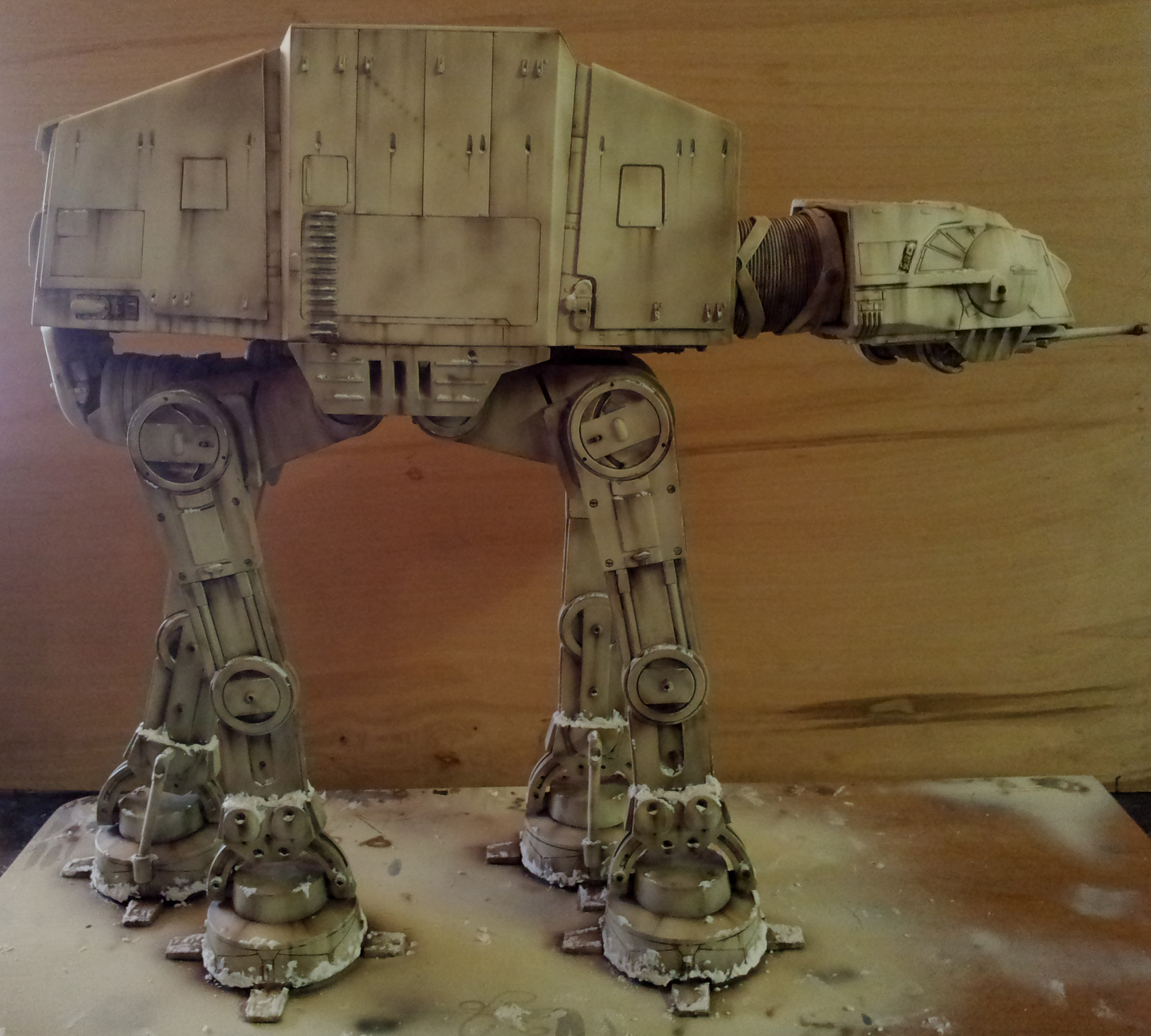

Day 2 is the most interesting day with light surface sketching done in a light black/brown mix. This is to add some subtle surface textures and to have a sketch to follow on the surface later on in the re-paint.
As this is going to have plenty of snow on the feet, I am going to darken the areas around the snow for more contrast on the finished job. Everything is just applied by eye following the reference for shading and surface squiggles etc.

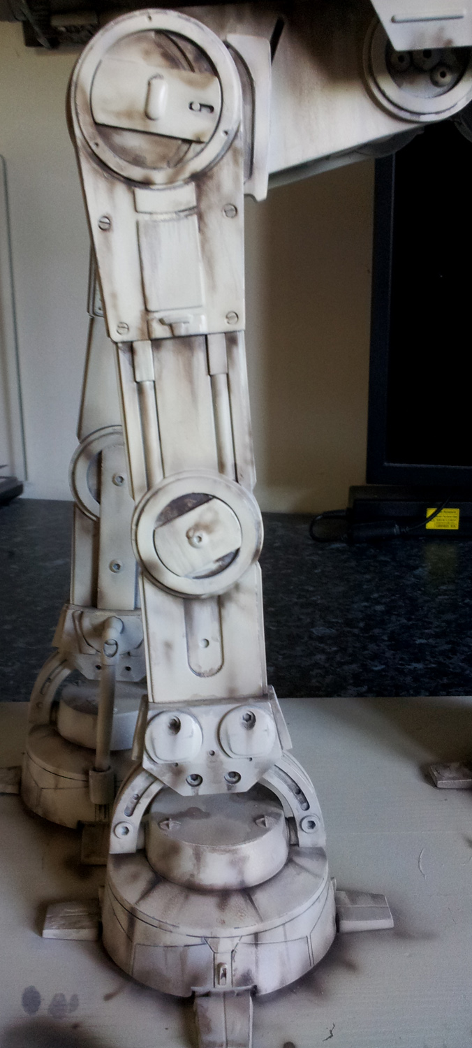

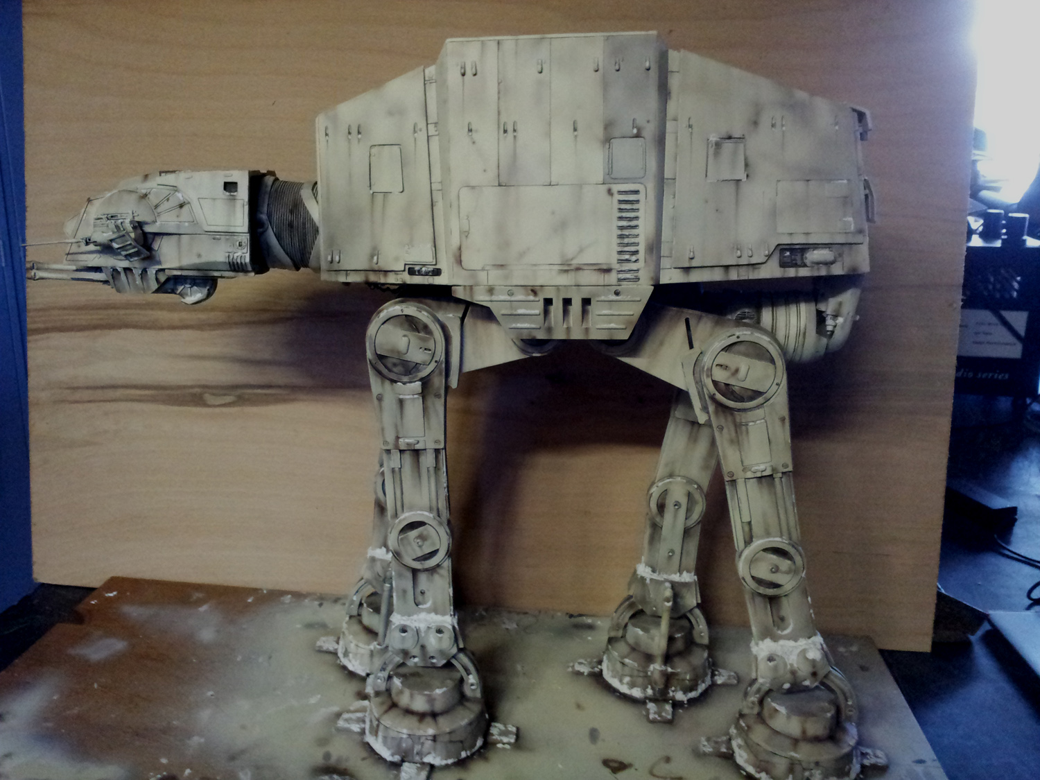

Day three brings another day of surface sketching
Carefully following the reference I add more dark shading to the surfaces and start to mask the smaller areas of weathering where needed to make the panels pop along their edges and add some perceived detail.
still a long way to go to get it looking right.

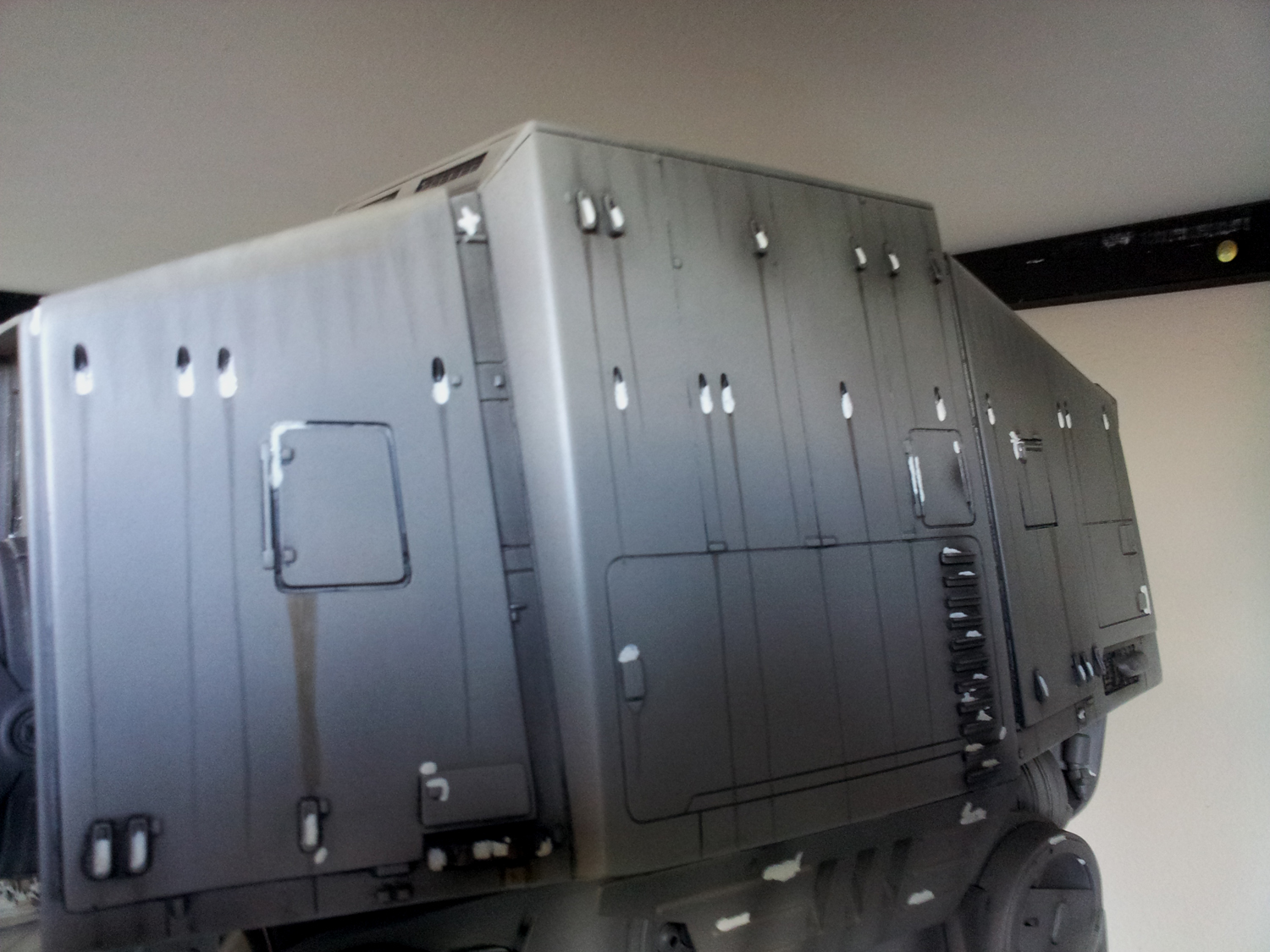

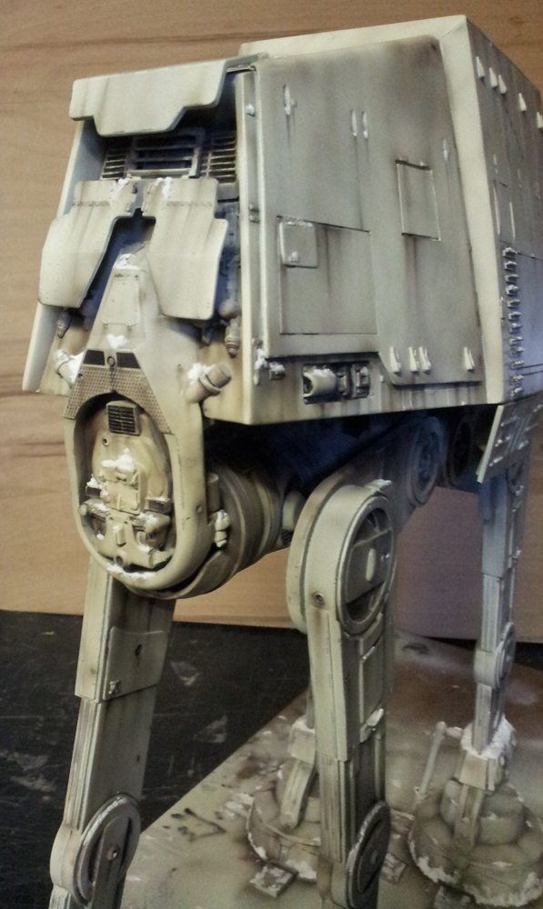

Day four and it starts to become more like an IM paint job.
You can see at this stage there are more colours added and some pin washed added to only a few of the panel lines. I only add this wash to areas where darker weathering is seen, this keeps the "dirt on the surface matched to an area of dark panel lines and adds to its realism and reason to be there.

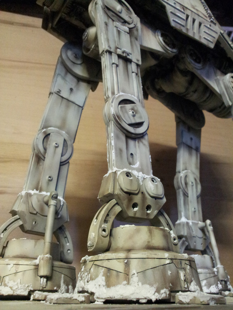

Day five now.
It starts to come together much more as the layering goes on.

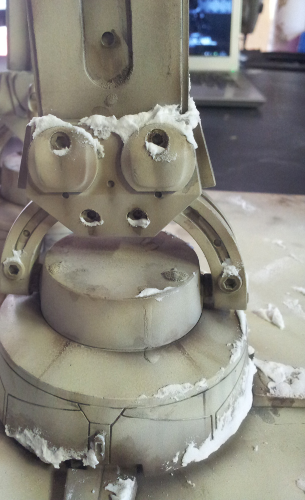

At this stage I am thinking mainly of the snow to model contrast. So al areas where snow is to be applied need to be slightly darker than the main model. As the feet will have the most snow, they are darkened a little in comparison to the rest of the model. Its hard to see but I makes a huge difference when done. You can see my first application of snow on the rear left foot. I tried many types of snow including some resin with talcum powder, (no good, grains are to fine) some citadel snow (no good, too sparkly ) and settled on Tamia snow effect as it sticks well and can be formed into overhangs as well as a thin snow covering.

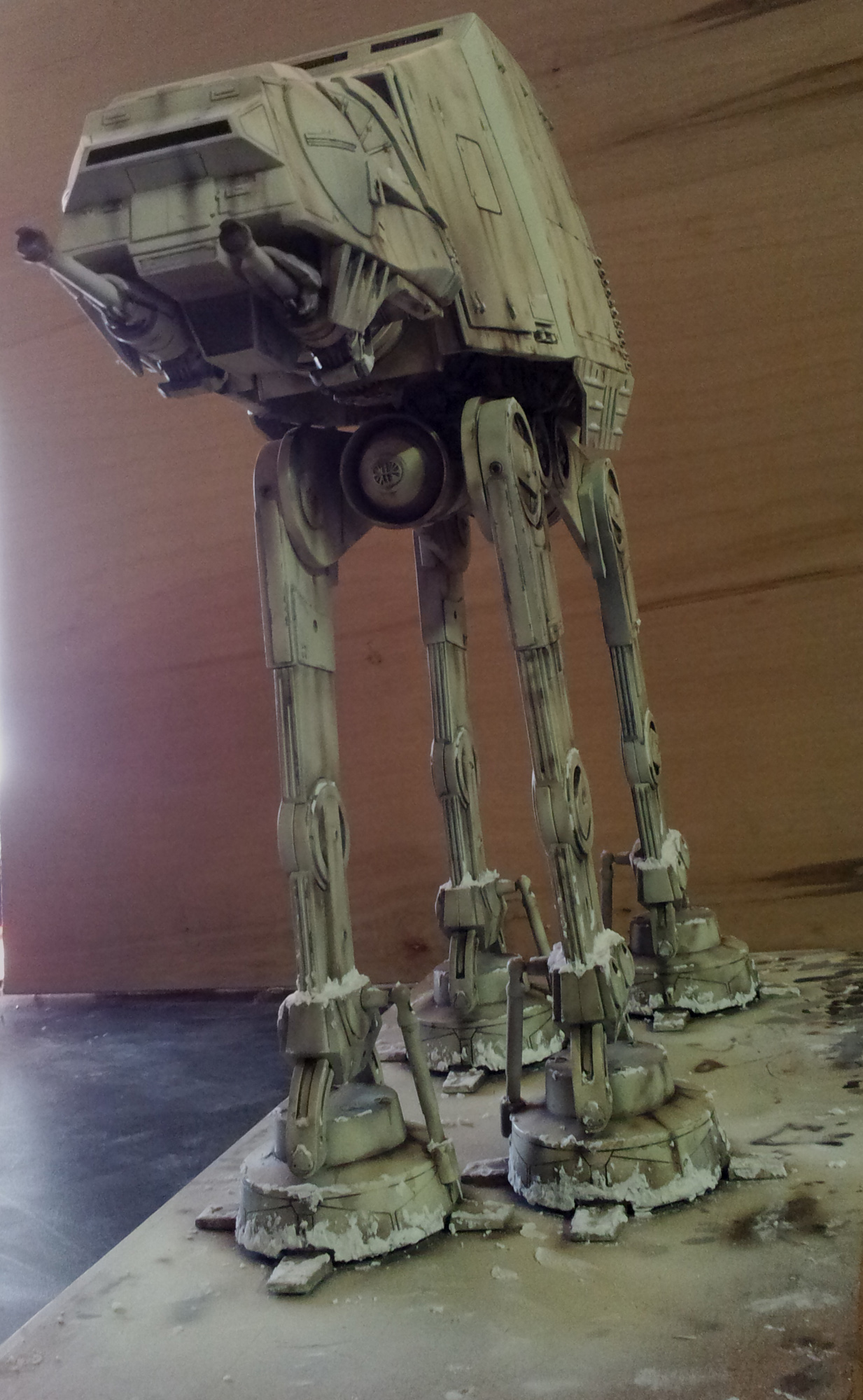

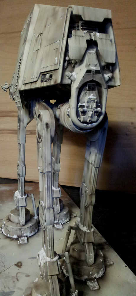

Another day, another snowstorm.
Now things are starting to look better. The contrast with the snow is about right. The warmth of the paint colours is looking perfect to me.

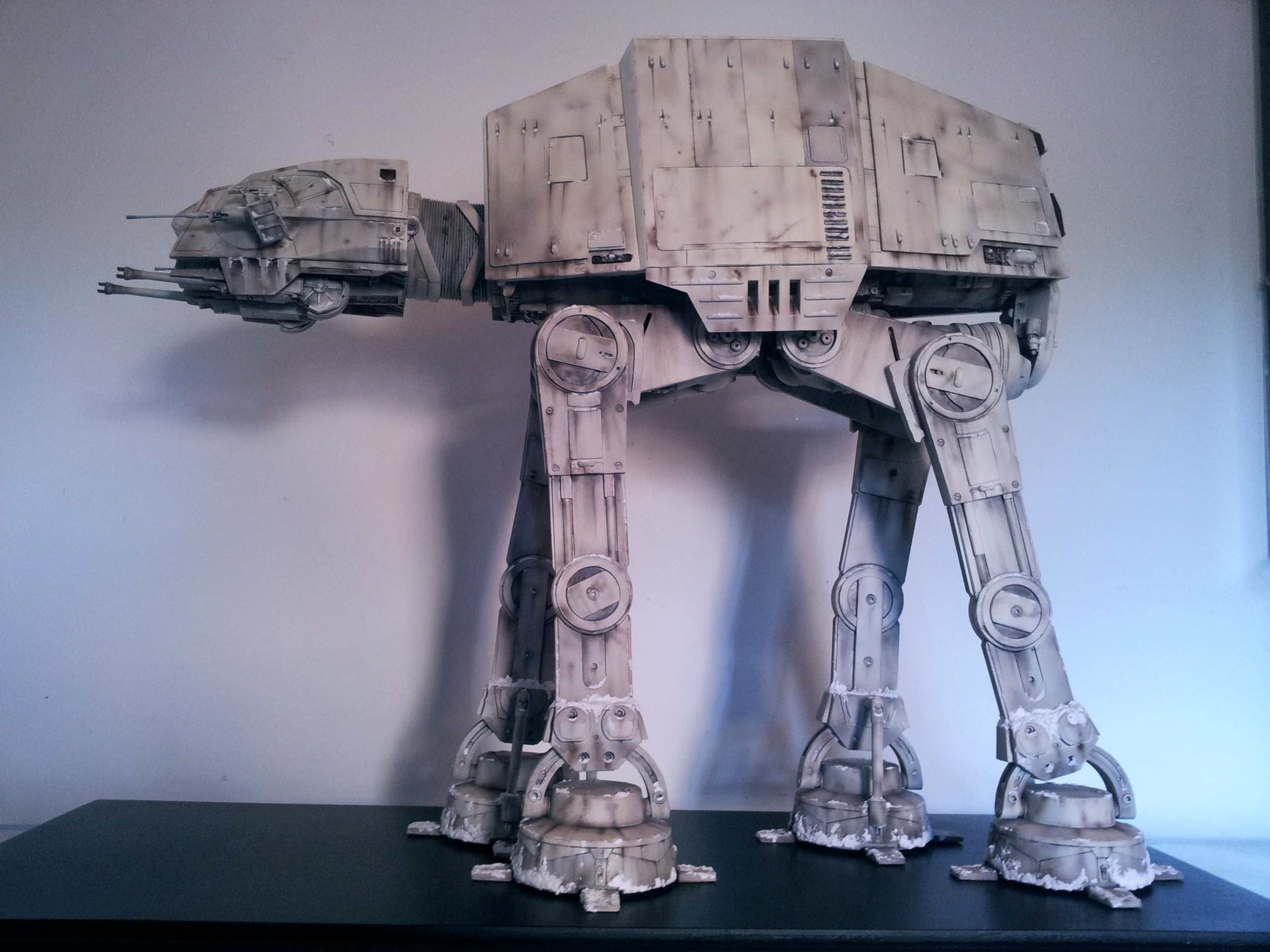

Attached to its new base, the model sharpens up dramatically without all the mess of the painting around its feet.

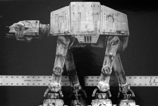

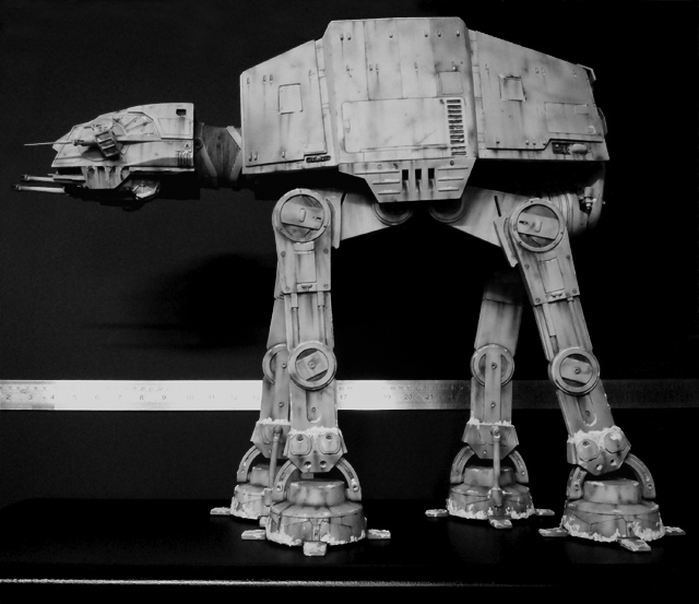

And just for everyone who thinks this is overdone !!
Here's a comparison with the original reference image and the finished version in black and white. The lighting is a little different, but I think its pretty close.
repaint first.
