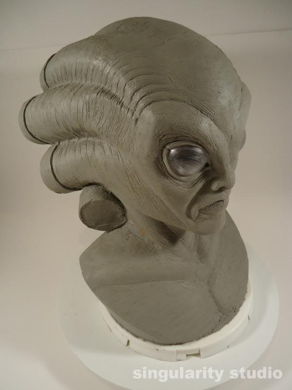

I stared this project sometime last summer for a guy in the Rebel Legion. Seems like it took forever to get done. The first one was a little heavy and "buggy" so I had to start over. By far the Most complicated latex mask I've made to date. Makes all of the other ones look like a breeze. This is a Revenge of the Sith version of Master Fisto.
Those are vacuformed pre-tinted 1/16" plexi eye bubbles set into the mask. Not the easiest thing to vacuform by any means. Lots of screw ups.
Instead of sculpting the tendrils, I went with the carving upholstery foam option. Thought it would save some money, but ended up taking forever to make them. Lots of carving, sanding, etching, coating, re-sanding, re-coating. After two sets of 14 tendrils, I'm done with that route. I ended up sculpting and molding a few, but I haven't made any. Polyurethane foam is a strange beast I have yet to mess with.

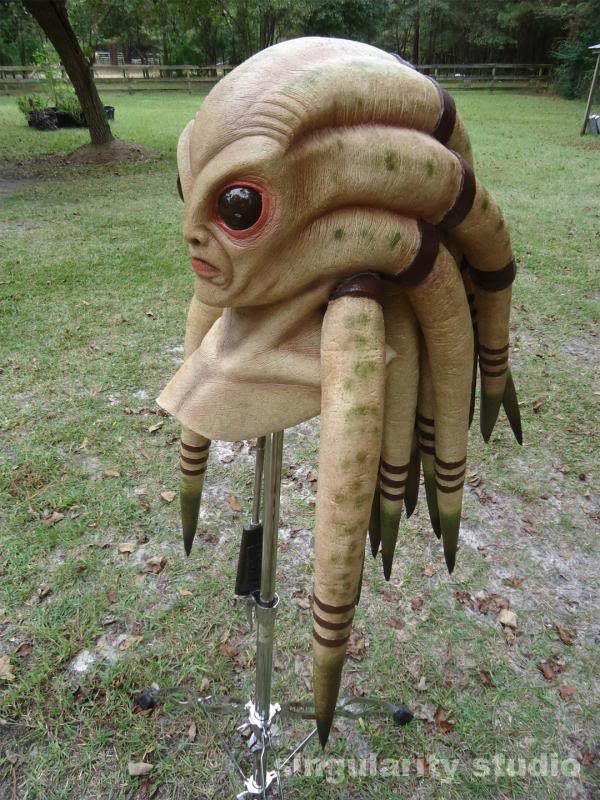

The tendrils all coated and painted with hand applied strap detail.
And...done.
Despite all of the latex, it's not too heavy when on the shoulders.

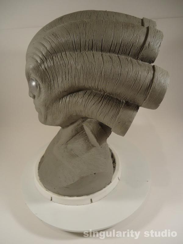

Woah! Wait a sec! Was this a two part or one part mold?! From the picture you posted it appears to be a one part. If so I am impressed! Also any tips to insure that the mold is handled correctly?
