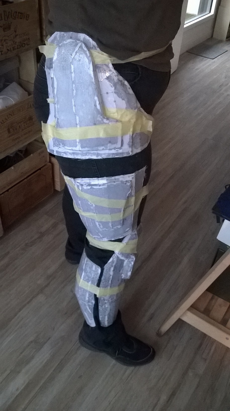

I re-pepakura the pieces who lose their shap (collar, back and thigh) and this time I will make more pieces, more smaller than big pieces who lose their shap !

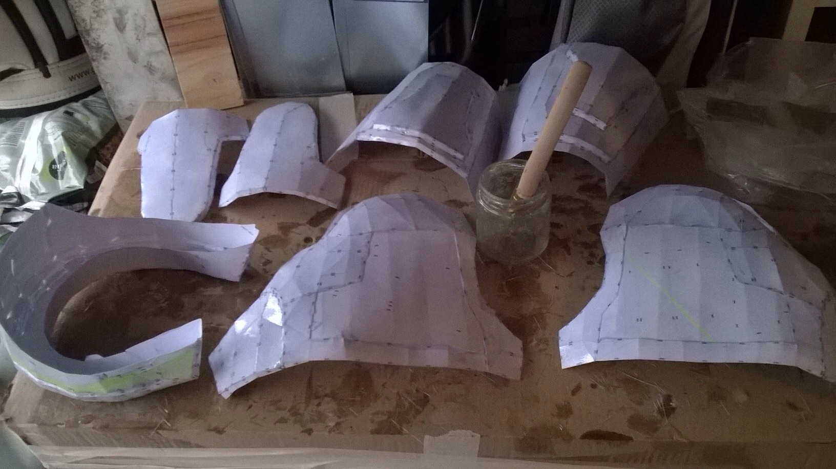

This weekend I finished the big pieces of the armor. I put the second layer of resin and fiberglass
Next week I'll make finishes before starting mastic.

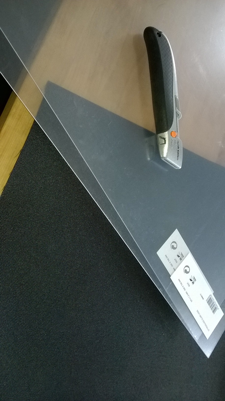

I started something important too : abdomen. As I said : I fight a lot ^^ and I need robust pieces so I will not use foam. This is a difficulty.
The only person who did N7 armor with abdomen in PVC, is Freya. So I read her post many times and tried to decrypt how she did.

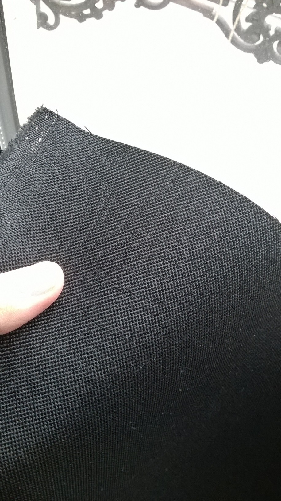

I went in supplies shop and I bought PVC plates and tissues

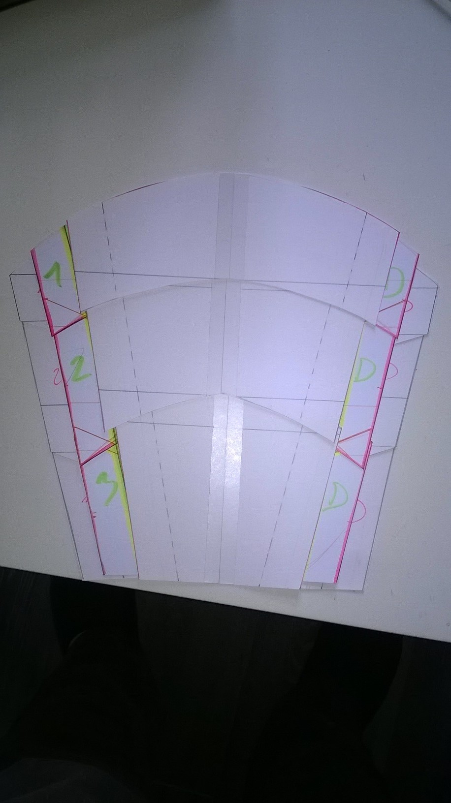

I did a cutting pattern
