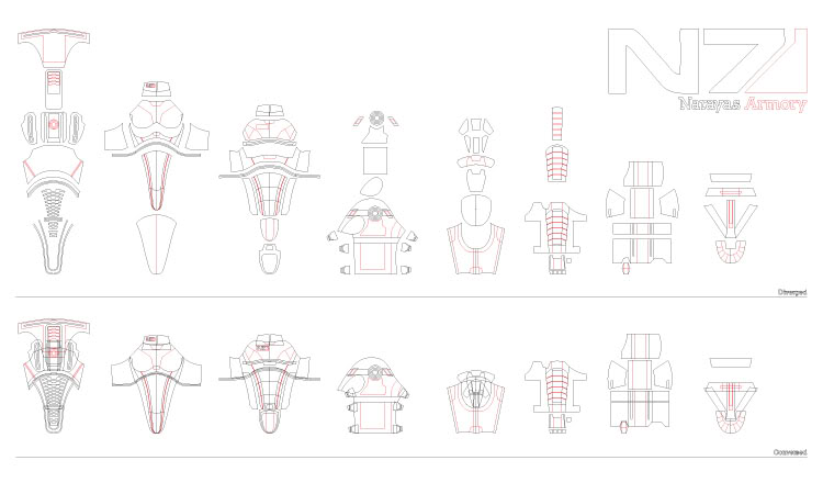

When I started the whole thing, I needed templates. I used this one:
I believe it's linked to Narayas, here on TheRPF, but I'm not sure, because I found it on google search.
So I got my templates, but there was a problem, these are ME2 templates. Unfortunately I couldn't find ME3 templates in good quality, so I modified some parts on this one. At the end, it worked out fine.

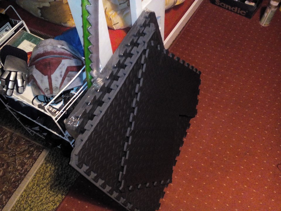

My main material was the good old EVA foam. (of course, duh) But, I didn't want to use the pattern on the inside to make it look like carbon fiber, cuz' I don't really like that.
I used up, like 10 sheets of EVA foam (60x60cm) for the armor. (helmet not included)

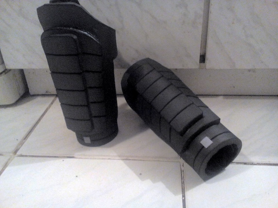

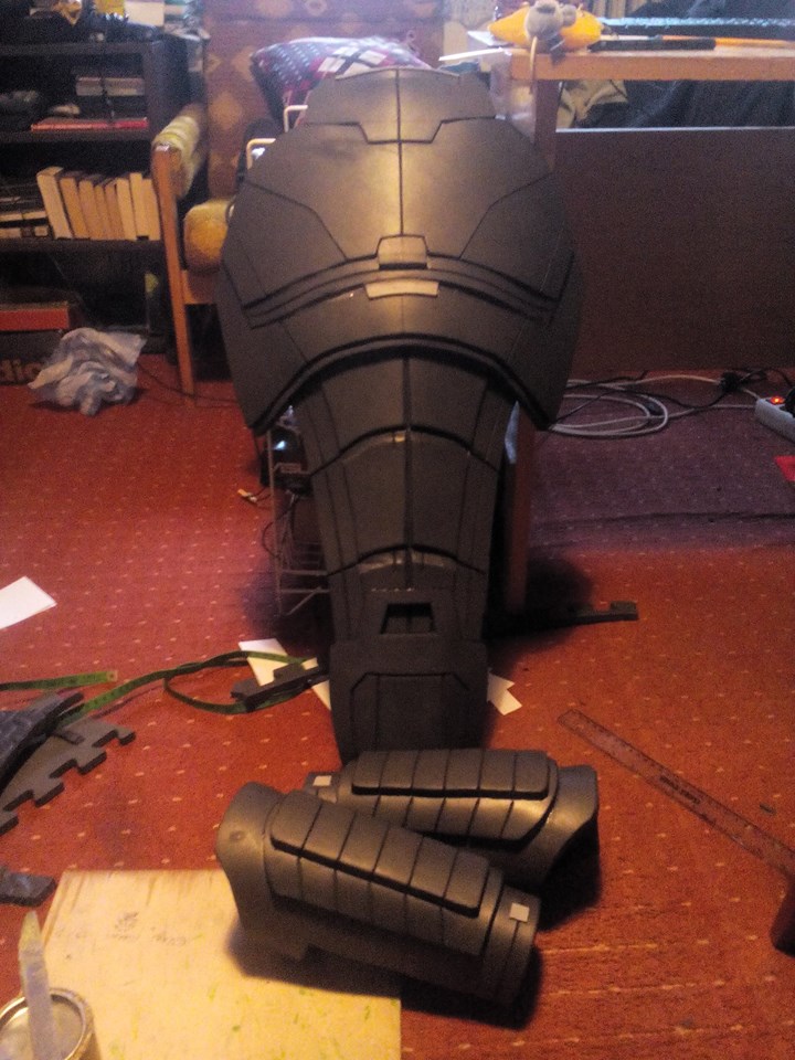

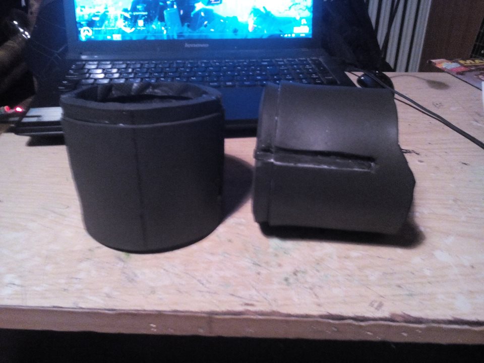

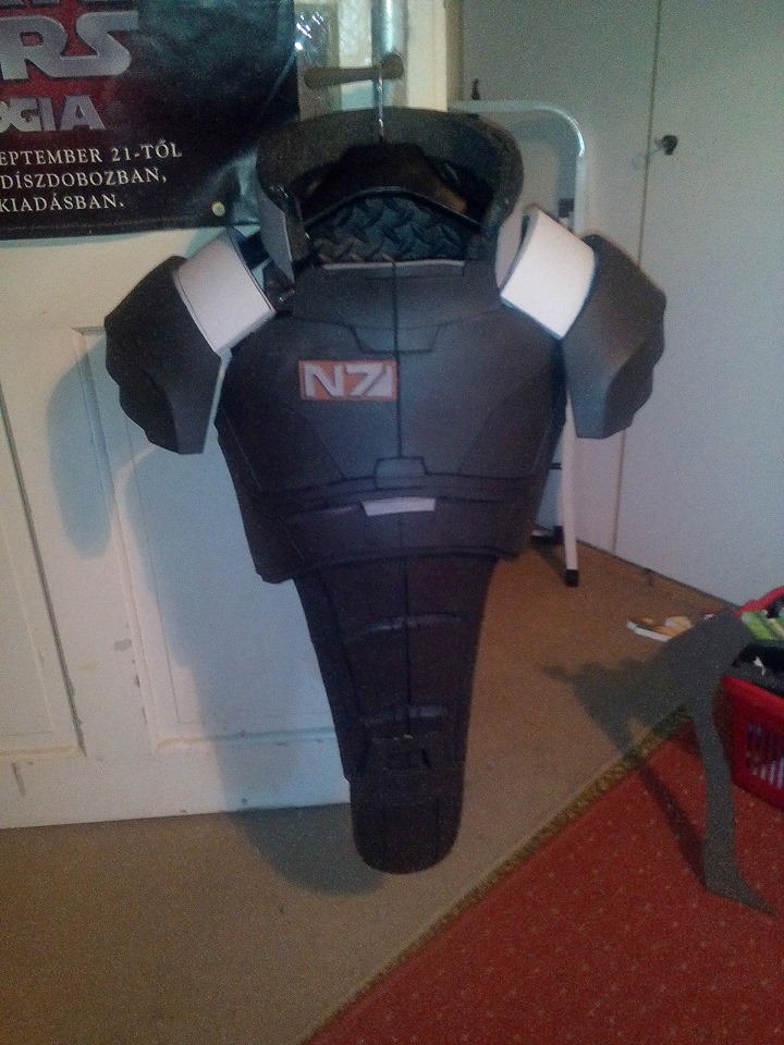

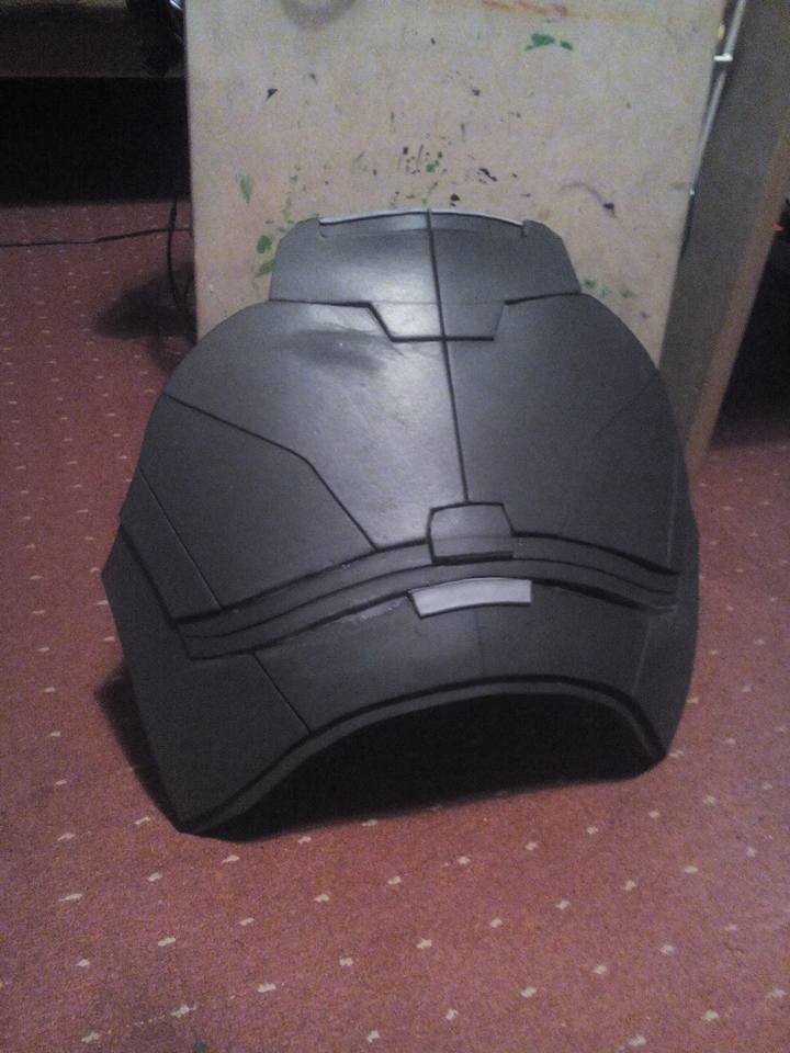

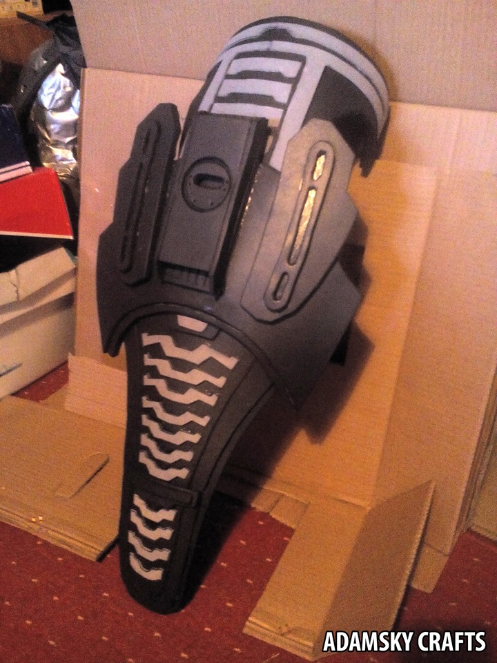

From now on, I followed the lines on the template, cut and glued. Here are some progress pictures. As I said I had to modify some parts like the abs, the little panel in front of the neck, the shouldpards and some little details.

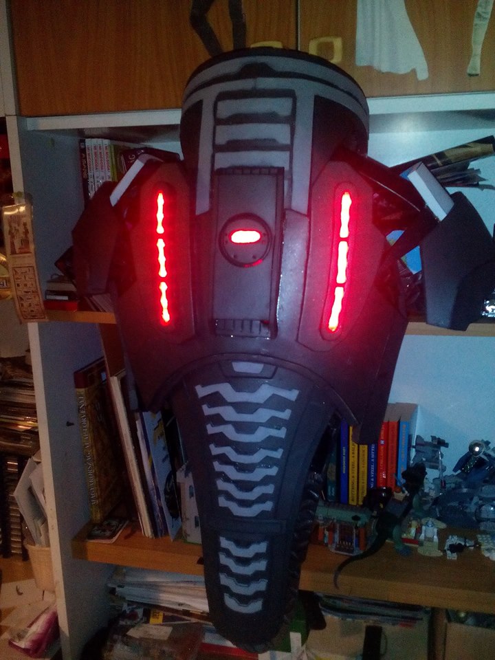

15966028_384281528589676_5718080709813224992_n.jpg 16142380_385201841830978_1035628112082245662_n.jpg 16472960_393707474313748_8143849702850708851_n.jpg 16427284_394699614214534_6144679637594908525_n.jpg 16996478_405784089772753_1122752059088629873_n.jpg 19275092_462335870784241_7138926804963492268_n.jpg 19275061_463257744025387_2406144876828185399_n.jpg 19399949_464701817214313_3611314132604543001_n.jpg 19732280_468514136833081_4459891279414405794_n.jpg 19598523_469104163440745_5172585667162425871_n.jpg
For the lights I used some LED strips and a 9V battery. Simpley stuff.
After the build, I sealed all the foams with my heatgun and 3-4 layers of wood glue. The wood glue gave it a nice sheen. After that I painted it with a metallic gray spraypaint (acrylic) and then for the weathering I used black and silver acrilyc paint applied with a small flat brush.
