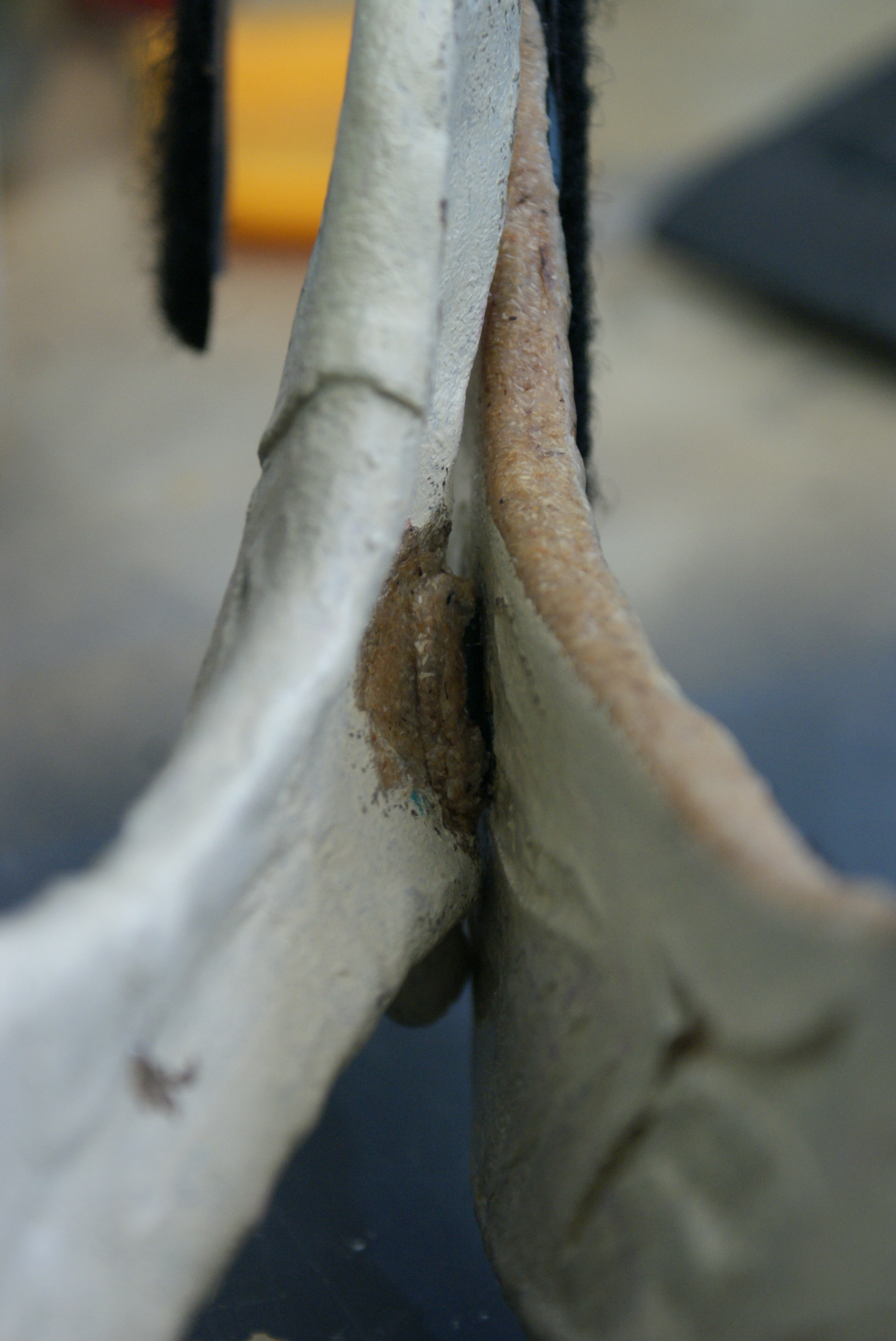

the mandible were done the same way using Eva foam as a base.
took an other hour and a half to finalize the jaw as well
I put some small hinges in the corner and blend them in the piece
so for now I got some problem with the cable system which is not strong enough to withstand repeated abuse. I tried 0,10" illusion cord to make it invisible but the friction on the worbla got the better of it. any input?

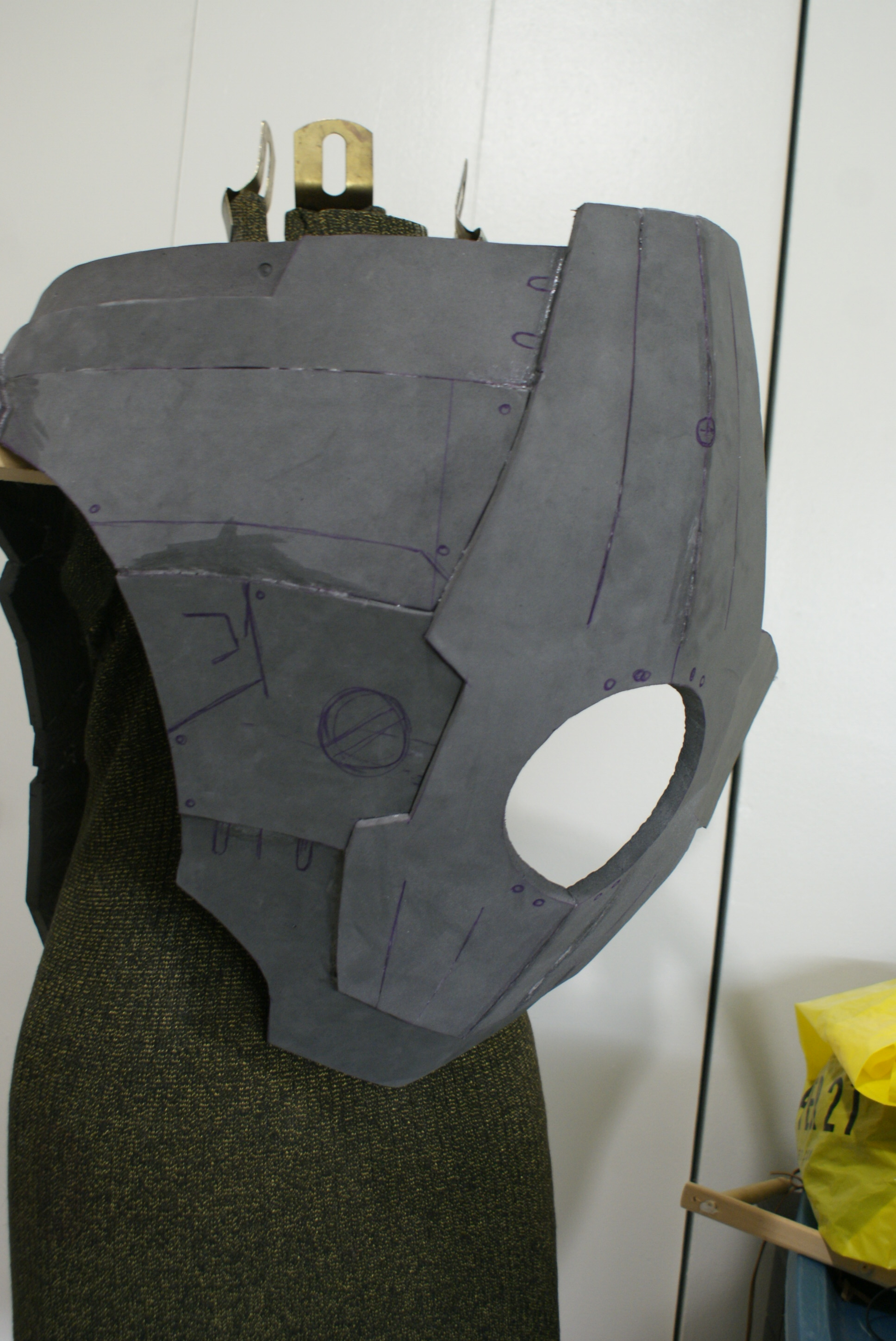

the armor smithing have began. the chest piece even tho it scale and proportion to my size. I still feel like I'm inside a big egg shell

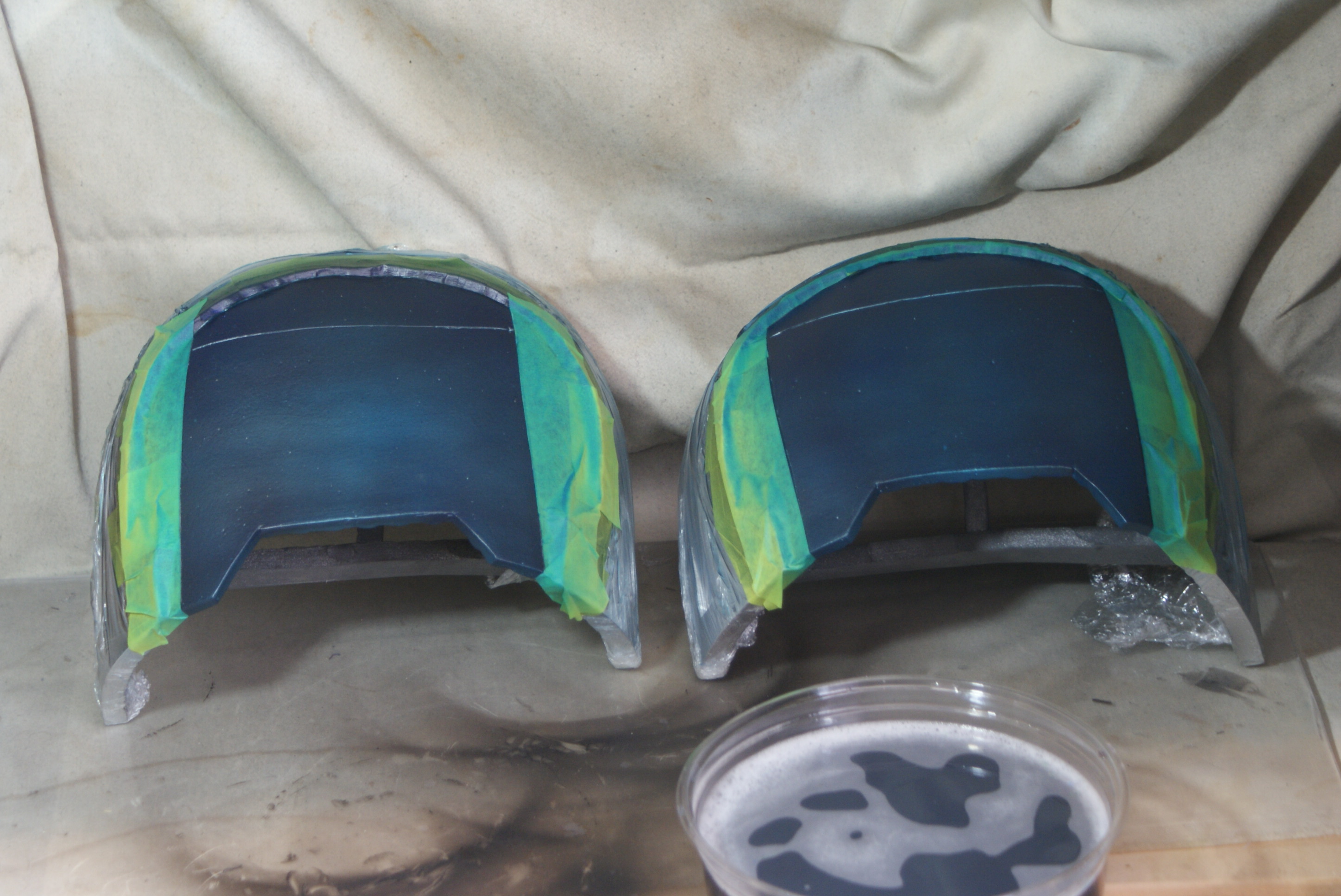

and an other update on Garrus progress keep in mind that nothing have yet to be weather.
arms are glued painted and clear coated
the body armor is finish and in the process of being sealed

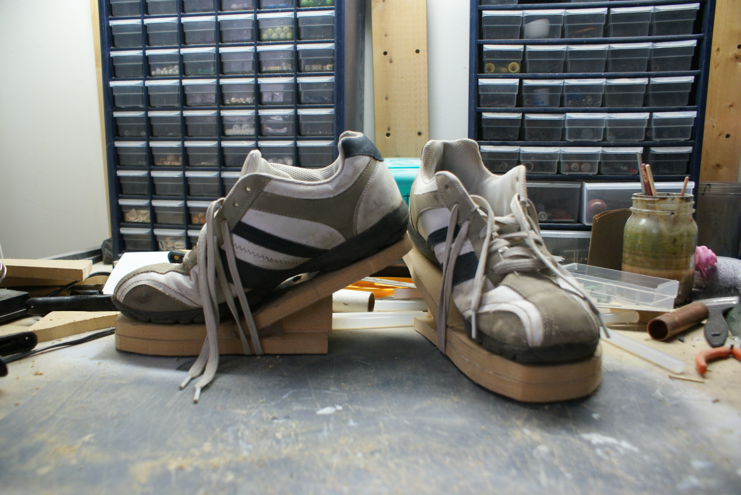

and the boots platform are done and ready to be cover up

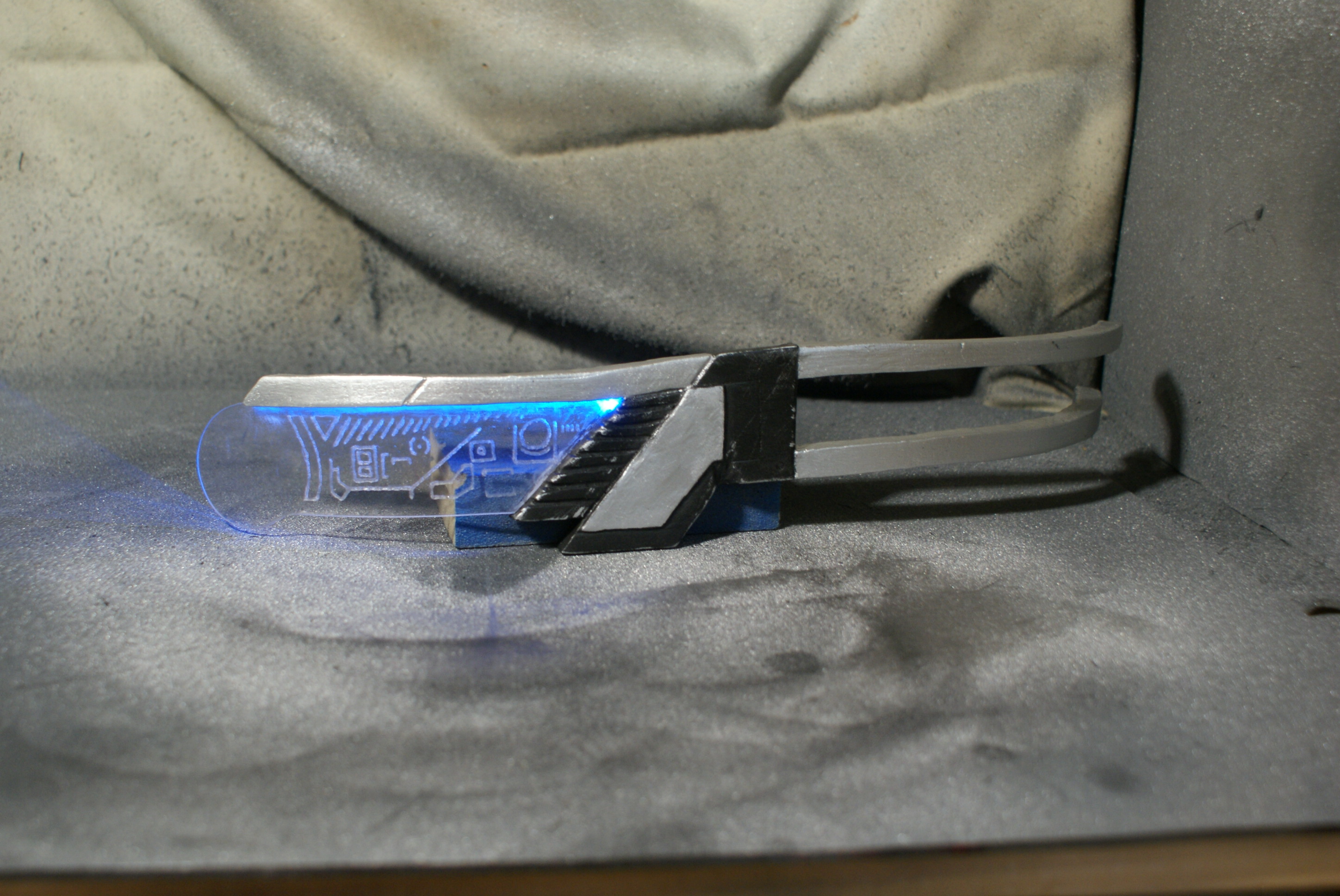

the visor is held by one neodymium magnet inside of the mask and two washer in the visor itself

Kamon
Well done! what type of or magnet did you use? I tried using n52's but mounting them proved to be impossible, how'd you manage it?
MNCProps
I used a rectangle neodymium magnet around 1 1/2 inch long that I embedded into the mask material (worbla) put I don't remember which type of neodymium. I added around 1/4 inch worbla over it so It won't rip off the washer from the visor. Which is completely made out of foam.
