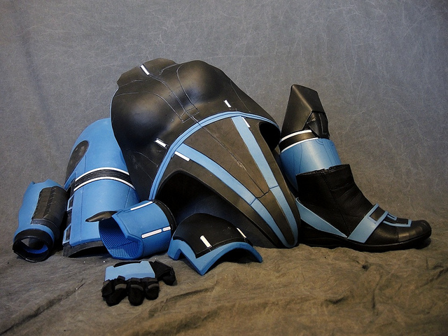

These are some of the reject parts
And these are the ones that are less fail I'll use. Think I might redo the forearm though

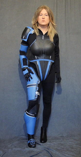

So far have done 7 sections (Right boot, shin, thigh, glove, forearm, upper arm, shoulder and the front of the chest), 6 of which are now PVA'd . Hopefully the left hand side will prove easier than the right as I've got the templates adjusted now .
(Yes that's me this time)
Some bits in the pic above are held on with masking tape, proper strapping etc will be done after painting, they are bit more complicated than Shepherds and my shin guard isn't straight. Plus that under suit is temporary, I've got a spandex catsuit on order to replace it and I need to find the right wig. And after its done I'm going to need to build a rifle to go with it aren't I.

I'm guessing the shin piece is a little angled in that picture?
2 questions/comments:
1) planning on dyeing your hair or wig?
2) it might just be the photo angle, but the breastplate seems to be sitting a little... low? I realize the breastplate is one piece at the moment, but I sort of wonder - cause in the game it looks like it should be two pieces (i.e. kinda like IM armor where the upper breastplate can sort of slide over the lower torso "V"). In practice that might not really be possible, but I would imagine two pieces might be better for mobility?
Either way, it looks fantastic so far! Strong work!
Laika
Re: Mass Effect Ashley Williams WIP
Yes the breast plate is a little too low, but thats mainly because its was only held on with a strip of masking tape around the back, it will sit higher when its all finished and strapped, saying that am am physically rather long in the body. I've done it as one piece, like a lot of ME builds, but I'm thinking it would give more mobility if it was two and joined with elastic or something, even with it being only a front piece and only taped to me, bending down or sitting is very difficult as it is now.
The shin piece got turned around, sorry, its got a gap down the inside leg so I can get it on and is currently a little loose, I'm going to to install a zip in it after I've painted it.
