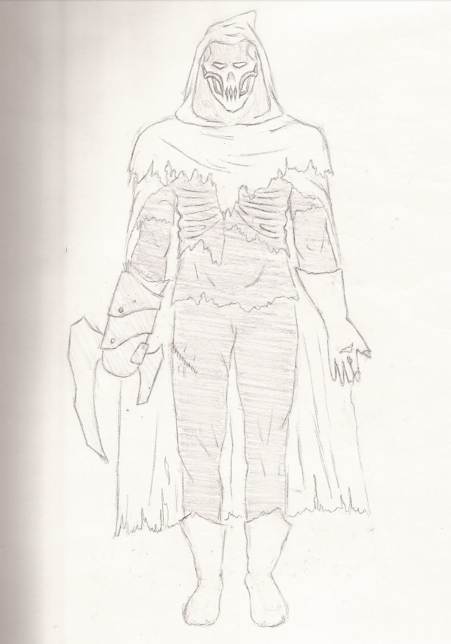

Alright in regards to my other projects I found this one to be more manageable, so I’m going with it. Yay Mask of the Phantasm! I’ve always wanted to make the Phantasm. It’s a bit of a re-design since we don’t get a lot of costume details in the movie.

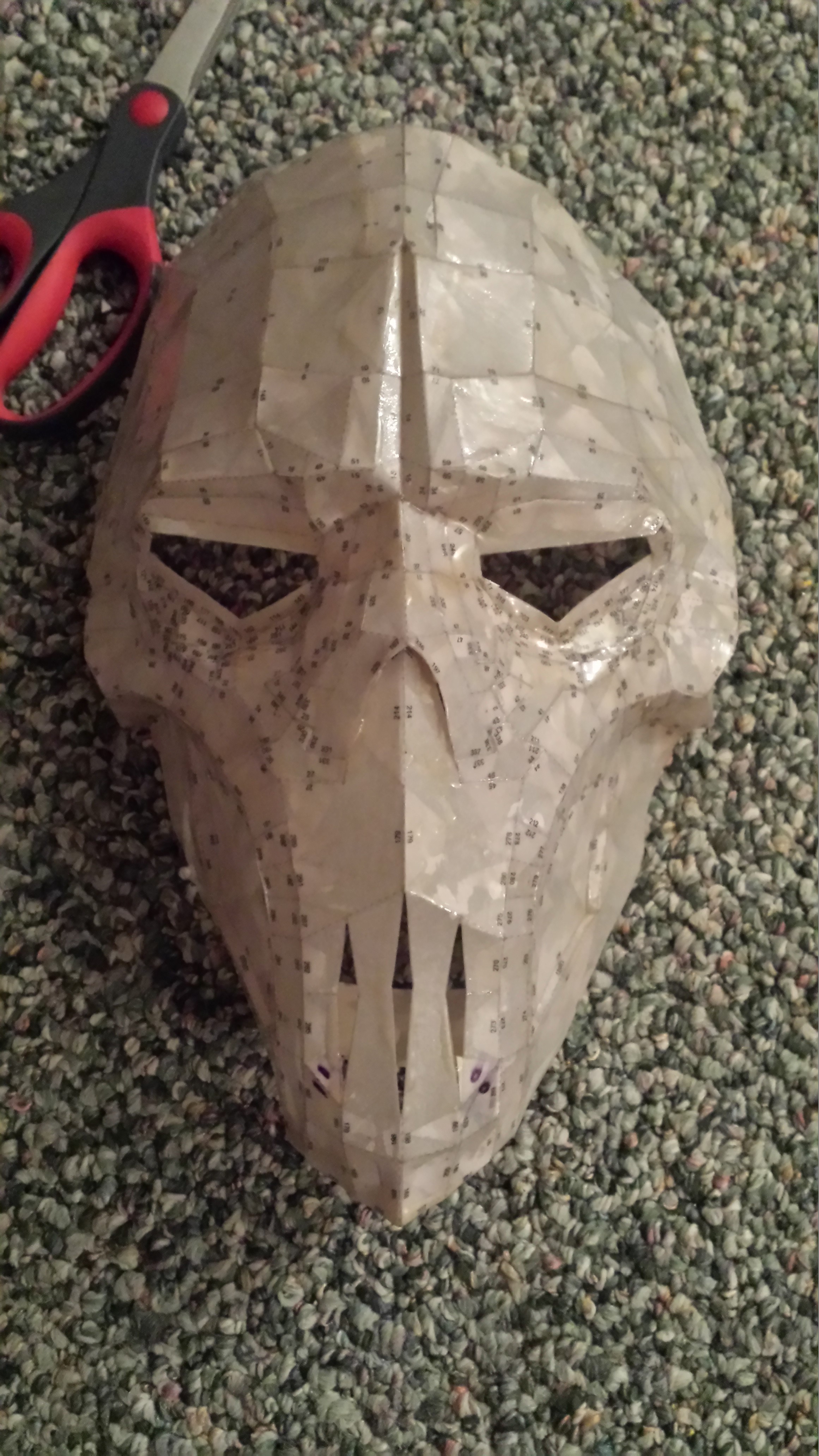

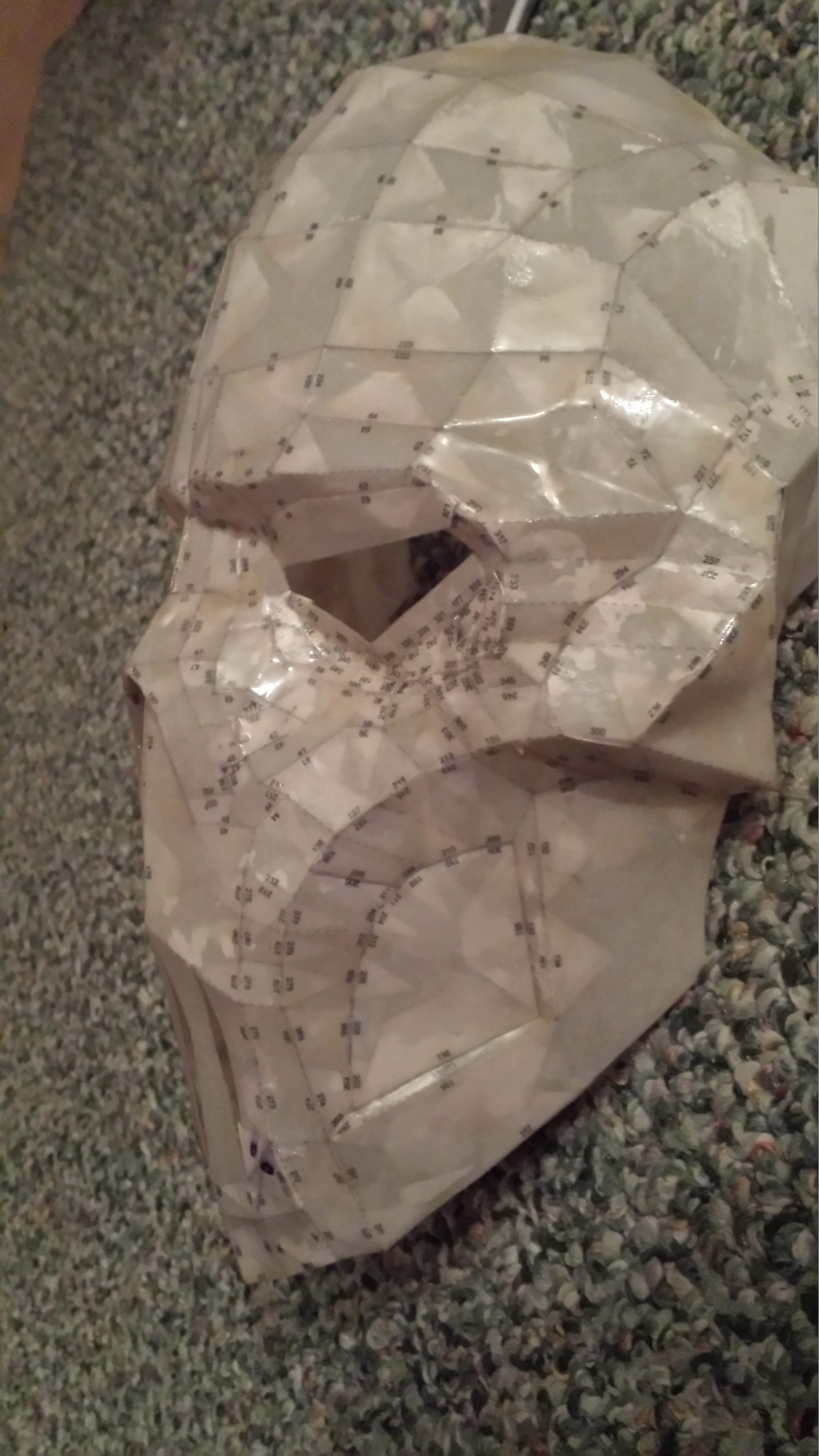

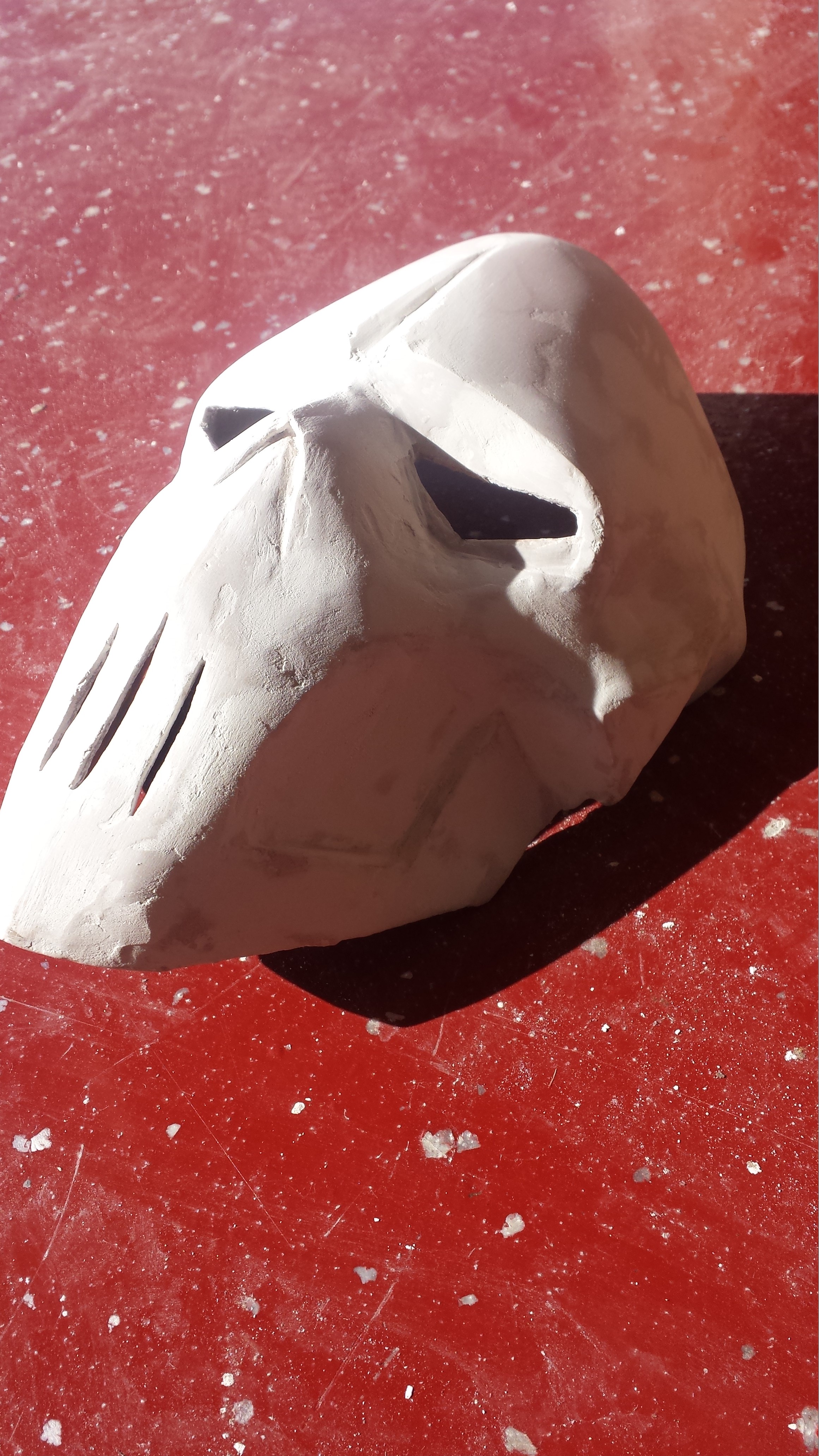

I want to try the pepakura and fiberglass route for the mask. I’ve never used this technique. So first thing I did was 3d model the mask myself. Translated that over to Pepakura. And after a day of folding paper and applying the fiberglass resin:

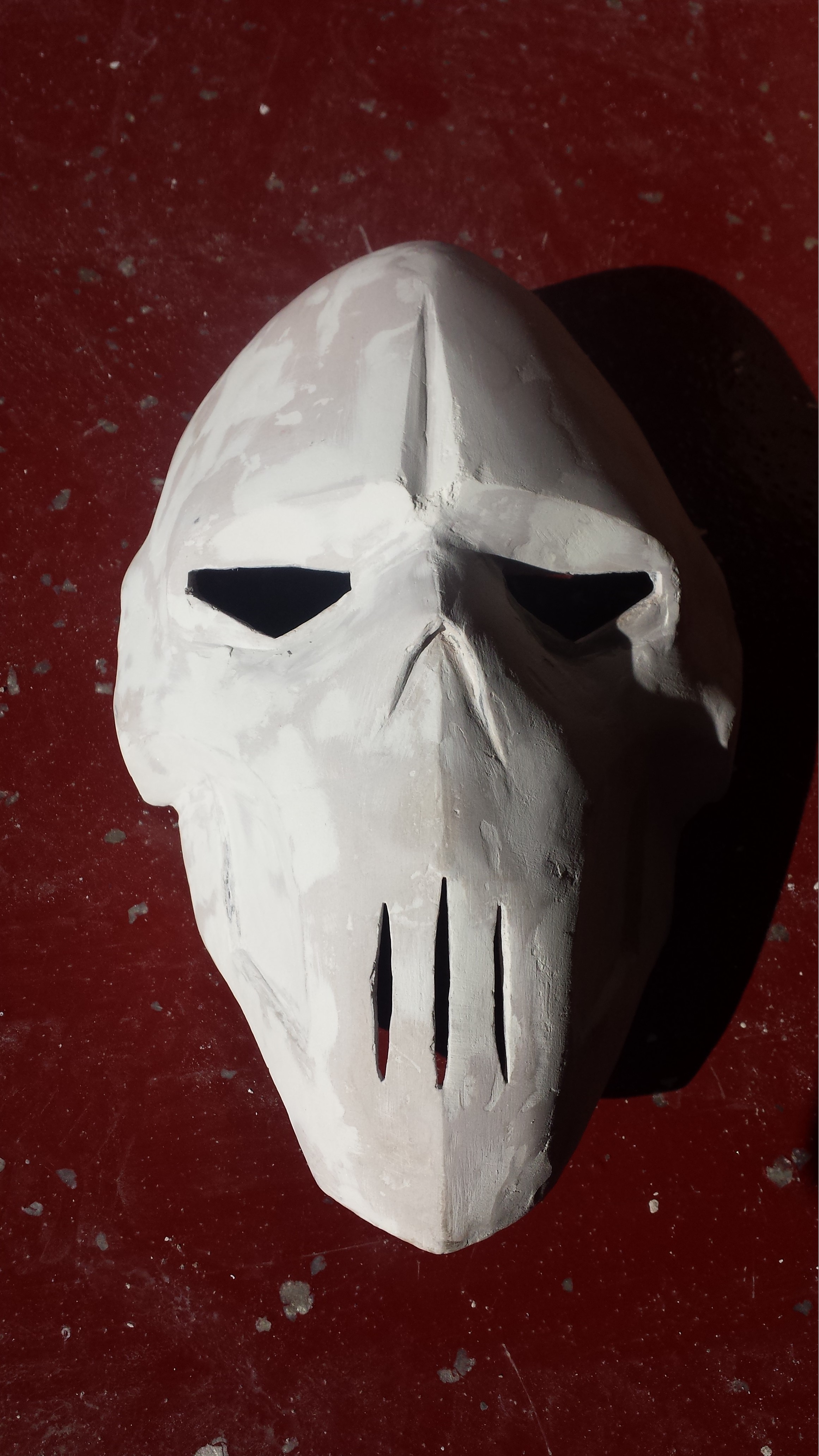

I then applied about 3 layers of bondo over the fiberglass. I filled the lower parts with joint compound. It seems to be working for the most part
It definitely still needs some refining, but I think it’s coming along nicely. It’s my first mask in this style. I don’t expect it to be perfect, but I’m going to keep going with it. I’ll make changes on my future iterations of the mask. I might be able to even start painting the mask this weekend!

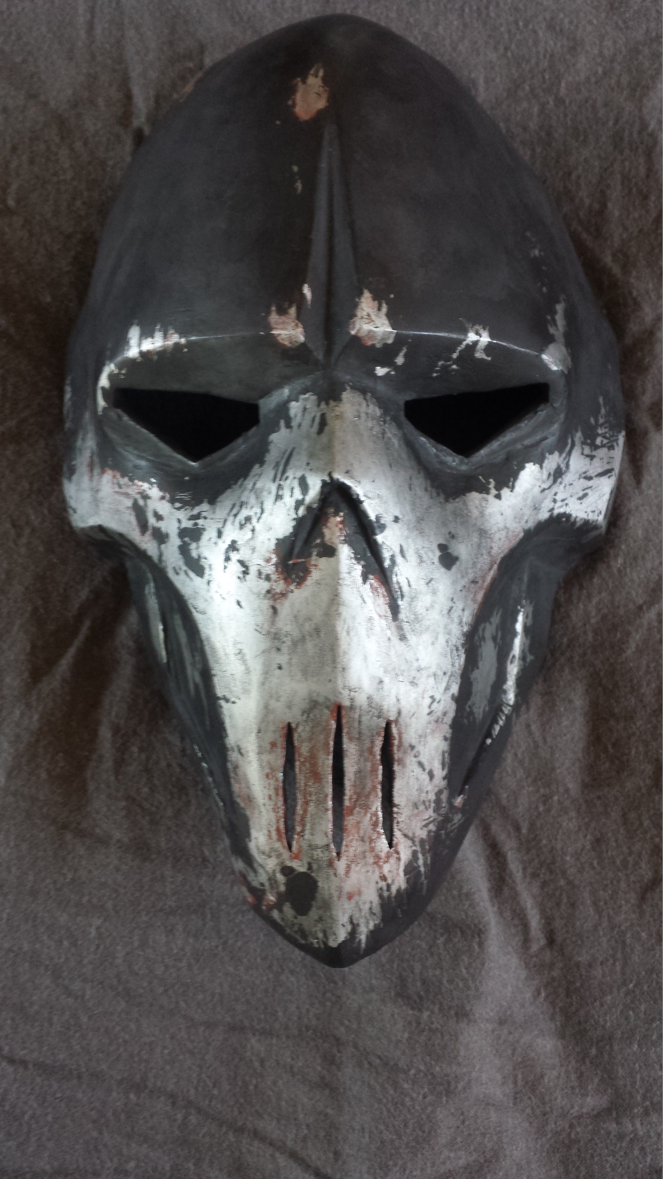

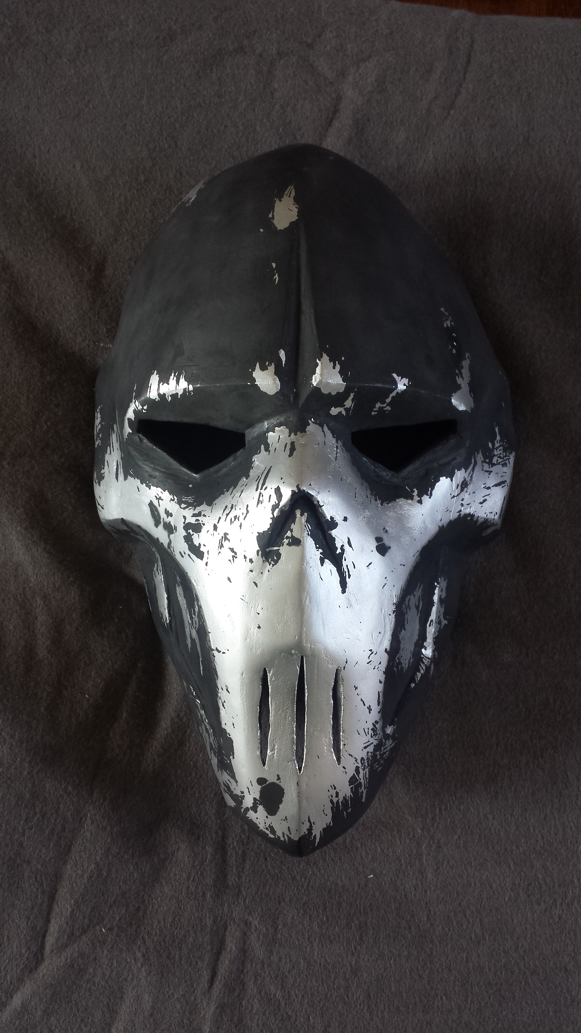

I finally did a bit more weathering to the mask the other day. All I did was brush some watered down black acrylics over the mask and wiped it off quickly. Then I added a bit of rust around the mouth, nose. and a few other spots.

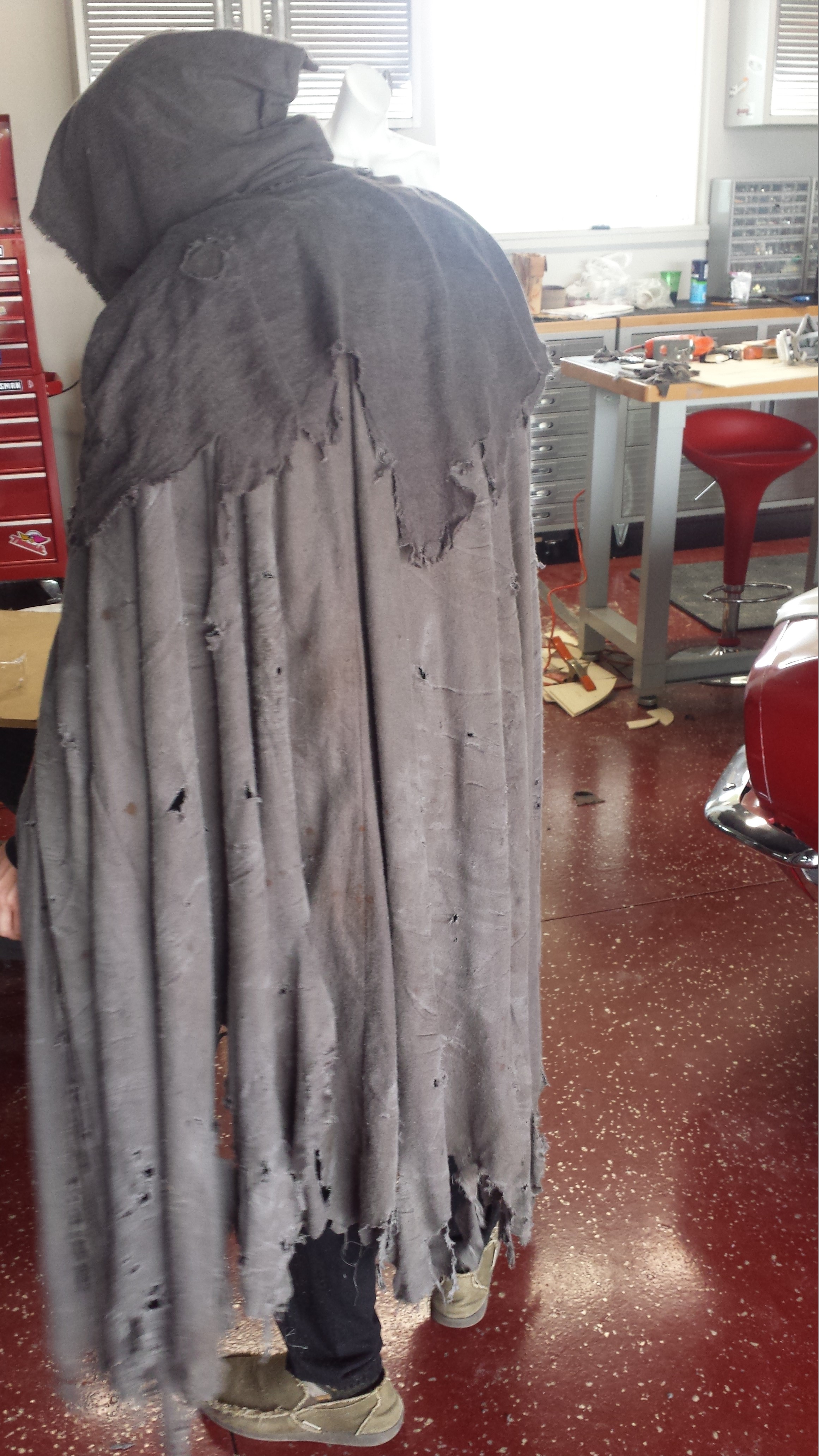

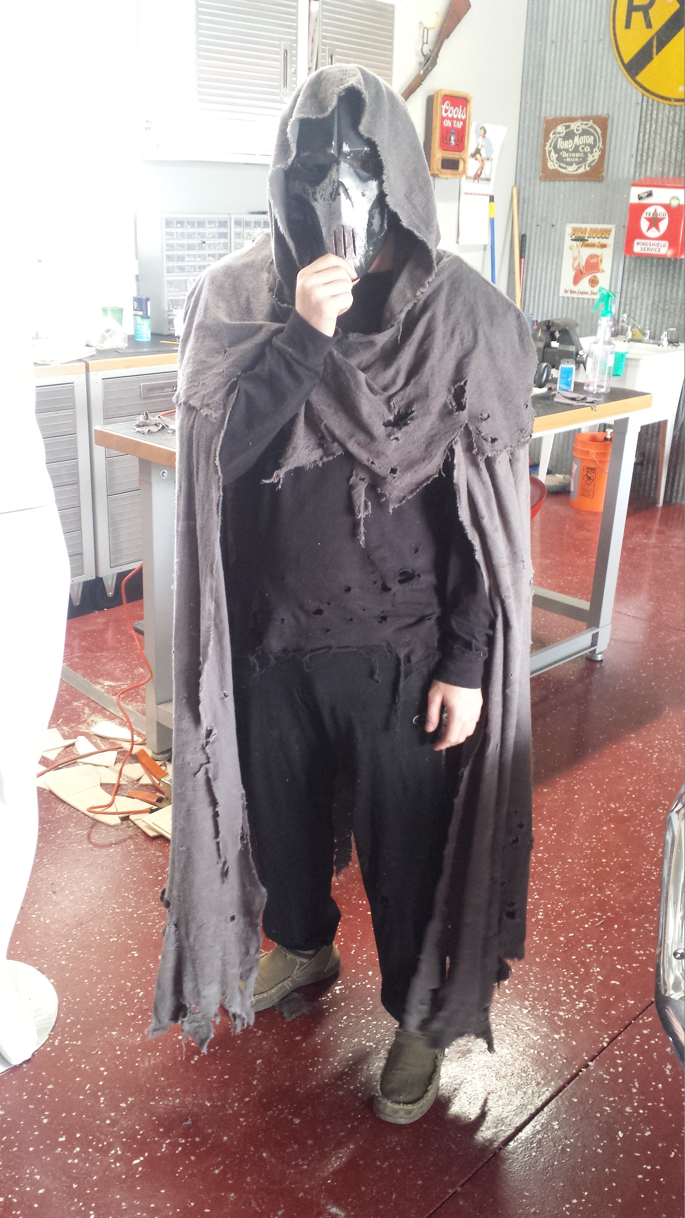

I got to work on the cloak and under shirt today too! I sewed the cloak yesterday. (someone showed me how to sew!). I rubbed wet coffee grounds around the cloak, more concentrated towards the bottom.I let the cloak air dry to assure the stains set in. If you do rub a lot coffee grounds into your material I strongly recommend washing the cloth afterwards, my cloak smells like a Starbucks. After it dried I took a belt sander to the material to shred it a bit. I used a wire brush to fray the material even more. Here's where it stands right now
20150805_144748.jpg20150805_144809.jpg, I

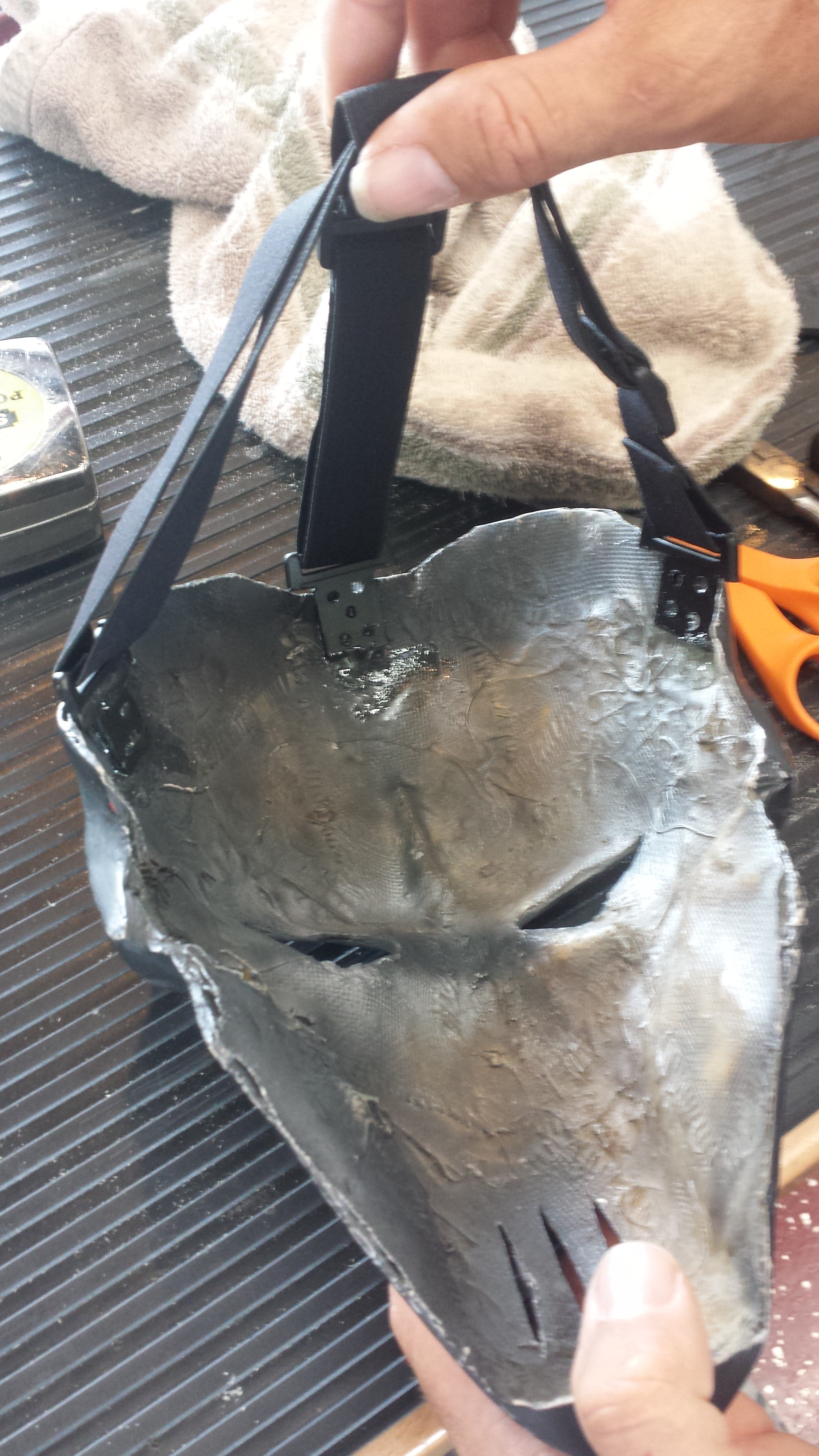

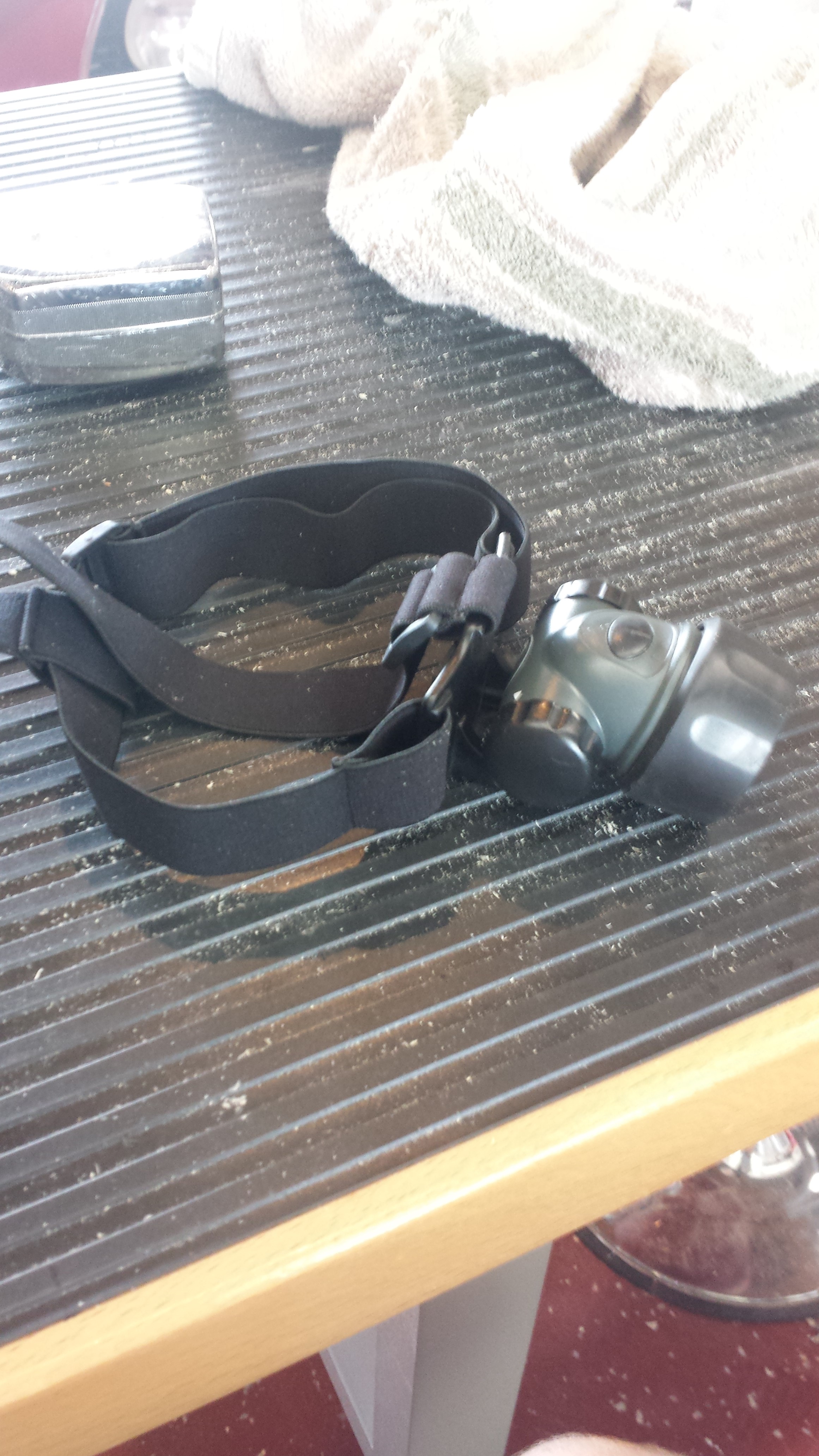

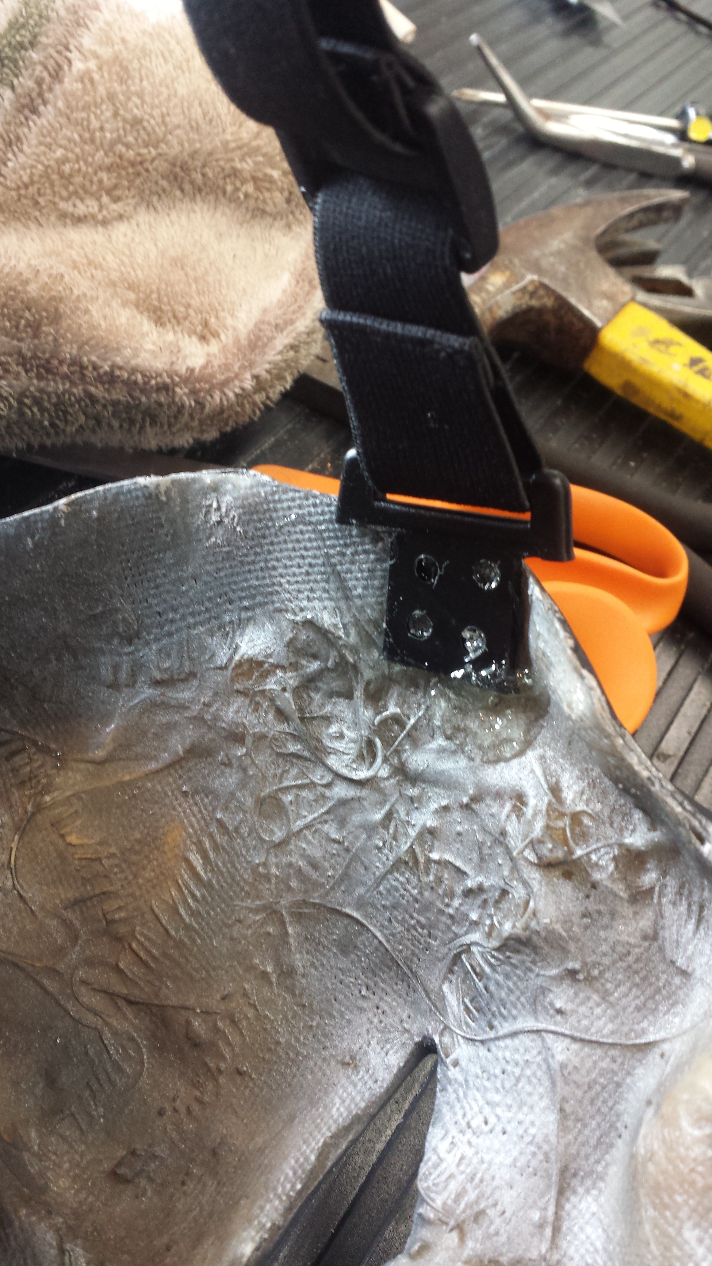

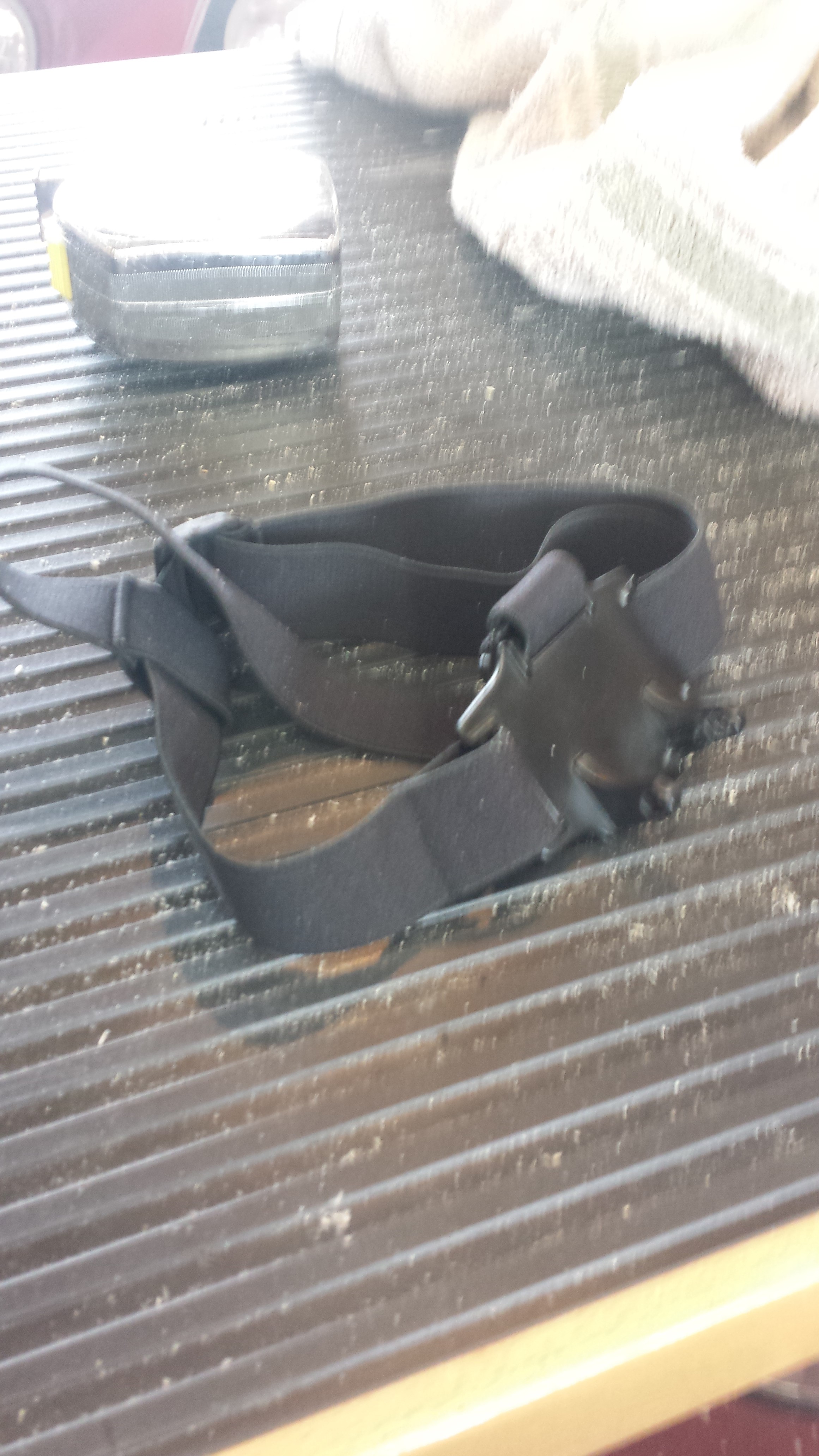

I finally put some straps on the mask. I found a broken head lamp of mine and used it's straps. I cut the middle piece into 3 pieces and then attached it to the mask using epoxy.

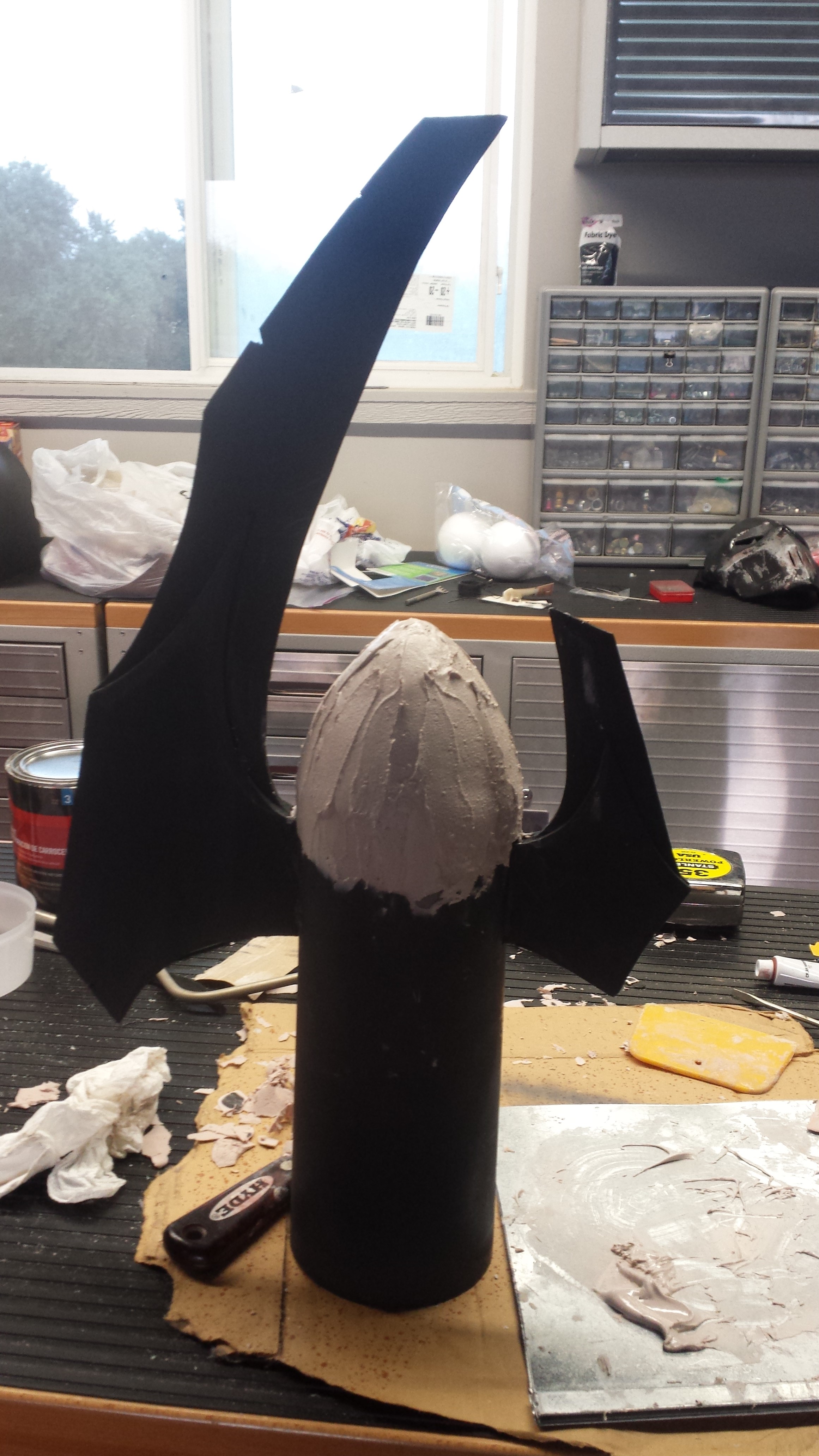

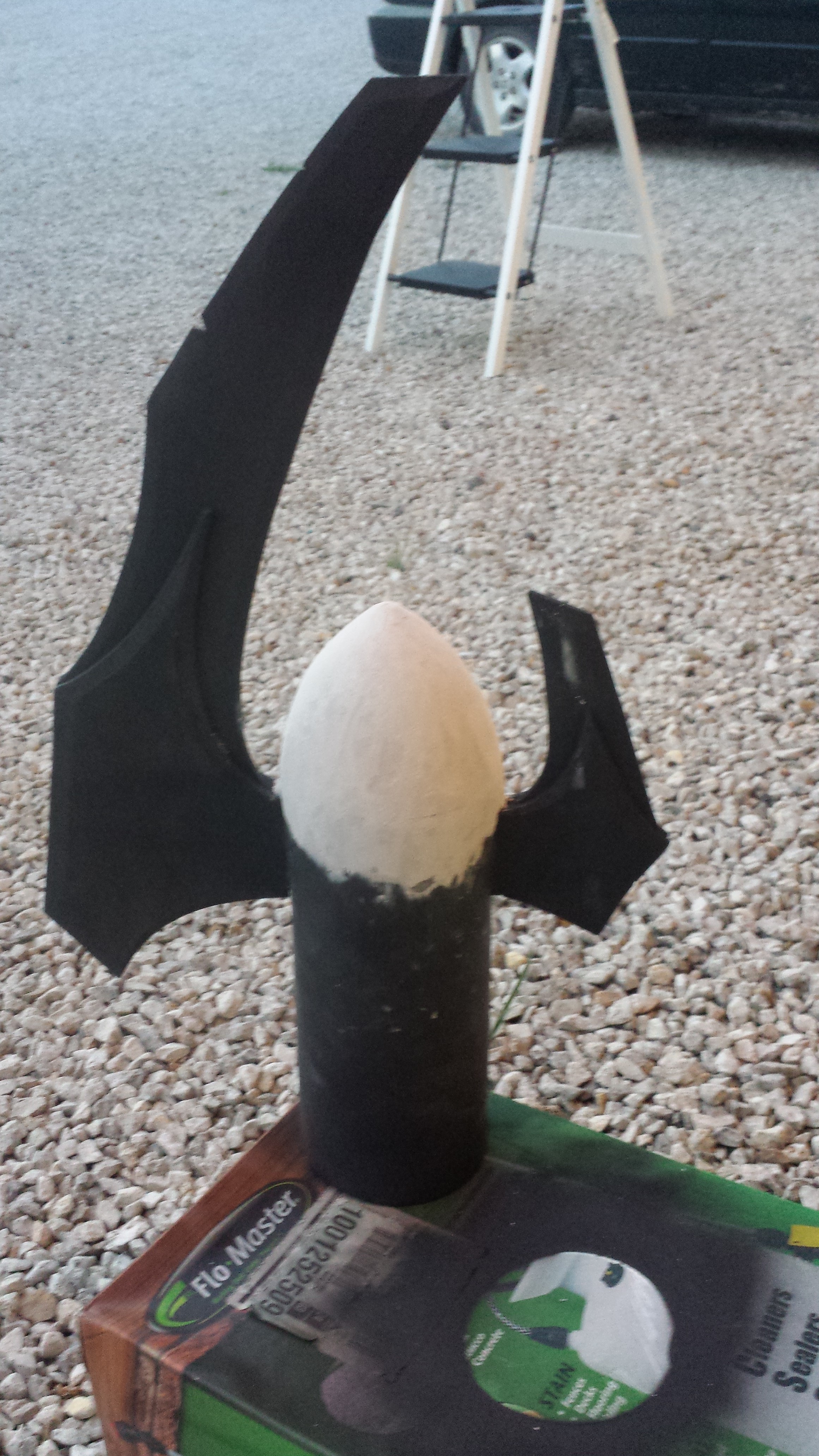

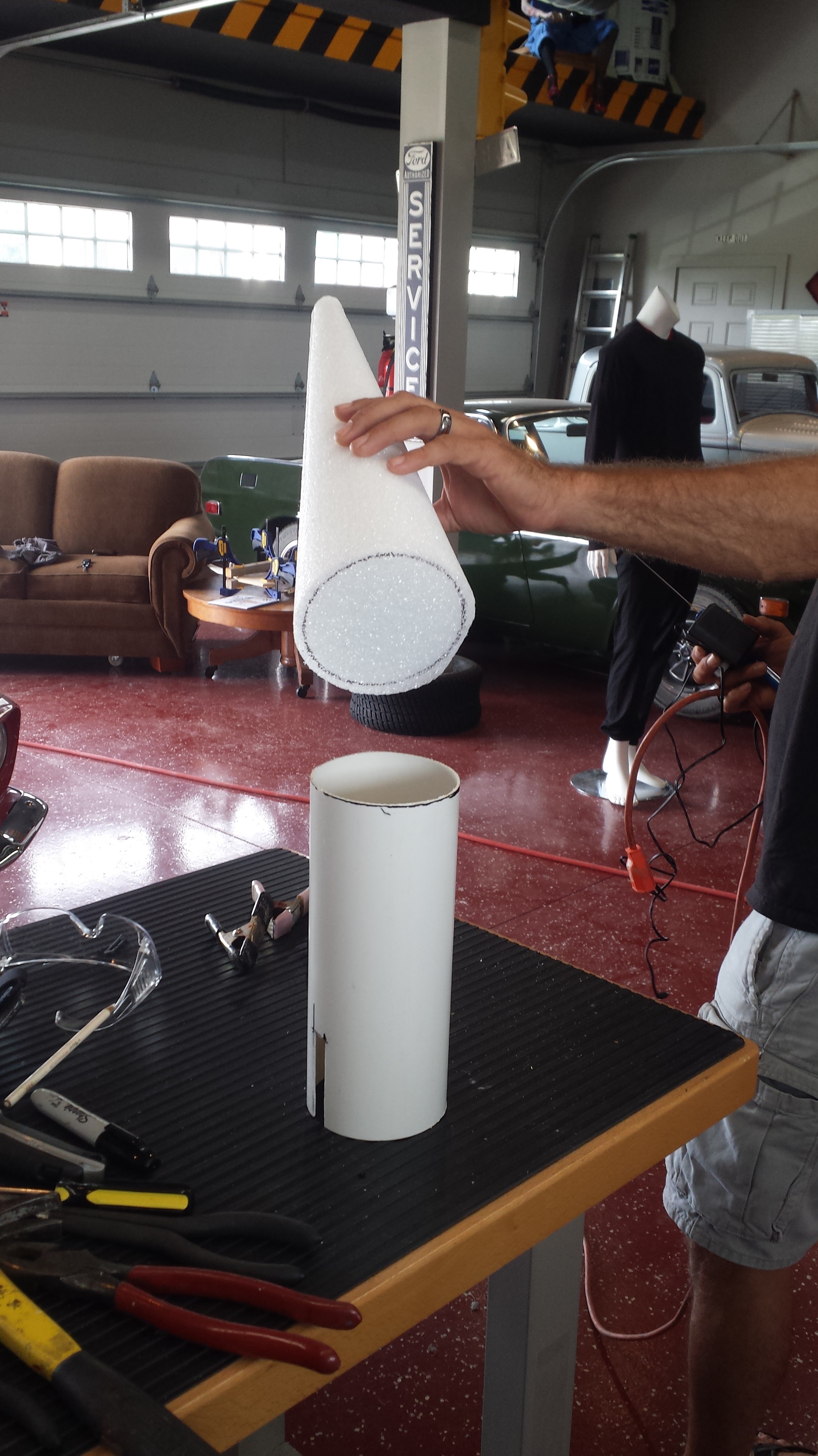

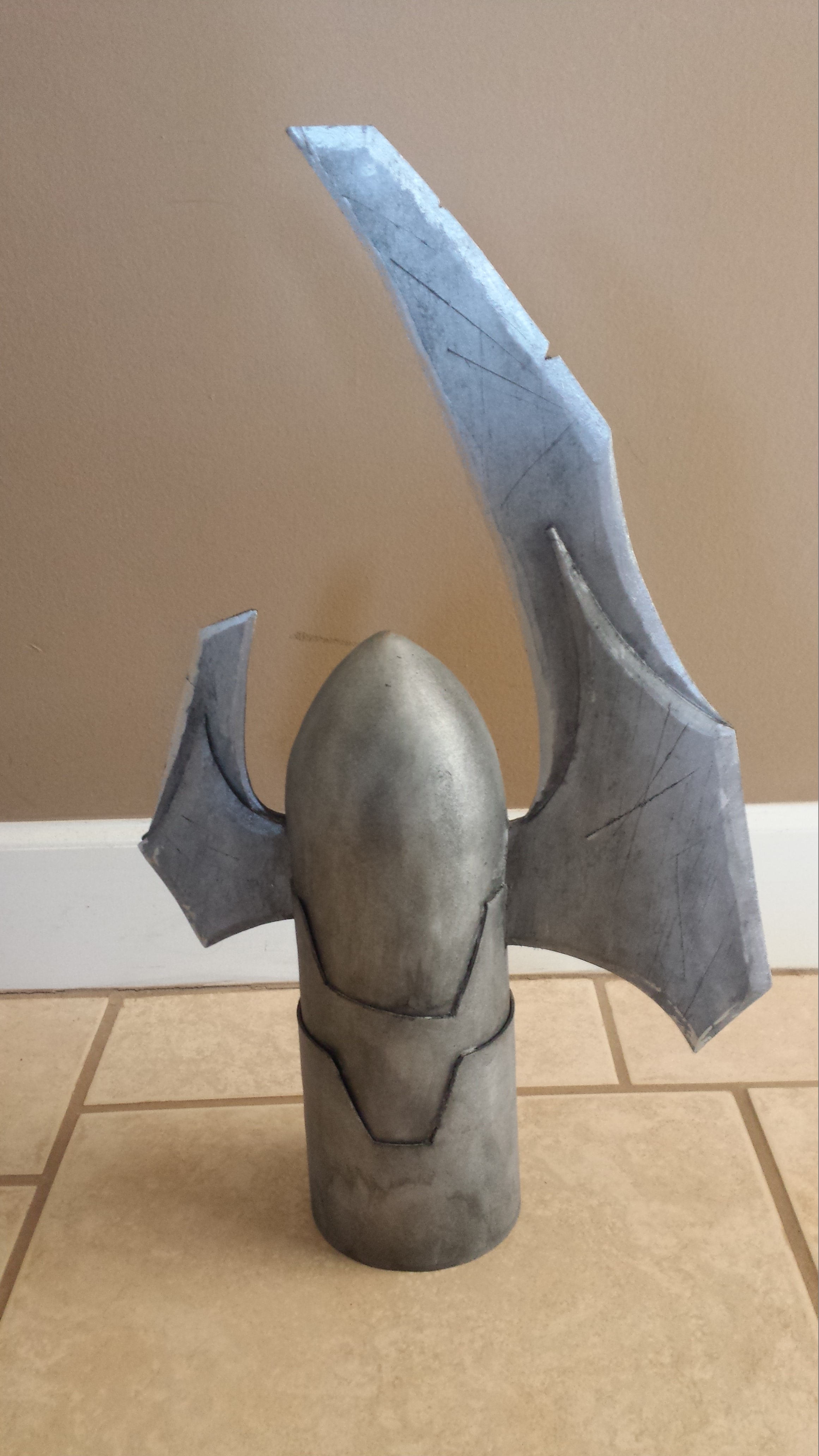

I also finished making the claw today. The base was a piece of pvc pipe. The claw/blades are made from 3 pieces. Sorry I don't have any pictures of the claw being made, but it's just wood pieces cut out. In between the blades is a handle. A slot on both side of the pvc pipe was cut so the blades could slip in. The cap is a piece of styrofoam that was then shaved down. The styrofoam was then covered in bondo so it would attach easily to the pvc pipe. The raised ledges on the pvc are 2 pieces of the thin foam sheets.

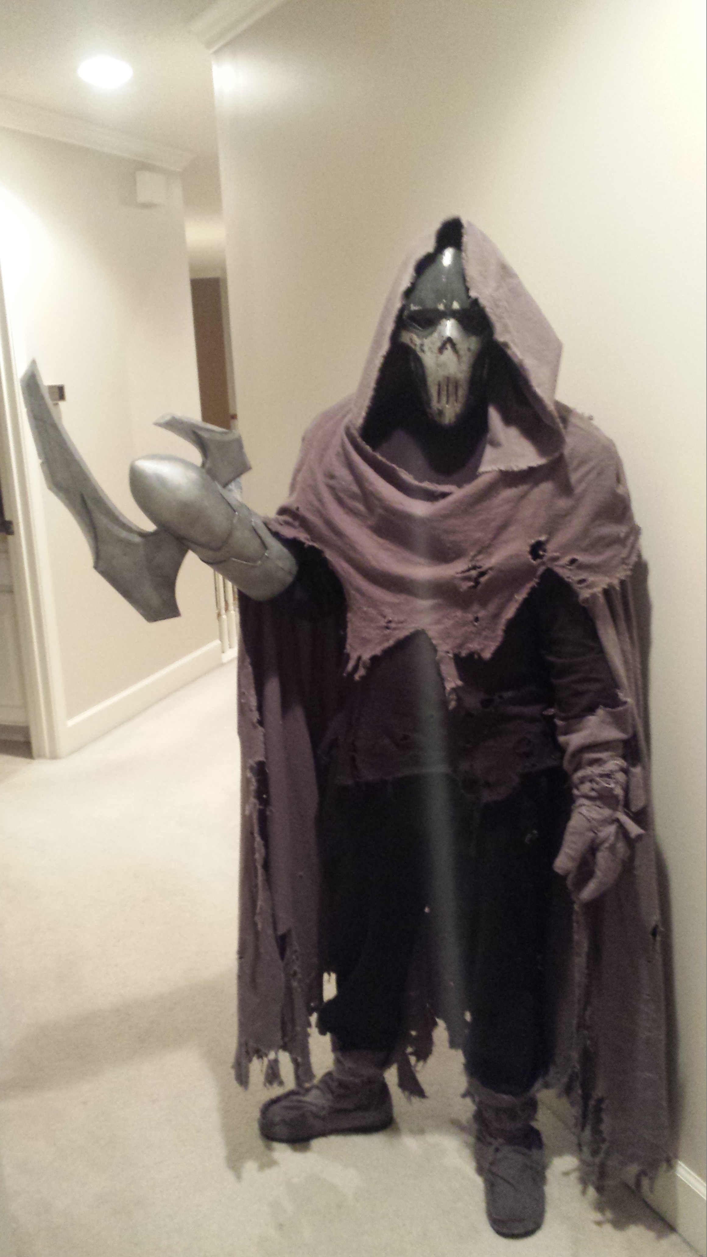

20150806_152253.jpg20150806_200755.jpg20150806_203235.jpg20150807_120735.jpg20150807_173226.jpg

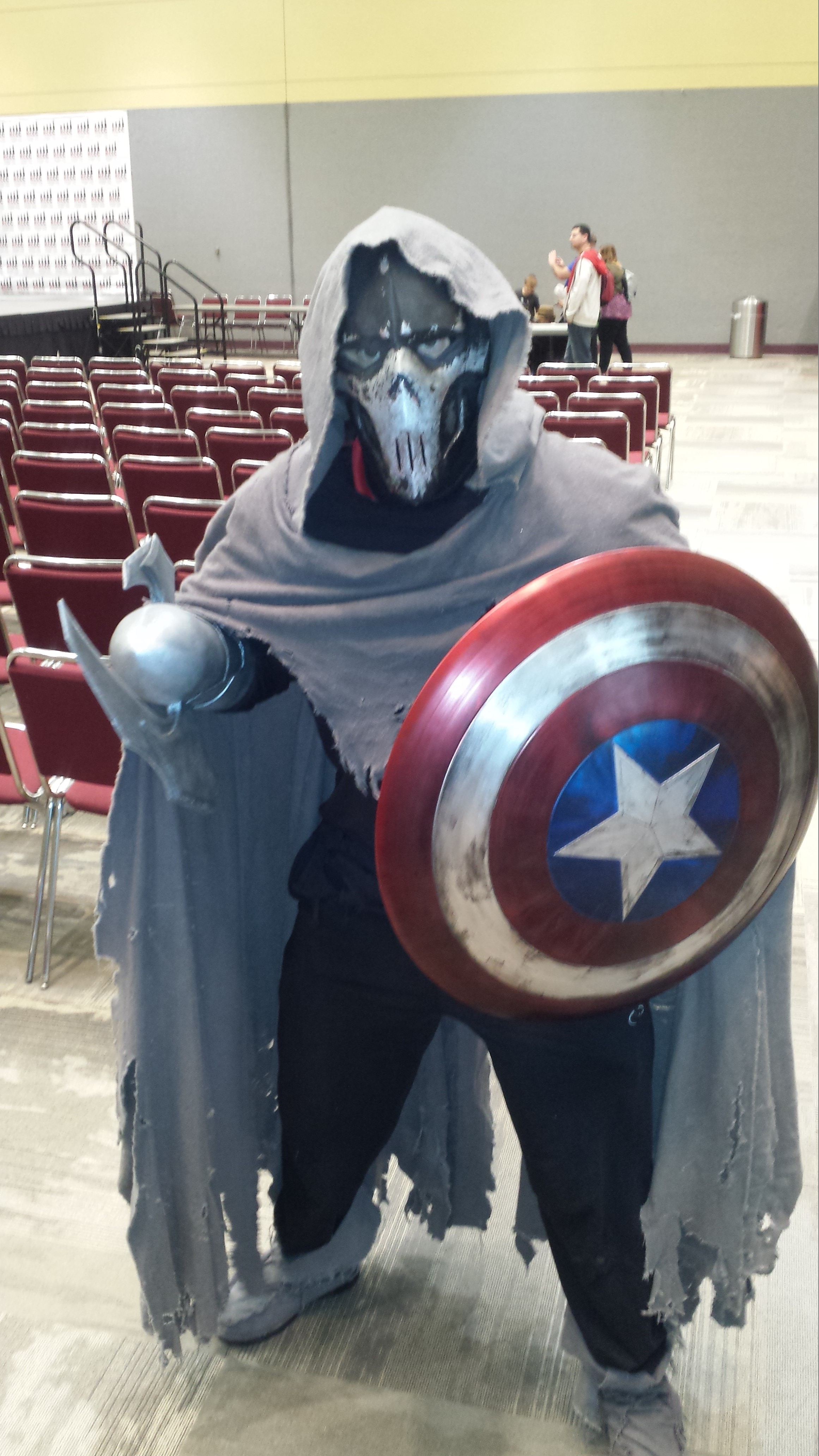

I finished attaching the boots to a pair of shoes I had lying around and my left glove was finished as well. Sorry I don't have any pics of these at the moment. I'll get some tomorrow. Actually the costume is pretty much done at this point. I should be able to get some full pictures of me in the suit tomorrow as I'll be wearing it to KC Comic Con!
Captain Rogers
This is so cool man! I love redesign builds. Your suit looks perfect, and now I really want to watch the movie again lol.
springsteel
I can't believe I missed this thread. Whatever. The mask looks even better in person; with the metallic paint showing through, it genuinely looks like metal. So cool!
