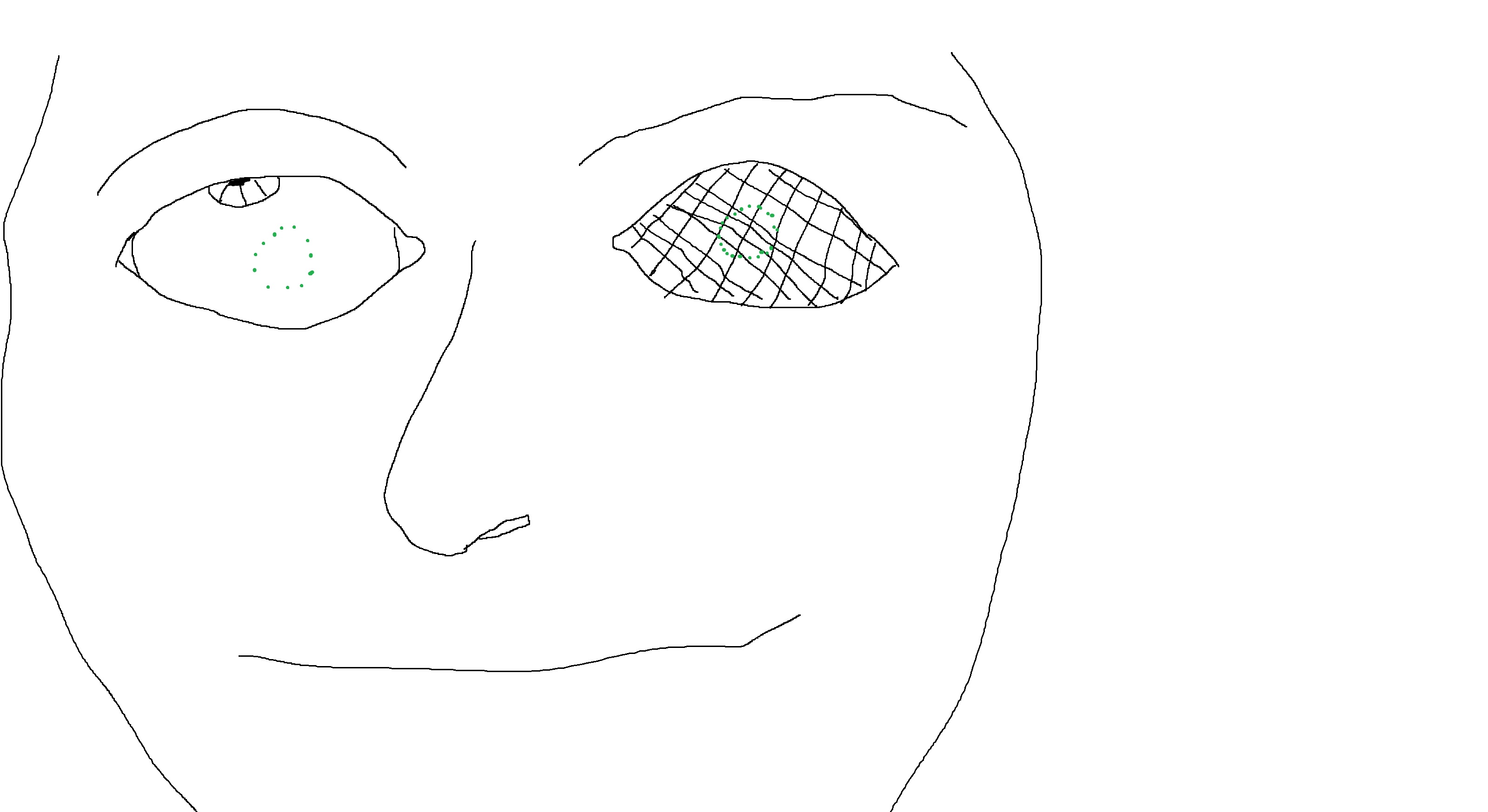

I am prepping for this year's Halloween costume and I am in the works of plotting out my plans for the mask. I will be sculpting it in clay and then casting it in a resin. Does anyone know any clever ways to make eyeballs that you can see through? I am making sort of a ghostly character and one eye is going to be missing, while the other one will be turned, only showing a tiny bit of the iris. So I am trying to determine a way I would be able to see out of the white of the eye ball without cutting open any slits. Is there such a thing as white tint that can be applied to a clear plastic so it appears white on one side and translucent thru the back side? Same with the other eye I suppose. Instead of the white of the eye, I will be finding a way to see through the sculpted eye socket.
Any tips or clever tricks of being able to see through something that you would otherwise not.
Forgive me for my flawless "Paint" drawing. I just wanted to have some sort of visual aid to show what I am talking about. The dotted green circles are where my actual eyes will line up from behind.

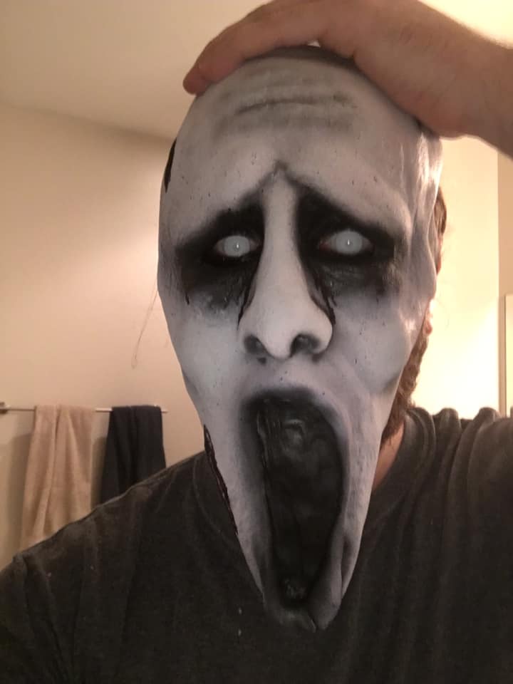

To give an idea of how my masks have been the past couple years, here are my last two costumes. As you can see I made actual eye holes and used colored contact lenses. This time around I wanted to include the detail of the eyes in the sculpt itself concealing my actual eyes entirely.

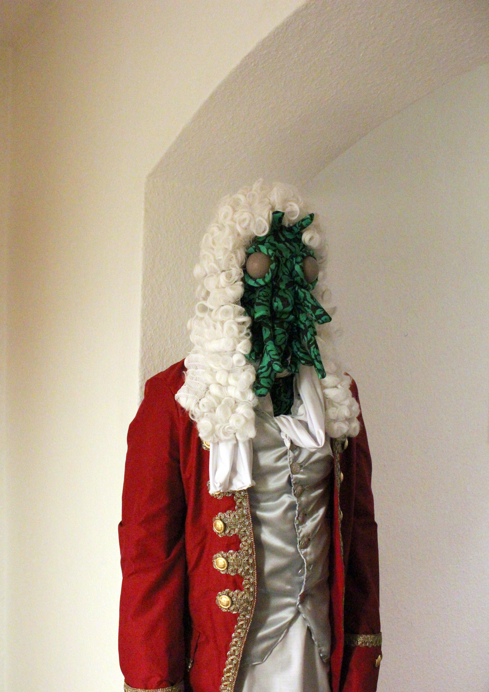

I have had good results with BarbWires method. I simply used stockings and put them over a clear sphere. Can be a little hard to see through, but for me it worked.
also used black stockings that had kind of a latex layer on it, what worked pretty good. you can still see through. (sorry for the pad picture)
If you want white, maybe you can find a similar material in white.
