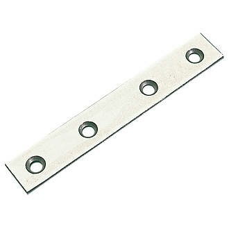

The best way to connect shin thigh is using mending plates use hot glue to get them where ya want them then fix them permantly with resin cloth i sued them on bicep forarm too
Sent from my SM-G920F using Tapatalk
@creativestress what are "mending plates"?
These you need 4 for ea leg to for shin 2 for thigh just use a bolt and locking nut to hold the leg together ae235.jpg

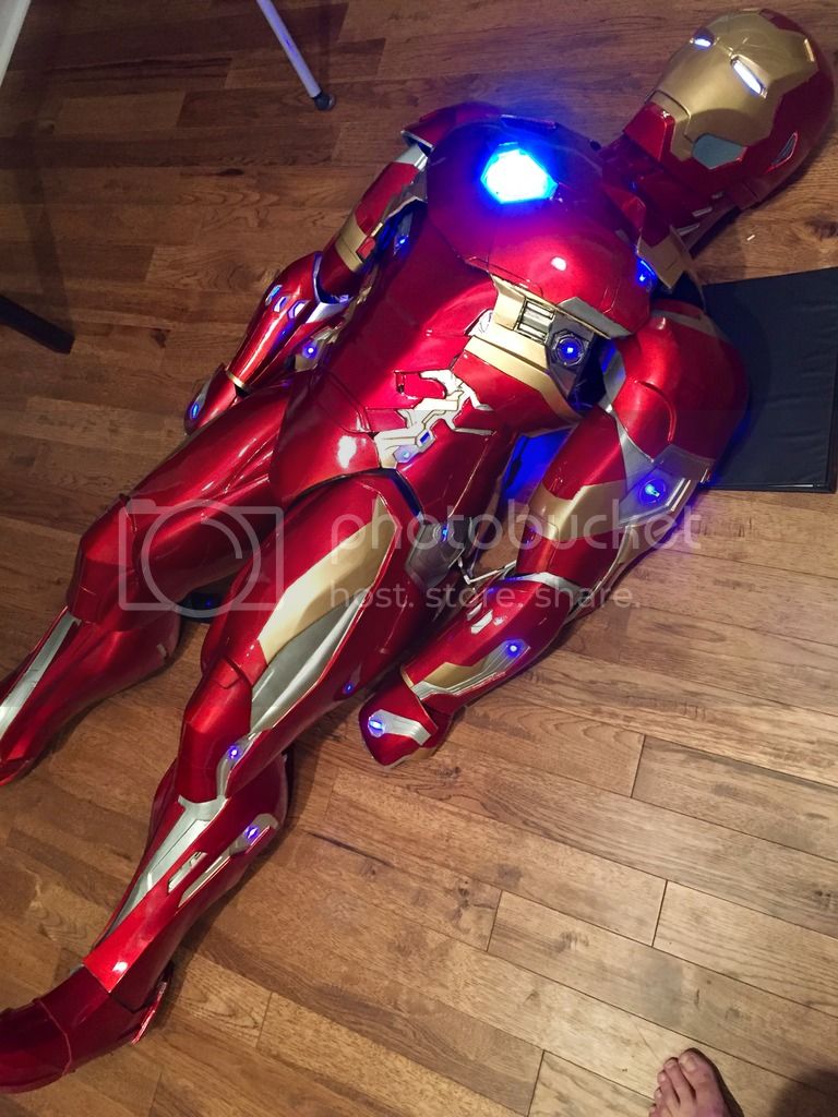

LEDs are complete. Was able to sort out the knee. I added shoulder straps and foam in the knee so it stays aligned. Can't use the mending plates because of the form fit. Unfortunately I have to twist my leg in each peice separately. Just need do the fingers this weekend sort out the helmet issue and it's a wrap.
[url]http://i1378.photobucket.com/albums/ah120/tkcc71/0A848BA5-EB8A-46BC-8AC6-D08A11F0515A_zpsuxwckiks.jpg[/URL]
How are you putting on thigh armors and shin are they two separate shells or you got any new technique
