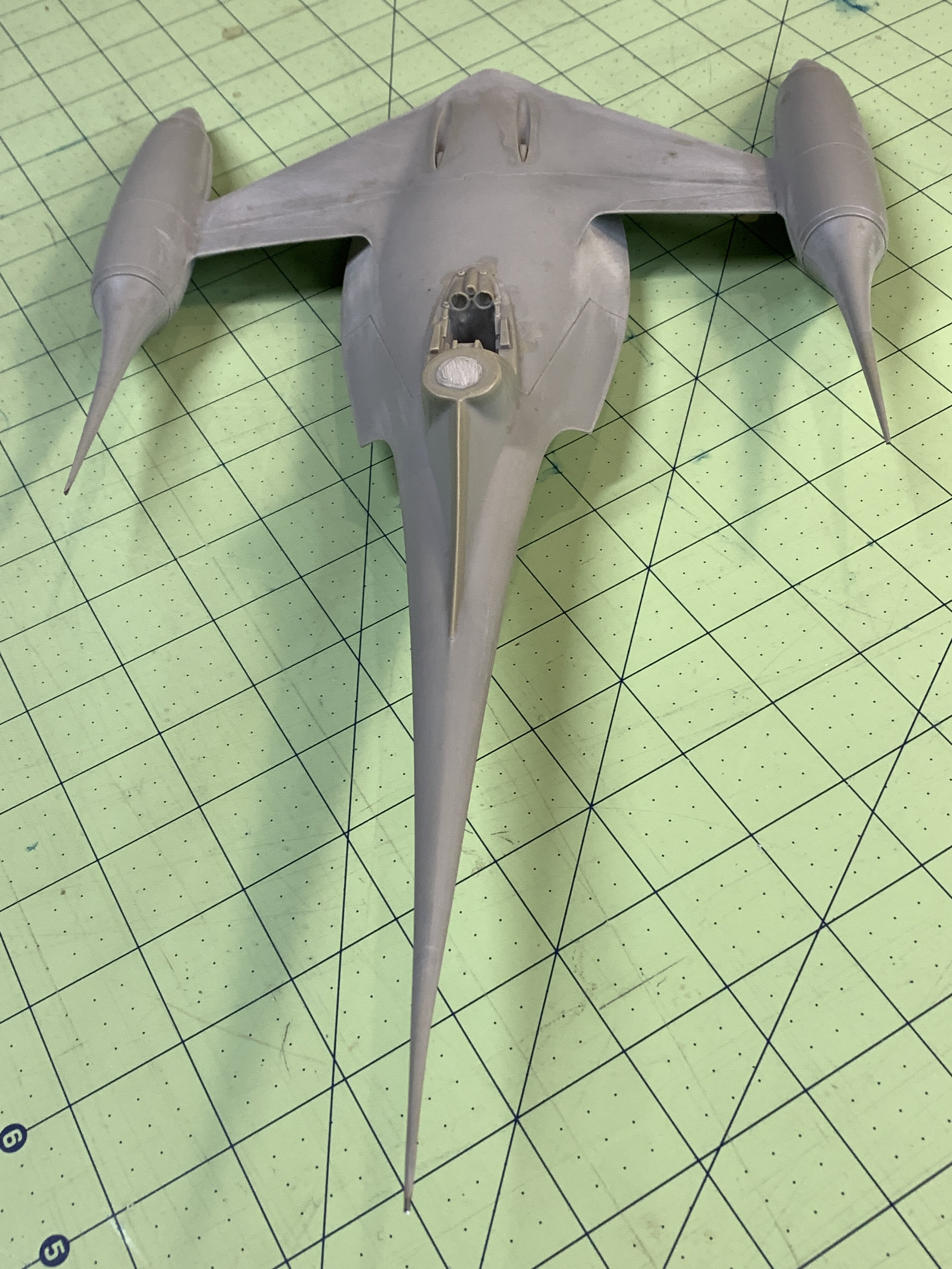

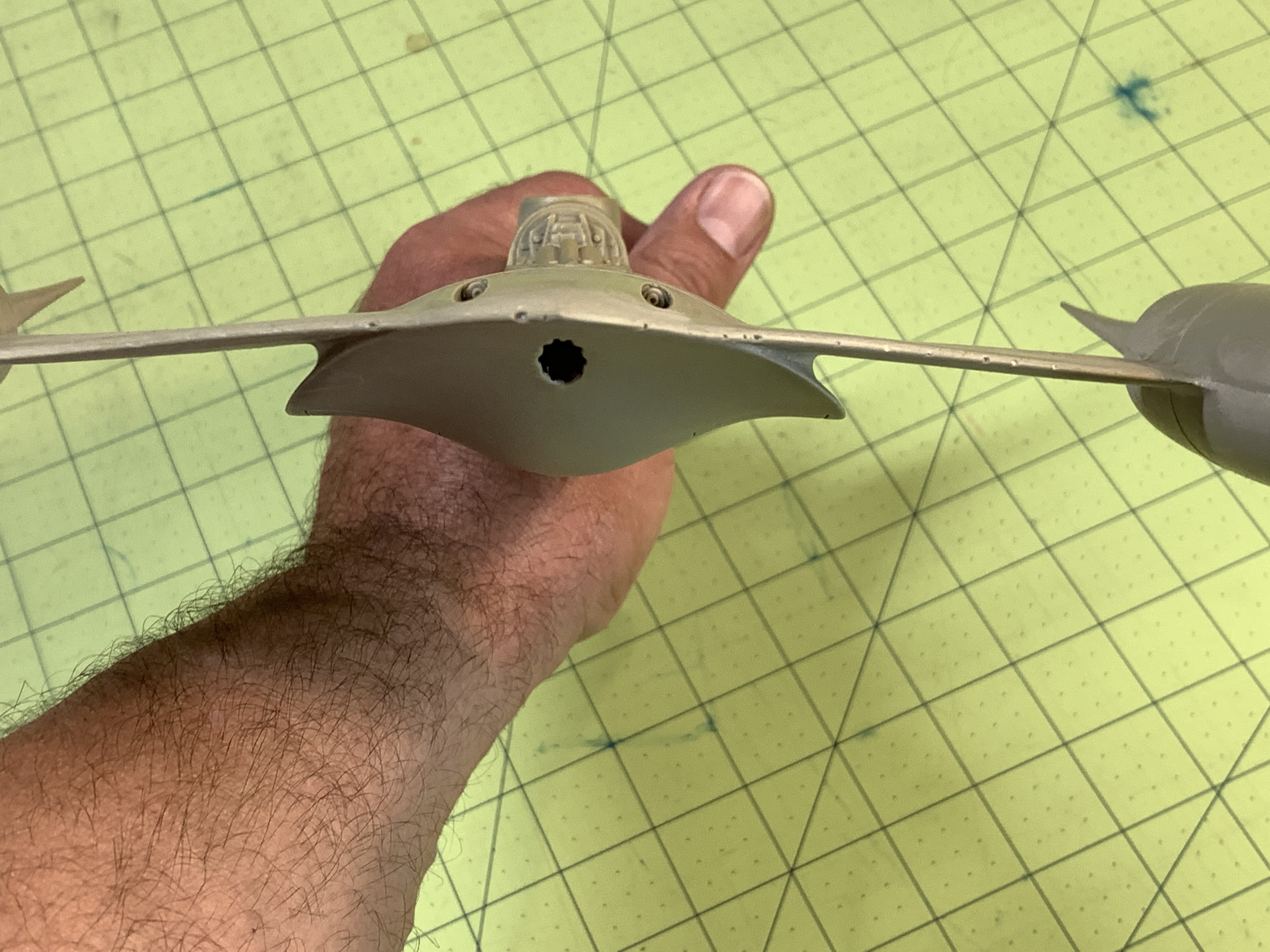

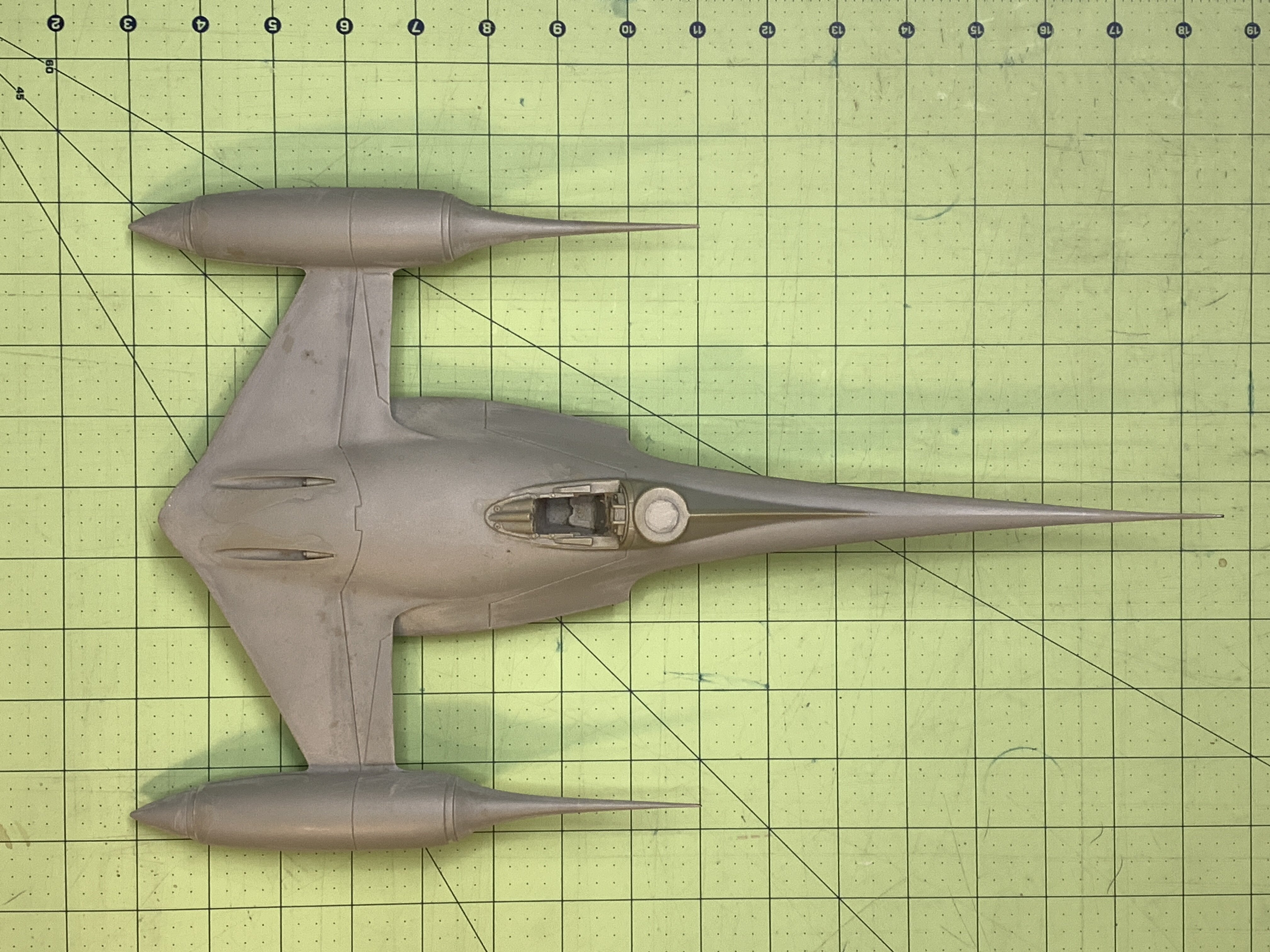

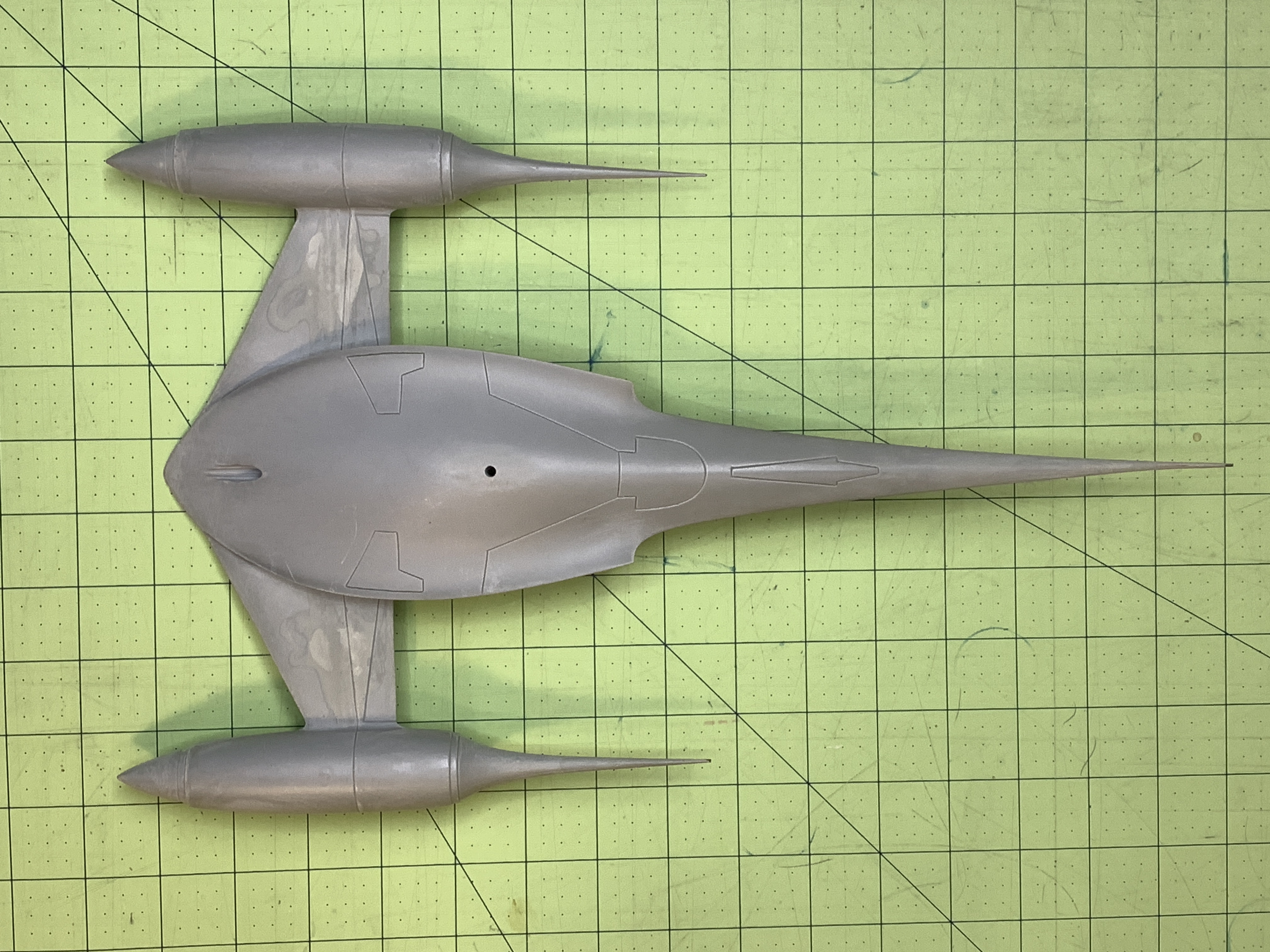

I snapped a few pics of my N1 maquette castings, and here they are!
And, yes Hunk a Junk, there were gear doors scribed into the maquette. If I recall correctly, the landing gear was to look similar to the Queen's ship landing gear - kinda' curved and pointy.
I also included a door for loading R2 from below. My "logic" for that was that he was oriented sideways, with one shoulder facing forward.
Since his head could rotate all around, he didn't need his body facing forward, after all.
The original drawings had a more flat bottom. I added the "boat-hull" bottom as well as the chines (or winglets) along the fuselage edges.
I still have the original wooden model tucked away somewhere (I'll see if I can find that too). It has the wings coming straight onto the body without the curves at the wing root. It shows how the design developed as we went.

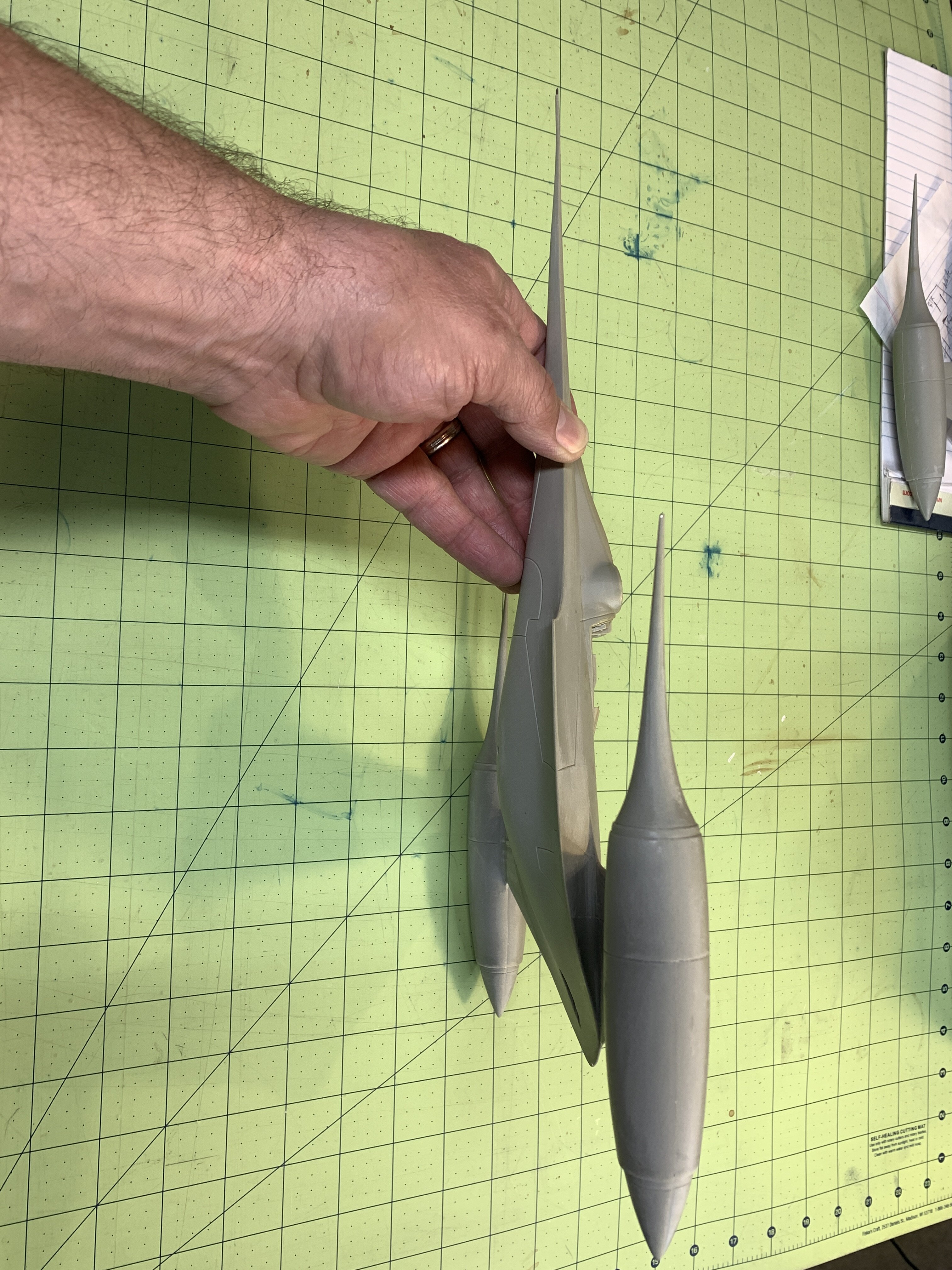

Sorry I couldn't do a straight side view - the foreground engine blocked the fuselage contour.
You can see the straight rifling on the torpedo barrel in this shot (as well as bubbles in the leading edge of the casting;)).

Wow, thanks dude...these will really help to compare to when fairing my lines. Love the logic on the R2 hatch.

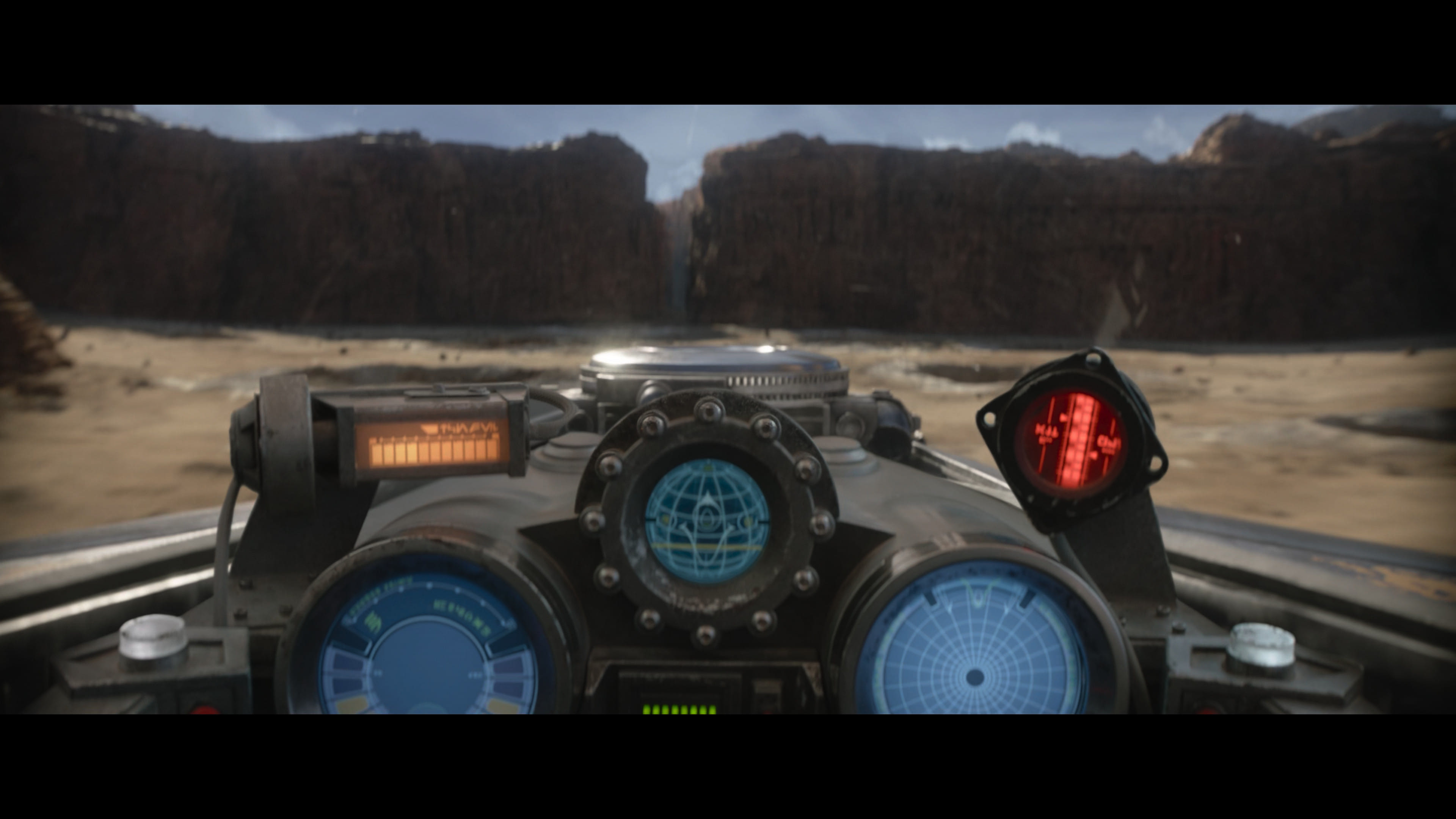

Just thinking ahead...if anyone has a hi-res image of the HUD panels...I'm thinking to have them at least lit up with the other blinky lights in the cockpit. I have this screen grab but it's cropped and a bit blurry;

I always wondered how the R2 units were supposed to fit in these. I remember seeing illustrations that showed the astromechs being disassembled inside the body of the ship with just the dome exposed, but Duncanator's original idea sounds much better.

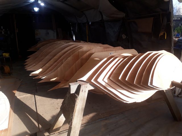

OK, a lot of work later...I have all the shell templates sitting on a steel bar. Nothing is spaced out properly yet but it gives me idea what I'm up against. Next up; insert the lower bar and weld the two spines together in a kind of ladder pattern, to fix everything in place;
Duuuuuuude!!!!
So cool to see your progress.
The full sized Ep1 props used adhesive-backed mylar sheet for the chrome, but Mando's looks like most of that is raw metal.
Hey guys, so this project has been on the back burner for a bit while I tackled other jobs but hopefully now I can continue with it.
So the next stage is getting the moulds ready for glassing, which means the steels have to go in first...Every alternate pair of moulds is filled with Jablite and carved to shape. Once the steelwork is welded in place, I can fill in the gaps
