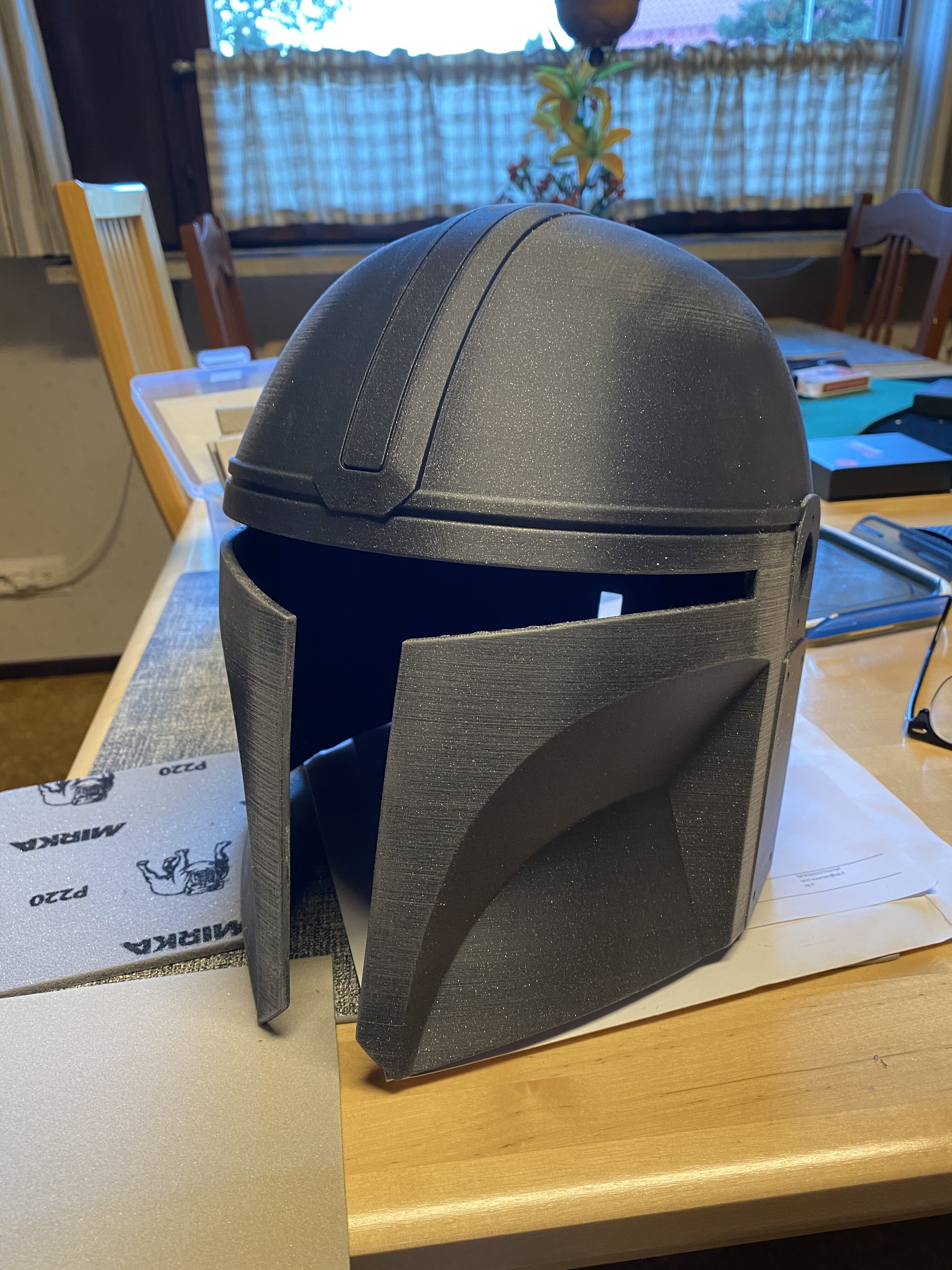

Hey everyone. Thought to share my Mando build which also happens to be my first "real" finishing job on a 3D print. Got my first printer this year. I had thought of getting one for a long time but as I was looking for a good Mando 3D model for a friend, I was referred to Great Ape's model right here on RPF and that really was the tipping point and the printer arrived a week later. For a few months I kept churning out small prints, the Mando files always tempting me... After learning the ways of the for...I mean my printer, I decided its time to dive into the deep end and take my chances on a 6-day print with really no support. I can honestly say it was a week with less than adequate sleep, the last day being most harrowing...
I do know casting would be the best way, but not having done any serious print finishing, wanted this to be as much of an exercise in finishing as it is getting a bucket of my own.

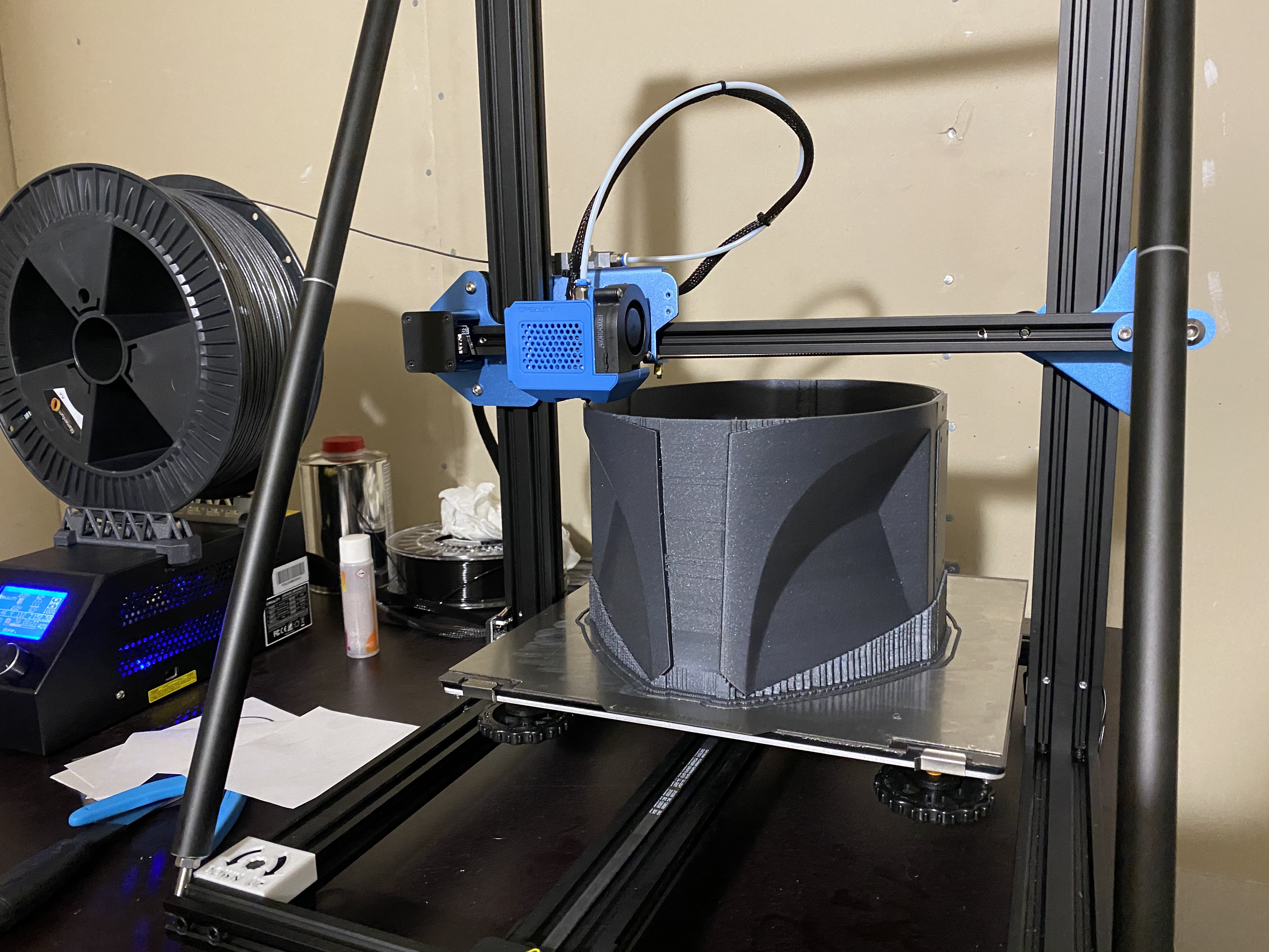

Armed with a 2,5 kg spool I was as ready as I was gonna be...

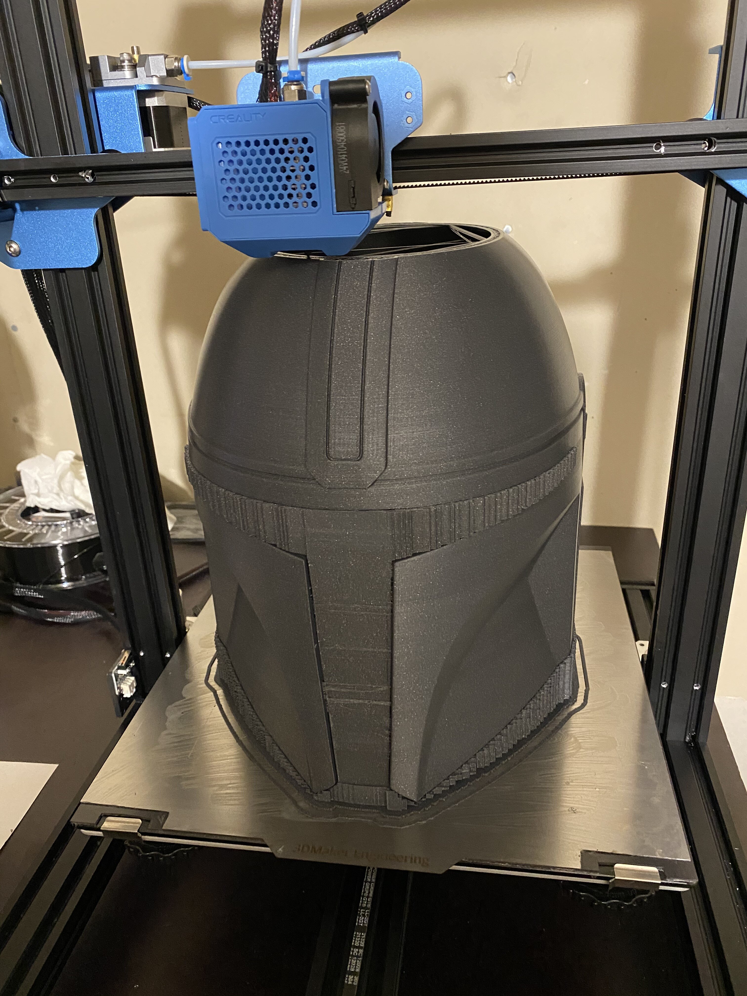

At this point I started to worry more, as it had gone so well...
And some time later:

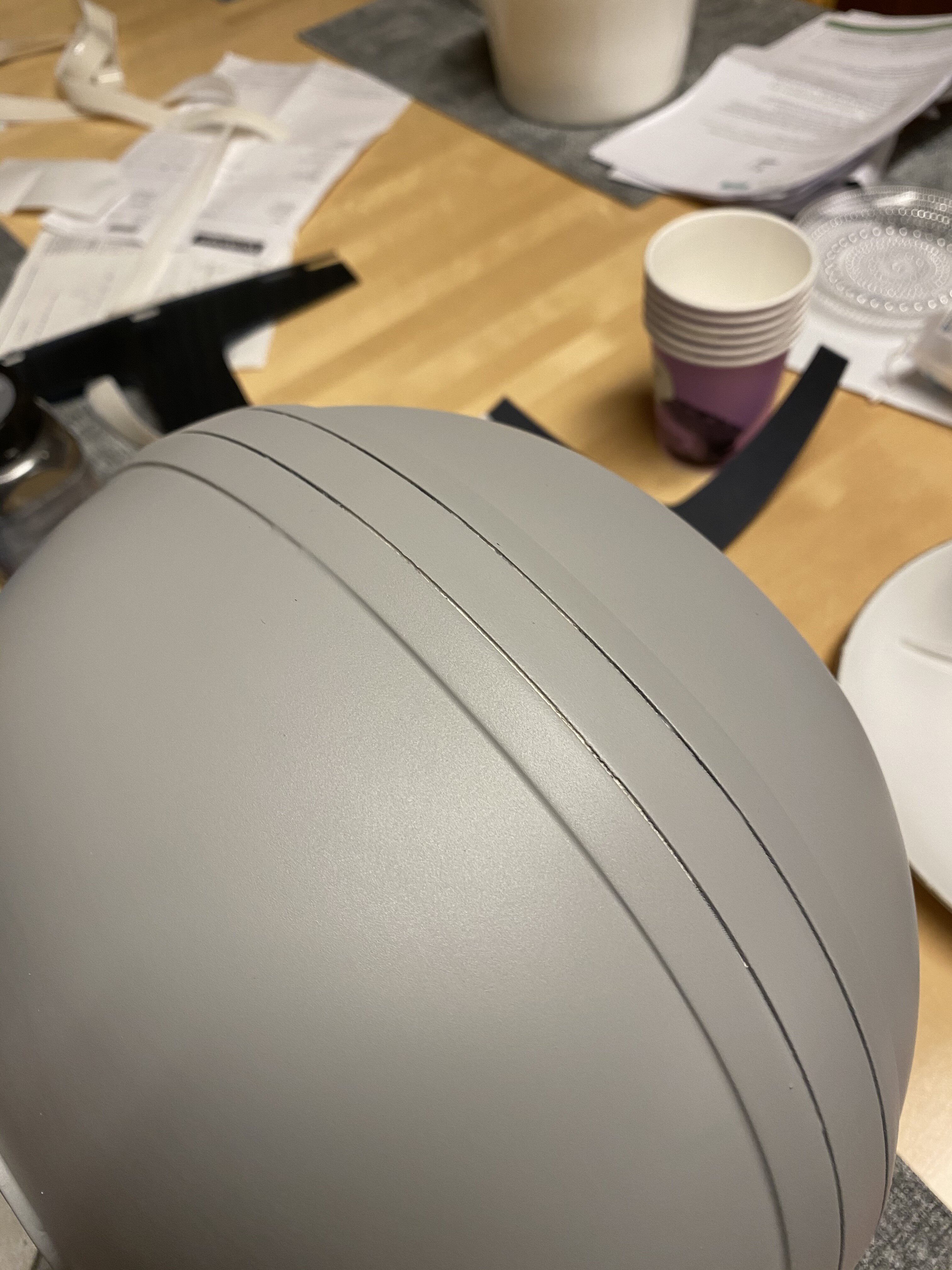

The very top had very visible lines, so it was filled with some drywall putty and sanded a few times. Then I started going with XTC 3D, diluted with rubbing alcohol and sanded. Did 3 coats of it.

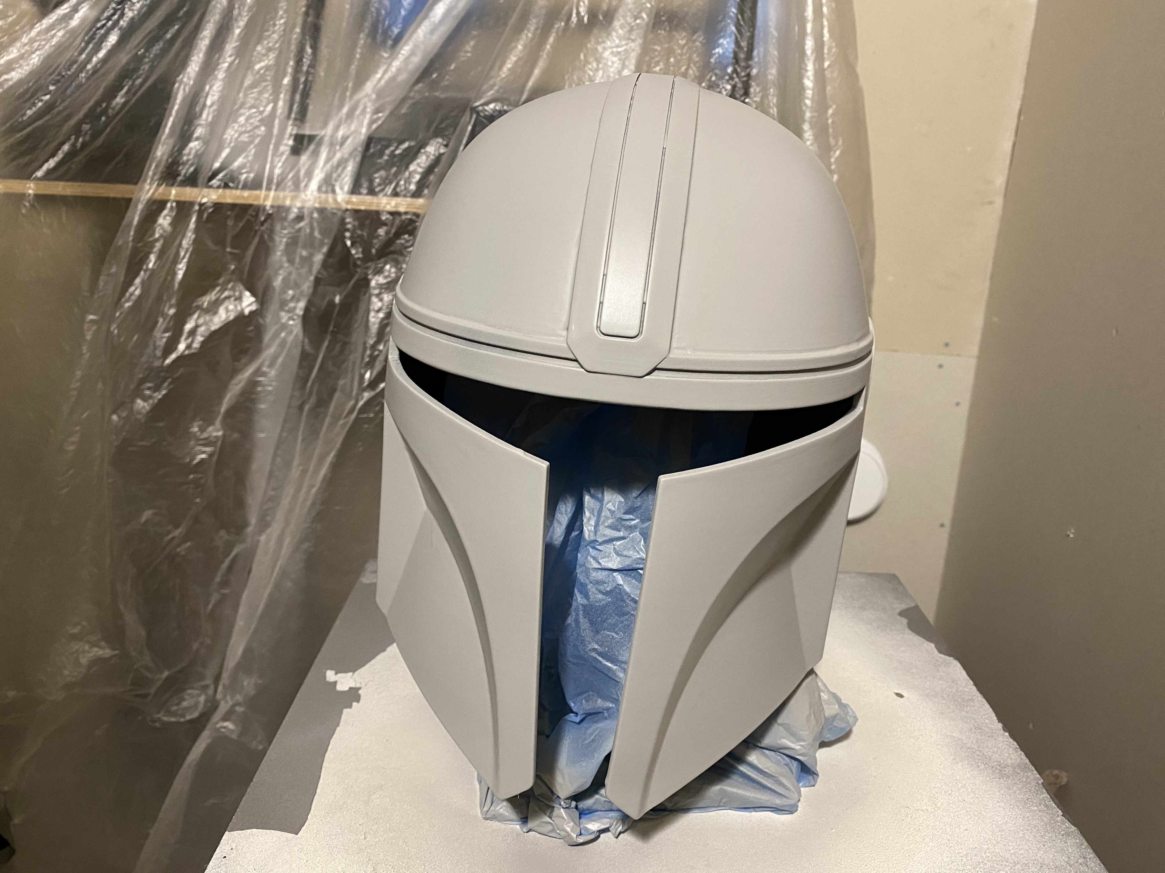

After the resin coats, it was filler primer time:
Very top, the really problematic area, turned out just fine:
Filler primer was then wetsanded:
I did make a few booboos... Accidentally took wrong rattlecan which caused a reaction with the original black paint, resulted in some peeling. After that, I put on a coat of the proper paint, backed onto a leaf blower and ended up dusting the entire helmet. Had that been a TV show, it would have been 5 straight minutes of beeping...

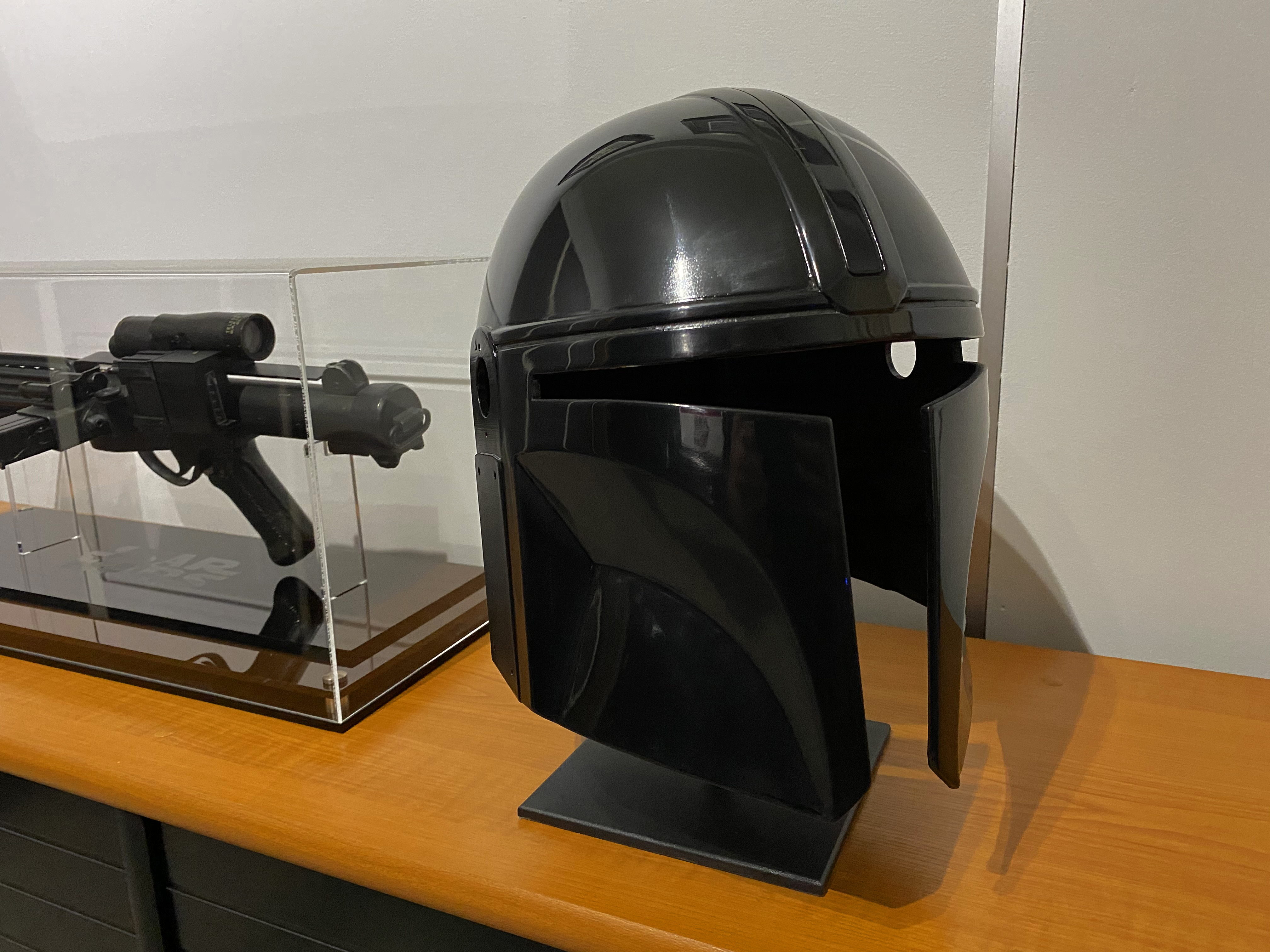

This is where it is now:
Theres both some dust and water on it in the picture.

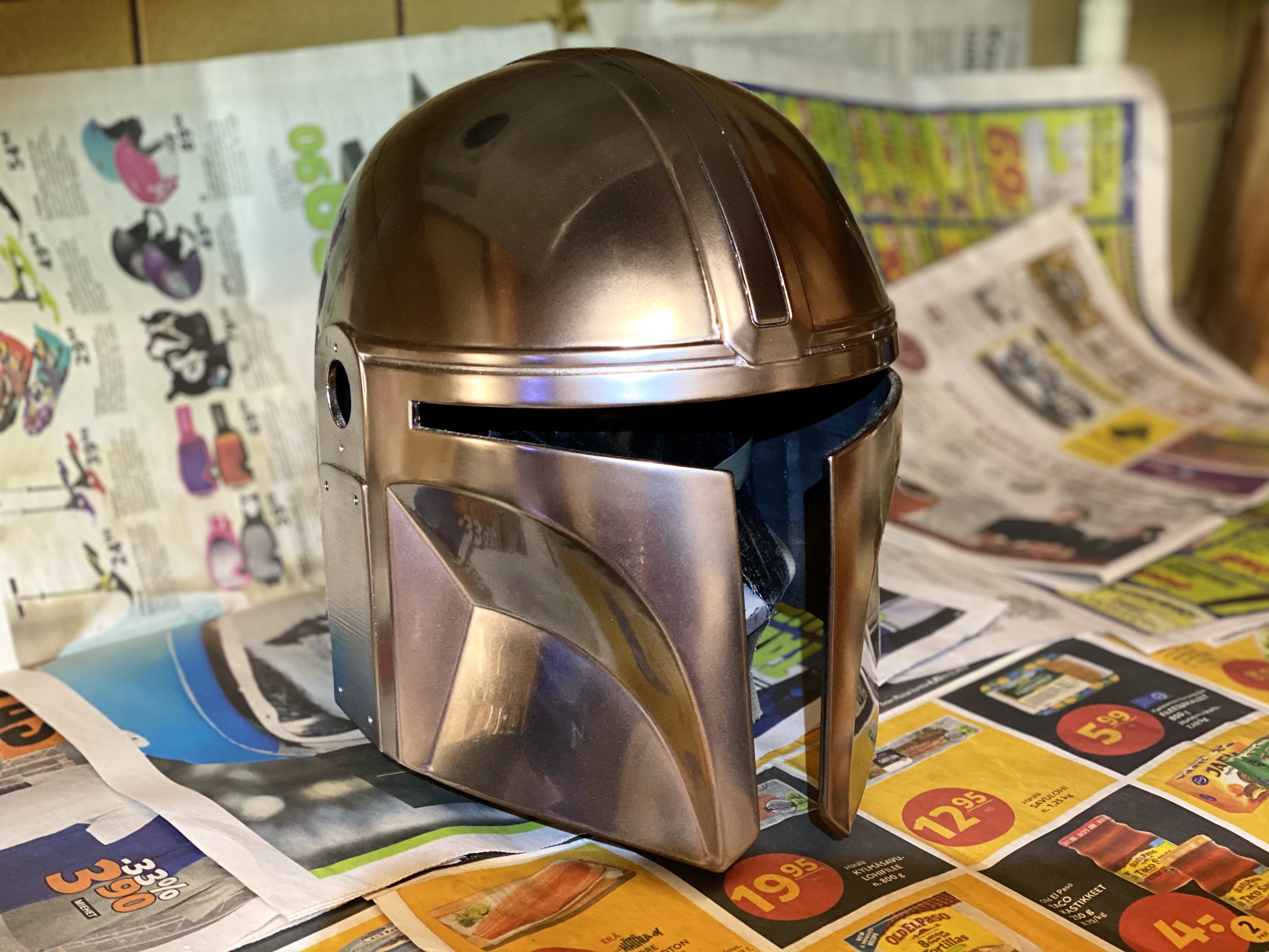

Little update since yesterday...I was mostly happy with the finish, but there were a few tiny hairs on the bucket. So in a surge of empowerment I decided to hand polish it and now I am quite happy.
Now I just need to make up my mind as far as the metal finish goes. My initial plan was to use graphite powder, but having tested it on numerous things, I am not very confident getting it on as good as I want. Alumaluster is not available here, and even if it were, the price makes it intimidating to use-I'd hate to mess up paint that pricey. I might go with Stainless Steel Alclad as my tests have been very promising with it.
Do have a question about the visor. I am using the Hobart welding visor. It is flexible, but should it be pre-bent? Also, how do you guys attach yours? I am even toying with the idea of Velcro so I could easily remove/replace it.

Thanks! Like I said in my original post, this was very much a process of learning the proper way to finish a print and from the very beginning it was my goal to take it seriously. I did leave the ear portions unfinished-save for what filler primer there is-for two reasons. Its covered so why bother, but also to have a point of reference so I can see my progress (and pat myself in the back lol).
I am quite happy with the color, its Alclad Stainless Steel. While it may not be screen accurate, to me its way more important that any given prop I have looks good in person, or I should say looks and feels right to me. That said, I absolutely love the attention to detail I see here every day with awesome 100% screen accurate builds.
