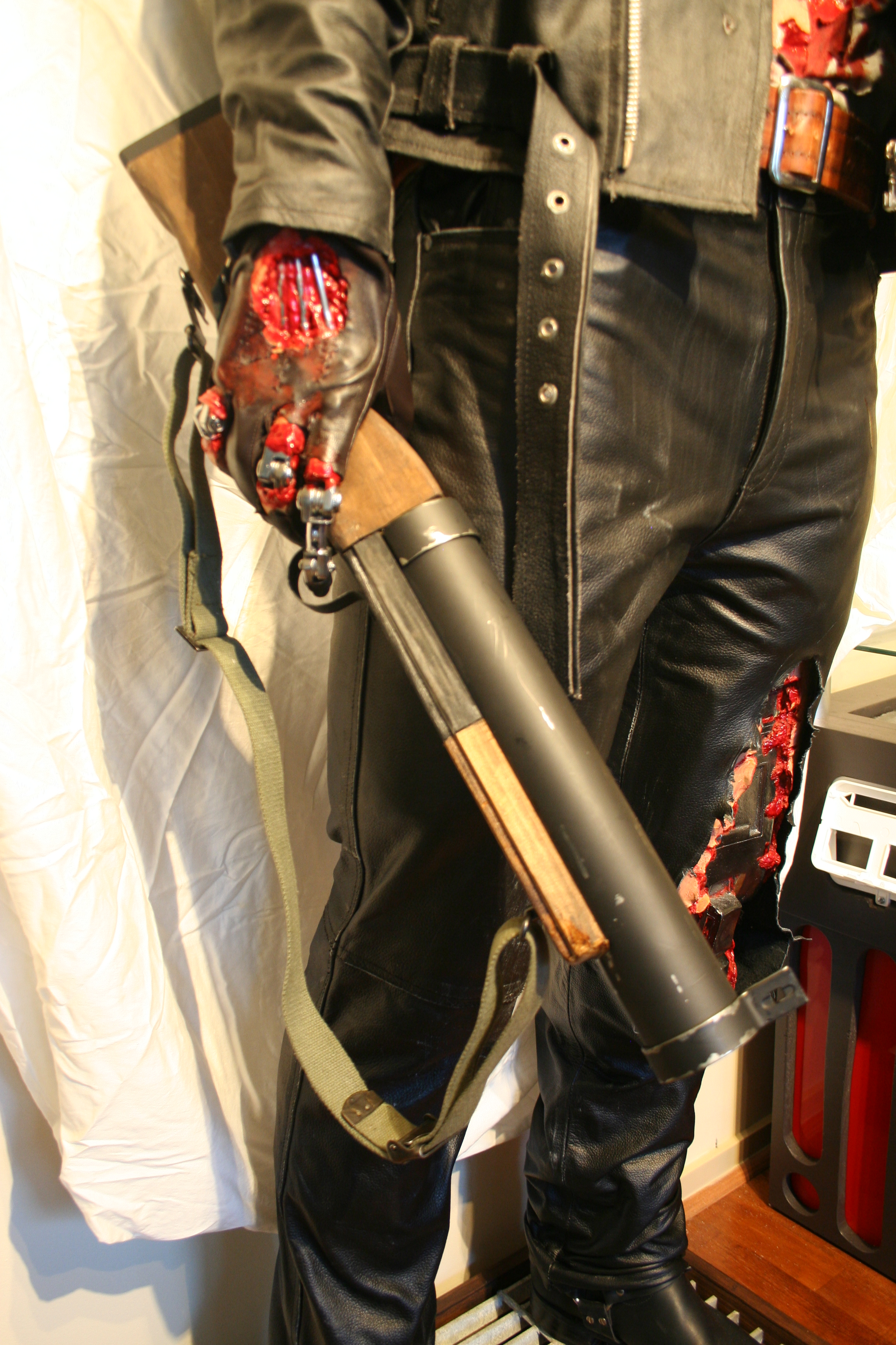

    I made this Stage 5 lifesize a little while back so I assume you are wanting to make something similar?
    here is the link;
    http://www.therpf.com/showthread.php?t=210351&highlight=terminator+stage
    With the mannequin hands you can simply heat them up using a heat gun and they become flexible. Pull the glove over it and pose it onto the M79 to whatever pose you want. Then you will need to hold it in place until the hand cools and becomes really rigid once more.
