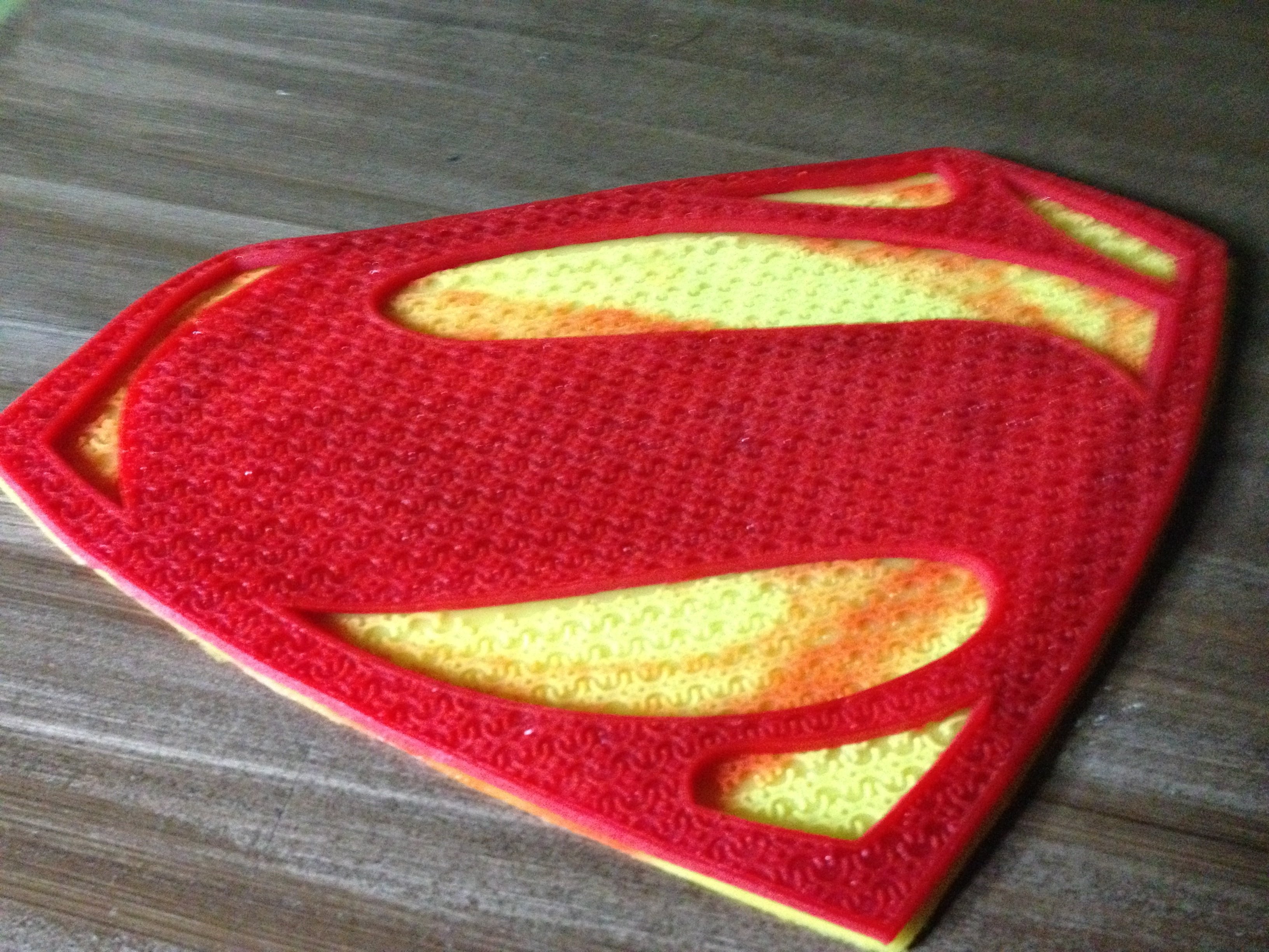

First off, you have to start off with some sort of texture. In this case, I ordered the Man of Steel emblem from Kapow here at rpf

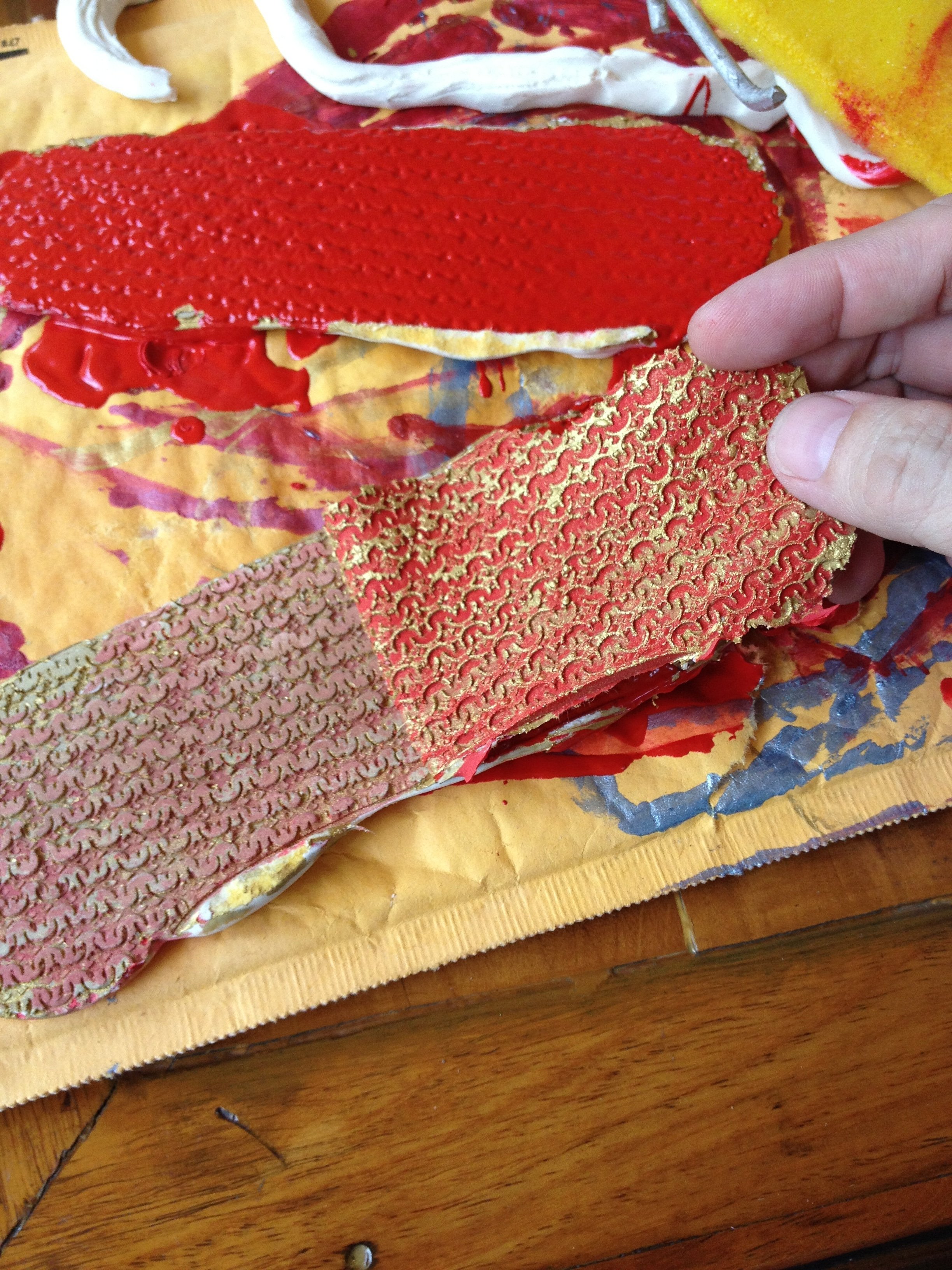

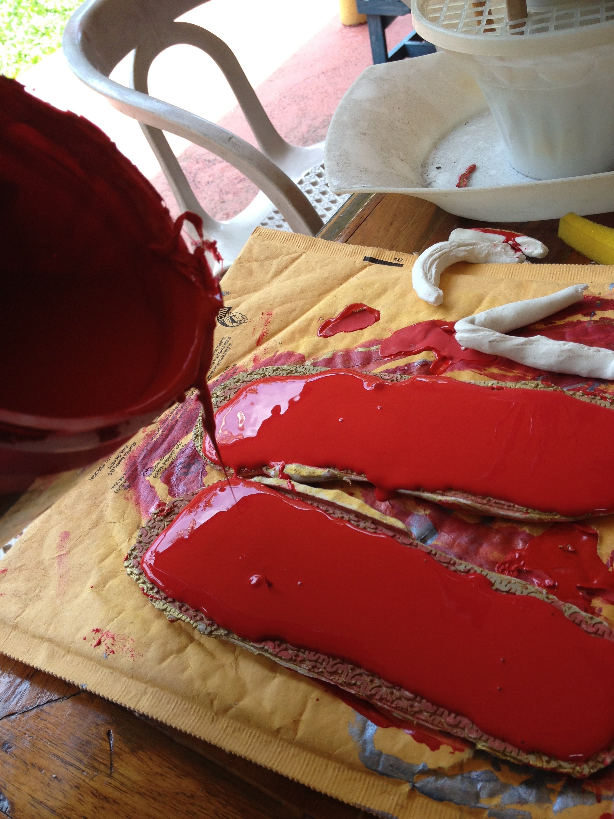

Next pour some plaster of paris on a portion of it and when it dries, peel it off and you end up with a hard negative mold. Pour some thick Elastomeric paint on it, let dry, then perhaps another layer. For some strange reason, my local brand has a red that really pours really thick.image.jpg

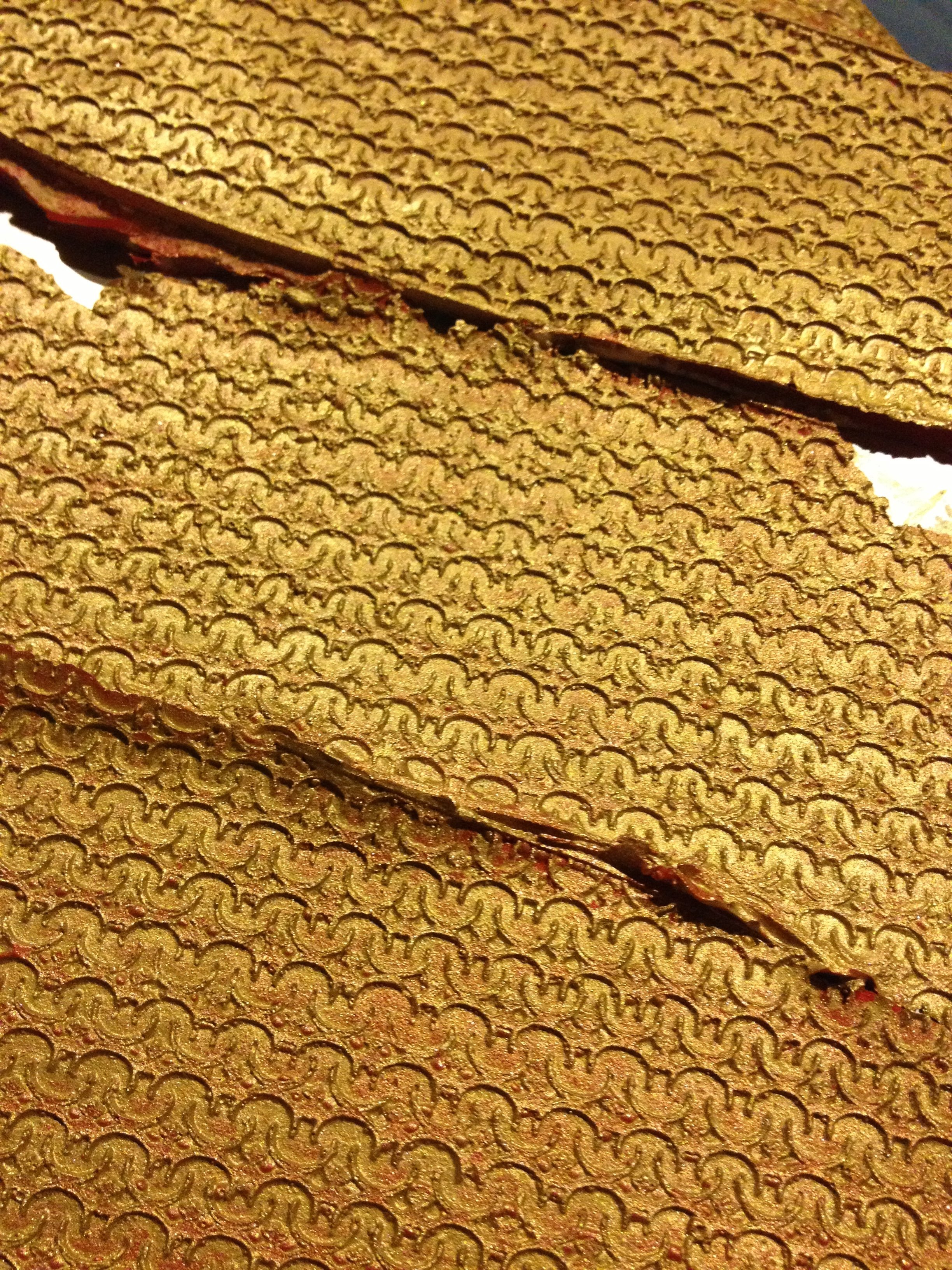

Peel off film and repeat process several times until you get several skins of texture. I made a mistake of pouring gold paint on the plaster mold. Looking back, it would have been perfectly fine to pour plain paint on the mold and paint it with acrylic gold paint later.image.jpg

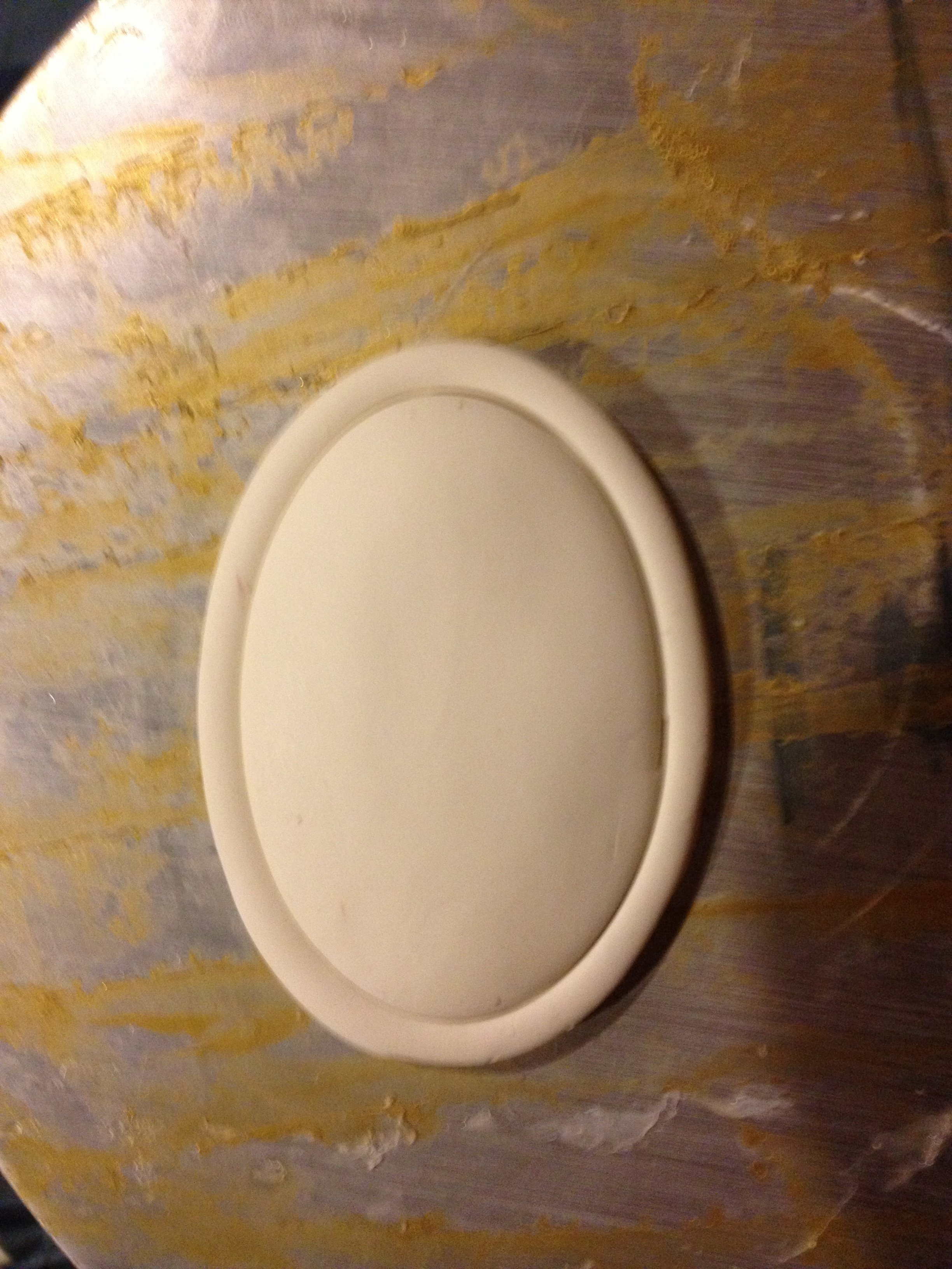

Mold the buckle using Sculpey and bake to set. Sand it down with sandpaper.image.jpg
