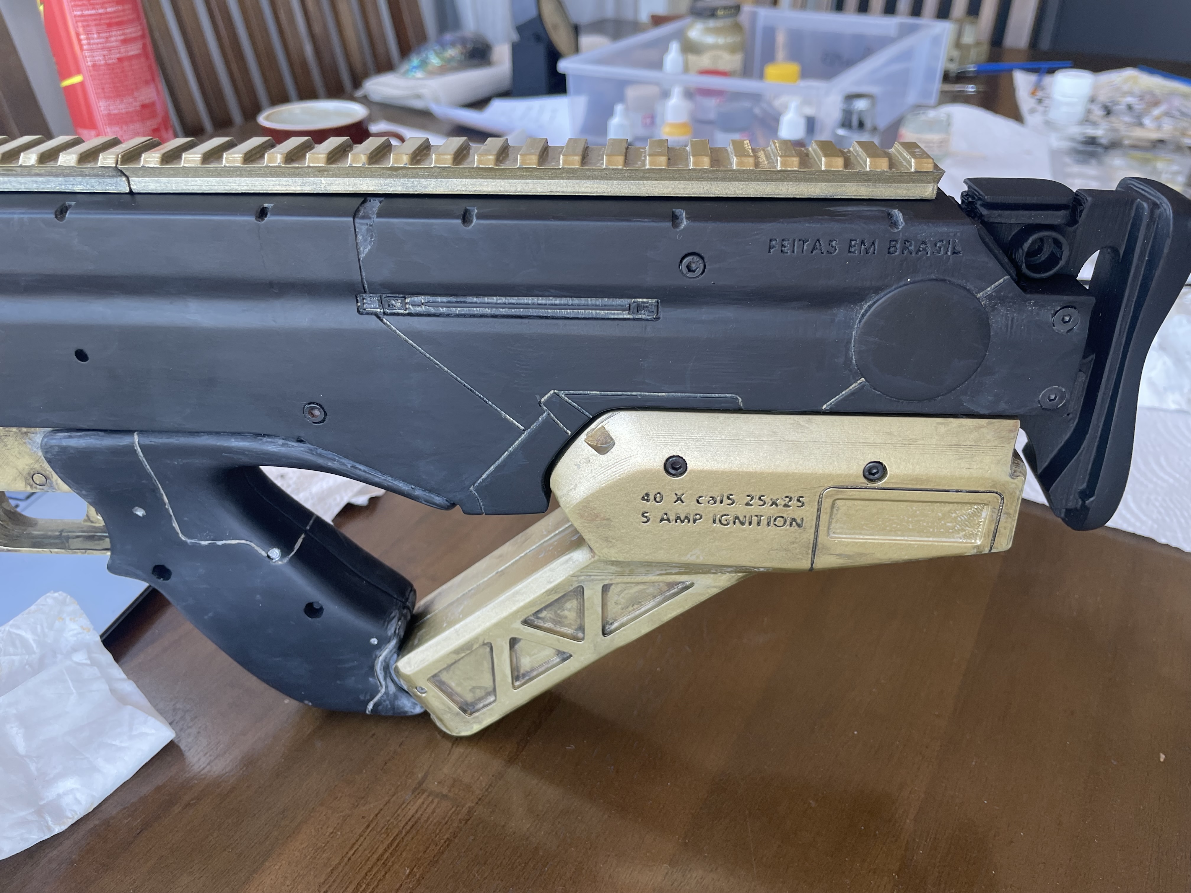

Starting weathering. Some of it I like. Some not. Think I got the sight done quite ok. Not happy with gun body yet (trying to get light sand look)

So making some progress. I’ve done a number of tan washes (very diluted) over the body then I’ve washed over those with black to tone them down. You can see in the pics that I need to black wash the right side some more:
The other pics show… just more, different angles
The side badges are attached, and I’ve better filled in the silver dots on the handle (cut a toothpick in half and used the end to dab)
