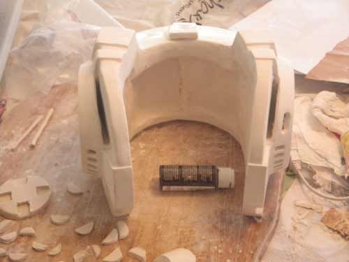

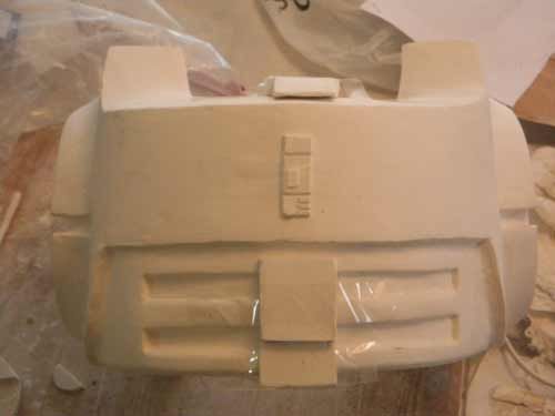

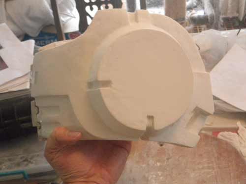

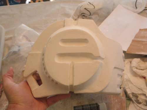

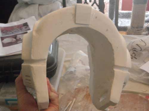

If it helps any here are some pictures of the helmet. Note that there are a few pieces taped onto the back and top which I only put on for the picture to show off to my fellow Rebel Legioners. These pieces wont be molded into the actual copies (how ever I make the copies) but instead will be made as separate pieces from resin and glued on later.
