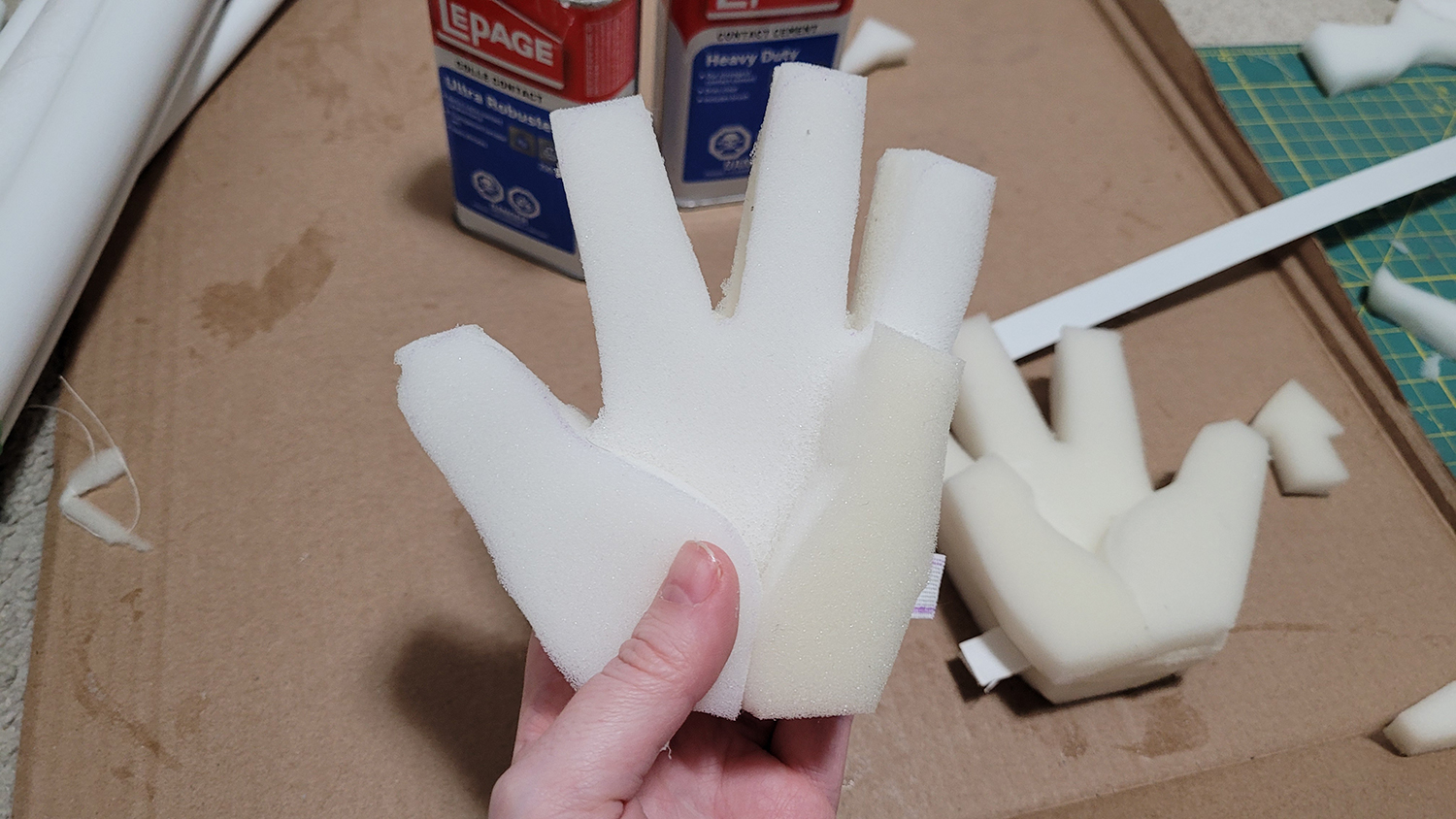

Piggy's hands I made by stacking a few layers of 1 inch foam together, then cutting it down to shape (Cutting the fingers thinner than I needed since the fleece will add bulk). Inbetween the two main layers of foam is a little cotton pocket for the arm rod, and wire twisted to shape so the fingers are poseable. I wish I had made the wire a bit longer on each of the fingers, my final hands come up a little short there. The wire of the thumb is pulled through a hole in the thumb, and sandwiched between more foam on the other side of the hand.
I was hoping that I could maybe cheat a bit and use a machine to sew the fleece for the hands... since Piggy will be wearing gloves, this seam doesn't need to be super pretty anyways, right? Well, I think I need more practice sewing stretch materials, because the stitch was very visible once I popped the foam hand in the fleece glove, and hidden or not that annoyed me. So I did spend a good few hours going over the machine stitch by hand. Then I just had to sew the hand to the arm, and the hands were done.

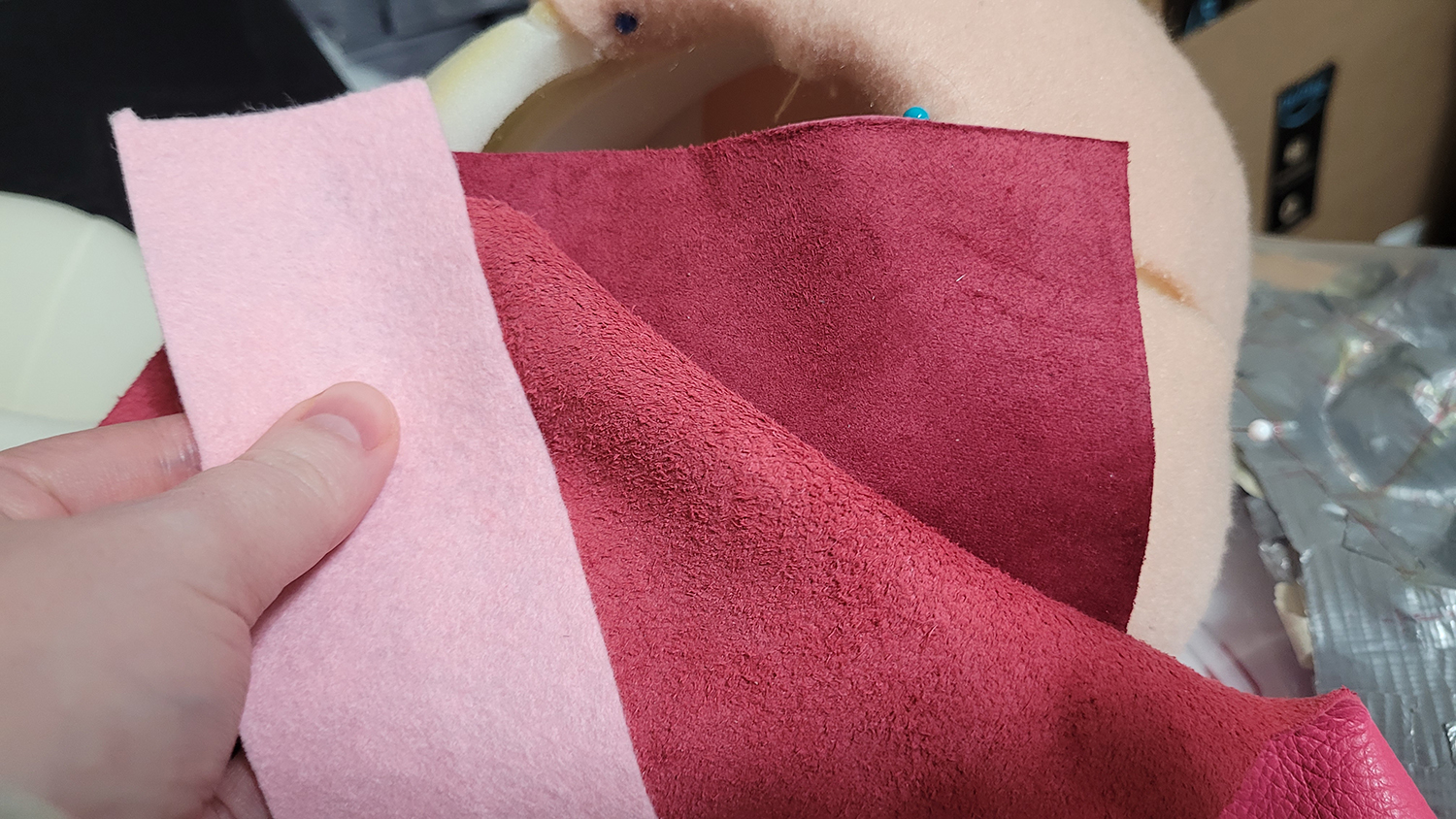

I ordered some different suede hoping it would arrive while I was still on Christmas vacation, but alas the Canadian postal system was still trying to catch up from the recent strike. Though that turned out to be a moot point as the original suede I ordered turned out to be pretty different from the listing photos (way too dark, more purple than maroon). Thankfully the seller was extremely helpful and offered to colour match the suede for me, so I ended up sharing the above pic of Piggy with her and she dug through her stock to give me a few options. I actually don't know if there's an official name for these two swatches of suede she gave me, they are oddly shaped so I assume they were scraps that she had left over.
Left is the felt I'm gonna use for Piggy's tongue, I'm currently leaning towards the slightly lighter suede for the mouth plate? But if anyone has any strong feelings one way or the other, feel free to chip in. I'm hoping to get the mouth plate built this weekend, and then I can hopefully finish fleecing Piggy's head.
