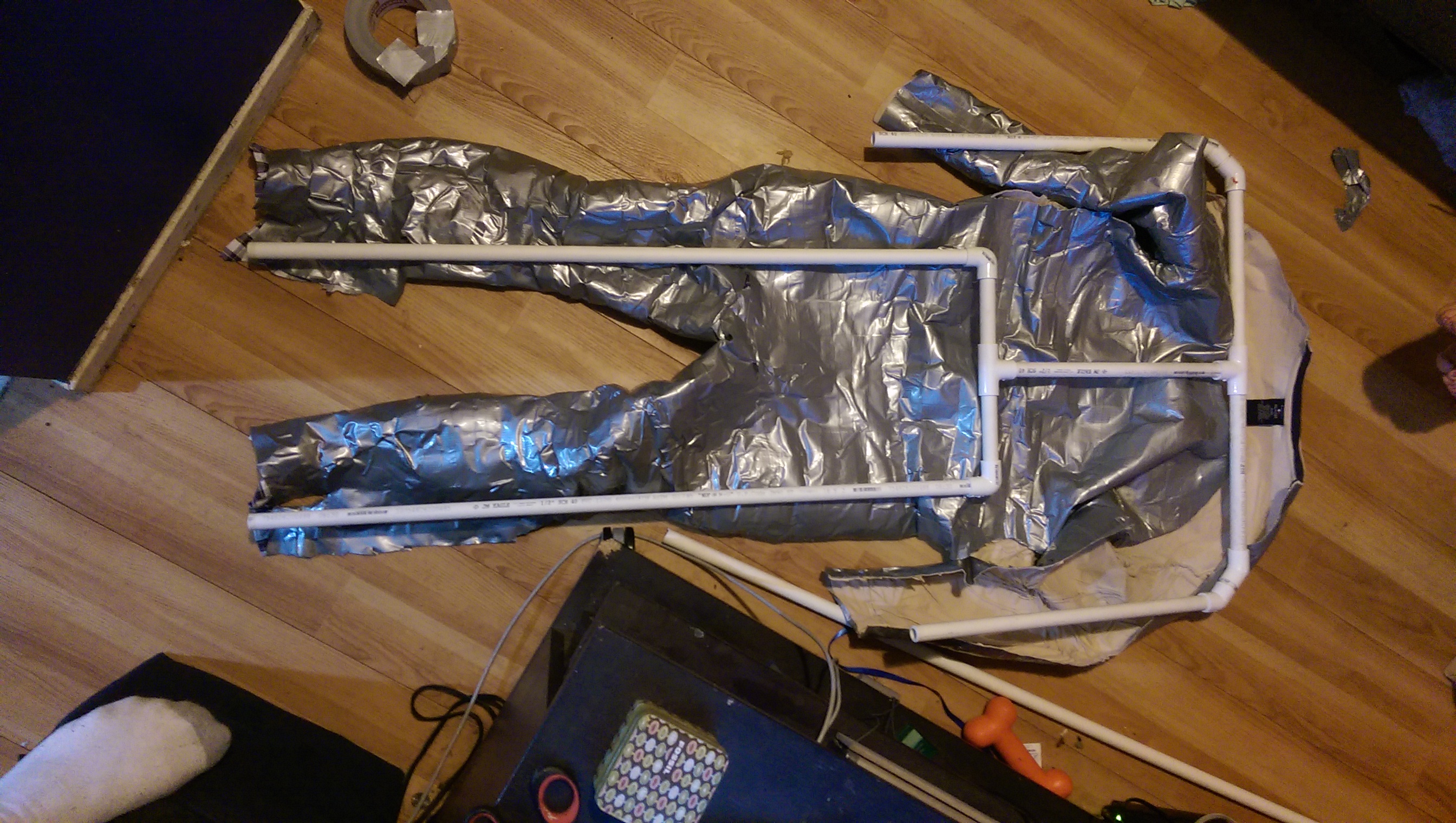

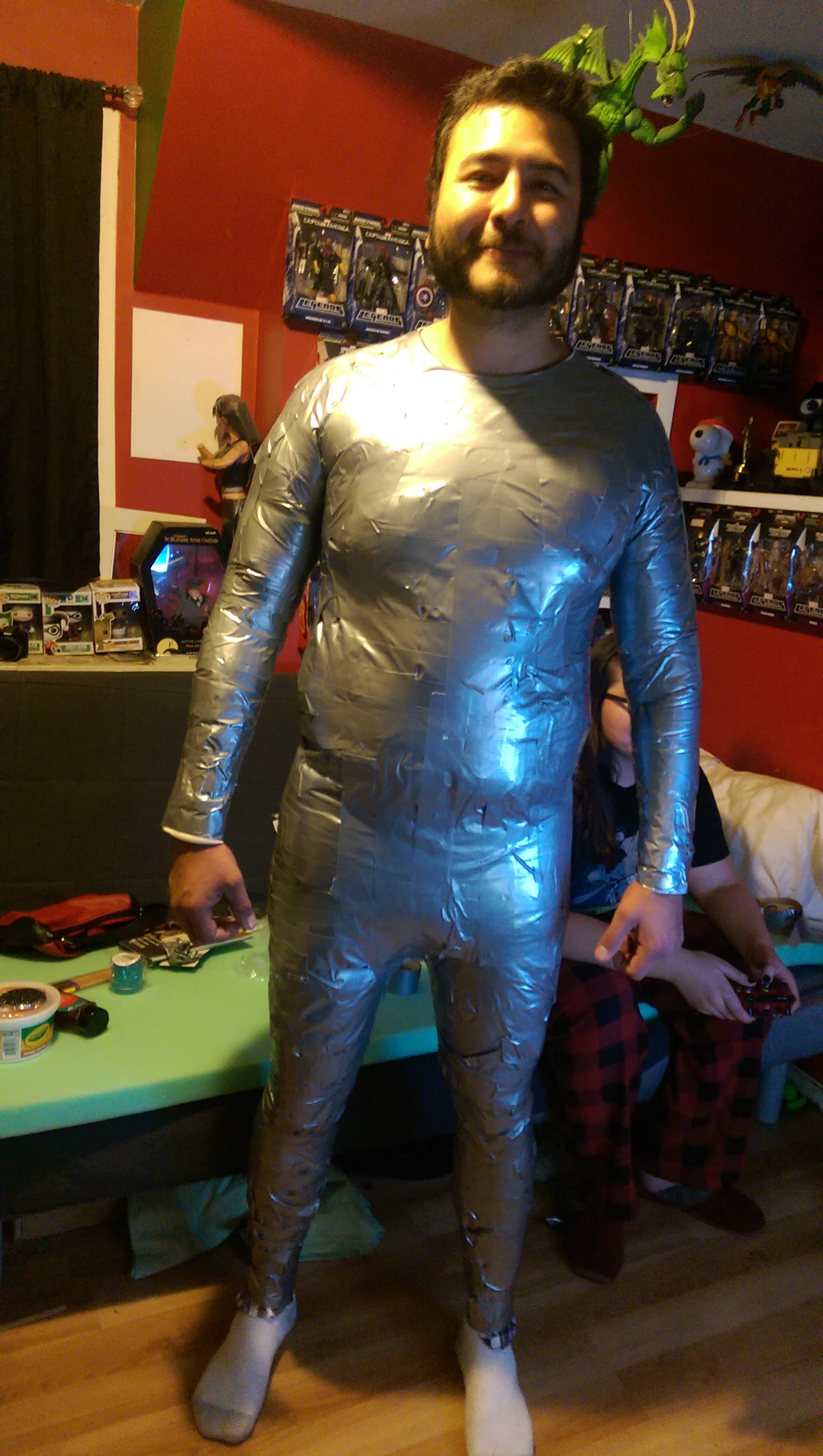

ecmuniz2

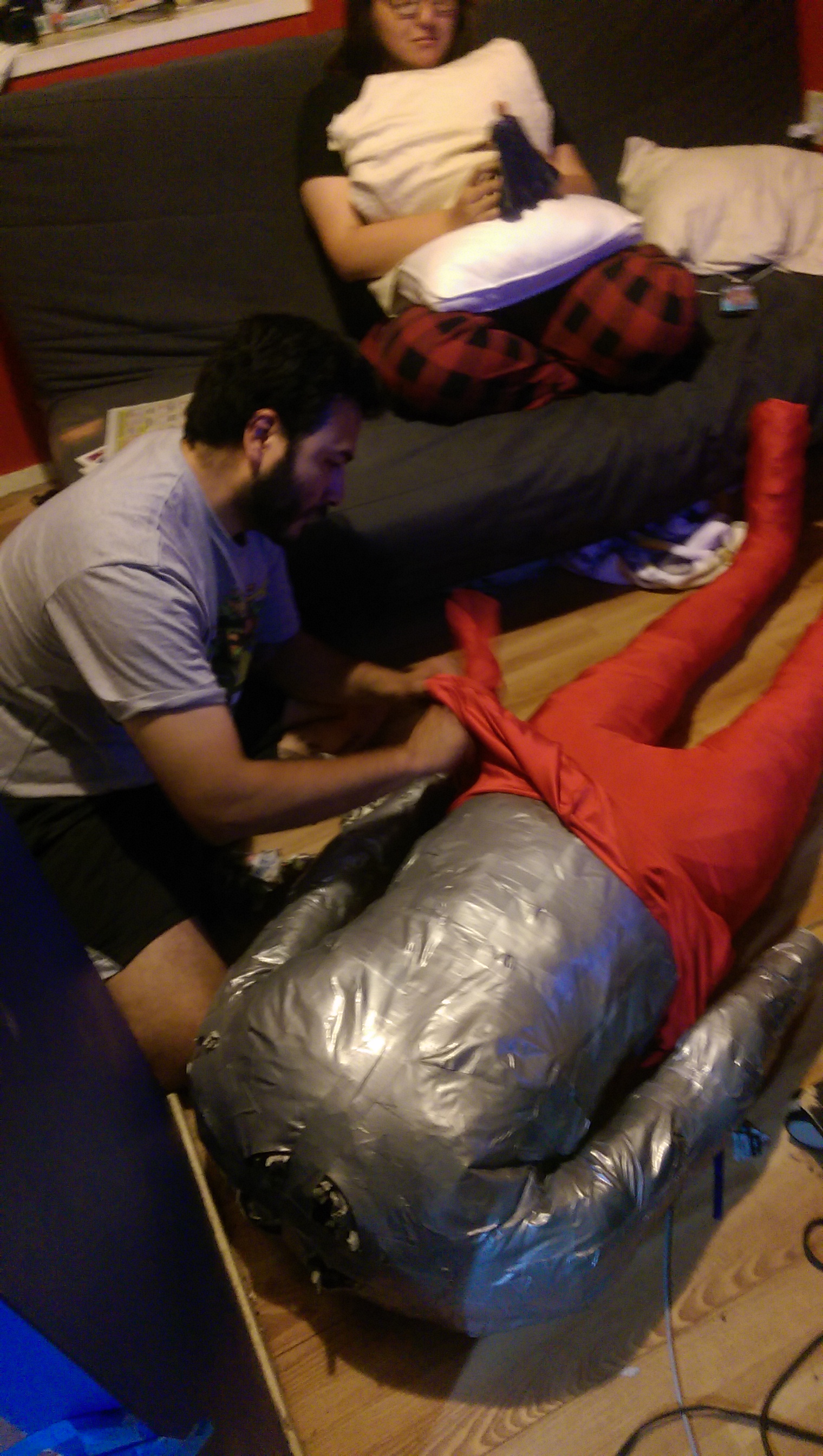

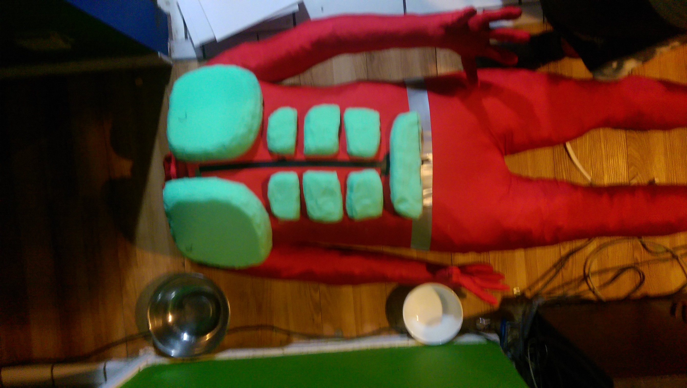

I then stuffed the dummy with newspaper and attached a red morph suite as a base

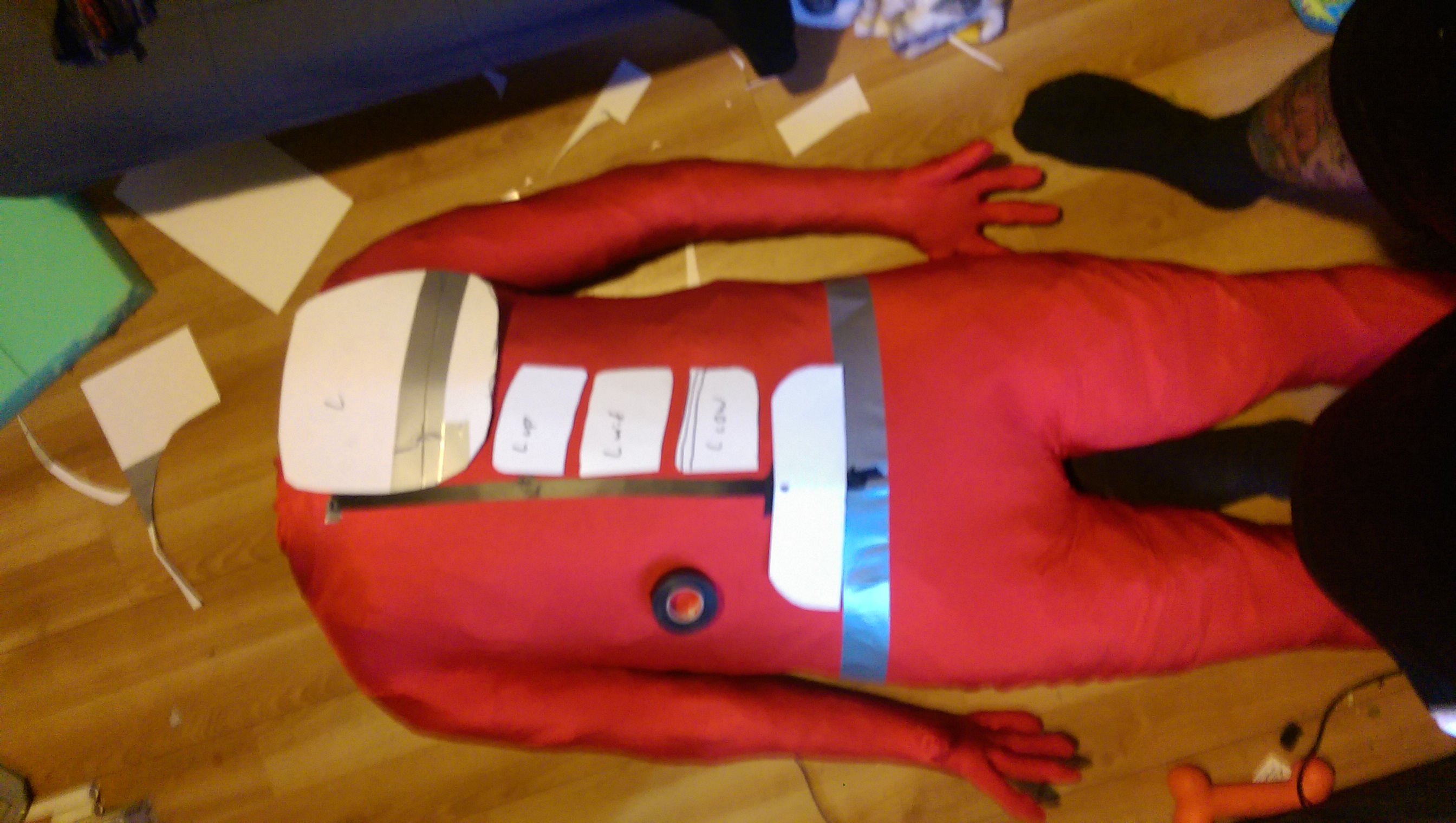

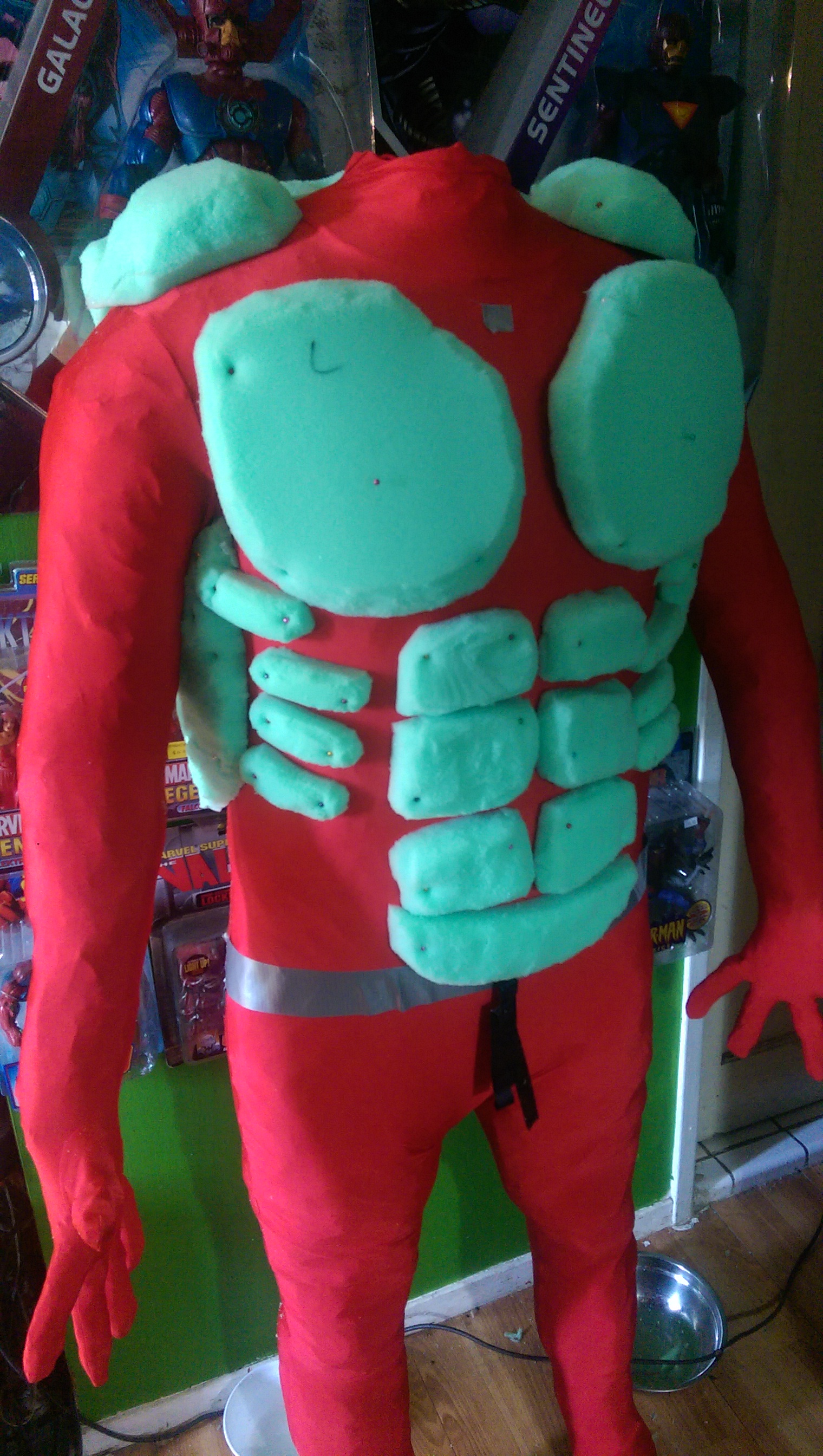

then I started making templates for muscles
ecmuniz2

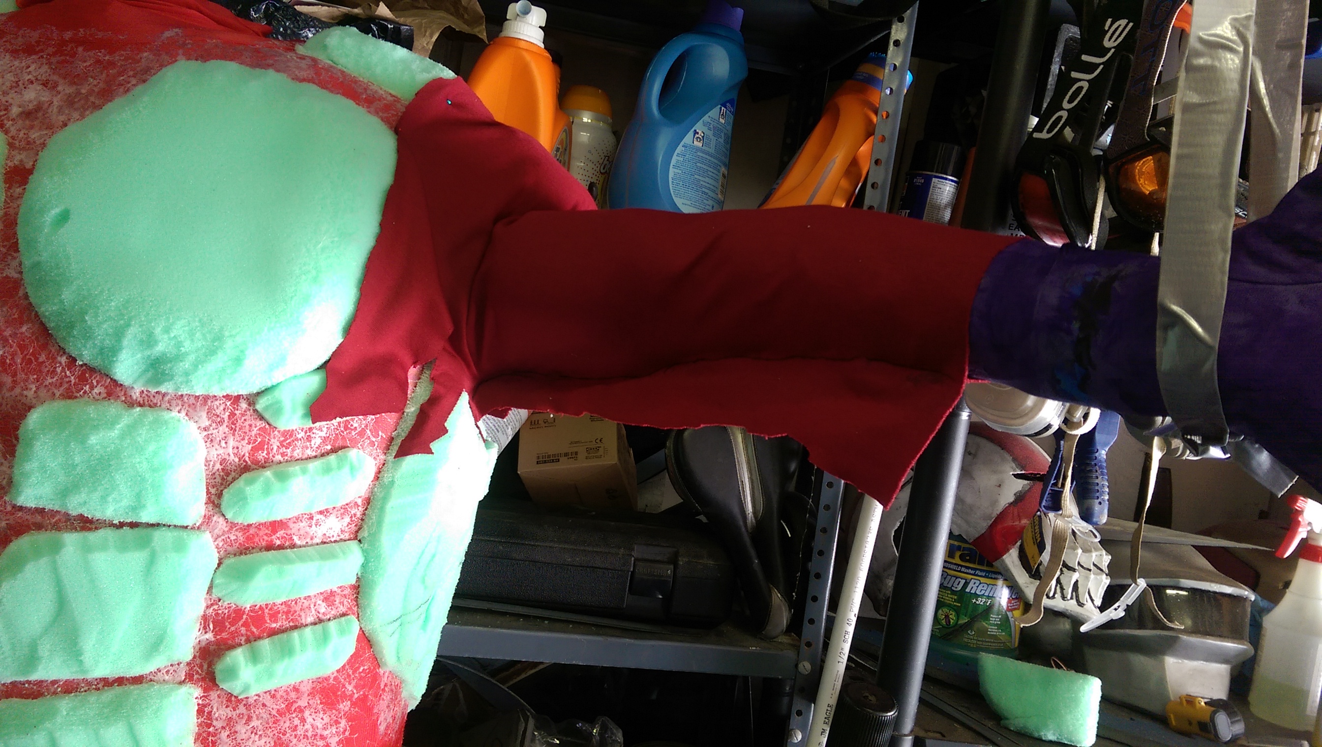

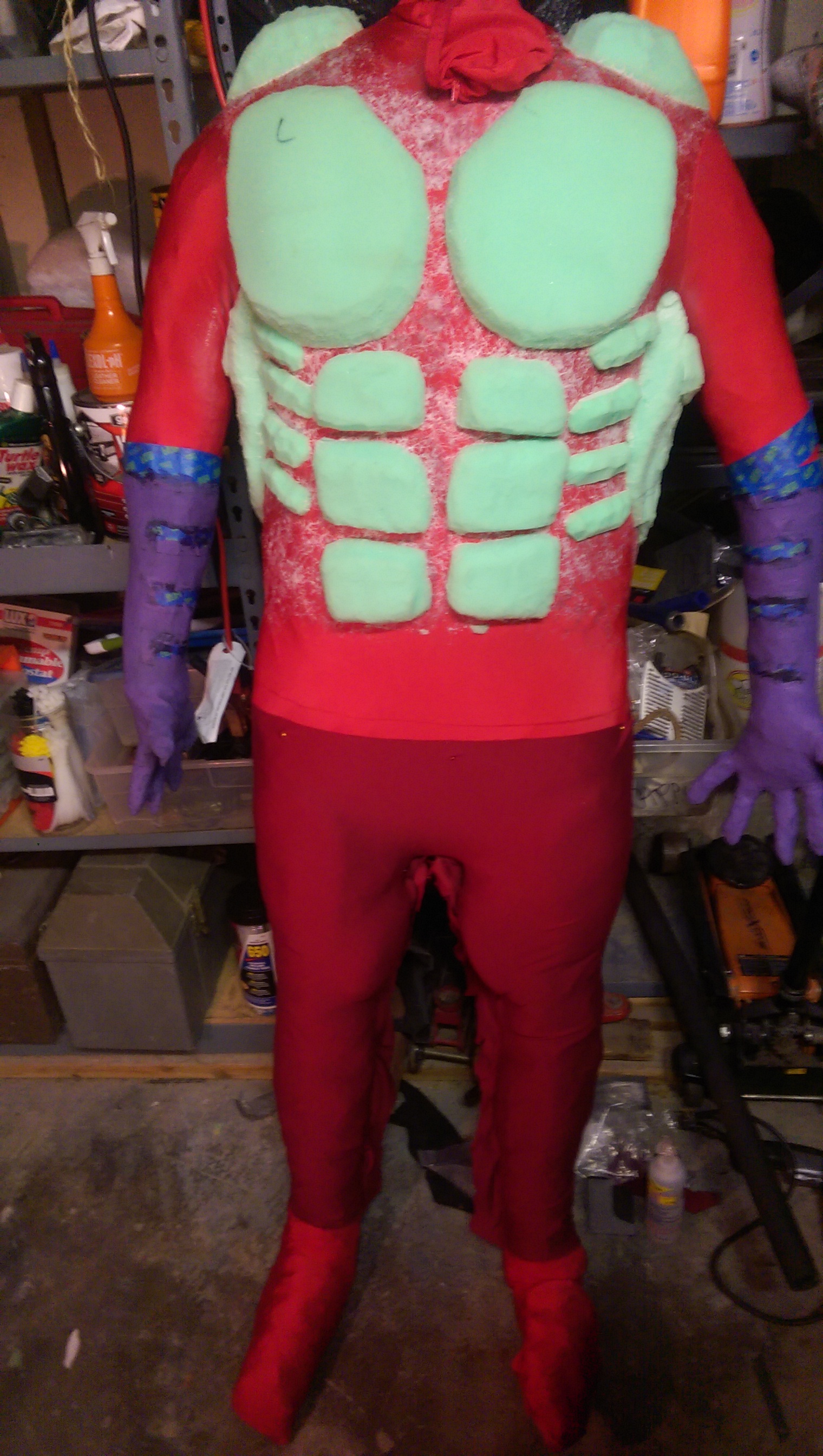

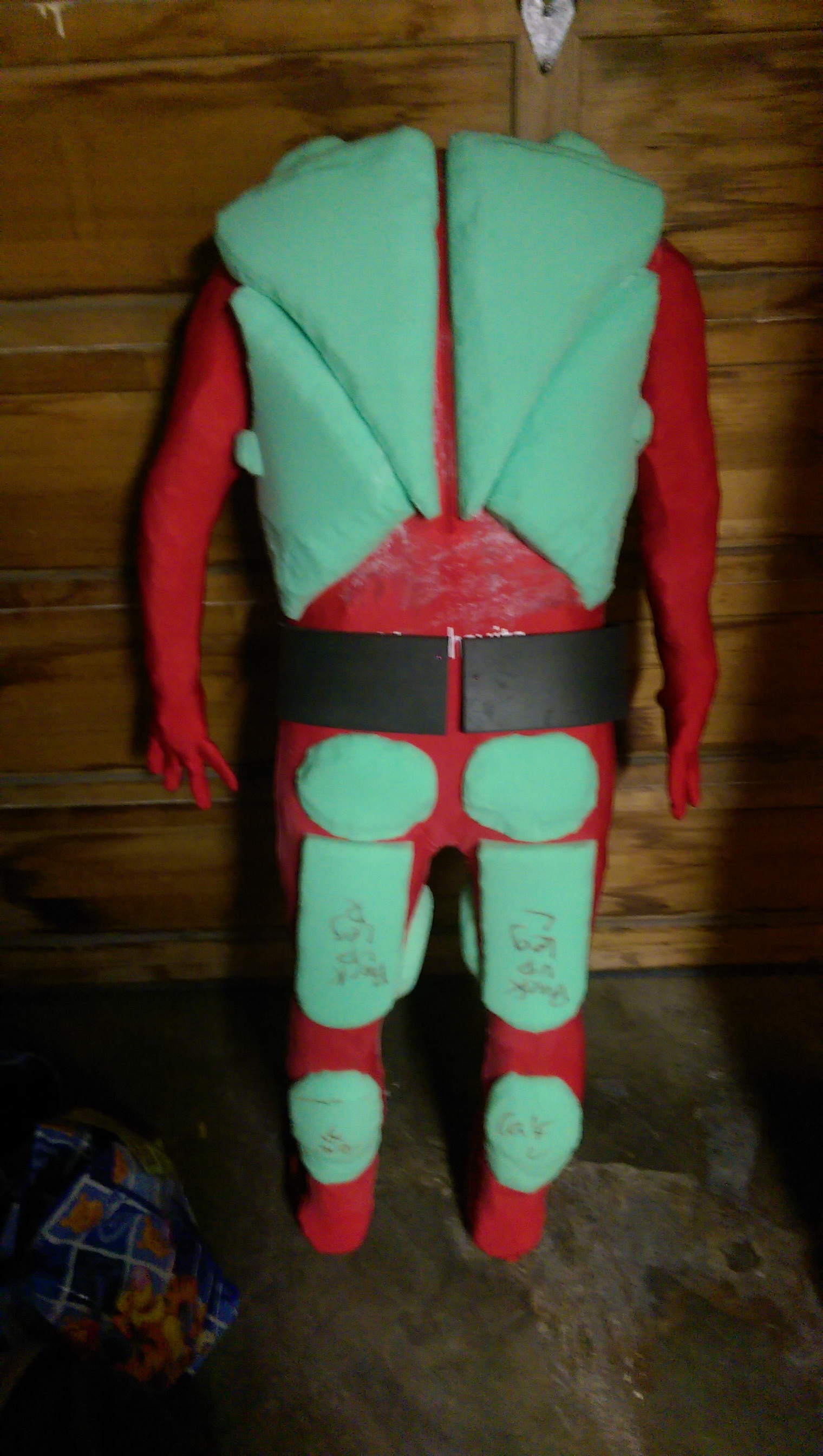

made more muscles and attached with pins at first,then glued on with spray adhesive called super 76, great stuff! IMAG1142.jpg IMAG1142.jpg
here's some of the back and leg muscles, making sure to leave space in the middle of the back to unzip the suite ! the belt was made from good ol' Eva foam IMAG1156.jpg

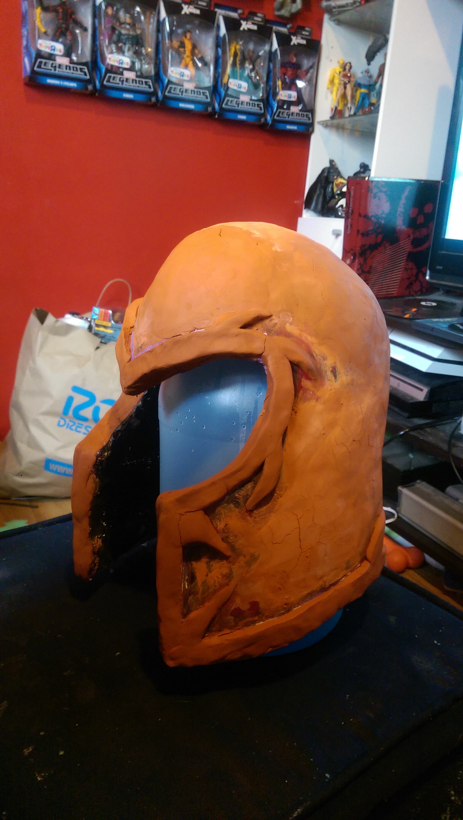

I took a break from the suit to work on the helmet a bit. I sculpt it with air dry clay IMAG1160.jpg

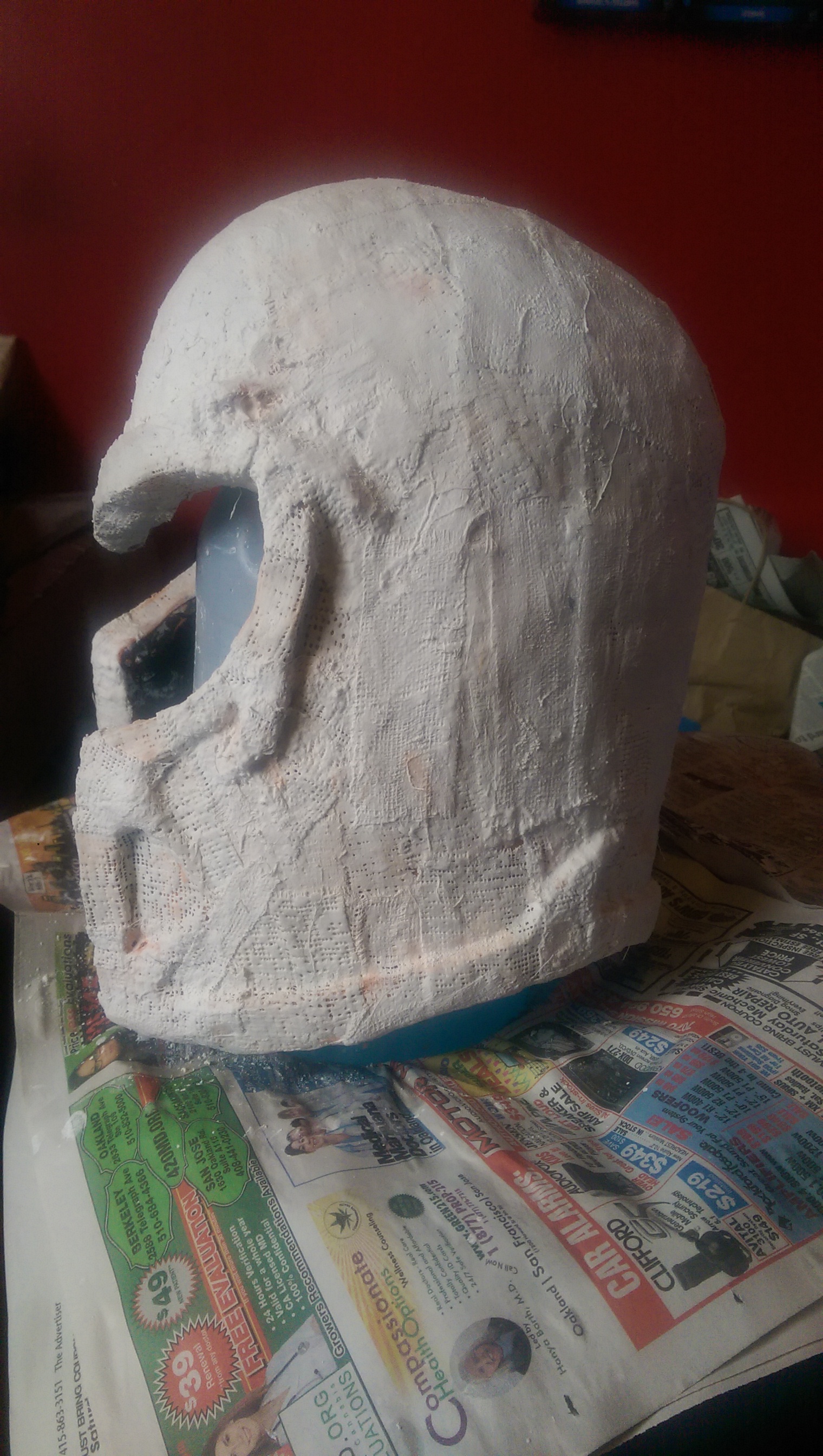

once the clay was dry I covered the clay with Vaseline and wrapped it in plaster cloth. IMAG1167.jpg

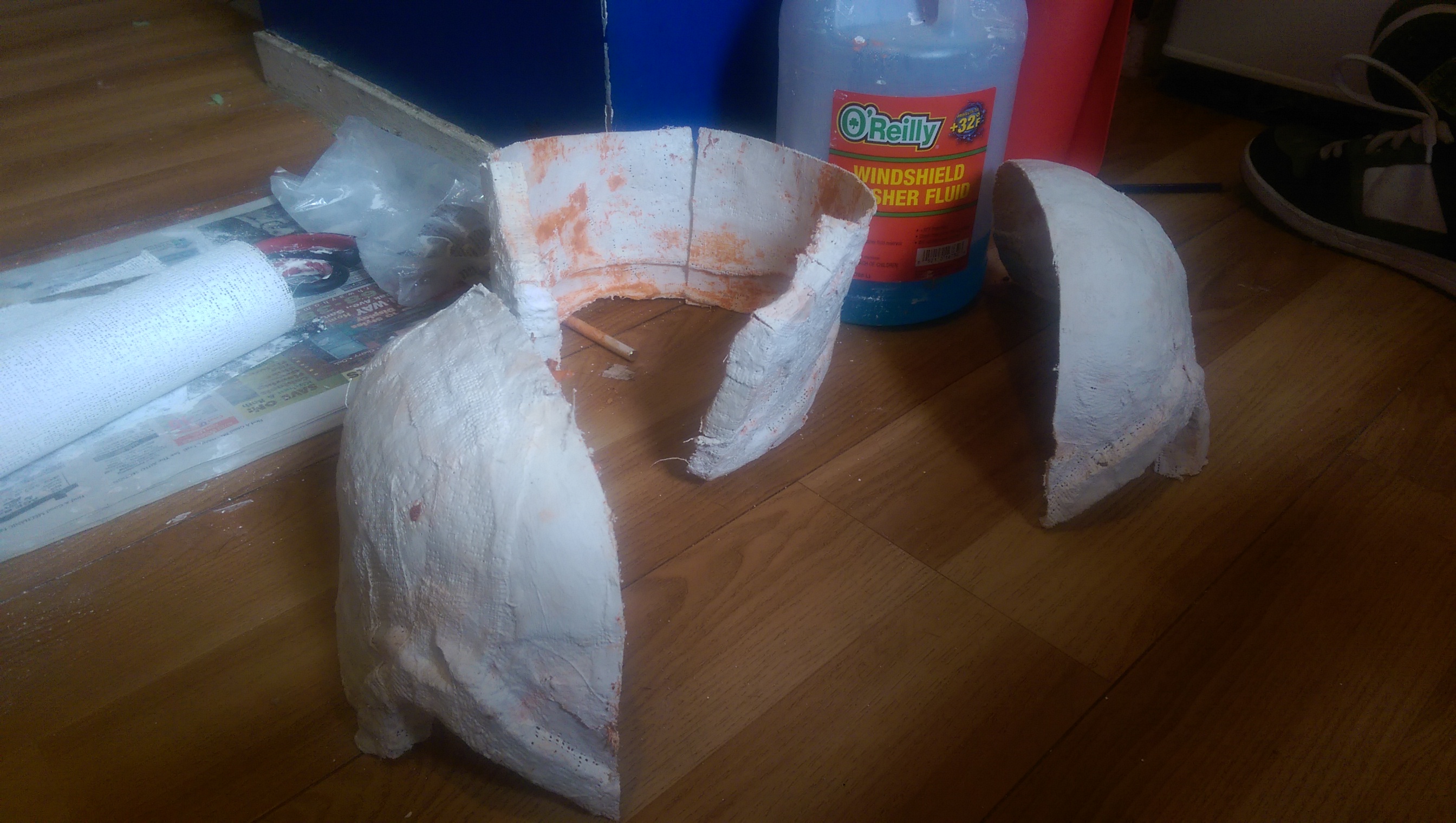

I then cut the player wrap and removed the four pieces, still very fragile at this time! IMAG1168.jpg

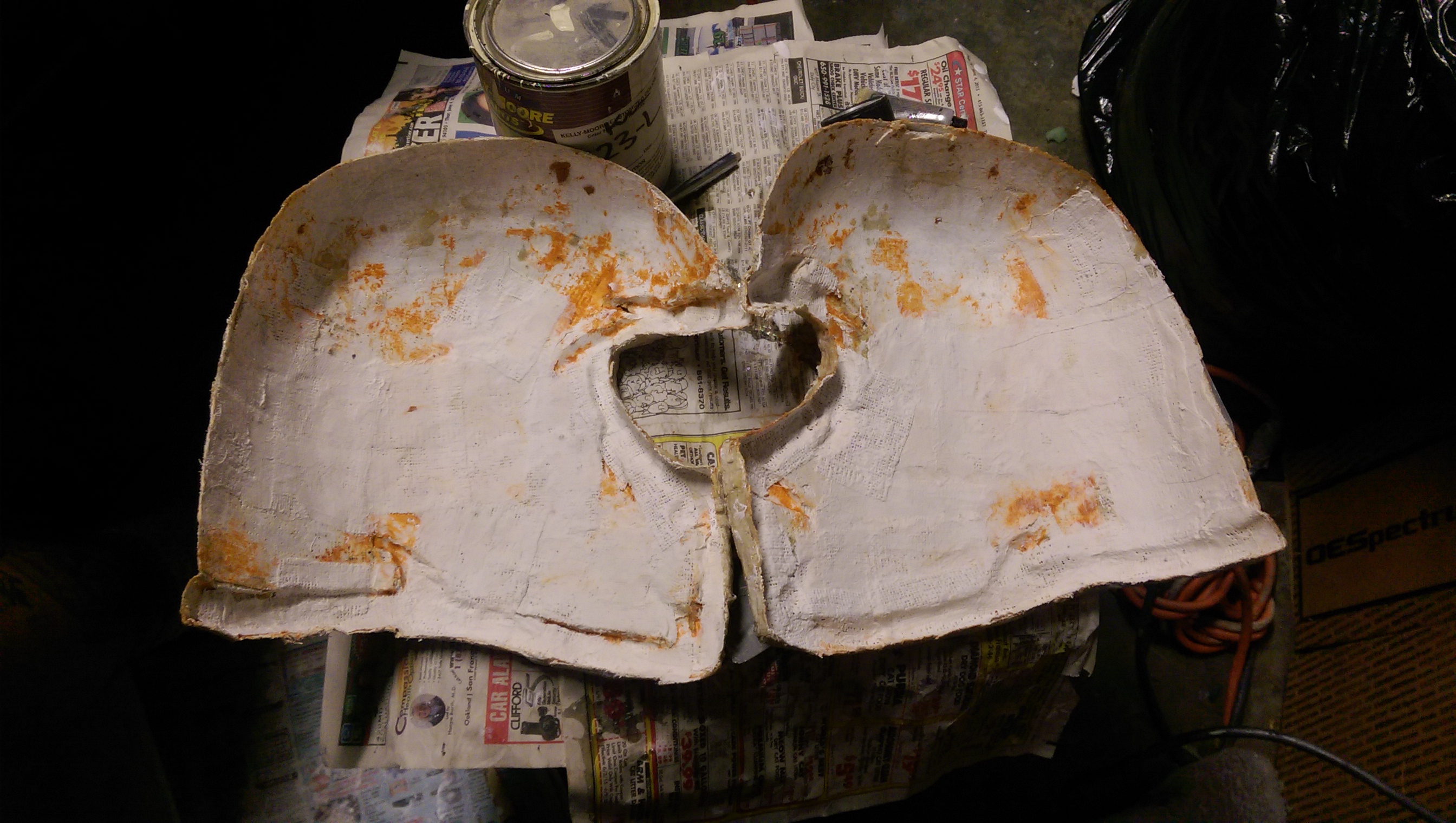

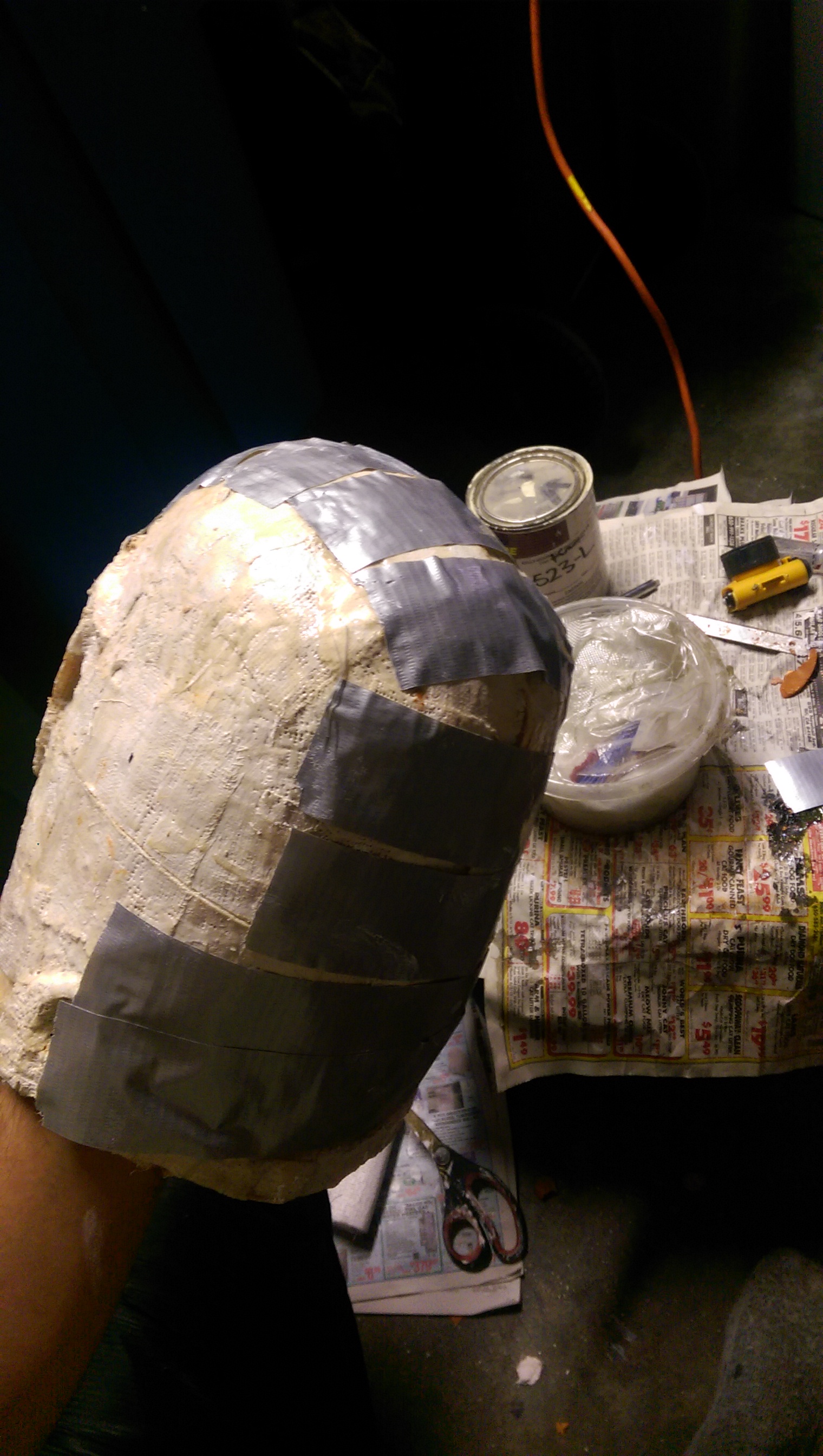

I then used plaster wrap and duct tape to 're in force a bit and put helmet back together IMAG1173.jpg

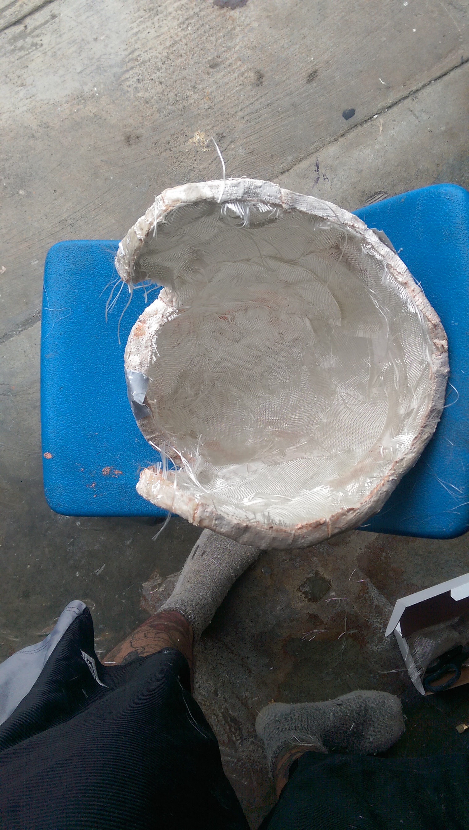

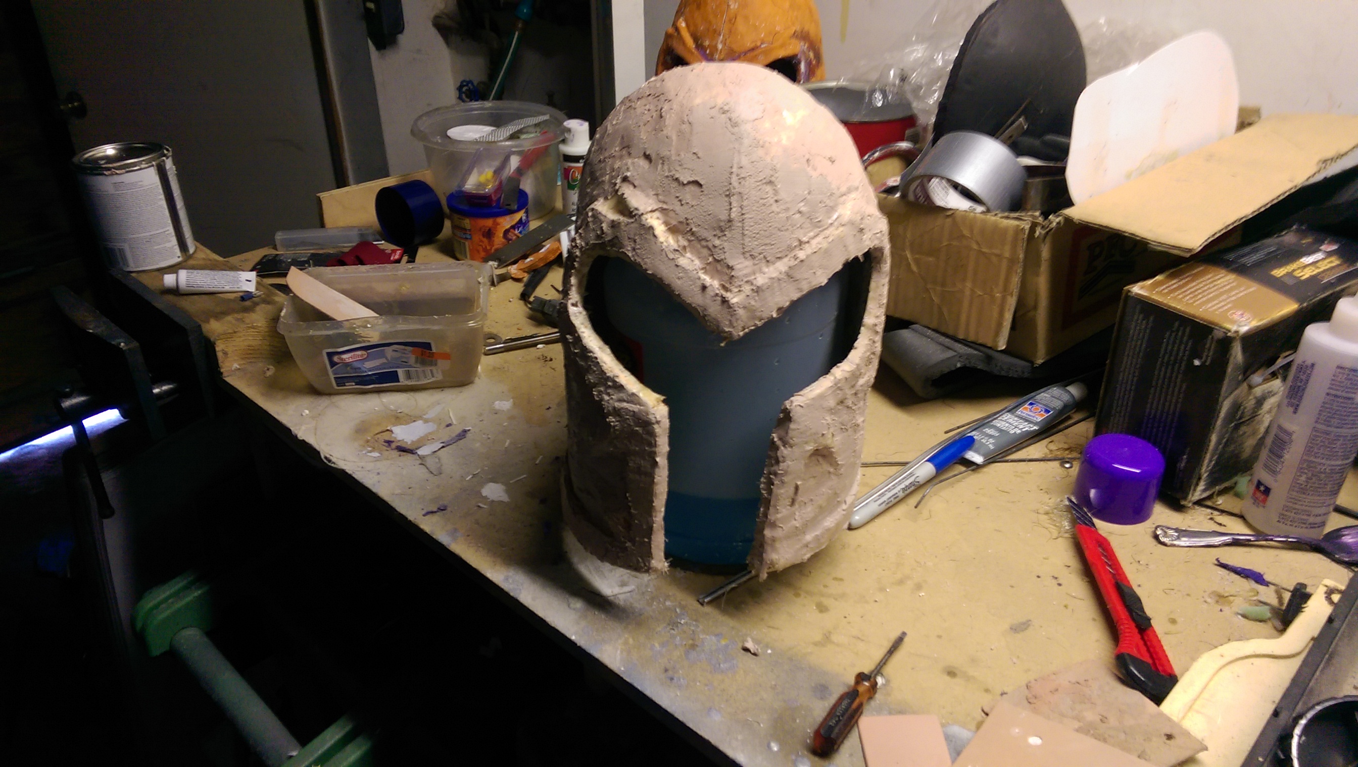

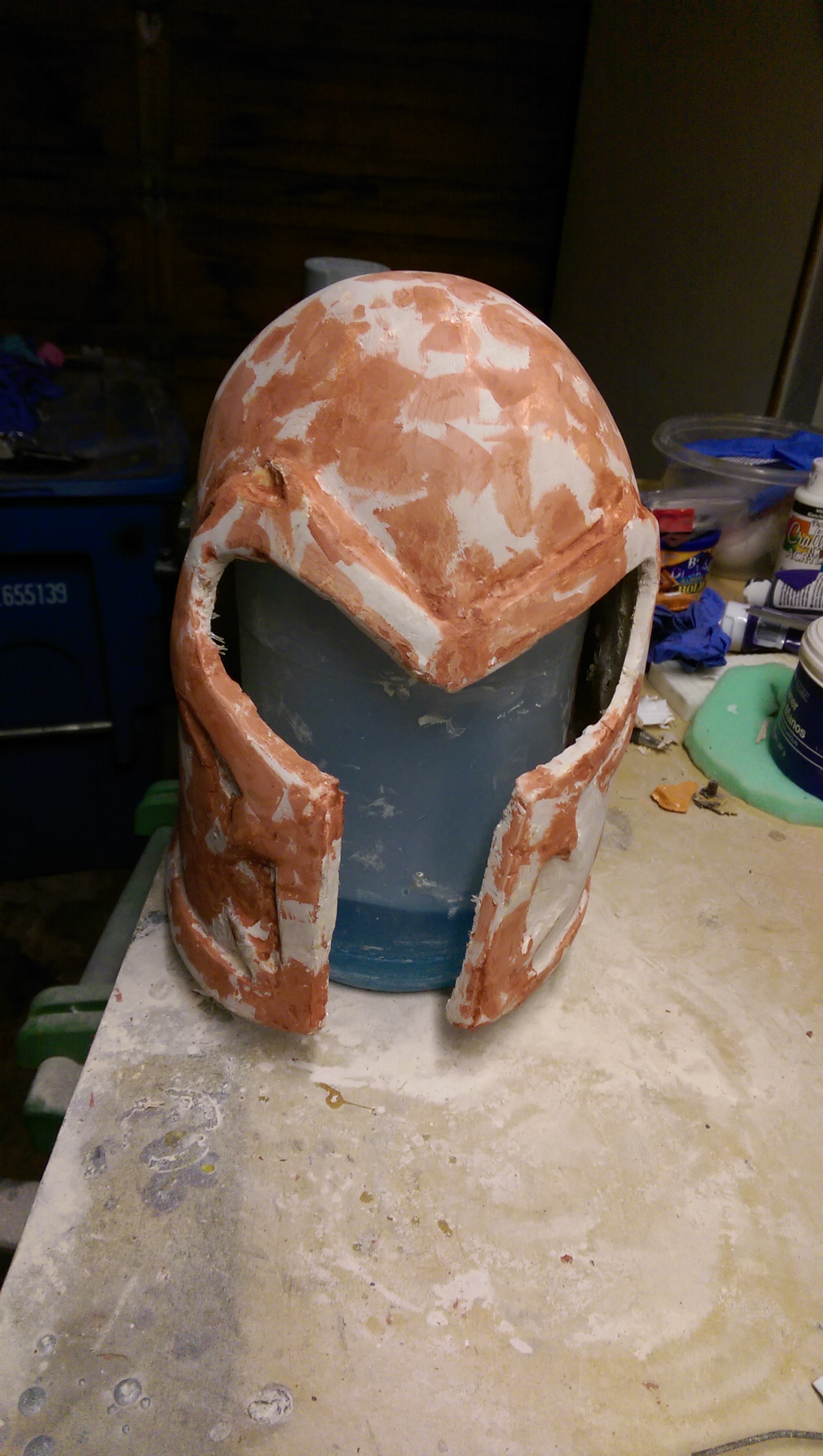

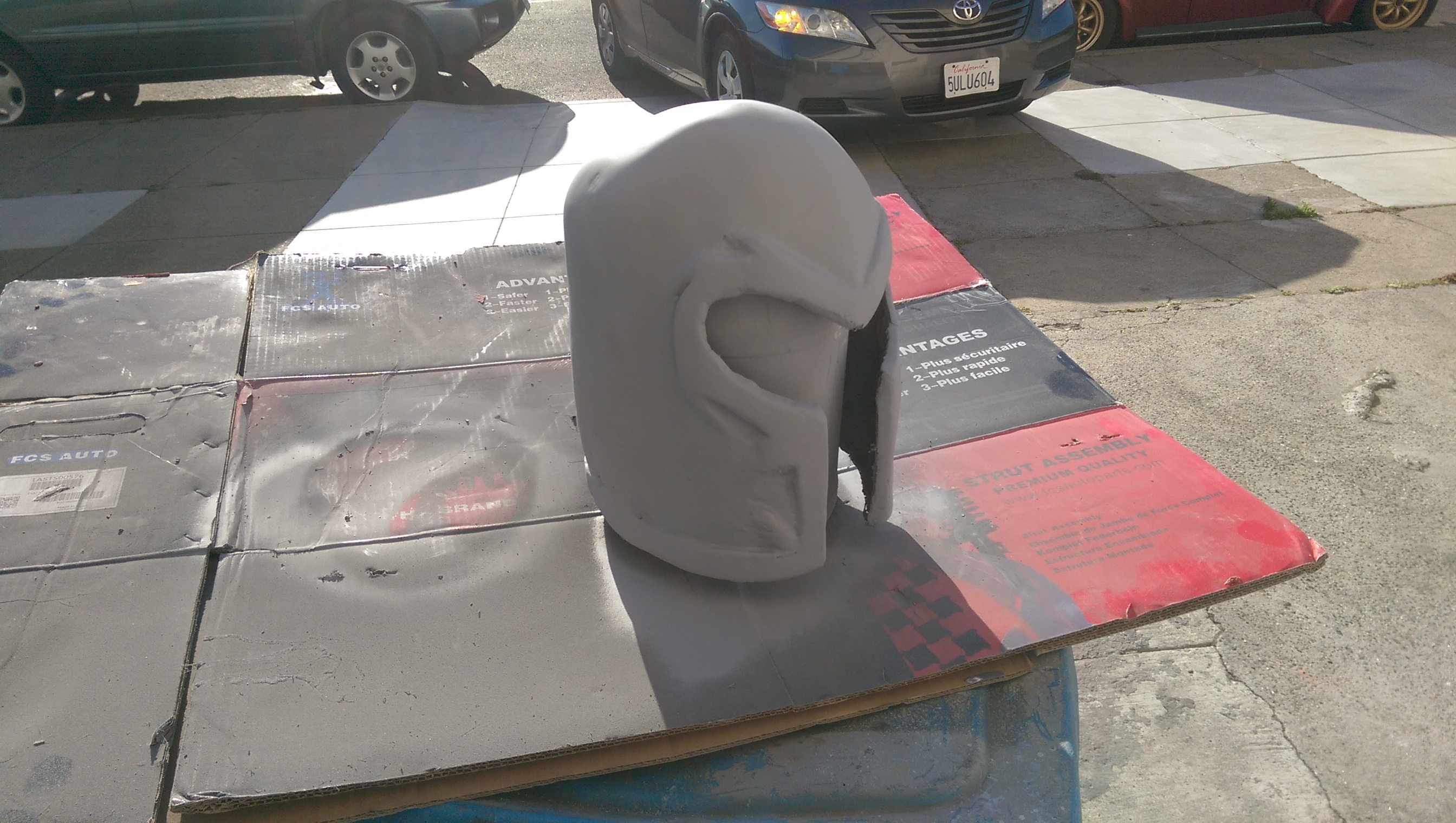

After a bunch of sanding and glazing this is what I had IMAG1243_BURST007.jpg

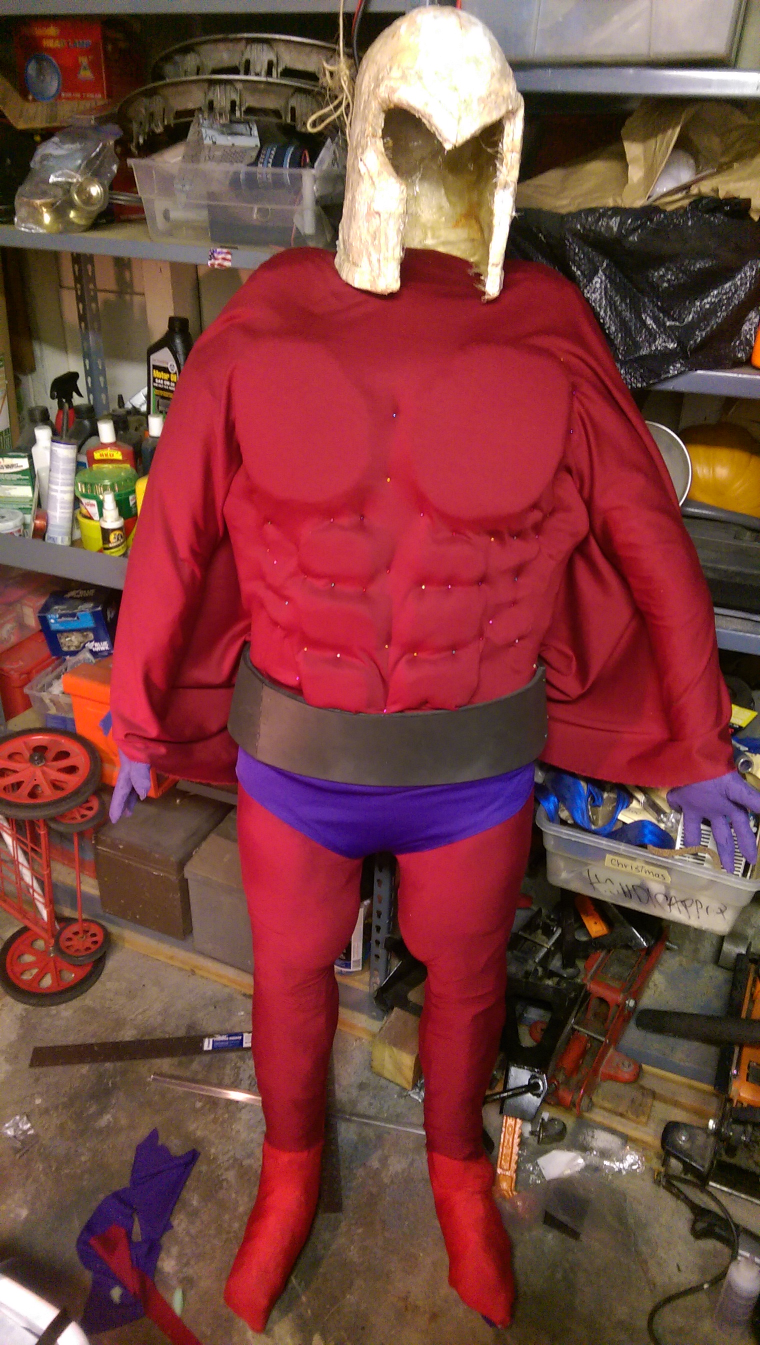

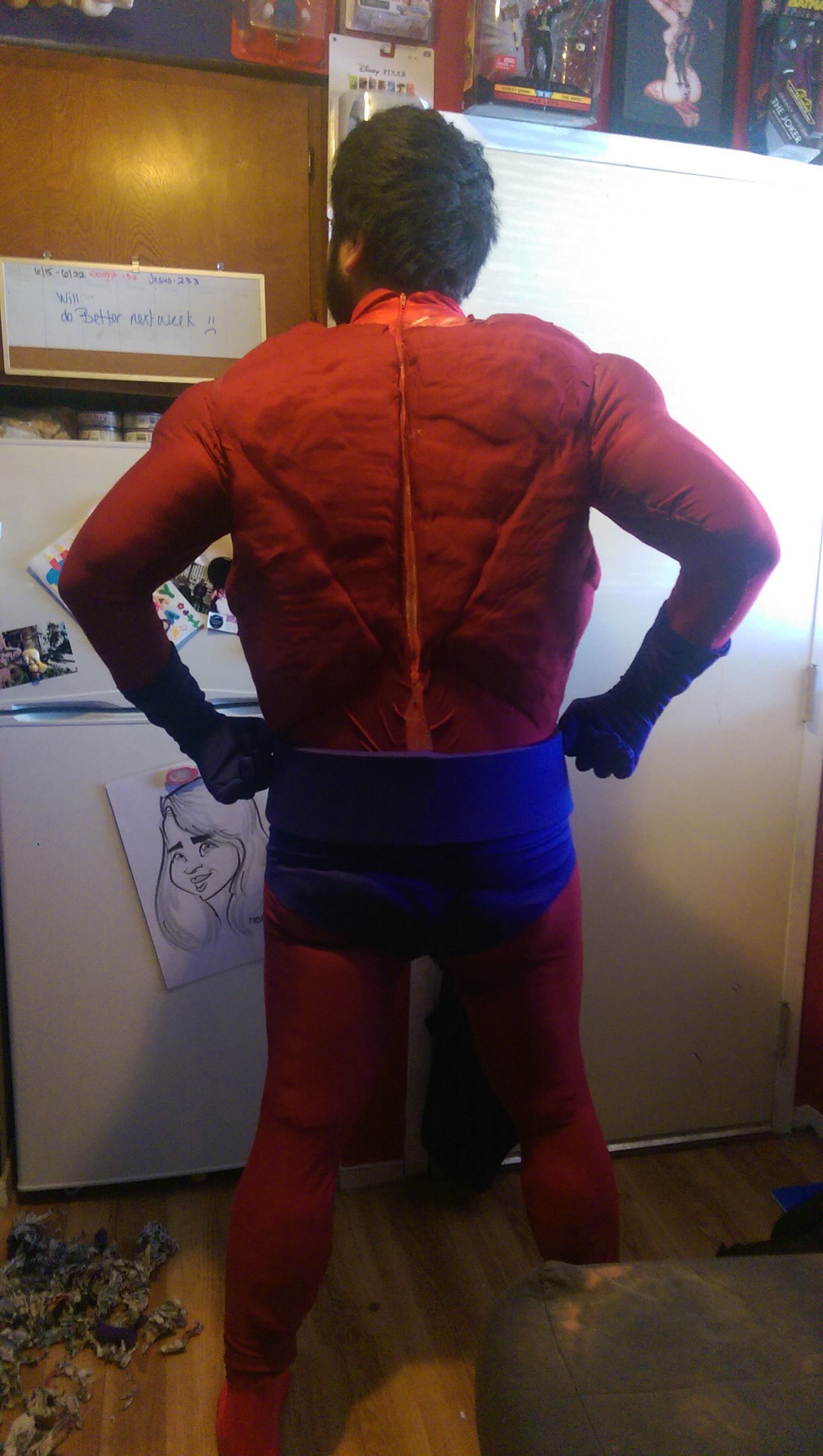

I sowed some underwear and pinned were the shirt was going to get an idea of where to cut the fabric, at this point I decided he was too bulky and shaved off and reshaped some of the muscles IMAG1188.jpg
I then glued the torso and and back material using super 77 adhesive spray, did the same to the belt then used hot glue on the inside of the belt for reinforcing. The cape was just in place for general sizing at this time IMAG1213.jpg

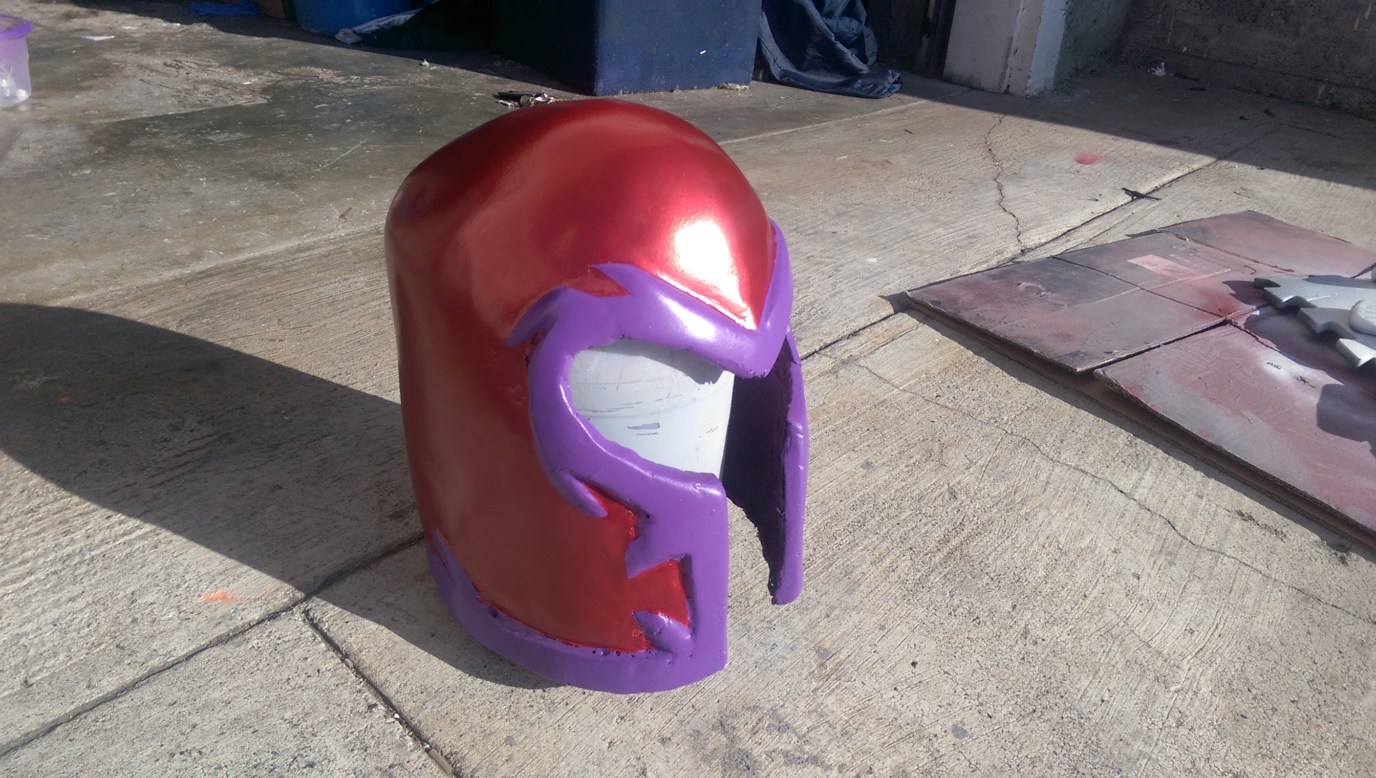

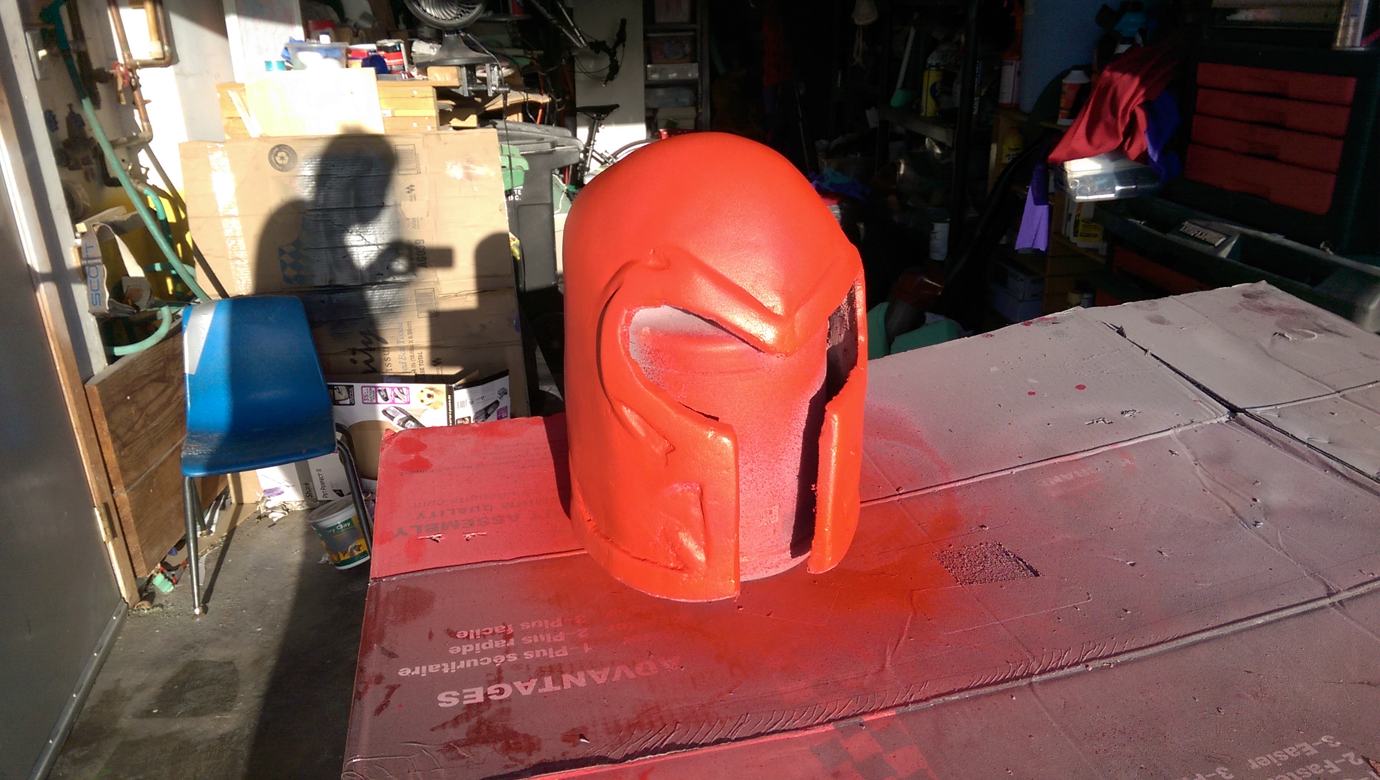

I couldn't wait longer and went ahead and used a red on the helmet IMAG1248.jpg

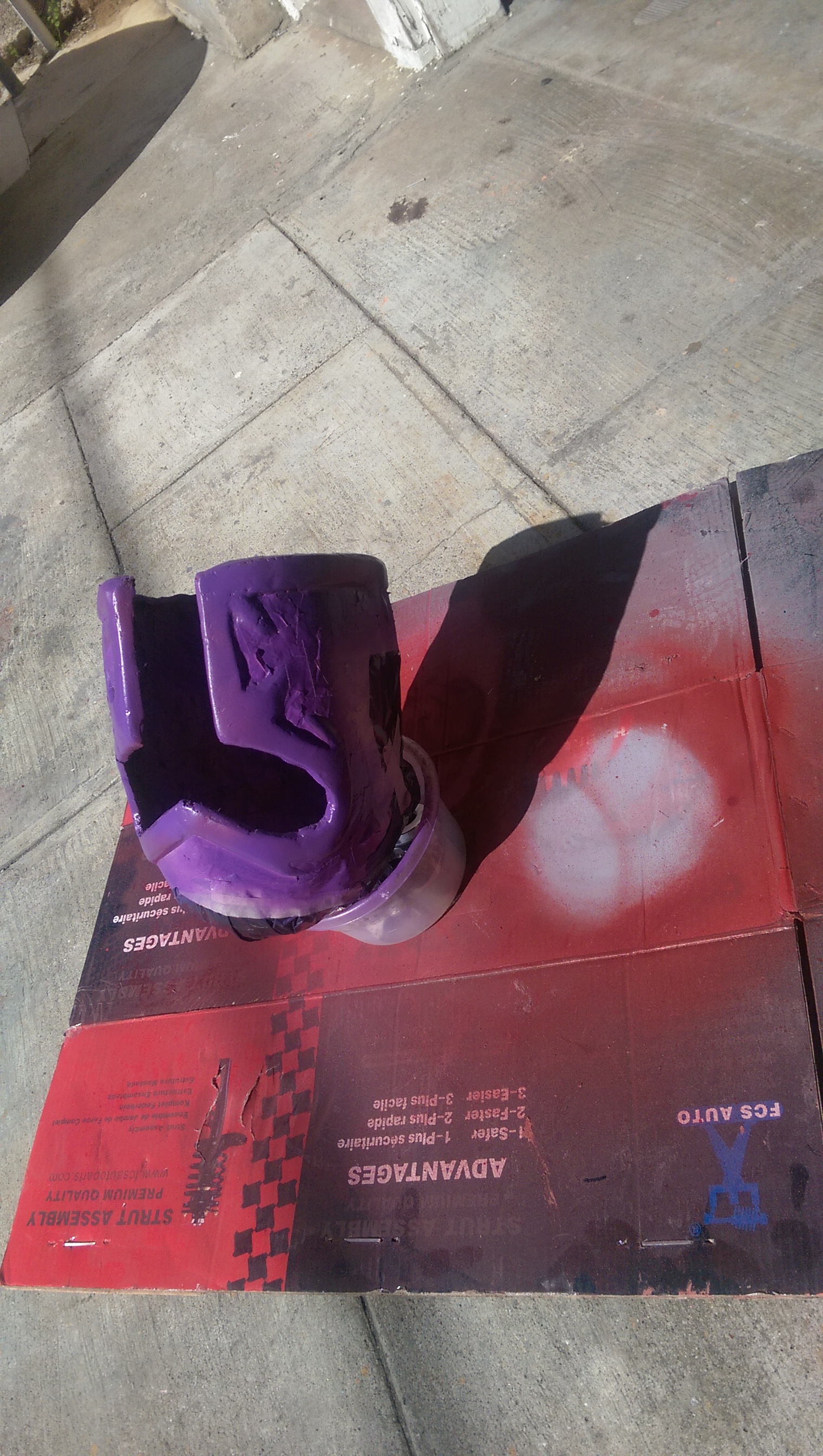

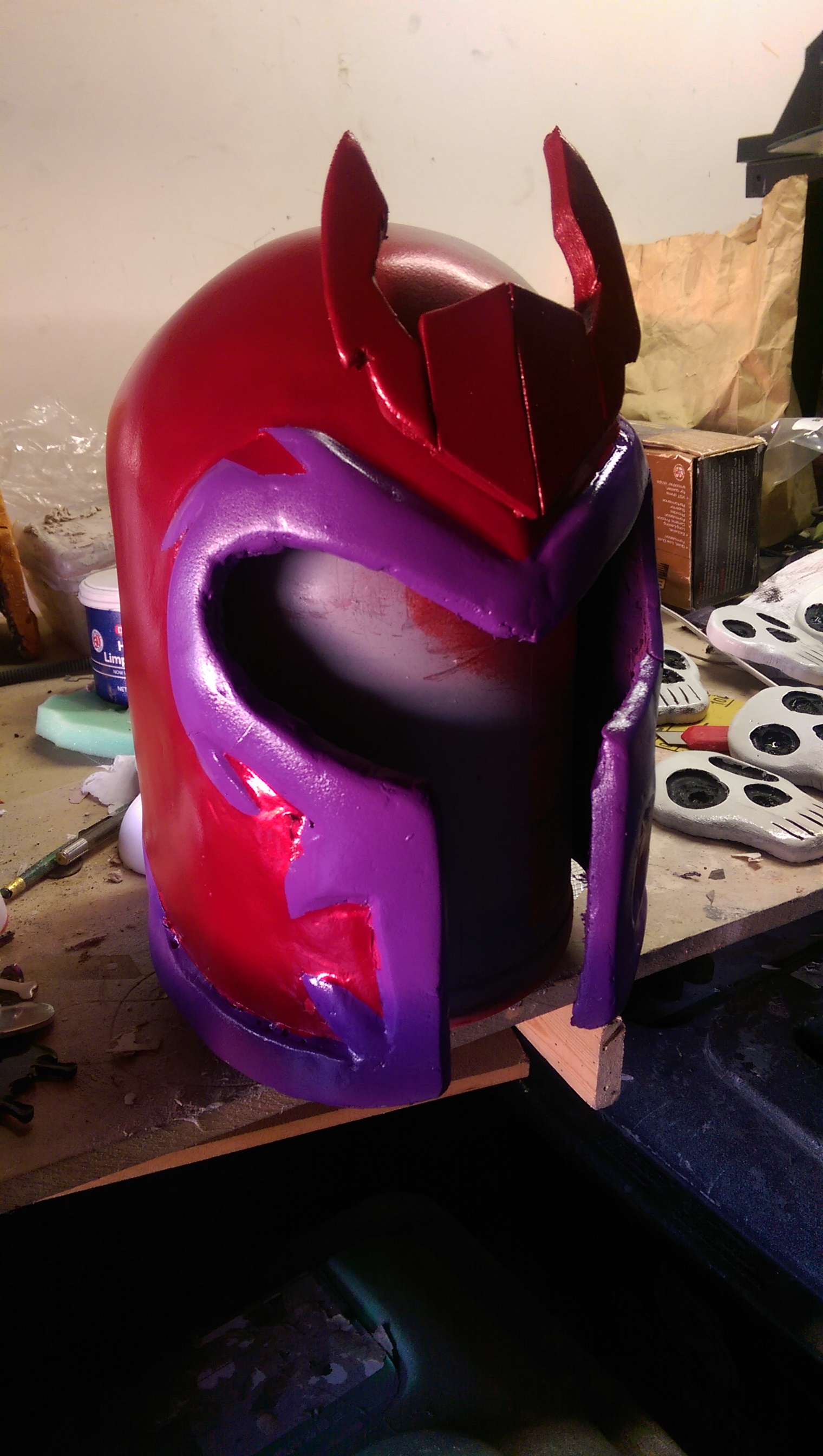

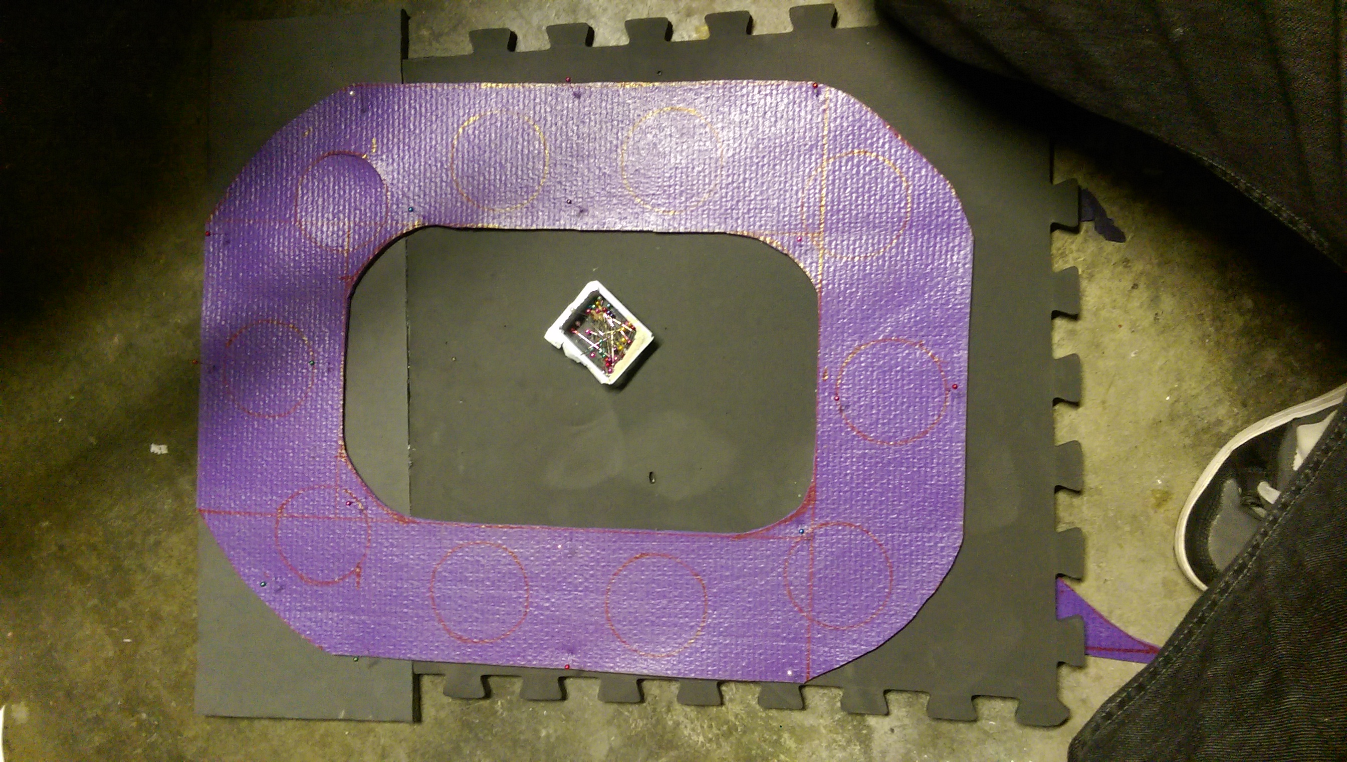

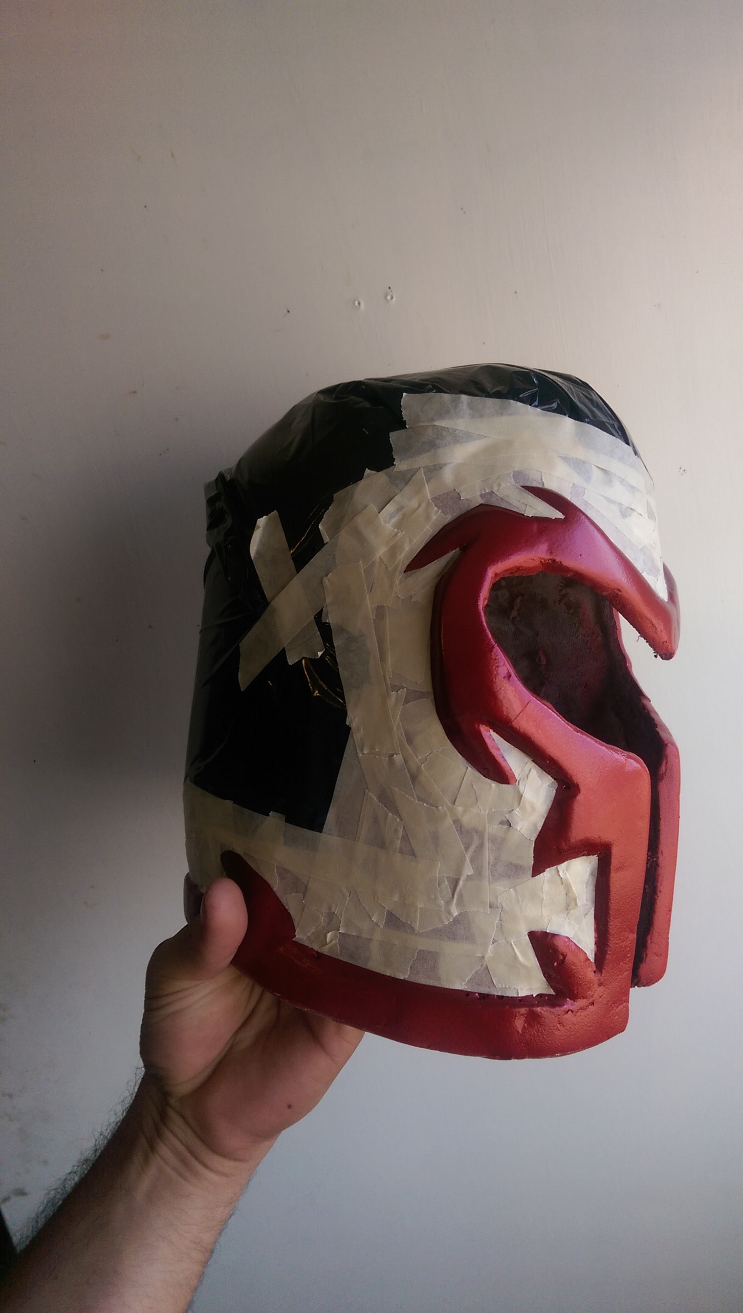

I then masked off the areas I wanted to stay red IMAG1276.jpg 3

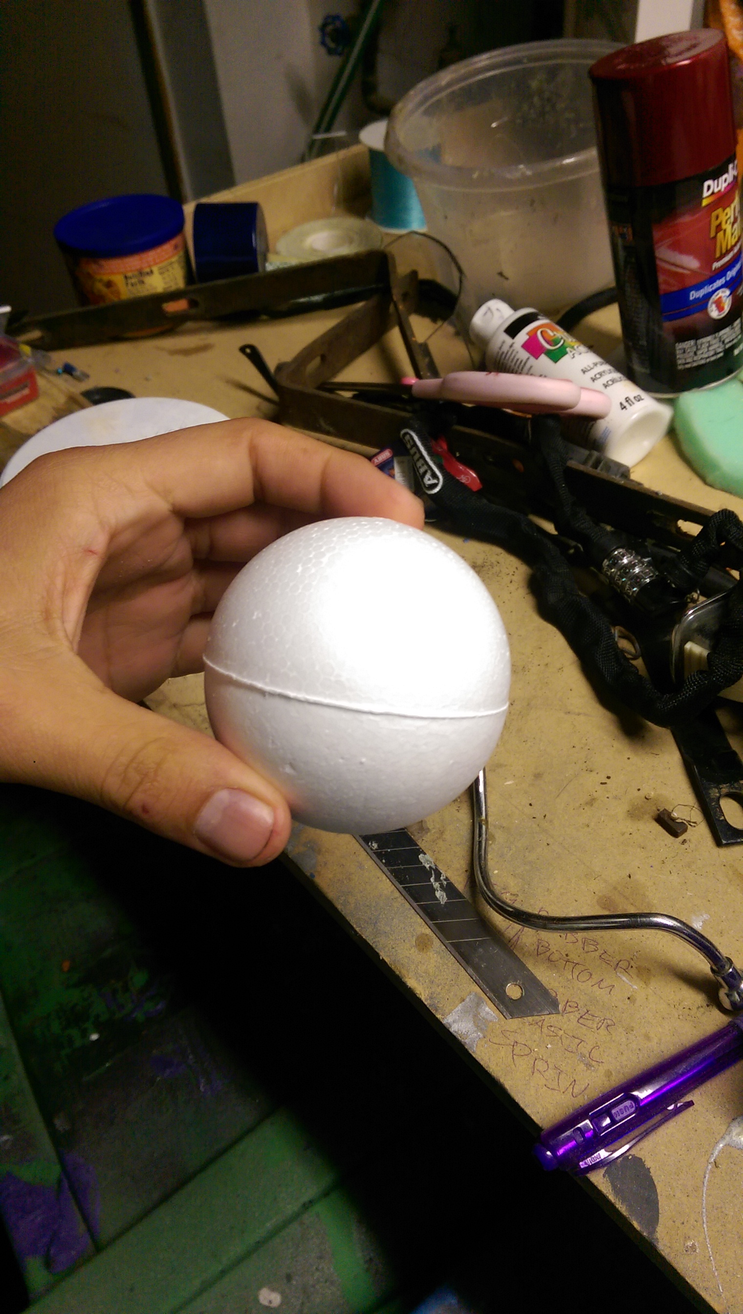

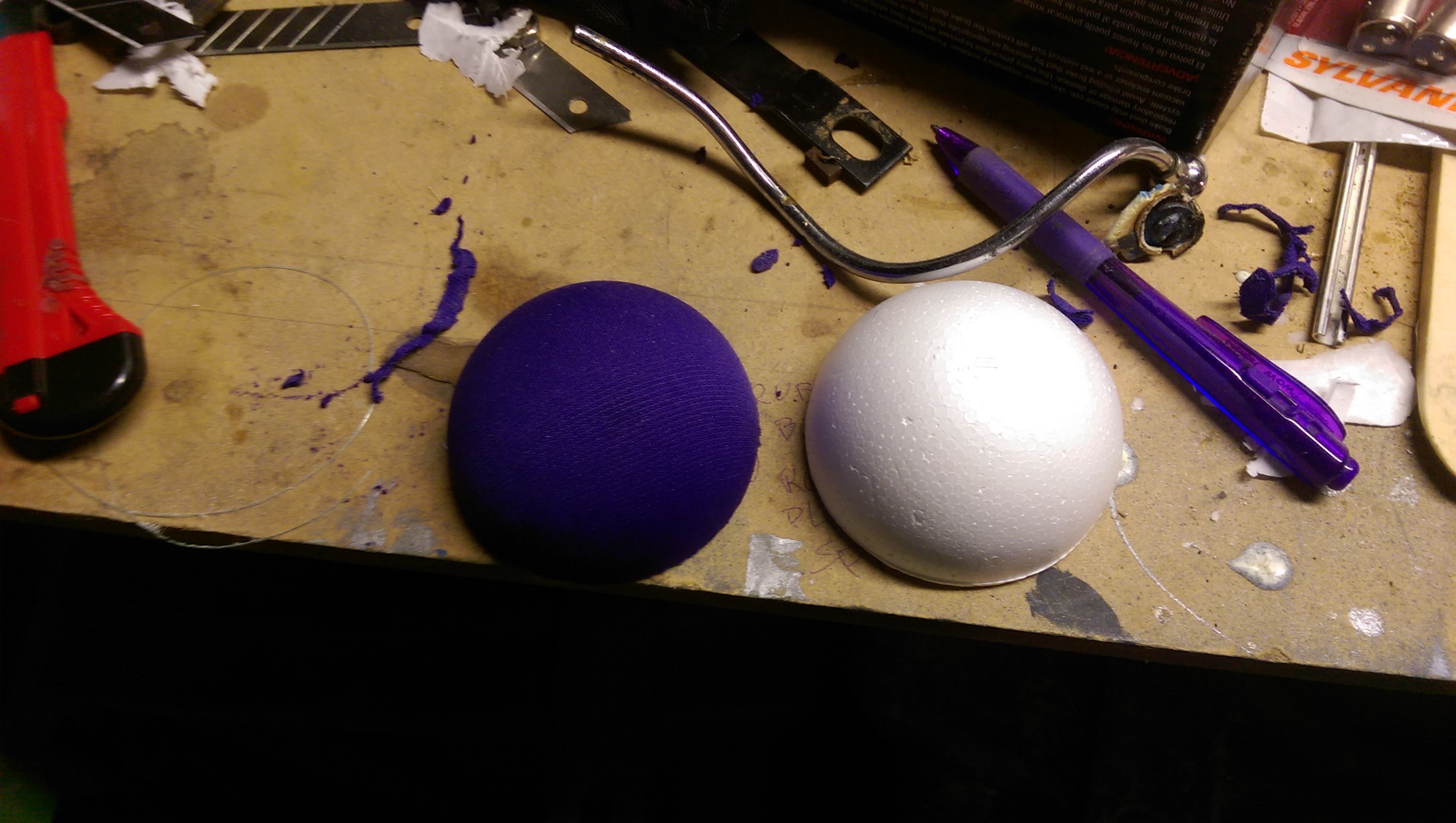

when I was at the fabric shop I ran in to these Styrofoam balls and bought a bunch to cut in half IMAG1214.jpg
then I traced the pattern to Eva foam, using two pieces glued together to get the right lenght IMAG1218.jpg
after using some heat to shape the Eva foam I used adhesive glue to and hot glue for reinforcing to attach the cloth just like I did the belt IMAG1221.jpg

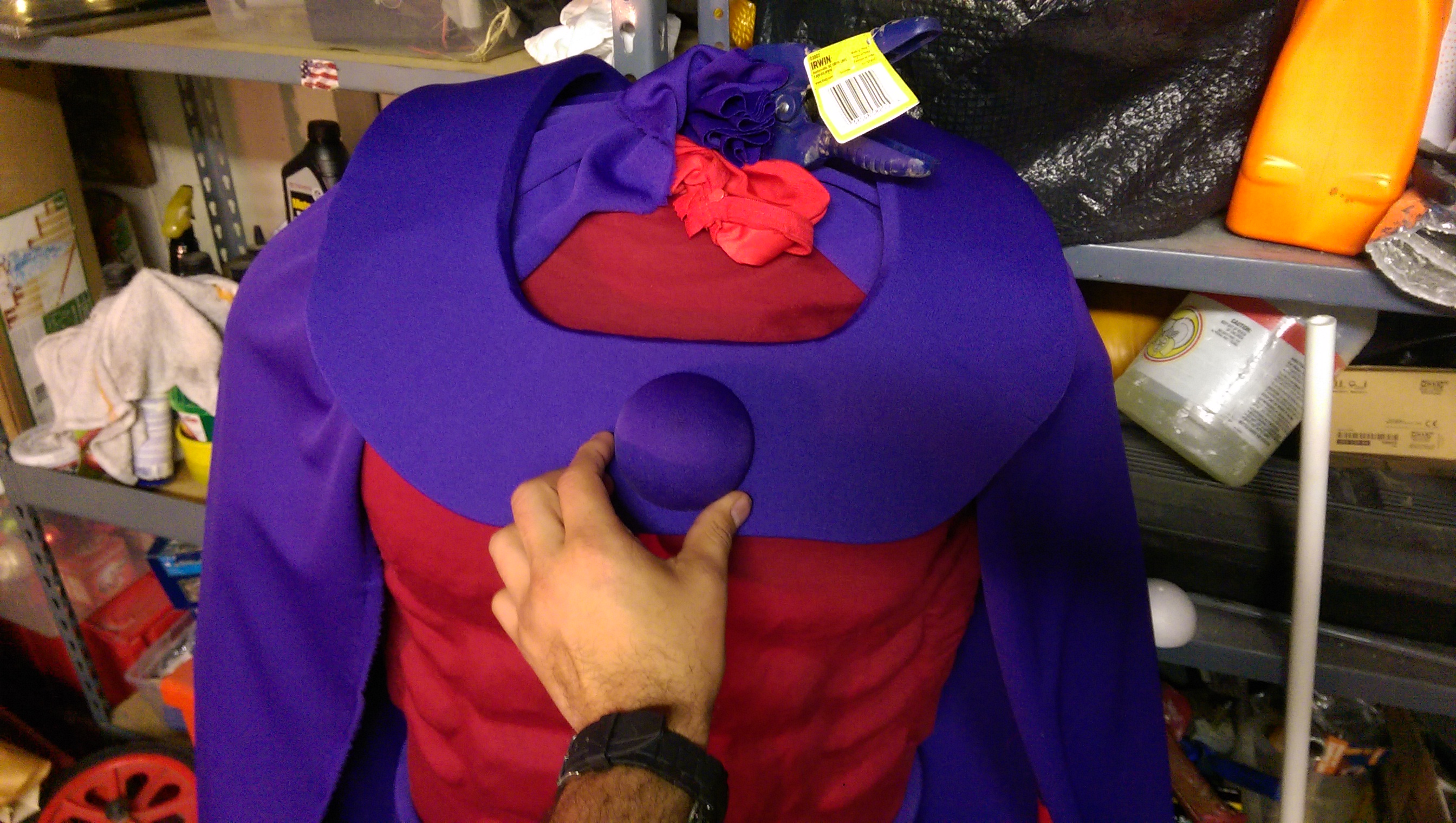

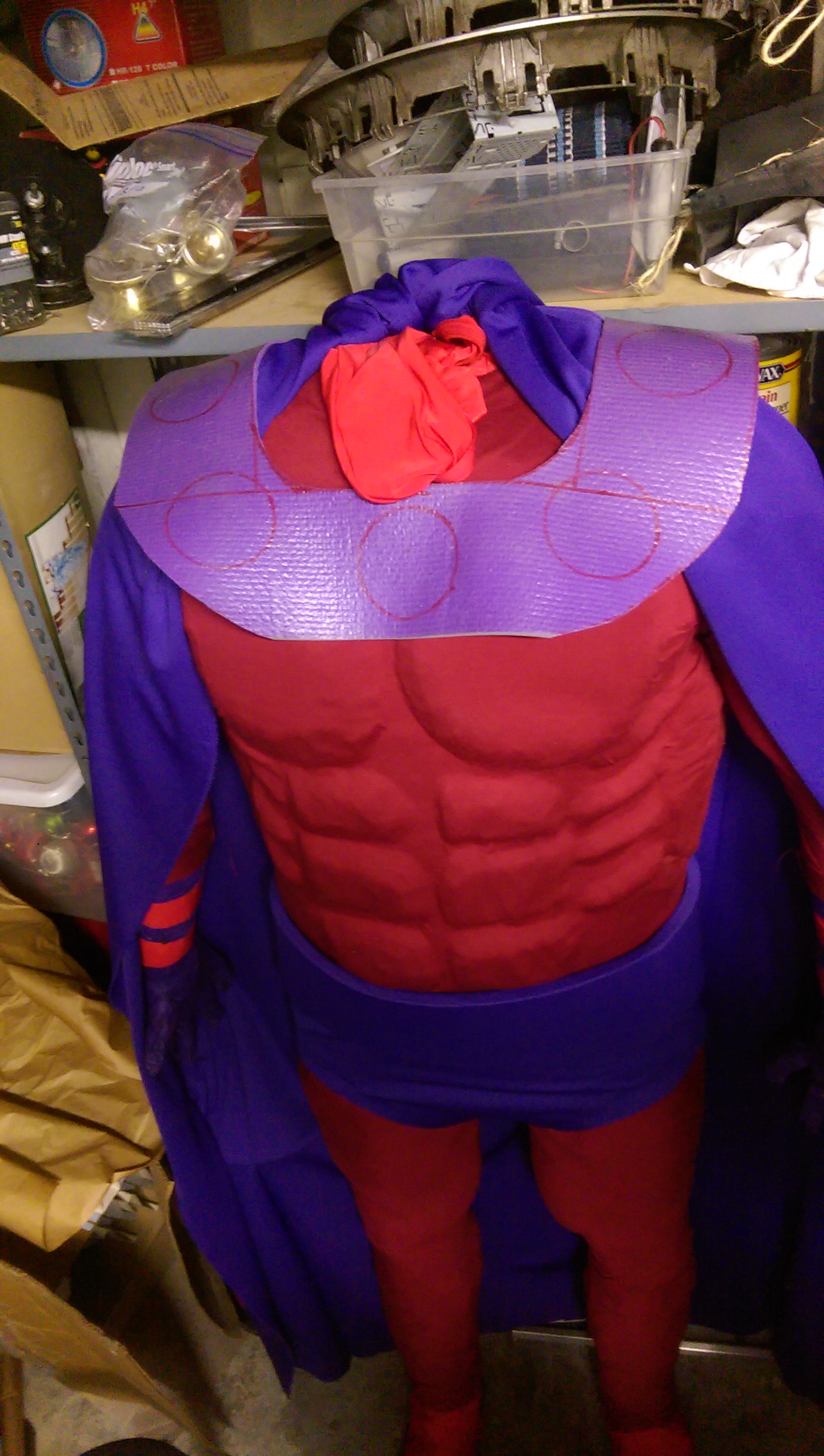

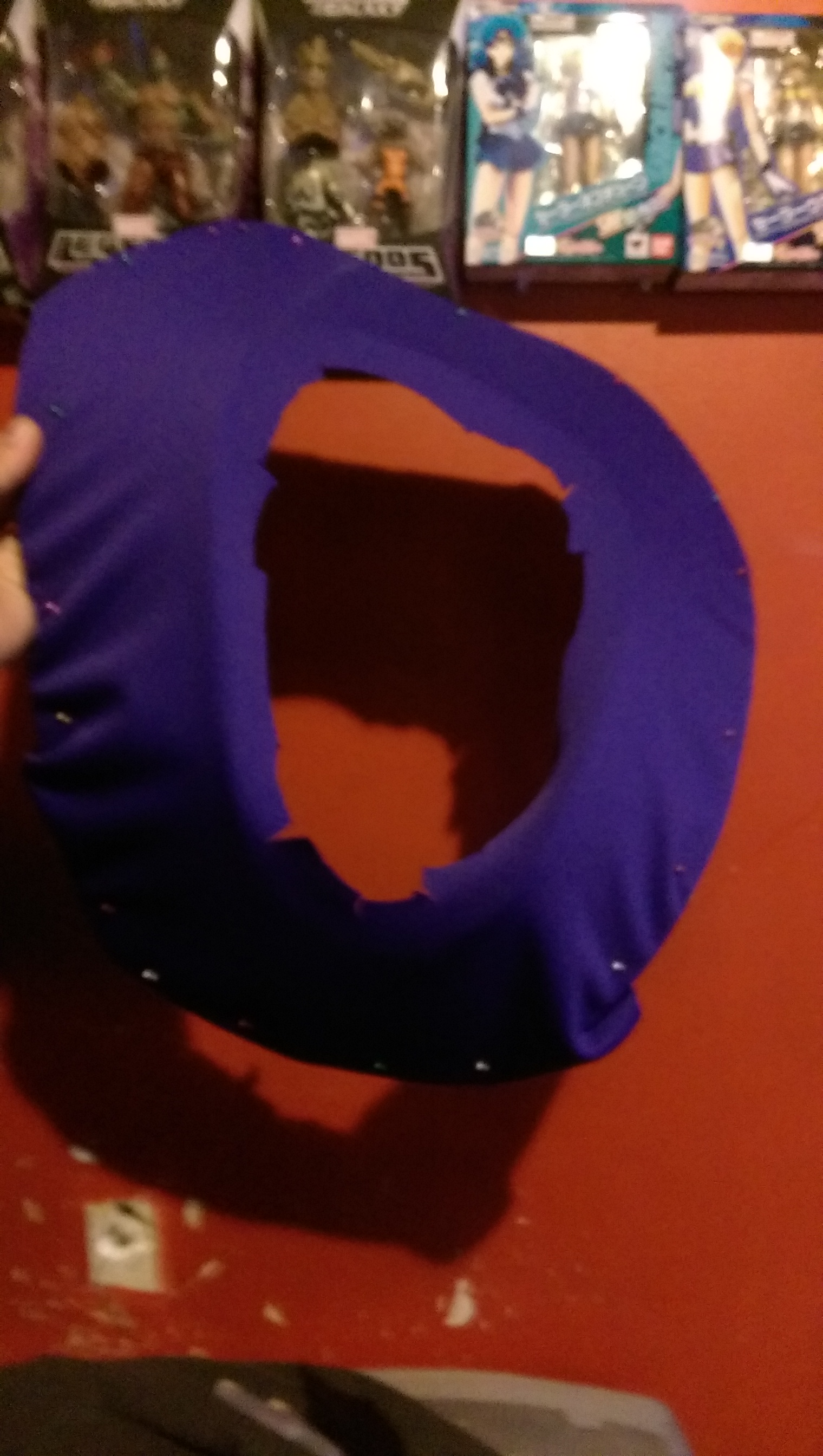

I attached the semi balls around the collar then hot glued a purple piece of cloth on the inside of the collar where my head will come out of IMAG1252.jpg . I also Went ahead and sowed a pair of gloves as I didnt like how the painted ones came out

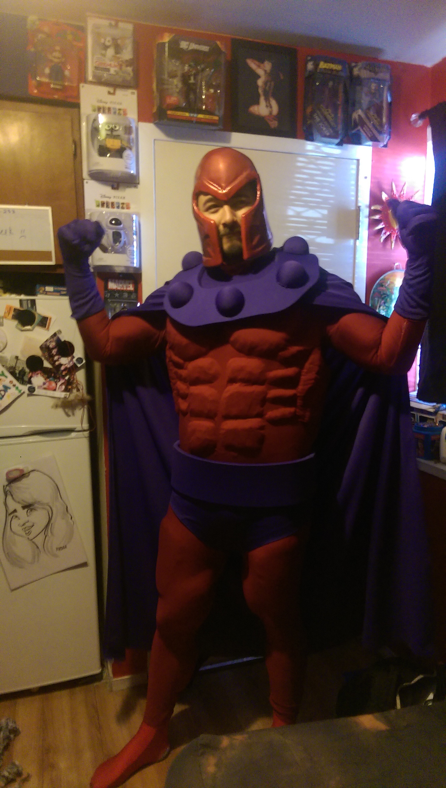

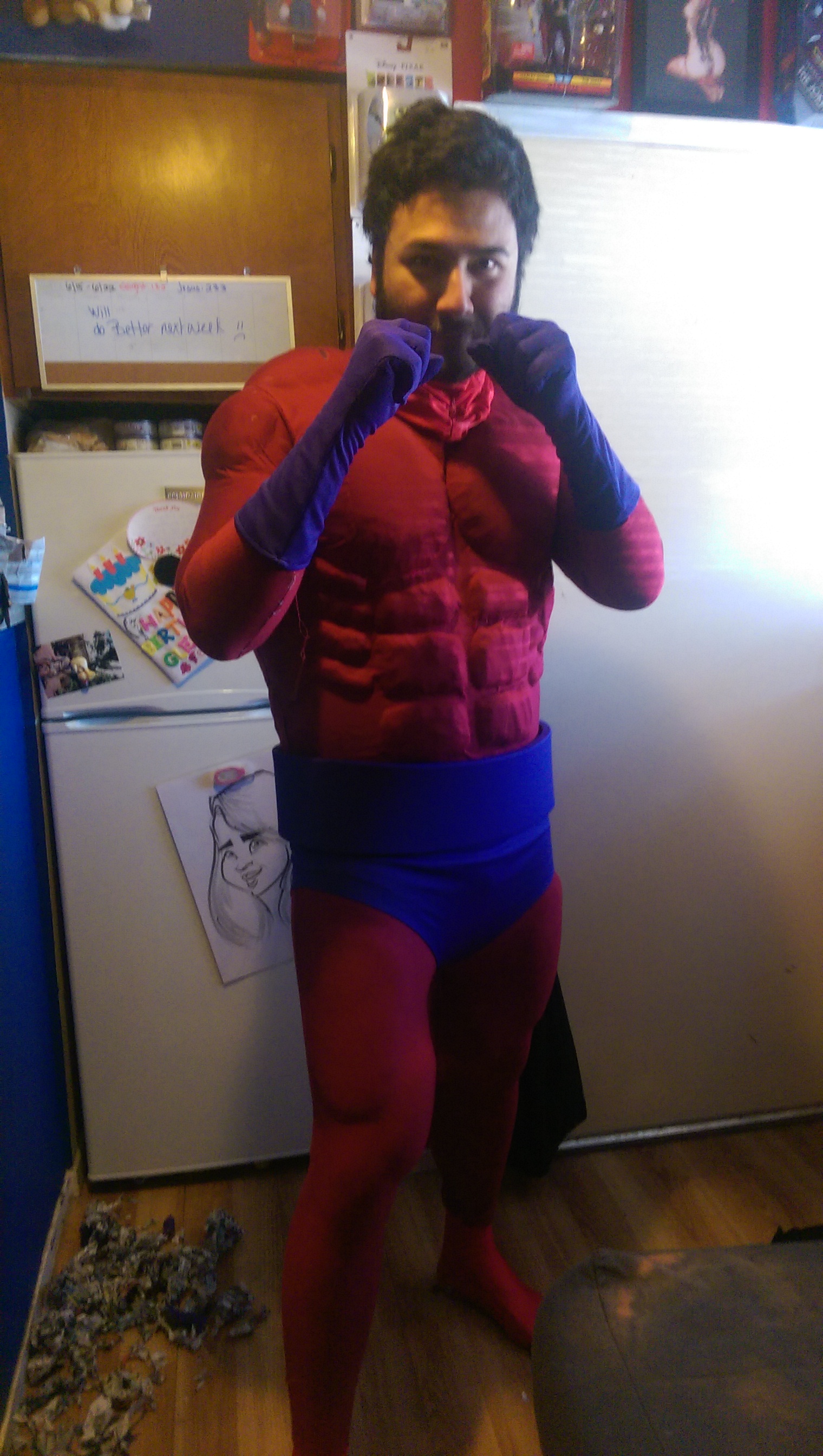

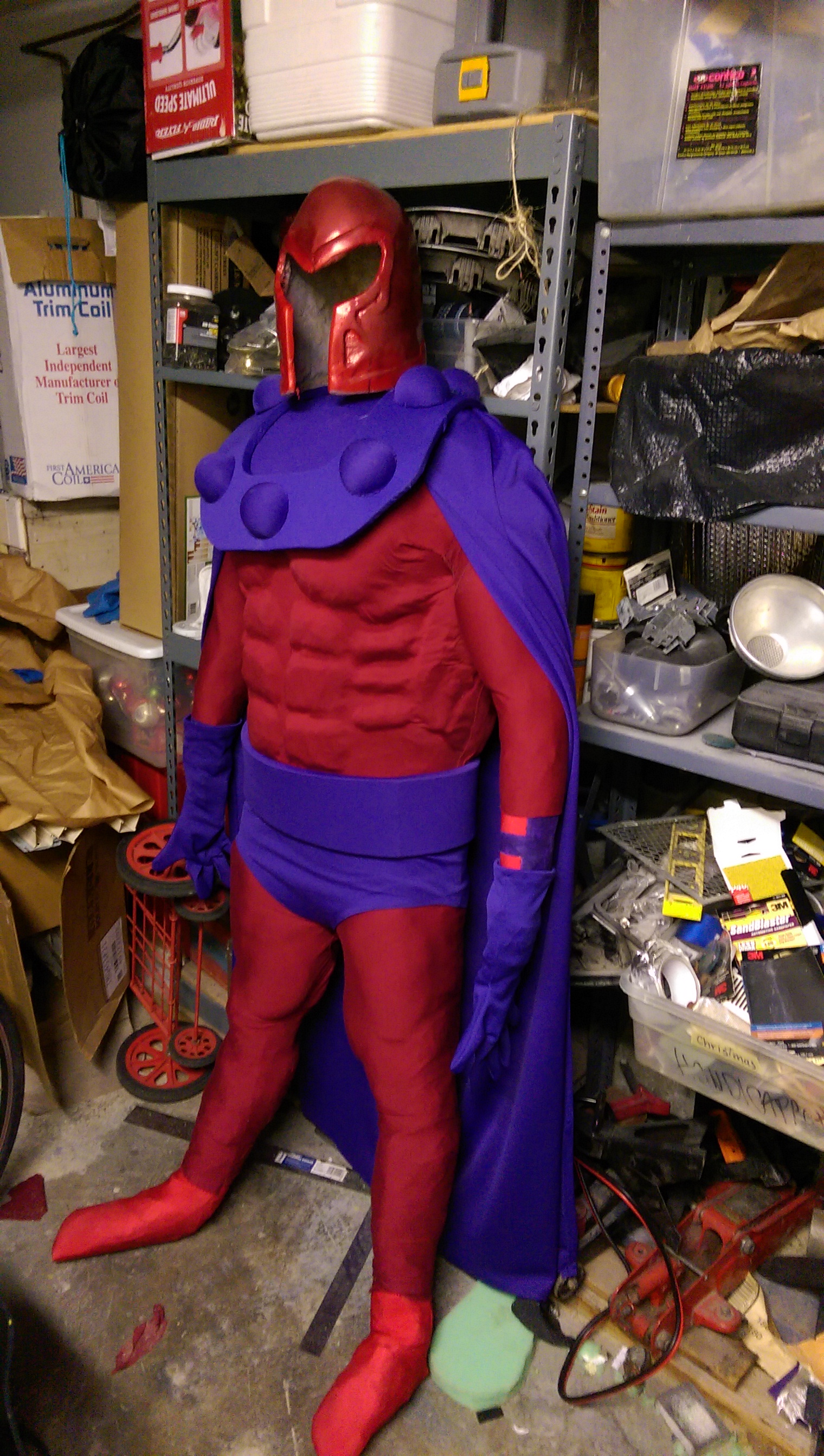

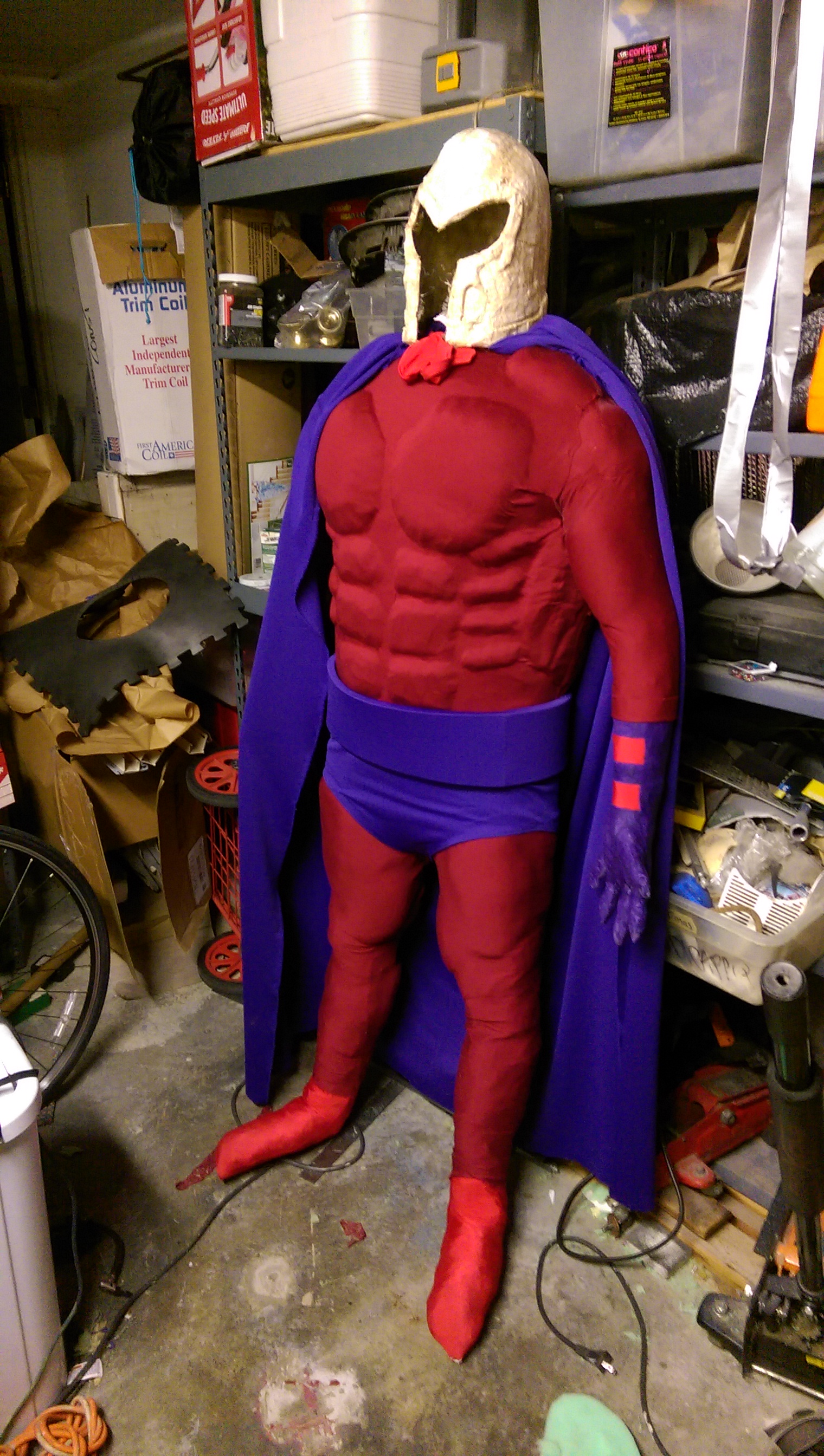

I decided it was time for a fit test at this point as I hasn't take. The suit off the dummy and I was getting nervous to make sure I could put it on! IMAG1265.jpg
it fit IMAG1264.jpg like a glove !!!
