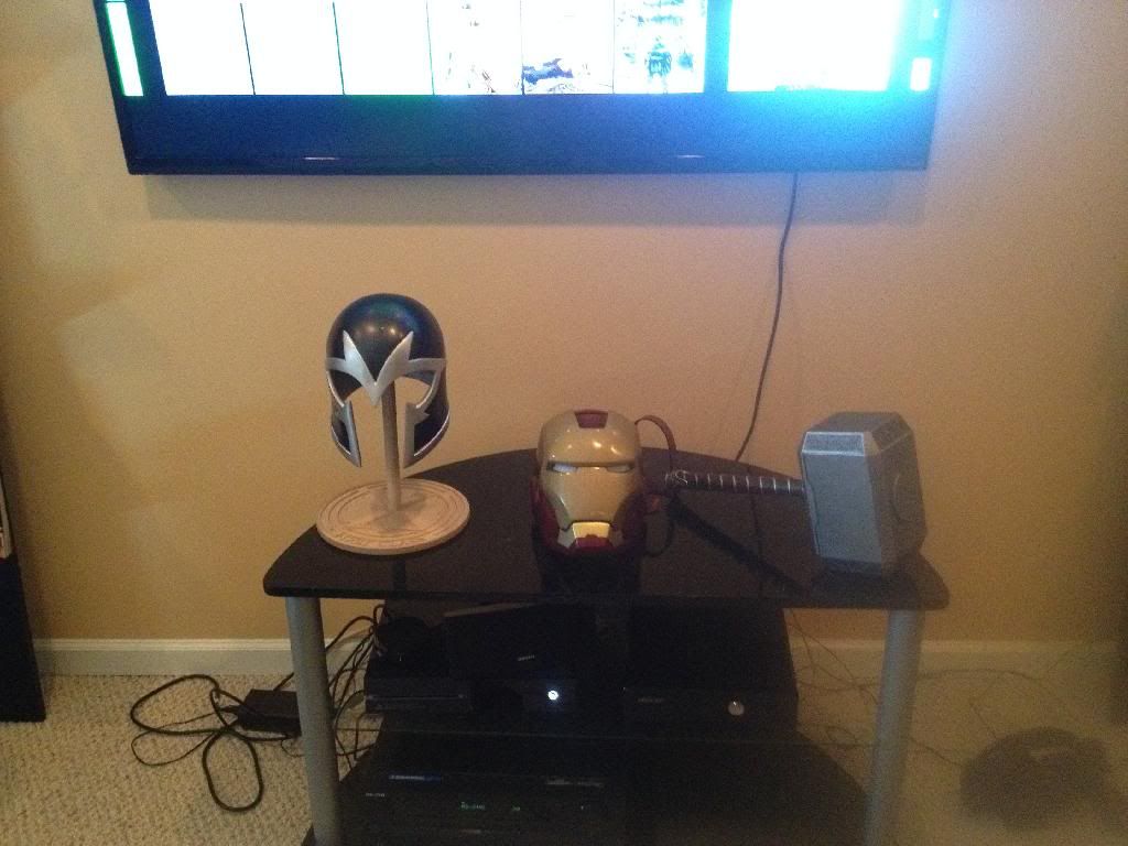

Ok here you go. I still need to do some touch ups and clear coat it and buff

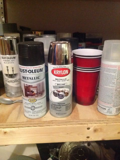

black- Rustoleum brilliant metal finish
silver - krylon metallic brilliant silver
i believe I got both from walmart and needed a can or two of each

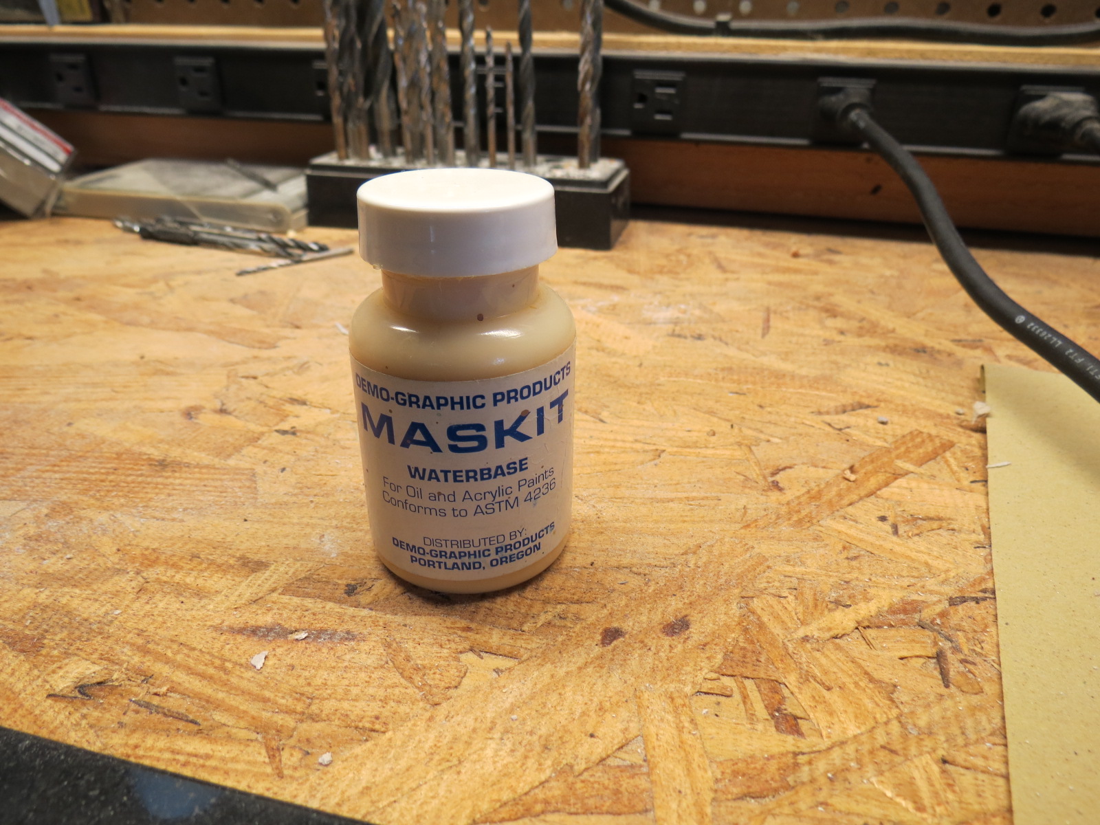

One thing my wife has suggested, is a product called "MASKIT".
It has a thick, paint like consistency. You paint it onto the areas you want to cover, and then when you're done, it peels off like rubber cement. Sounds iffy to me but she swears by it. I might do some tests with it.

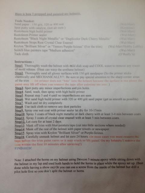

Actually... I think I still have a piece of paper that came with my helmet that had Paints and steps to finish off the helmet. Let me know and I can try to post it here. I believe it had color suggestions for Silver/Black and Red/Purple
Ah crap sorry about that totally forgot. Will do that tonight or tomorrow once I'm back from my business trip.

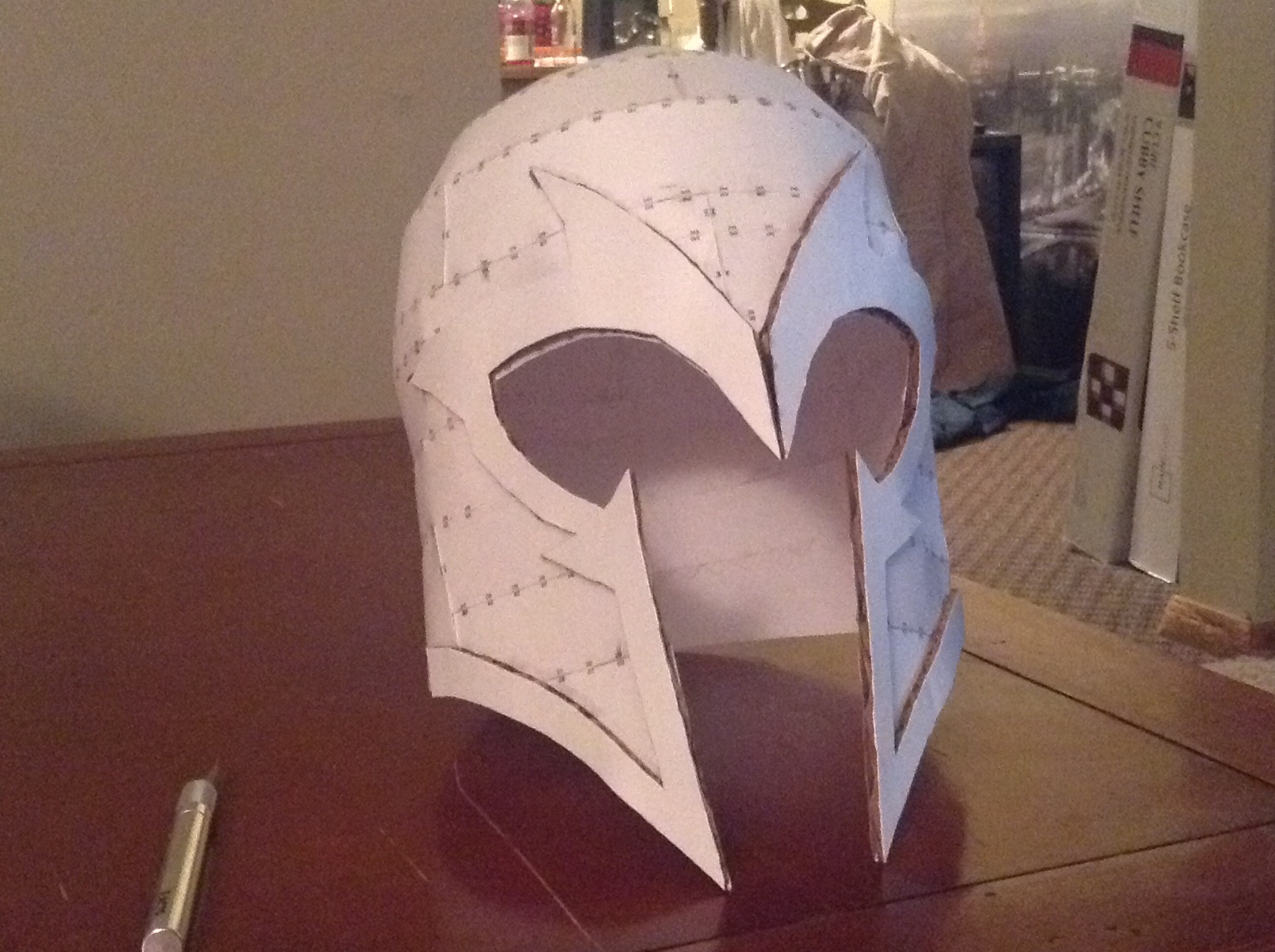

FYI the helmet looks great man. Is that cardboard trim? Looks like the perfect thickness.
Sorry for the crappy pic and how long it took for me to post this.
Here is the colors that this other guy listed out for me and steps to finishing the helmet
