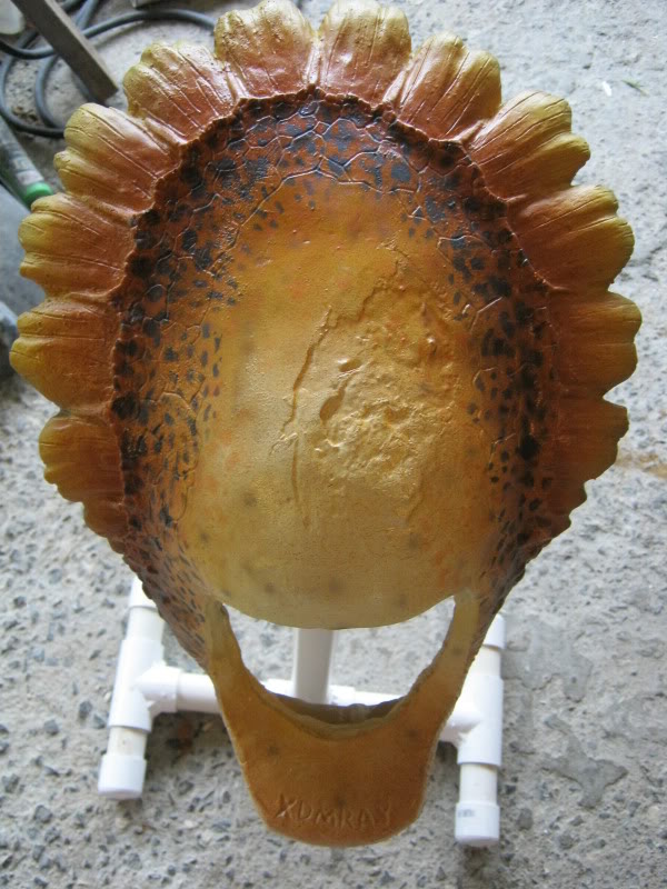

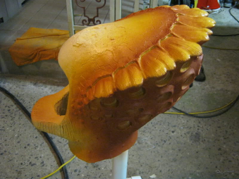

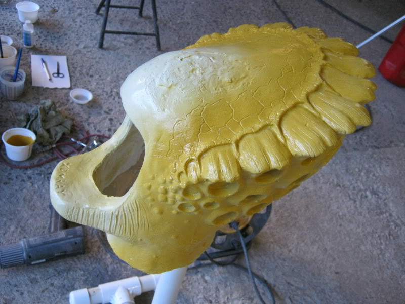

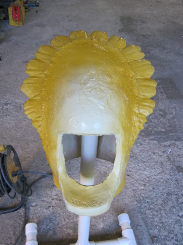

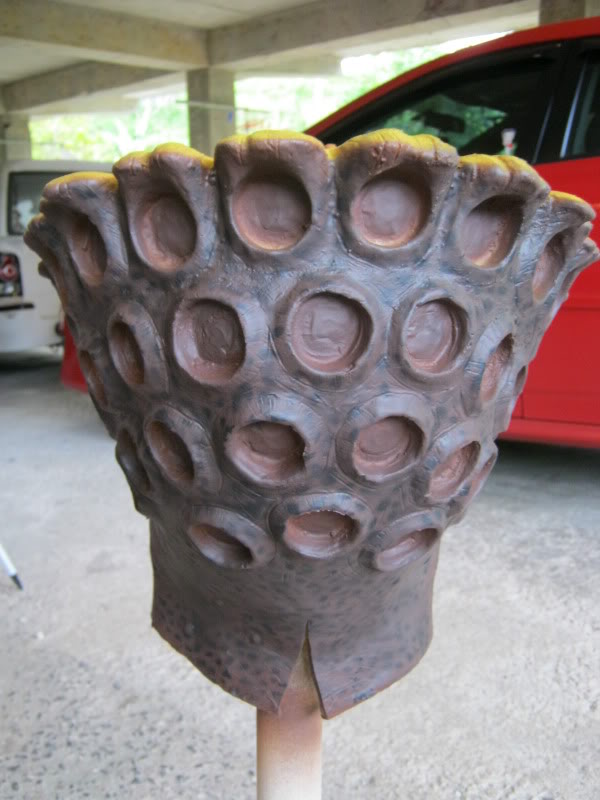

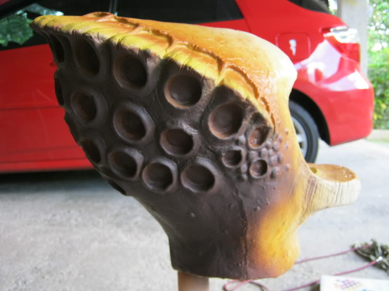

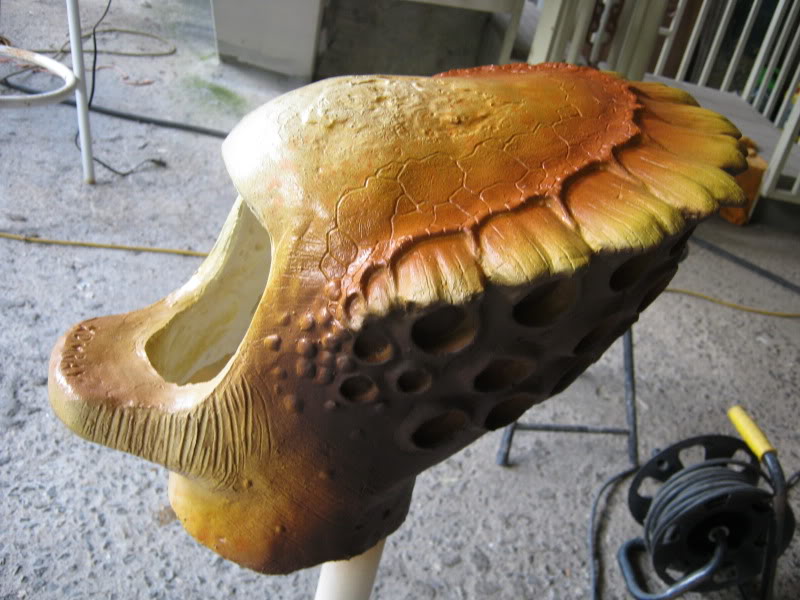

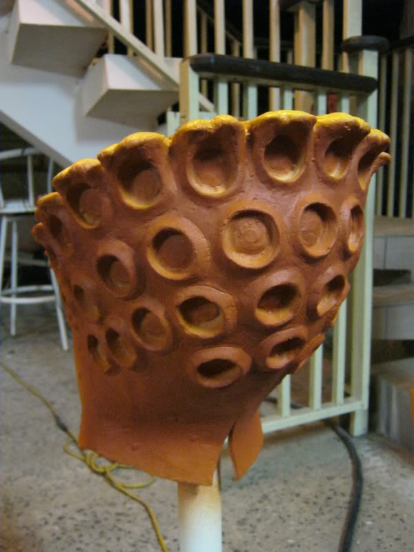

ok, then more kryolan pros aid, then on to the yellow ocre:
then same step, pros aid then sprayed on burnt sienna:
still no airbrush,all that with the spray gun shown in the pics
hope you like its my first time :)

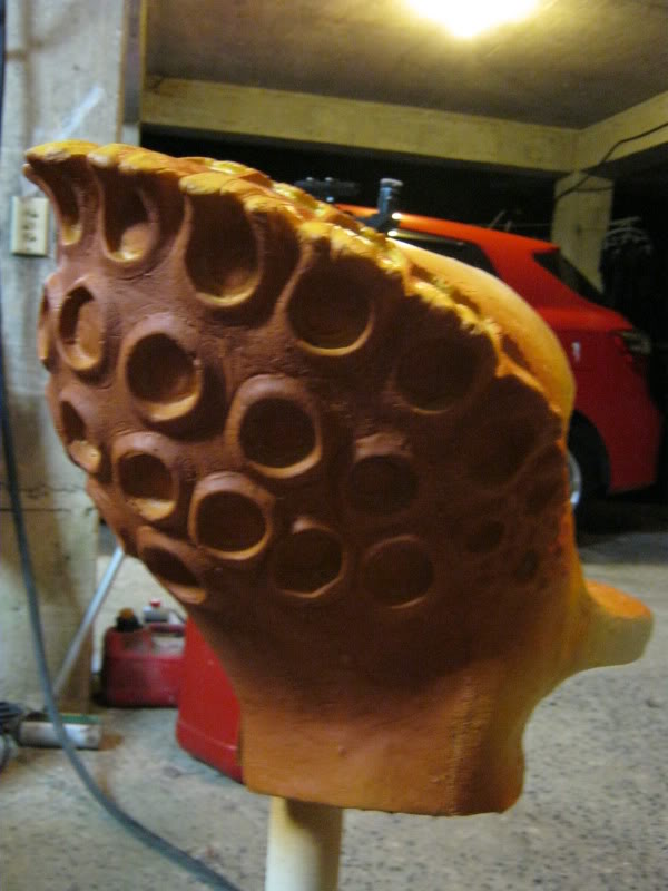

you guys are funny about the X slits for dreads. just so you know, i cut mine for the dreads. they hold fantastic. and you dont even know they are cut. :)

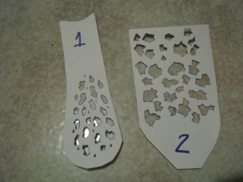

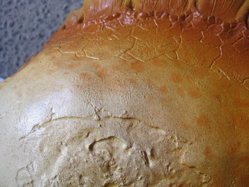

thank you xdmray, here are some template idid today, i drew on card stock then cut with the xacto blade:

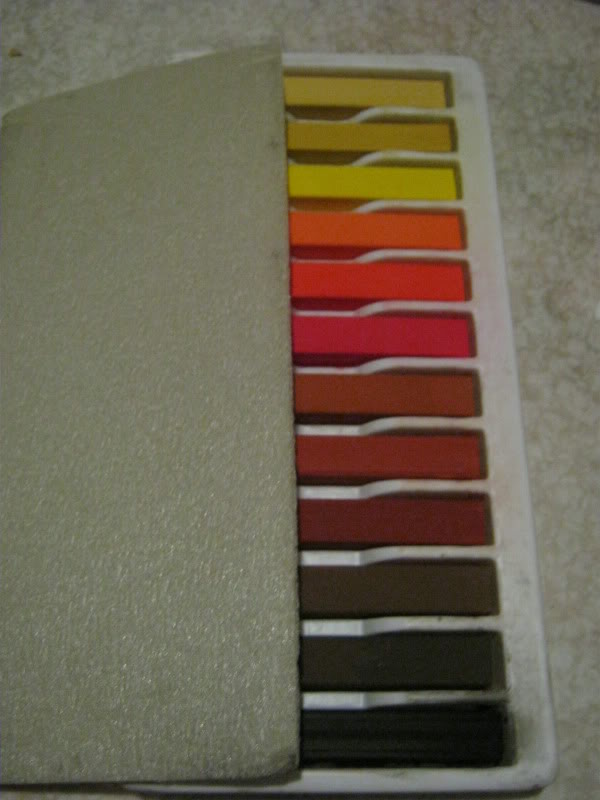

i dont know if somebody knows this technic here, what i do is i sand theese pastels and with that dust i thin with alcohol, and spray with the airbrush, but its need to be sealed, and cant be touch without sealing it
or maybe ill try the liquitex
Love the colors you are using, i should've thought about making stencils to add the spots. I don't know why i didnt do it.
LOL. it hurts bro, trust me, maybe not to you cause youre the creator, hahaha, ;)

some like to use a brush, but i think its more time consuming, with the templates are easier and faster, go on and try again, its never too late
I already sealed the paint, idk how its gonna turn out. And i'm with you, if u was the creator i probably would cut x's as well. It's my first half mask and my baby, i can't hurt it. Lol

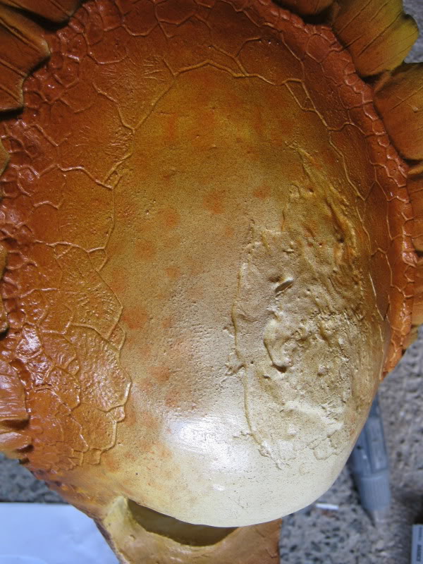

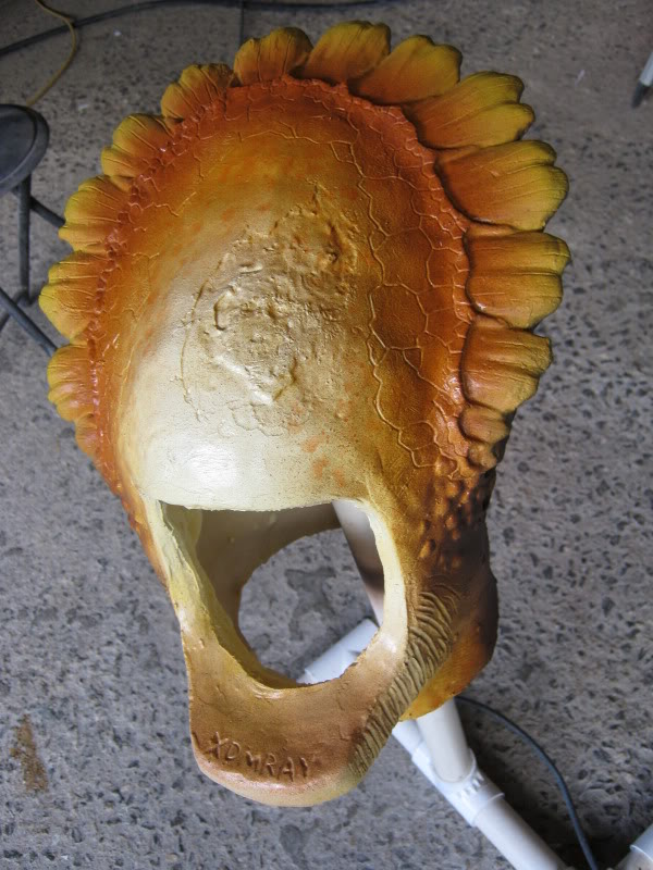

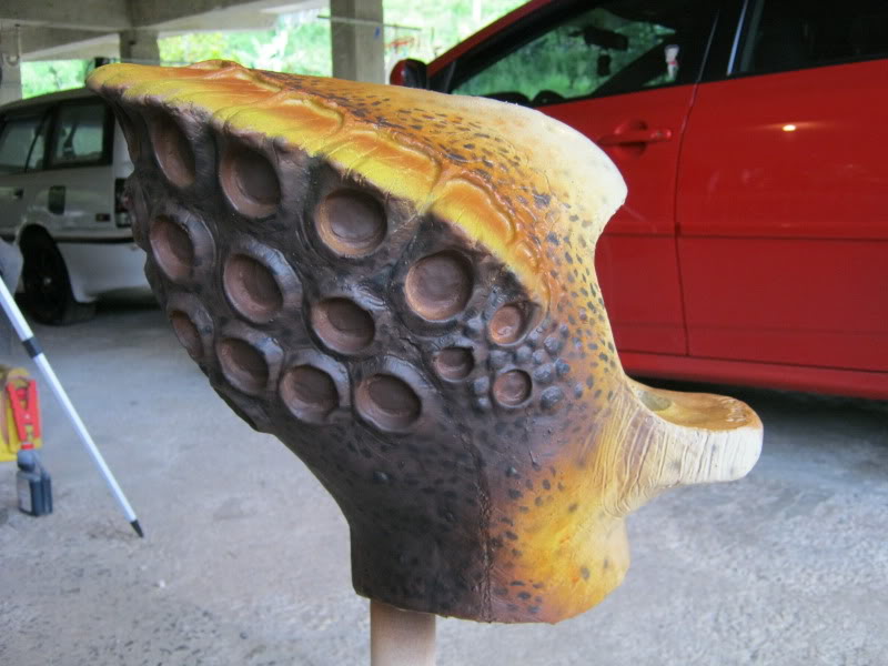

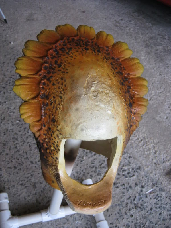

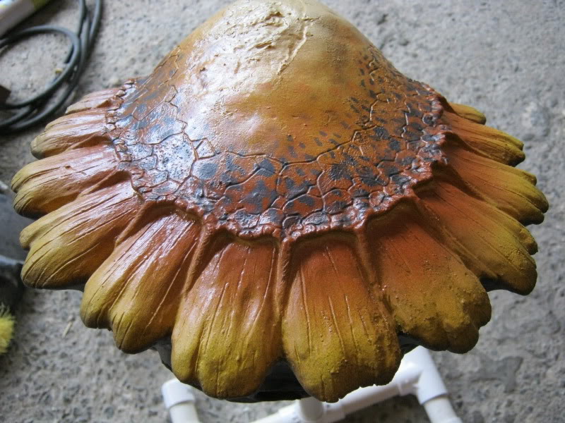

added the burnt umber today;

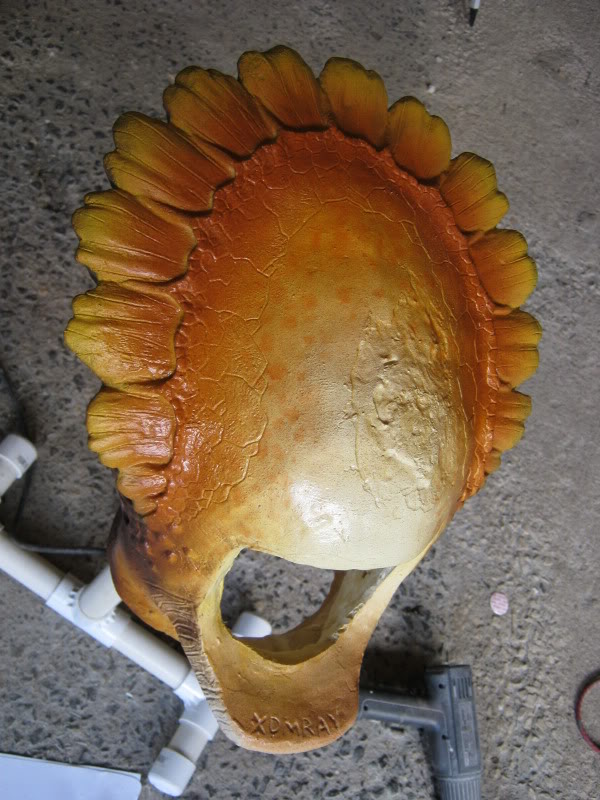

then i made a mix of 3 colors to get like an orange to match, and sprayed tru the stensil i made:
then i didnt like the yellow ocre alone in the crown edge (leaf)and decide to give it another yellow, lighter yellow just around the edges

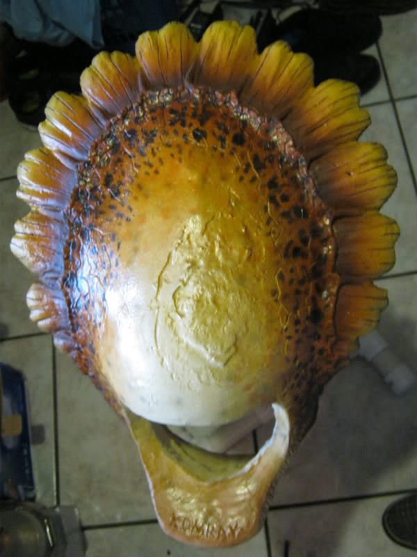

then went to add the black spots:

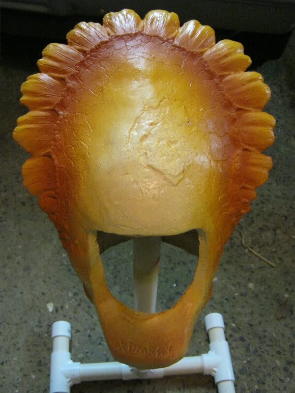

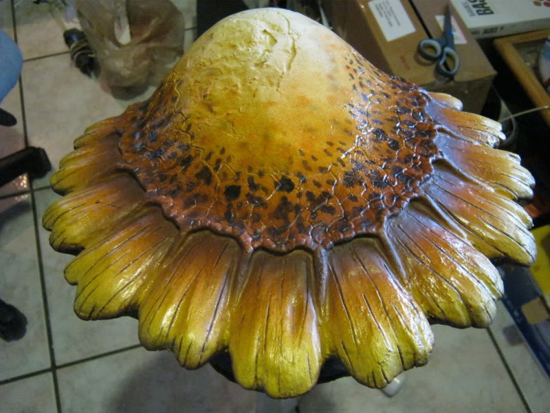

its almost finished, just need to get a little wash on some areas to highlight some details on the crown and ready to seal( when the sealer arrives :( ), didnt use the powder tecnique, just liquitex paints for detail, and apple barrels for the tones
BTW- do i have to coat with pros aid again before sealing the paint?, thanks

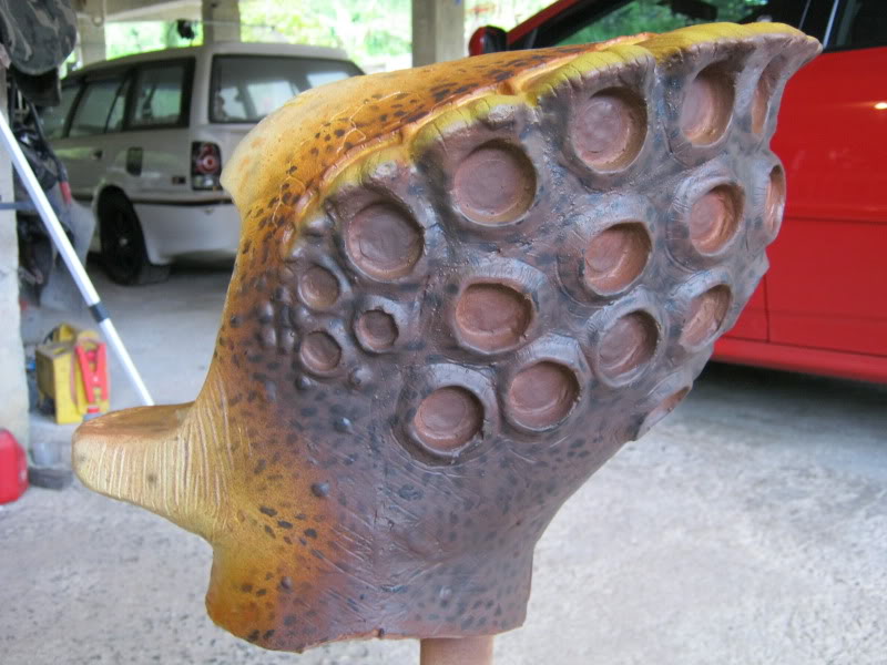

i sprayed some more light yellow at the edge of the leaf area, and some fading burnt umber at the begining, now just need s to be sealed, im happy with the outcome, just as i pictured:
I was looking at your pictures thinking 'all that needs is a wash'. Then, bam. I read it and you already knew. Great work, keep it up.
With Pros Aide I have just mixed with a little water to thin it for spraying but it may not be necessary. The more water, the duller it is.
If I remember right, MEANGENE83 recommended adding Pros Aide but I haven't done that. You would still have a tacky surface.
You posted while I was typing. That looks awesome. (y)

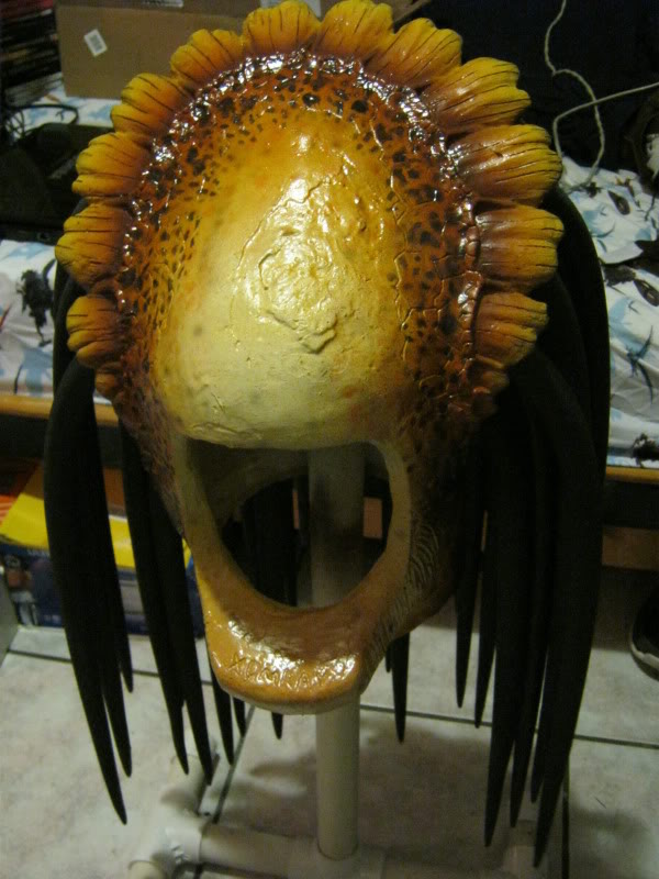

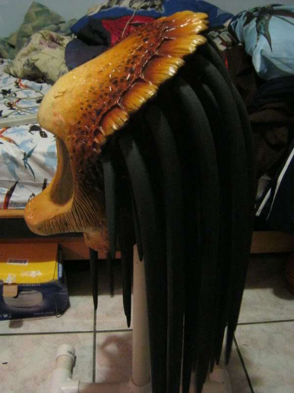

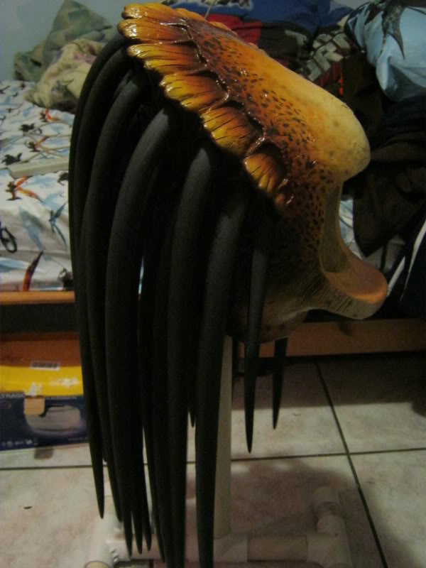

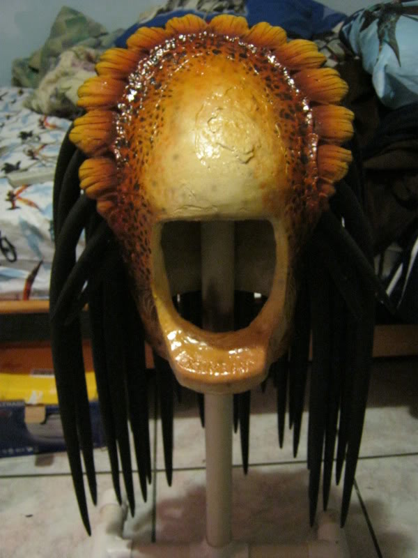

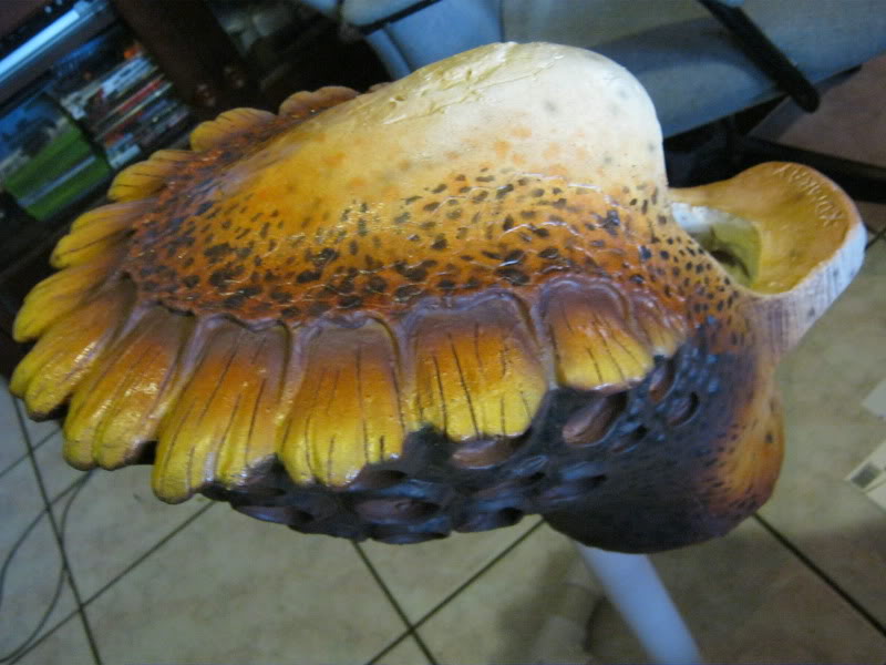

sealed today, and put the dreads,darkened the rear a little more with acrilic black paint thinned with water, 3 light coats of liquitex gloss medium and varnish, thinned with water and a little 91% isopropyl alcohol, worked great, better than i expected :), went with the long dreads :
