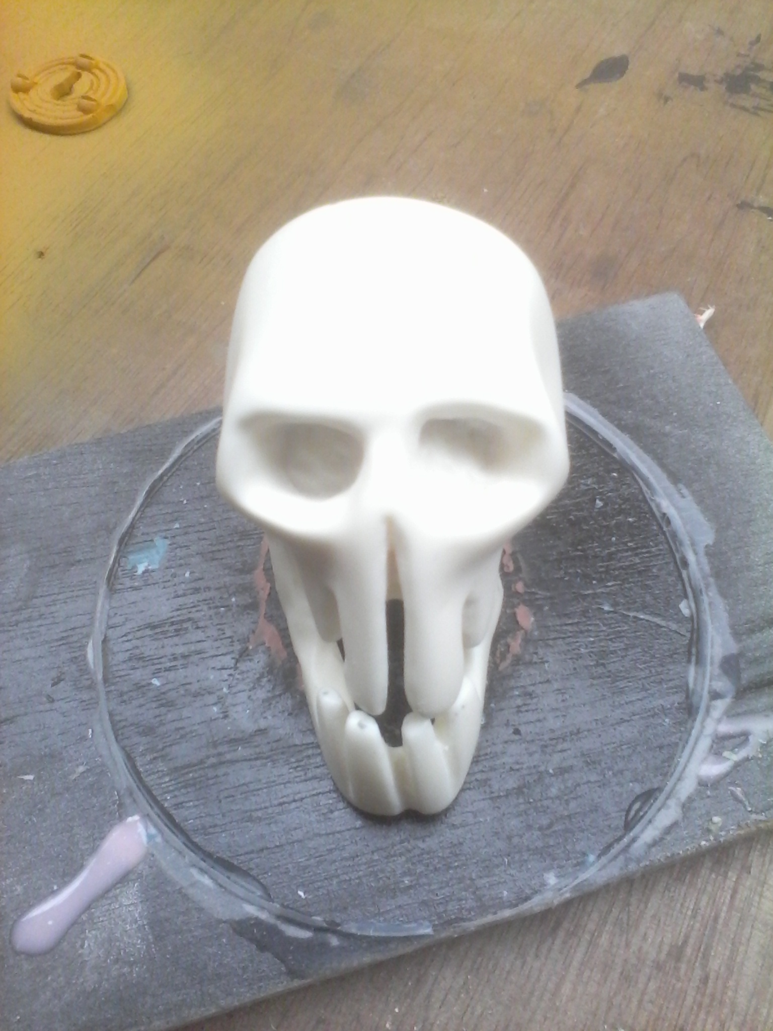

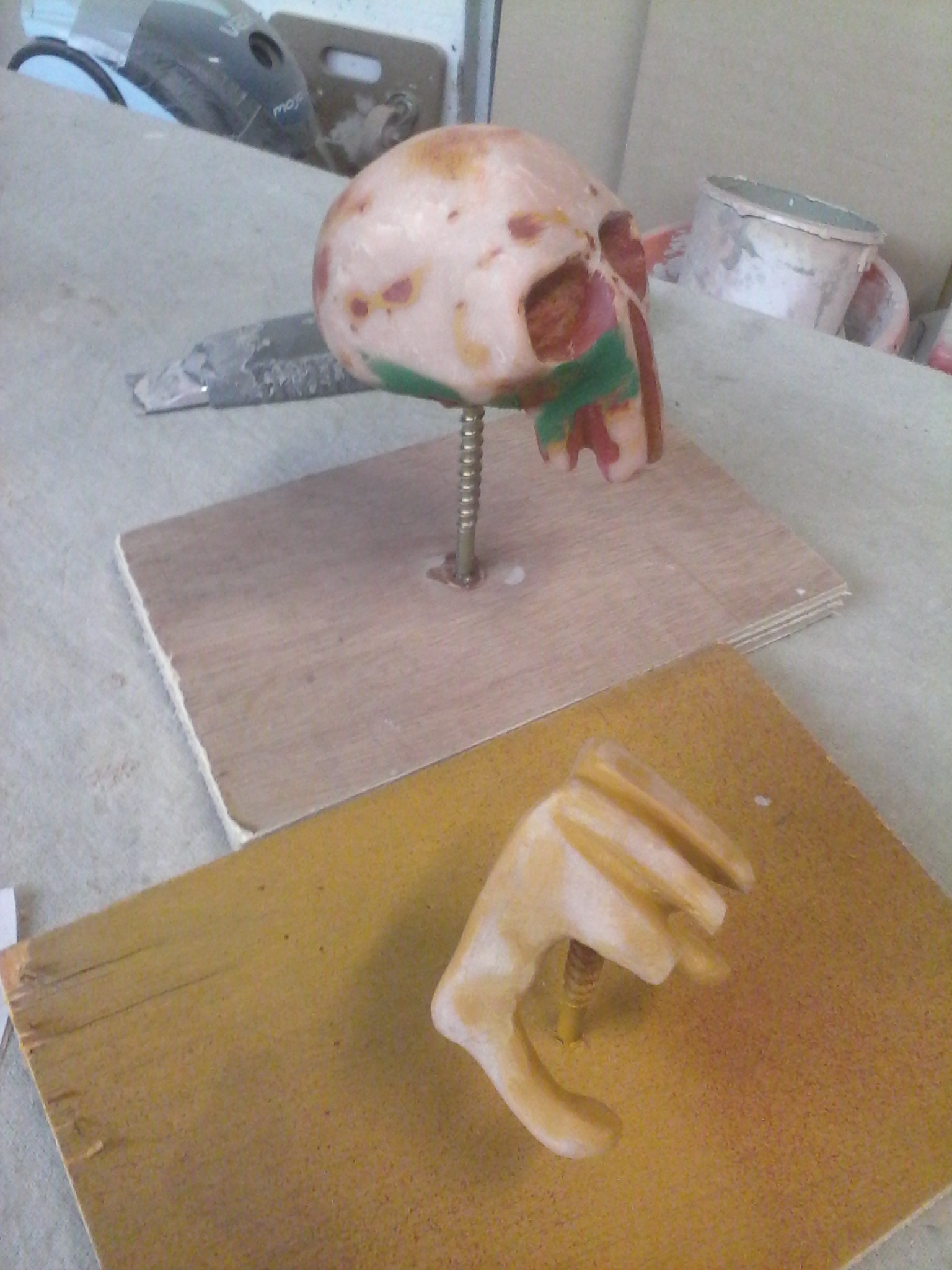

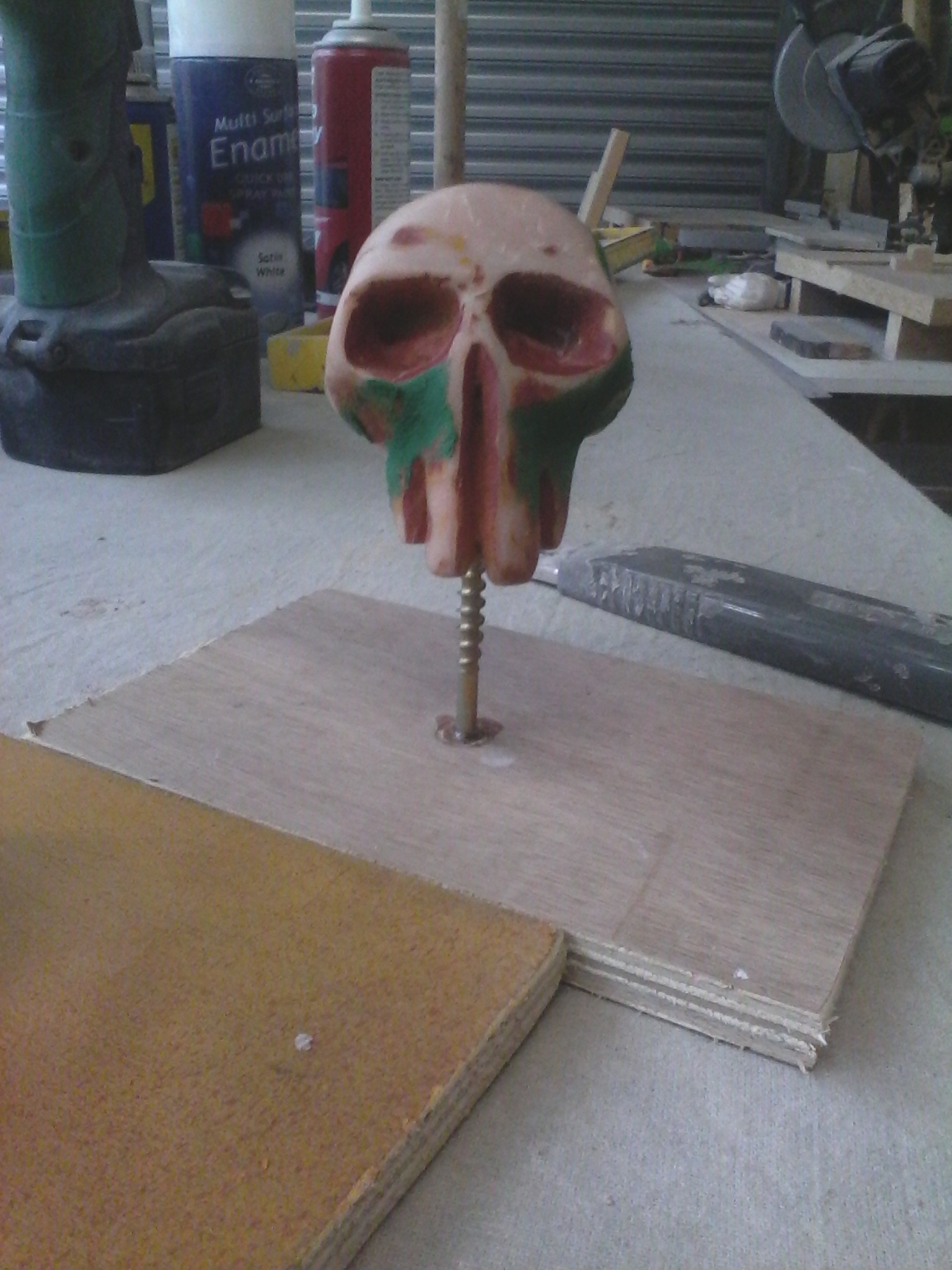

I seen the trailer for road fury last night and got to work straight away with some sculpey on the gear knob you see for a split second, its still work in progress but what do you think?
sand prime sand prime and more sanding then prime

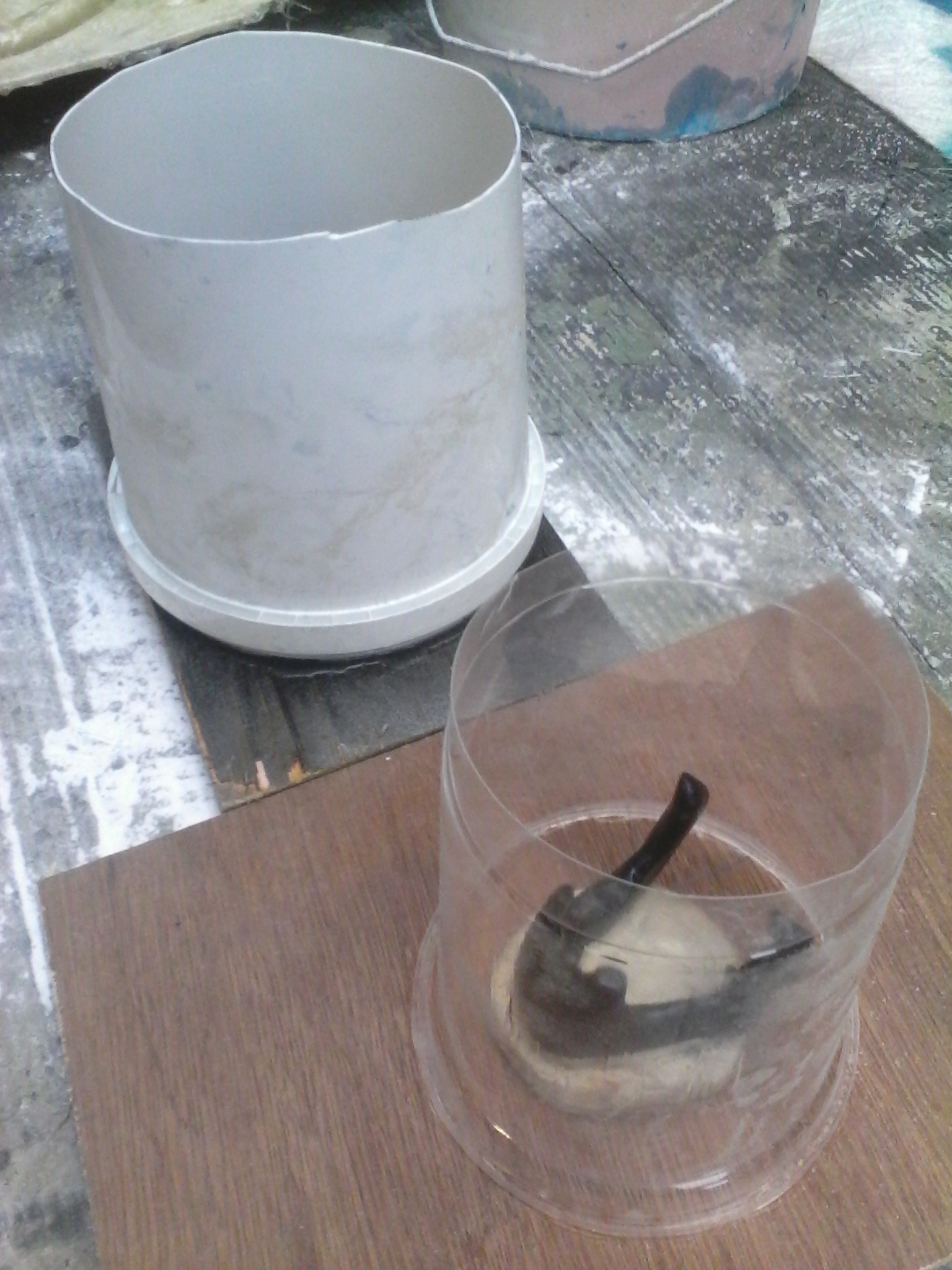

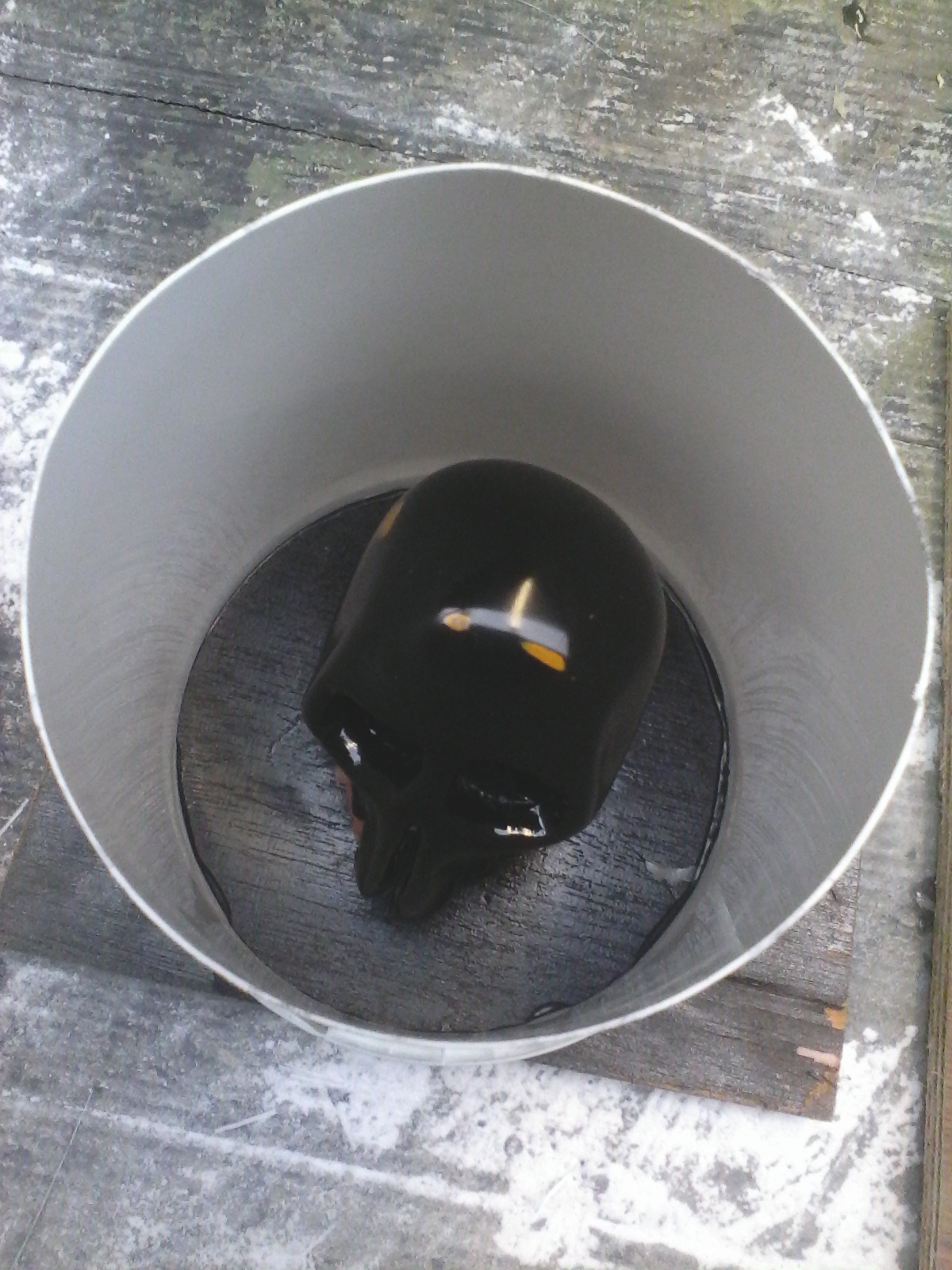

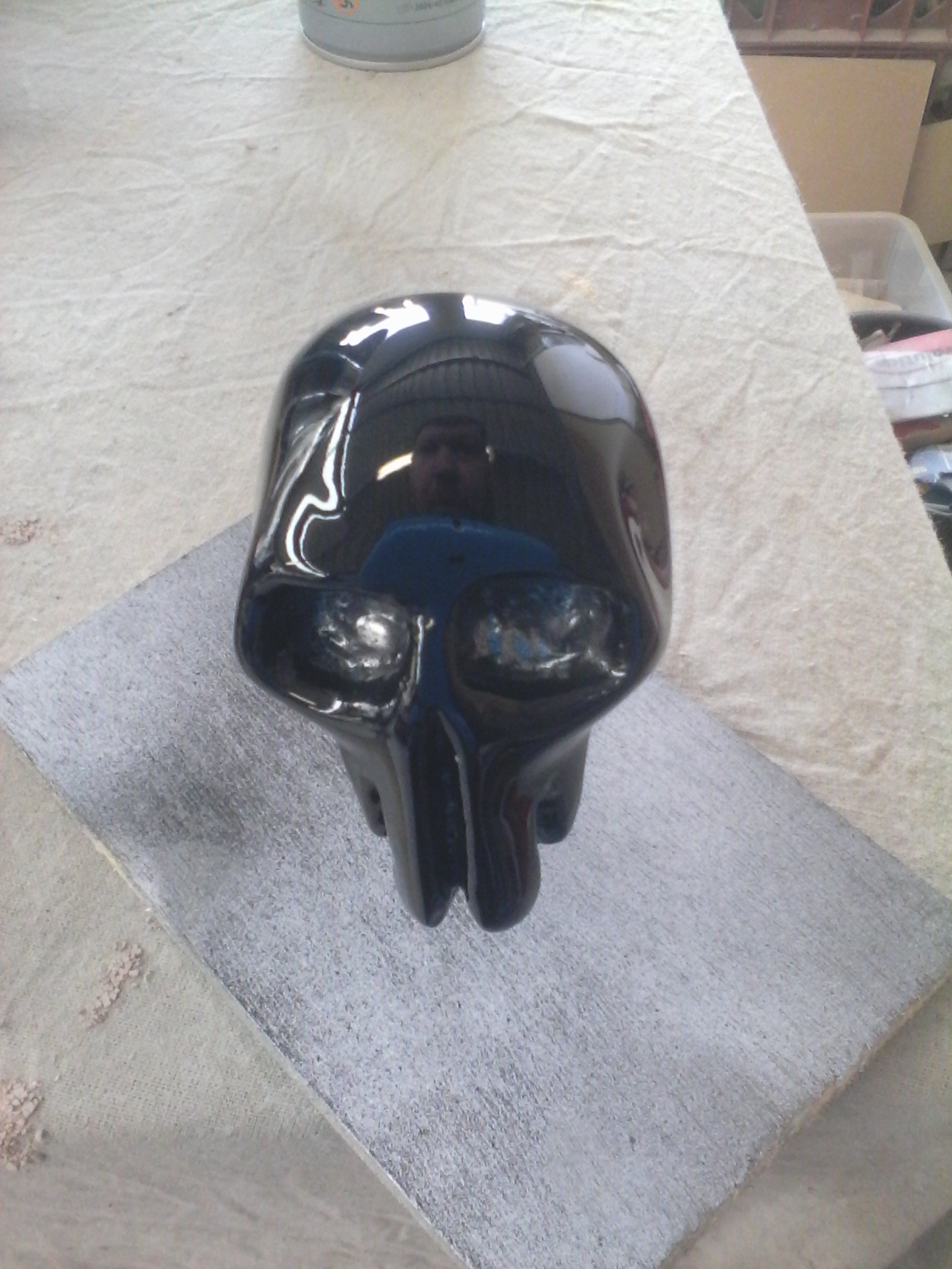

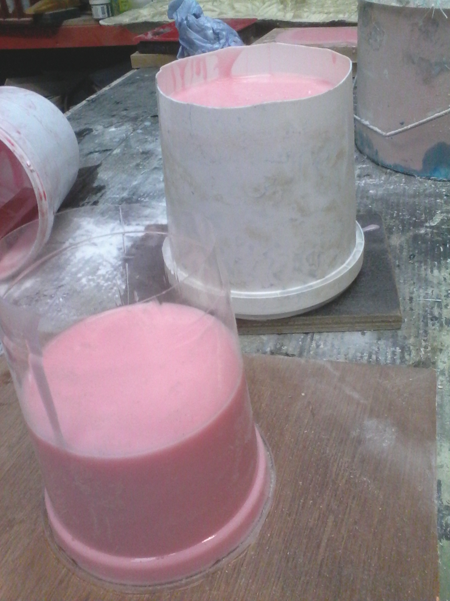

gloss black the silver im gona make a silicone mould and cast in PU later on but could not resist putting some silver on
Re: mad max fury road gear stick

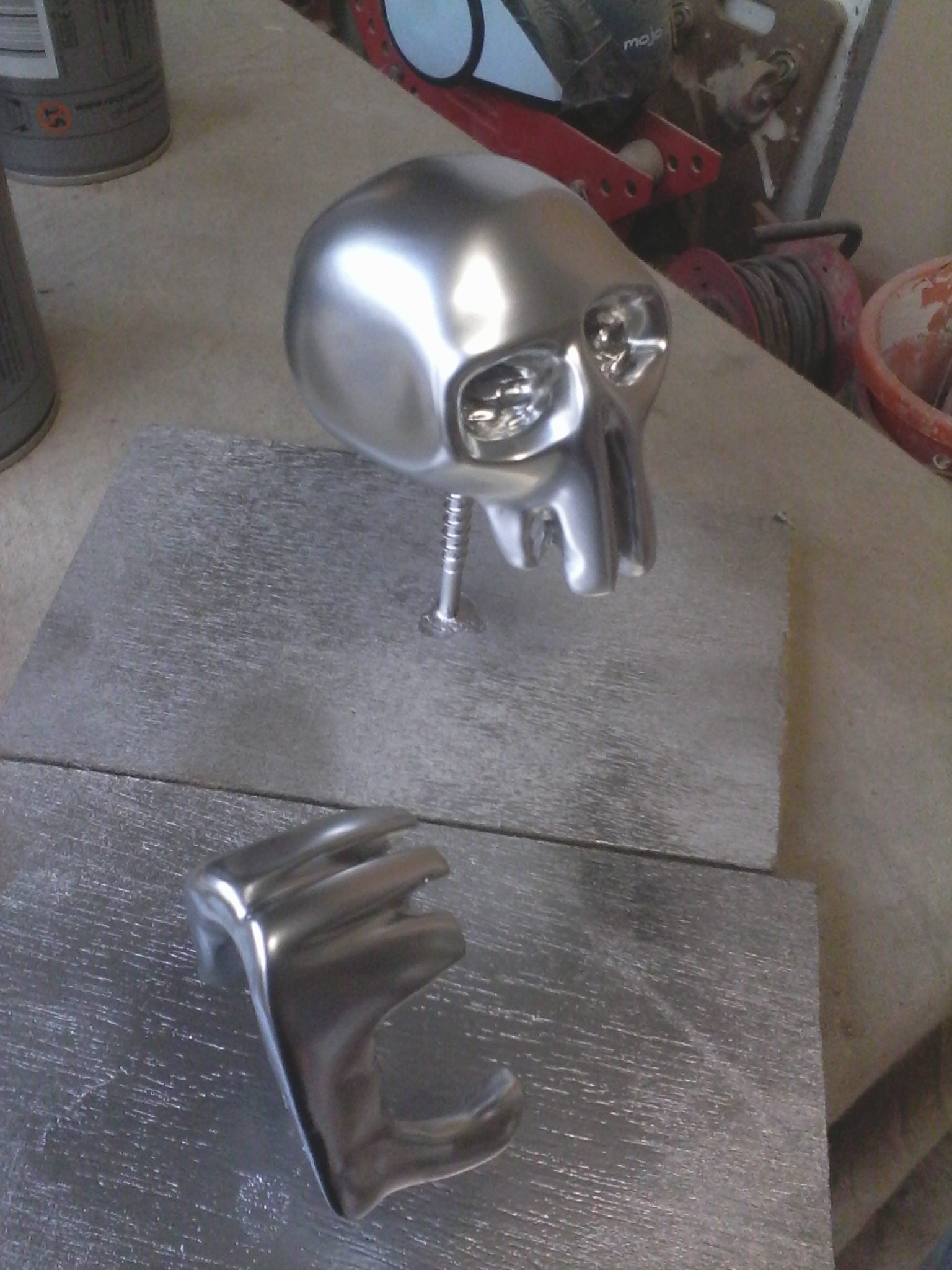

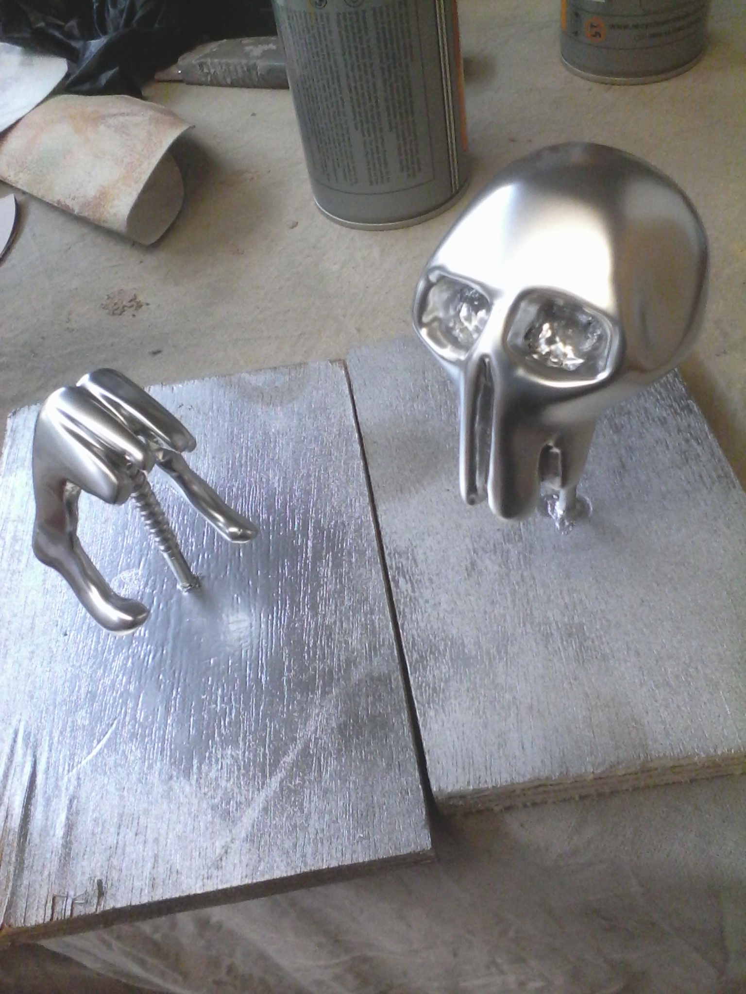

Anyone have any tips on chrome painting it just didnt have the depth i think so I have rubed it down with 1000g and repainted gloss black
I have not seen the picture of the prop but prehaps you should spray it with alclad, it would give it a aluminum finish
Thanks for the tip on alclad I've just orded some, and I am making a mould so a run is not out of the question if there's people interested
Alclad is great. You don't need to use much either. It's definitely a case of less is more. You don't need to load it on over the gloss black. A lighter coat actually looks better.

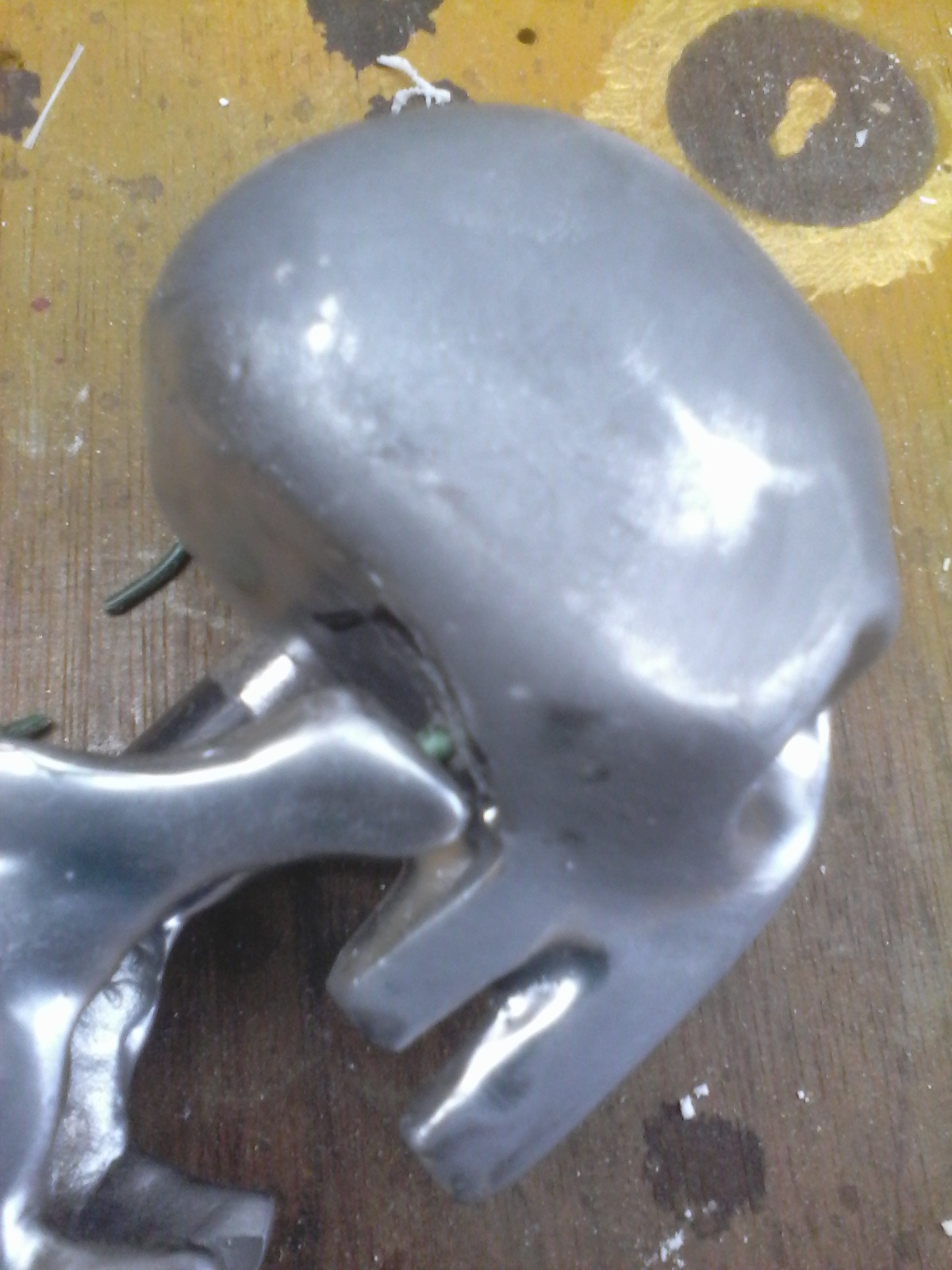

first pull and all looks fine, i've dremeled out the the gaps in the teeth from the rear this was always the plan to make the mould straightforward

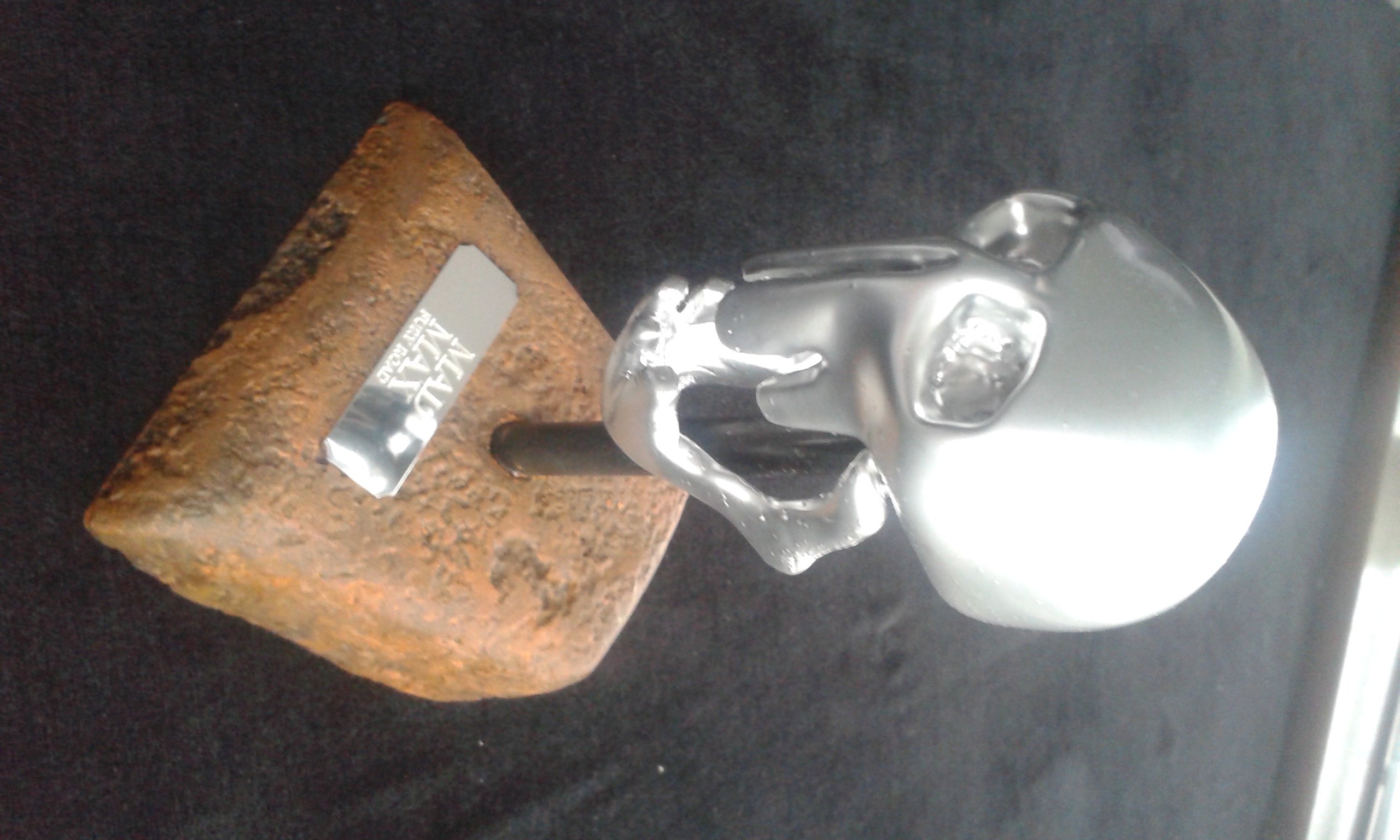

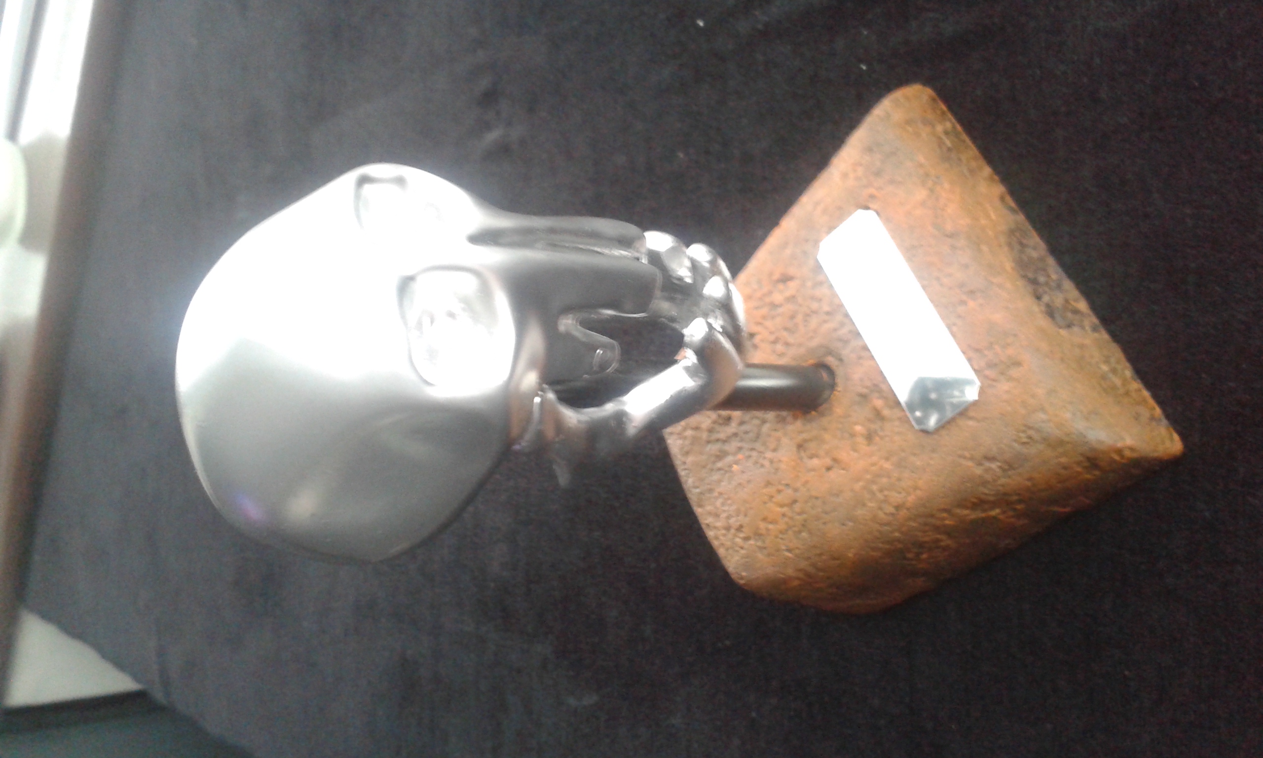

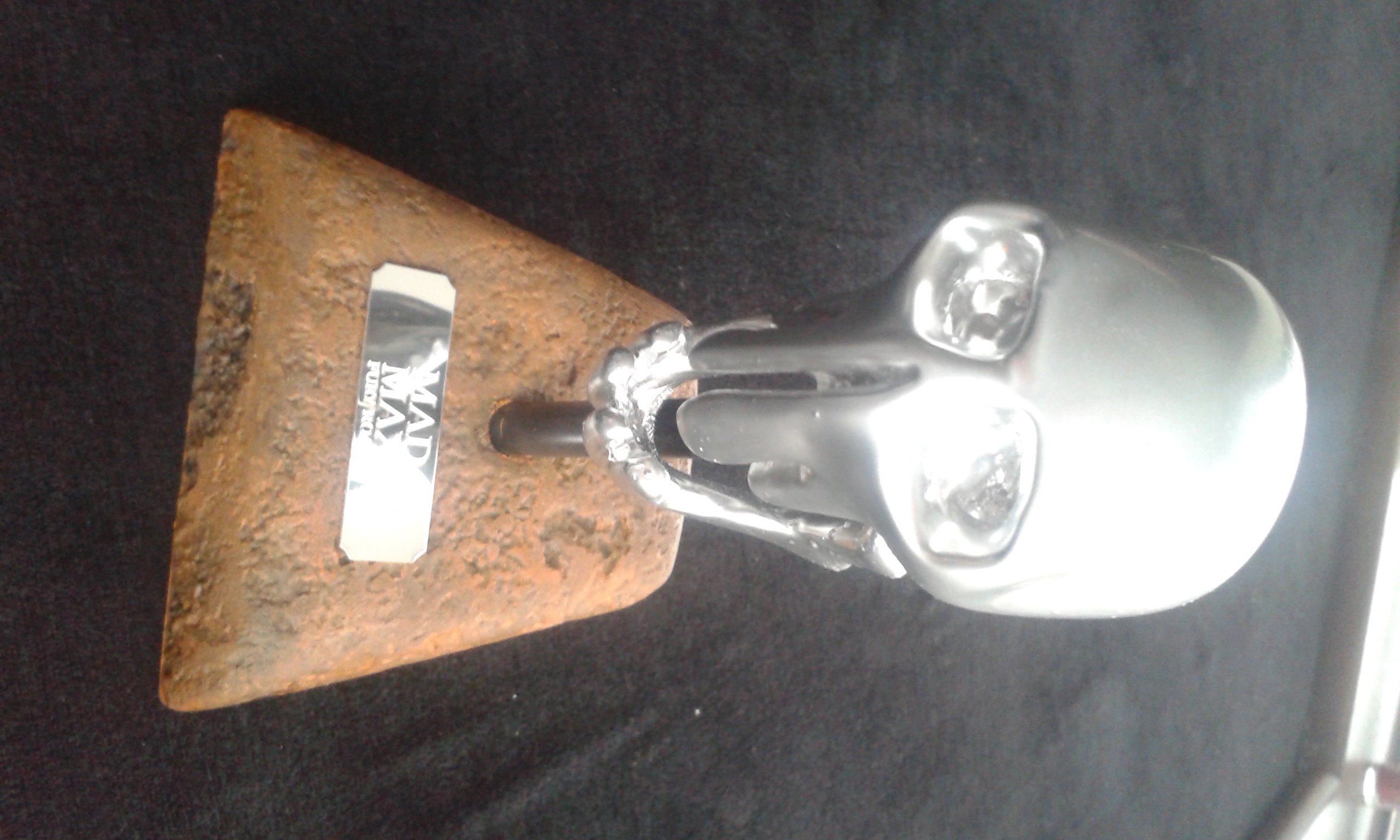

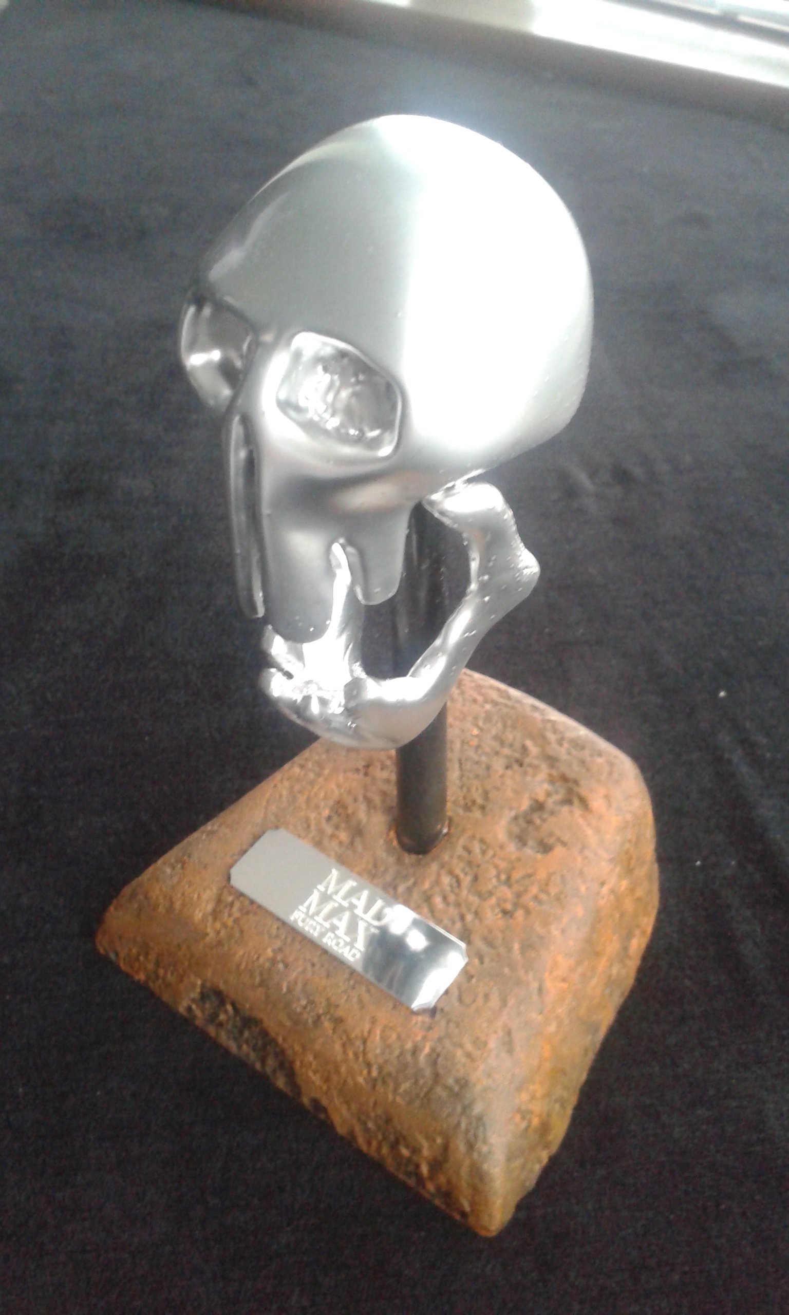

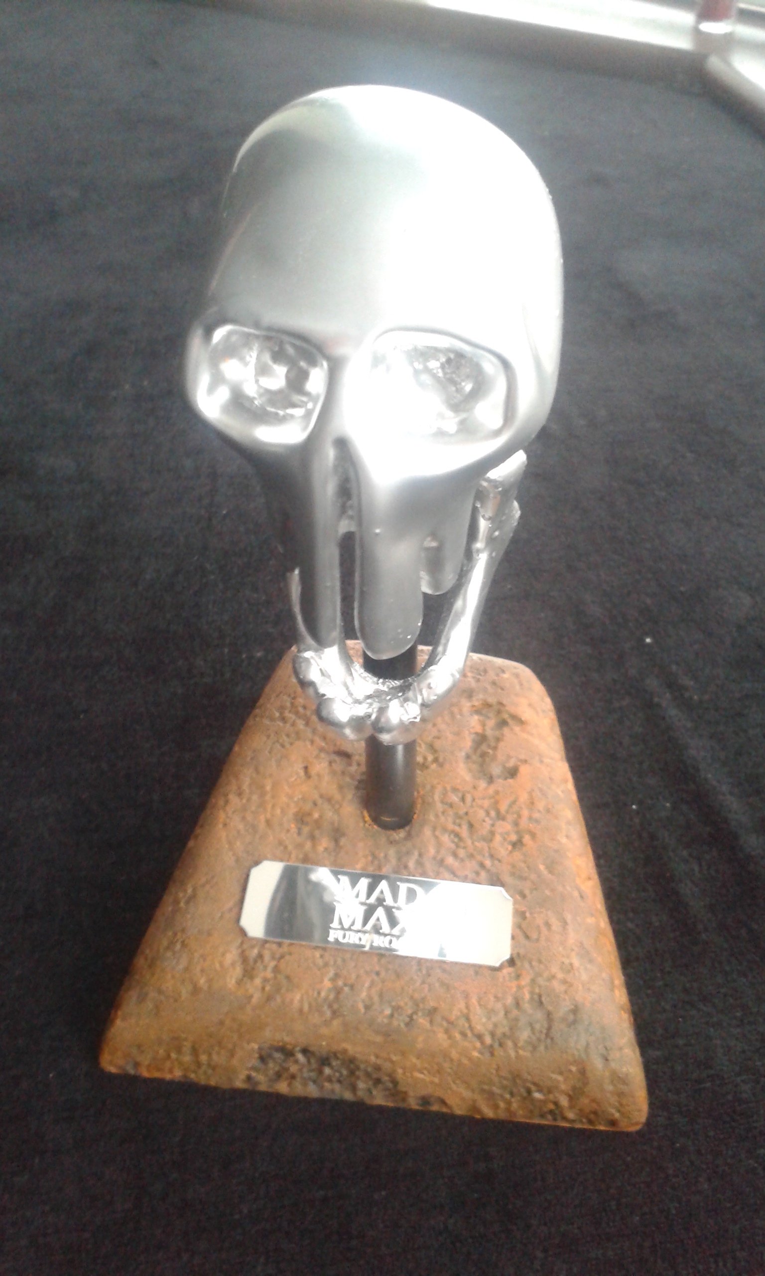

also started the stand today not sure to finish it in a leather or rusty effect?
that's the stand finished, a mdf base with body filler for the texture then dry brushed and washes and iv had a steel tag engraved.
still not happy with the chrome im gonna give the alclad ago.
sorry for the pic angle no matter what i did they still lay down in me
