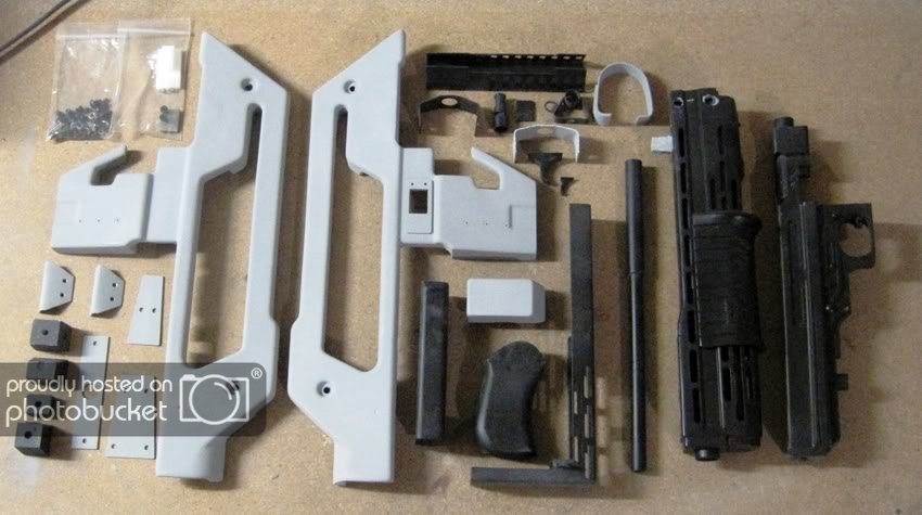

OK I’m finally ready to post some of my pulse rifle build details. This is taking a lot longer than I thought because I keep getting distracted with other projects.
I got this awesome kit from a member of the RPF.
HCG grenade launcher
Resin Thompson
Steel barrel vents
Steel stock
Resin Shrouds
Steel connector plates and screws
Attached the barrel vents to the grenade launcher, the grip and stock to the receiver and replaced the resin barrel with a steel pipe. Attached the stock, nice and long, because I have ling arms.
Test fit in the shrouds.
Test fit closed.
Now comes the hard part, attaching it all together solidly. I'm going to use magnets to hold the magazine in, and go with a fake counter for now.

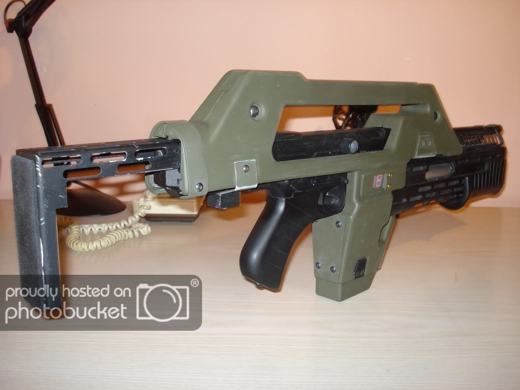

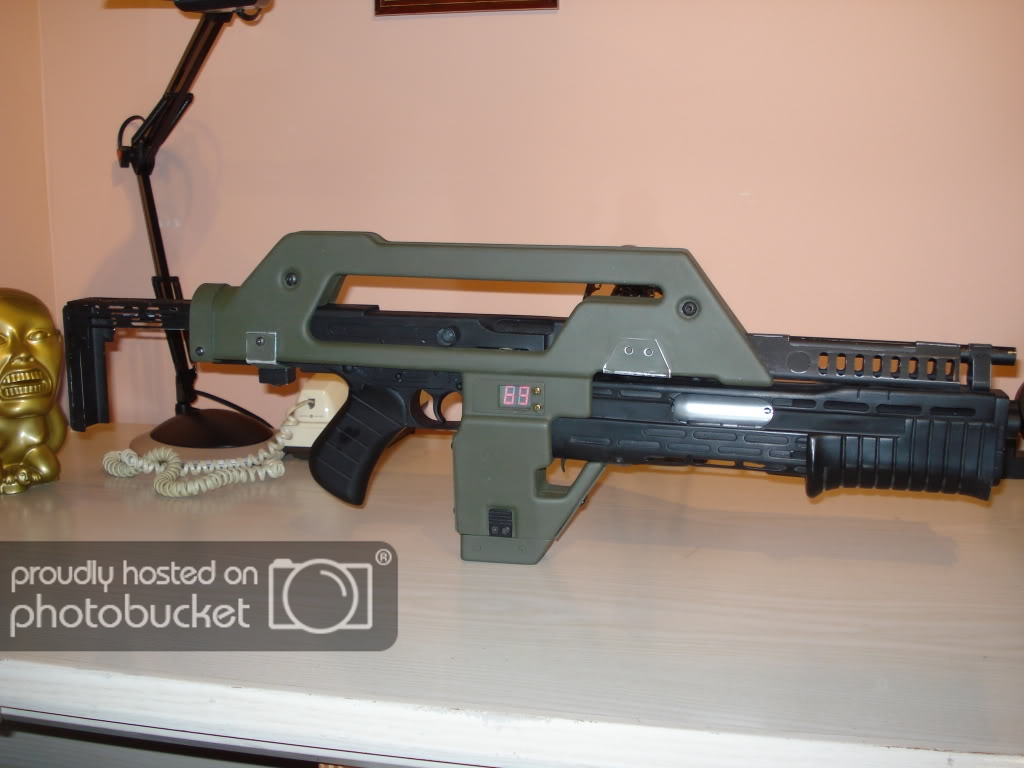

Ok I final finished this baby on the weekend! I might do a little more dry brush weathering on the shrouds and GL front. The counter is just a print-out, not sure I want to spend the bucks on an LED counter, I’d rather buy a VP-70 kit to add to the collection.Now I need to come up with a wall mount display, it’s too big for my shelves.

The large screws on the top of the shrouds actually thread into separate resin blocks (black blocks in the bottom left corner of the unbuilt pic) that fit into recesses in the shrouds. These blocks act as both pins to align both halves and prevent you from crushing the shrouds together. The 2 small plates on either side of the mag housing hold together the shrouds at the bottom, and 2 bent plate strips top and bottom on the back end hold tight around the stock. All the shroud connector plates are steel.
The hardest part of this build was making an aluminum bracket to support the GL under the front of the receiver. I used a steel pipe for the barrel which supports the GL at the front.
