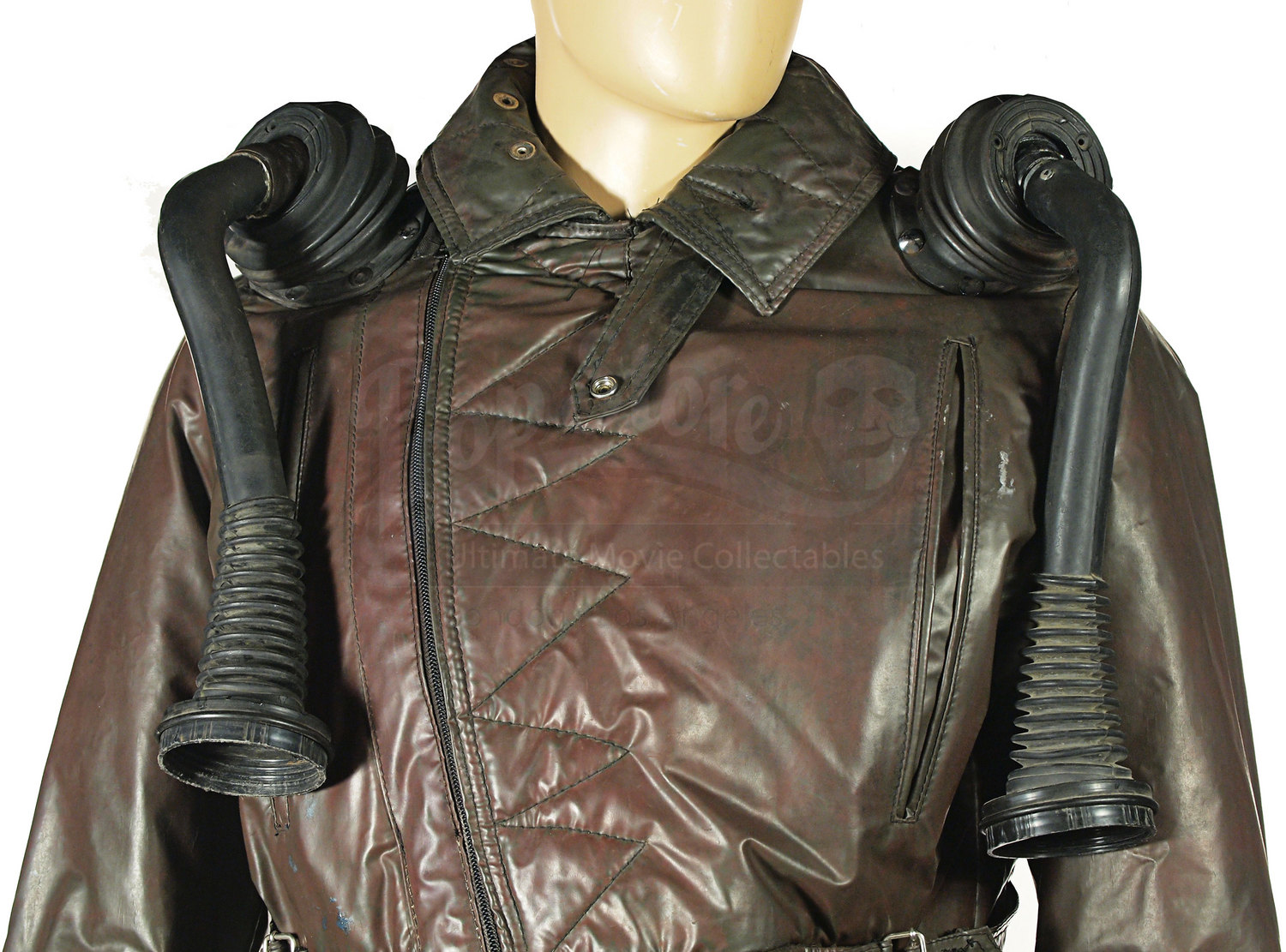

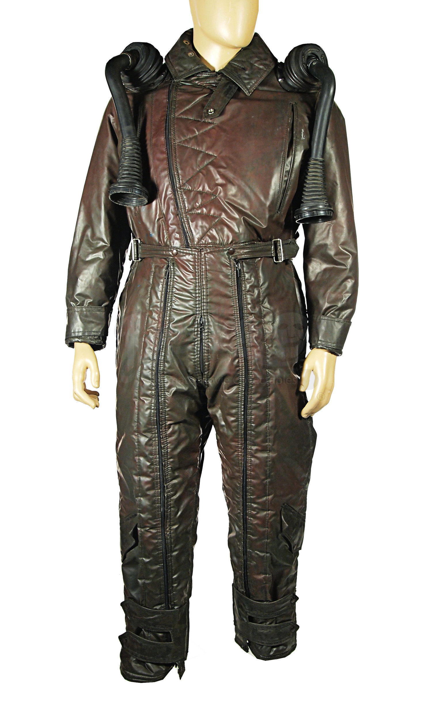

Nick, never seen those and never had the costumes pegged as that colour - fading with age? That's a very helpful look at the hosing too -very kind of you.
