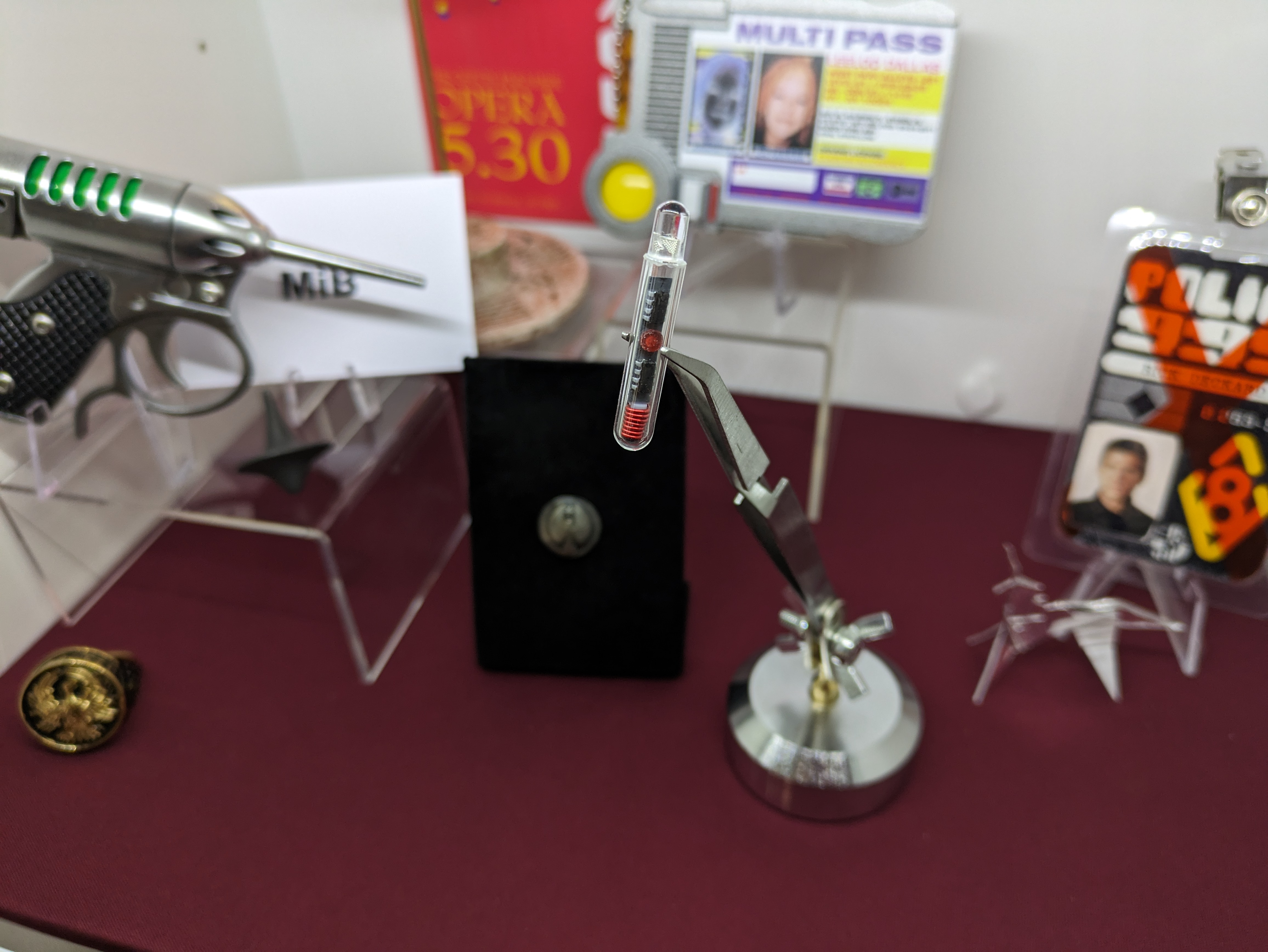

Parts for this project are starting to find their way to my lab so here is a quick sneak peak. I have identified all parts and 3D modelled the backer plate piece that everything inside the glass chip case is mounted to.

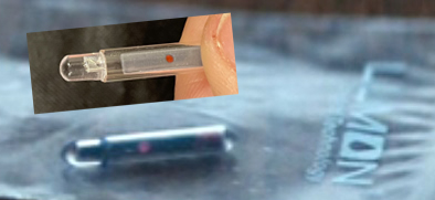

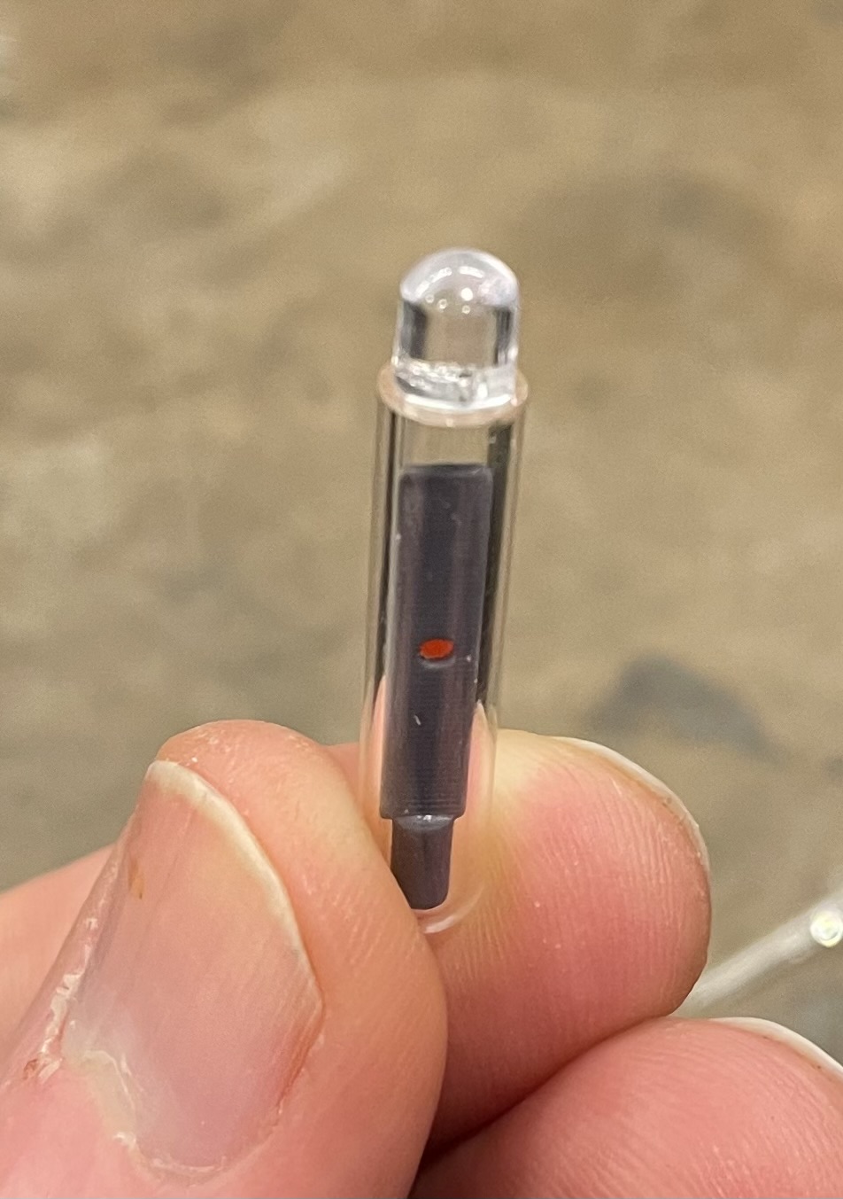

First test fit with the parts inside of the capsule. Once the copper coil is delivered to me I'll attach that to the main plate and test again. When the copper is installed it will force the plate to sit higher and it should eliminate the gap that you see between the end of the capsule and the capsule end cap.
The next test fit will also have a slightly longer glass cap as mine isn't quite tall enough. Here's a side by side:
To make these available I really need to do a couple of things. First, I need to find someone that can laser cut the middle red disc. It’s 1mm thick frosted red. Second, I need to work on the black microchips. They may not be a found item, but more needs to be done to clean them up. I’m super happy with the copper coils. So more to come!

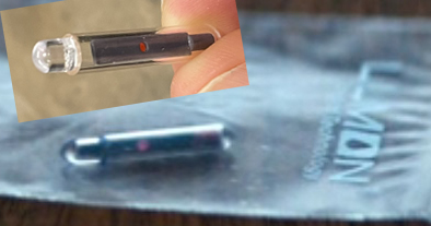

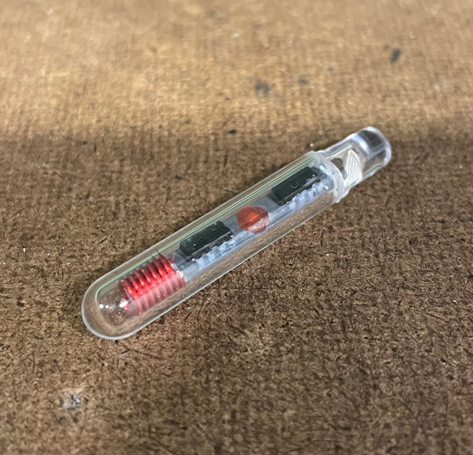

A lot of trial and error today but I'm super satisfied with the final results. I would feel good about offering these to folks now. Only catch is, the non-necklace version is very fragile. The "cap" is only able to be glued on and there's just not a lot of room to secure it really well. The necklace version doesn't get the cap, so it's super sturdy. Here's my version of the Severance "sevy" brain chip:
Man this is really outstanding! You really outdid yourself on this. What material is the “tube” component of the chip made of? Is glass or plastic? A++ :love:(y)

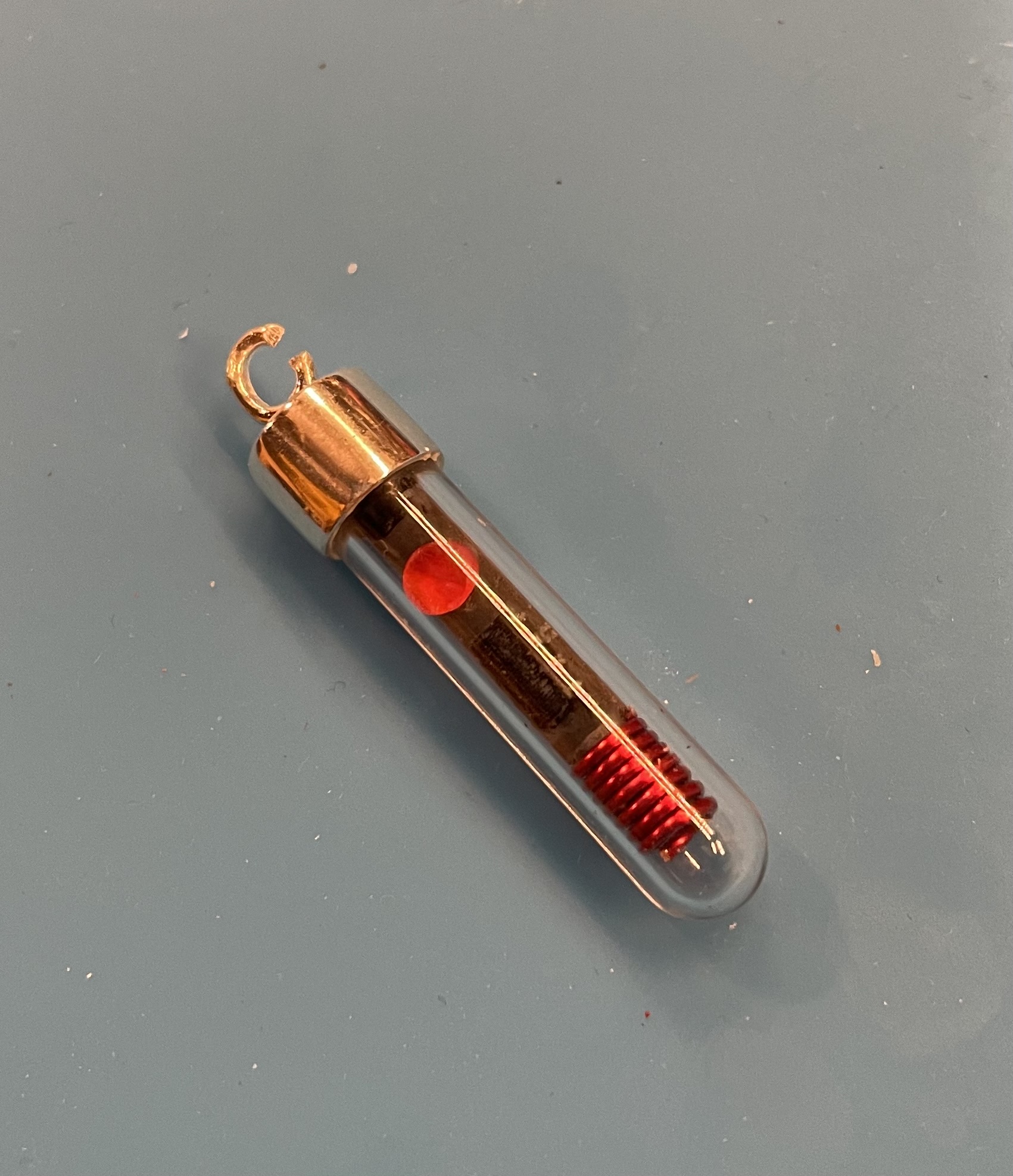

The main tube is glass. The tube cap is clear acrylic. The circuit board that everything mounts to is 3D printed, as are the black microchips. The coil is wound by hand and the red led is a real led filed down to fit. Takes about 2 hours or so to make one, but I could cut that down if I did them assembly line style. I have a chain link necklace coming my way to scale the link size for Kobel’s chip necklace. Once I have that I’ll be putting a few up on my Etsy page.
The tolerances for this thing are bonkers, lol. There’s about 3.5mm inside diameter to work with on these tubes. The whole thing crams inside really tight. It’s a little nerve racking trying to get it all inside the tube.
