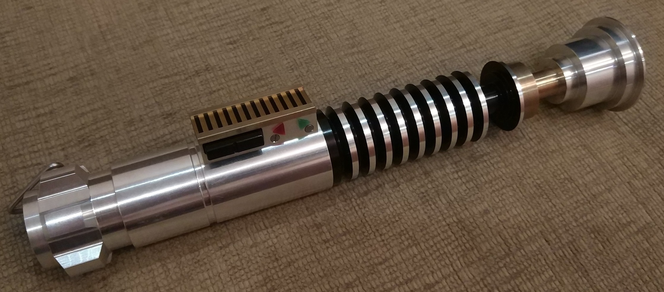

It's ready to ship now!
If you want to buy it - please fill in the order form. There are also photos and additional information.
https://goo.gl/forms/Ig1ESU1GL5o5ImPo1
All of the hilts were sold. If you want this saber, wait for the 2nd run!

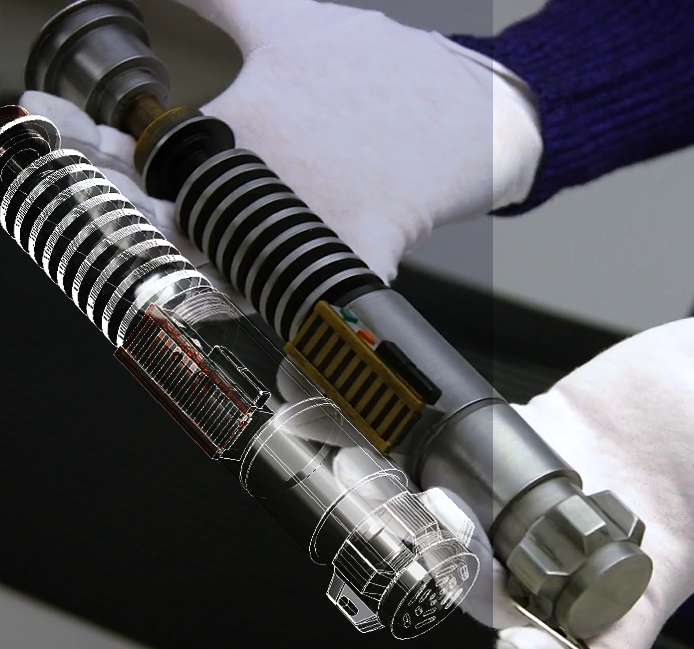

I want to start a new run of Luke's authentic TLJ lightsaber. I worked for weeks for this project to make it as close as possible to the original one from the movie.
It will be ready to install electronics inside, it will be made of anosized aluminum, brass and steel using CNC.
«What's the difference between TLJ and ROTJ?» I can explain:
1. Emitter: there is an additional step with holes that (which will remain when you insert the blade). The second and third steps of this detail have increased by 10-20%. The diameter of the last step increased and the diameter of the largest section became the same as in the grenade section.
2. "Copper part": diameter in a thin place decreased, the length of this section increased. Well, now this segment has brass color (looks like oxidizing brass).
3. Grenade section: the diameter of the first ring has become the same as the main part. Increased the diameter of the black step under the first ring. All other rings have the same width and its wider than in the ROTJ-version. Reduced the length of the thinnest section.
4. The main body, including the pommel cubes: the linear dimensions are slightly changed, the main changes in the part with the cubes. They have become longer, the angle of the faces has changed. Ribs became symmetrical (longitudinal angles of slope of faces). Previously, one of the edges stood on the axis with the control box. Now all this part is rotated left about the axis. Also, between these ribs appeared flat milled surfaces (previously there was a radius milling). The triangular ring has moved one edge to the left. The ring itself increased in size and decreased in diameter. The plug diminished slightly in length.
5. Control box: the height was reduced (as I see it), the green and red arrow became bigger, the screws disappeared (as this panel, where there were screws and diodes at all) - now everything is made in a single block without partitions. The button has become single with a small V-shaped sample in the middle, all faces are now rounded, the button itself become smaller in all directions. The copper part is now also brass, its eaves are reduced in comparison with the usual ones. The Box plate has 13 golden stripes.

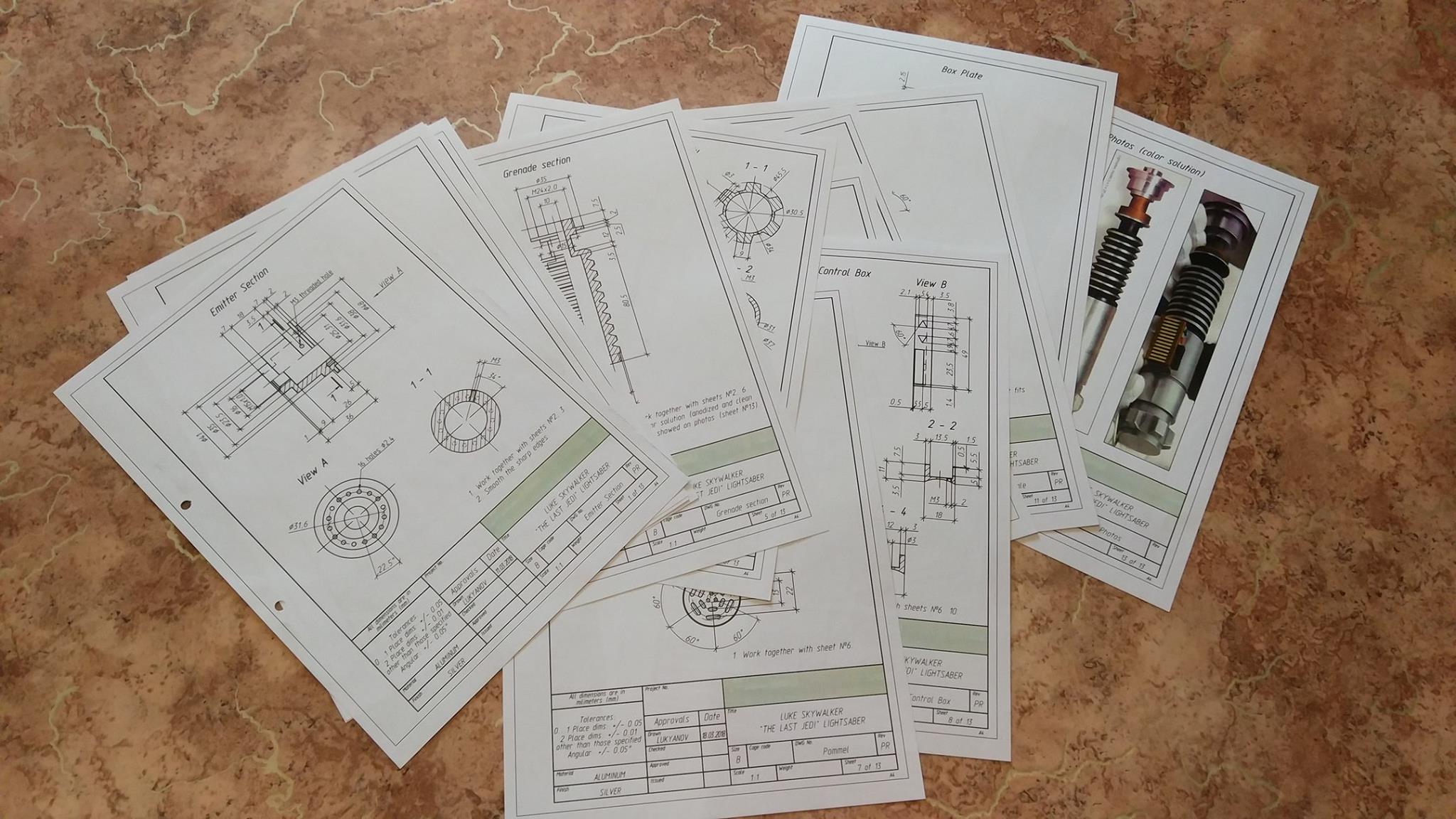

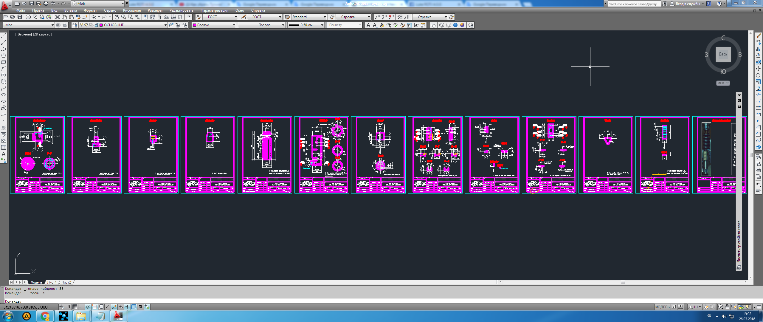

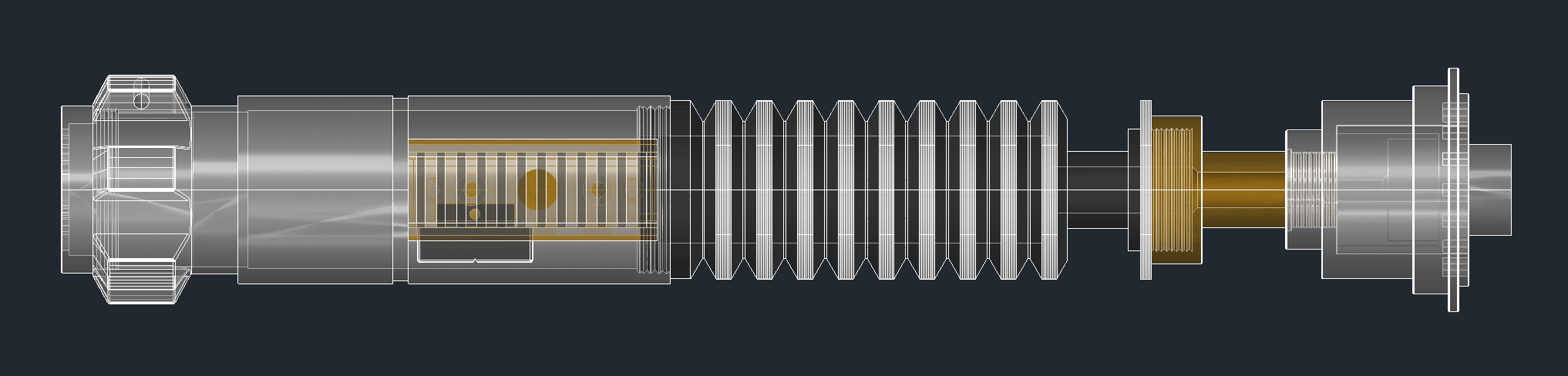

I have tried to take account of changes in my drawings:

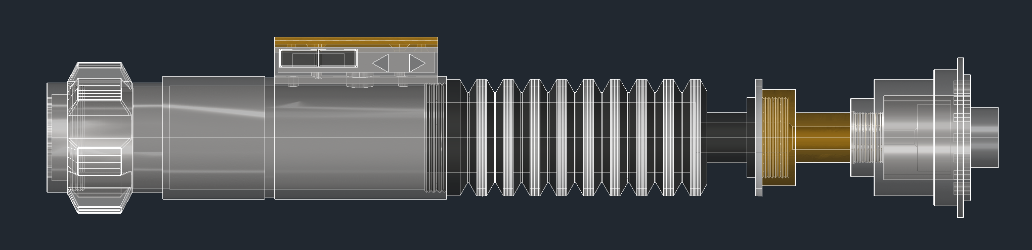

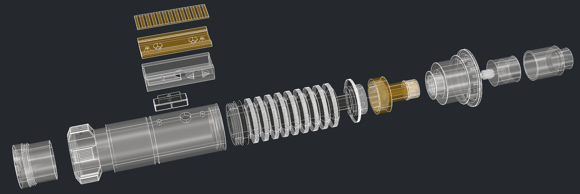

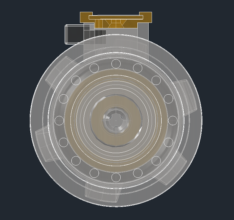

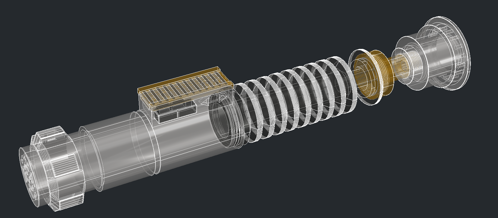

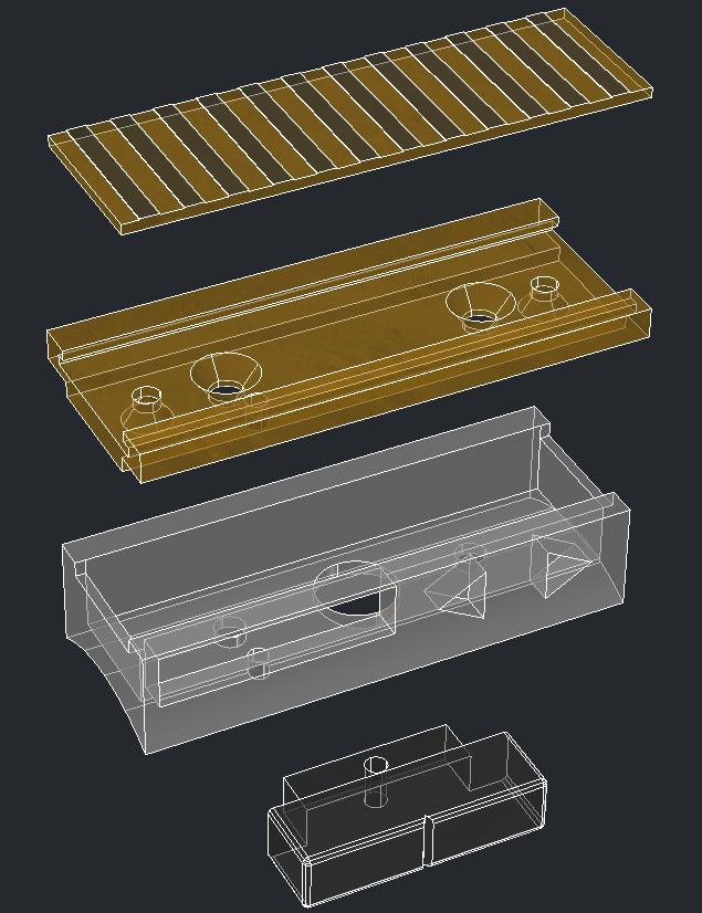

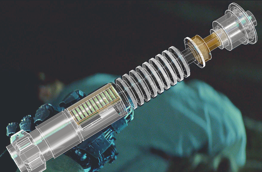

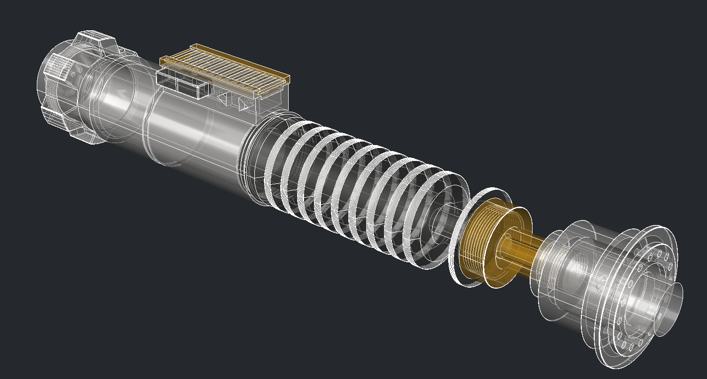

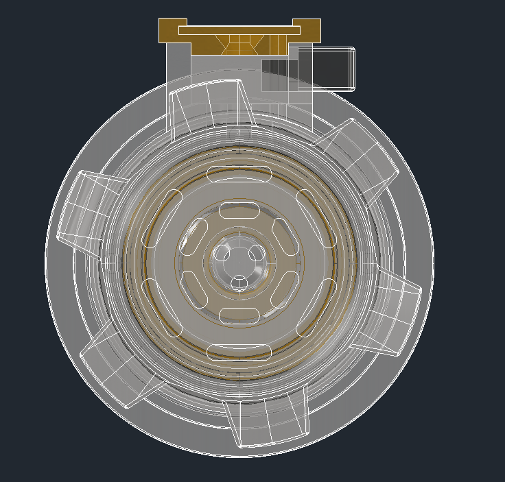

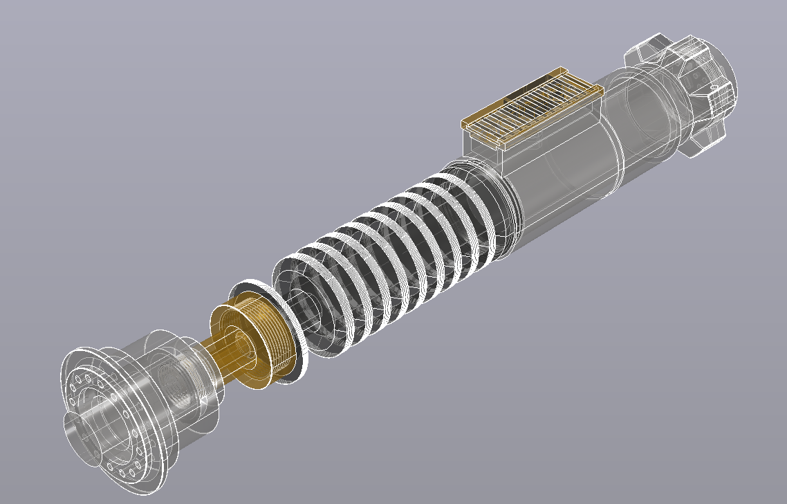

These screenshots are made from my 3D model, which I recreated in the accuracy of my drawings:
View attachment 805233 View attachment 805237

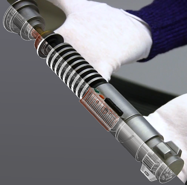

View attachment 805245 View attachment 805249 View attachment 805248 View attachment 805252 View attachment 805251 View attachment 805250 View attachment 805244
View attachment 805246 View attachment 805247 View attachment 805253
View attachment 805258View attachment 805259 View attachment 805260
