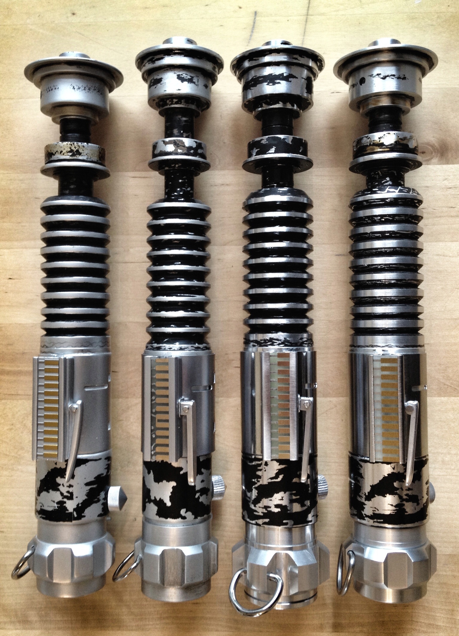

So Dan ... you do realise that to be able to recreate an ANH casted stunt you need a seperate nipple in the kit? I'd love to make an OB1/Luke shared stunt as well as an accurate V2 ... - note to self - need to start saving a.s.a.p. or sell a kidney and a liver :wacko
