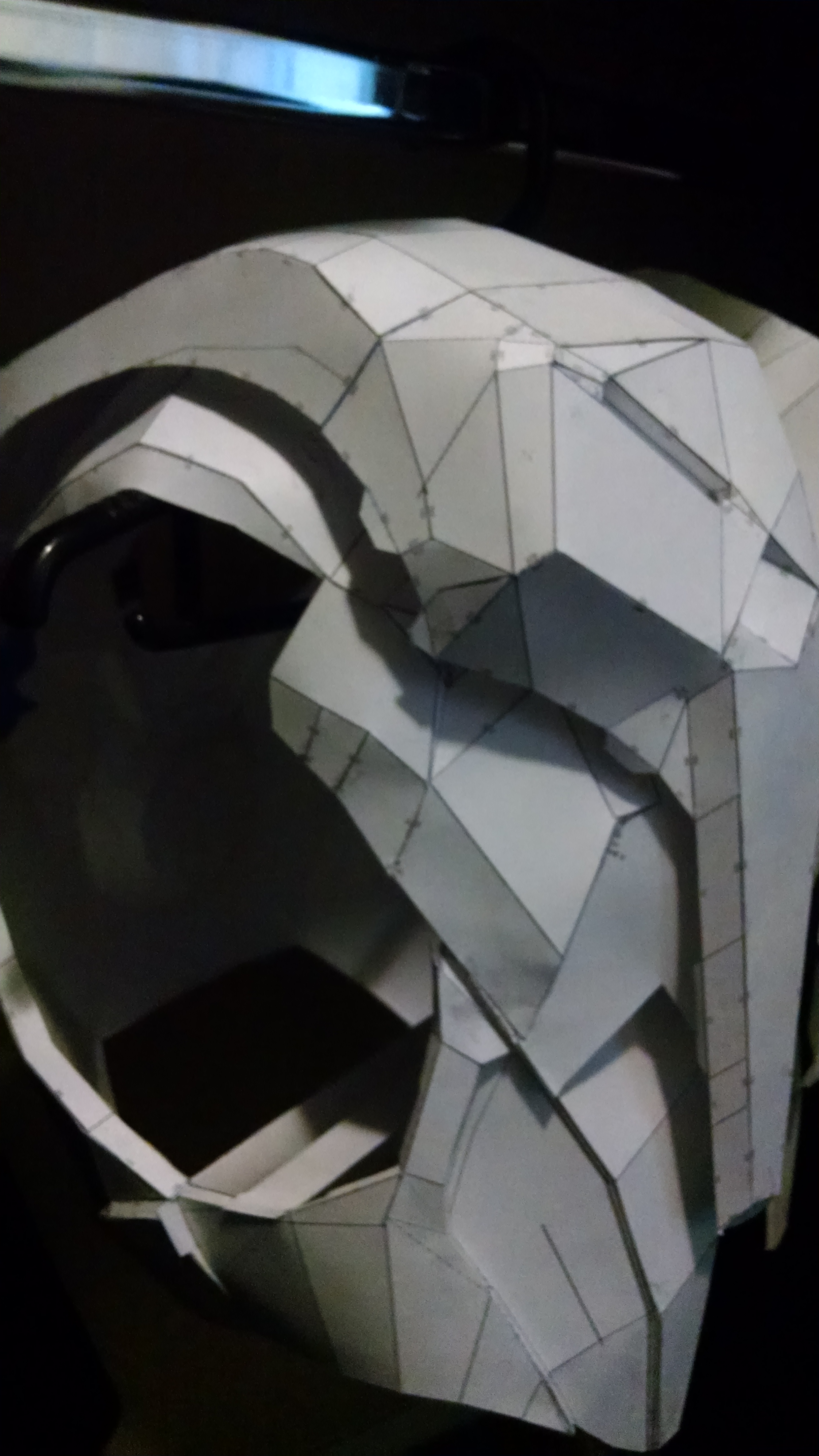

Helmet: Omarbou1 (eventually--gonna be last item on my build list)
Neck: Omarbou1 (possibly foam)

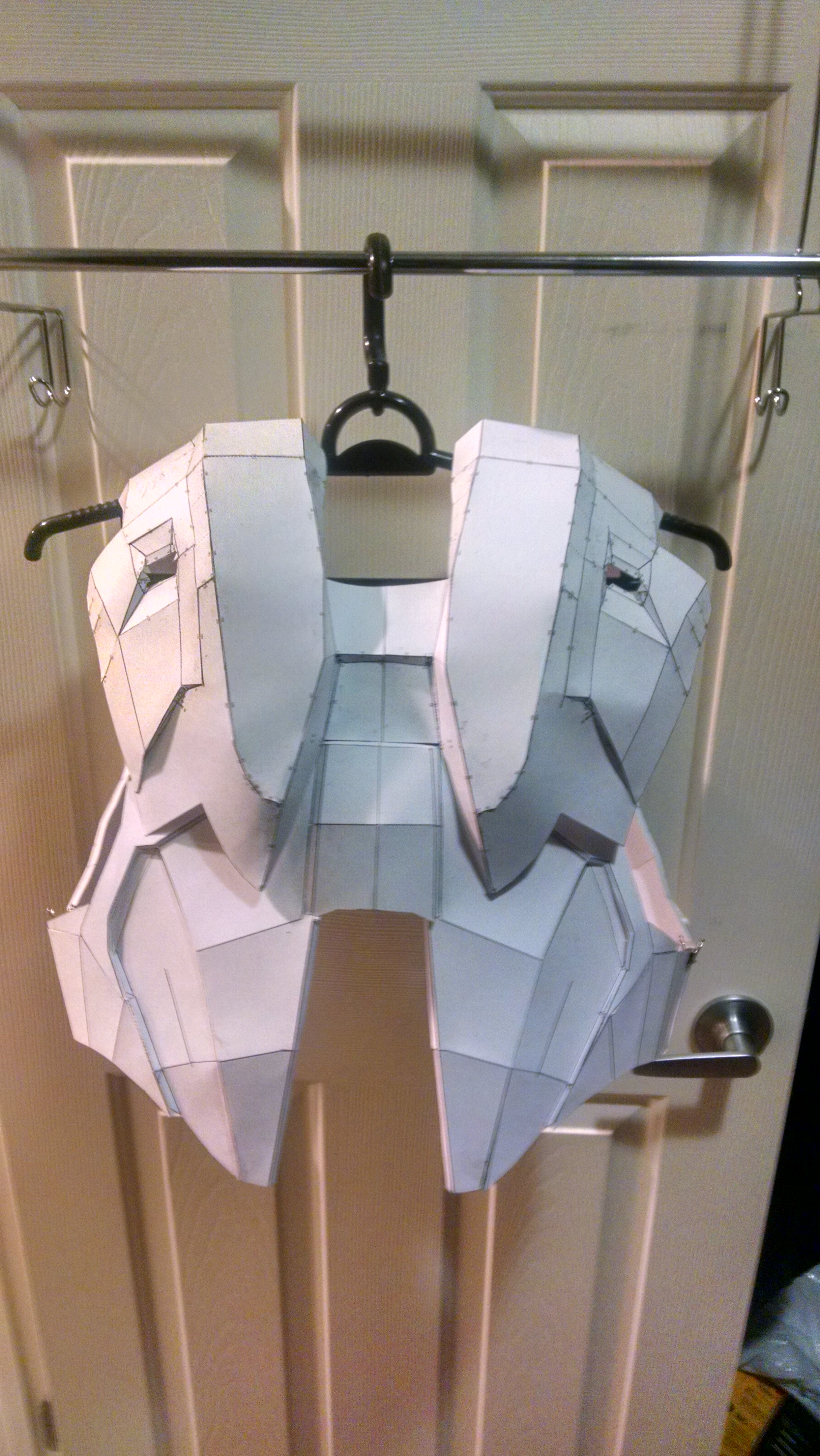

So I started with the Gaitron model and figured out a scale that fits me. (It's a nightmare for me because I'm only 5'2" so scale something shorter and it becomes too tight to fit in.) Once I figured out the Gaitron back & chest, the key was to figure out how to fit the KS back in there.

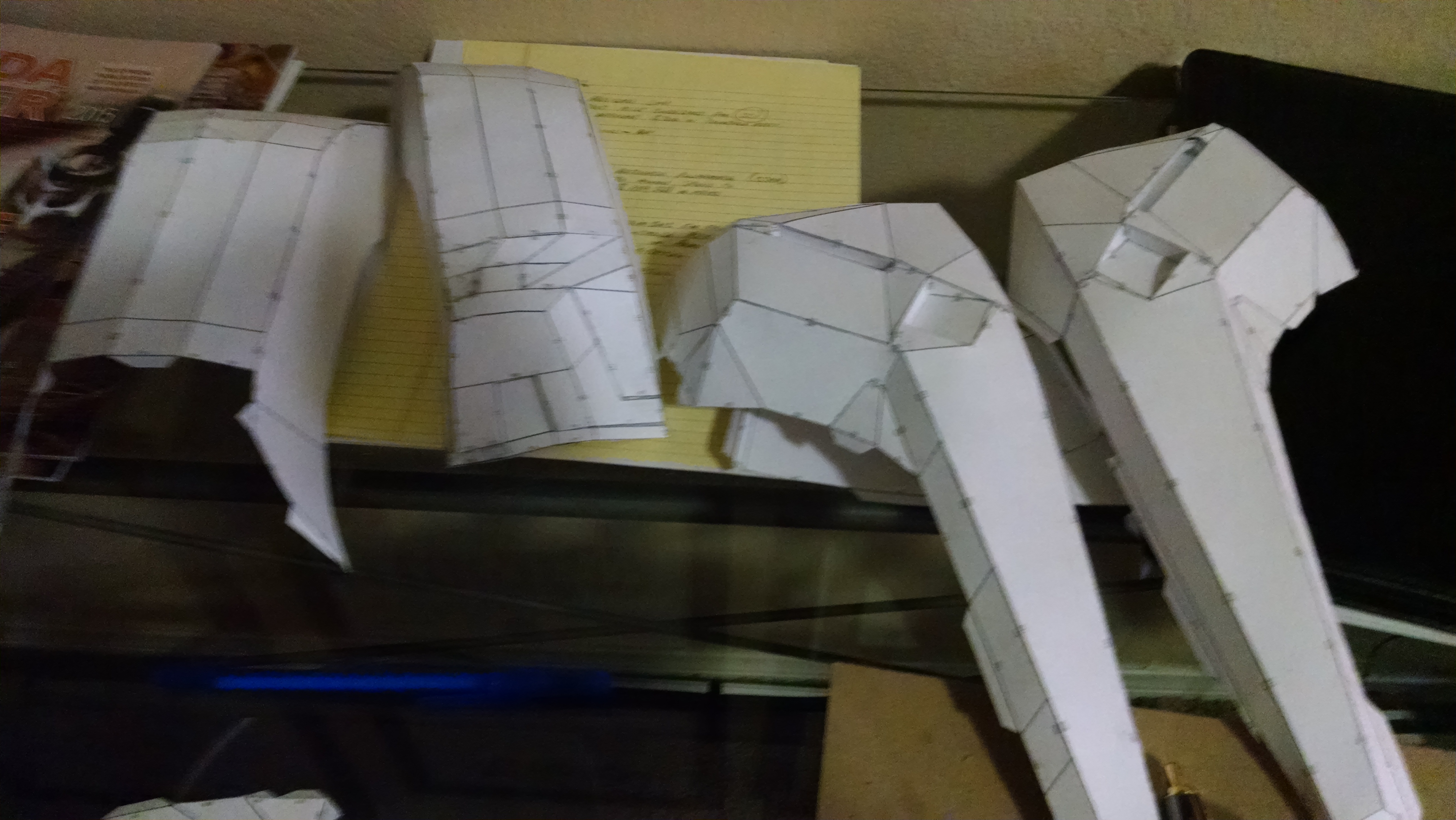

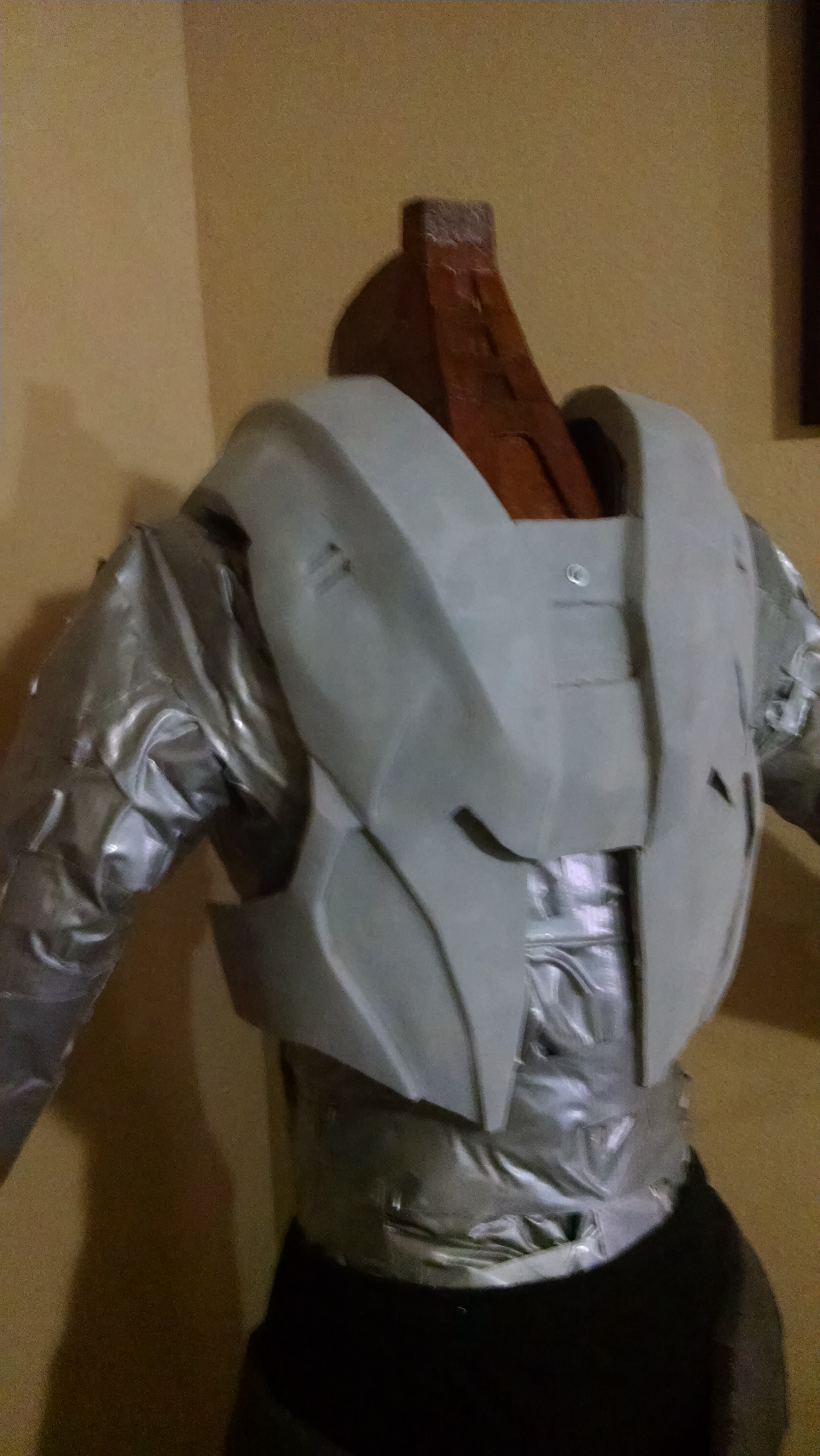

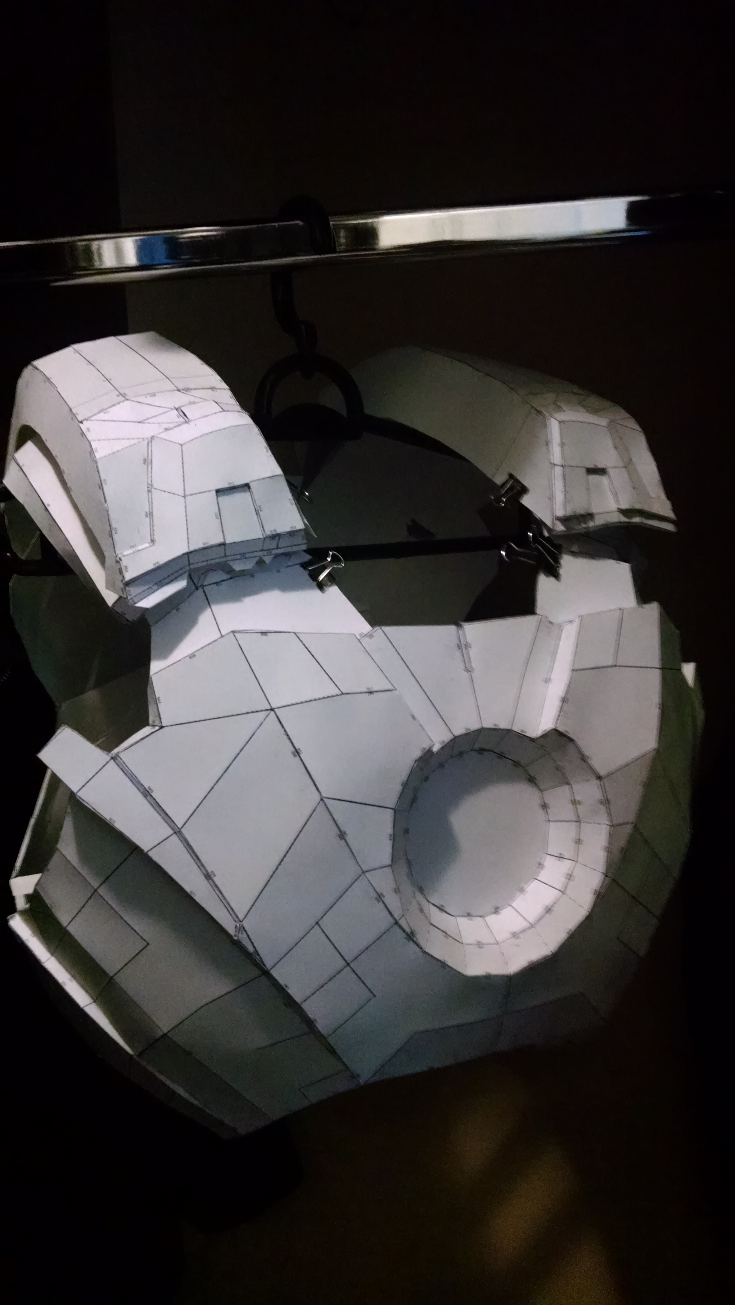

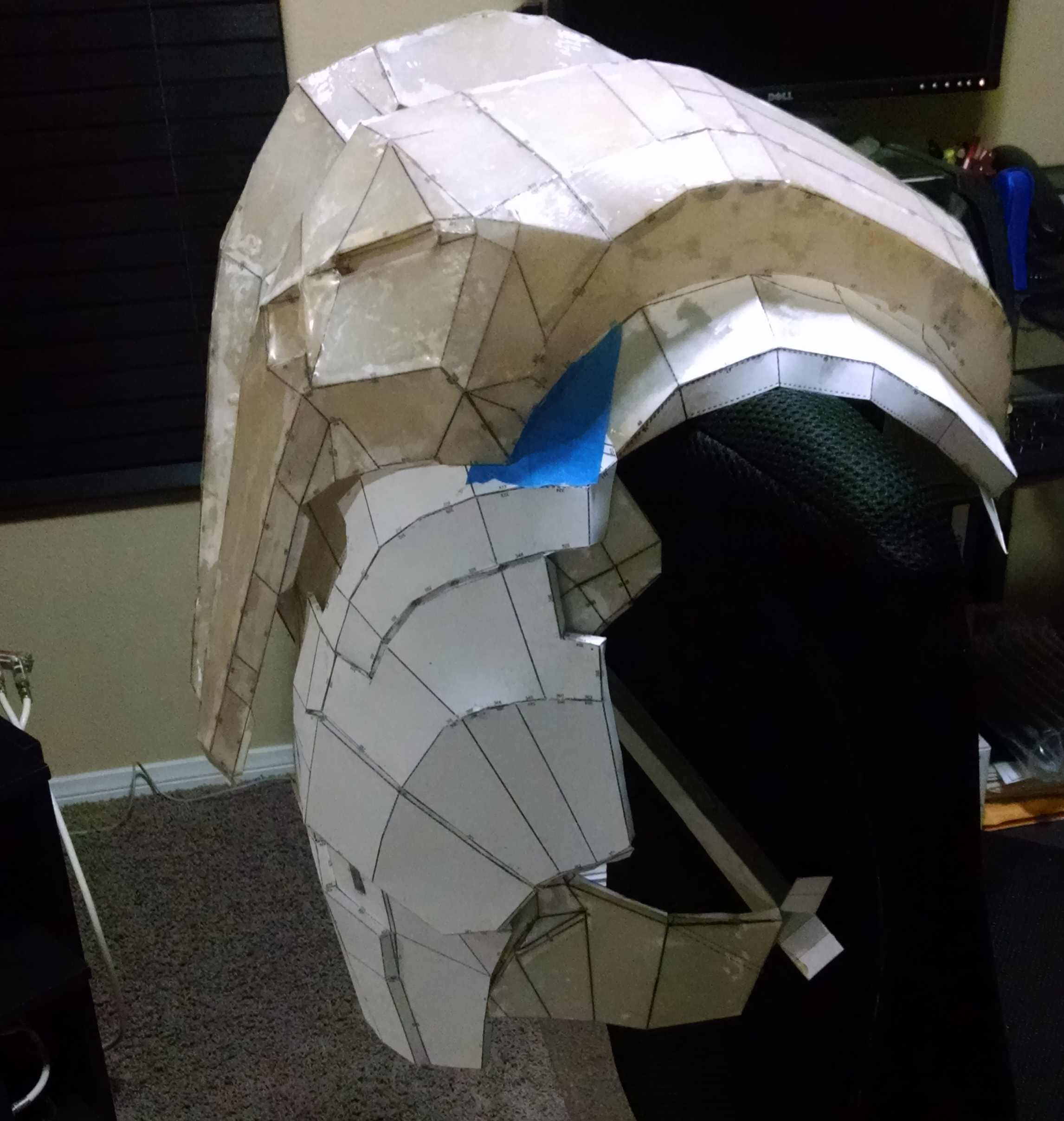

IMG_20150225_230826809.jpg IMG_20150210_174511665_HDR.jpg IMG_20150305_243758240.jpg

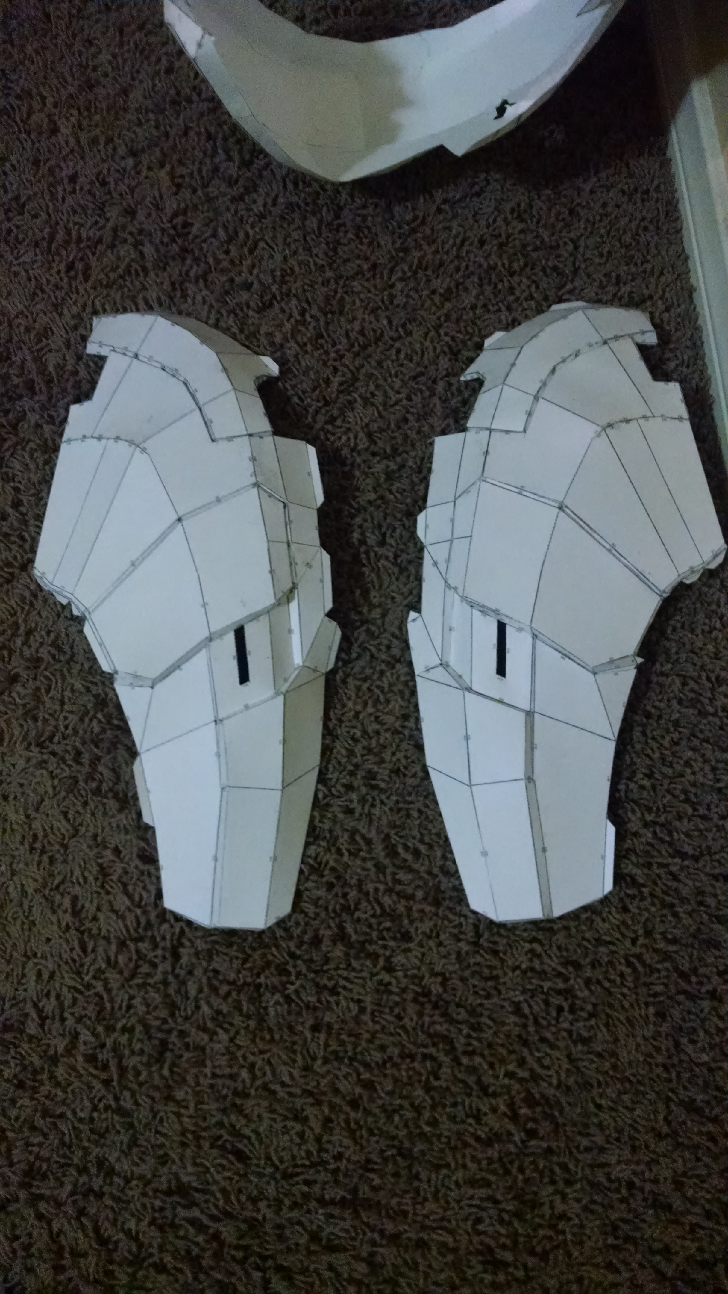

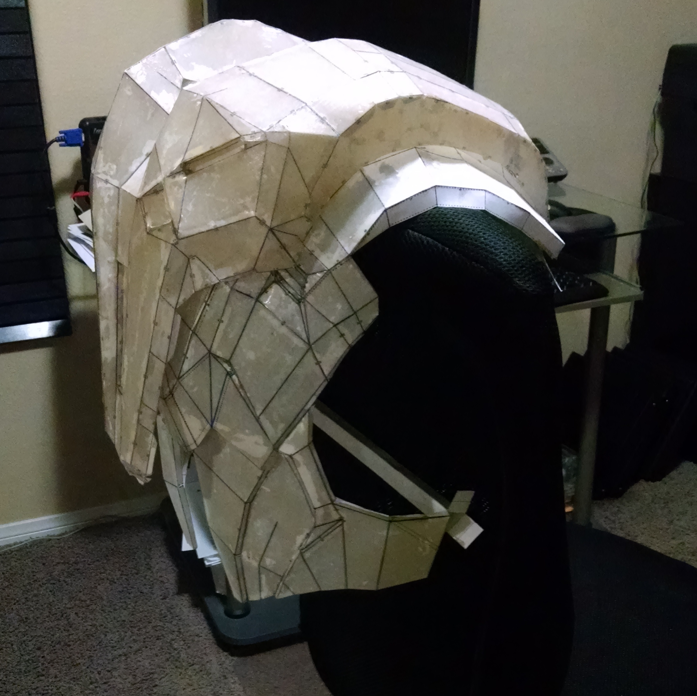

IMG_20150226_171453949.jpg IMG_20150226_171516395.jpg IMG_20150311_155309812.jpg IMG_20150311_160841702_HDR.jpg

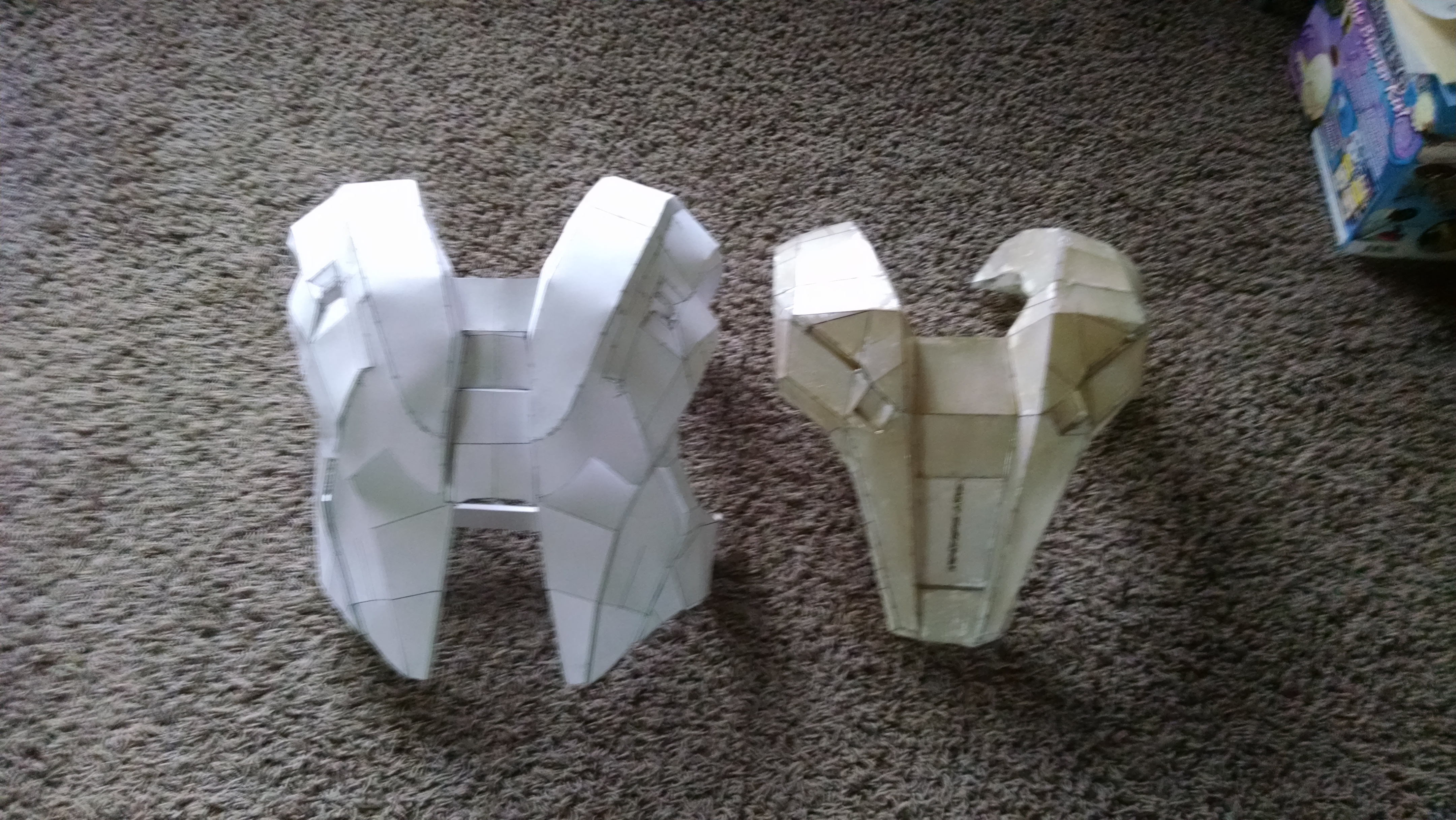

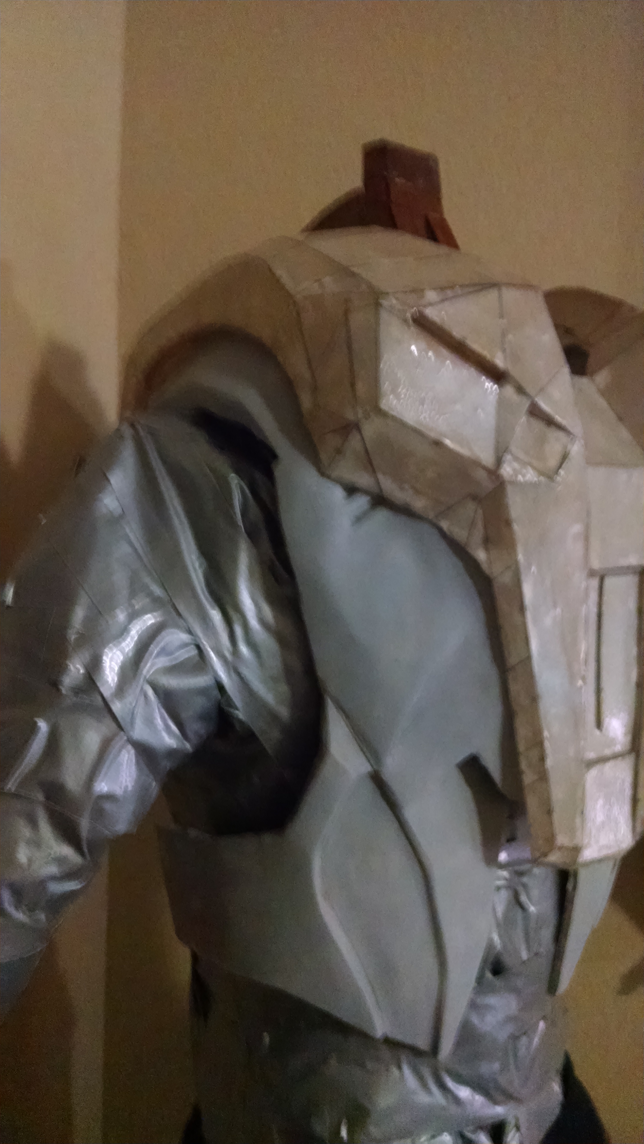

So I built the Gaitron model out of paper (the pieces are in the pepakura file--you just need to move things around). I tried cardboard at first, but because cardboard doesn't want to bend, and will only bend one way, it's really hard for trying to make two models fit to each other. So I built the booster pack from paper, then made the KS back out of paper and attached it to the Gaitron chest and kept increasing/decreasing KS pieces until I found one that fit. It was a bunch of trial and error (a lot of damn error) until I had a KS back that fit the chest and the Gaitron back.
So here's where I'm at so far. The pieces appear to fit ok, after the first couple rounds of resin and glassing. Hopefully the bondo and sanding part will cooperate.

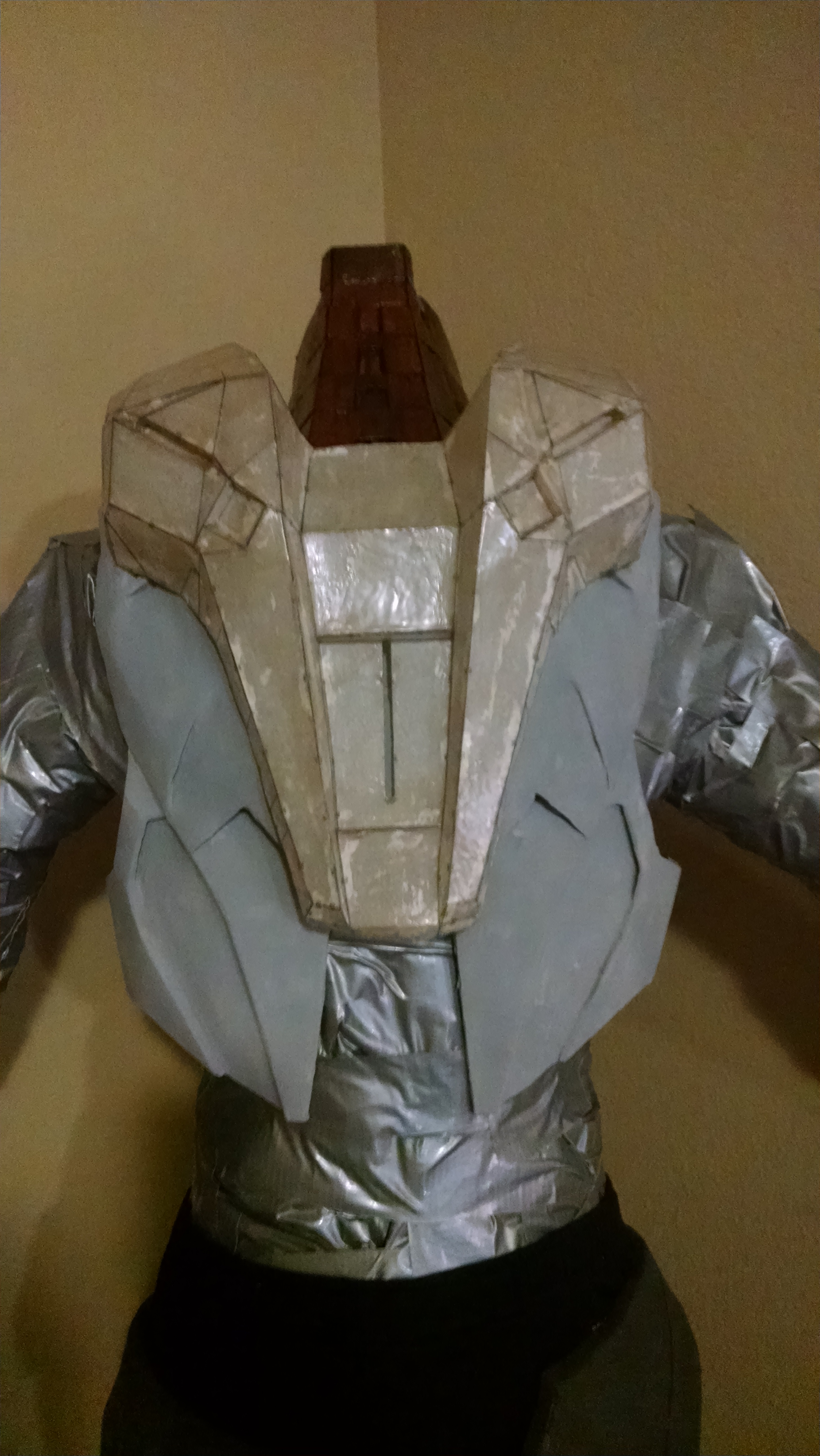

IMG_20150313_224336935.jpg IMG_20150314_205027581.jpg IMG_20150314_205946936.jpg IMG_20150314_205957511.jpg

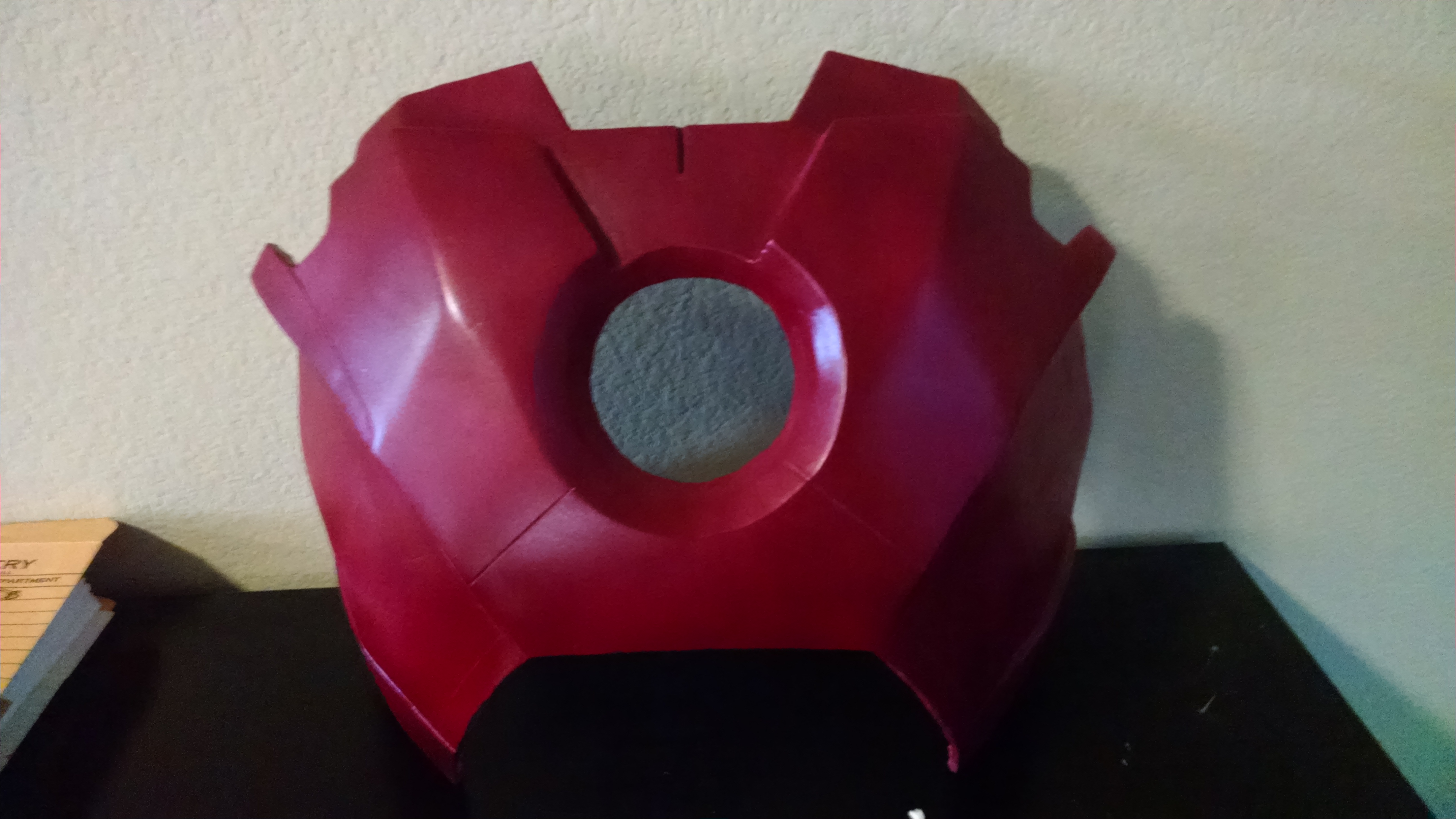

Updates! (I've been lagging--felt like trying a foam M43 for a change of pace):
IMG_20150404_193502391.jpg IMG_20150404_193627331.jpg IMG_20150404_193632584.jpg
Resin & Bondo stage looks ok. I still haven't decided on how I want to mount the booster pack. I'm thinking magnets of some kind. I'd like to be able to motorize them at some point, but there's not much room in the booster pack.

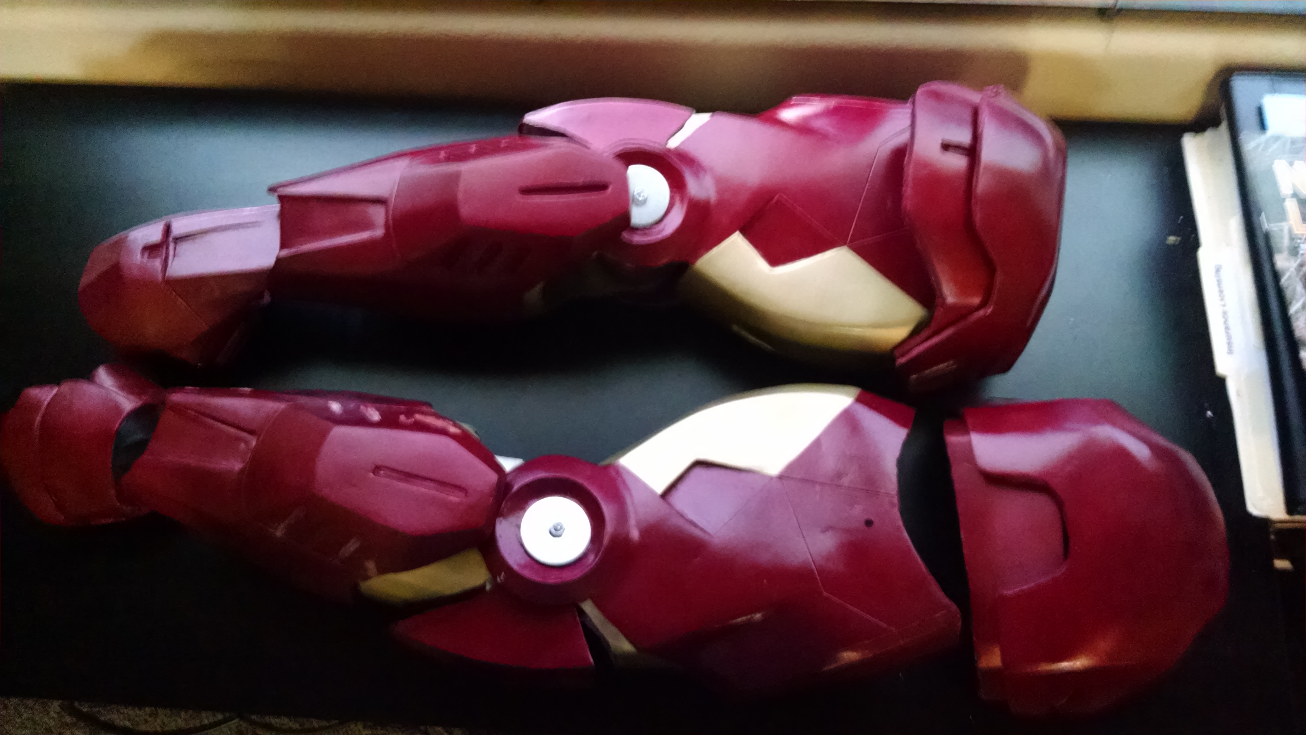

Some of the other parts are coming along ok:
