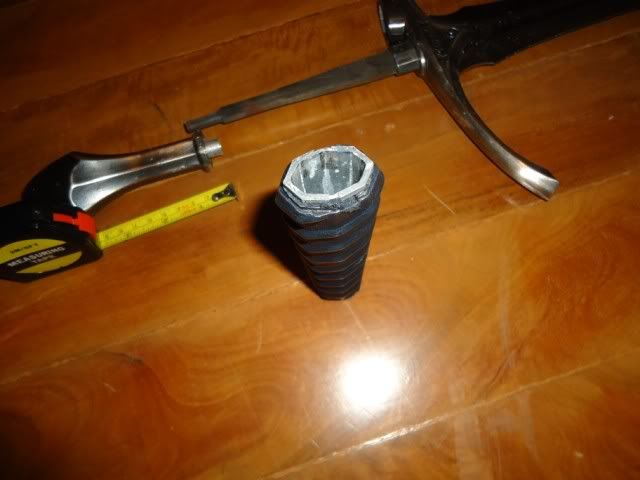

As you can see, the hilt shard is removable:
Here's a better look at the hilt shard. Pardon the lighting here - you can tell why I think the light correction sensor is going.

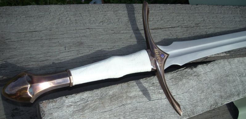

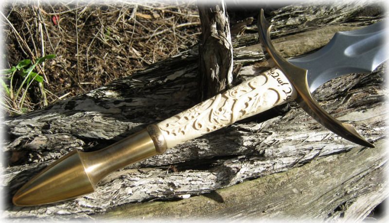

On shorter scent stopper pommels and historical examples, the pommel is slotted fully through and keyed to the shape of the narrowing tang, before the tang is peened over at the termination to rivet the assembly together. However, this becomes trickier to do with highly extended pommel forms like that found on Glamdring, unless the hilt components are made through investment casting.
The other option for extended pommels with radial symmetry is to do a screw-on construction, but done the RIGHT way. Screw-pommels need not be inherently weak, as long as the base of the pommel isn't acting as a fulcrum on the last few threaded centimeters. My friend Brendan Olszowy is a custom sword maker who employs this method for certain extended pommel forms.
In some cases I will use a screw on pommel rather than a keyed and peened pommel.

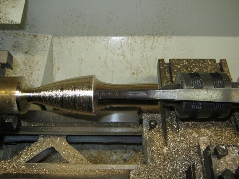

I do my screw on pommels so that the base 7/8" insertion of the pommel is sitting on 10mm x 6.5mm flatbar (3/8" x 1/4") - the threaded part of it is only deep in the pommel.
I forge the end of my tang into 3/8" rod, thread the end of it.
The pommel has a 7.5mm pilot hole drilled about 5cm deep. Then the outer 22mm is drilled out to 10mm. The deeper part is tapped out to the 3/8" UNC thread.
I Fit the tang to the pommel, and then grind the flats down so it can fit through a guard and grip without a big ugly pilot hole.
This technique gives a plenty strong base (fulcrum) for the pommel to sit on. Try bending some 3/8" bar with 2" of leverage. I managed to put a set in some such bar by hanging a 5kg weight plate off each side and pounding it down on a central fulcrum - no sword is ever going to transmit that much shock to a pommel base. Much stronger than the threaded rods the cheap makers are doing.

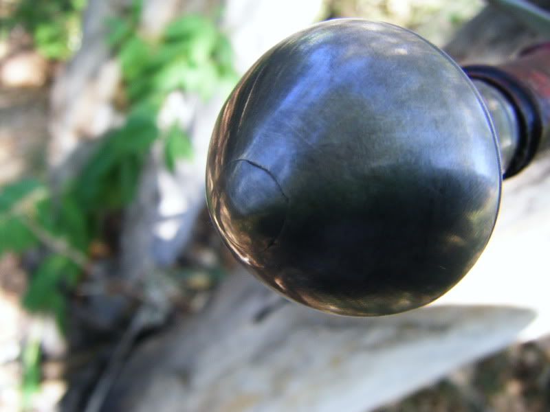

A pic here to show how the tang is positioned inside the pommel.
