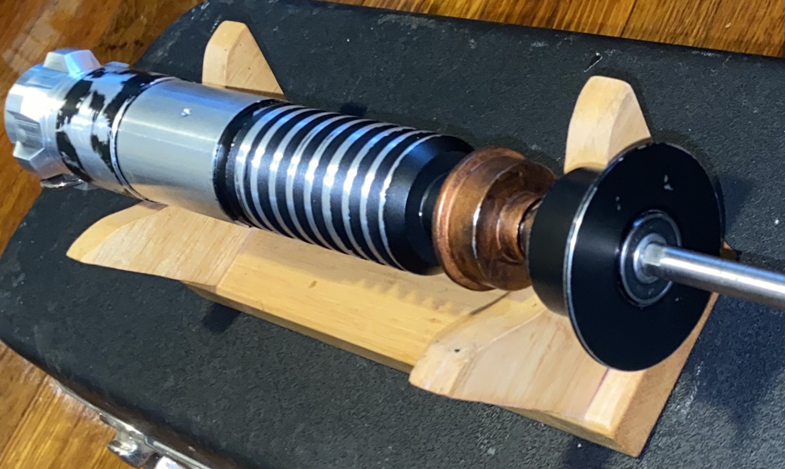

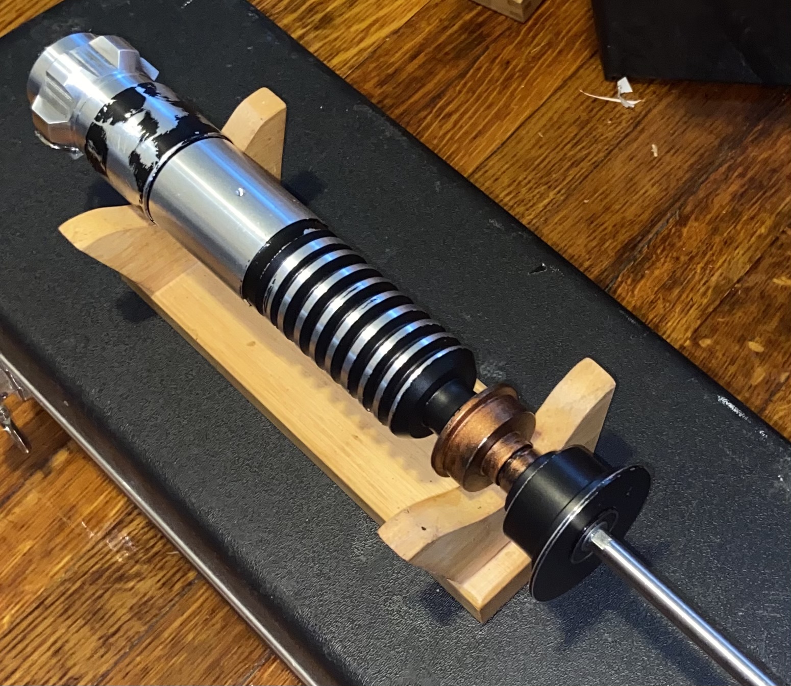

Thanks for the bearing info guys. Given the recess sizes & Johns's sketch I think there's a fair chance one was fitted to the V2 (for ANH) & maybe intended for the V3. Whether this proved necessary, as you say PPP, is a moot point for me as we're after reproducing the props.
Once again seriously impressive results PPP.
If it helps, the emitter recess being for a bearing... it works. That’s if you find one that exact size which they could have had

I had found a supply of 8x20xx bearings before - but of course now that I look again I can't find them :lol: I will try to find them again later today. I'll have to take another peak at that B&W photo again to check that attachment as well.. The V3 emitter has a pretty damaged joint, I think that at one point that emitter might have been attached to a hilt and broke off rather than being a spare casting, so the bearing would have been useful at one point. Definitely not with a spinning emitter though, ha!

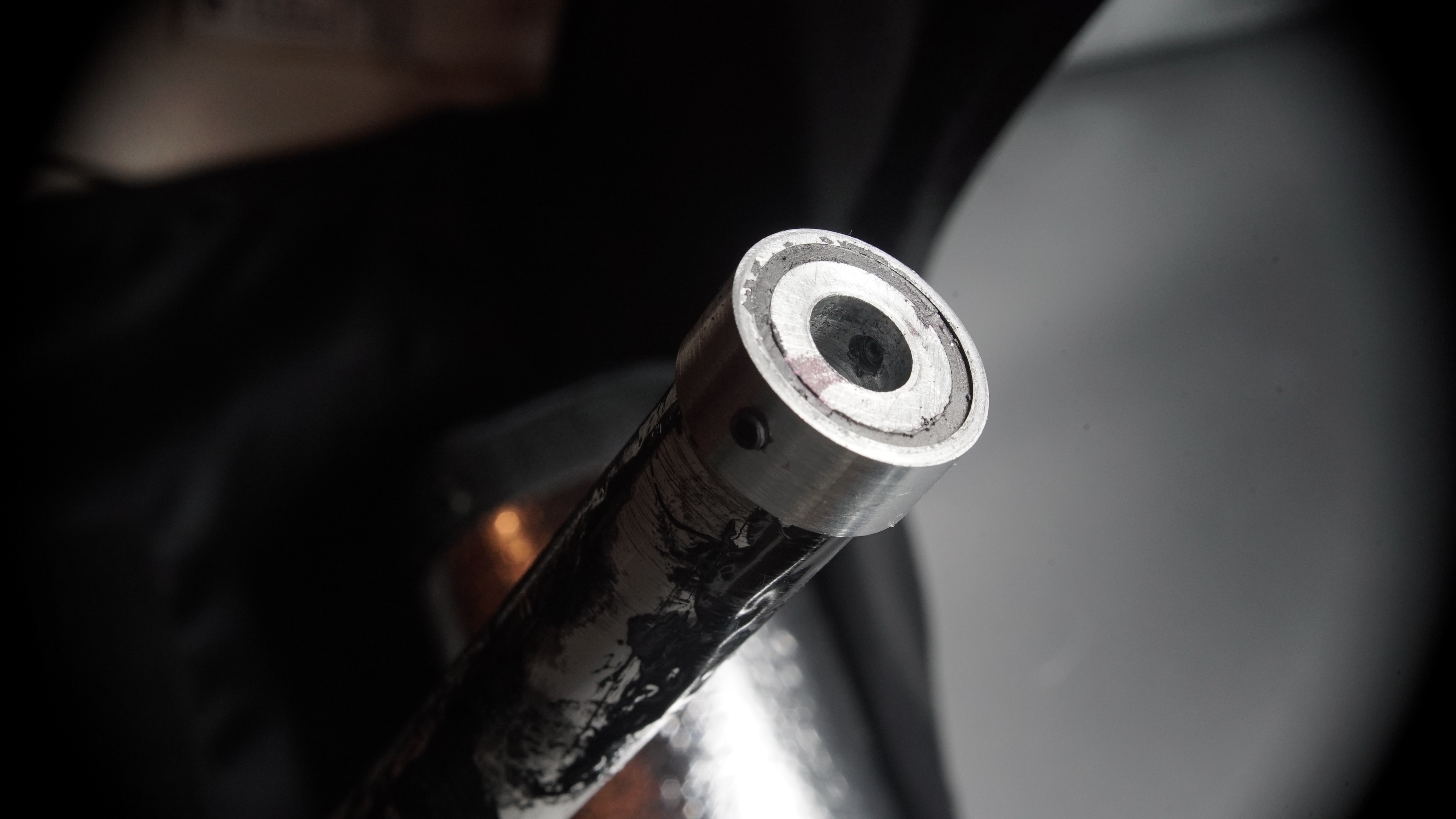

So.. i think, given how not true these casts are, its nigh impossible to drill straight through and end up where you want on the other side.. and making the neck wall thickness uneven. Cutting the emitter off is one sure fire way to be able to machine them, keeping the neck portion true and shortening the length of bore offset

Ain't that always the way? I used to get all my bearings from VXB but eBay has better value now that I know what to look for. Damn near impossible for me to find 8x20 when I was playing with my V3 set-ups. Always 9x20's or 8x22's..

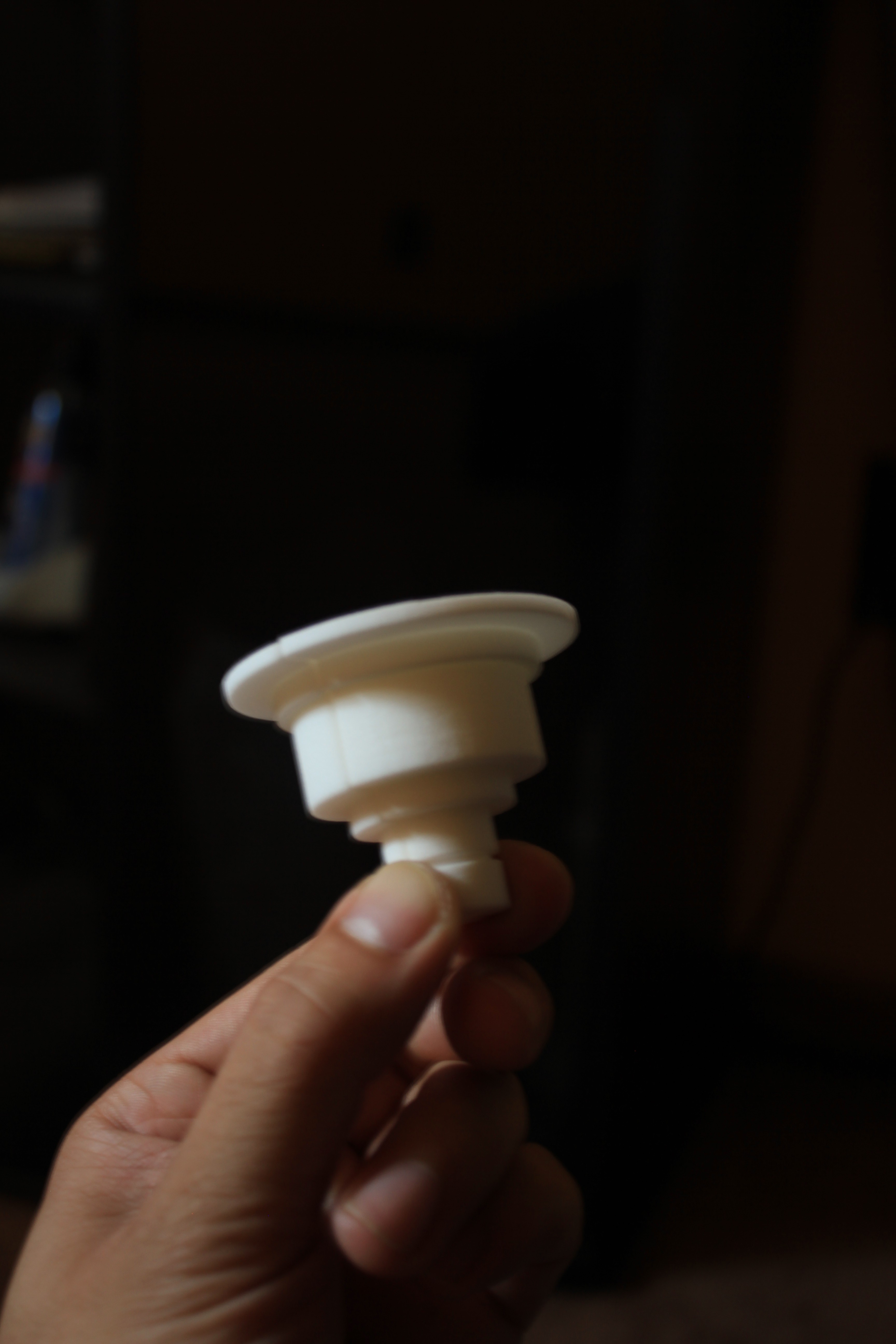

Quick update:
Decided to just go whole hog and cast separate emitters as well in my normal castings. But I can say that I absolutely hate Shapeways and all these other online 3D print and scan services. If it's not for industrial uses, they need to go.
This little piece would've cost me 70 USD had it not been for the sale Shapeways was having. Between my orders from them, I've spent enough for a decent 3D printer plus extra materials and accessories. I would've had full control over how my prints turn out! There's always something with these prints, sometime minor to not-so-minor.
I can't wait for the day when 3D printers come complete with a small scanning tool, print in ultra-fine print resolutions as a standard, are as affordable as inkjet printers, and Shapeways and them won't even be footnotes in history. They were a decent service at one point when the process was expensive but that time is quickly drawing to a close. They're nearly redundant now with how much better technology is getting and providing the ability for folks at home to do things like controlling the print quality.
I'm not saying it's been 2k down the drain but it was a very expensive lesson to learn.

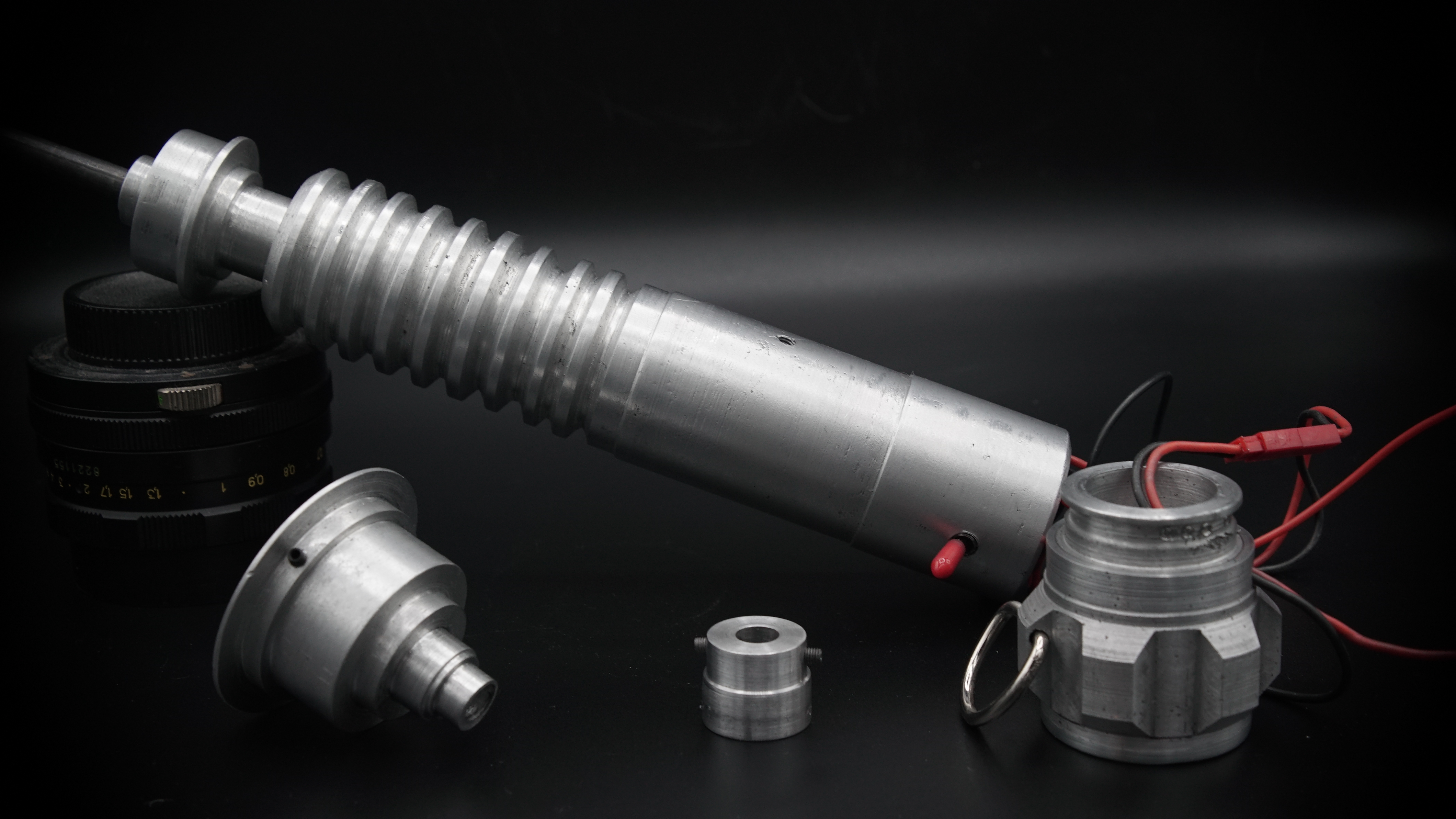

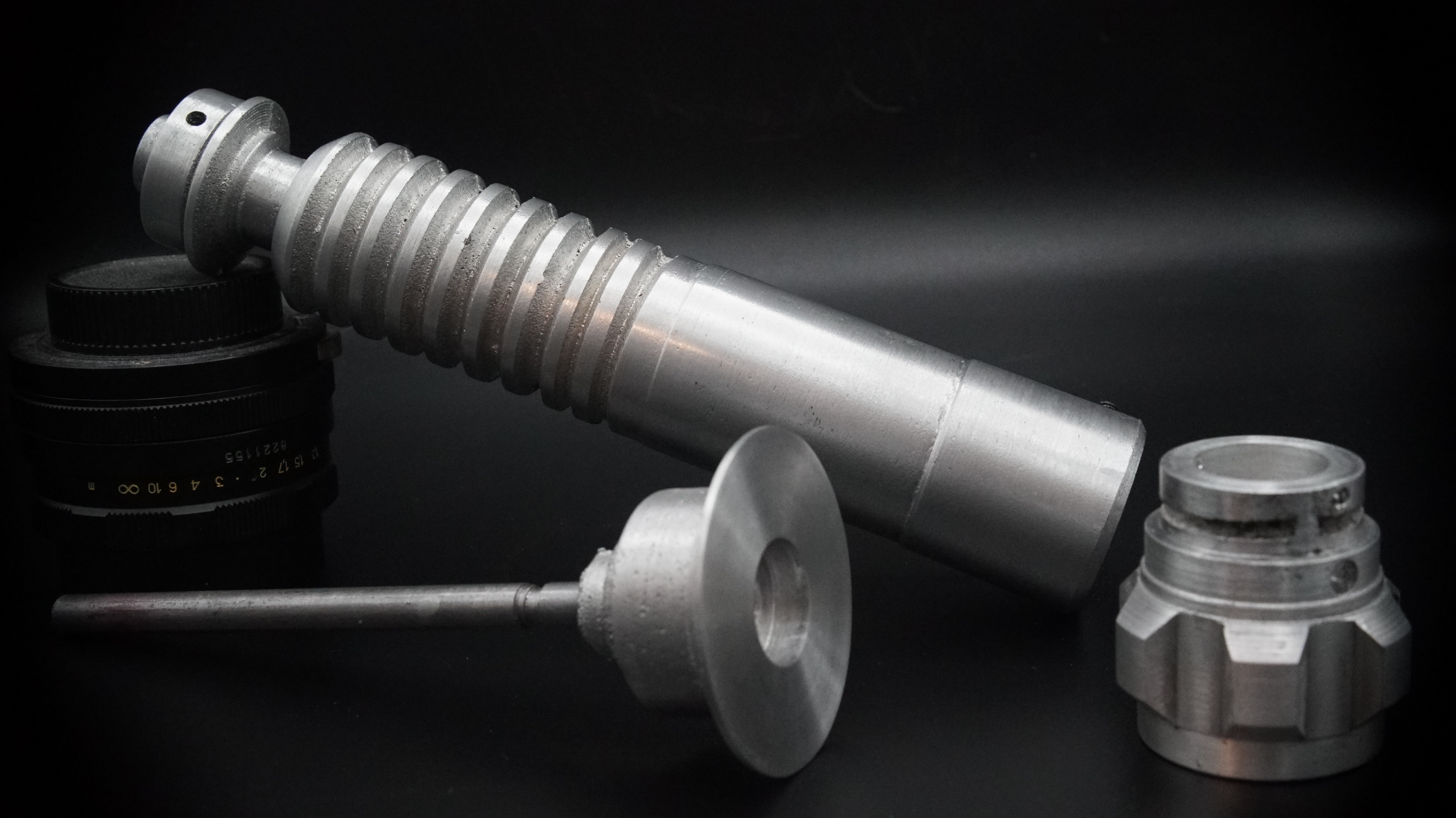

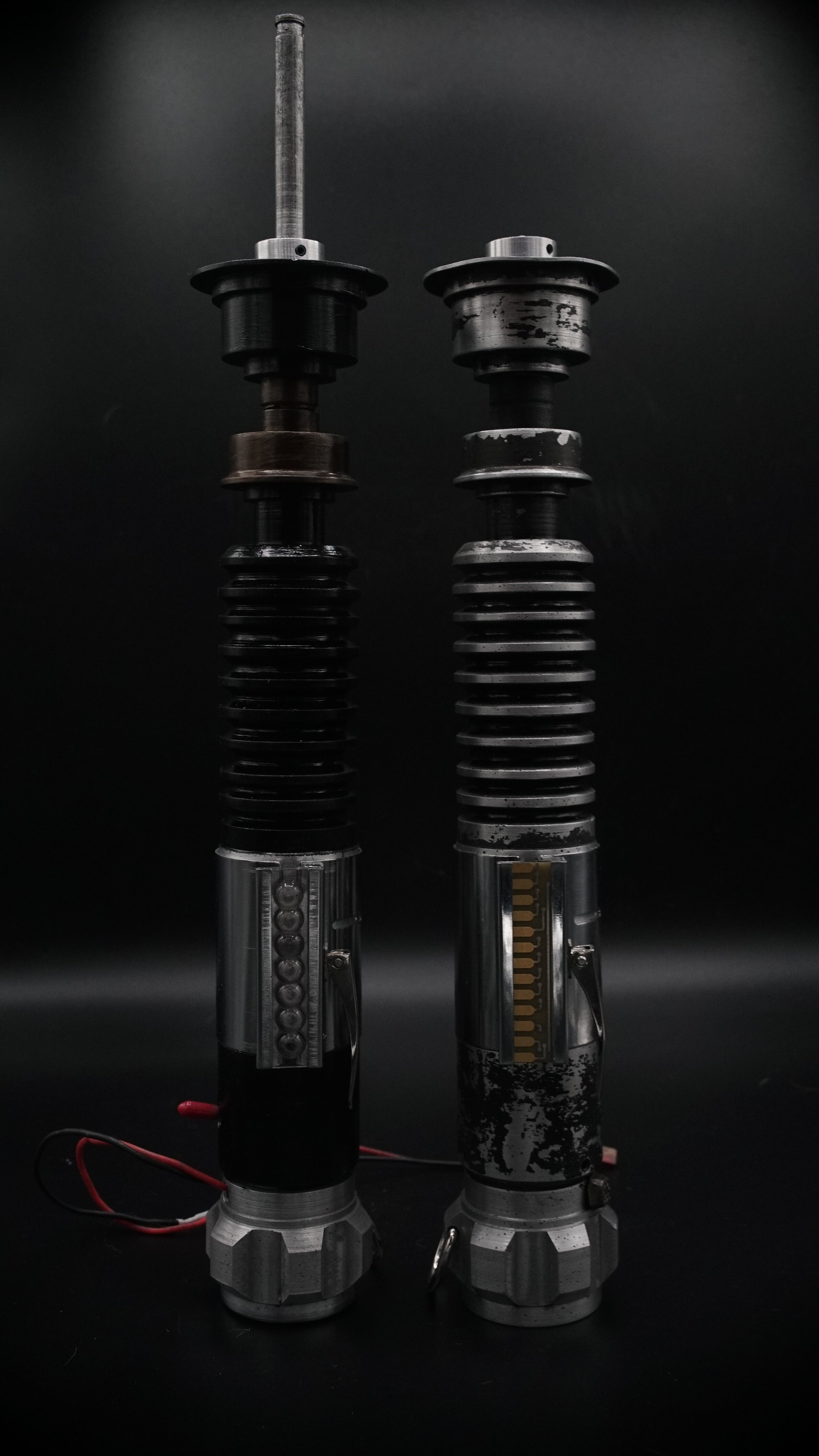

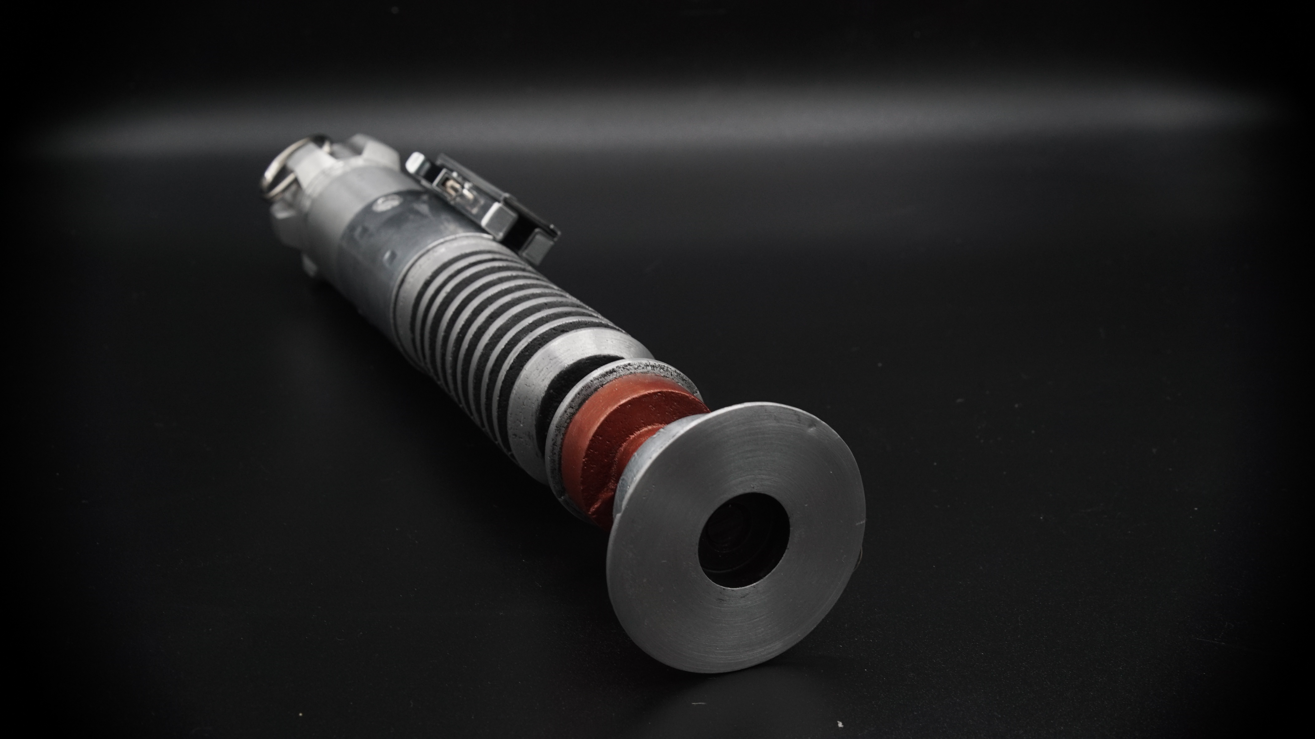

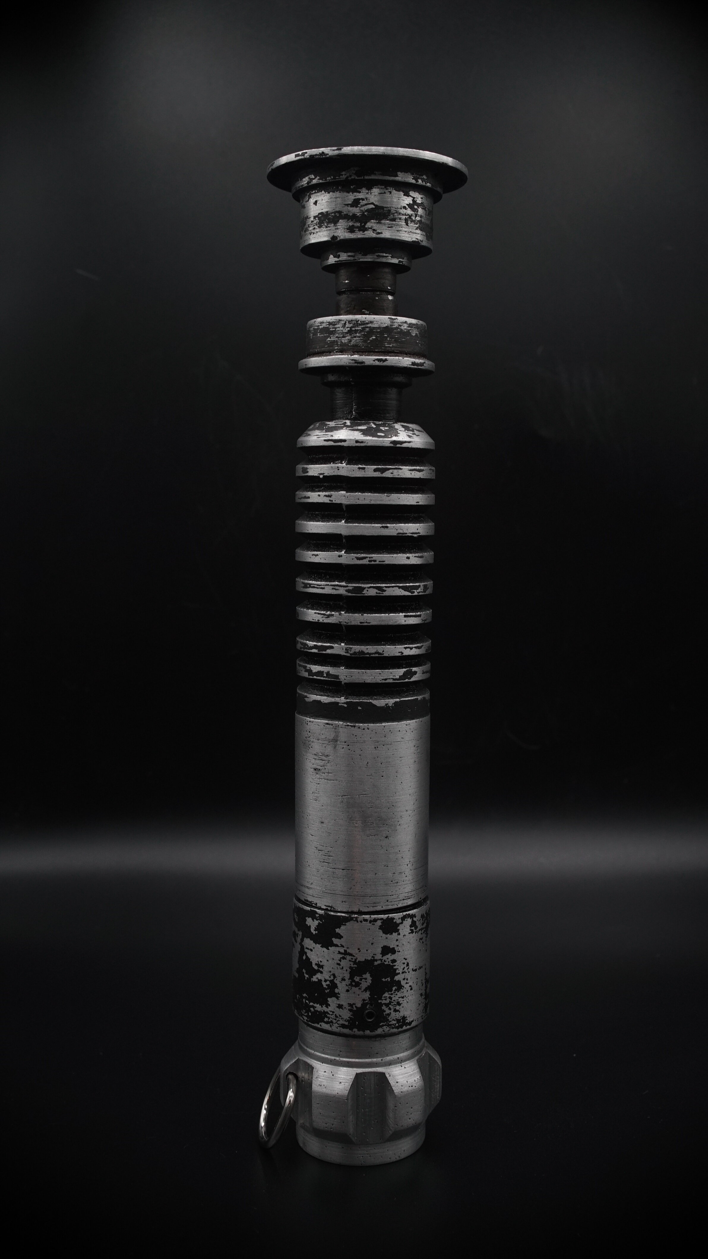

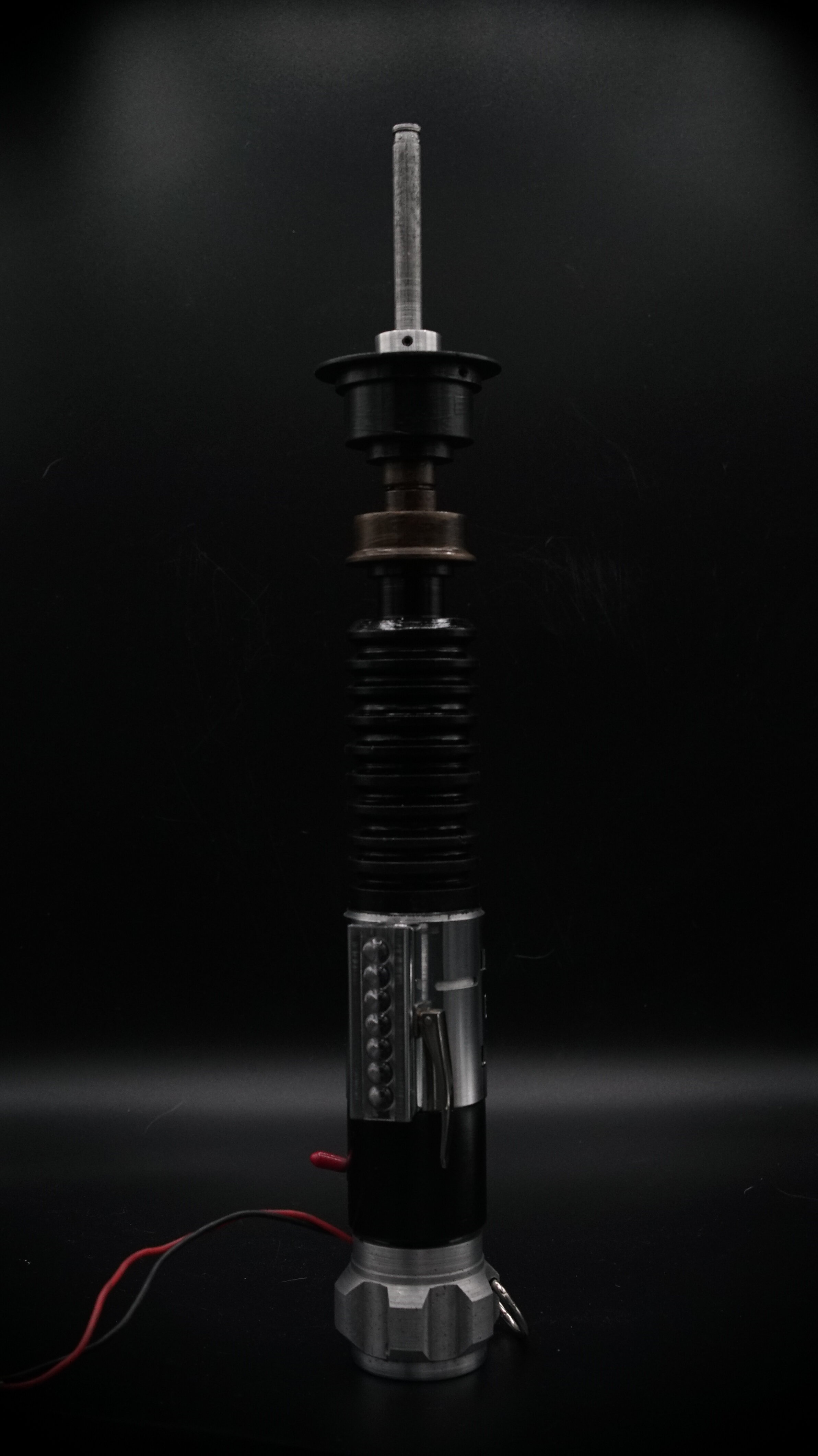

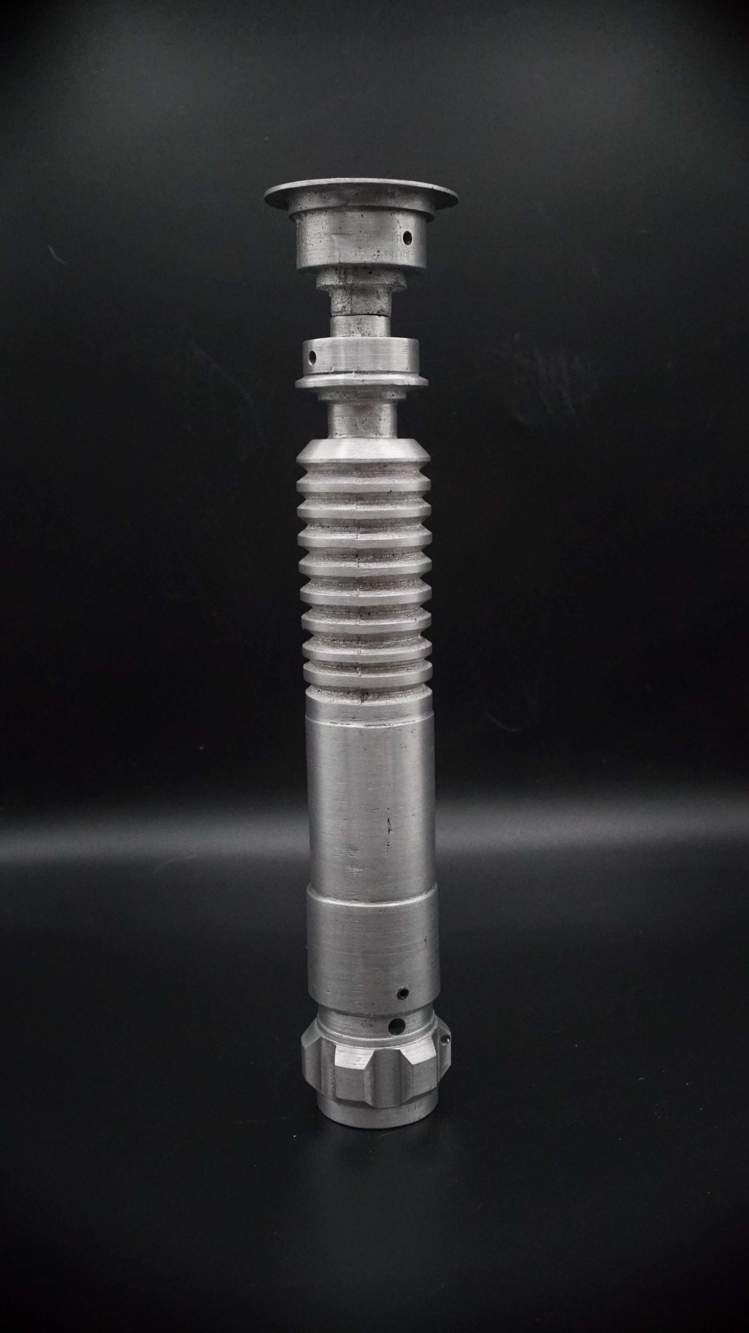

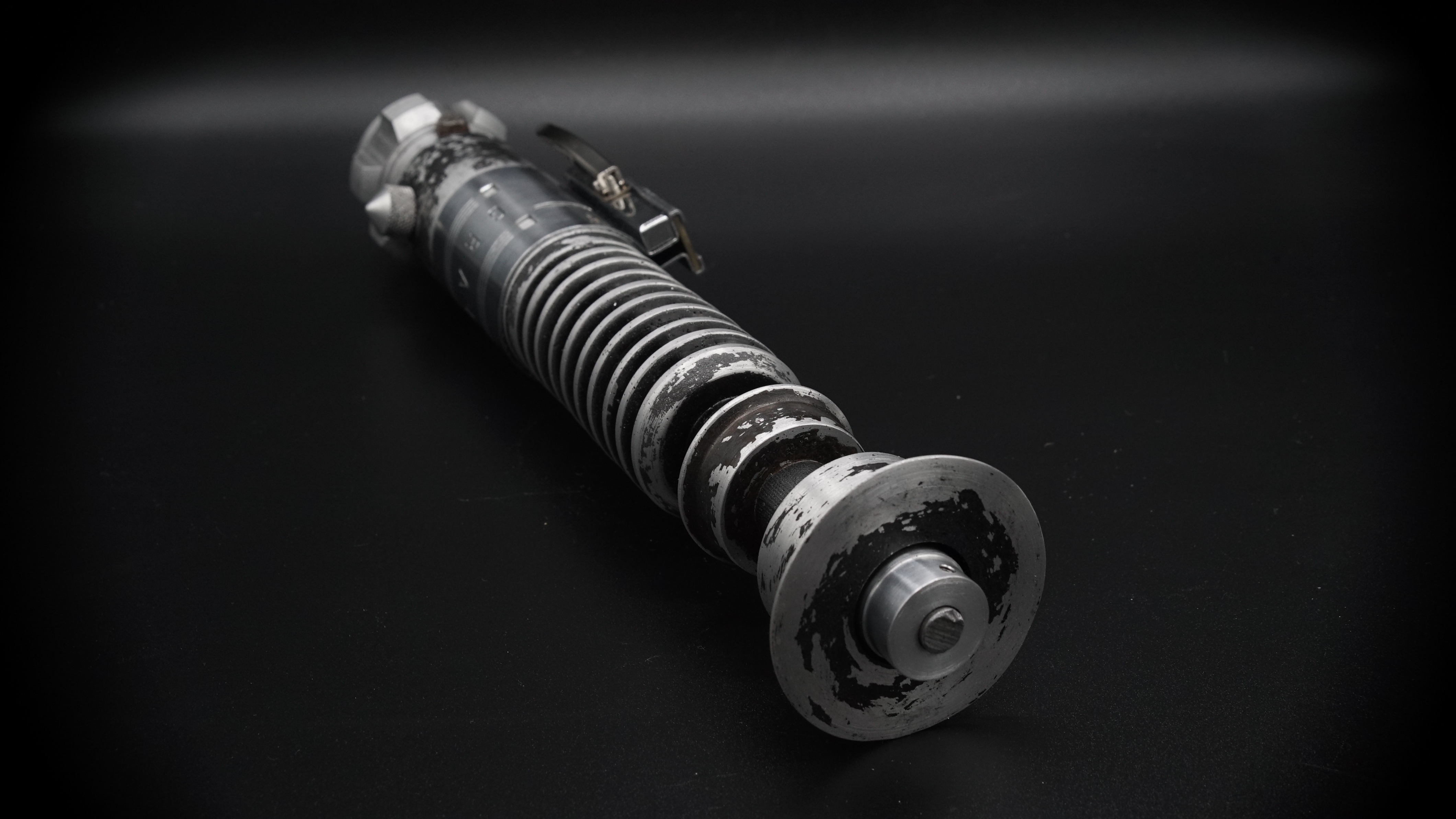

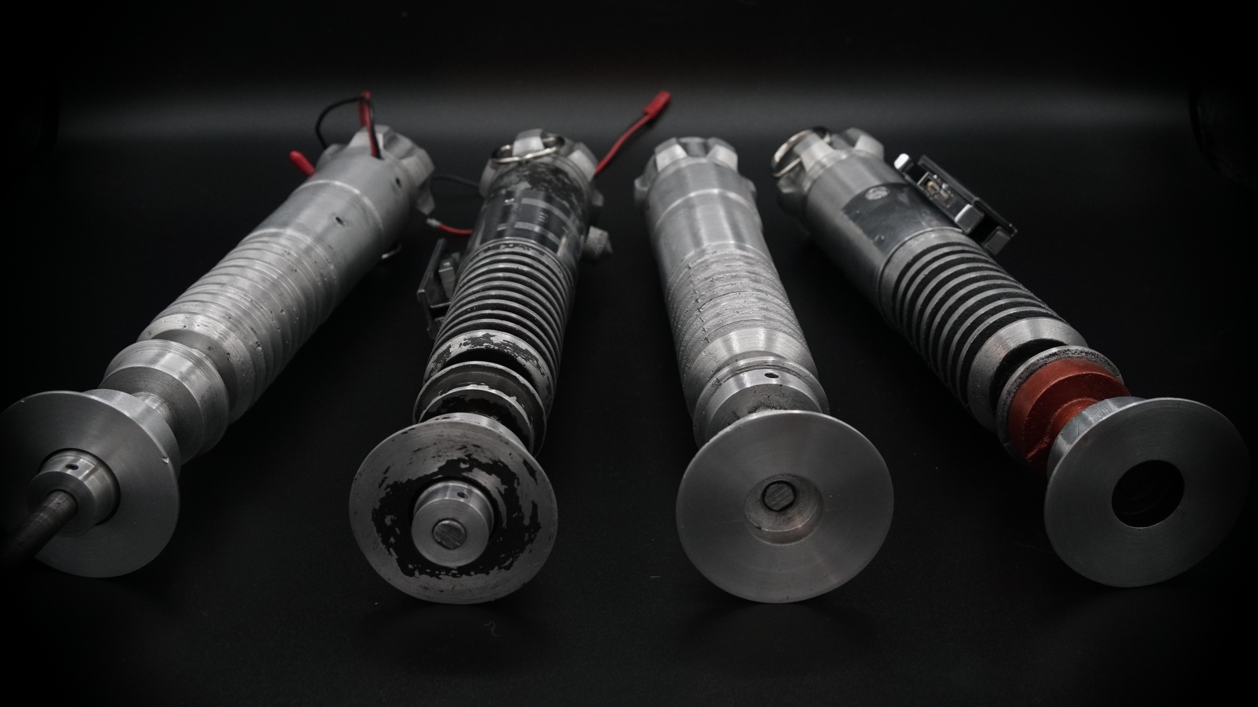

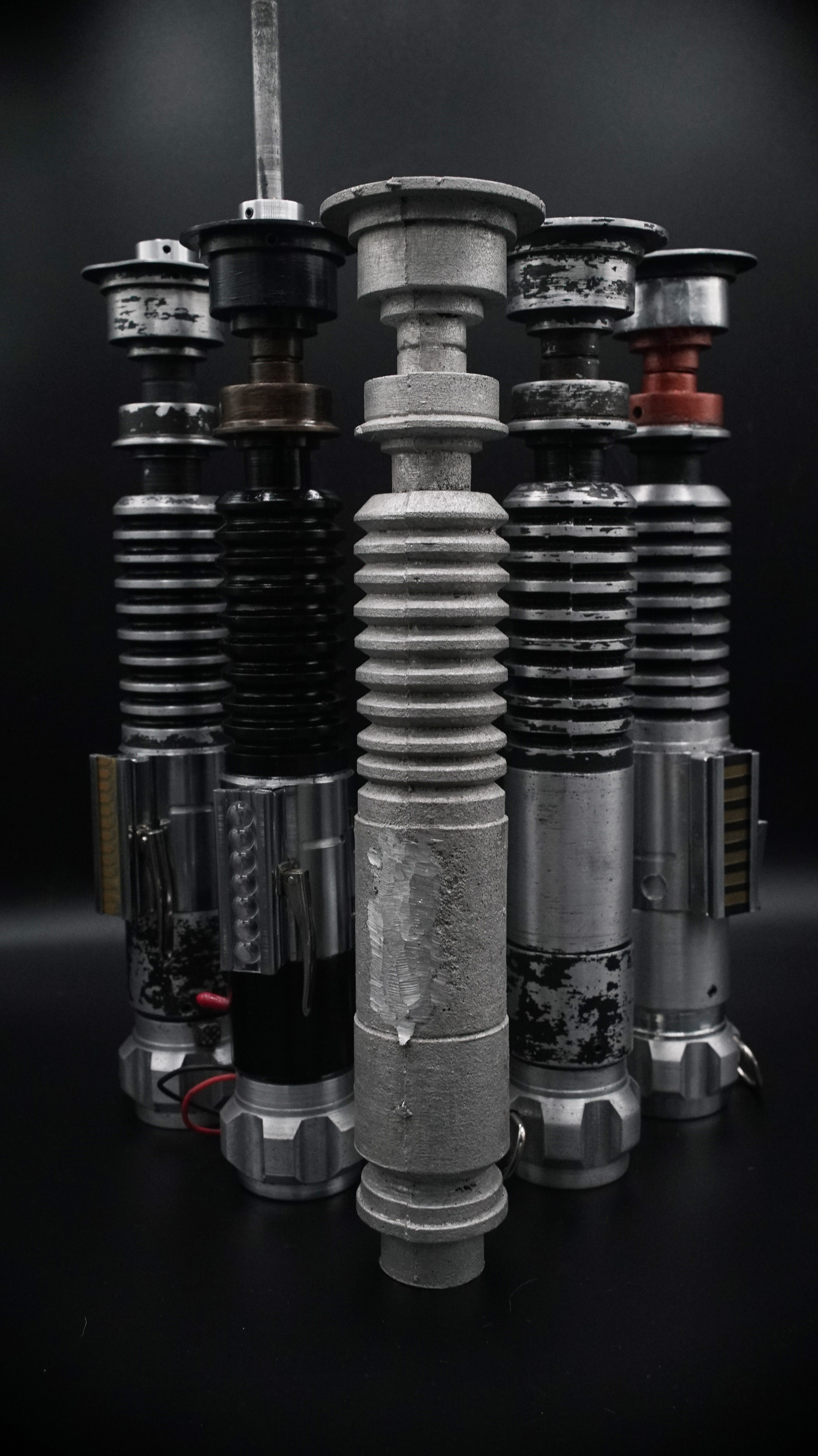

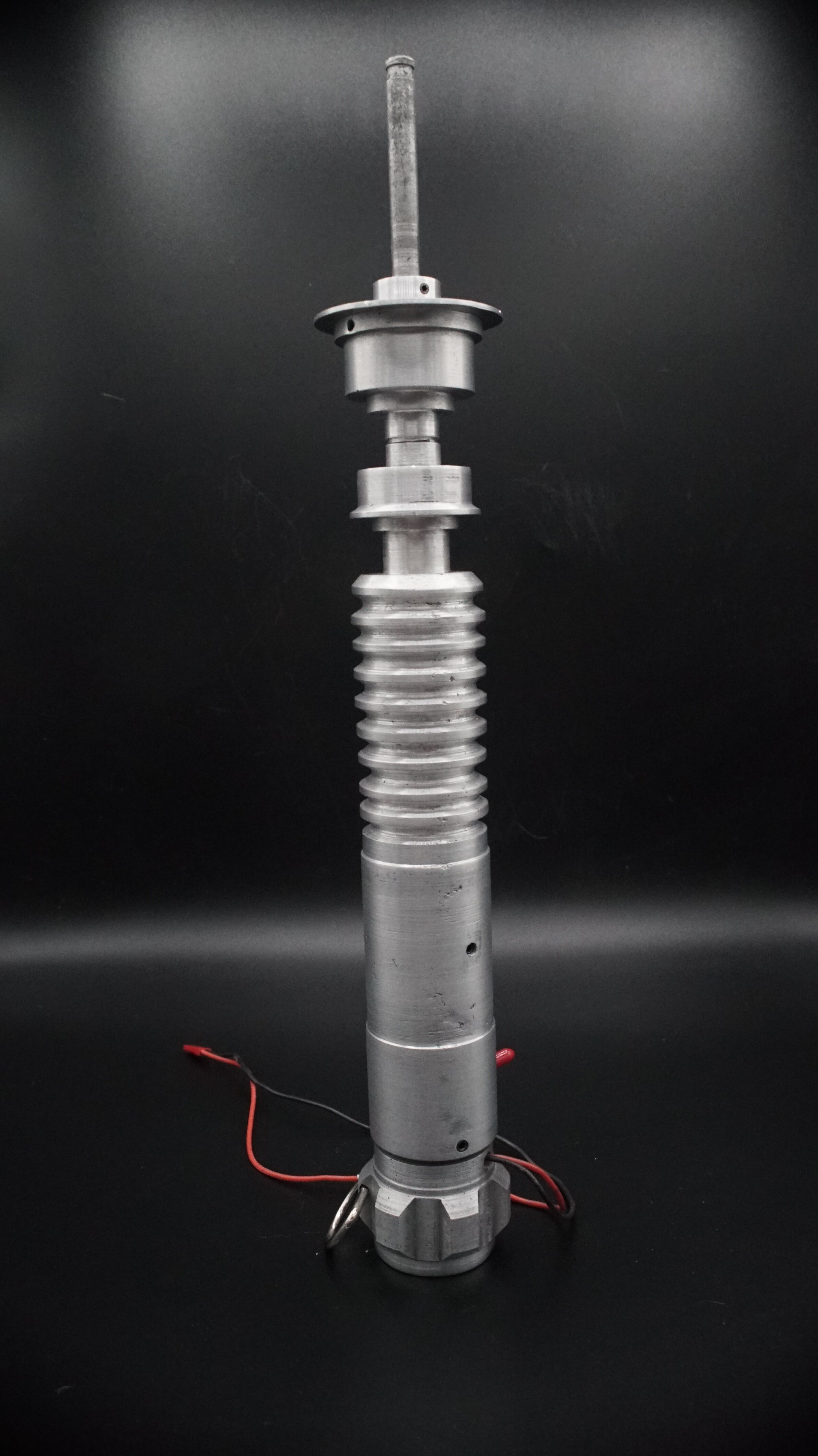

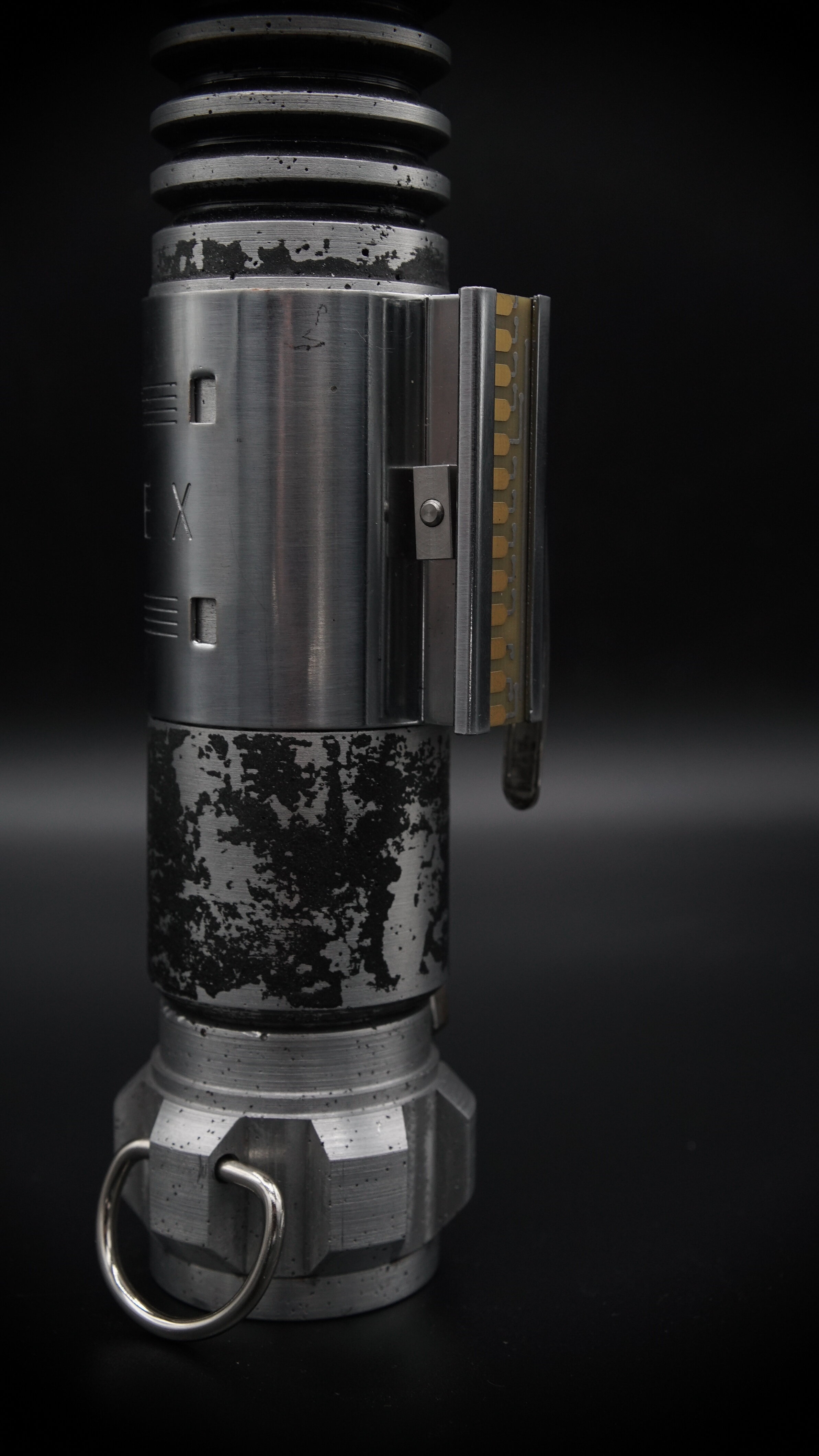

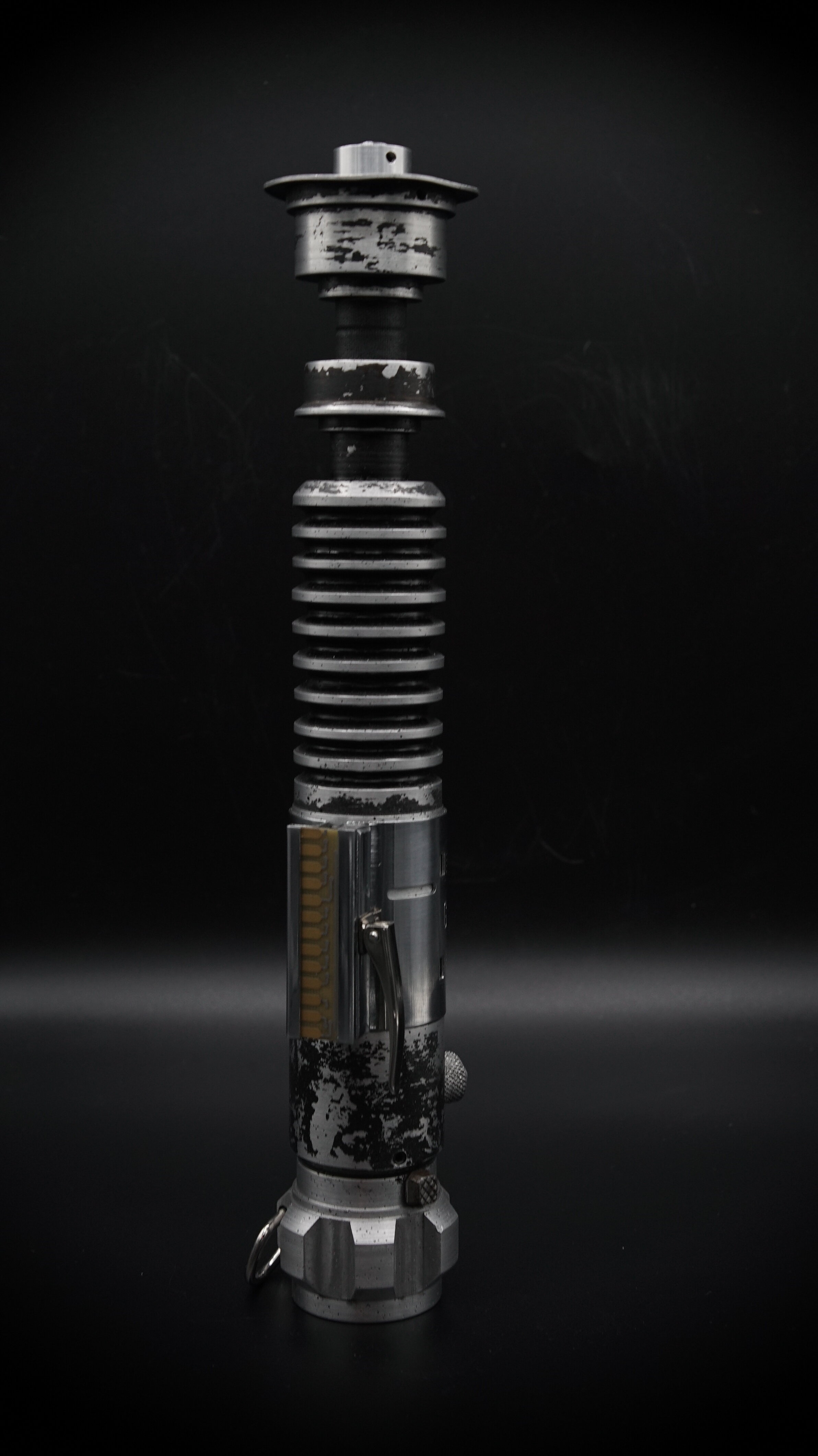

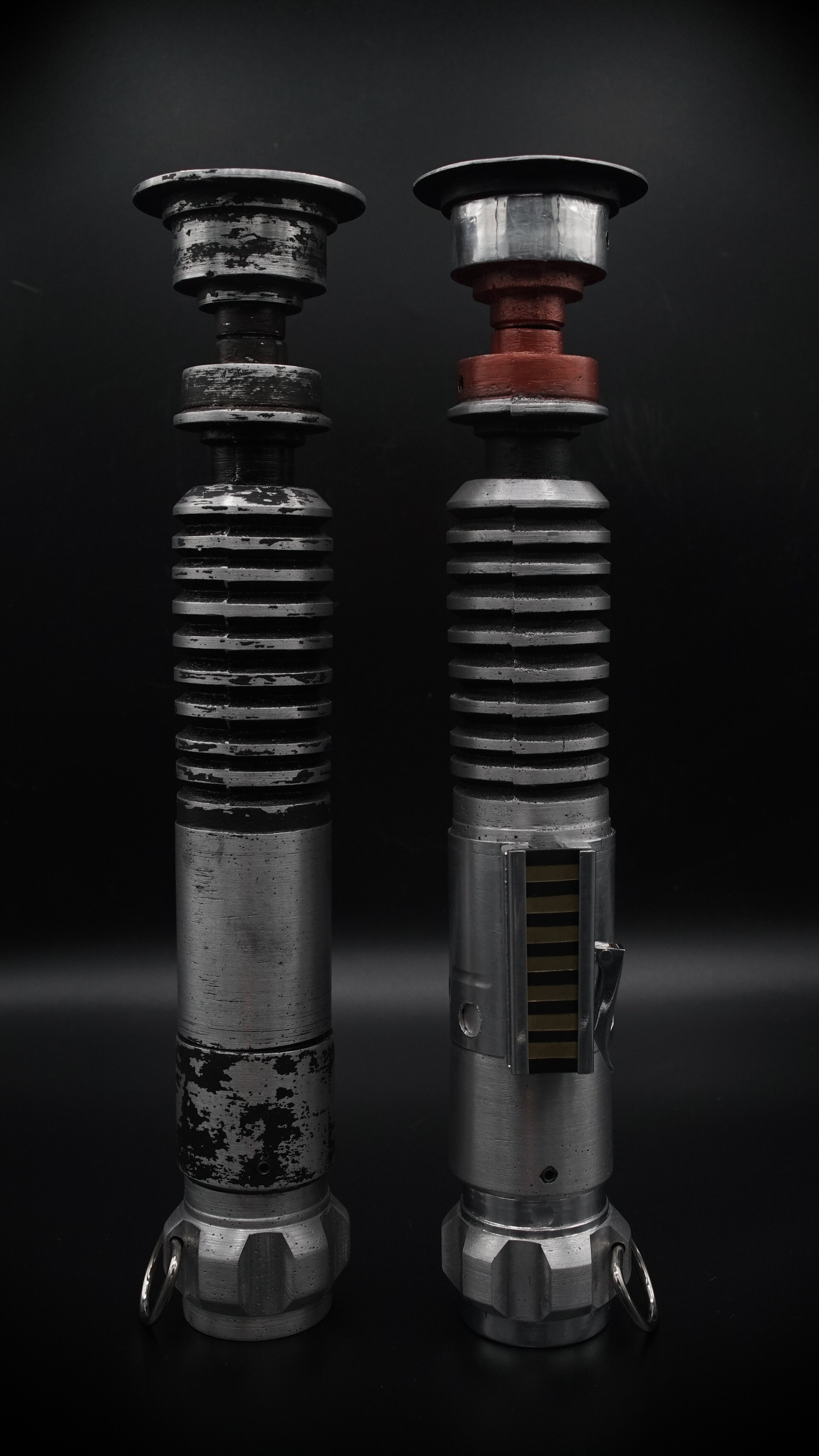

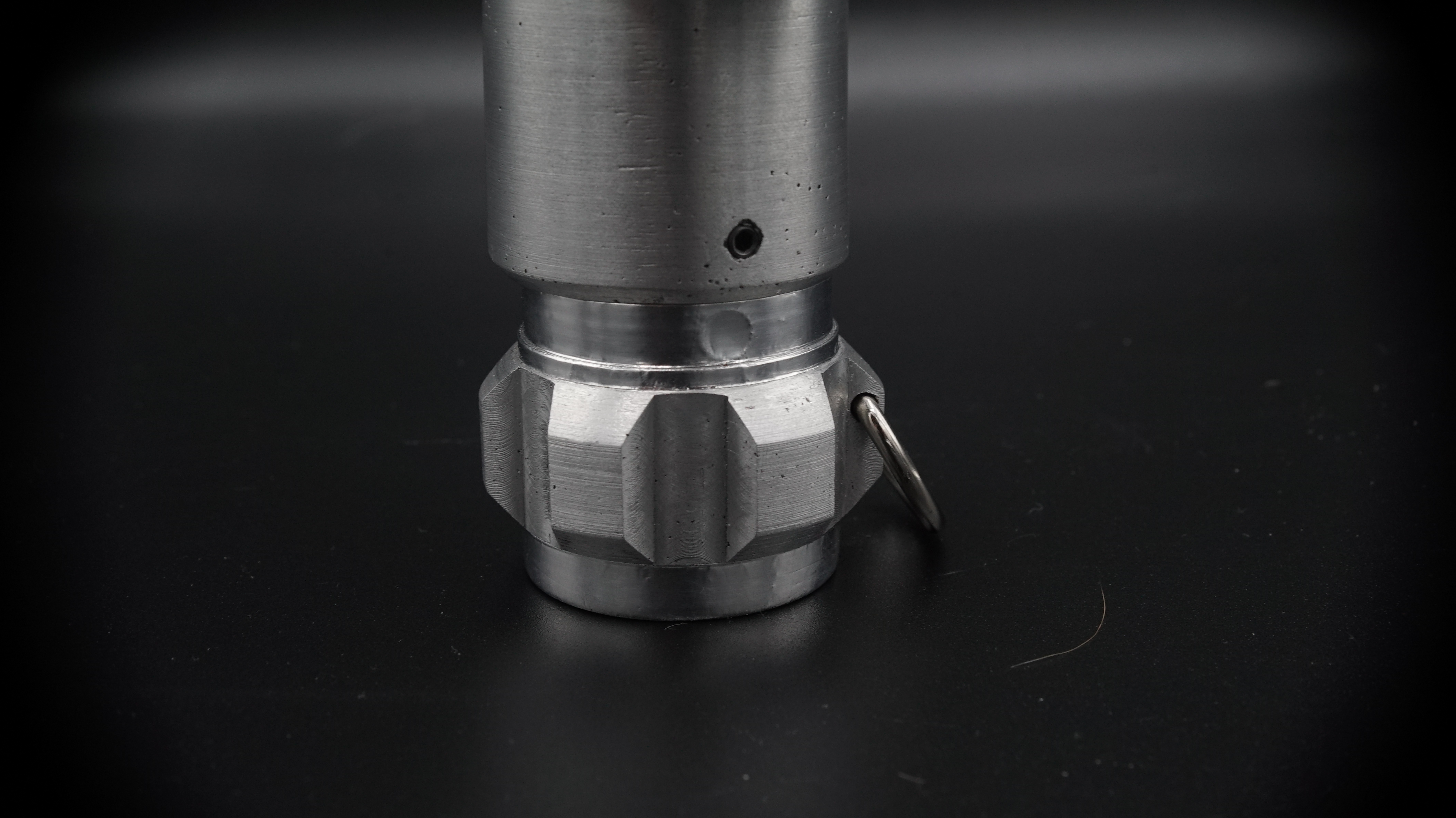

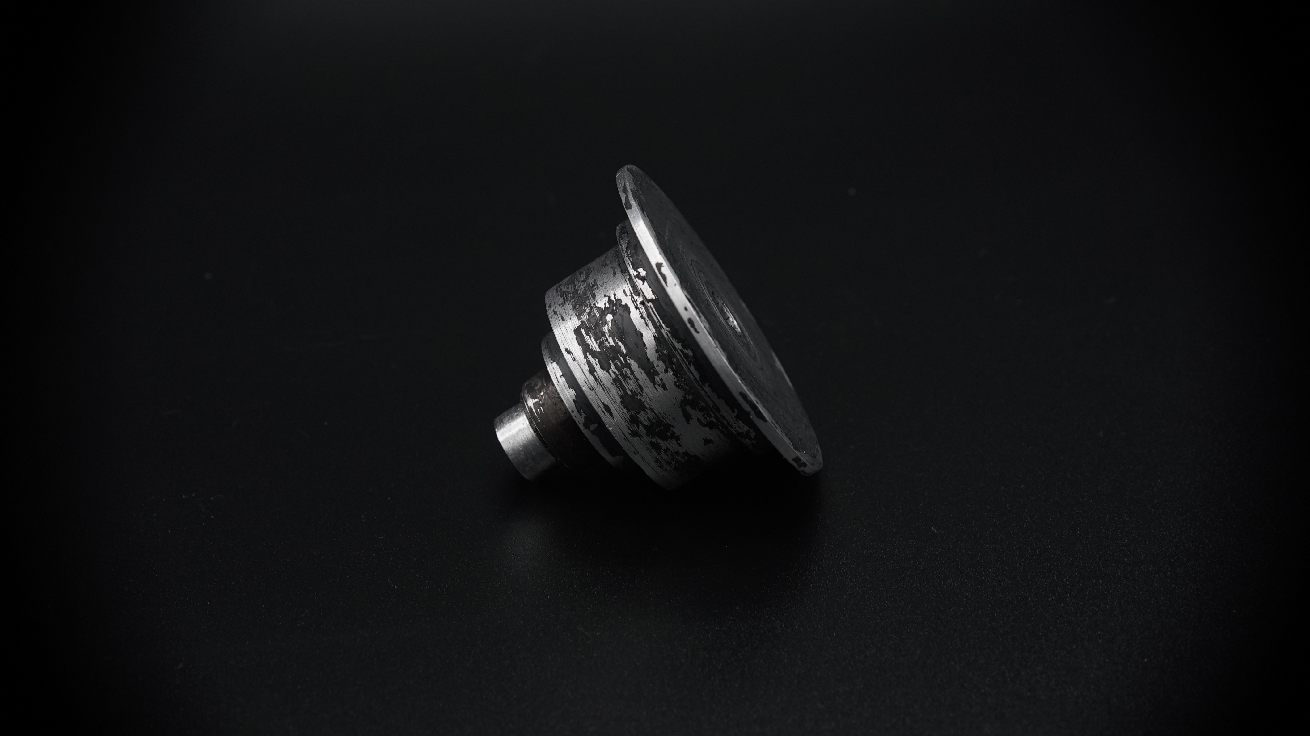

I originally had the intention of doing a big write-up on these hilts but, honestly, I think the photos speak for themselves (and that I also forgot what I was going to write about). So here's a big ol' photo-dump with some goofy video.
Some of these were made with the lesser casts for myself to get my hands used to the work, so there's some pock-marking on on a few of these that aren't on my more pristine casts. Otherwise, this is it; these are the hilts as originally made---everything!
