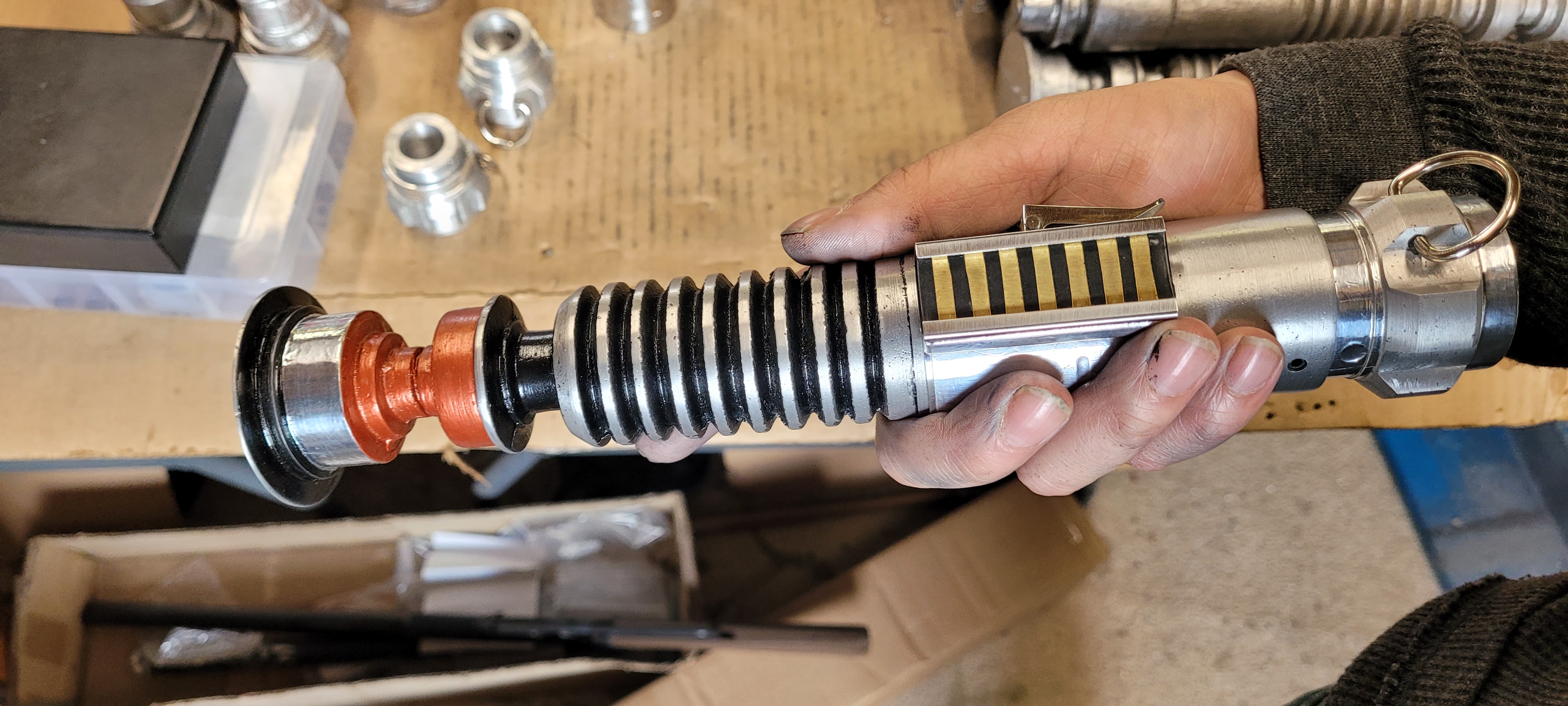

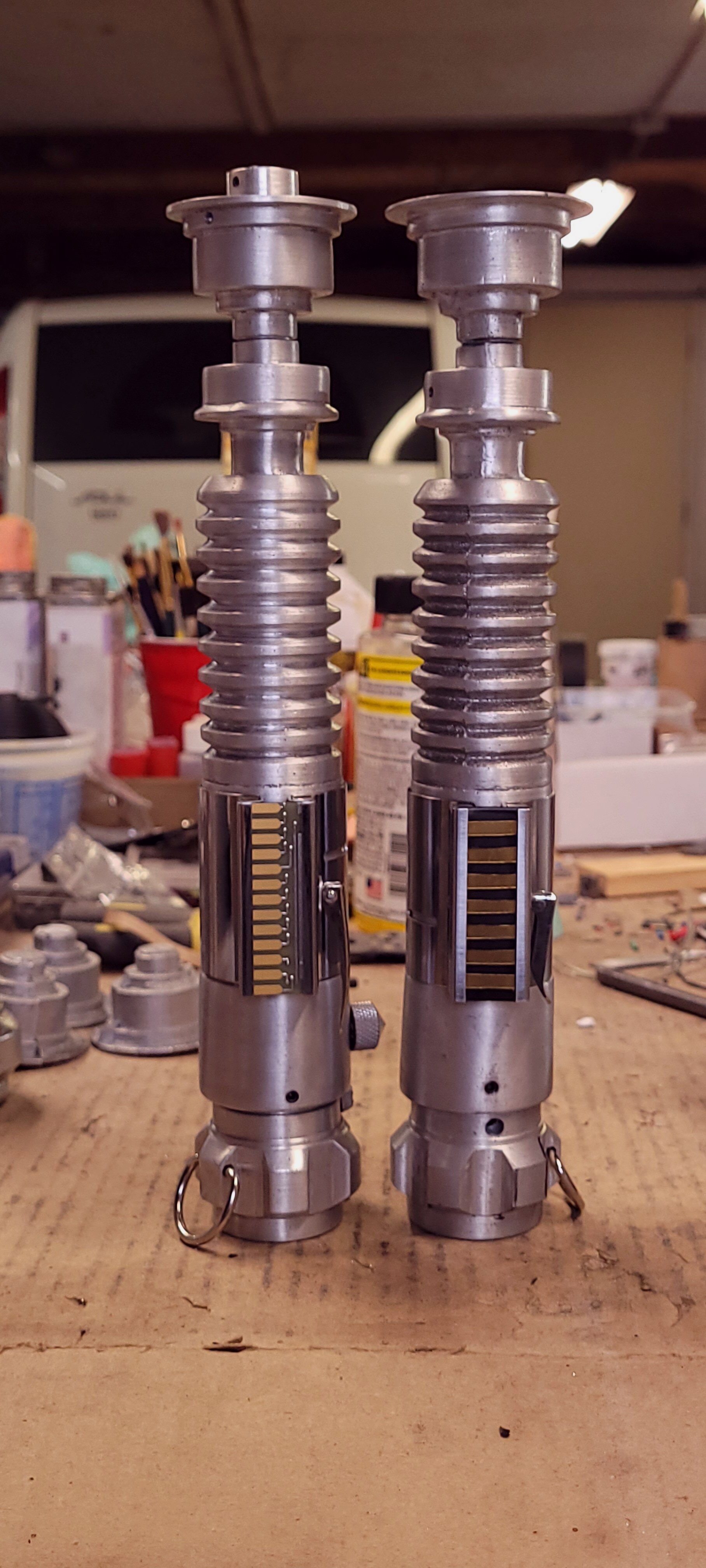

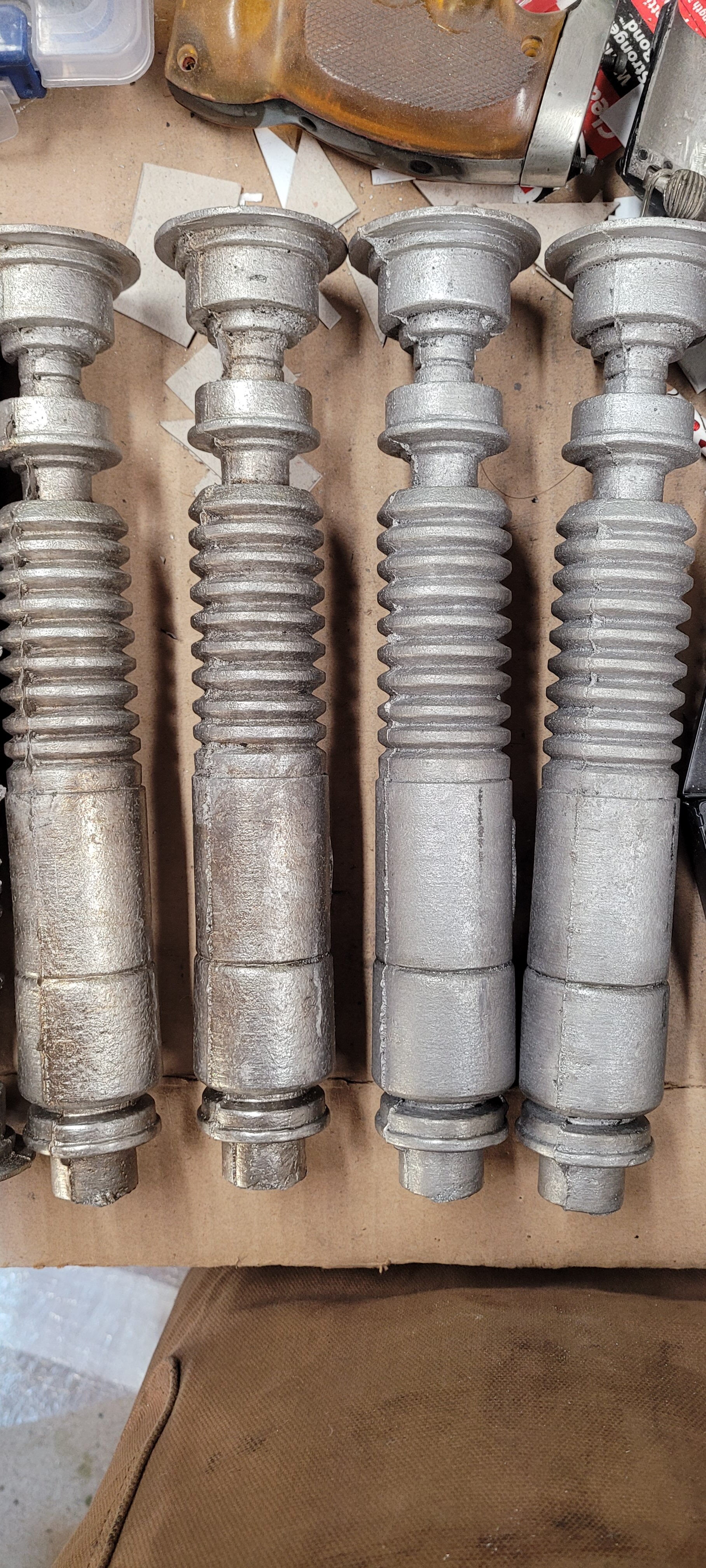

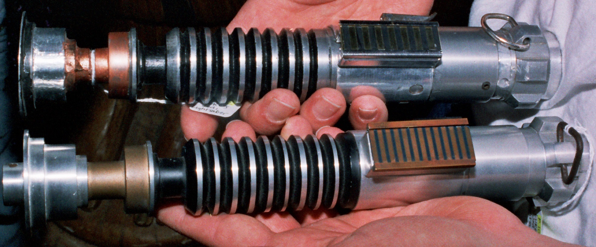

First off, the wood master had a lot more character to it than I could have possibly ever imagined. One of the things that needed to be worked out when restoring vadermania's cast was identifying was a blemish caused from casting and what was something inherent to the master. When I was able to discern what was a result from shrinking or soft-spots and rectified them, what was left really left me surprised. There are so many little details I would've never been able to find without had I not had the model in hand: many undercuts are concaved, the angles of the surfaces slope different to another, the grenade ring cuts are slightly hooked/humped, the emitter plate is at an angle and slightly dished, the clamp section being slightly bell-shaped, how genuinely oblong the booster is; there's so much I could go on about! These details were important to find out because that ultimately informs how much the respective hilts (v2/v3) were cleaned or not.
The V3 was pretty straight-forward and there wasn't much different to how I approached it this time around with the lineage cast. It's the V2 that always gives me pause. I know that the V3 isn't as clean and polished as the V2 is based on the surface finish and how much of the flashing and gravel-like texture from the sand casting still remains. The trick then, and has always been for me, how much do I take off the V2? Was it machined at all?
Ultimately, I concluded that the V2 was not machined but cleaned with a rasp and sandpaper--like the V3 but more than the V3 was subject to. I may be really late to reach this conclusion, but the collage that DaveP had done for his project and the research by Halliwax backed it all up. The rings looked like the cast's and much of the proportions remained intact even after casting. I was machining my earlier pieces because it was what was said at the time by Alinger and what everyone pretty much held true, and it all worked with the measurements taken from replica pieces that were available. It was exhilarating and disheartening to know my hilts were coming out a little too thin than actuality.
Apologies to everyone on the earlier runs! :oops:
Mark-Hamill-Pop-Culture-Quest-Return-of-the-Jedi-Lightsaber-Brandon-Alinger-Prop-Store-FI.jpg

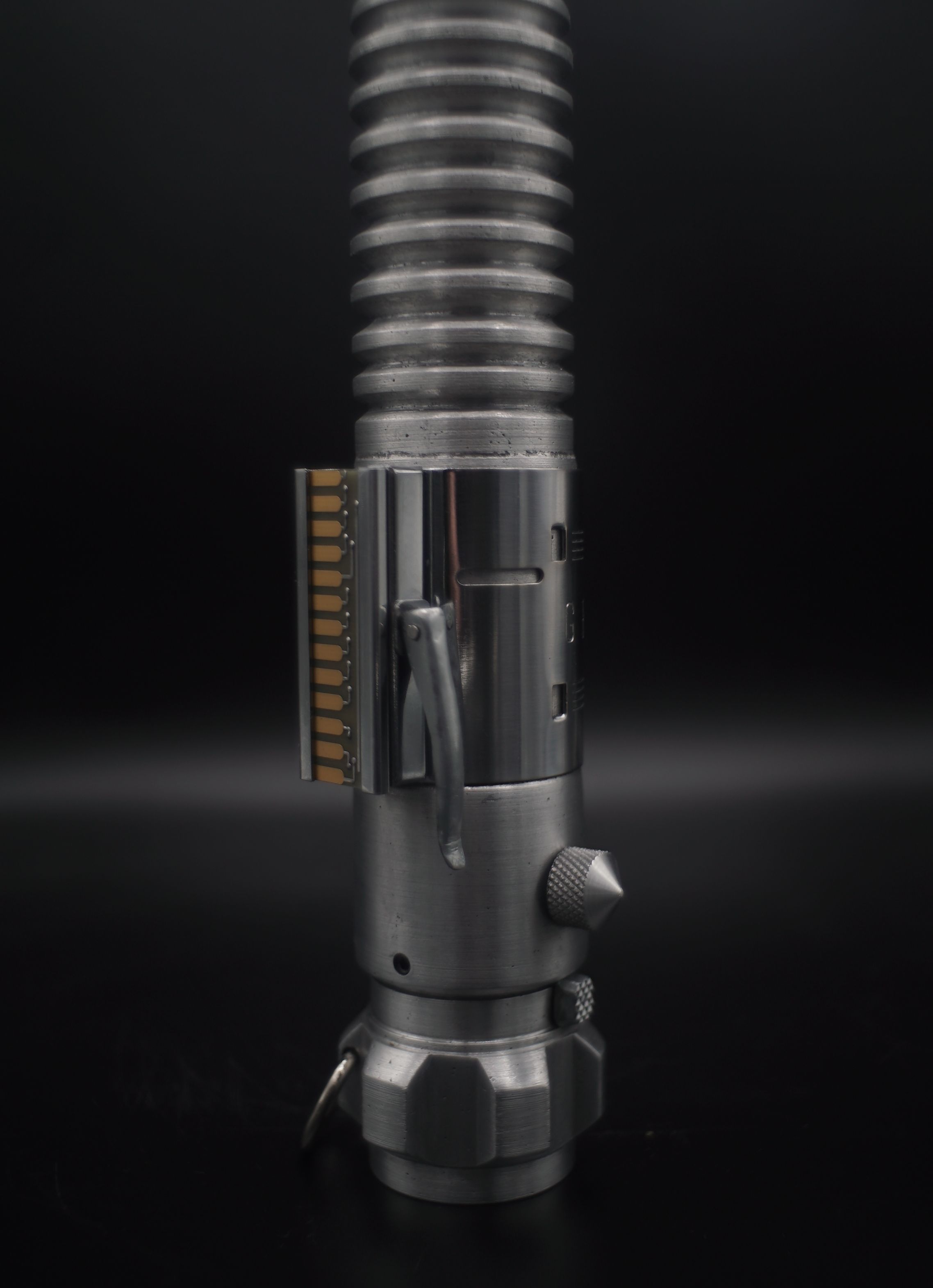

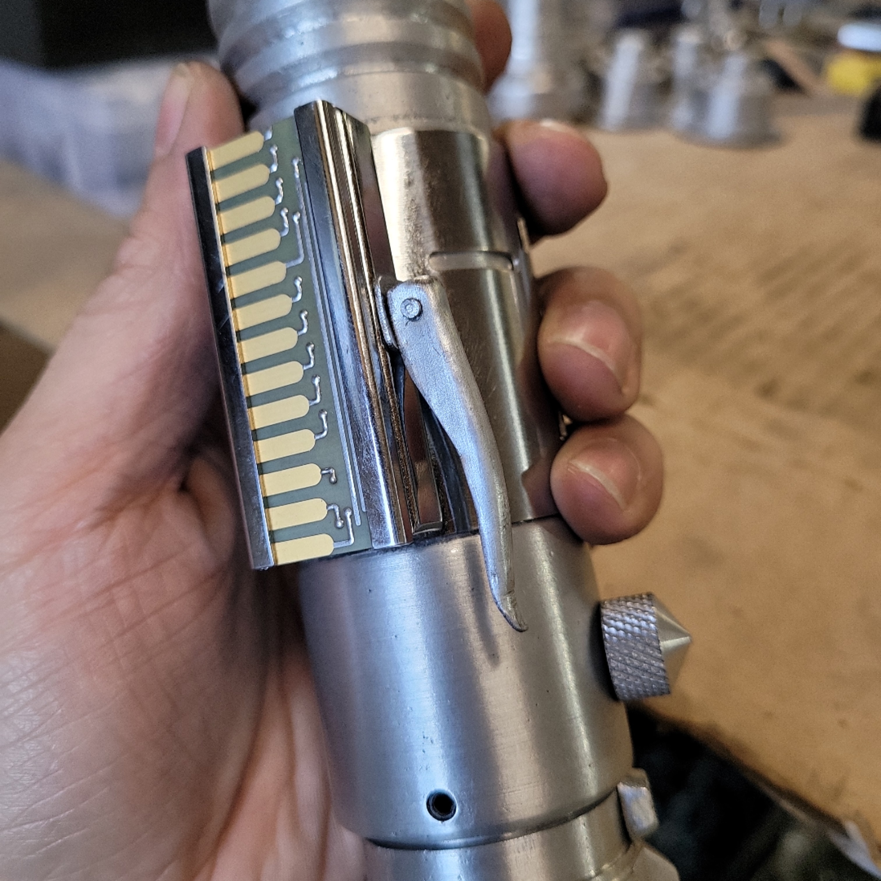

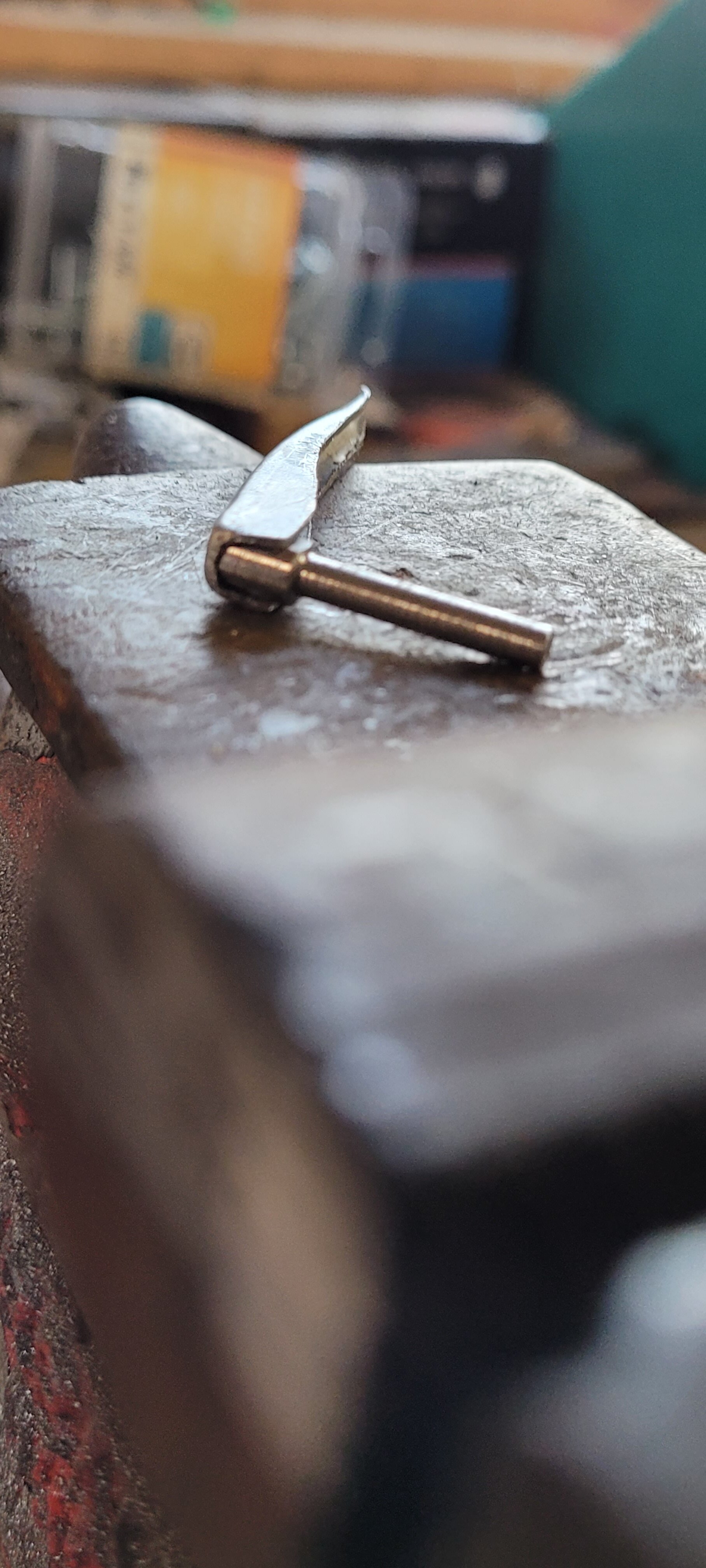

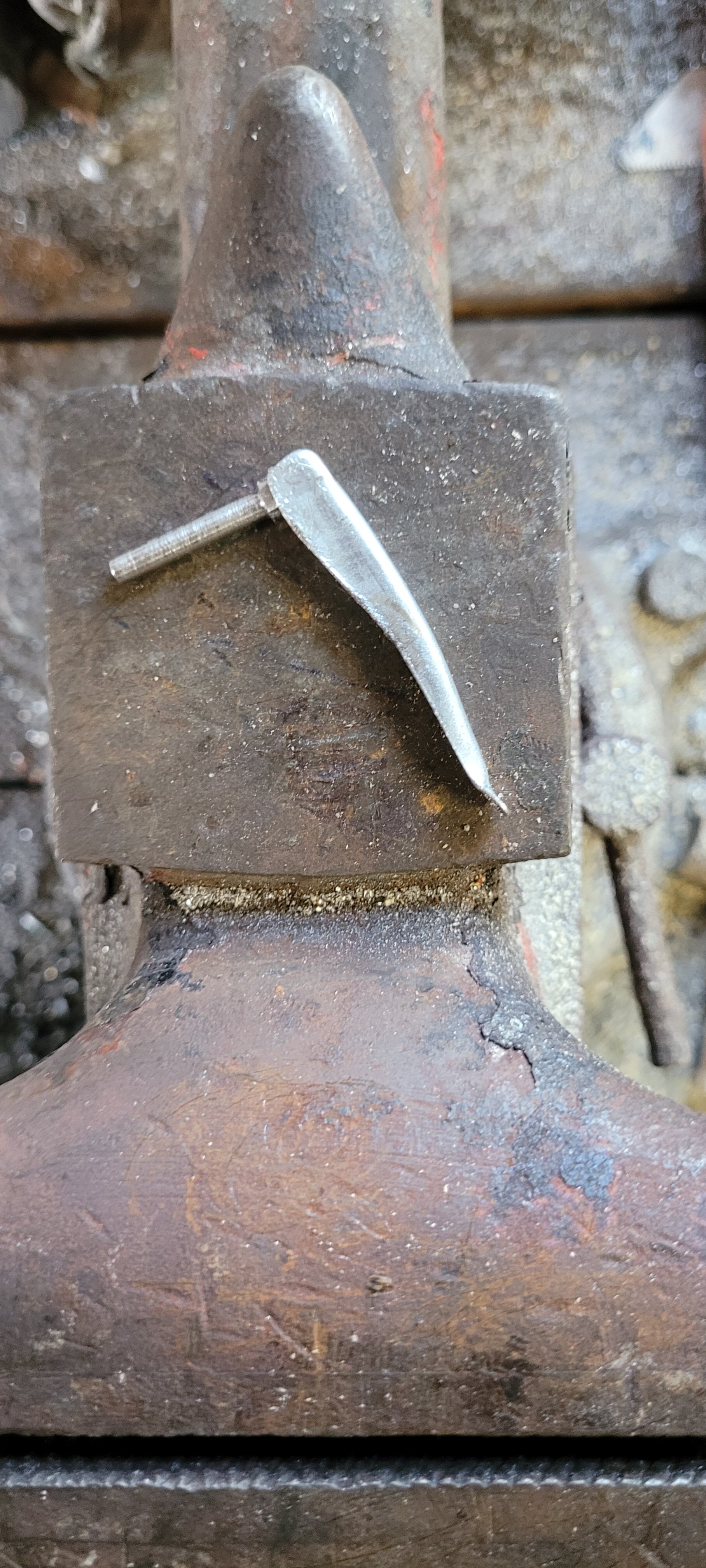

This then lead to the clamp for the V2 as now the lever for it no longer fit! Something that I went and solved all the while--had I waited-- roygilsing concurrently solved with his 2.0 version of the clamp lever assembly! Not knowing this however, I had to fix this issue myself and making it harder for myself, I wanted to address the quibbles I've had between the previous clamp levers offered.

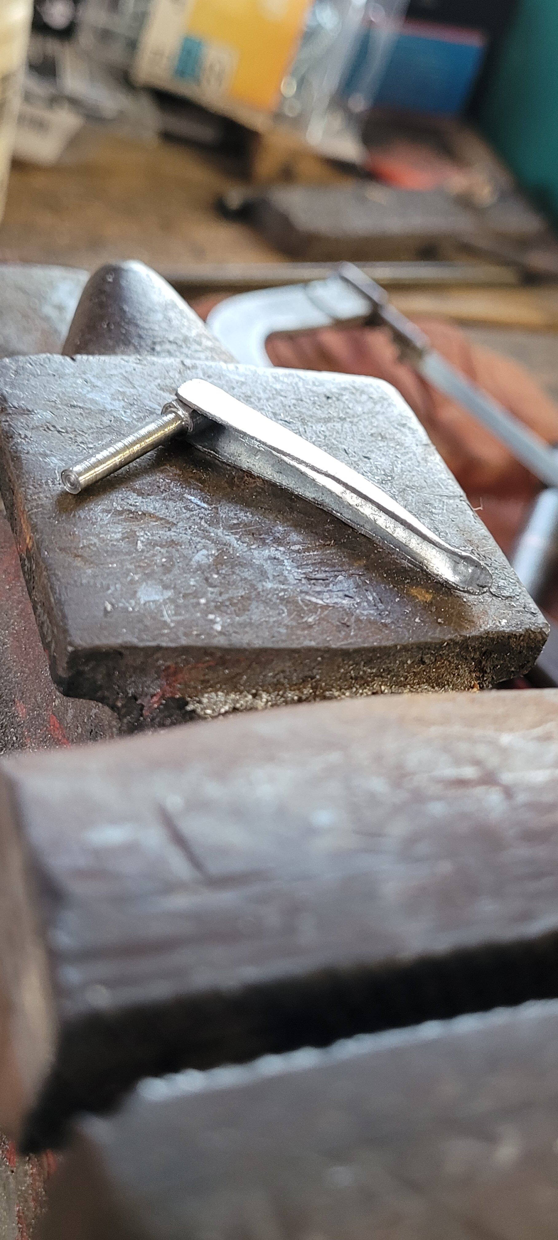

I've always felt that the clamps levers made were too thick, too clean, and too shiny. Between the chrome plated pieces to the bare aluminium that some offered; it never looked quite right to me. It being comparatively thin on the real thing, and still being sturdy, I settled on steel as the material to use for the piece and the local hardware store had the perfect sized sheet of galvanized steel to use.
I made positive masters out of wood and plaster to mold and sand-cast dies to quickly and evenly produce these. They're a certain size and profile so I can remove the excess material away on my grindstone into the proper lever shape. The post and square lock nut are custom made out of steel as well to now better suit the lever thickness. A simple finishing nail acts as the bolt to hinge the lever and post together. Here is an early test piece dry-fitted together before reaching the final result:

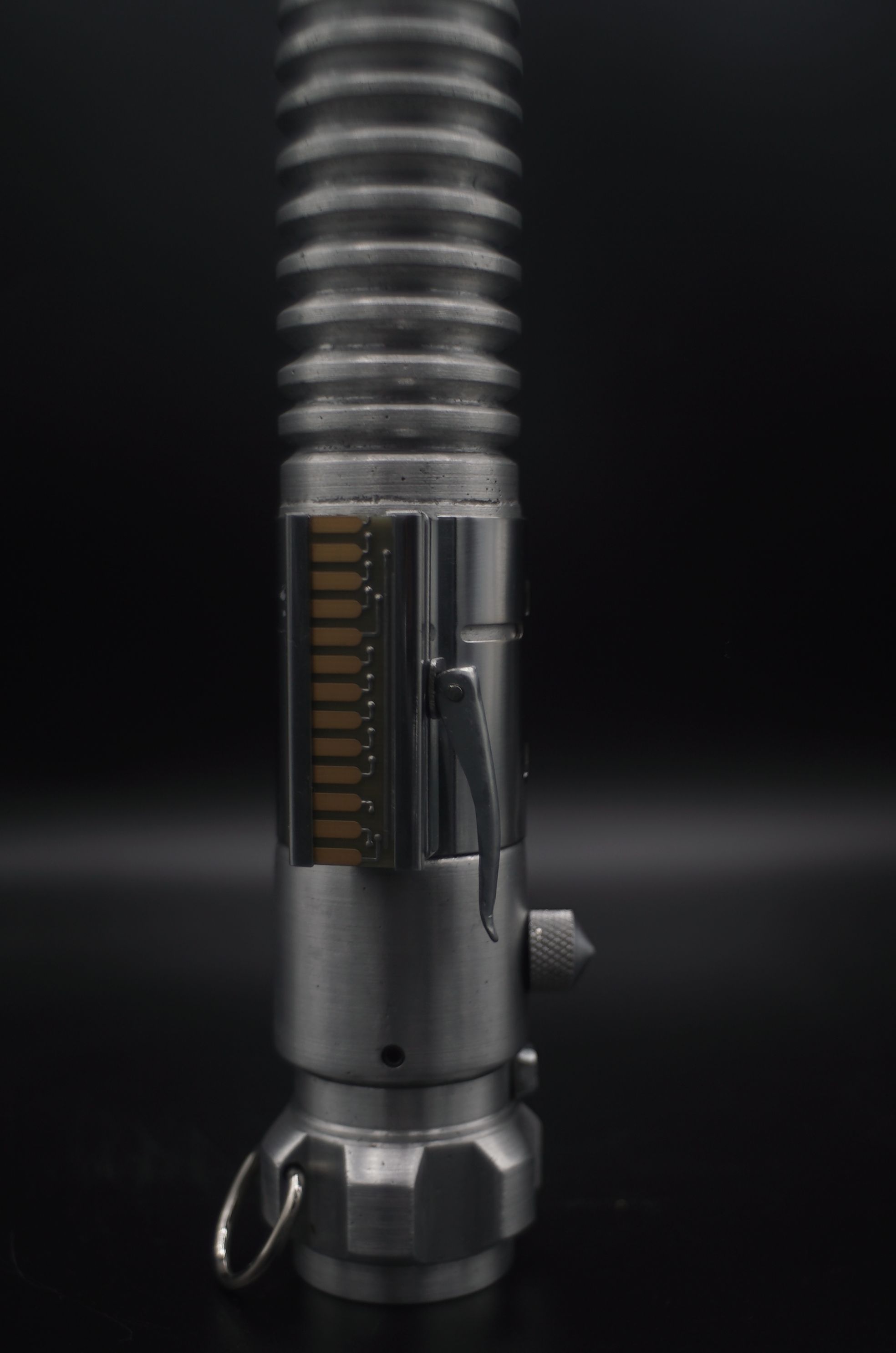

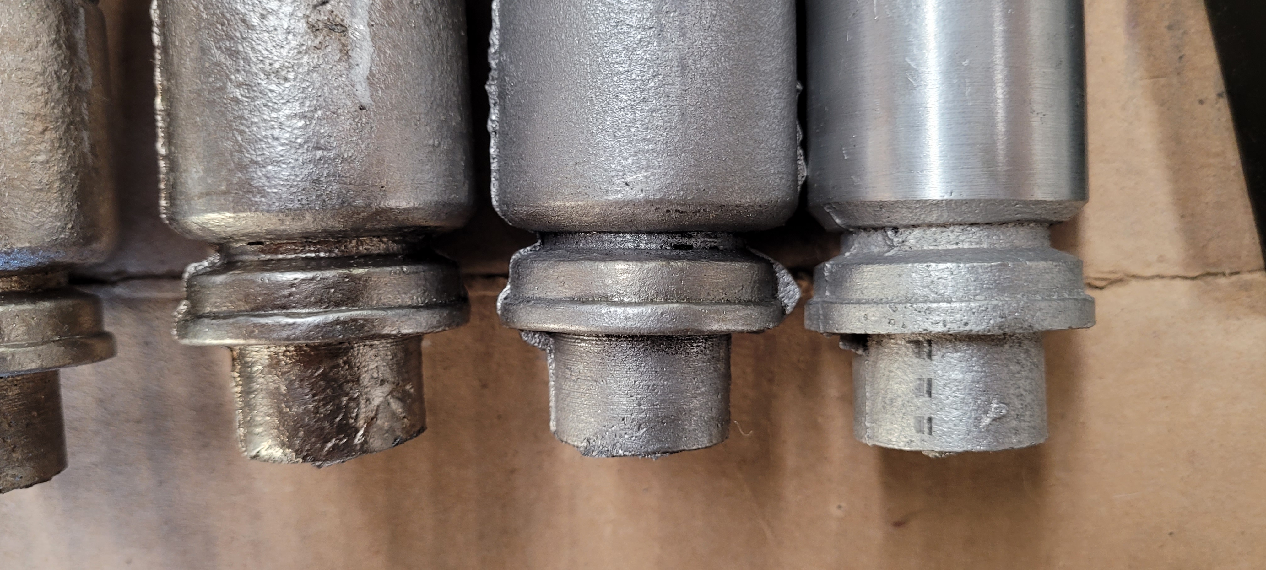

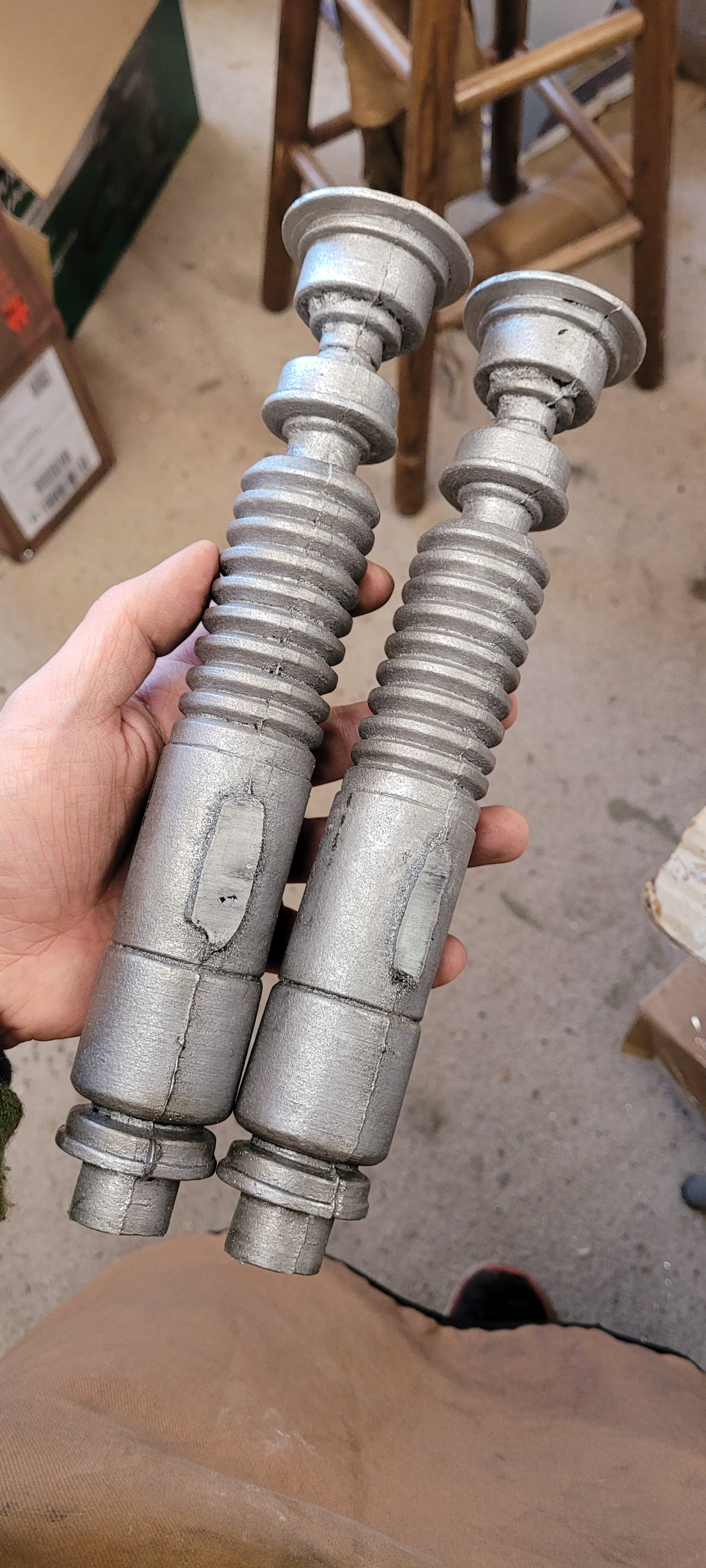

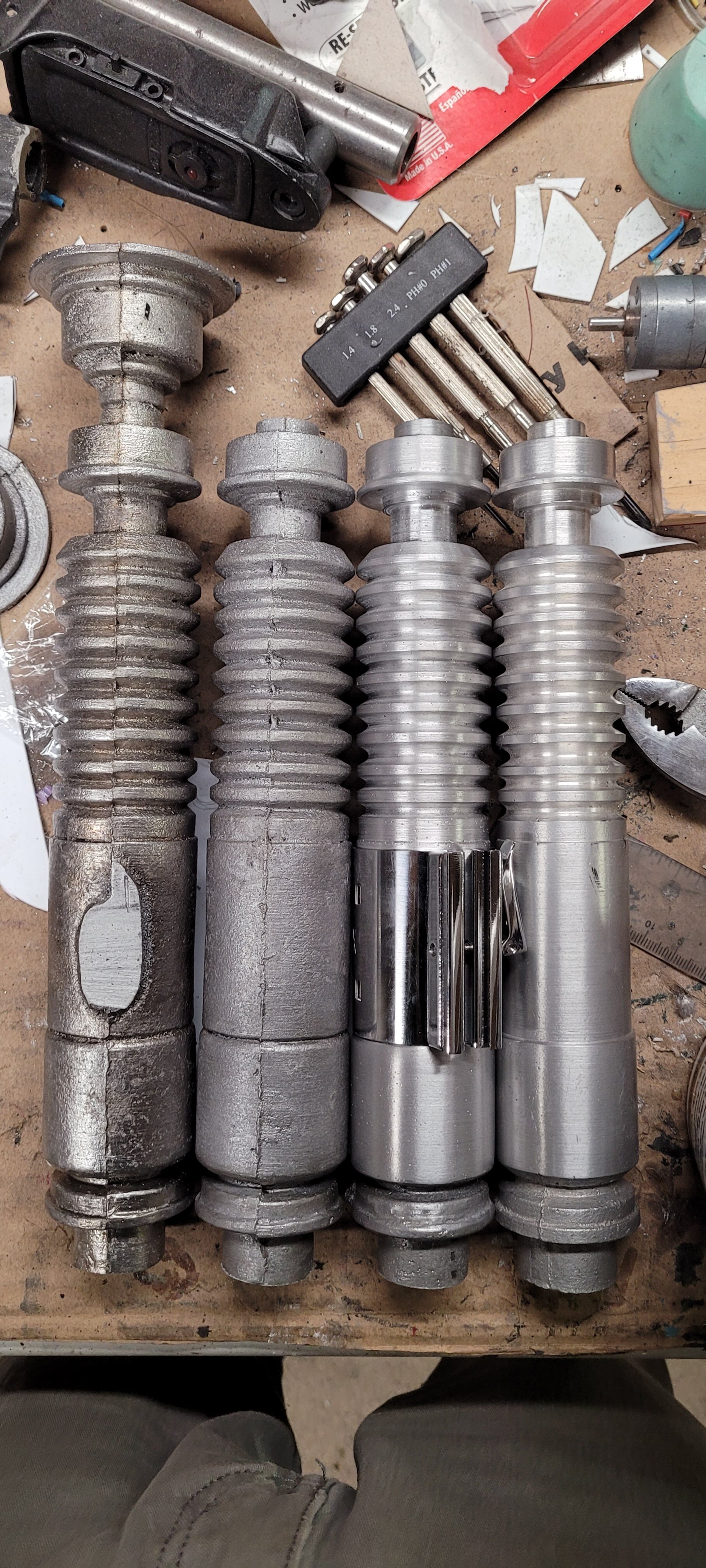

The rest of the V2 after settling on filing over machining it was pretty straight forward. I do find that because I'm working on something with genuine heritage, I am a little too gentle when it comes to cleaning out the grenade rings for the V2. I need to hog more out to get the right ring thickness but I always just pull back a little too soon for worry of irreparably going too far; it's better to have a little more than a little less, I feel. Currently, any way.;) Once I steady my hands and my nerves to do it, it shouldn't be a problem.

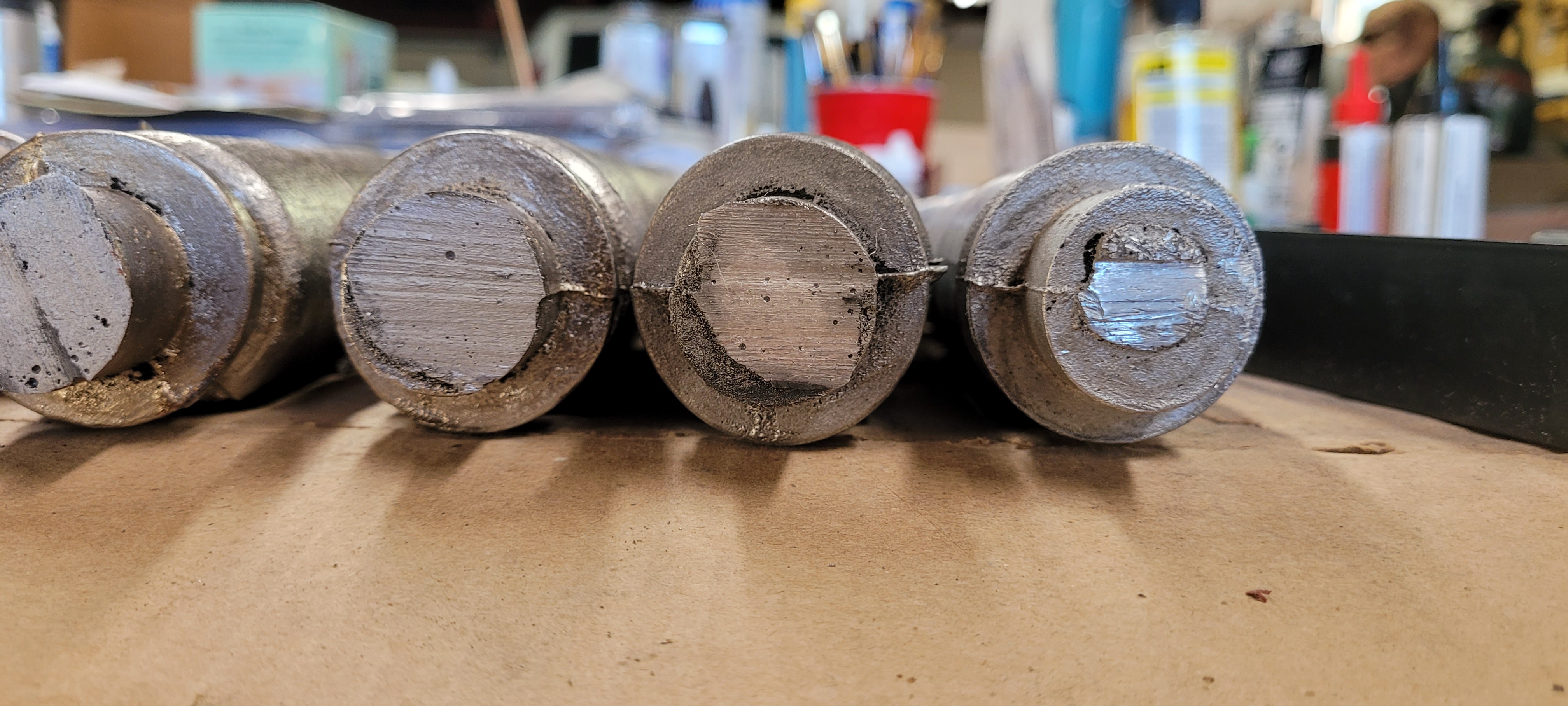

My one concession and failure to remedy I've come to accept during all this is the emitter. Rather, the damage to it on the V2. I've burned through four good emitters to try and get it, but I can't. I've tried all sorts to get to match the real thing, I've even created a separate die just for it similar to how I made one for the lever, but my casting alloy is just not strong enough to handle the stress of bending the emitter face to angle without damage. It irks me to no end to come to terms with it. The brazing wire originally used to make the real production casts are or had to be stronger than what I can currently get my hands on if they can warp as they did without surface damage (or flat out chipping off). I've quenched, I've annealed; I've quenched and annealed; hammered and pressed without any success. I can ding it, I can beat it up to a certain point, but the casting aluminium available to me is just not strong enough to achieve that one detail. I've crossed the finish line of the marathon but keep losing a shoe, it feels like.

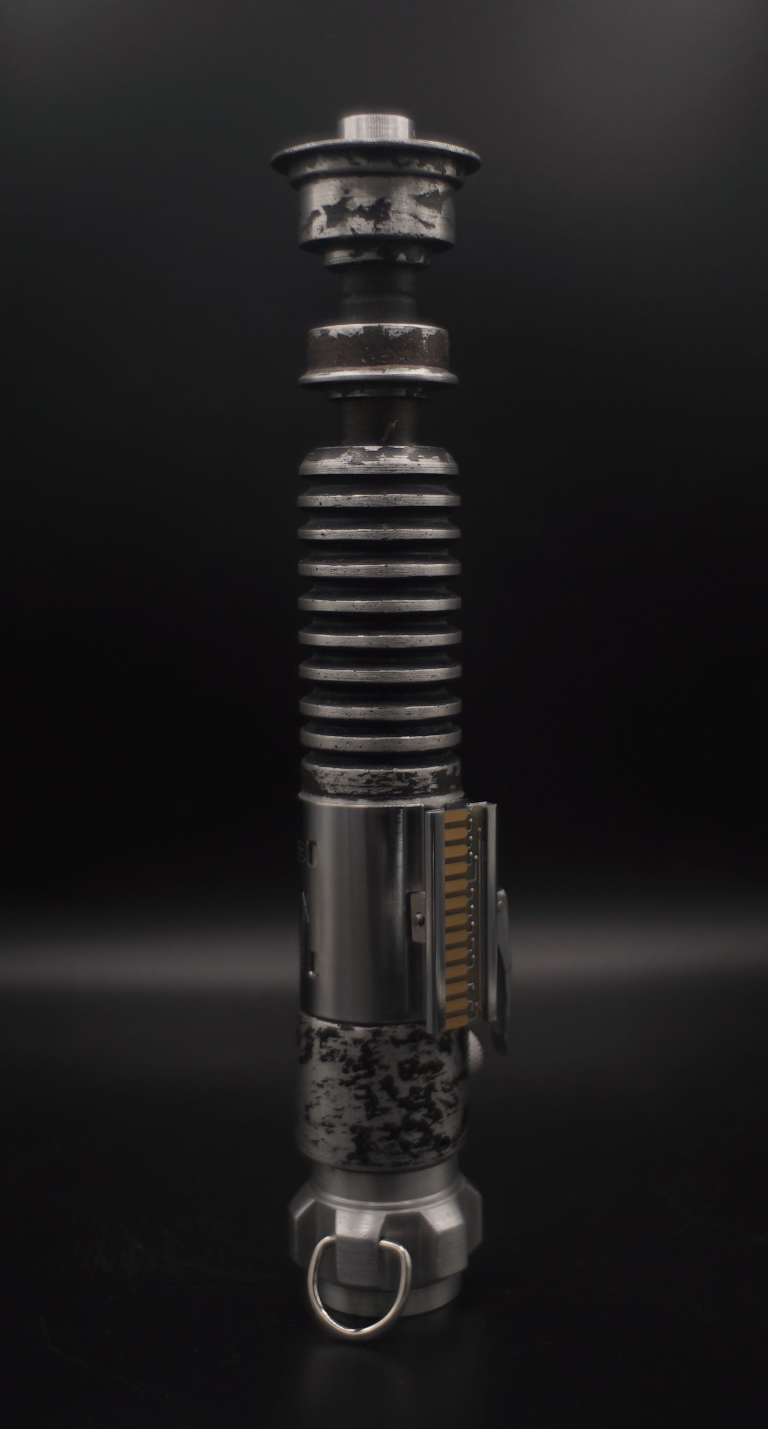

One plus is that I've settled on the paint application of the stunt hilts as they were first done up. I always felt it was doing too much if I was mixing specific, hard-to-find colors together. It didn't feel authentic to something that was dictated by having little time and money to produce. It need to be something simple and fast, and that turned out to be just an airbrushing of brass enamel over black, and then dry-brushed with black on top and calling it quits.
Not too bad, I think.
The V2 I've made in the photos here and on the project run will be leaving my possession pretty soon. This is a pro-bono gift to vadermania for all he's done not just for the project but for the runs before and after mine, what with all he's shared freely. It will also come with a little bonus. ;)
