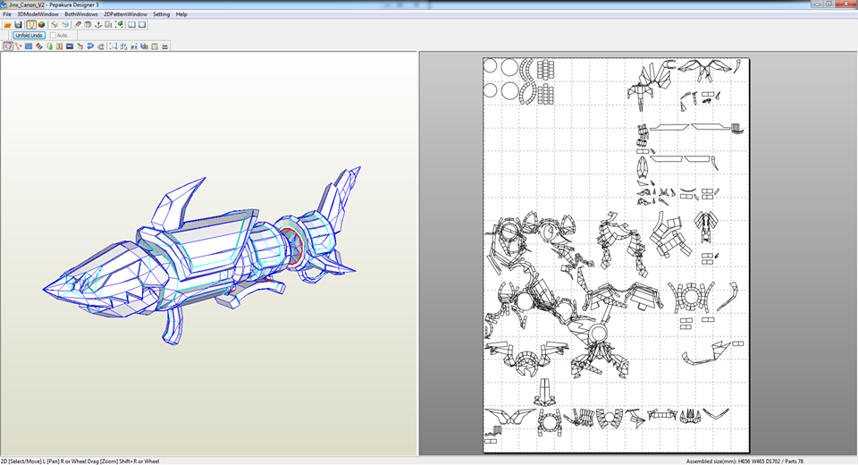

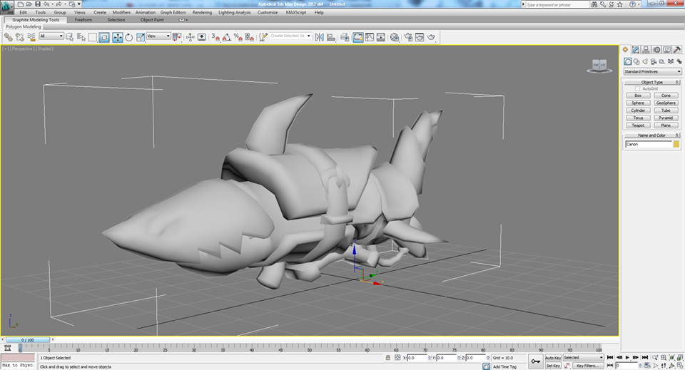

First thing I did was rip the 3D files out of the game and plug them into Pepakura, starting with Fishbones, the shark bazooka.
I scaled the pep so that a 4in pvc pipe could eventually be run through the parts as the base. This would later allow for moving parts to be placed inside barrel that make the jaw open and close. Followed up by folding the papercraft, cutting the pipe to length and throwing some fiberglass resin into the mix.

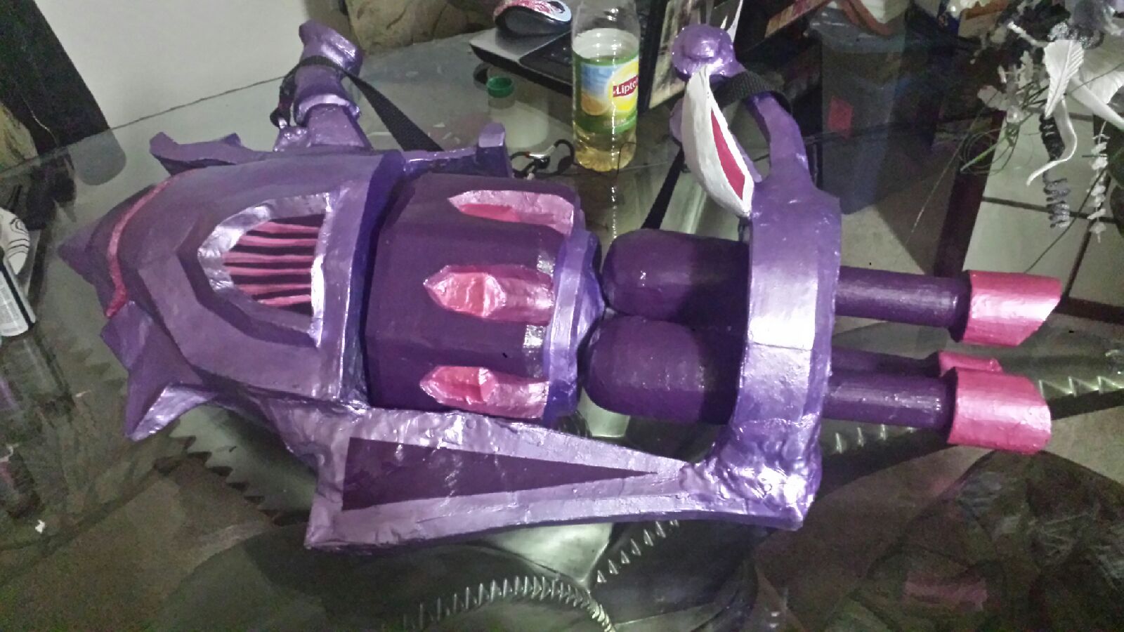

As of today I've been working on getting all the parts through their body filler treatment, starting with the Upper Jaw which is going to need a lot of attention. Later on I'm planning on adding LEDs to the eyes and barrel. I've also recently started folding the Minigun.

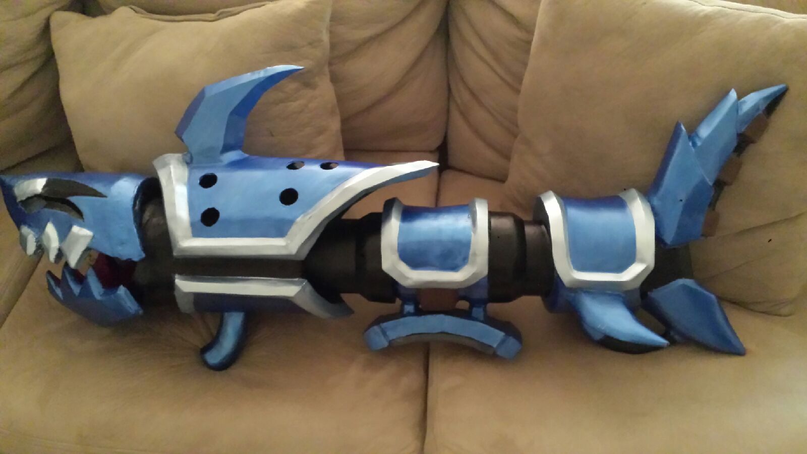

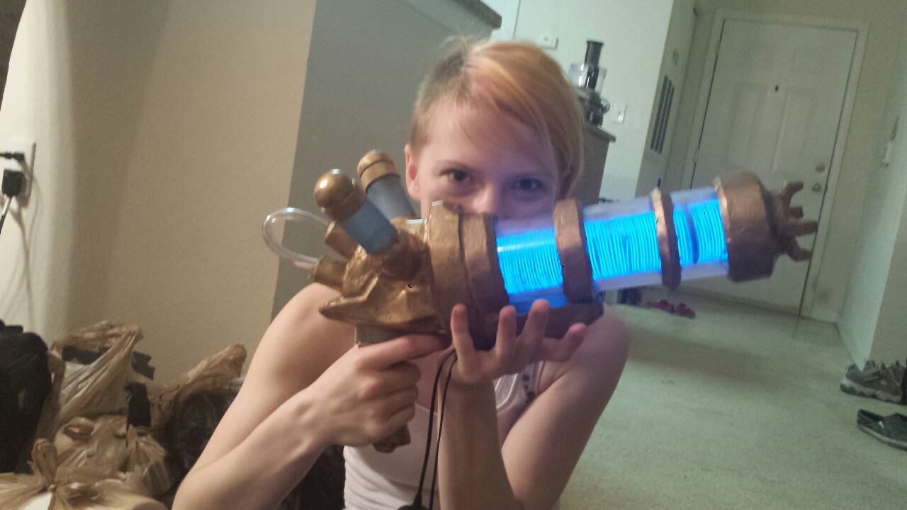

Okie dokie, sorry for not keeping up with the thread, it's been nearly a decade since I was last a part of a forum and I honestly just forgot to update here along with the other social media I was updating (Facebook and Flickr mostly). The build is finally done and I've released the .pdo files along with it. I have a complete write up on my blogspot here, at the end of the post you'll find the download link for the pepakura files. Also here are a few photos of the final product along with my client's cosplay.
