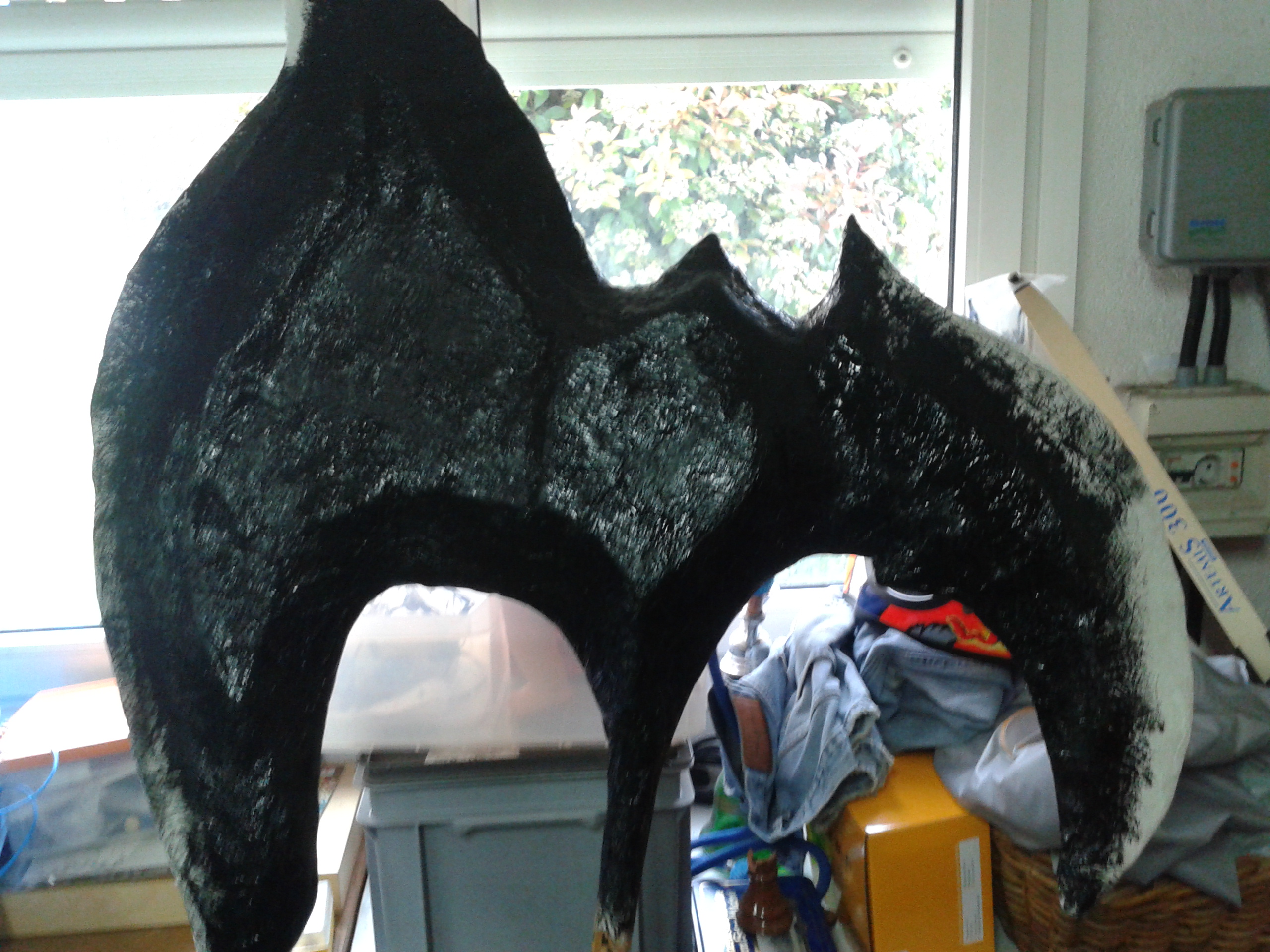

This is my first replica, it is meant for a Drius cosplay, it is not finished yet and I need some help.
I have used a cardboard basis with some reinforcements and I'he applied expanding foam on it, finally I've put a newspaper with glue layer.
Firstly, I show a step by step gallery of what I have done until now:
However, I don't like the newspaper layer so I would like to know what to put in order to have a good surface to paint.
I wonder if kitchen paperwith glue would be good idea.
Thank you very much for your attention and sorry about my poor english.

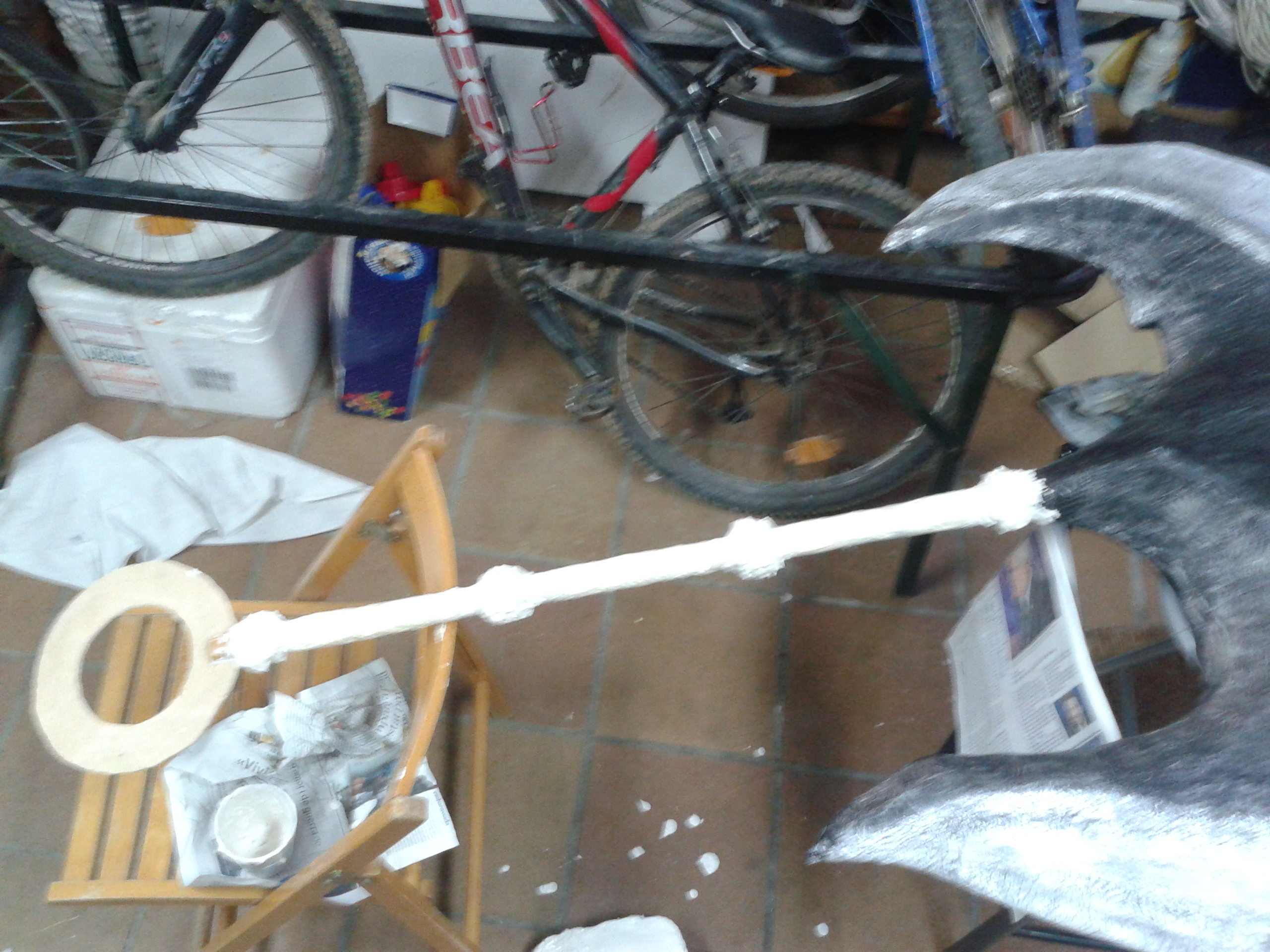

After some advice I recieved, I tried to find something like a plaster to do a layer for the paint. However, after going to some shops I concluded it would be expensive and a large amount of work.
Finally, I found a cheap special glue for the foam, so I have done a mache paper (kitchen paper this time) thin layer with this glue and I will add some extra layers with normal glue.
The next step is, after adding the layers and doing the details with mache paper, sanding the whole thing to have a good result and paint it with a normal acrylic spray paint.
This is it's status right now:
Thanks for your attention.

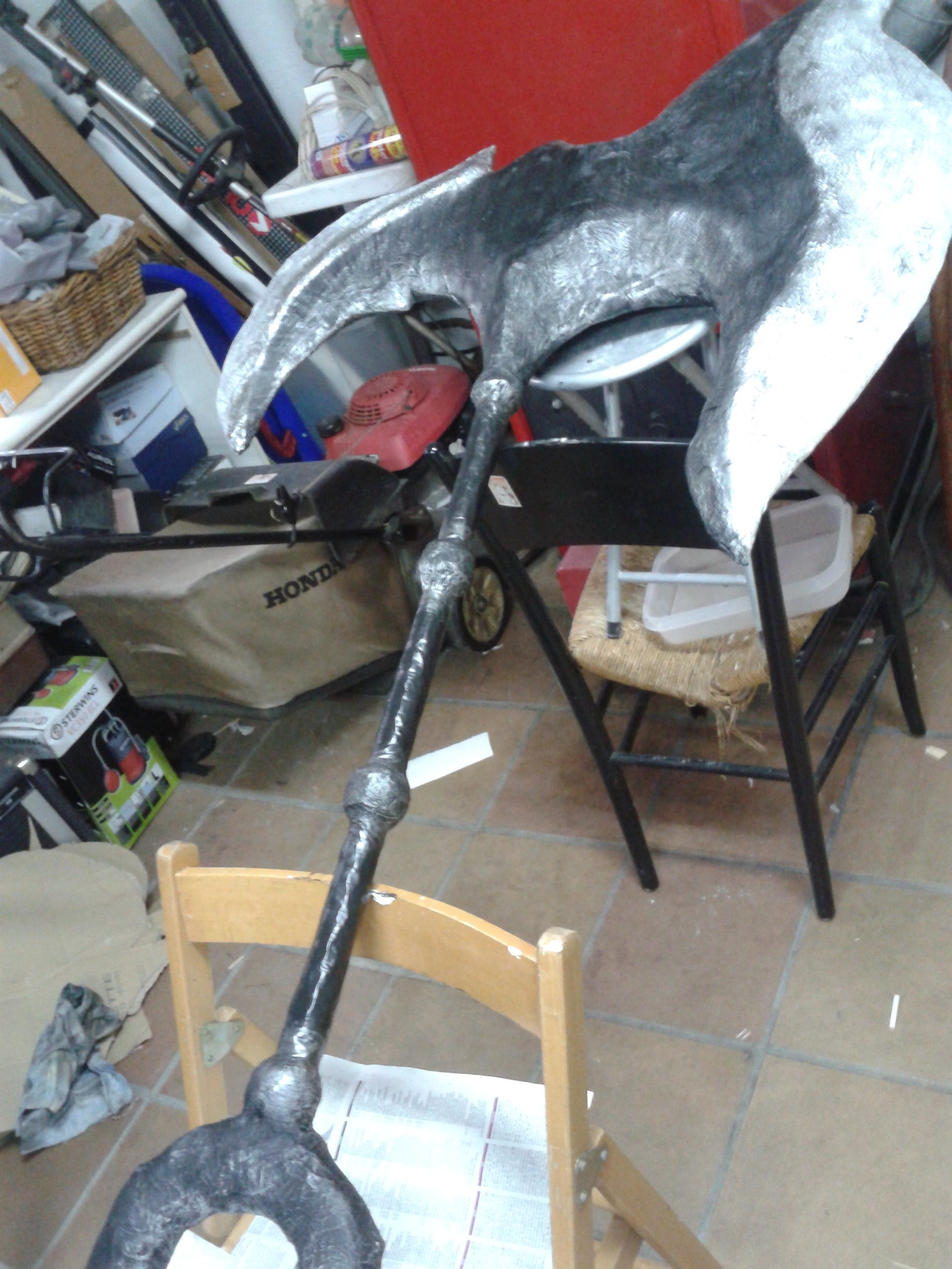

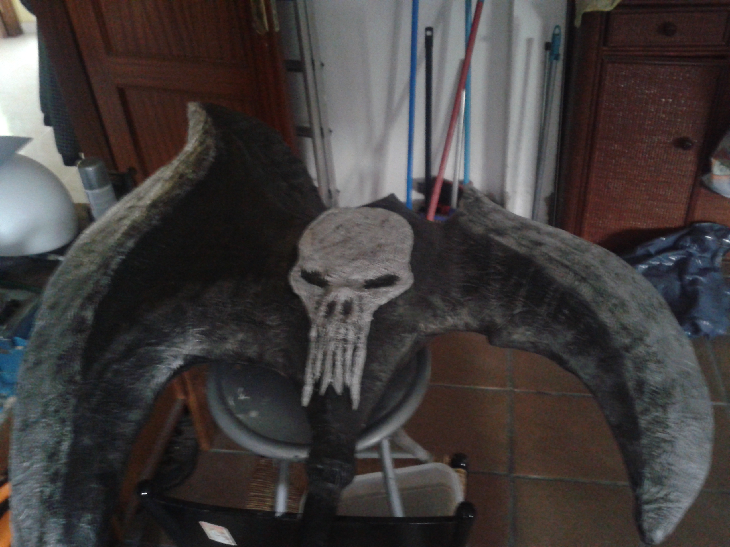

I have kept on working, adding layers of mache paper and painting.
right now only the skull and the are handle missing.

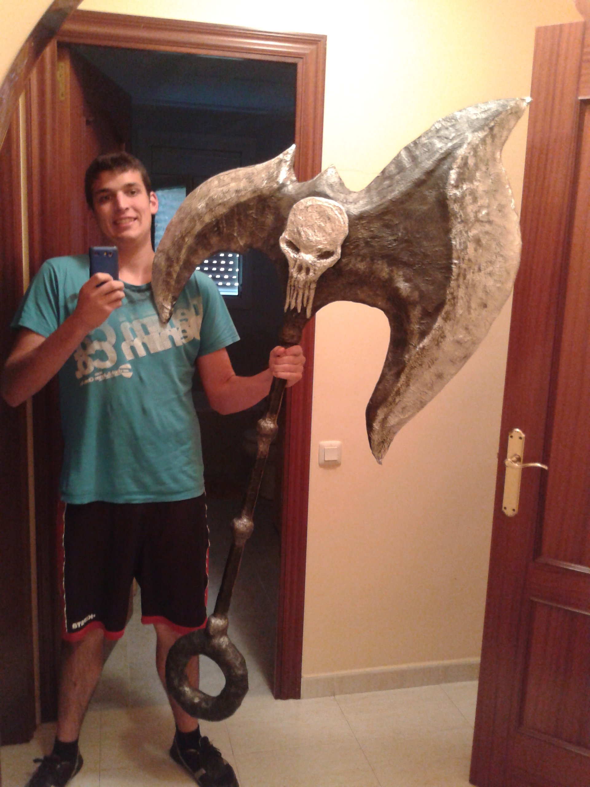

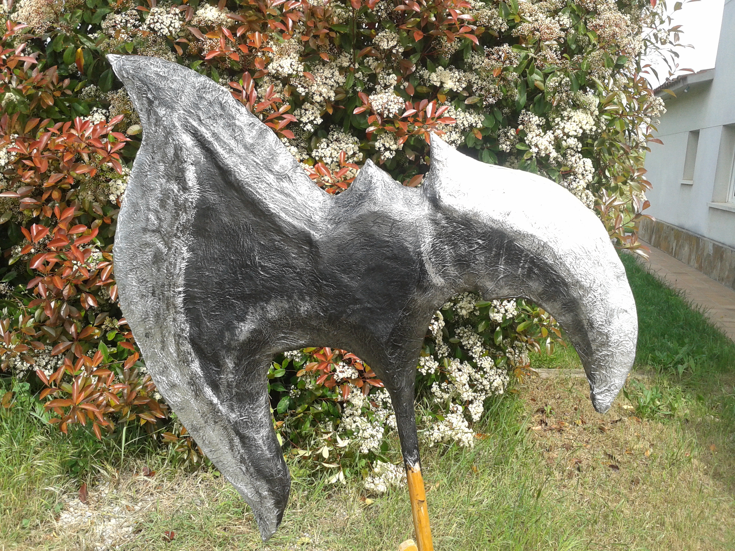

I continued with the work and I have finally finished the axe :)

Here are all the photos!
