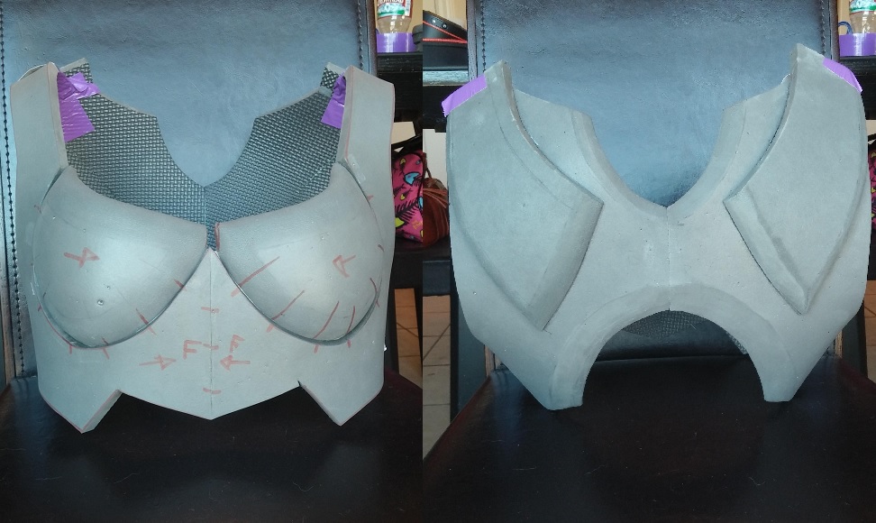

The first thing I decided to make was the breastplate. I used a duct tape dummy to get the pattern and then transferred it onto my foam. Cut out the pieces, did a little sanding to soften some of the edges, roughly heat formed some of the pieces and then put everything together with contact cement.
For now it's held together at the seams with tape until I can get some Neodymium magnets.
