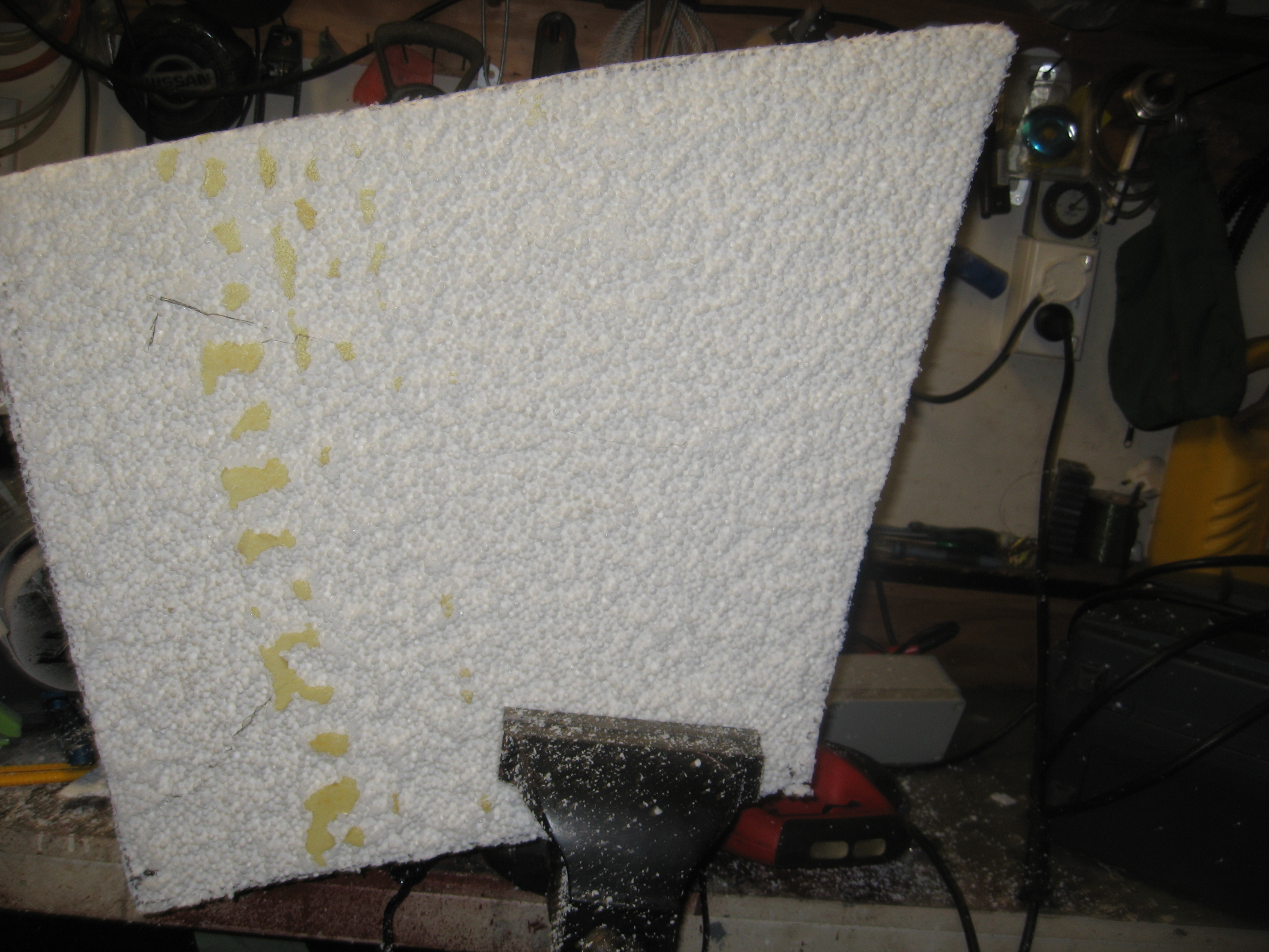

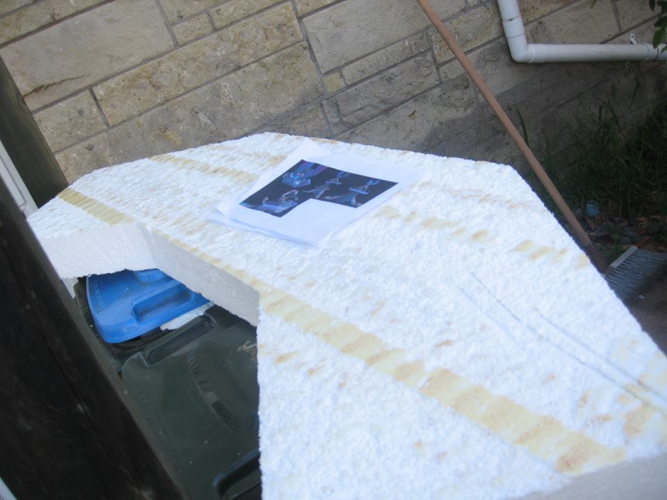

So I cut the slabs of polystyrene out today.
(And theres polystyrene fluff all over my workshop T_T)
All those pieces fit together to make the console that Sona is holding :3
JK I have to glue them all together, :|
And Yea, I did fail at that first piece of polystyrene, (Cut it by hand, lel)

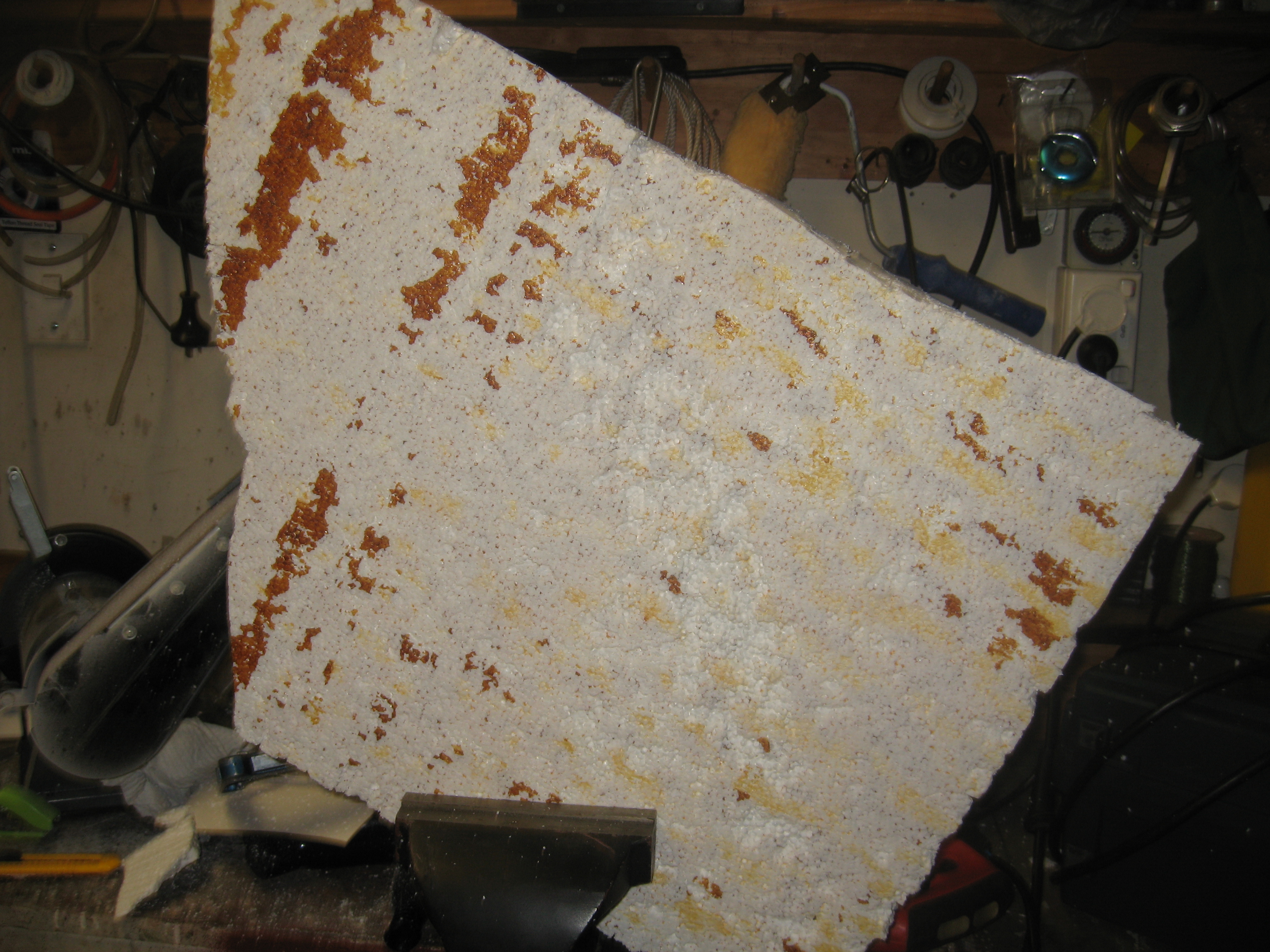

Seems legit,
I recut the whole prop again though, I thought it would be easier to not have to glue pieces of polystyrene together,

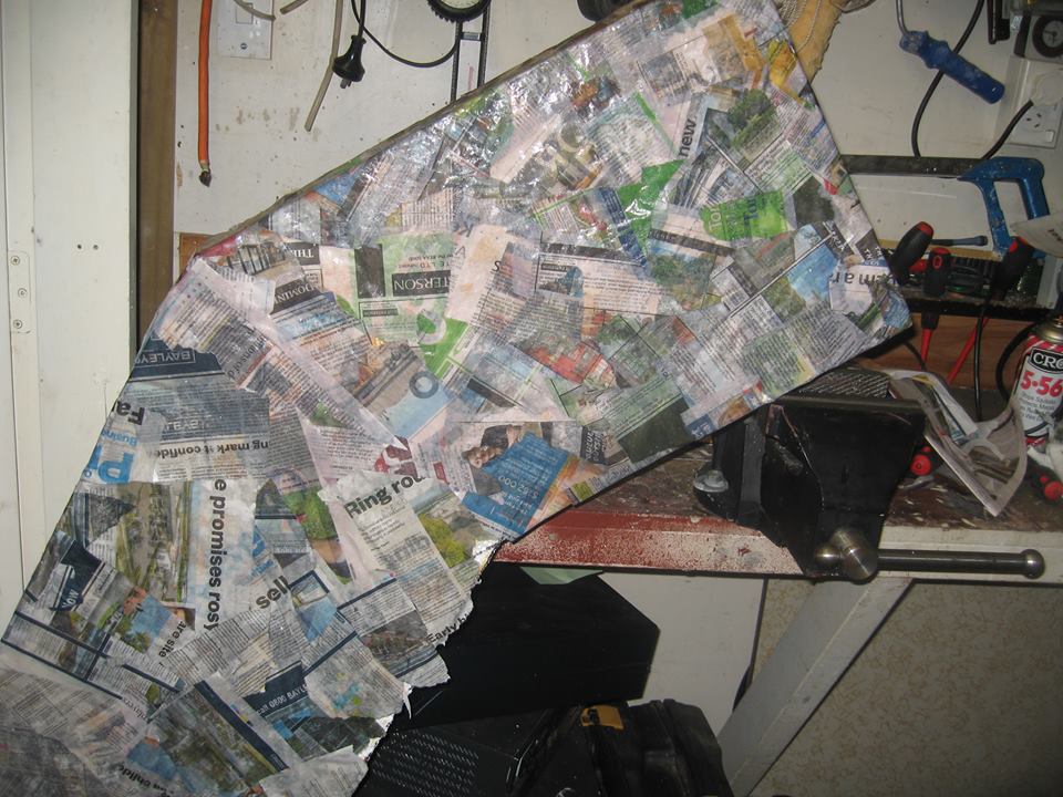

I went with paper mache to reinforce it a bit :3
It's gonna be fabulous~
