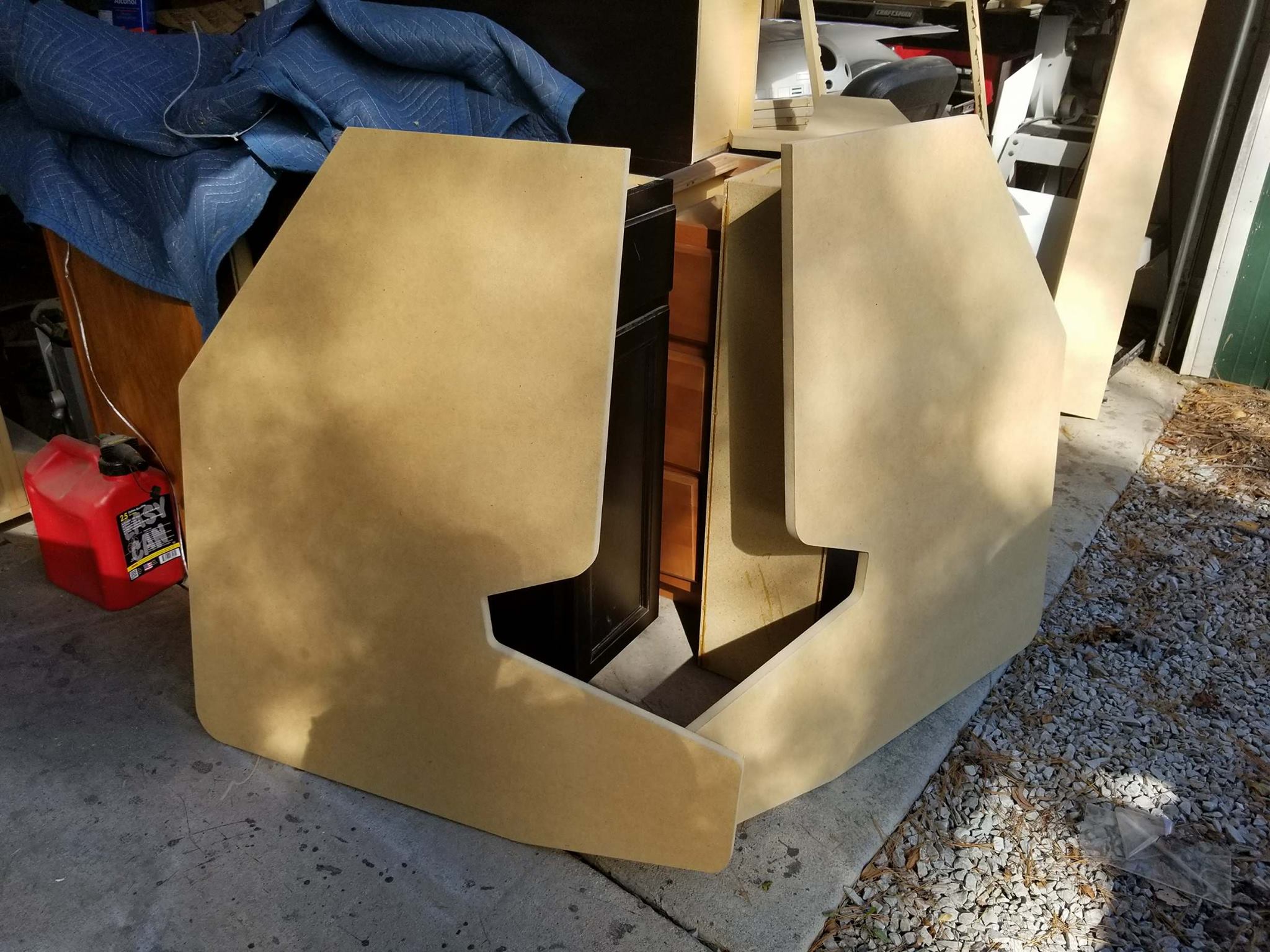

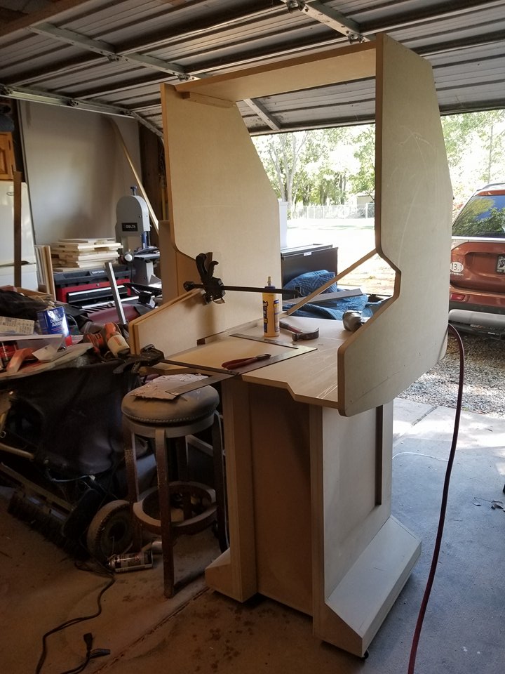

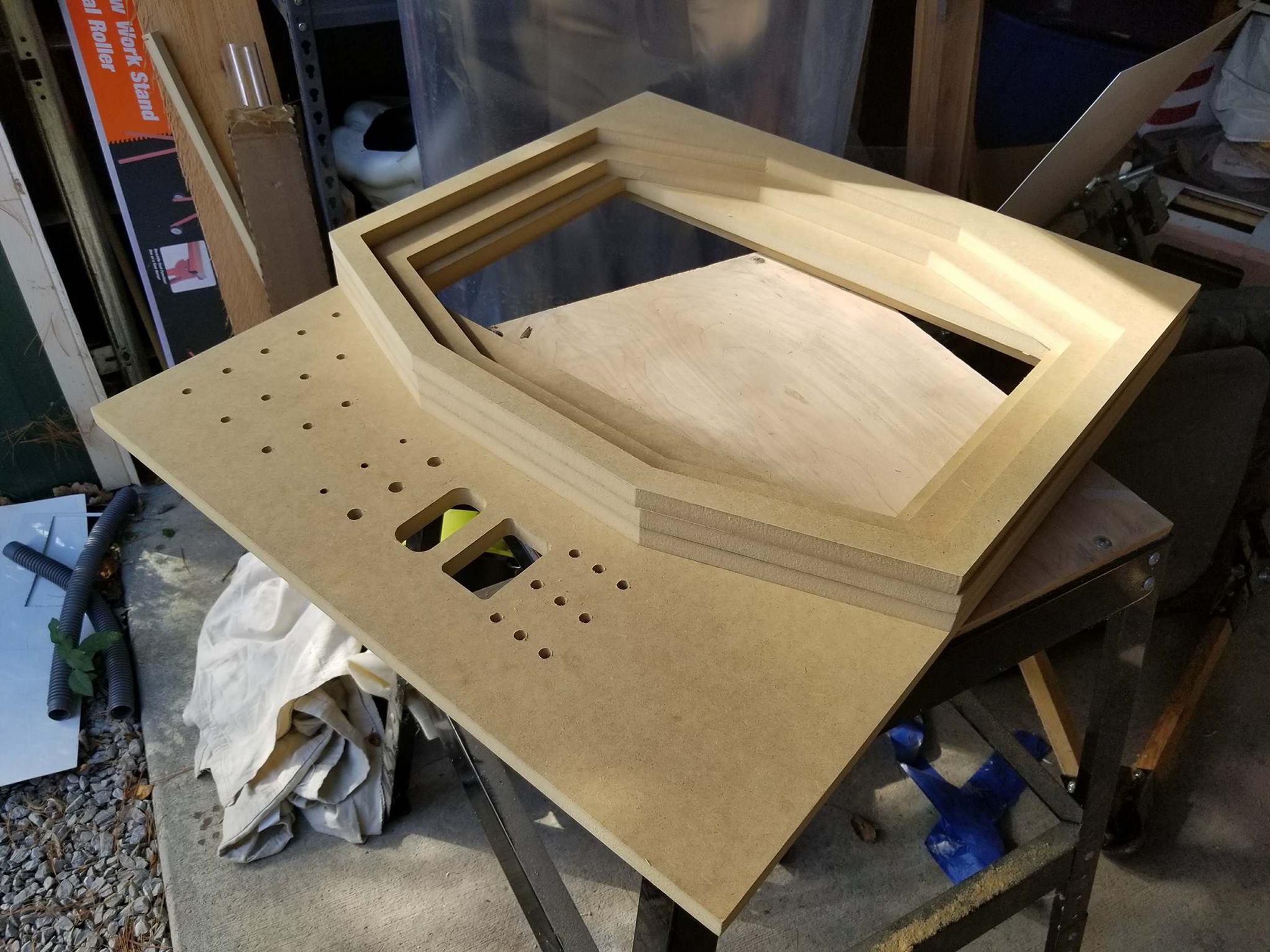

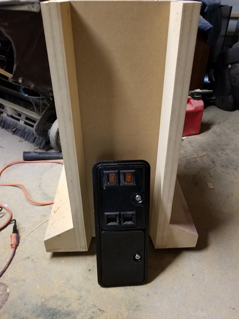

This has been rattling around in my head for way too long, so I picked up 3 sheets of 3/4" mdf and got to work on this Saturday.
It's based on the blueprints available online along with some additional reference material I was able to get from a friend. So far so good. The complex shapes I cut on a CNC machine, and everything else I did on my table saw. Granted, so far I'm only on the super easy bits, but it's been fun.

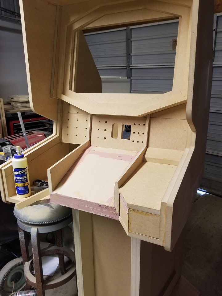

Day two is in the bag. Only thing left build wise is the left hand control area and cutting out the pockets for the joysticks. Hopefully I can have it all built by Friday and then begin the long, arduous process of clean up and bondo. Cue: this is where I start to get bored music.

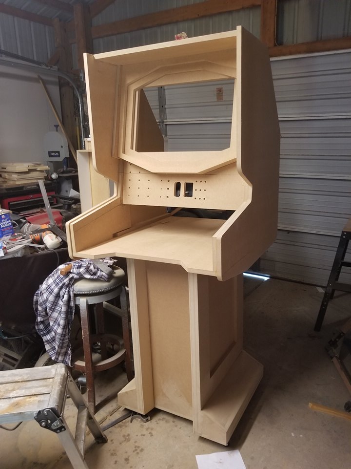

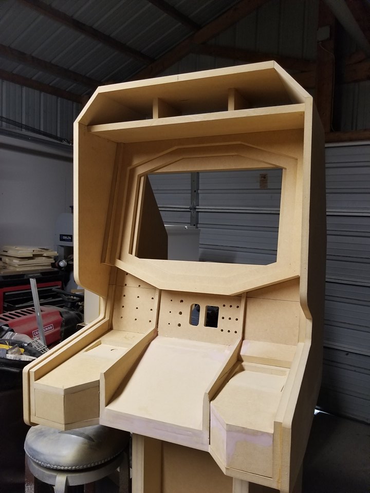

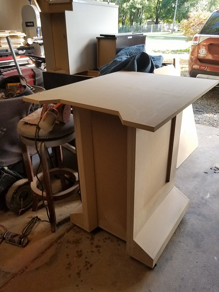

The build part of my Last Starfighter cabinet is done. I'm gonna say I have about 30 hours into it at this point.

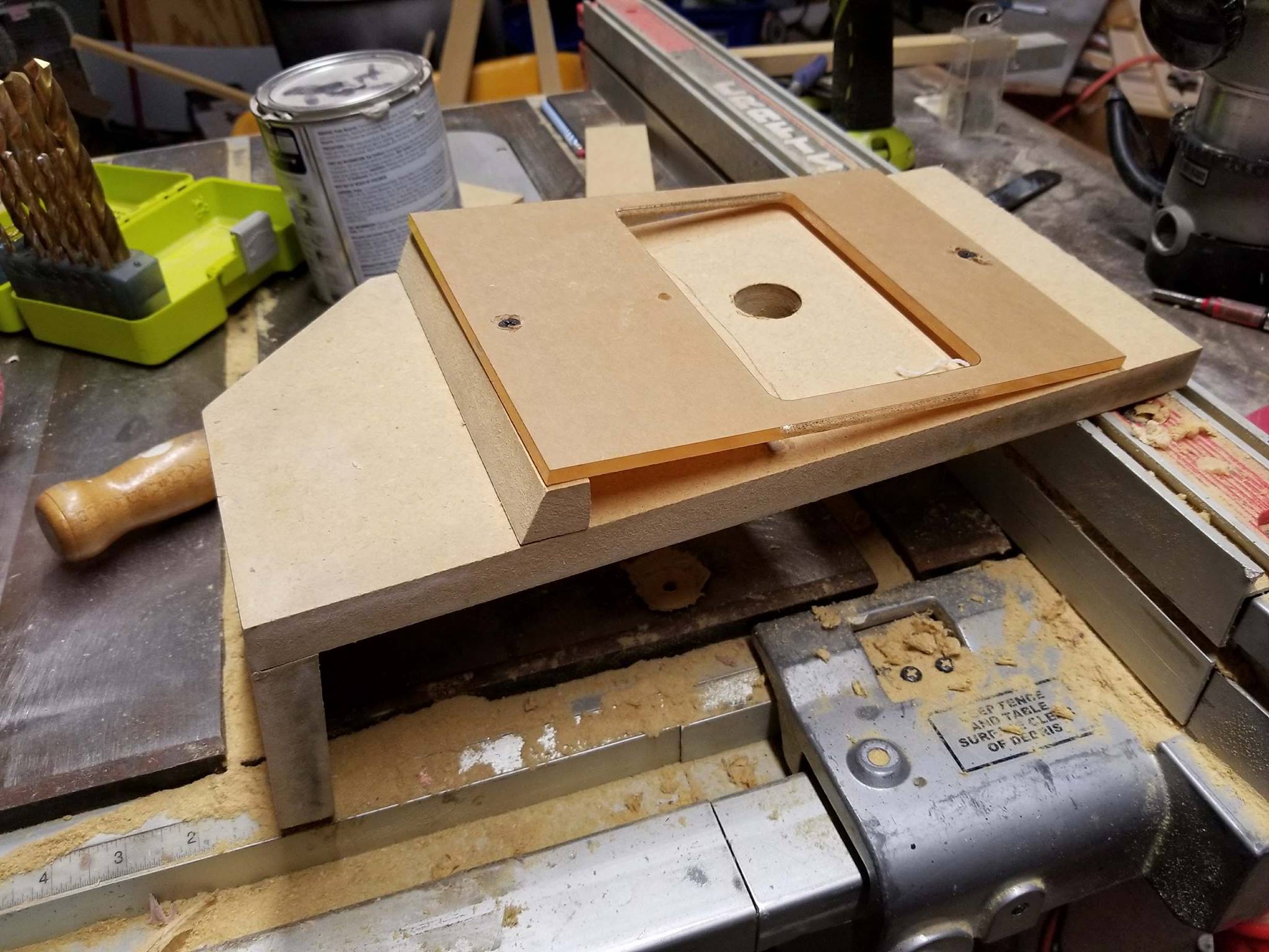

This morning I had the most difficult part, creating pockets for the controls. I decided to laser cut a jig for my router, and it worked pretty well. If I had to do this 10 more times, I'd sure I'd figure out a better way to do it...but this worked for a one off.
Now to let everything set, and start applying the bondo and get it ready for paint.

A couple of notes so far:
Materials used:
3- 4x8 sheets of 3/4" MDF
1 -2x4 sheet of 1/2" MDF
Bondo
Set of casters
Tools used:
Table Saw
Compound Miter Saw
Nail gun (16 and 18 gauge nailers)
Drill
Router
Handsaw
CNC Machine
Random Orbital Sander
The side panels, monitor bezel and base were cut on a CNC machine as I noted before. Doing this probably saved me a full day of cutting and at least an extra sheet of material. I cannot recommend this enough if it's an option. I use a local sign shop that does engraved signs to do a lot of CNC work for me.
As far as mods go to the blueprints that are out there, I reached out to Philip Wise who has been working on this for a long time. He was able to get me enough measurements to get started, but for the control area, you're pretty much on your own. You just have to make it all fit...and even then I missed some things.
