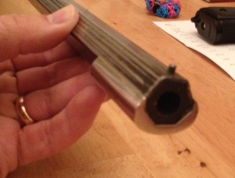

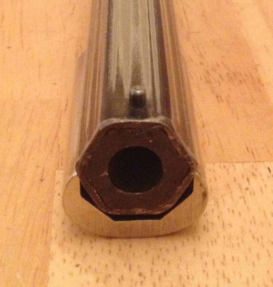

Ha! In setting up pics to better explain, I realized my (STUPID!) mistake...
The muzzle cap I ordered is octoganal. The barrel is hexogonal...

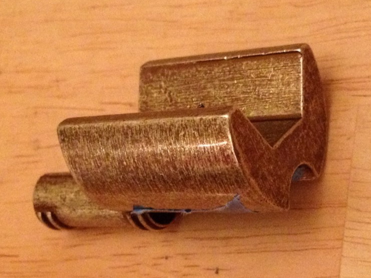

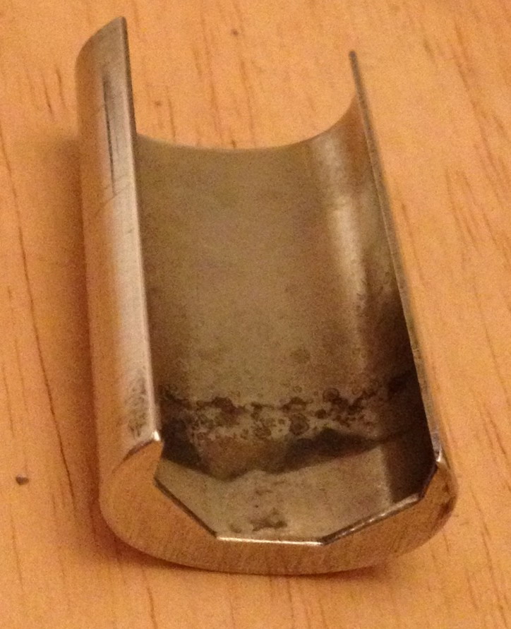

Here are the pics, nonetheless:
The original muzzle cap
The replacement
The misfit (for stupidly obvious reasons)

Ahh, ok, the fore end cap. They just usually cast them and you need to file for a proper fit.
