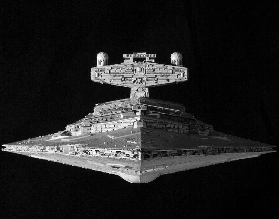

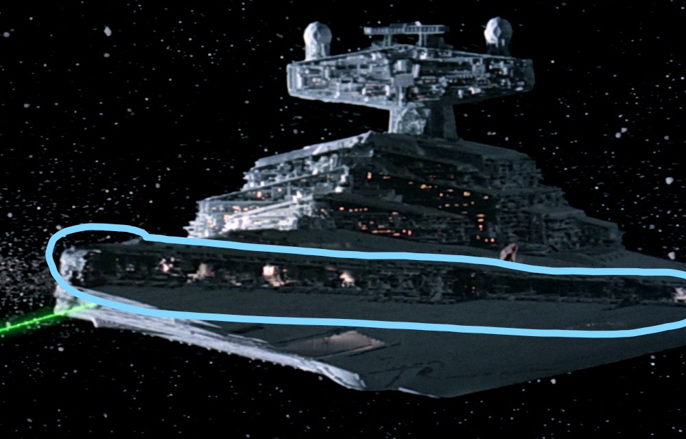

Gotcha. For the Zvezda kit, I've heard that you can buy custom resin replacements for certain sections like the shield generators and such. What seller would you recommend for the most accurate replacement parts?
Also, is it me or is the trench between the top and bottom hull of the Zvezda model kit thinner than the actual model? If so, is there a practical modification to widen it?

I'm no expert, but I believe you are correct, I've read many times that the Zvezda side wall trench is too narrow, and the wedding cake superstructure on the Zvezda is too squished as well. Bandai's 1/5000 is dead accurate as Invar stated. If only Bandai could release a larger one! :(
308 Bits at Shapeways has 1/2700 3D resin parts that many builders have used with great success. I also used Falcon 3Ds upgrade parts for the radar domes, engine bells and Hyperdrive engines and the garbage chute etc.
It is too thin. Part of the reason is due to the use of a digital model element from Rogue One on their ISD -I class, which for some reason, the retail specs have the side trenches far too thin, as much as the old MPC kit's side trenches were too tall. I ended up manually increasing the trench height by 3.2MM or 1/8" but that caused some other serious issues - specifically with the engine block and the top and bottom hull fitting. My build thread showcases what I had to do to deal with that.

Also, going back to the trench again, I looked again at your mentionings of it on the main thread, but it seems on those posts you indicated you raised it by 1.5mm. Did I miss a later post clarifying you modified it to 3.2mm?
-Matthew
My bad. When replying I grabbed the wrong pack of rods which were square tubes at 3.2mm, not the 1.5 mm square rods I used to raise the trench height. My memory is not the greatest anymore and I had to look to see what the size was and grabbed the wrong pack. Sorry.
