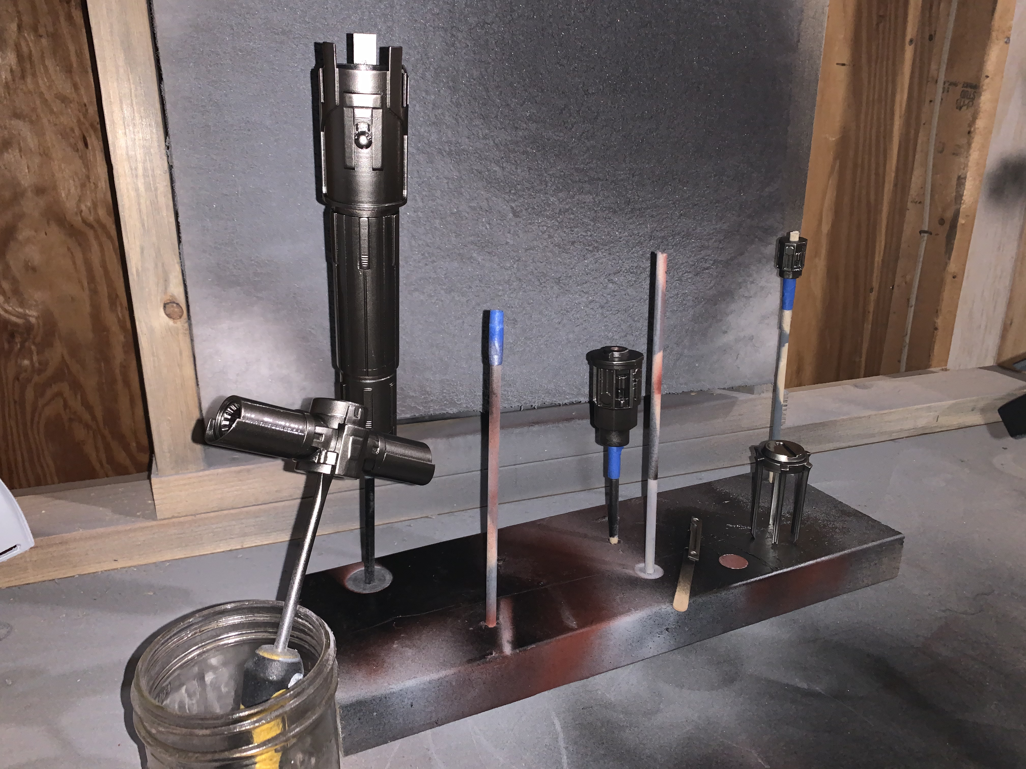

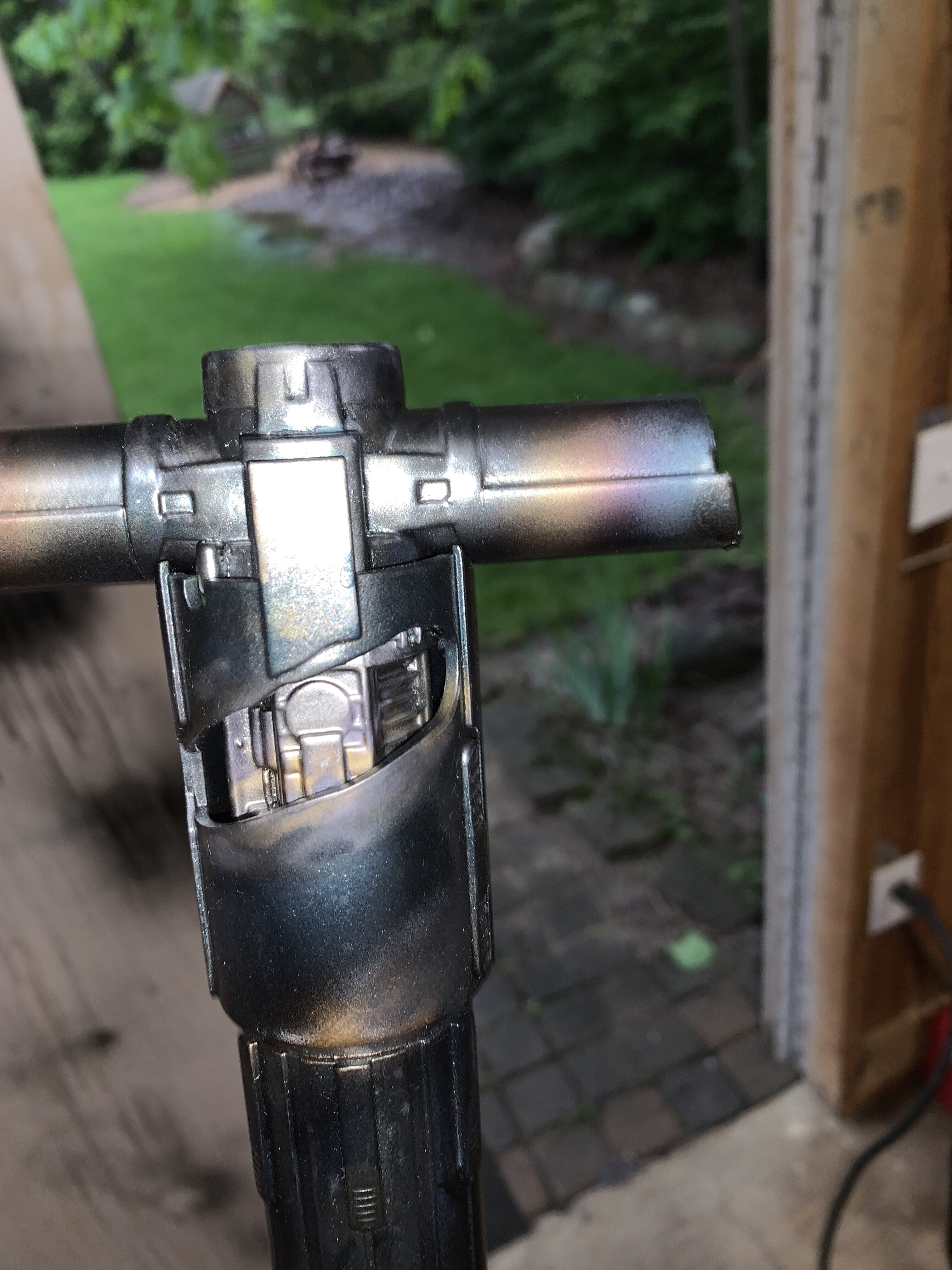

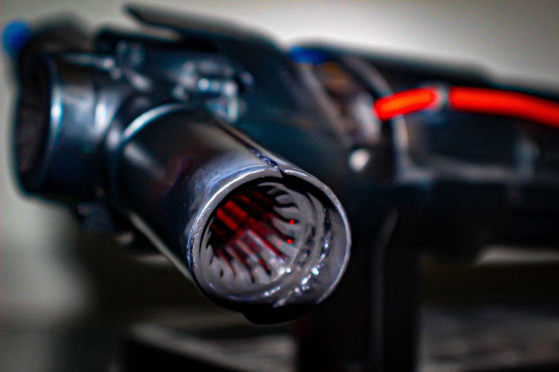

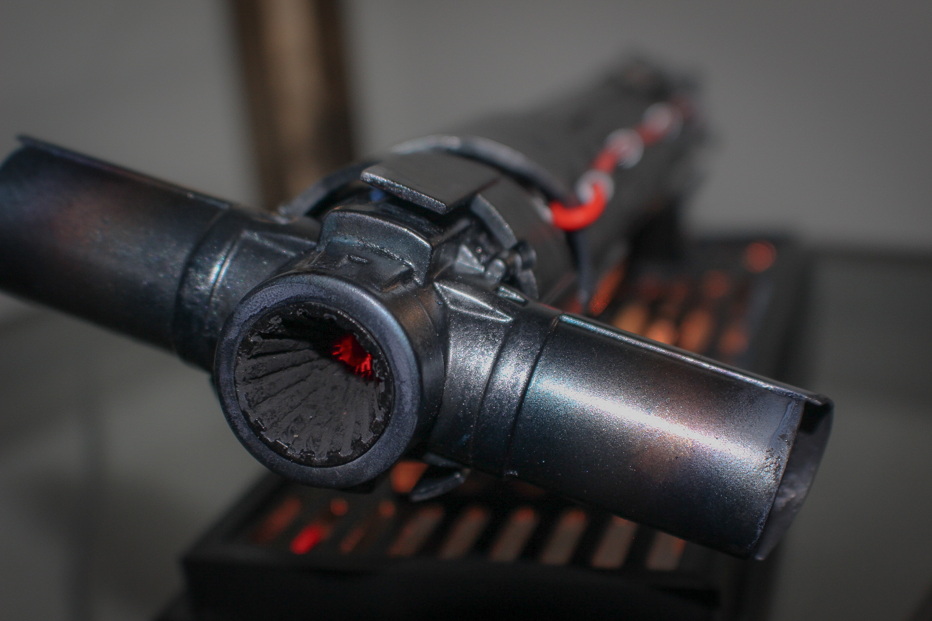

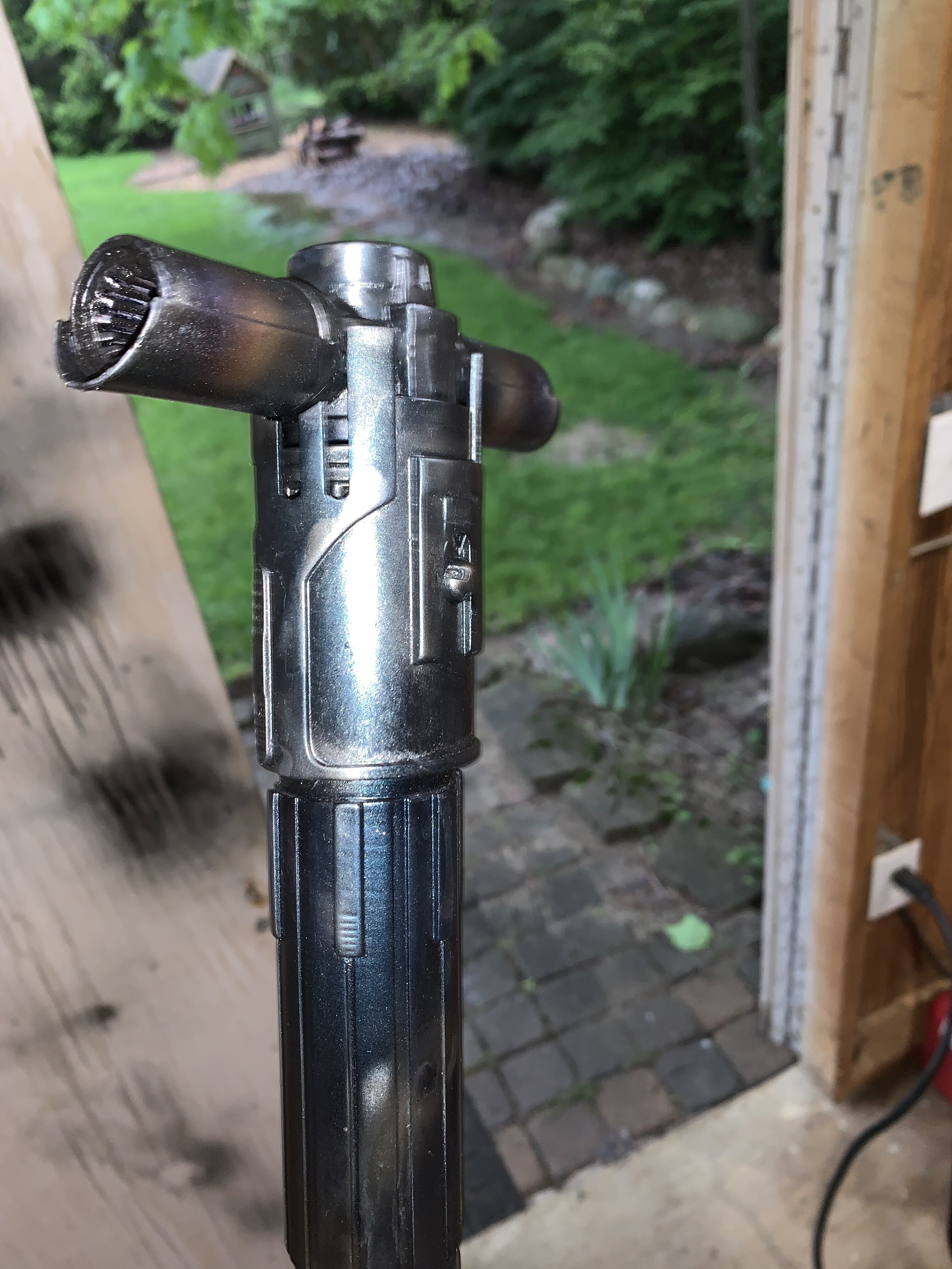

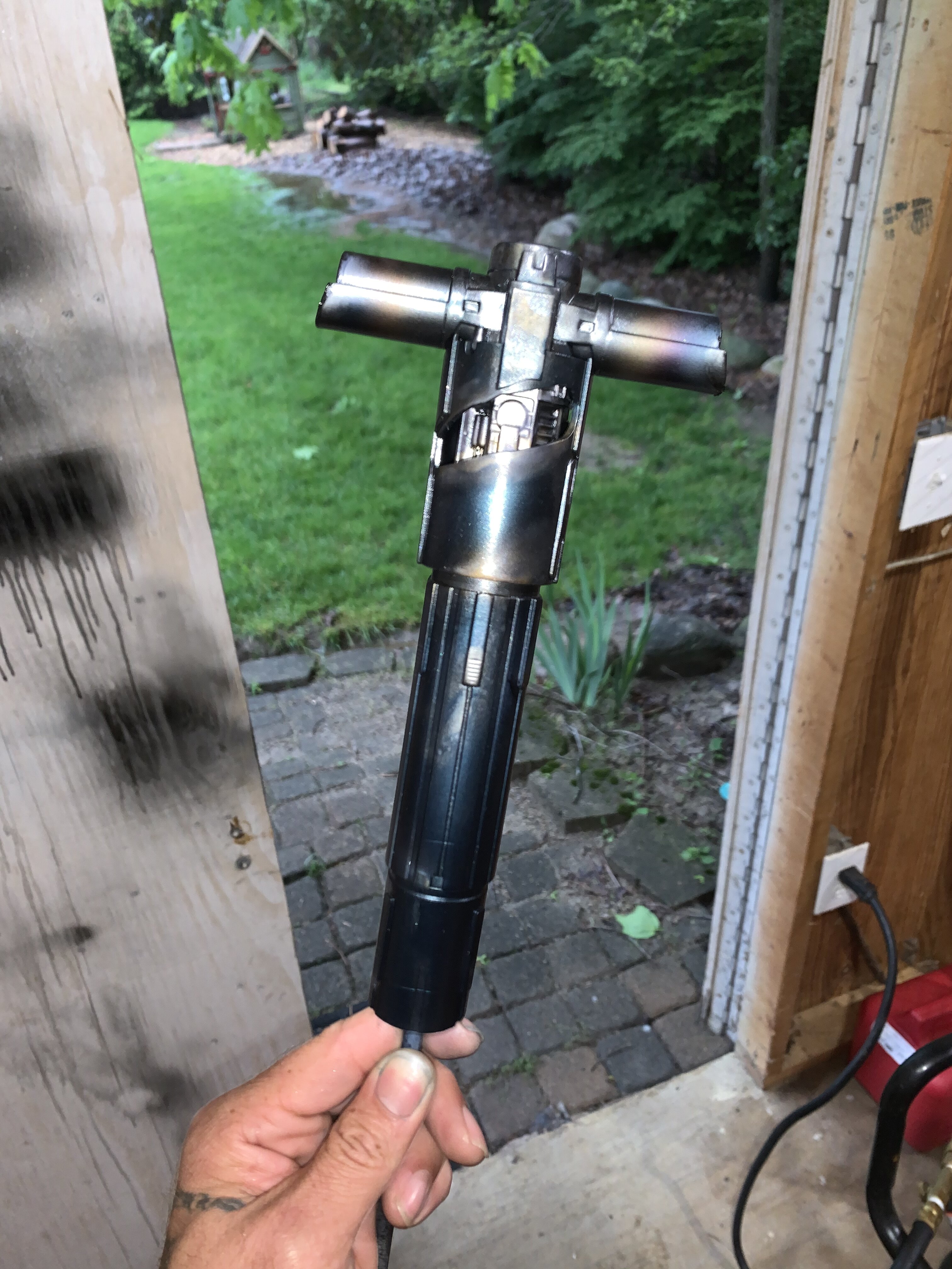

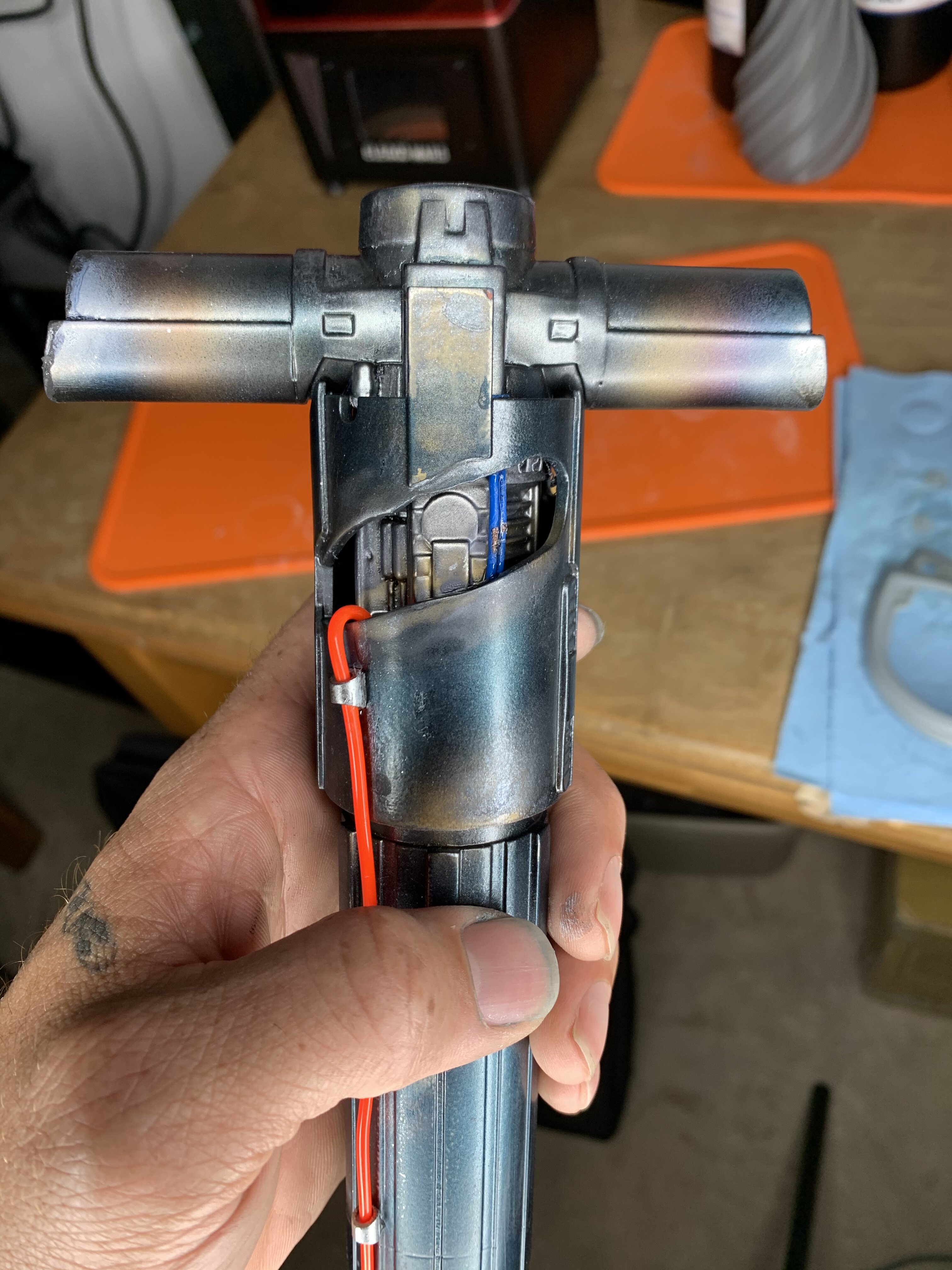

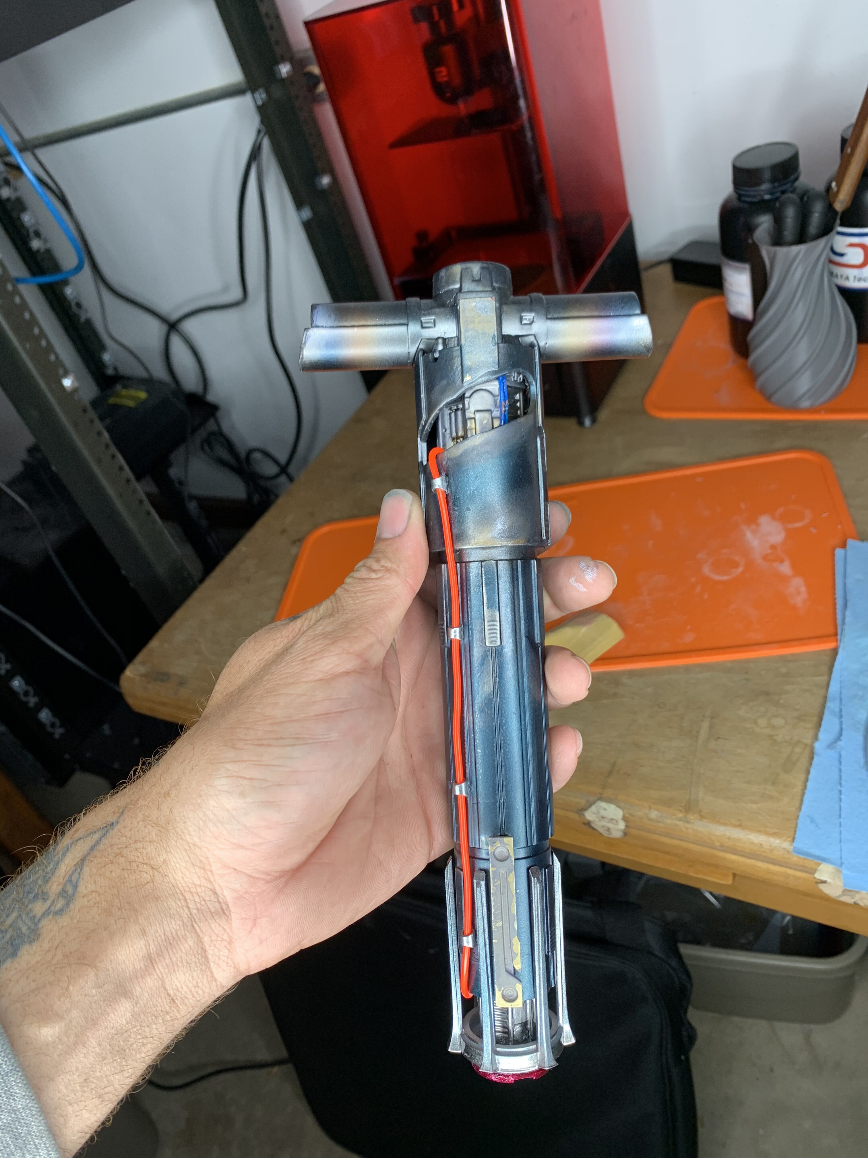

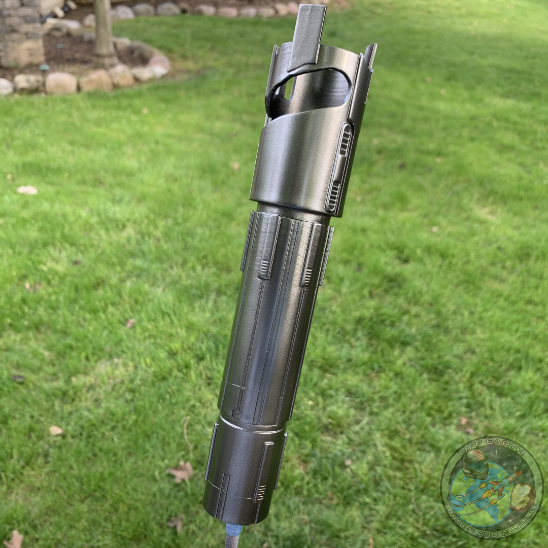

Hello Everyone!

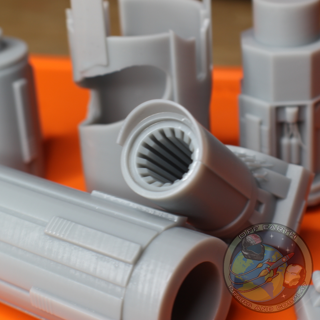

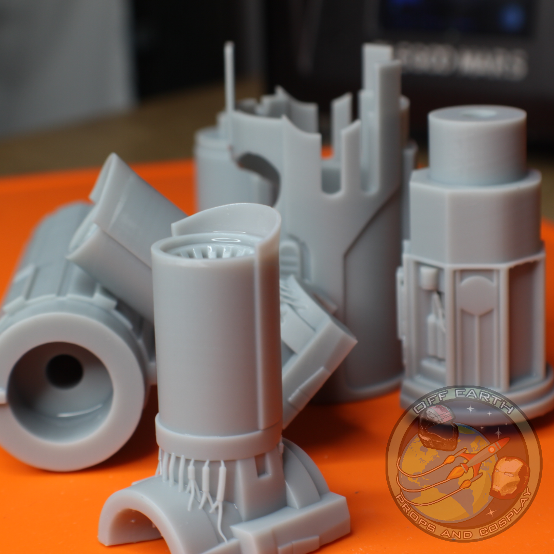

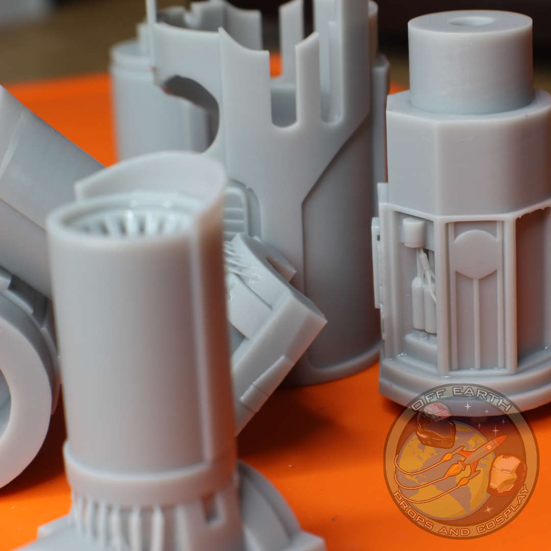

I recently completed a 100% Resin 3D Printed, Kylo Ren Lightsaber hilt.
This was achieved on my Elegoo Mars, using Siraya Tech Fast Resin. It took around 3 days to complete printing.
The piece was washed and cured then sanded with 120g Sandpaper before receiving Automotive Filler Primer and sanded further with 220g-600g. Once sanding was complete I assembled the main hilt and painted all parts with a gloss black undercoat, then Imperial Surfaces Alumaluster. Once dried I sealed everything with a 2K Urethane Clear.

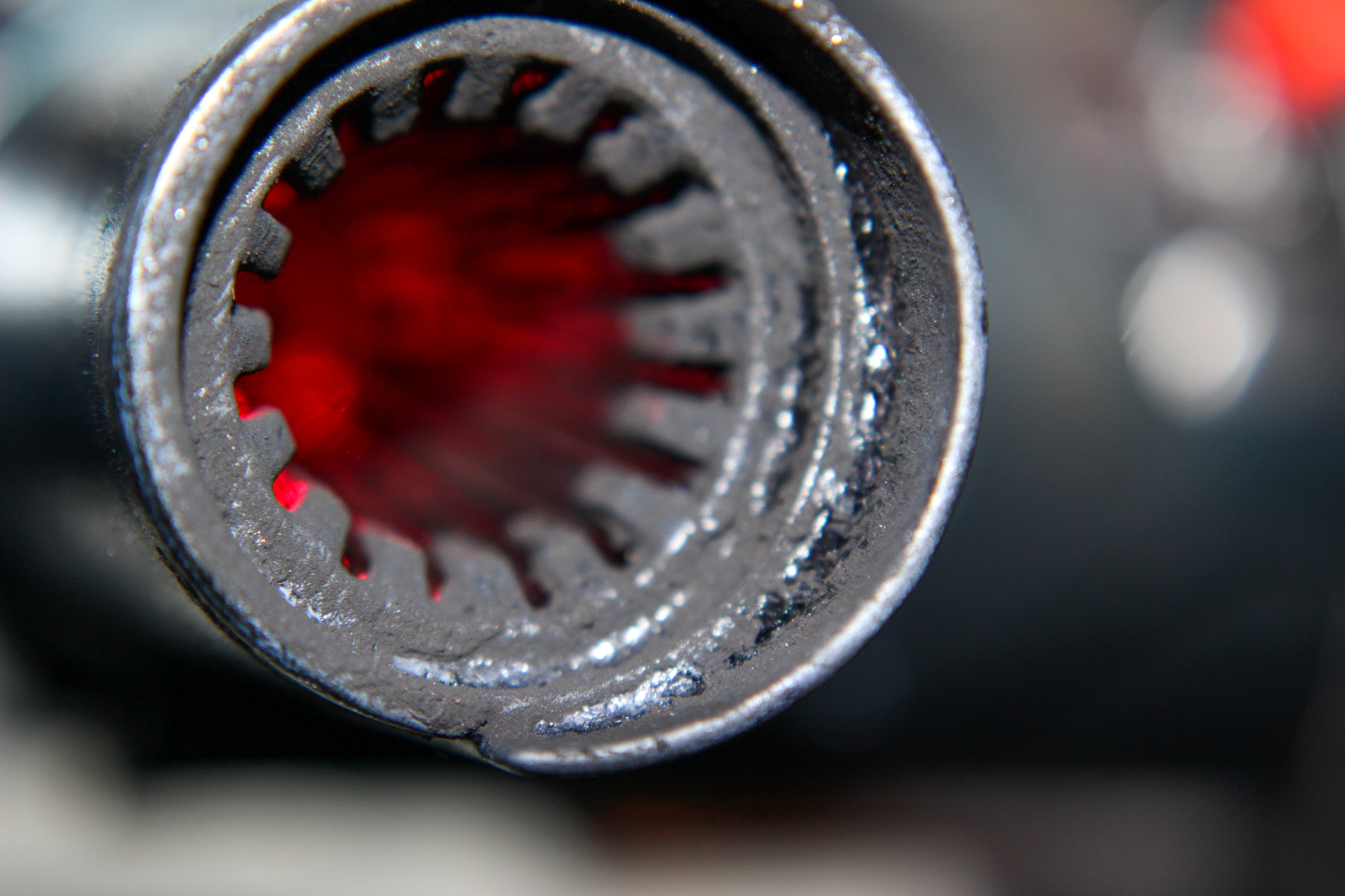

Next, I highlighted specific areas with Alclad II Polished Brass, Alumaluster, and Alclad II Transprent Smoke. I added a “heat treated” effect to the side vents with Alclad II Transparent Yellow, Red, Violet, Blue and Hot Metal Sepia.
The main parts were then painted with Specialist Paints Metallic Blue mixed with some Black to darken the hue. For weathering I used Vallejo Air Black Airbrush paint, Vallejo Pigments and some paint thinner to wipe away top layers of paint for a gradient weathering. Rub n Buff was applied to highlight some areas as well.
The red cable I used was El-Wire (2.8mm OD) and the blue was some spare 22g wire I had in the shop.
I’m very impressed with how this piece turned out!!!
Thanks for looking.
