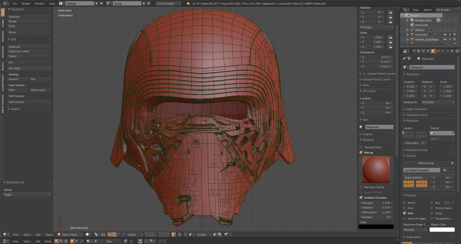

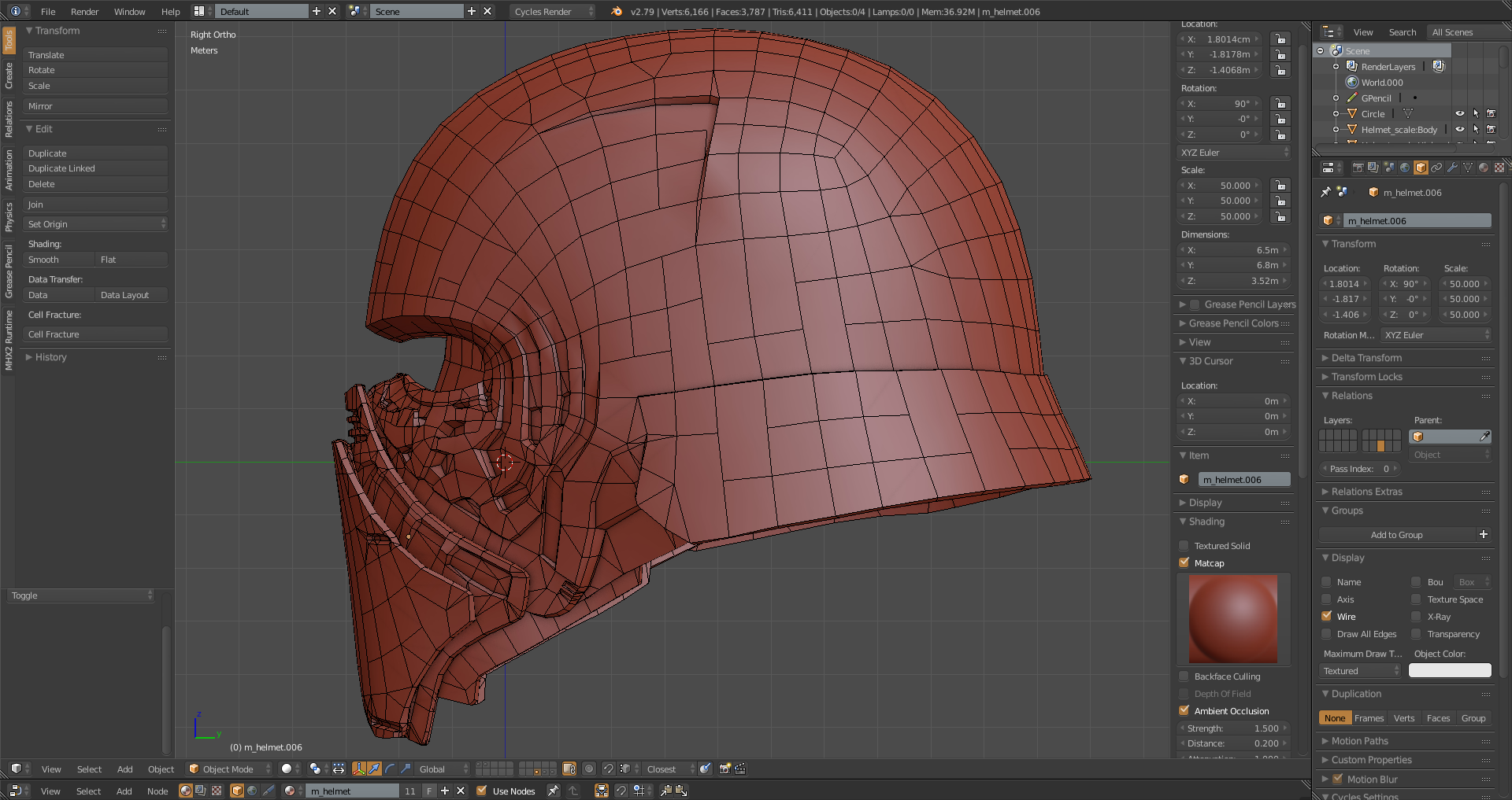

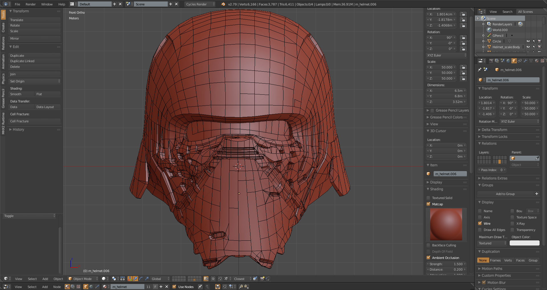

This is after I converted to quads. Originally it was Tris. So not bad, but to "fix" this mesh, add the missing details, scratches etc...I knew it would be very difficult based on that. So, I remodelled the helmet, using this as a base to work off of.

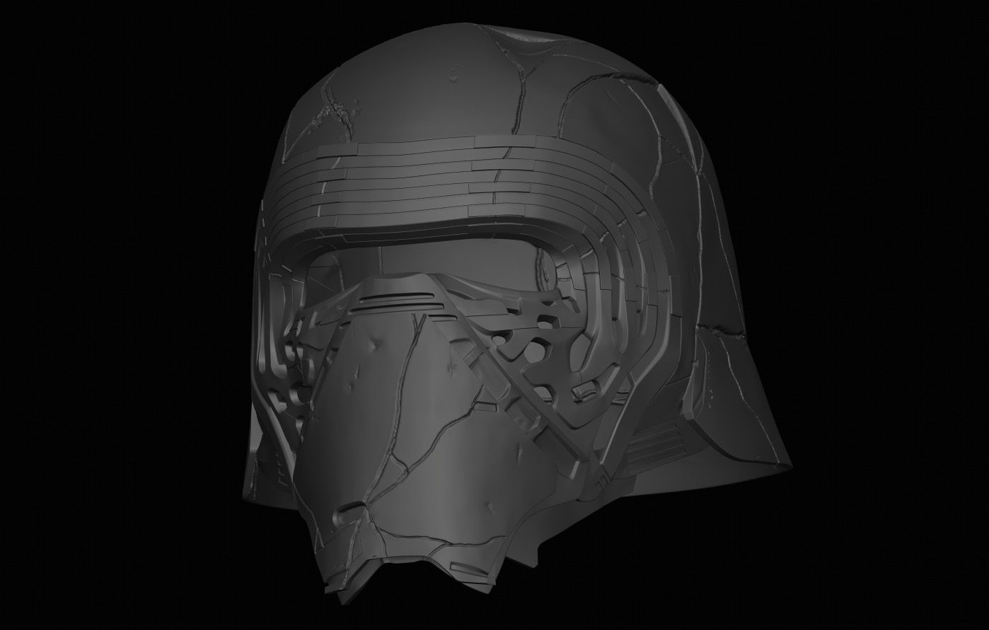

Much Better. I tried to add as many of the dents etc...with topology, but I went in with a final sculpting pass on the helmet (which was a first) and added the remaining holes, dents scratches....and it came out pretty good. Even if there are ~5million verts in just the helmet part o_O
Kylo-SCULPT-PASS-001.pngKylo-SCULPT-PASS-002.pngKylo-SCULPT-PASS-003.pngKylo-SCULPT-PASS-004.png

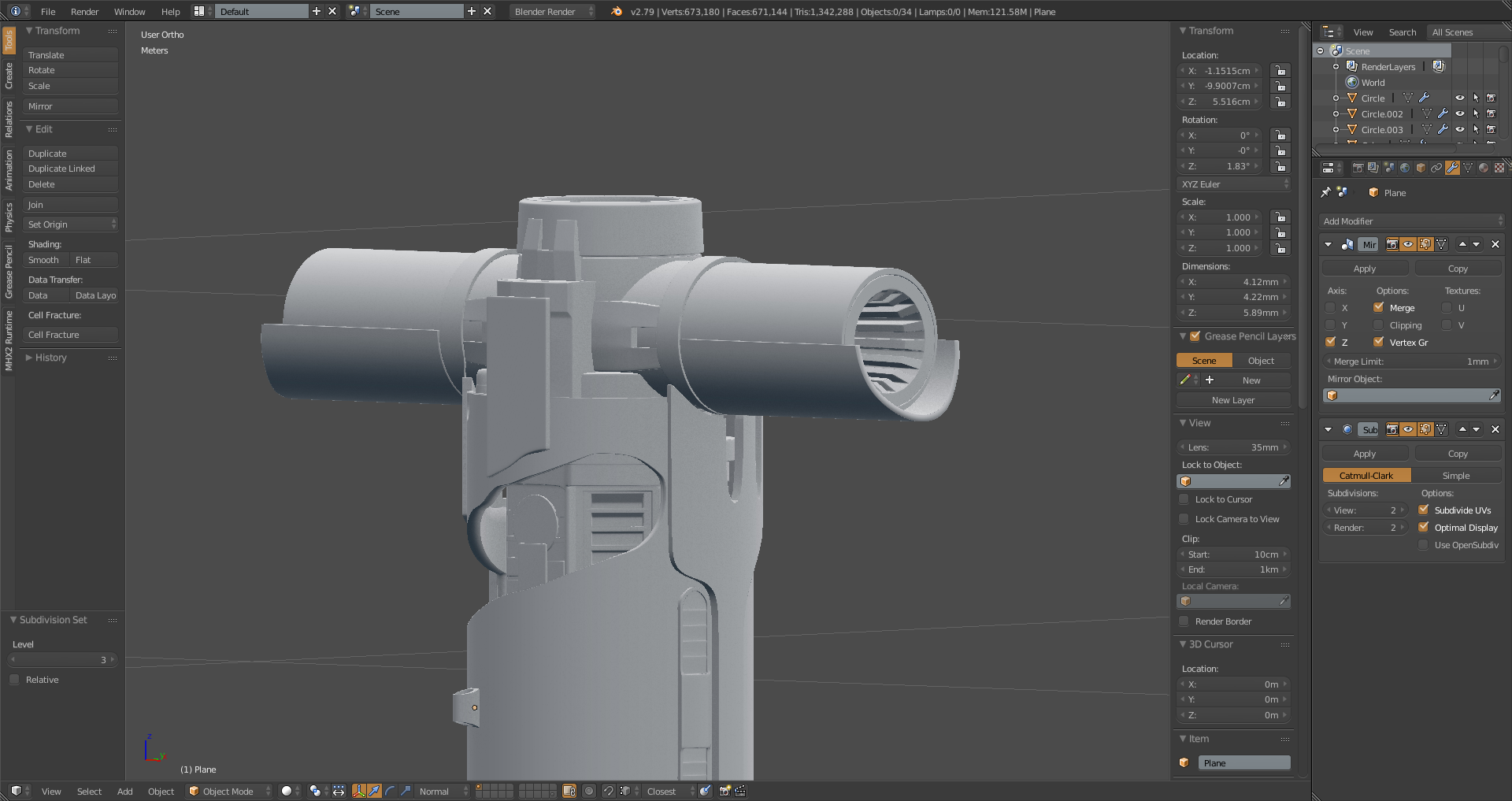

Firstly, on the lightsaber. Got most of the blocking out done now. Will probably tweak some shapes a little before finalising. But going well. This is my second attempt at modelling the lightsaber, and I'm finding it a lot easier to model, after learning a lot when I did my Helmet.

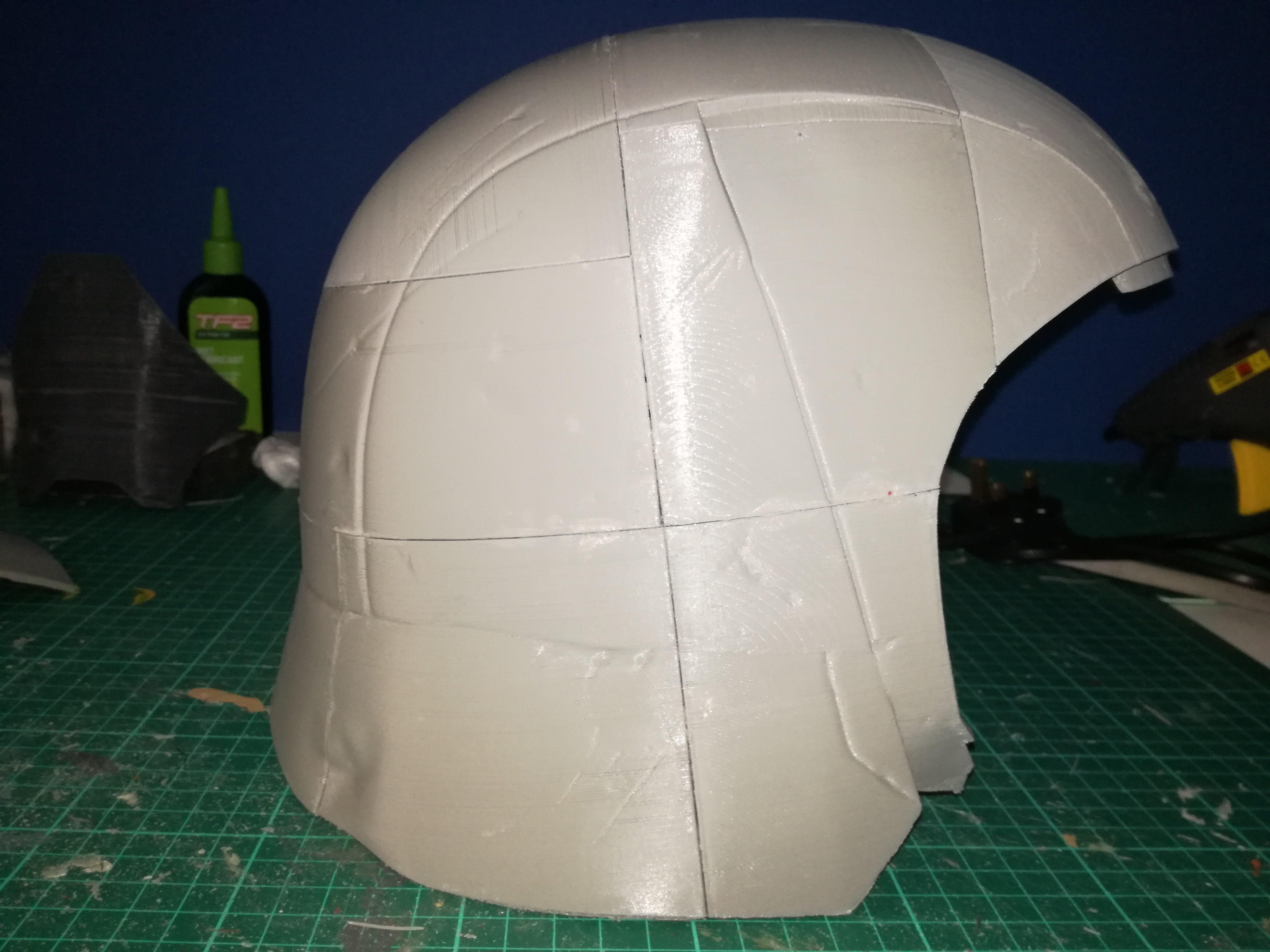

Re: Kylo Ren Helmet + Lightsaber Scratch Build
Finished printing the main dome part. Went together pretty well. 2 halves are just tacked together with hot glue for now. Will use my soldering iron to weld it all solid I think. Weighs around 450g which is pretty good! Most of the details printed out just fine at .2 layer height. Will probbaly lose a few of the small scratches in sanding, but am going to go back in with my dremel and touch most of it up anyway.

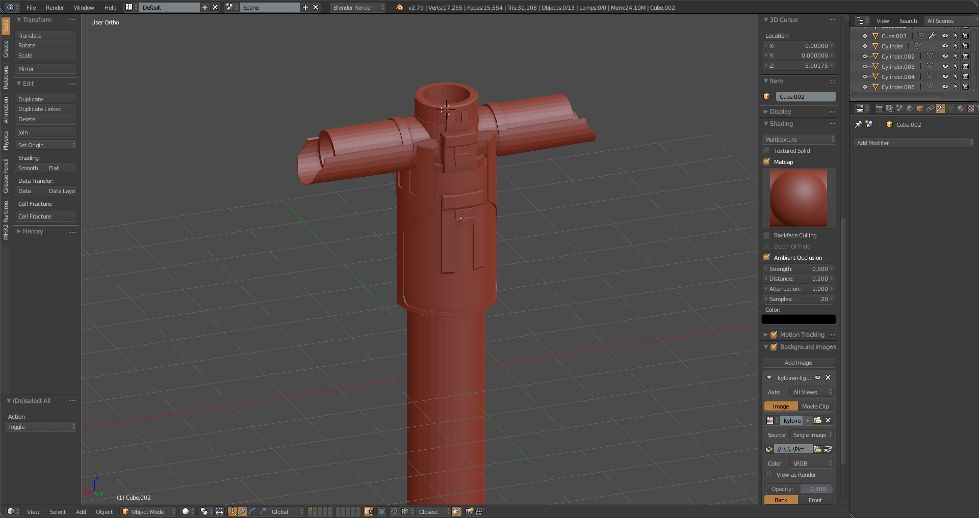

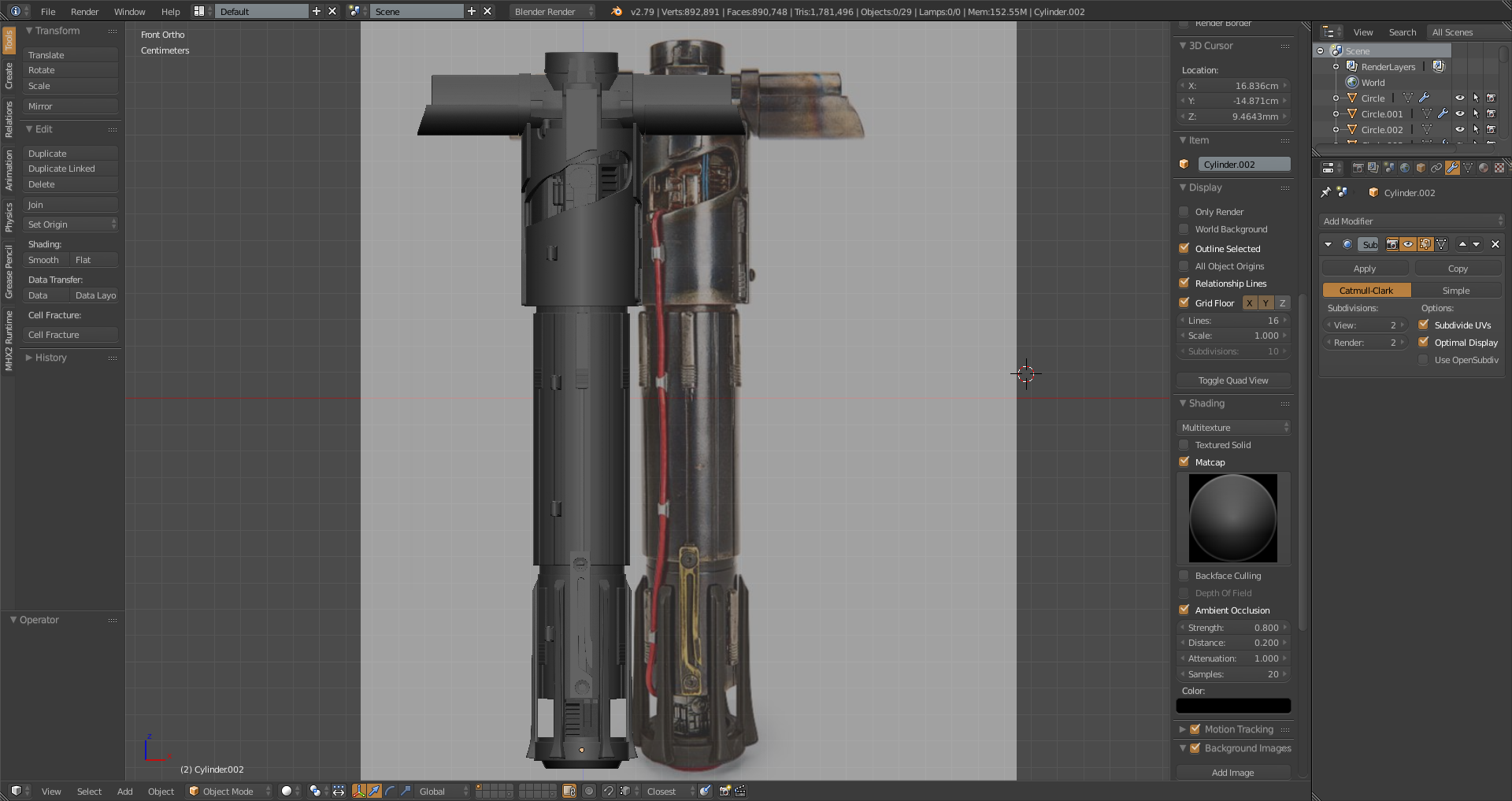

Little bit more progress. Finished blocking out Kylos Lightsaber more or less now.

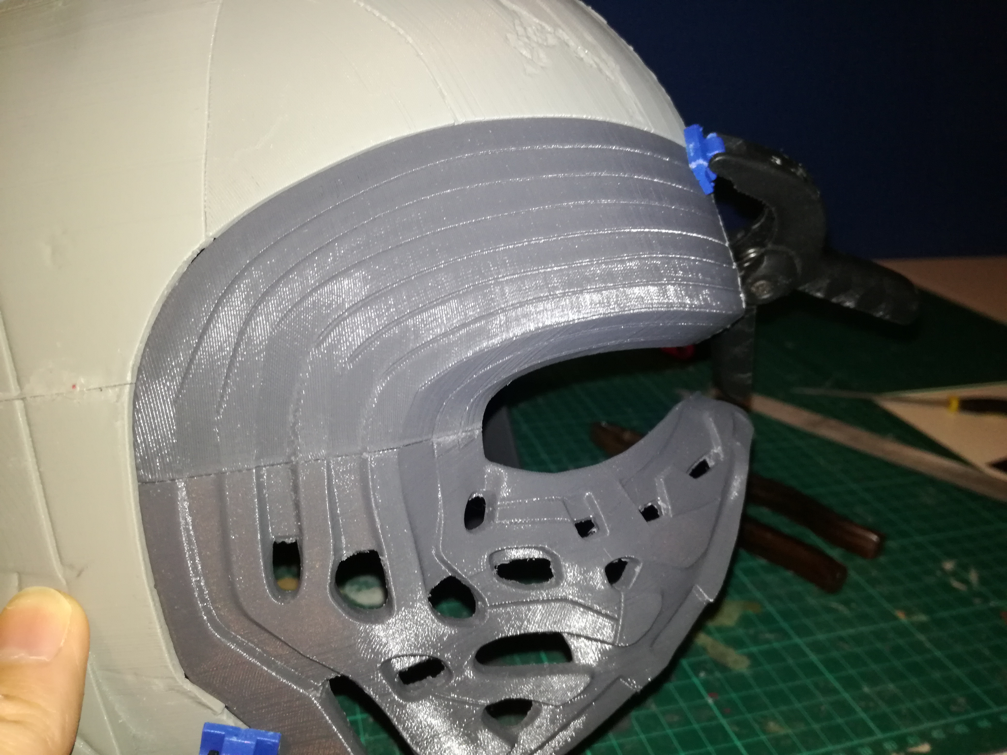

Also, half of the faceplate is now printed. Came out really well. Little bit of tweaking to get it to fit snug at the bottom, but it's not a bad fit as is. Edges just a different angles. Will check the 3D file to confirm how they should connect and work off that.

Almost finished the Lightsaber. Just some tweaks to make, add some edge loops etc...and then work on how it will all fit together. Will probably model the wire clips in Fusion360 just so I can get better control over them, especially considering their size. They're pretty small. But placed some placeholders there for now.

Almost done with the Lightsaber now. Couple of small tweaks, and making sure it all fits together nicely. I saw someone on here used Aluminium tubes for the wire clips, and that seems like a pretty good idea, so I'll probably do that, as printing them won't really work. Pretty happy with how it's turned out. The sanding of the helmet shall begin this weekend probably. May get the lightsaber printed at some point next week. Depends how long it takes to get this complete and print ready.

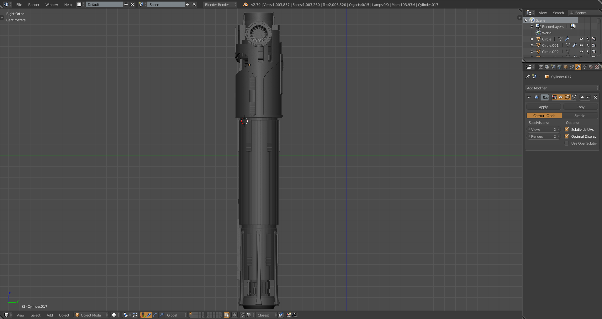

I got the lightsaber model finished! I've added an 8mm hole through the middle so that I can put a steel rod through. This is mainly to give it some extra weight, but will actually aid in assembly and give it some extra strength.
The pieces should slot together nice and easy.
Kylo-Saber-Finished-001.pngKylo-Saber-Finished-002.pngKylo-Saber-Finished-003.pngKylo-Saber-Finished-004.pngKylo-Saber-Finished-005.pngKylo-Saber-Finished-006.pngKylo-Saber-Finished-007.pngKylo-Saber-Finished-008.png

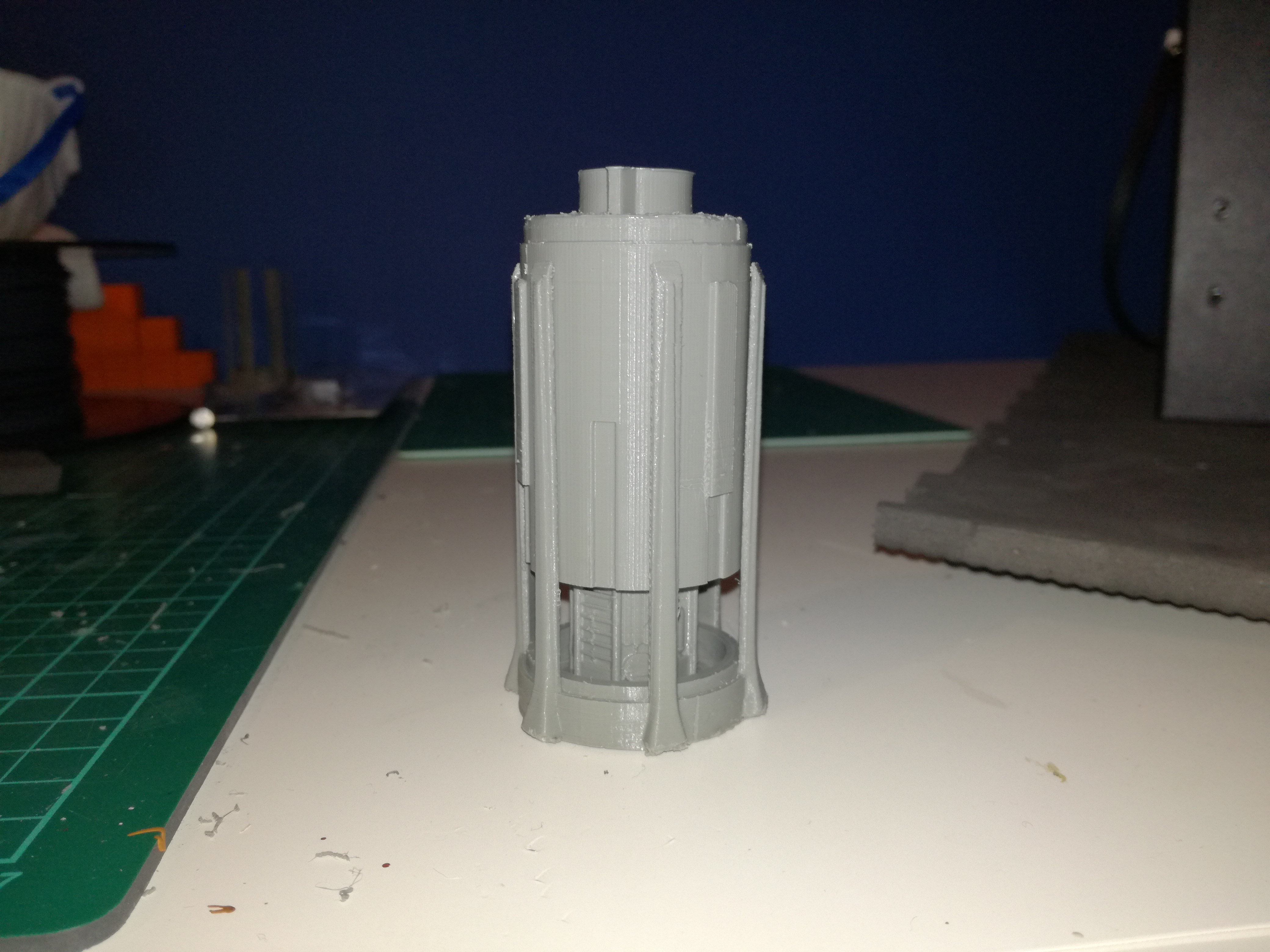

More updates. Started printing the lightsaber. The printer actually handles the small greebles at the bottom surprisingly well. I'm probably gonna end up re-printing these parts I have so far though, as some details haven't come out properly, and also, not entirely happy with a few bits now that I can see it physically. Things don't always transfer over that well from 3d space into reality. I'm gonna tweak a couple of bits, and then re-print them. I'll re-print though once I have the rest printed. That way I can see what I want to tweak, but also learn from these parts for the other parts.

Almost finished printing the lightsaber! For the most part, it's printed very cleanly at a 0.1mm layer height, so sanding should be pretty simple. I will reprint a couple of parts though, as mentioned in previous post.
