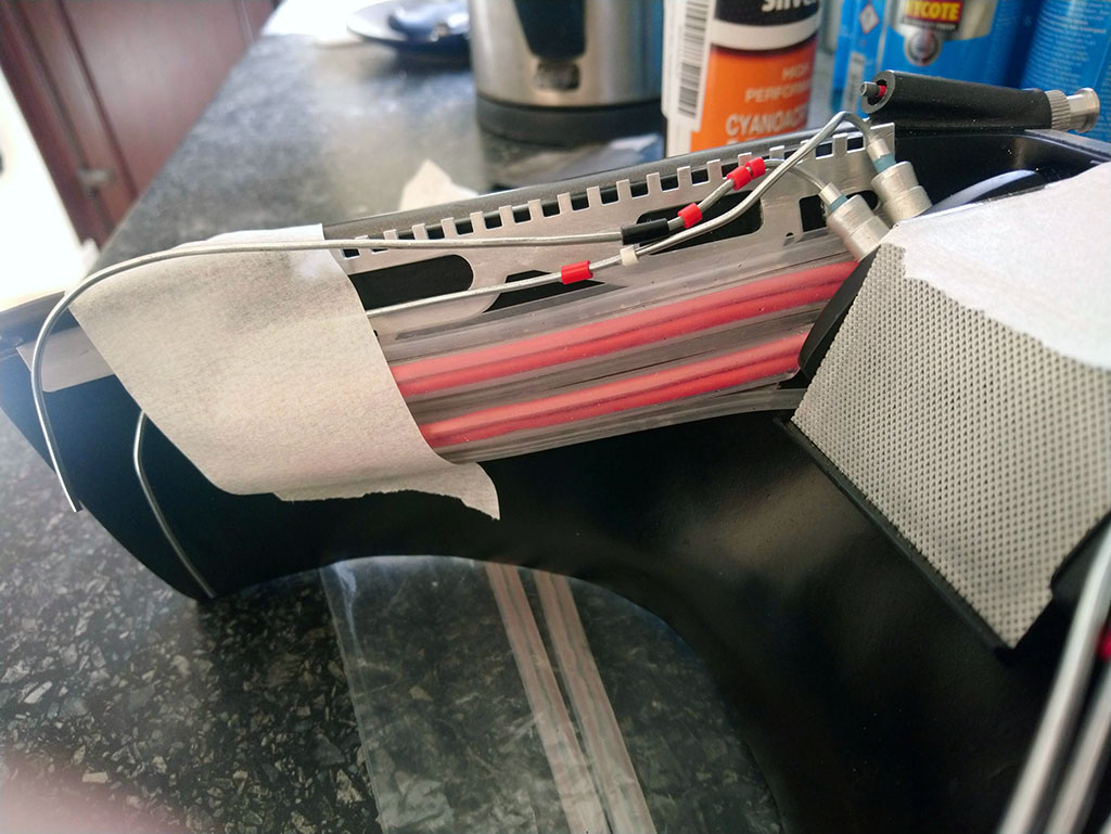

kurtyboy
Added the little gray tubes sticking out the back of the tusk tubes.

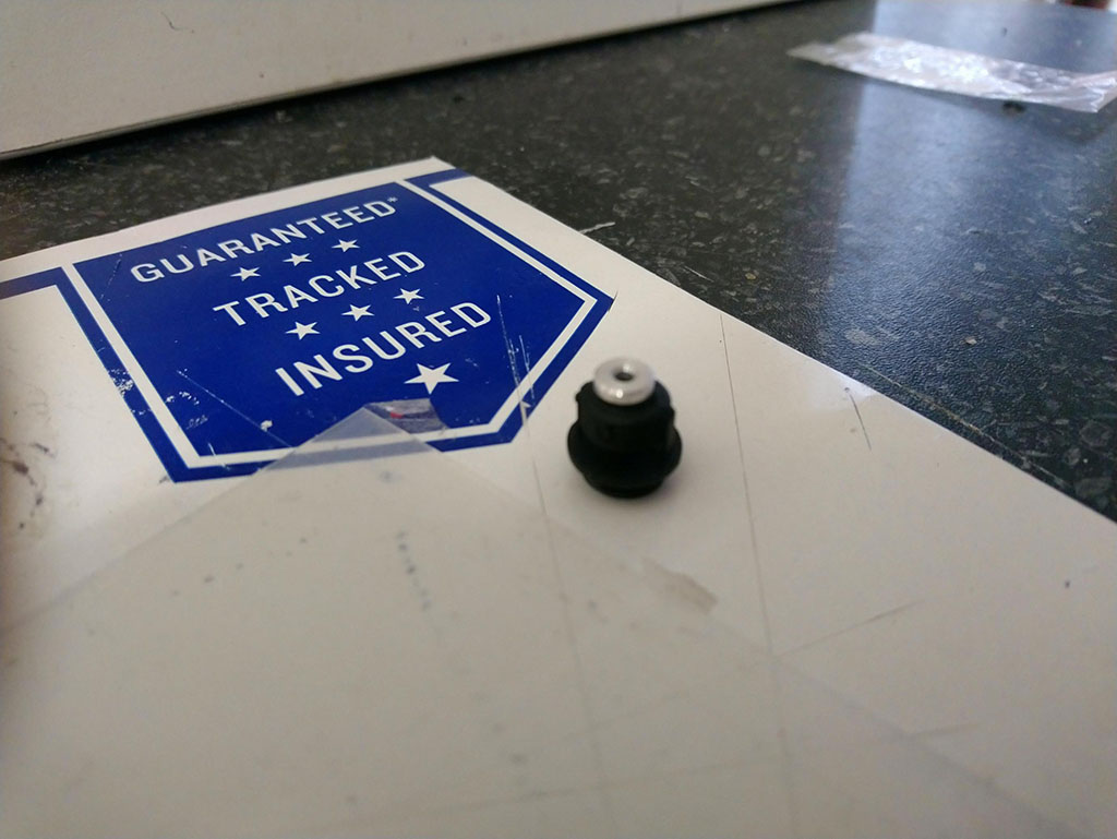

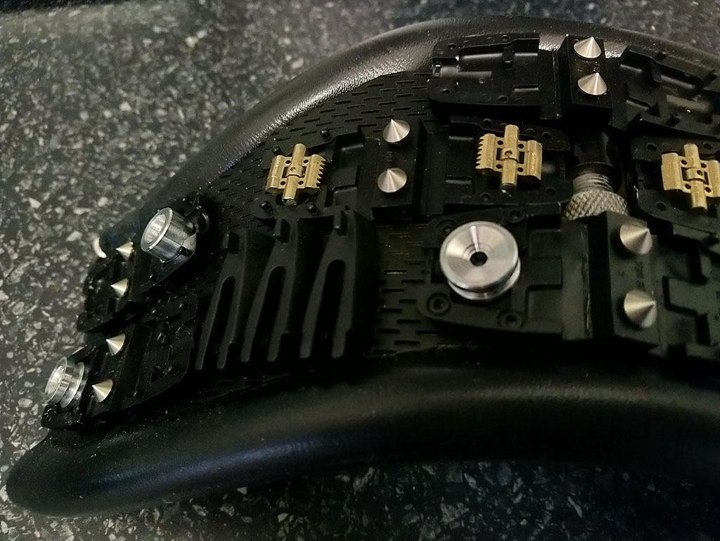

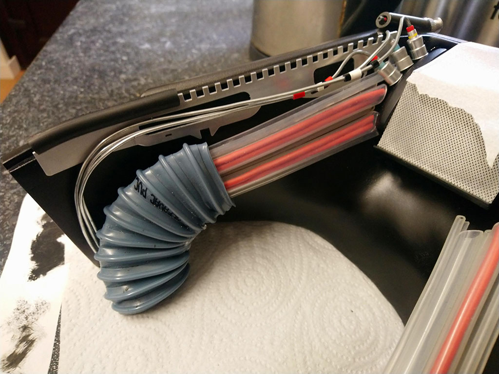

kurtyboy

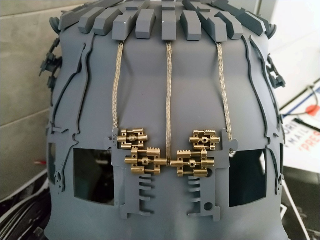

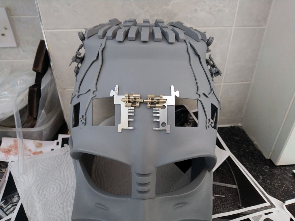

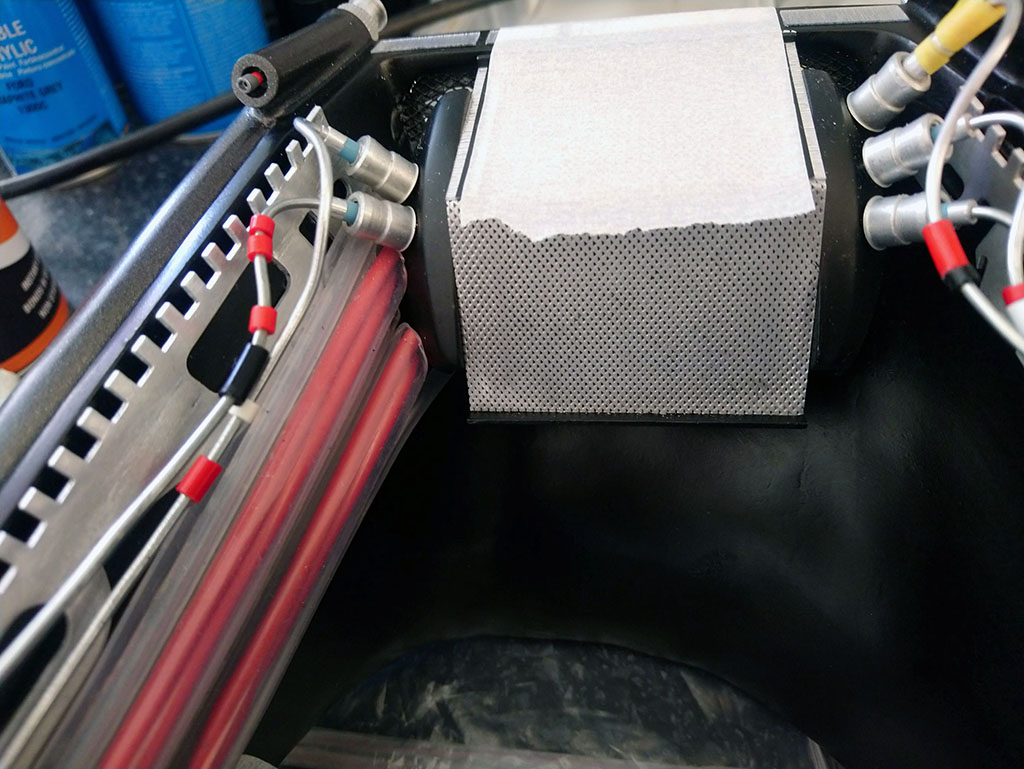

Got some machined parts in. The washer for the V8 part and the three odd neckbrace wheels.

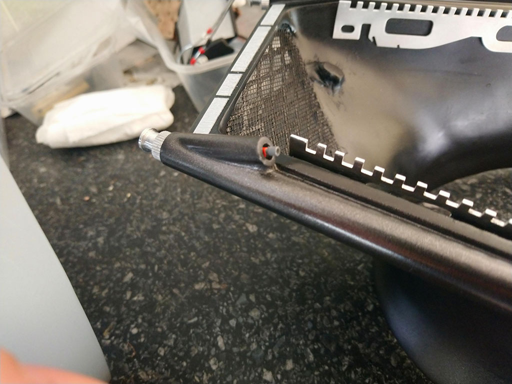

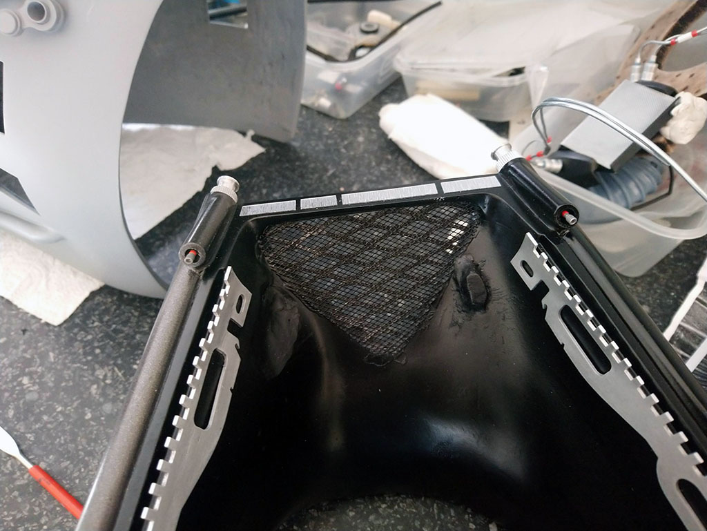

A test fit with a non-accurate piece of ribbed tubing. At least I found a good glue for sticking silicone to silicone. Comes with a primer. Brush the primer onto both parts, wait for it to dry then brush on the glue. Sets in seconds and is very strong. Regular superglue made a weak bond.

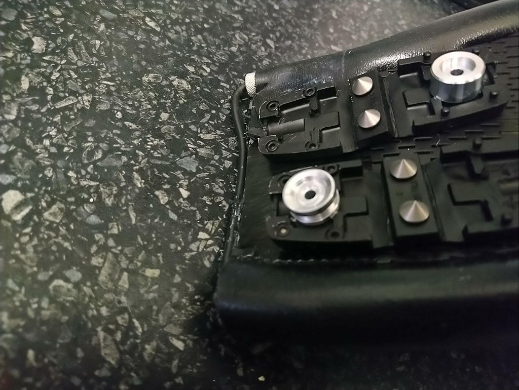

kurtyboy
The rubber trim for the back of the upper mask was easy to cut thanks to a handy seamline right along the path to cut.

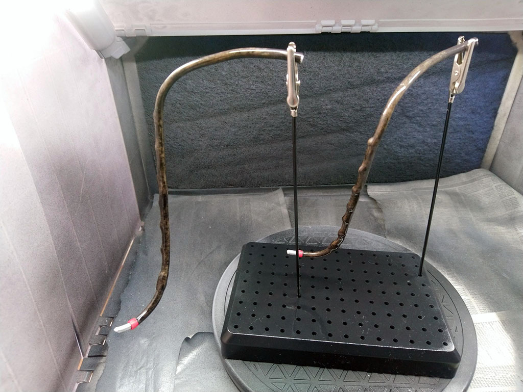

kurtyboy

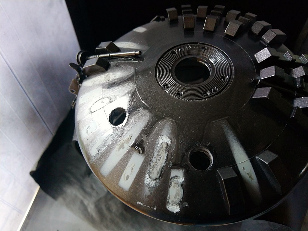

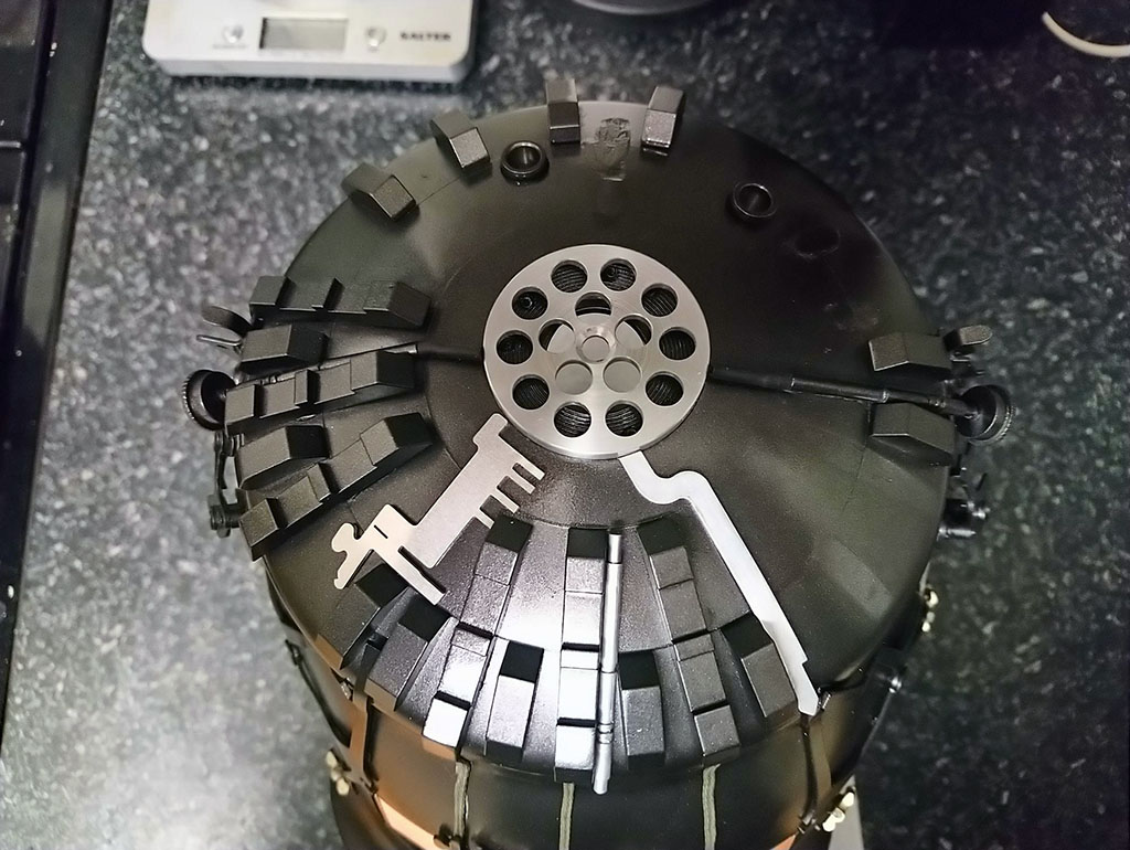

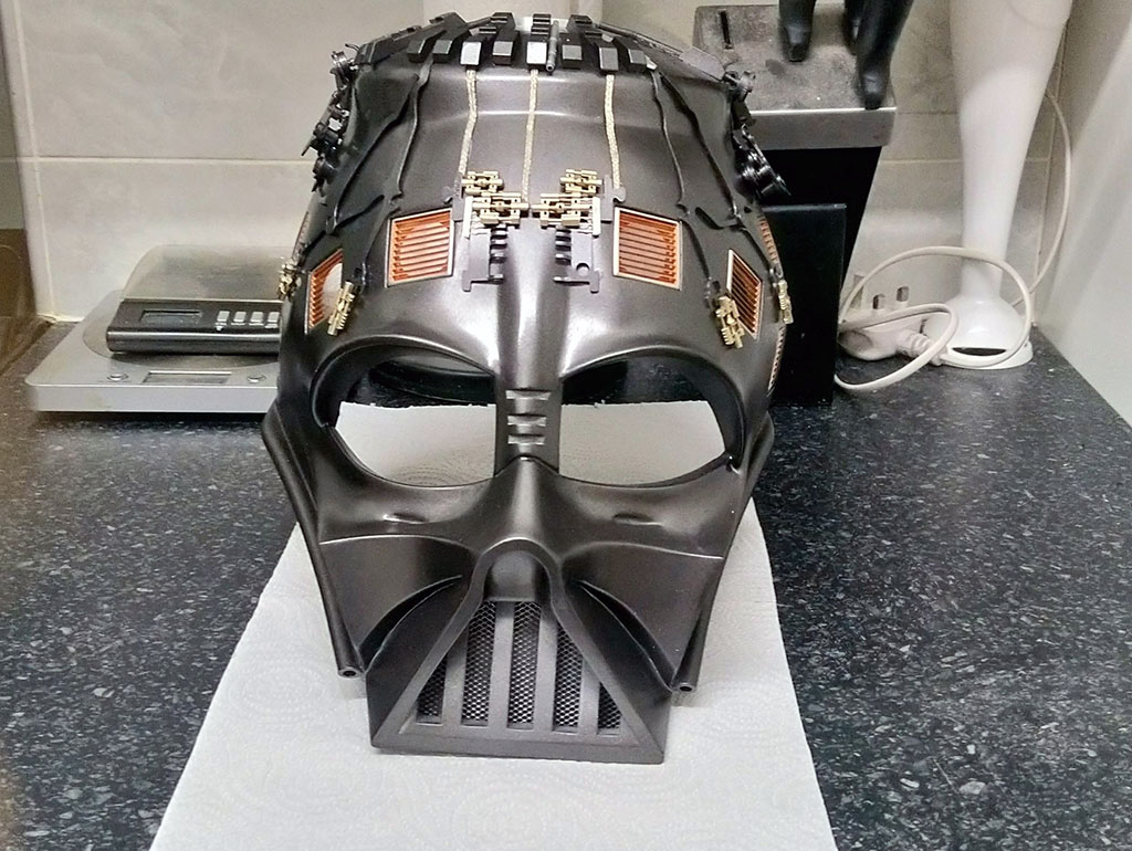

Had a bit of a problem when I painted the gunmetal. Lots of paint runs and pooling on the crown even between some of the keys. So I had to remove half the keys and sand it back. Came out okay and I just need to repaint some keys and reattach them. I did lose some of the etched circles though because the paint went on too thick.
