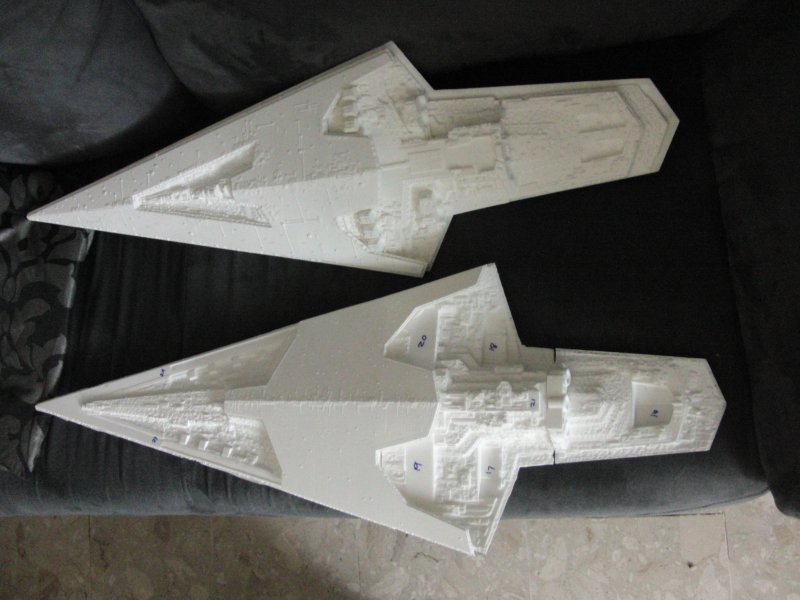

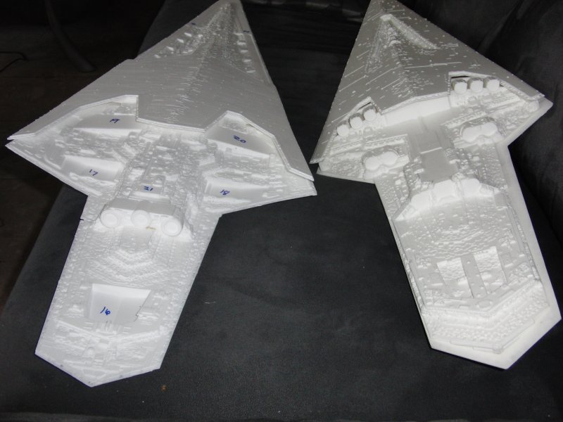

In my opinion, the Knightwire is more true to the original, while the Korbanth is easier to light.
Both kits have numerous bubbles in the castings, especially in the buildings.

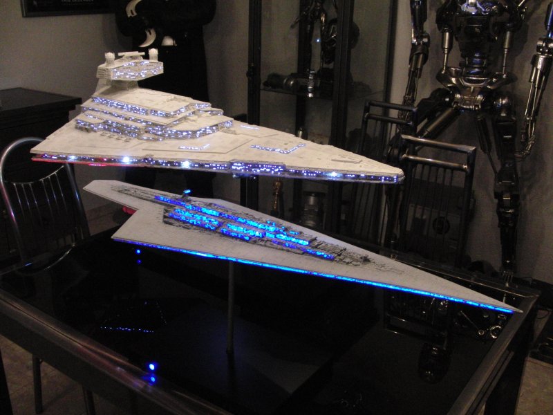

Here are a few comparison pics:
I chose the Knightwire to be build.

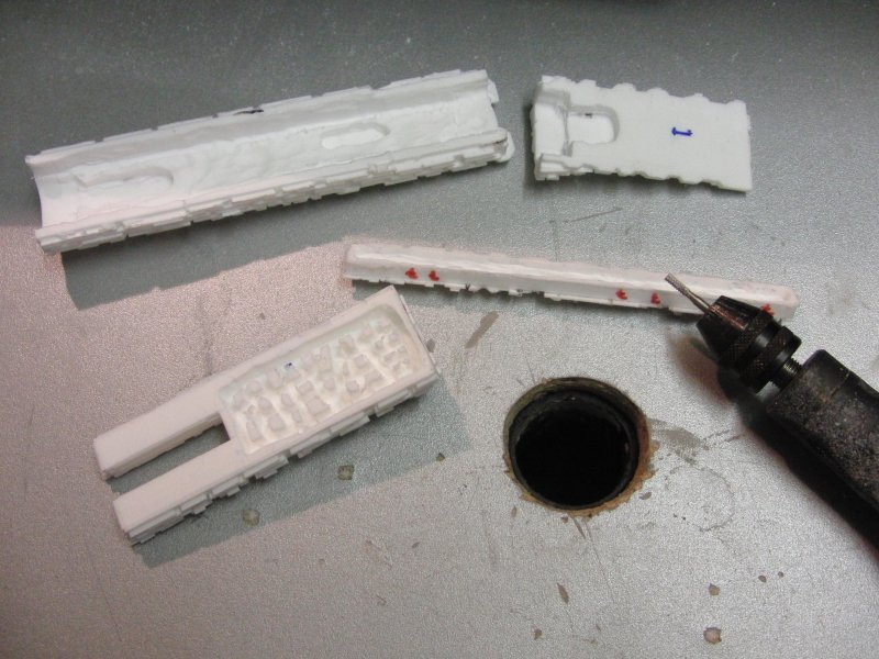

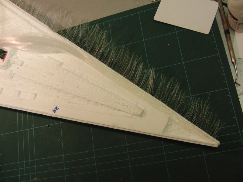

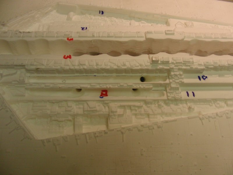

First I dremeled out a lot of material, to make room for the FO strands.

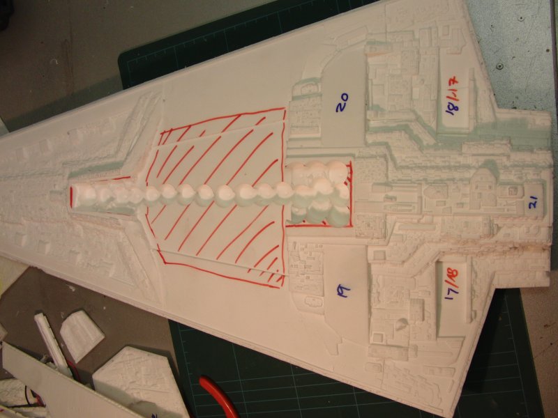

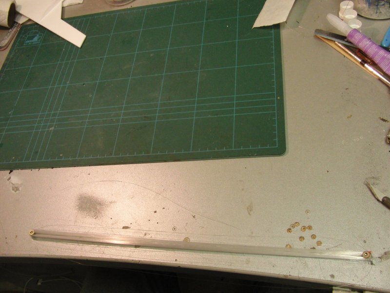

Here's my "special technique" for the bundling of the fiberstrands :D
The fibers in one trench...

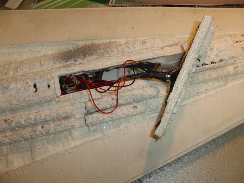

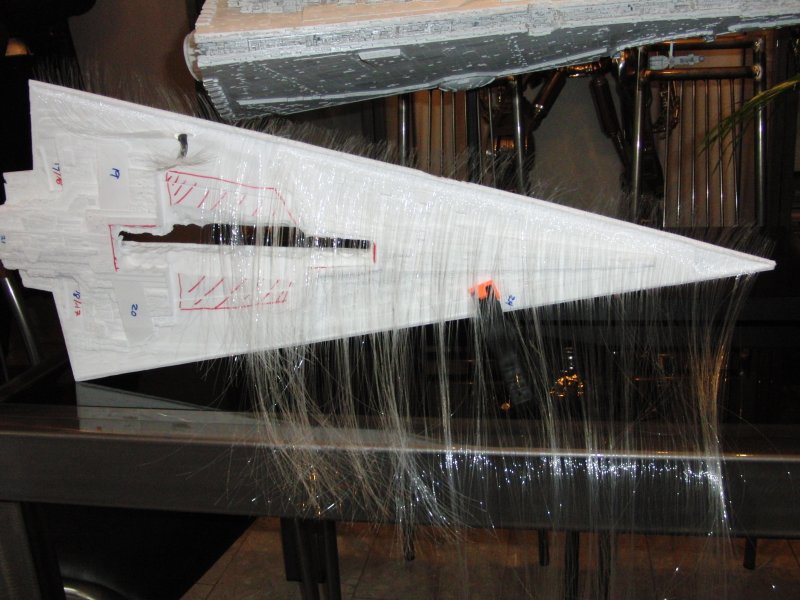

All fibers where bundled to strands of about 200 single pieces. Shrinktubing was then applied and after heating cut straight with a dremel cutting wheel. The LED was then placed in front of the fibers and fixed in position by wrapping it in self adhesive aluminum tape. Another layer of shrink tubing did the job then.

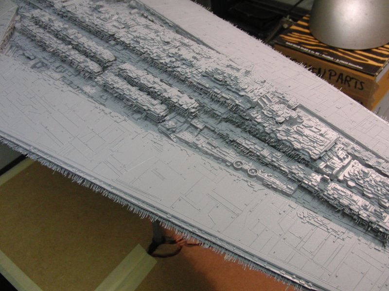

Here's the model prior to painting:

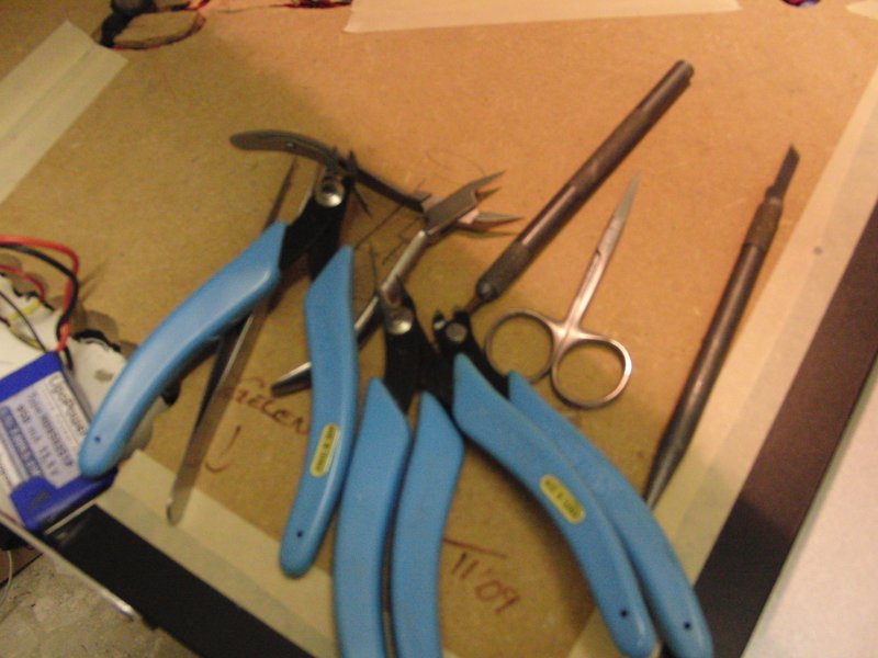

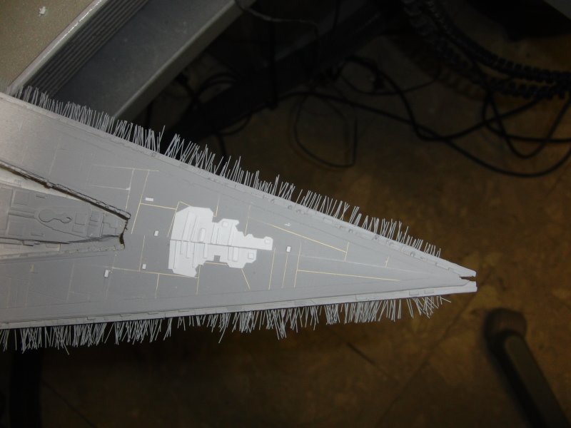

I used these tools to cut of the fibers after painting. I learned a lot building the Randy Cooper SD. Mostly a sharp #11 blade did the job.

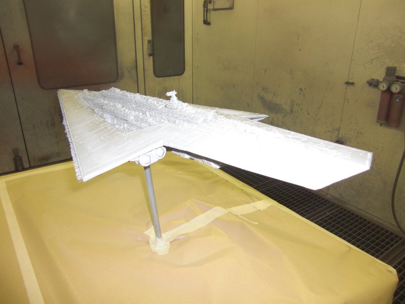

The model painted in automotive grey/blue water color (NEXA Aquabase Plus Engine Bay).

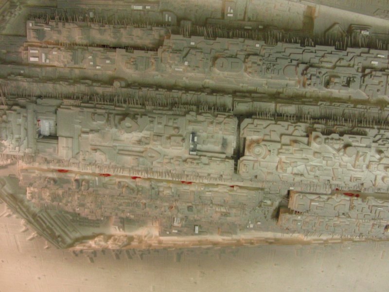

Some fibers cut off, 10,000,000,000 or so more to do ^^

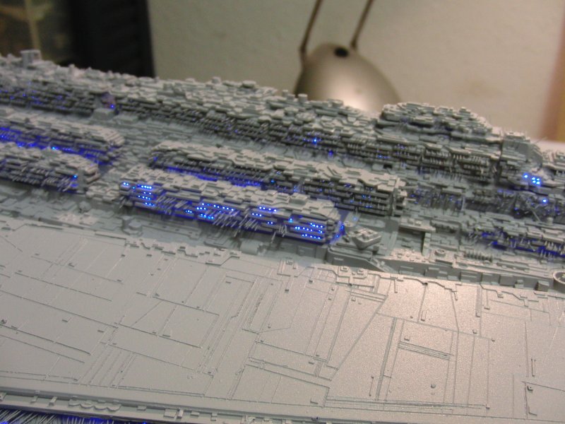

The finished model. So far I only airbrushed the buildings in a darker grey. In this scale, weathering gives me a headache.

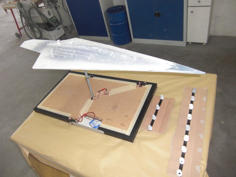

It took me 130 hours to complete this kit as you see it here. 5,761 holes where drilled for the fibers. Each fiber has a diameter of 0.25mm. I did not count how many meters of fibers I used but I had to reorder when I suddenly went dry :D The base features a blue LED for indication that the power is on. The 11.1V custom lipo pack can be decoupled. Base is made of MDF with an aluminum plate.

I'm curious as to what you used to cement the fiber optics in place.
Cementing the FOs in not as simple as it seems. I used the recommended white glue for my first fibers, but when the stuff is dry, there is almost no grip and the fibers separated from the holes.
Hot glue is way to messy and if you are not carefull, you will melt the fibers:eek
In some places where there is no strong curving of the strands, I simply used super glue with zip kicker. It CAN make the fibers brittle, so you have to be carefull.
I mostly used 2K Epoxy applied with a gun:
The good thing is, you don't have to mix yourself. The (one way) tip will do the mixing. The bad thing is, each tip costs money and has to be discarded after glueing. But there's so much work involved with fiberoptics, I don't really care spending a few more bucks for a safe solution.
