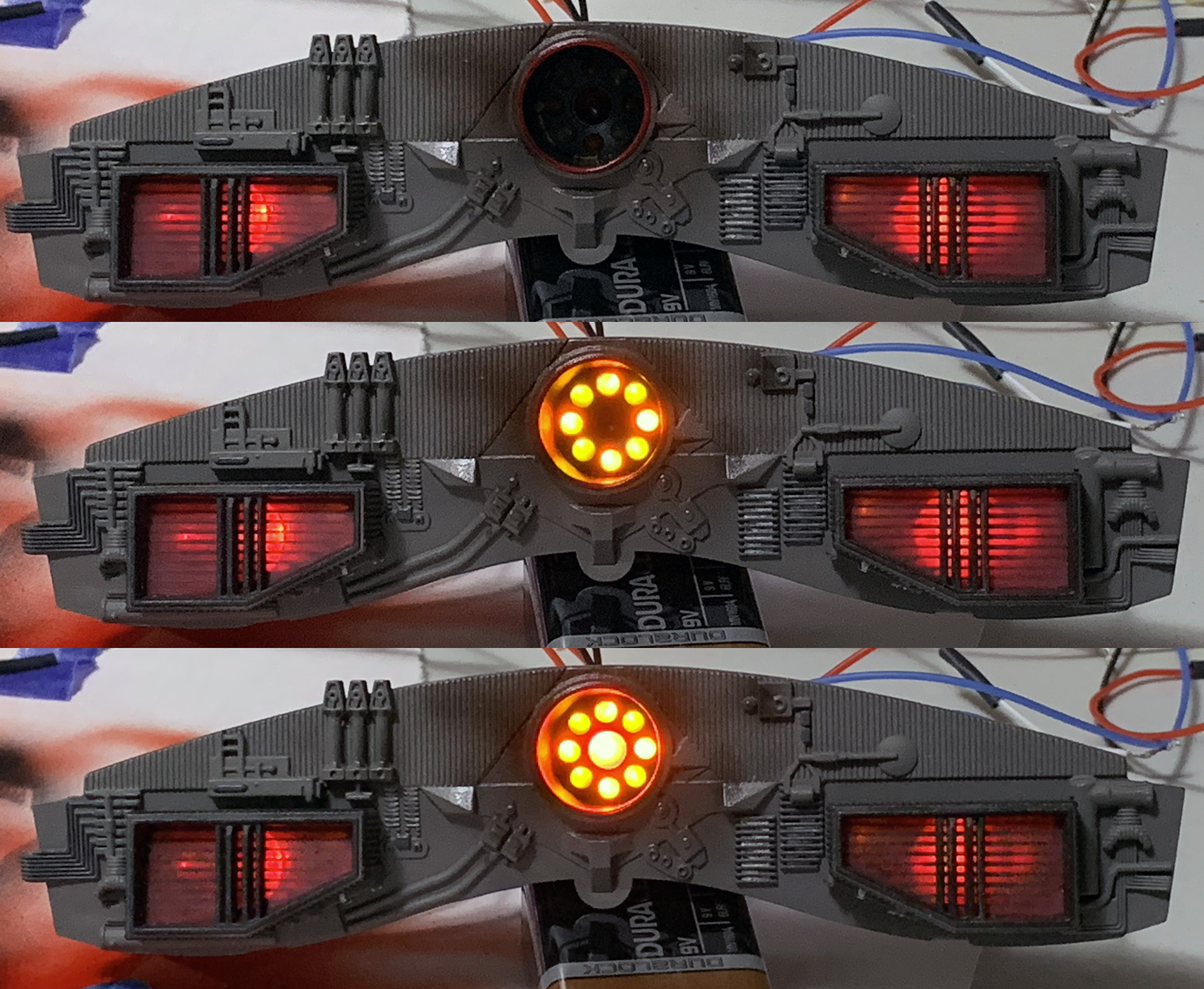

Torpedo firing -This is using the Tenacontrols Option C lighting system which uses the photo etch parts. I used one of the Green Strawberry photo etch torpedo plates. I then replaced the 1.8 mm orange LEDs in the Tena kit with alternating 3mm orange and yellow LED's and a red 5mm LED in the center. I got the idea for replacing the bulbs from a video by TrekWorks. A lot of what I am doing is based on his build. He has videos on YouTube.
Impulse Engines -I sprayed Tamiya clear red on the inside of the transparent engine covers and lightly frosted the outside. There is a photo etch grillpart behind that from the Paragrafix set. For each engine I used a red center 5mm LED and added another 3mm red LED on one side and a 3mm orange LED on the other. The Tena controls pulsing feature looks really good!
